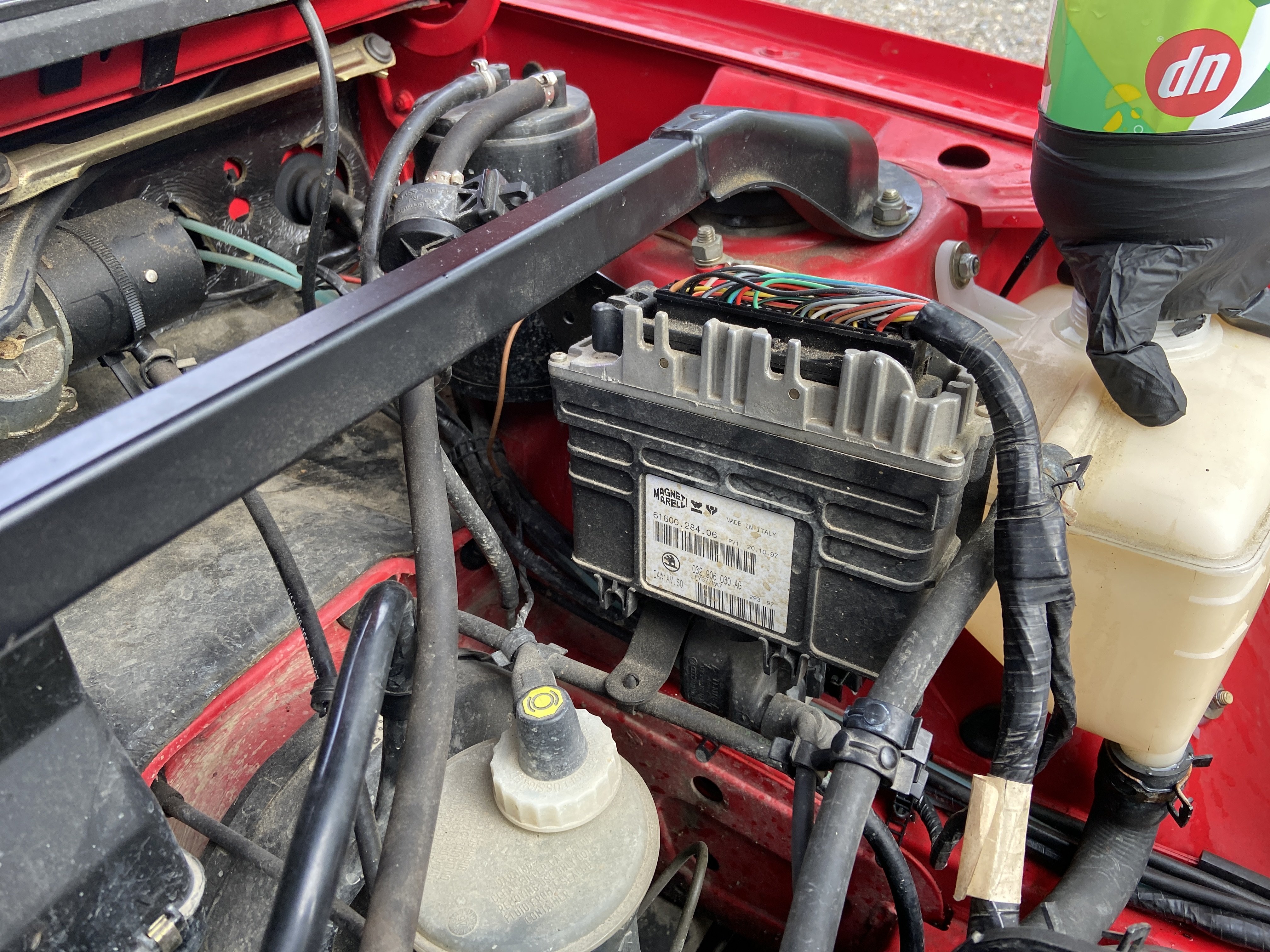

  • Looks like a bodge to me, I wonder if someone had previously wired-in an override switch to that loom.
  • My concern is over the very existence of those joints, not the quality of the work under the tape.

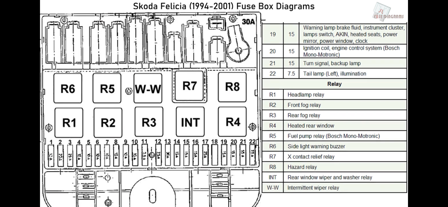

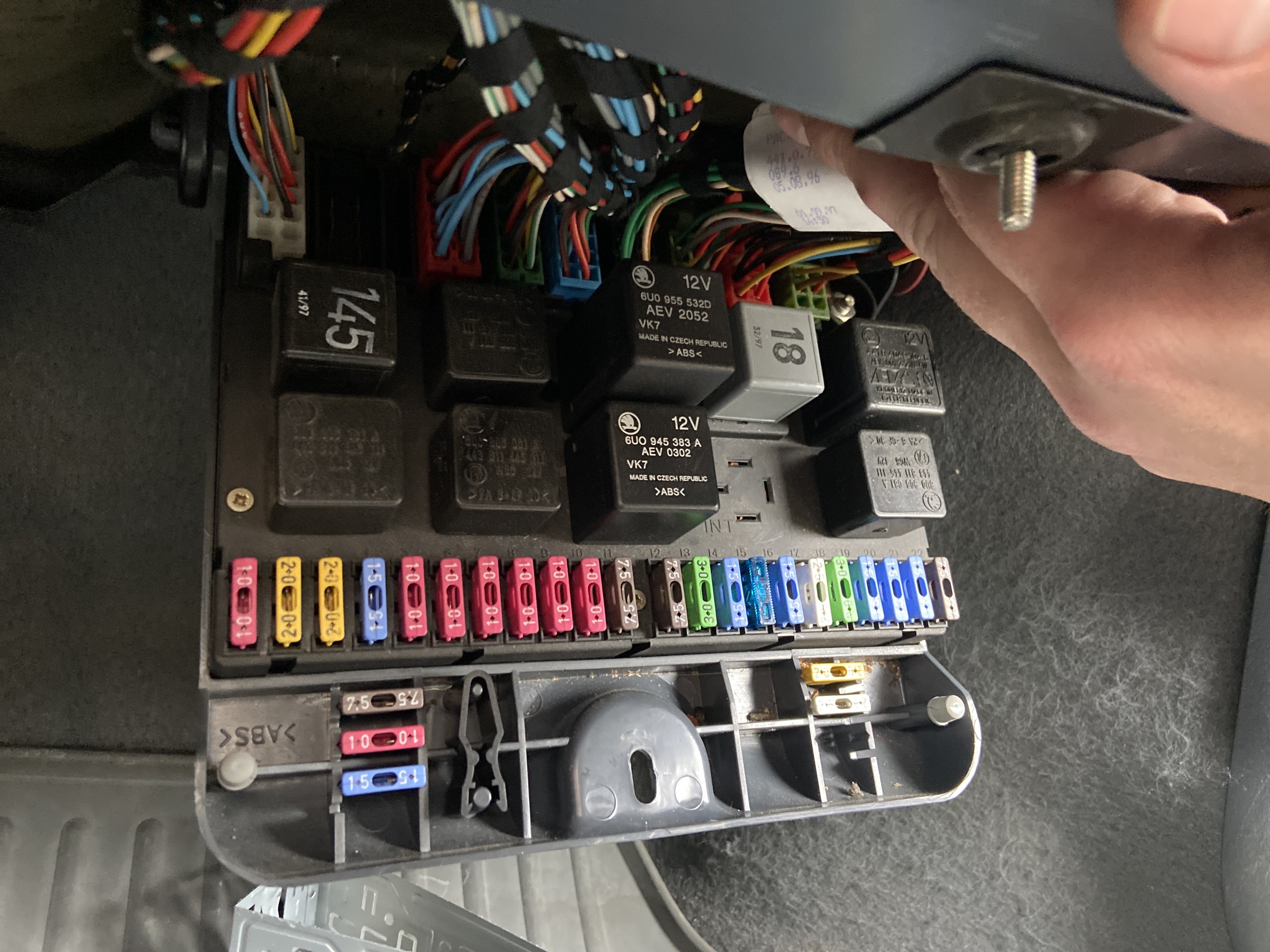

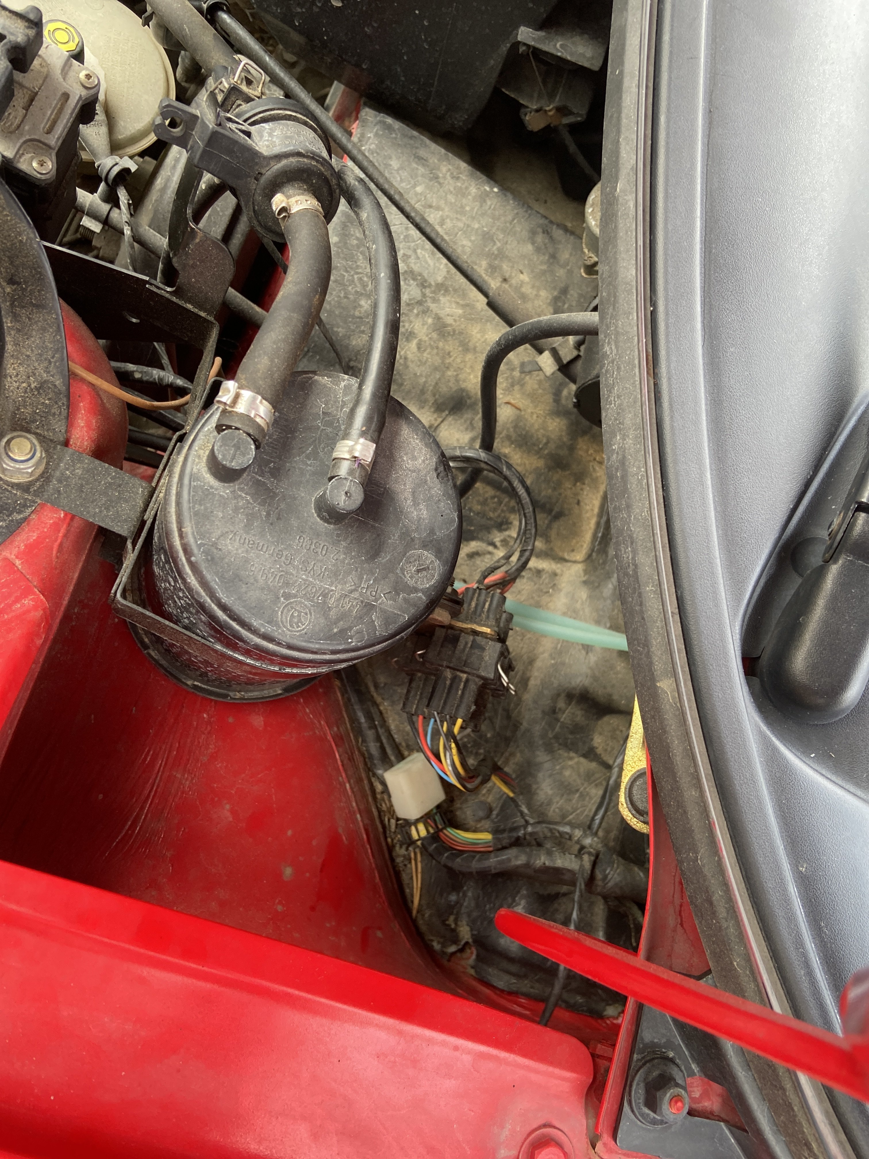

Am i dumb or… cant see a relay…?
3 hours ago, Papez said:
there are more types of AC. Factory type has relays and fuses near activated charcoal canister, on the opposite side from the battery.
@Felicia98noob f

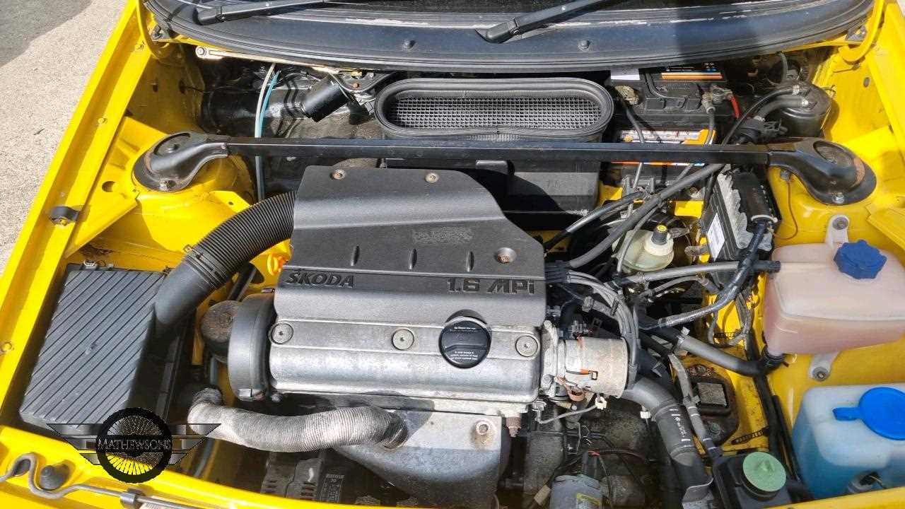

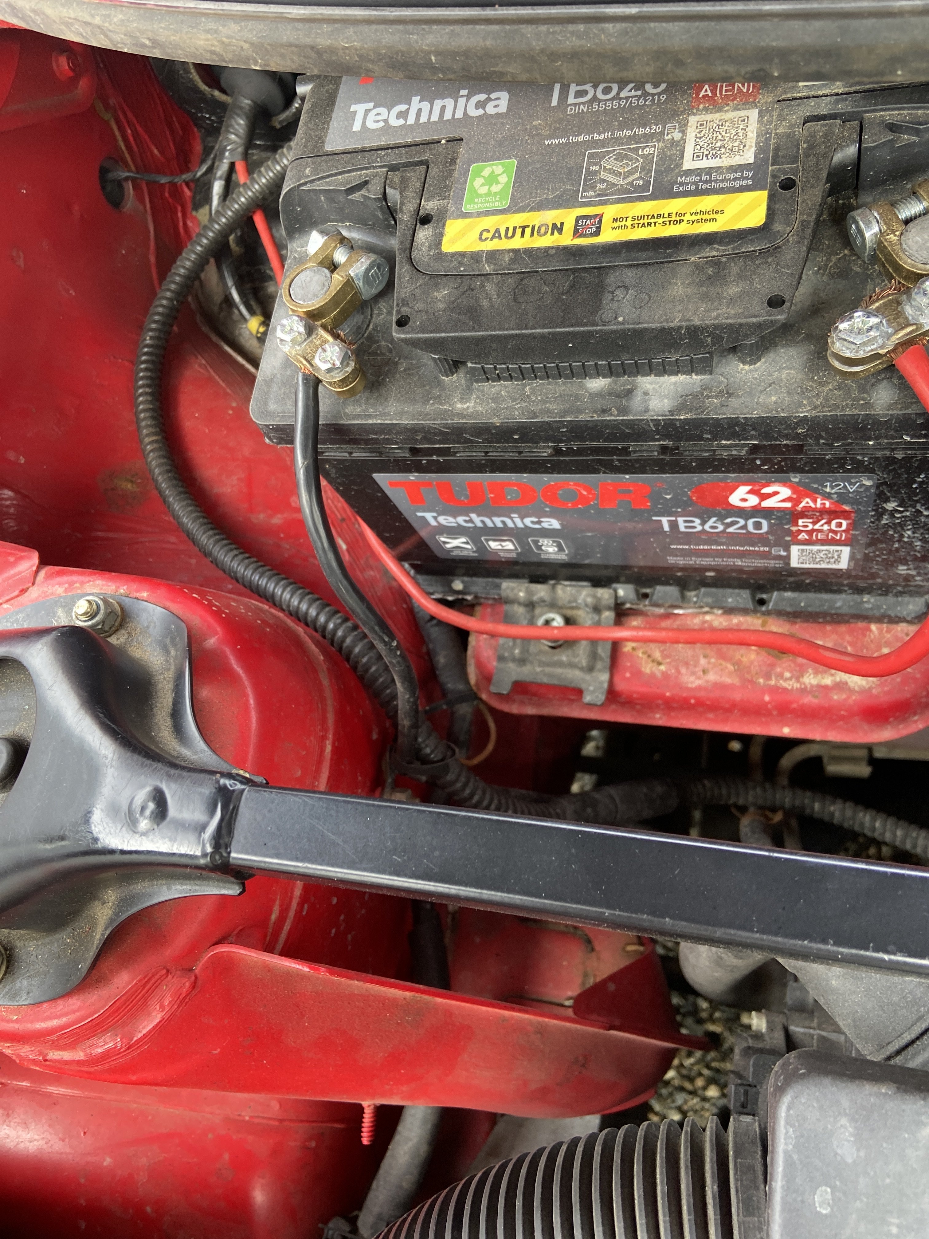

In this case I see a strut brace that looks newer than the car but I could well be wrong, where strut braces standard to the car from factory?
No clue man.
Looks like factory brace - they were standard on cars equipped with airbag.

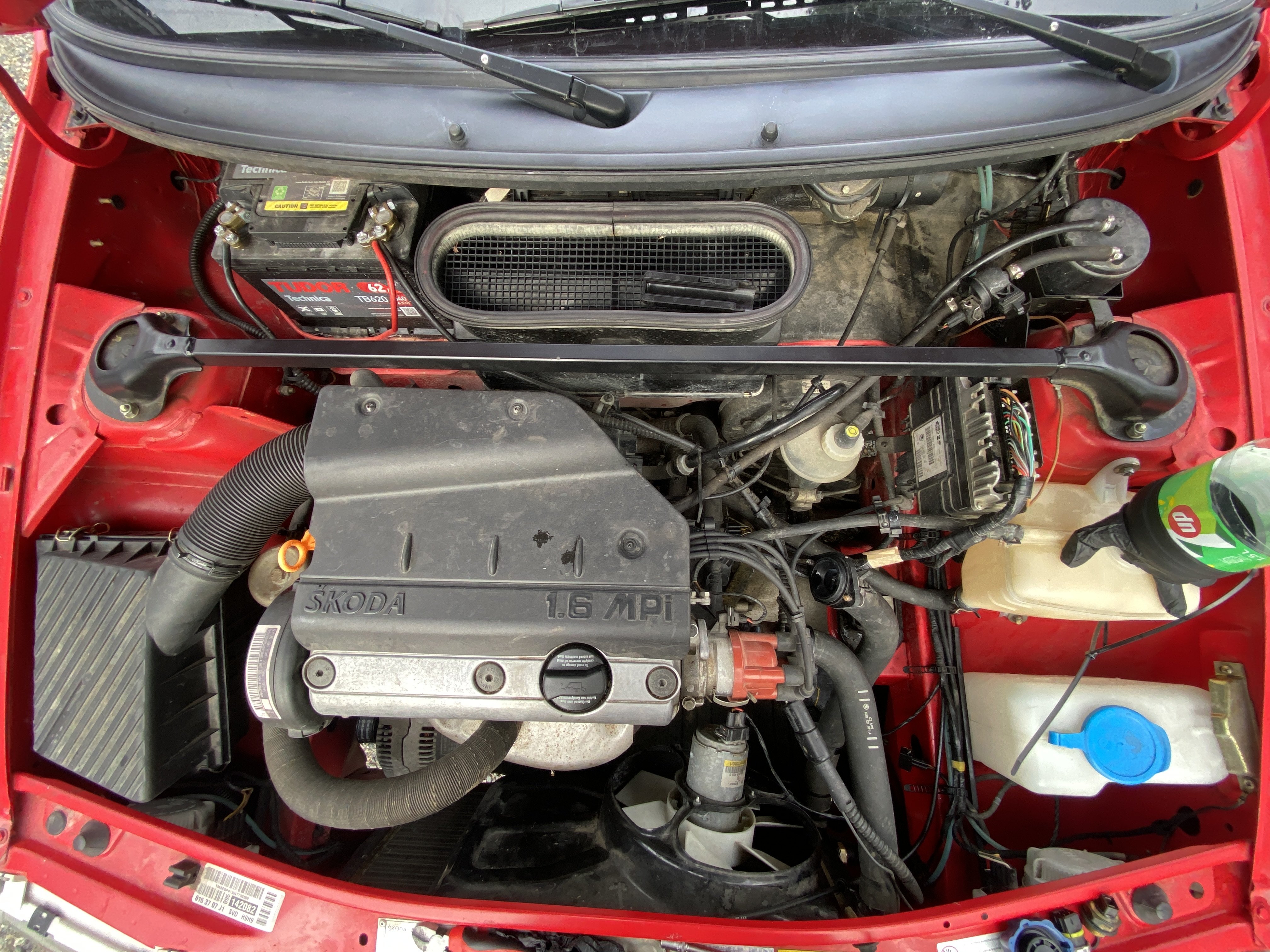

@Felicia98noob can you make a pic of the entire engine bay?
Could it be in there? 😂
Just found these haha maybe one of these?

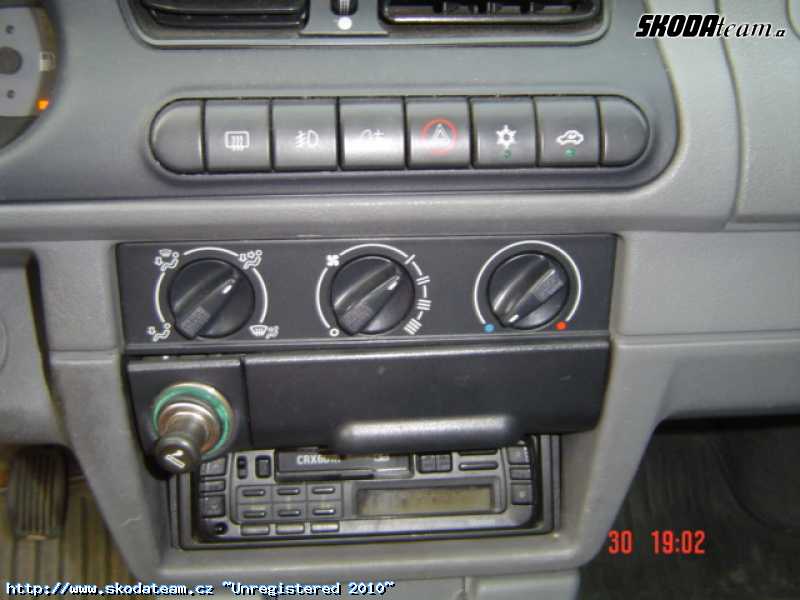

@Felicia98noob from what I can see, your car doesn't have AC. That means that radiator fan is switched directly by the switch in the radiator. It also kicks in rather late, when temp gauge shows around 105° - (+-5° or more, since these switches can drift quite a lot with age)
Not one of those i guess

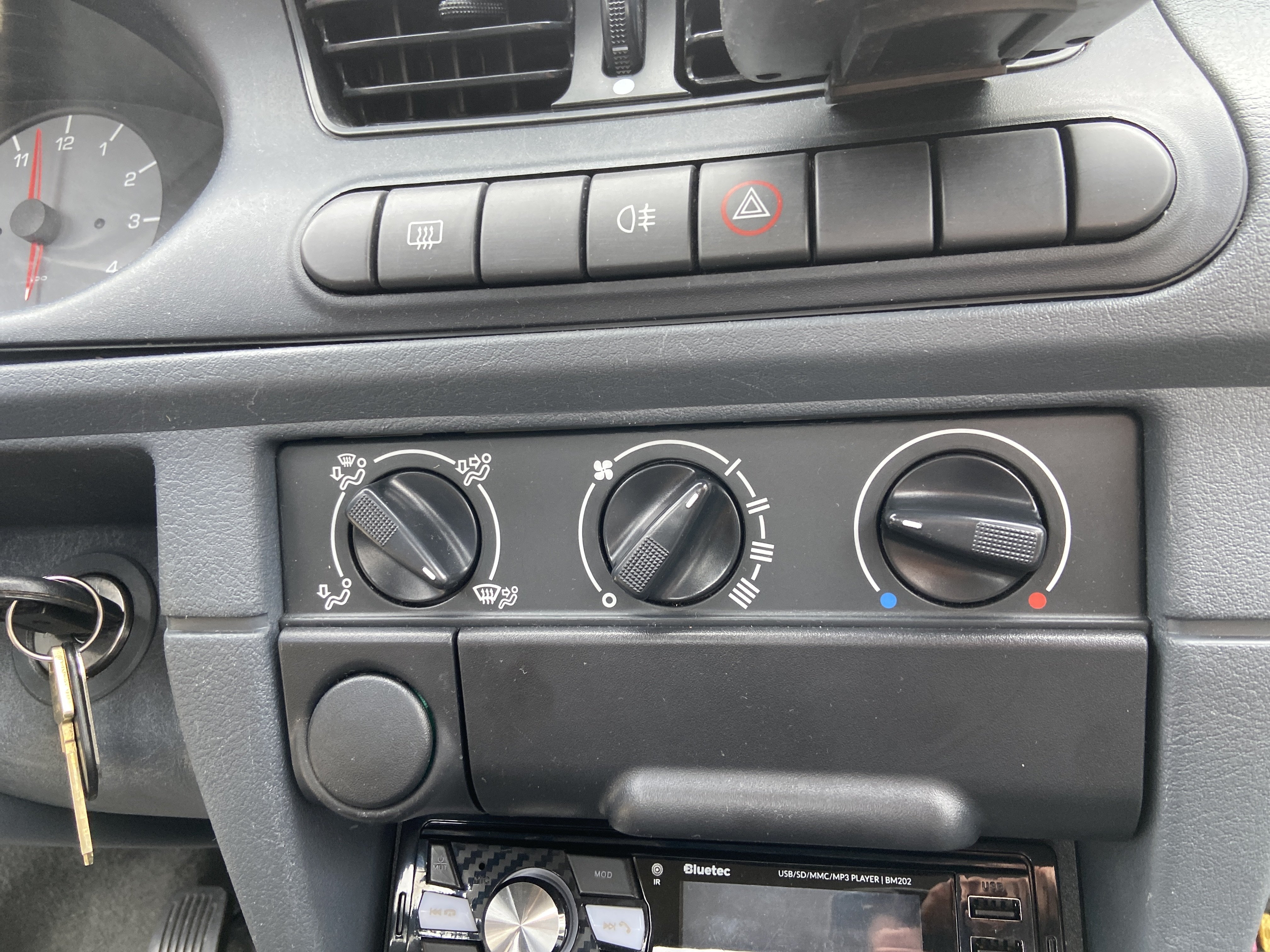

Oh okey hahahahahha, i thought it had because if these things 😂

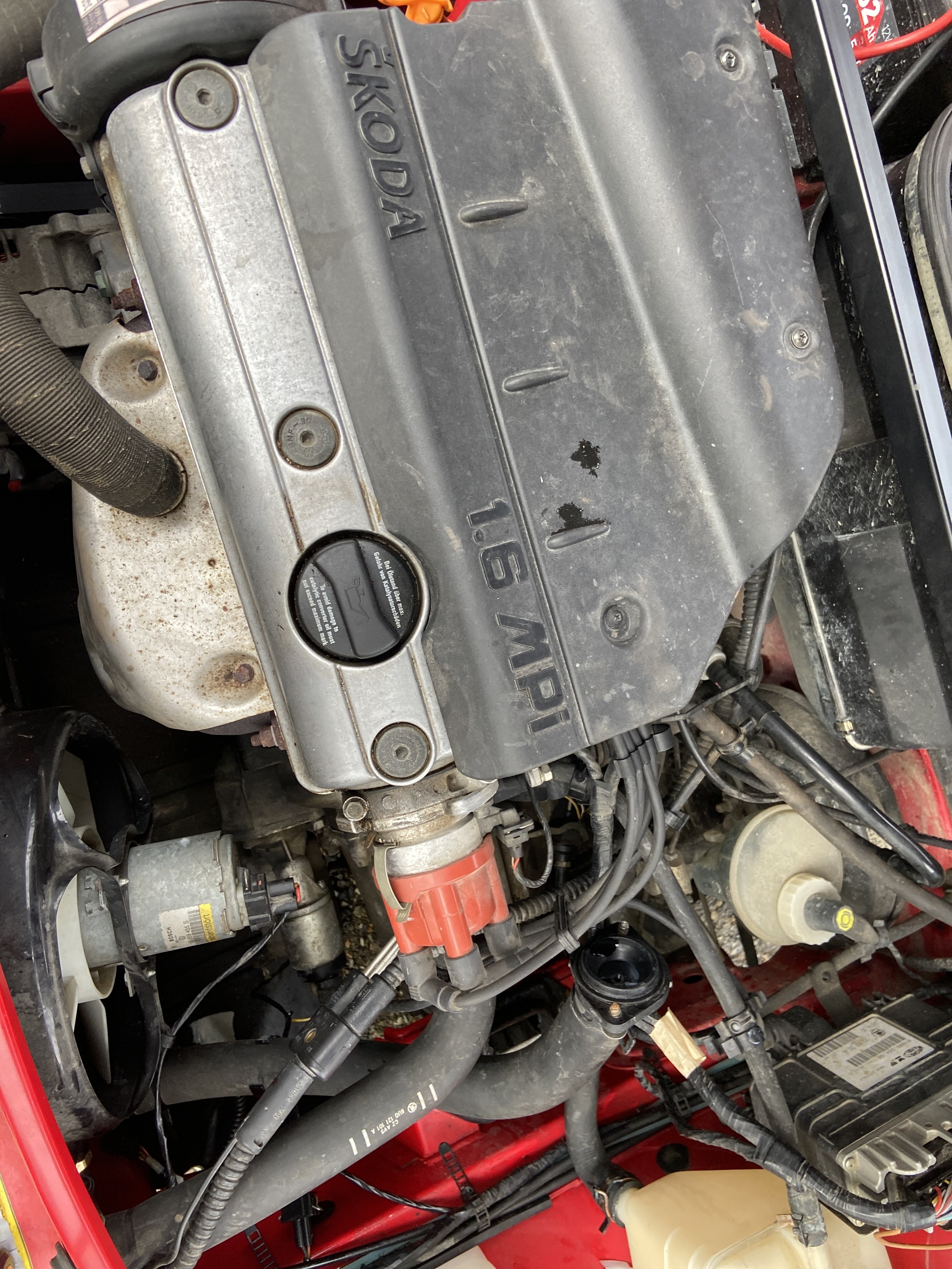

Car looks very good in your photos.  Oil filler cap upside down ! 😆

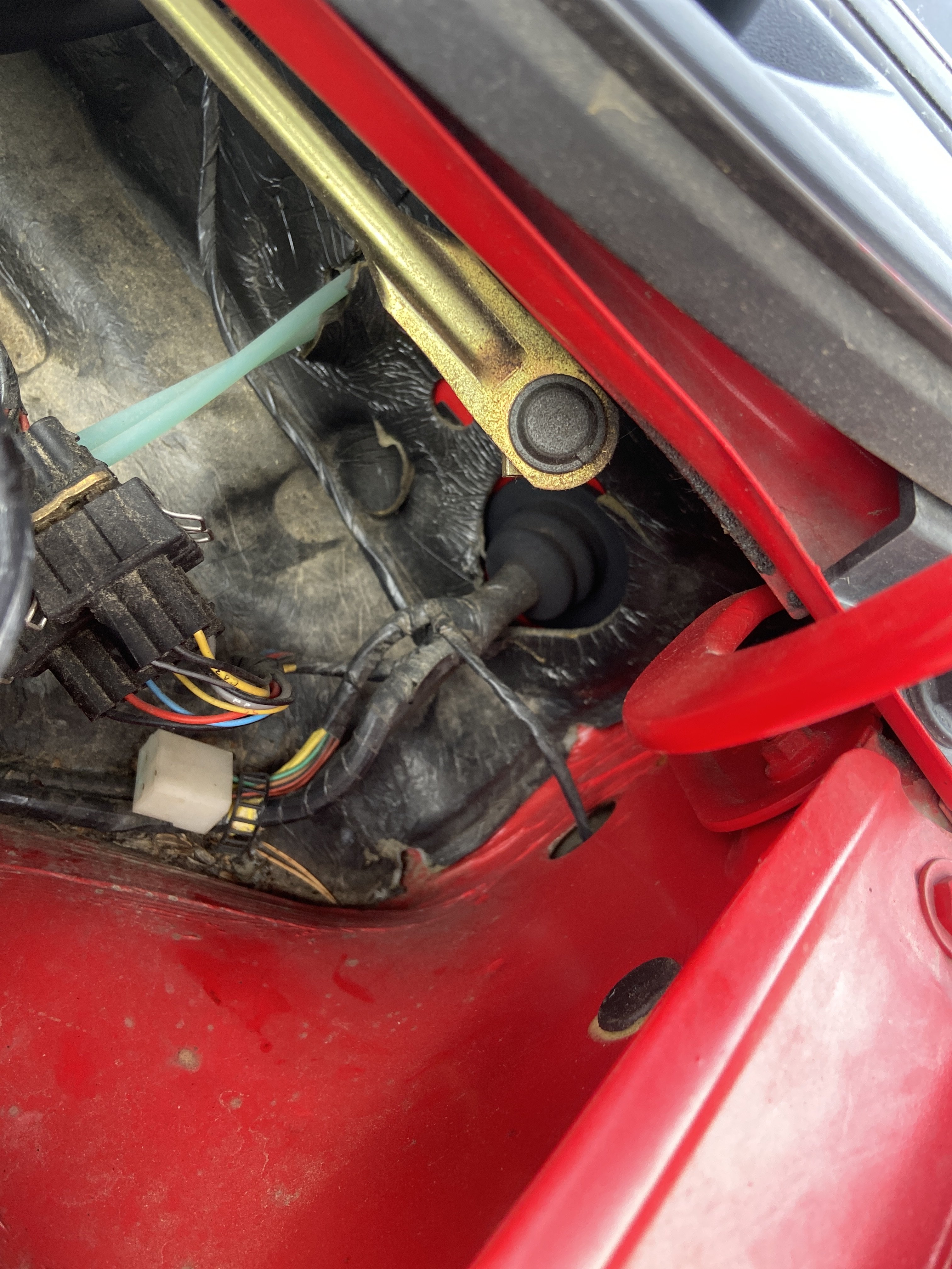

Any idea what that white plastic female wiring socket, in the engine bay near sub-loom, is for?

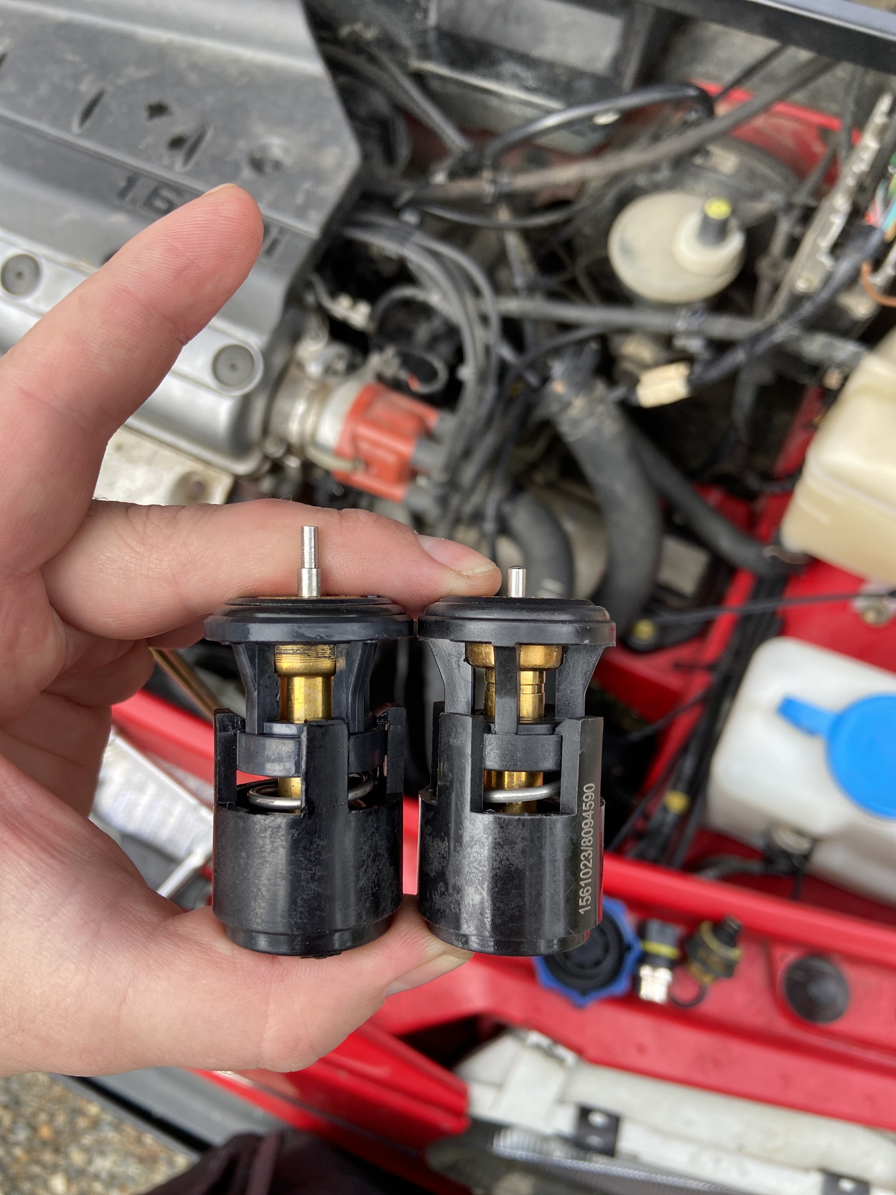

and bith of these are supposed to fit. But which one do i pick lol…
fixed it haha.. noo i dont know lol.
The cables in the ECU are exposed, no plug cap.
This means that dust, moisture, water etc are coming.
No worries i have the cap! Just took it off while thinking i have an AC 😂
That's just heating ant ventilation, AC has extra buttons for cooling and recirculation, like this
Or like this
That's for headlamp washers.

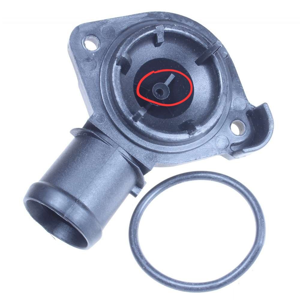

outting the themostat back in, is there anything i should think about?
Check this part in the thermostat housing
viko-skrine-termostatu-skoda-fabia-i-octavia-ii-1999-2013-neoriginal-032121121k.thumb.jpg.eb77418cbbabd0dfbda63c0b73ef8893.jpg
yea okey 😂
that part looked fine.

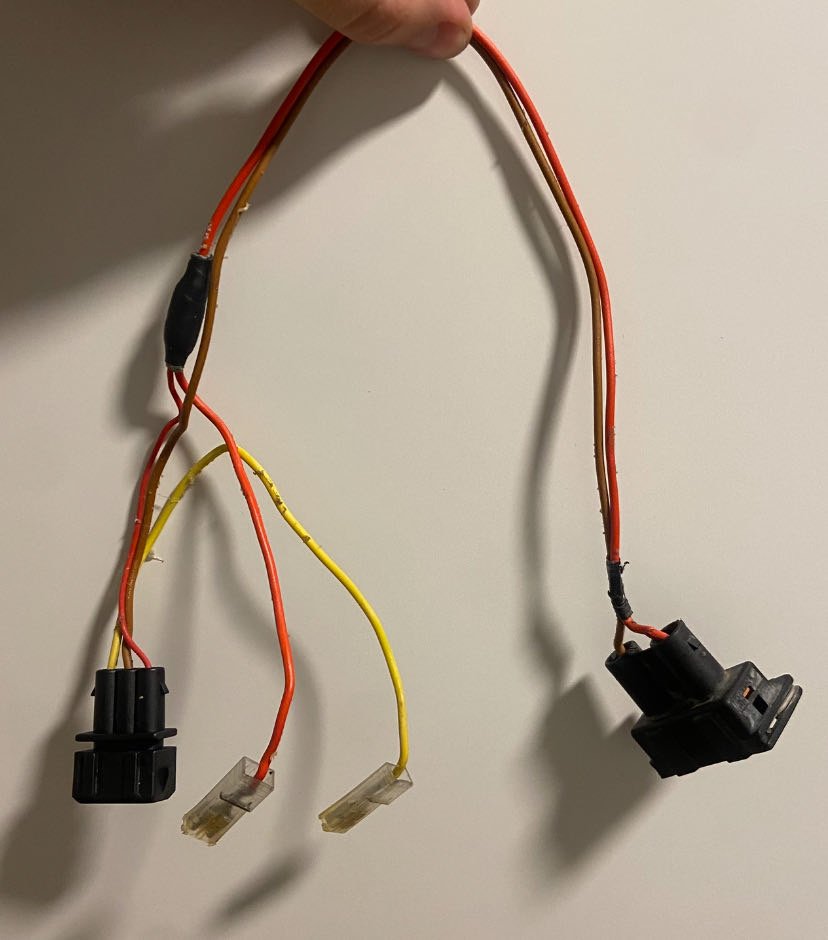

Hellooo again. SO the fan works it’s obvious to me know that they have done something here. The old thermostat is only two pins and its broken. I put it boiling water and it didnt connect. So i have a new one. It has 3 pins and now im confused. Please help 😂
it seems like they have done something, ALL the cables work, i have measured all of them. So.

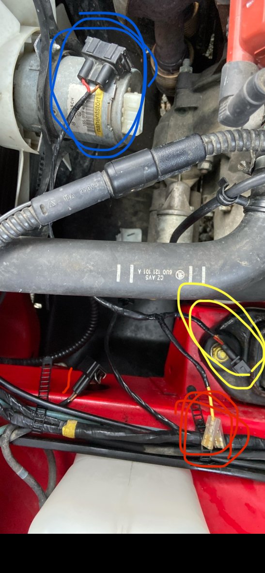

from the battery comes a yellow and brown (grounded) cable. The brown cable goes directly to the fan motor. The yellow goes to the thermostat and then the red goes from the thermostat to the motor fan.
what do i do
blue is to the fan
yellow circle is to the battery (the red one does not continue it just stops there)
Res circle goes to the thermostat
Edited by Felicia98noob
Thia is their cable management
two loose ones are the thermostat switch
the 3 pin next two them goes to the battery (the red one in this does not connect to a cable only yellow and brown)
and the brown red big one goes to the fan.
