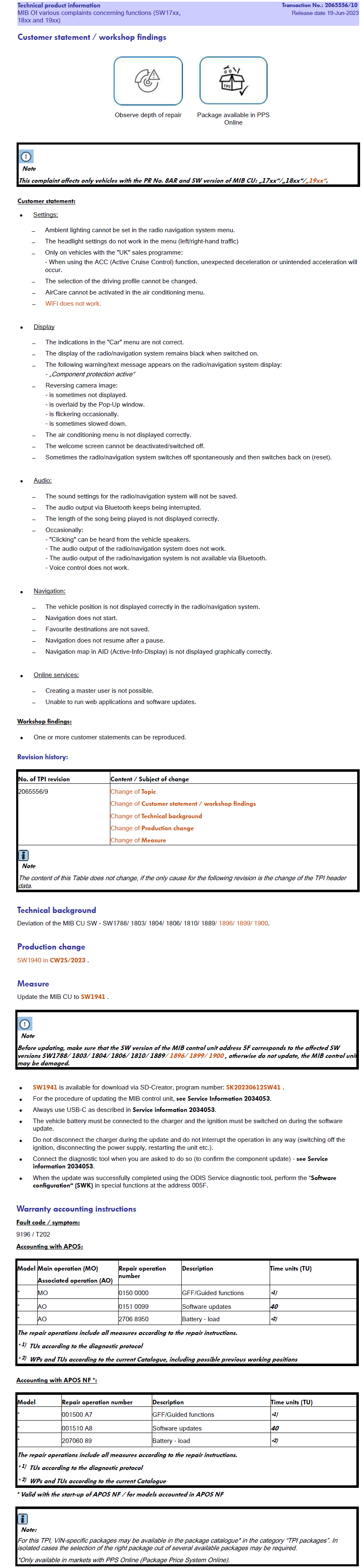

Also I have the TPI for firmware 1941 and it says that you can upgrade directly to 1941 so download 1941 update and than go to the latest 1985.
Here an image
TPI_2065556-10.png.5d4f06e59cfc0299d190c193b46a2866.png.f8f4ae08020ae2c4bc6498f2b13b1a6e.png
Well if that's the case then if you can find an image of 1941 and follow the guide that I did (pg 26?) and if you feel comfortable about doing it then fine.
Of course there's the caveat: "You do this entirely at your own risk, the board is NOT responsible for any damage that may be caused"
