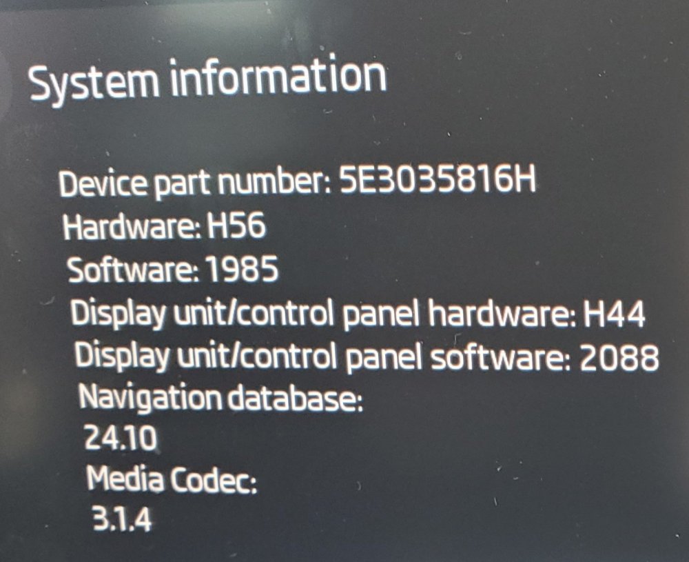

NEW: software 1985
And another successful installation. Tested OBDeleven gen 2 and working without issues.

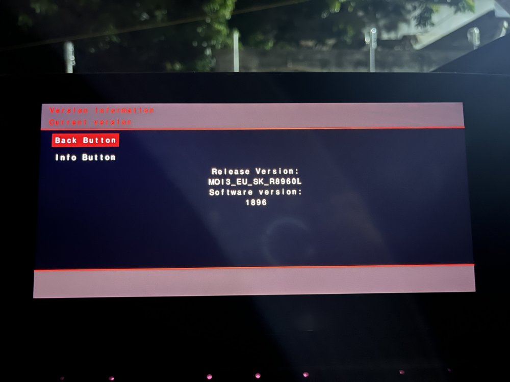

briskoda mo13_eu_sk_r8960l this one mate
Yes but go to System information and tell me what is written there so I can tell you if you can direct upgrade or not
this is what it shows
Also you can directly upgrade from 1941 this is confirmed, but when you have 1803 or 1806 it's better to go to 1941 firstly
Ok so install first 1941 than 1985

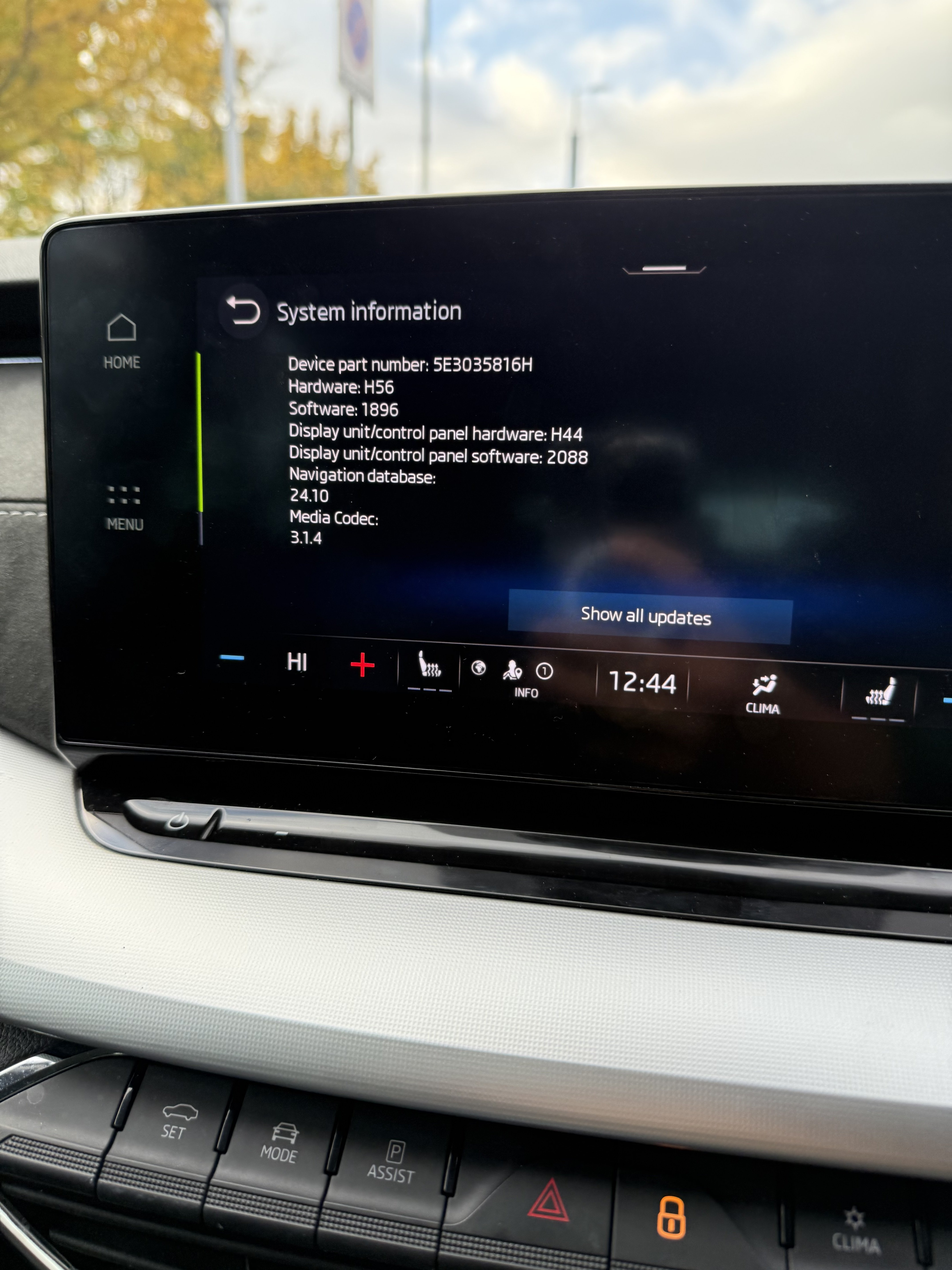

I ran the update today, straight from 1896 to 1985 after seeking advice from a VAG software specialist, and it went absolutely fine just as I was told it would.
That's mine done.

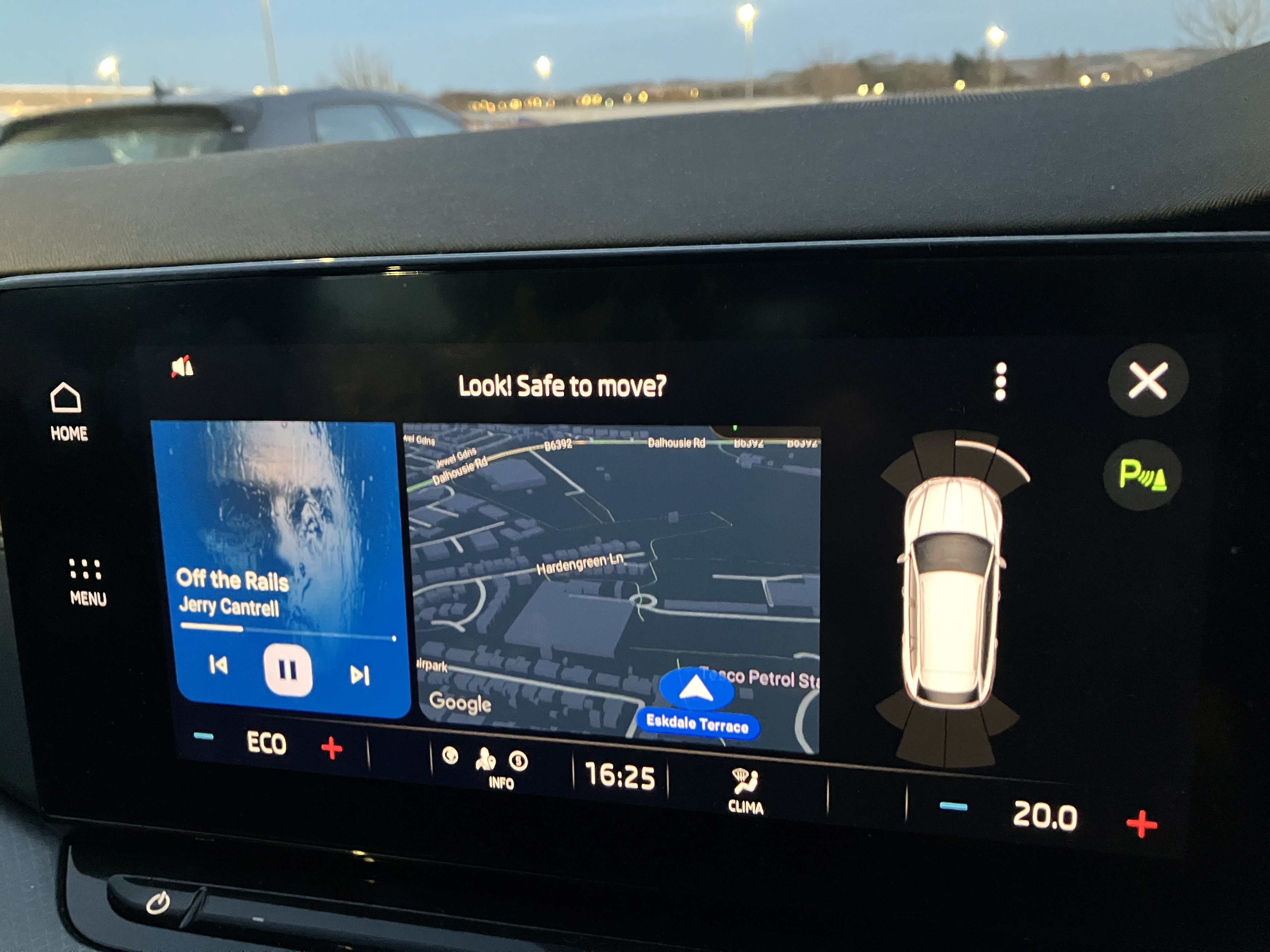

First improvement I’ve noticed:
...and that is? 😉

The proximity sensor no longer blocks out the entire display, That is with Android Auto.

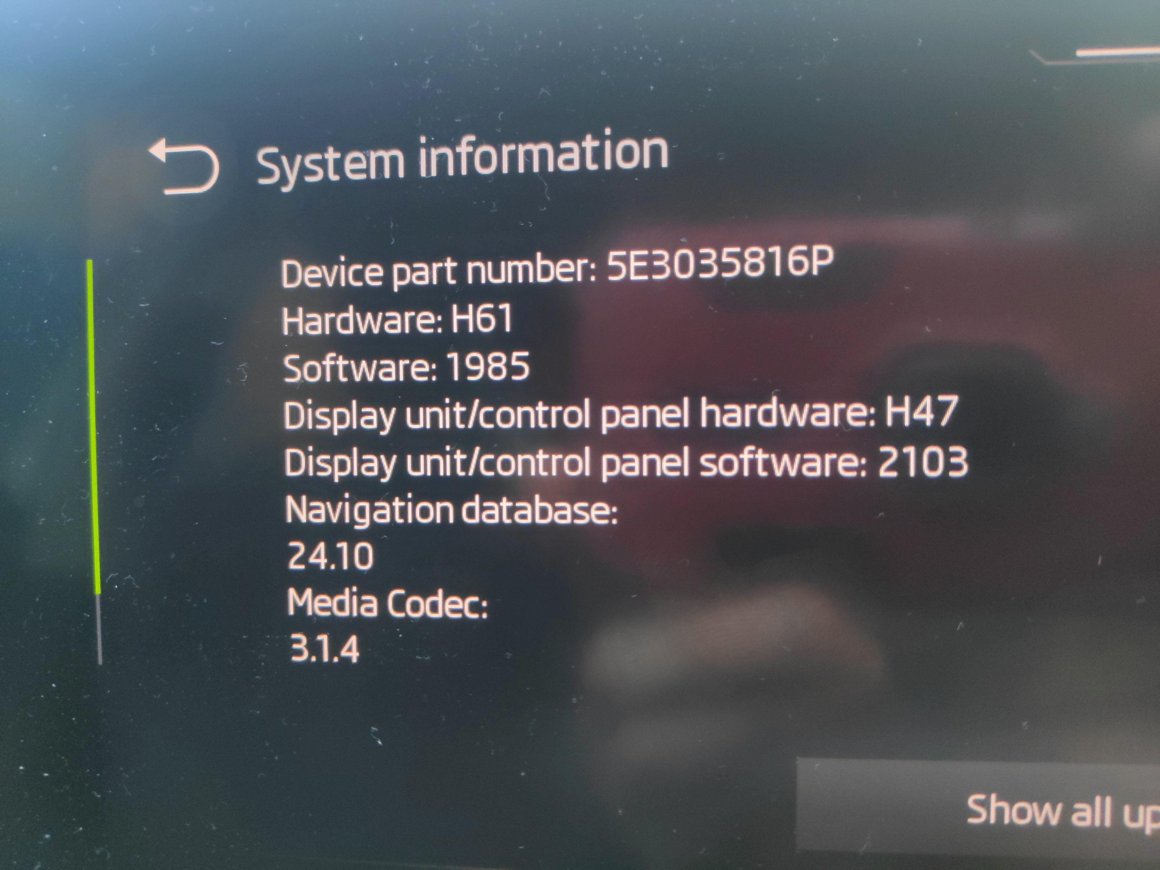

Finally took the decision to update my software from 1941 to 1985.
Wasn't sure if my existing hardware would allow it, but it all went OK. Apart from a squeaky bum time as it took an age (5-6min) to finally update the CPU.
I had the ignition on but engine off and also had the bonnet up. So an excuse to top up the Windscreen washer bottle.
Despite it being a simple process, thanks to all for giving me the confidence to take this on and the steps required.
