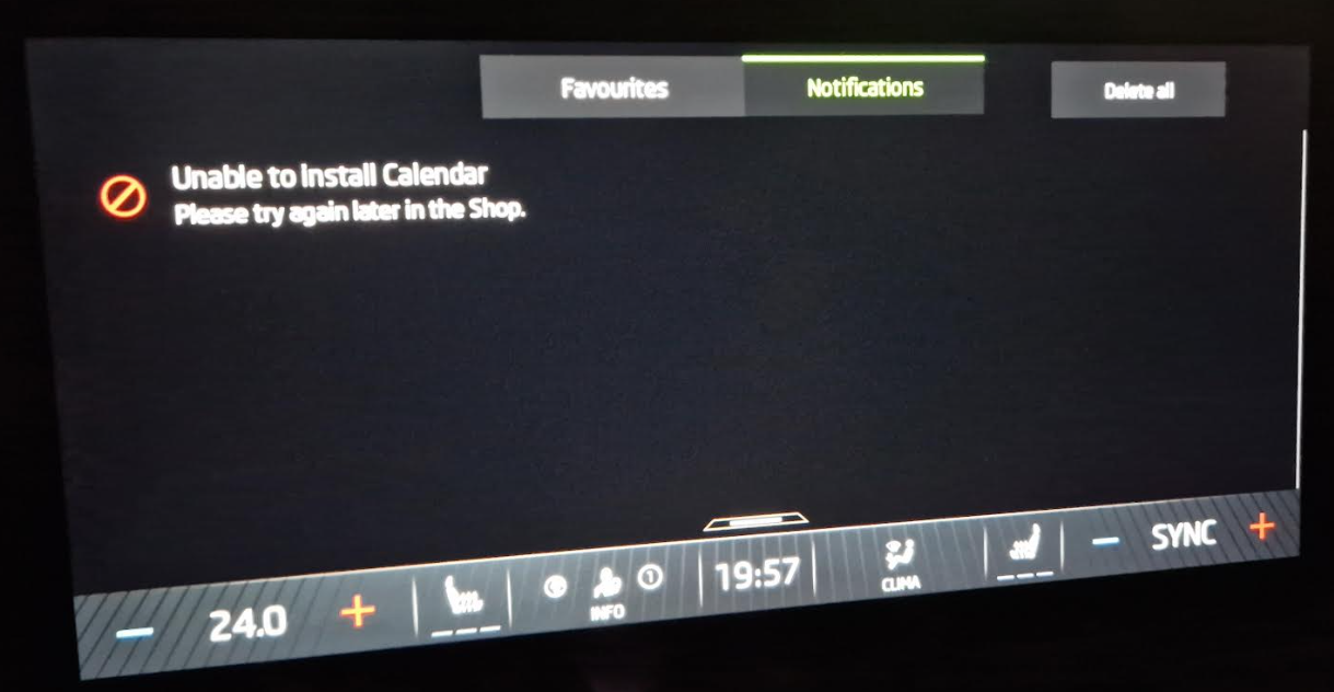

After update to 1985, persist this notification
Try, go to the shop, and uninstall.
"Calendar" no longer appears in the Shop
let's wait for the experts... but I think you need to restore the initial settings...
I will try to make a restore to the initial settings...
Thx!
