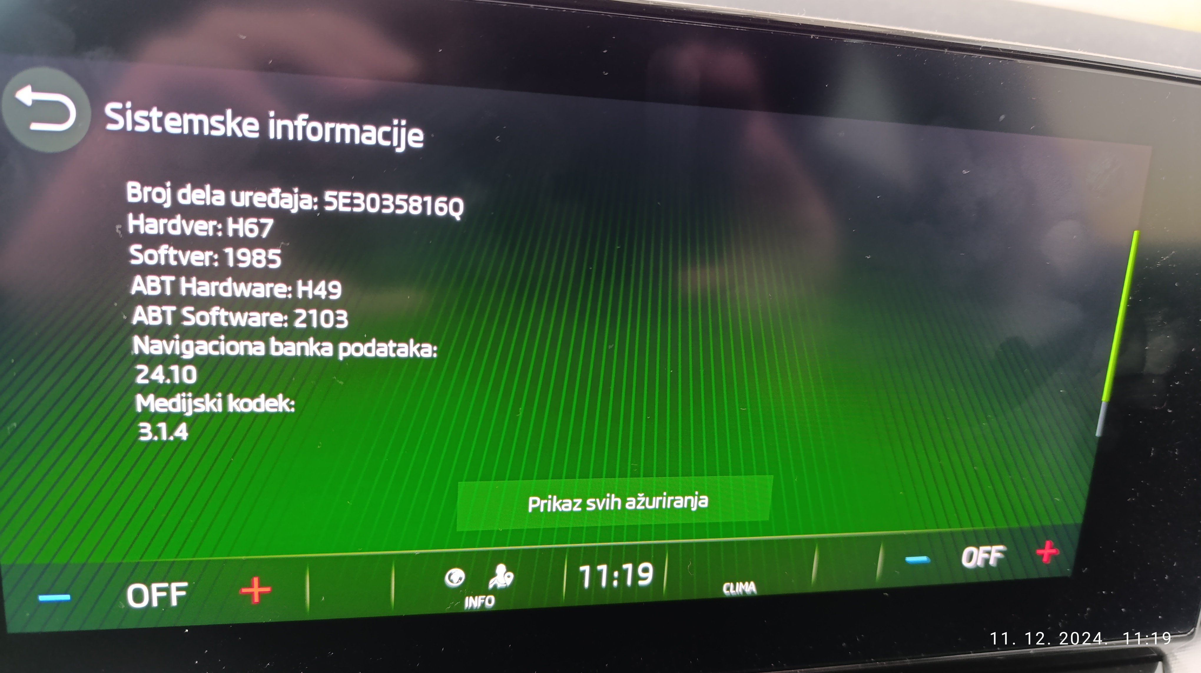

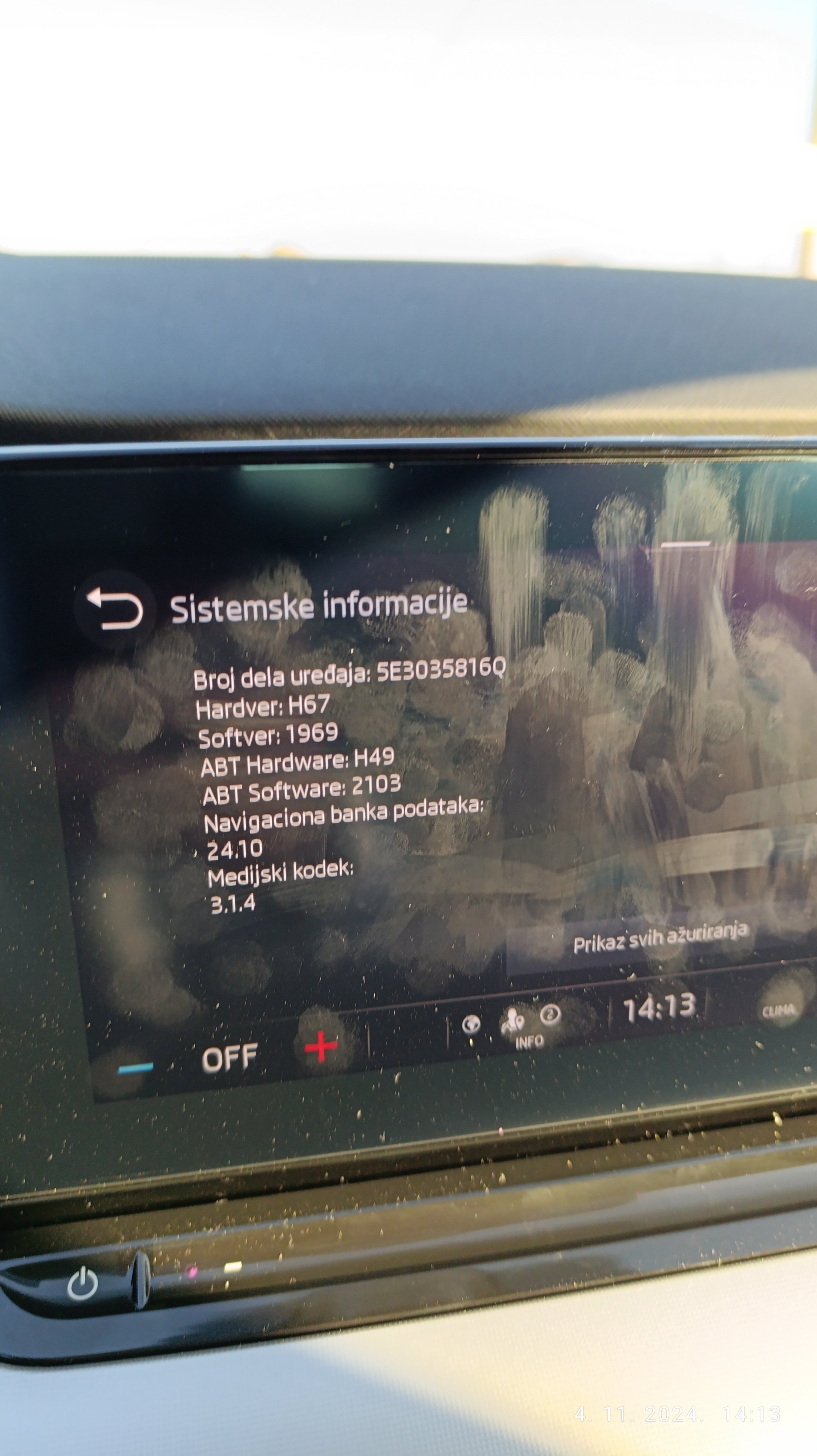

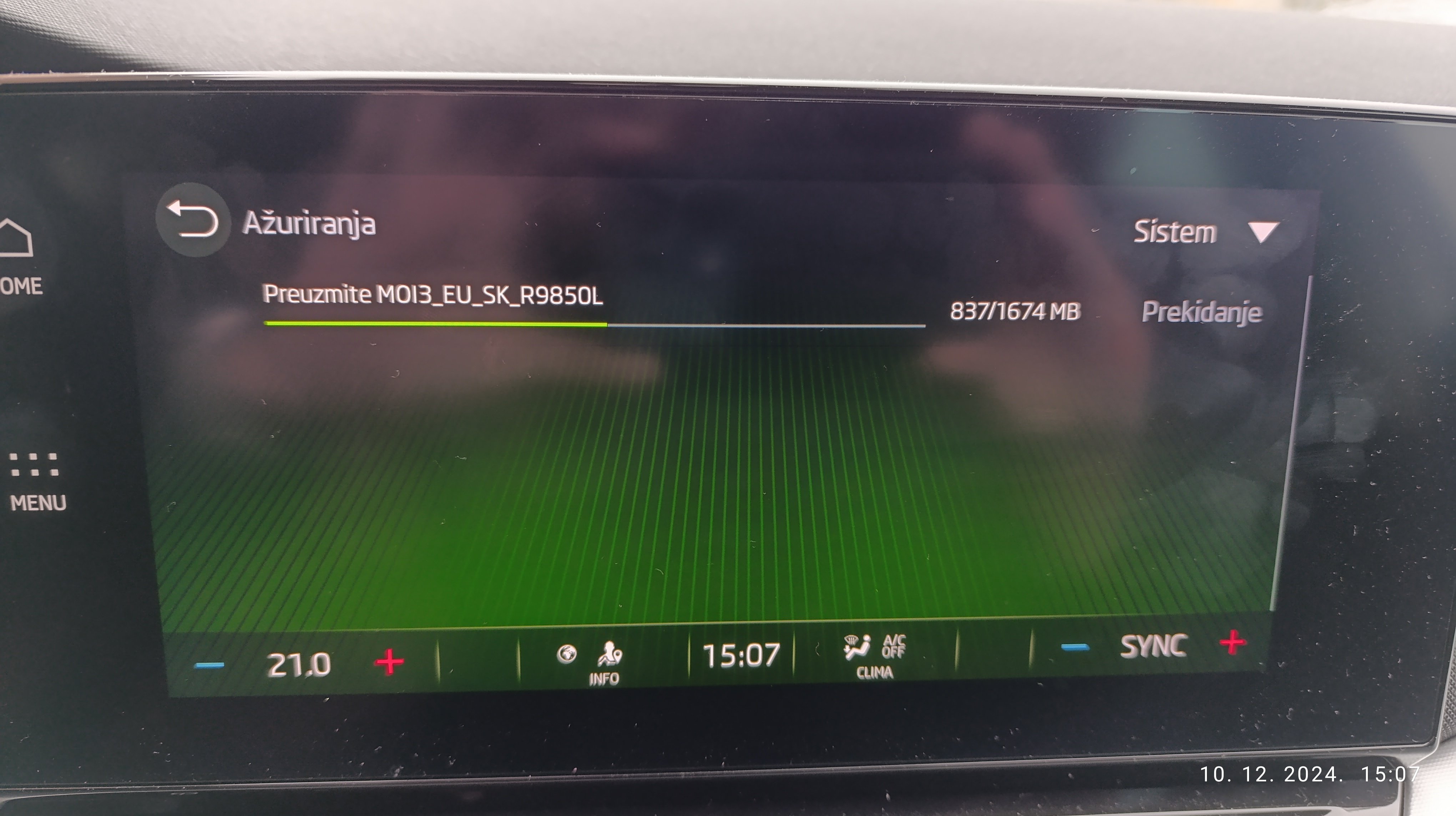

I have received OTA update today also. Car is made in 2024, but it is not FL. So it is brand new. I am in Bosnia if that makes any difference. Also Skoda connect is still active.
Current software version is 1969.
Update is still downloading and it is 1674 MB in size. We will see.
Edited by djukak

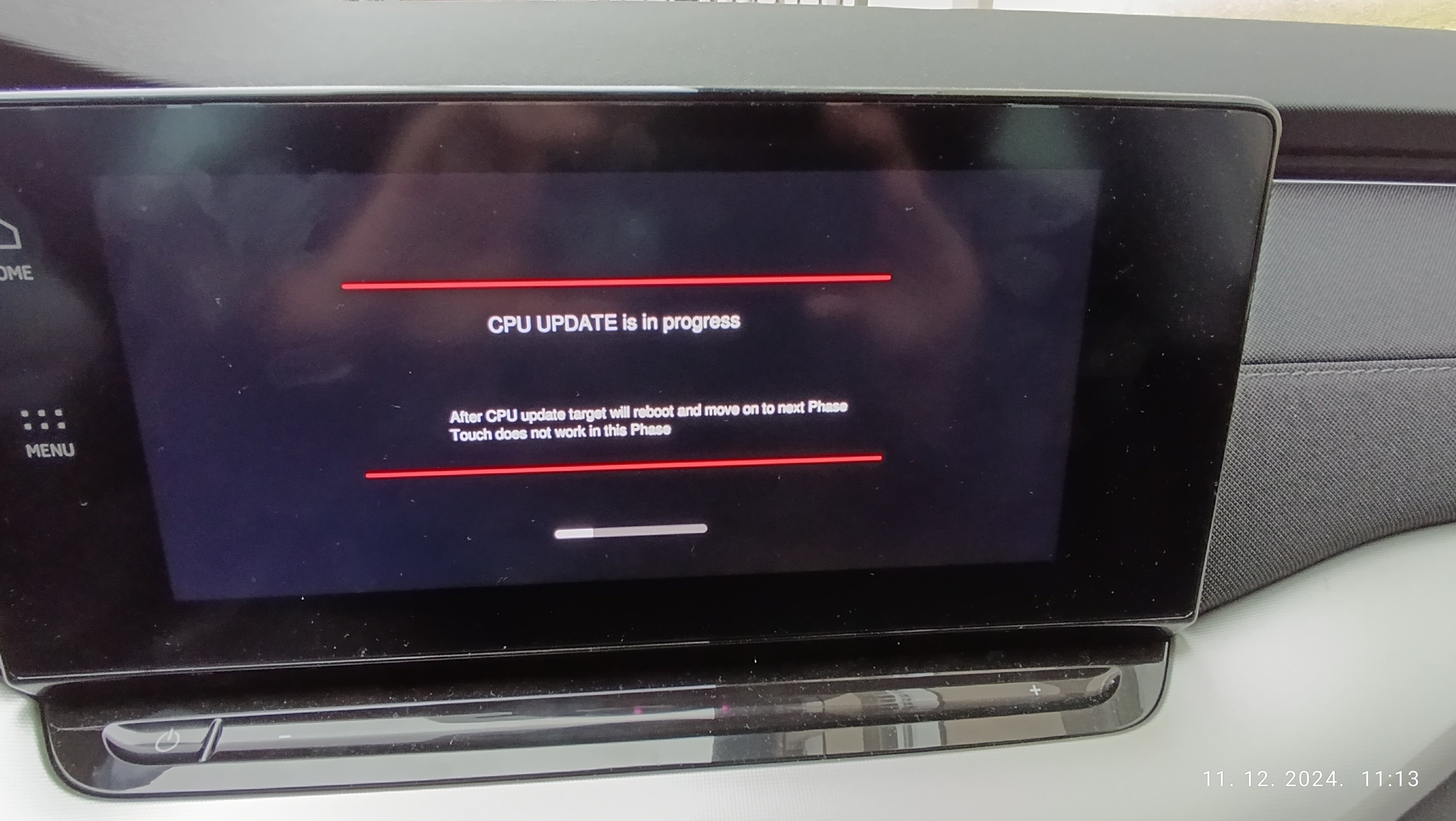

Update went smooth, it was around 20 mins or so. Ignition was on, but motor was not running. Will test it later to see if everything is fine.

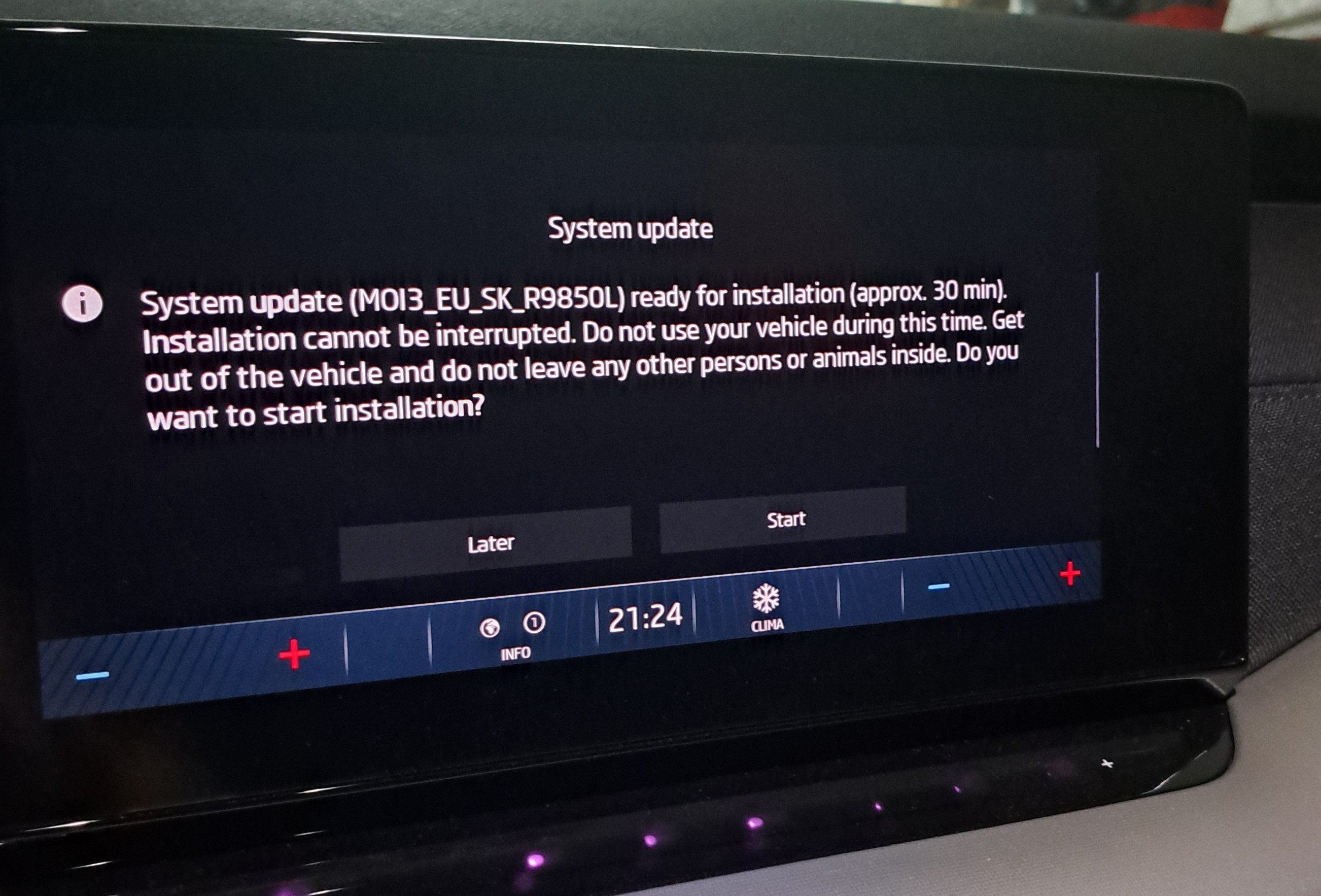

After the proccess started and the HU went blank screen I got out of the car and locked it like normal. Maybe 5-10 seconds later the HU woke up and started updating.
So it worked with ignition off.
Edited by aki78
That was lucky. You should allow the process to complete before keying out or turning the ignition off, if it had failed you could have ended up with a dud system.
I did the update as well. The directions were not to use the vehicle and exit the vehicle. Also, the installation prompt comes up after turning off the ignition.
I left and locked the car. The next morning I was greeted with a message that the update was installed.
I don't see any noticeable differences - except that it maybe boots up faster. But it was fine before as well.
Hardware version H61.
Has the instruction to "get out of the vehicle" been there for previous generations of updates, or is this new to 1985?
I was the same ,I switched off the ignition ,went back half hour later it was done with no problems.
I've never seen it before so it must be a new instruction. I've done updates twice now and never seen it.

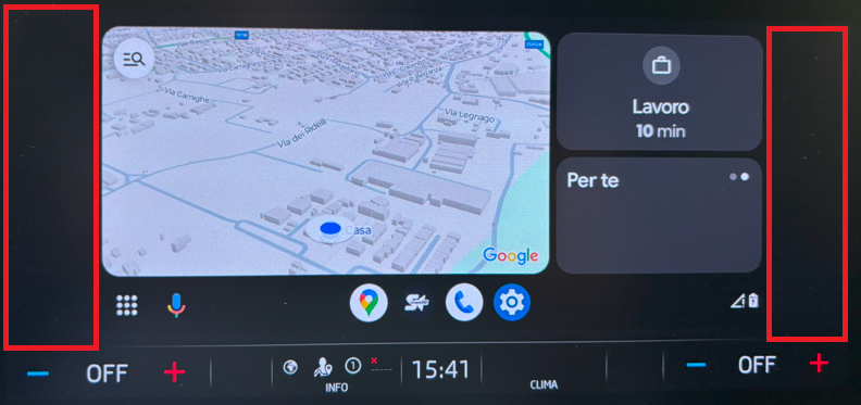

hi guys, after the update android auto and carplay no longer go full screen, any ideas?
Yes, there is a menu option within Android Auto settings to enable disable application shortcuts, this removes the ones from the bottom of the screen and reinstates the ones down the side.
I apologise, I did not explain myself well... they are no longer as wide as the screen... they now have two vertical black bands on the sides.
Ah, mine looked like the images in the first post. Not sure how to fix your one though.
I wonder if it depends on the source of the update.  If it is OTA then the update is stored in the head unit (presumably) and the head unit would be able to switch on and update.  If the update is on a USB stick the car may require power to run the USB sub system and access the update.

For Android Auto to work normally, it must be removed from the home screens and opened through the icon.
