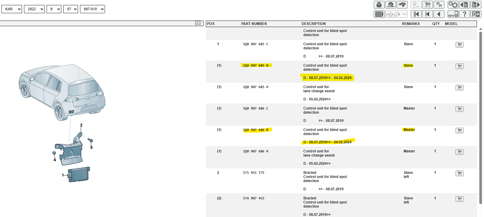

Normaly Index B
For which car?

  • I  am almost done with the materials.  Here the most important.      Left radar 2Q0907685H  Right radar 2Q0907686H (master) Bracket on the left 5E6907456A

So which I need?
2 hours ago, Benja77 said:
So which I need?
Same like me version B
I tried B (taken off from a Kamiq with AliExpress harness) but mechanic wasn’t able to configure them! Now i asked him to fit a set of brand new H and once the job will see if they work or not! Otherwise I’ll put back the B

Units are 2Q0907686/5 both H

20 hours ago, Benja77 said:
Is it H good for my 2022 FL Karoq?
No, fit B

It will not work, you're wasting your time. Install B, parameterise and code to suit your vehicle. We can do this remotely if needed
Is it easy to upload new dataset into version B for Skoda Kamiq ? Because the module I found doesn't come from a Skoda
You need Tool for Flash Dataset. Easy Job, 5min
