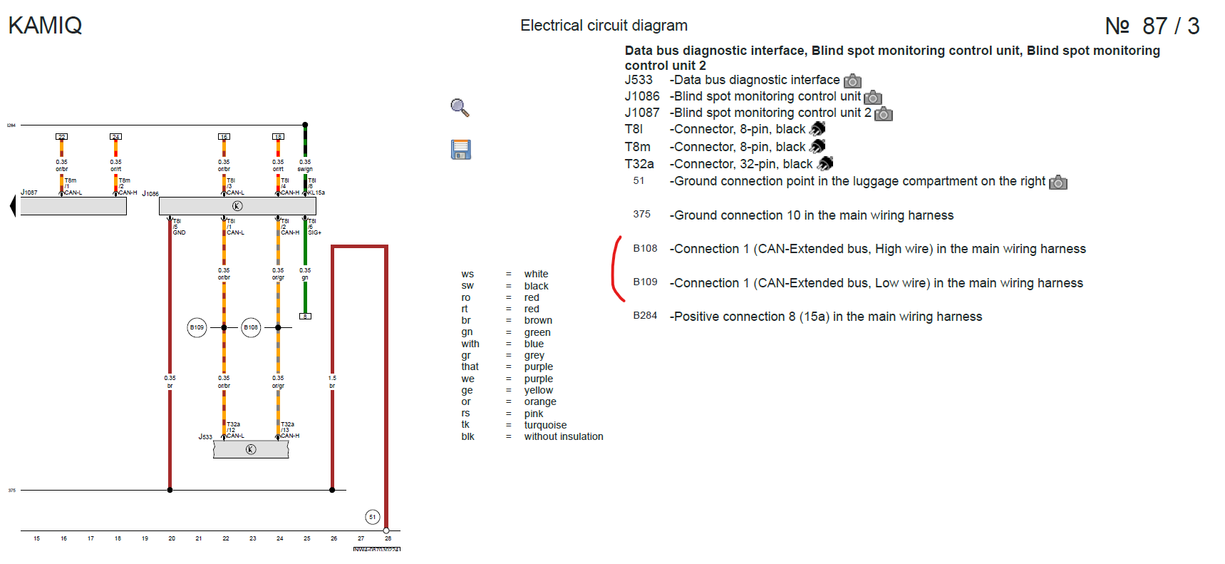

The strange thing it's the CAN Extended isn't recognize into the module 3C. In VCTool, others ECU show me the way to communicate with them (Powertrain bus, Infotaintment, etc) but the 3C is Unknow. Maybe due to SFD2 you'll say to me ? 😁

unece also Index H is no longer in the extended can
Then where?
I'm not agree, according to wiring for Kamiq after 2024 (using H versions) connected to Extended Can
But architecture of Kamiq is very special...
Lane Change Assist after 2024.pdf
Edited by Vincent_83
Sorry, i Looks bei unece Cars, where Index H is used, MQB EVO
Edited by Cairus
