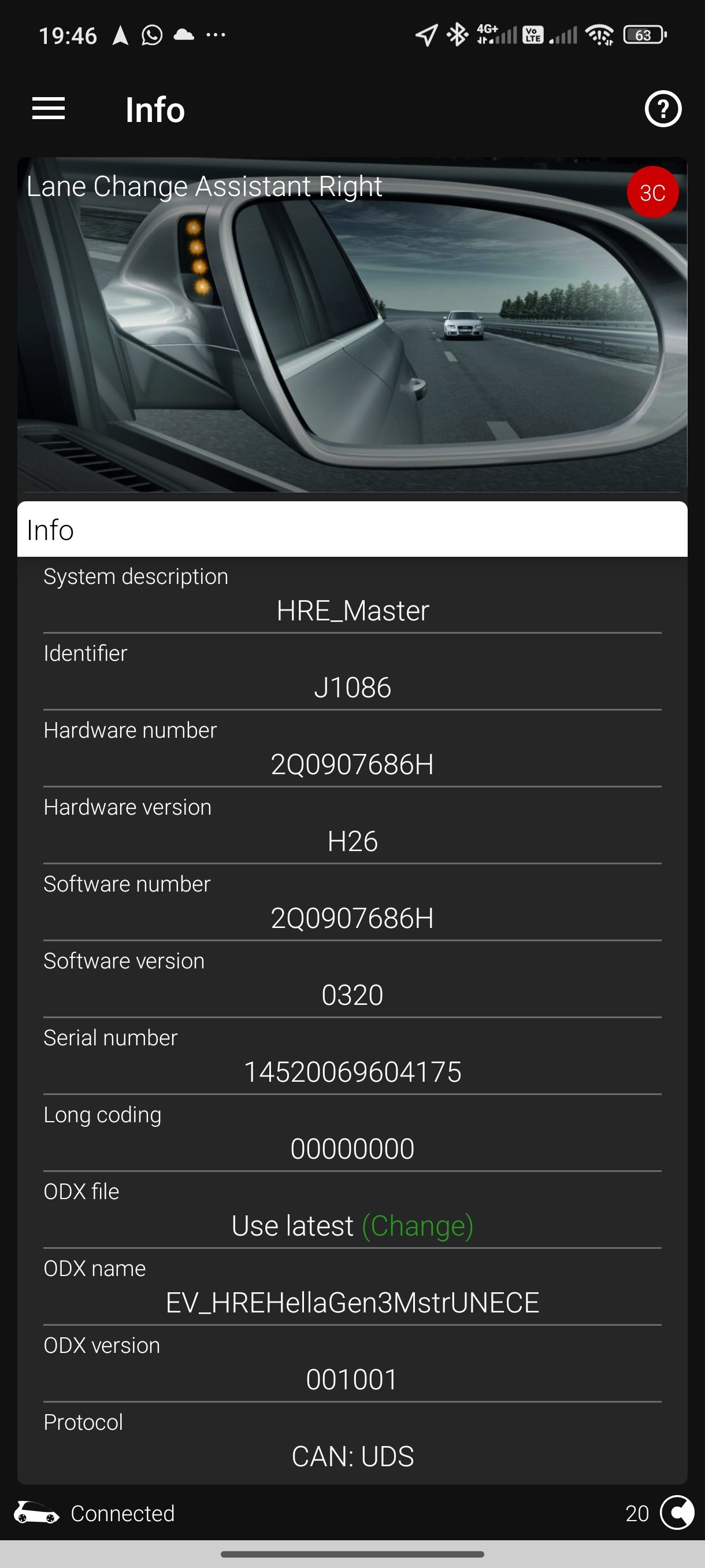

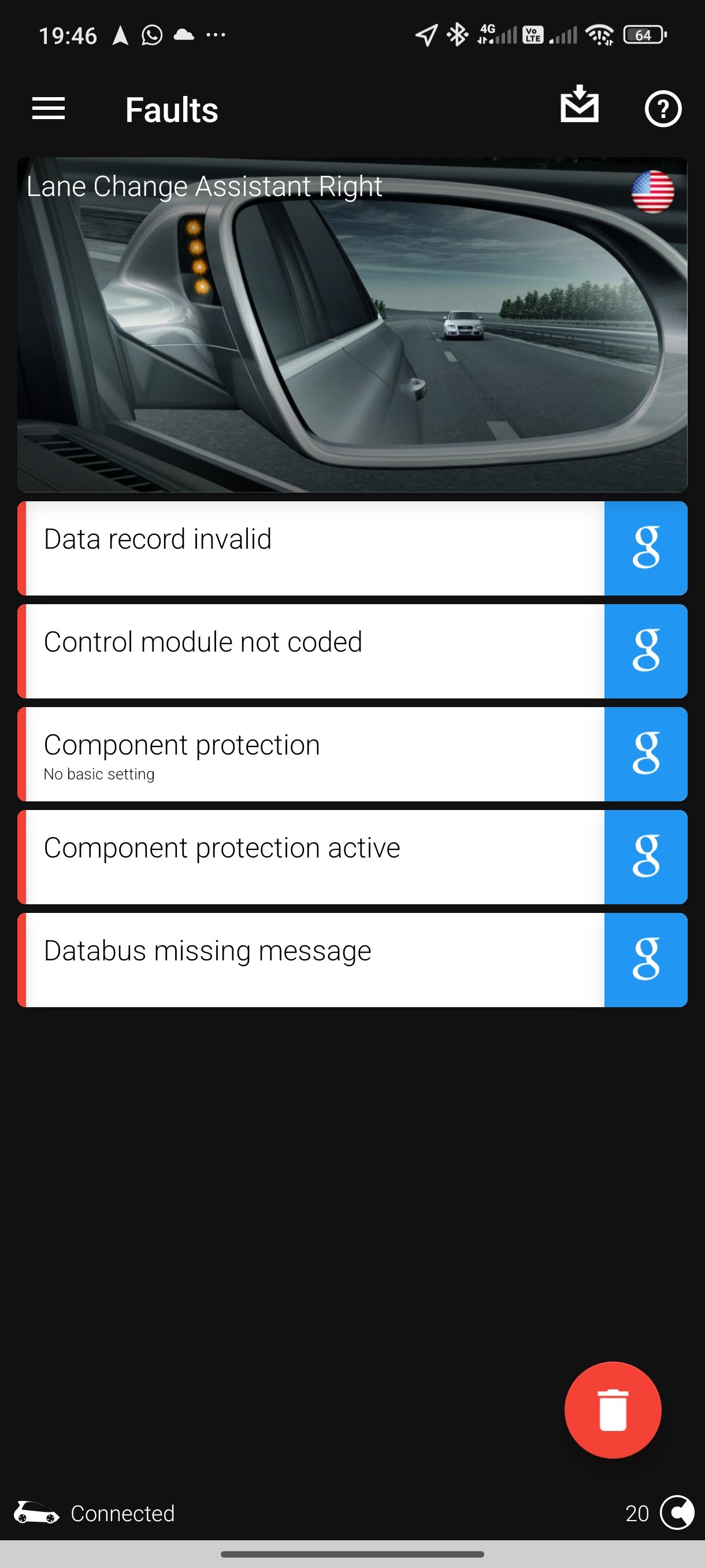

Hi everyone, I have retrofited my Skoda Kamiq to install the BSM. I have installed the same radar ( 2Q0 907 686 H / 685 H ) and impossible to remove component protection with Odis online.
I see on another forum the H versions are very difficult to install by retrofit due to SFD2
Anyone have a ideas ?

Which Error Code have Odis ?
Edited by Cairus
I don't take screenshots from ODIS but on OBD11: Screenshot_2025-09-20-19-46-04-881_com.voltasit.obdeleven.jpg
When we try with my colleague on Odis, the option to remove component protection doesn't appear
Wrong radar... H is for UNECE vehicles
Fit B instead

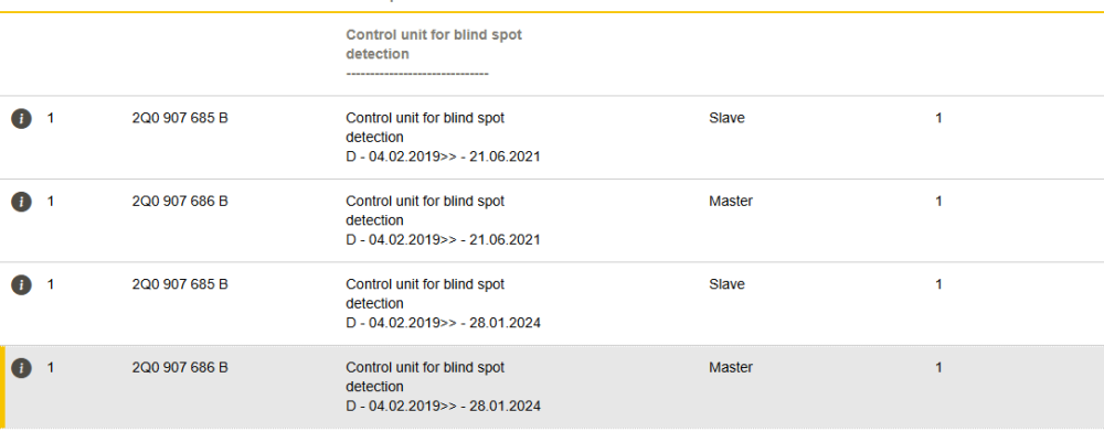

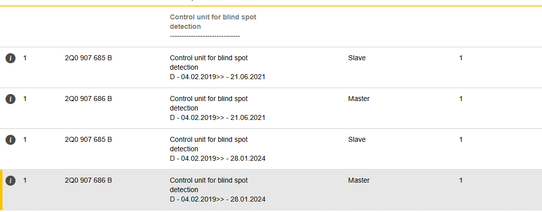

For Index B I have the note until production date 21.06.2021. If it is Index E in my opinion
  • Sponsor
Installation periods for the Kamiq
A B are for MQBx
D E G H K are for MQBevo & MEB
A & B do not have component protection
Edited by East_Yorkshire_Retrofits
Until Index B, the Power ist KL15
I have the same information, B is for Kamiq mk1 and HJ for Kamiq mk2.
Not others.
For the power, since 2019, these modules are powered by KL15a and not by KL30 (as recent car for Exit warning into the door IThink).

I just found on Ovoko 2 radars version B compatible with my Kamiq.
Maybe just the correct Dataset to be installed for Kamiq and I think it will be ok.
