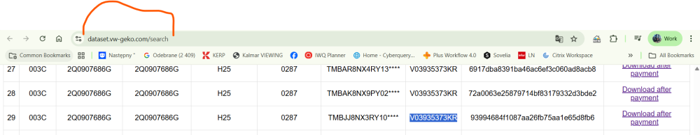

I have estate after retrofit with exactly the same module - I have dataset V03935373KR. After retrofit working perfectly You can download from side (30 eur/file) unfortunately ☹️or search in VCtool (for somone who have subscription it is better price )
I navigate to URL but I don't know find software number. How I found? I have no problem paying as long as it works. If you can help me found an buy this file? Thanks
