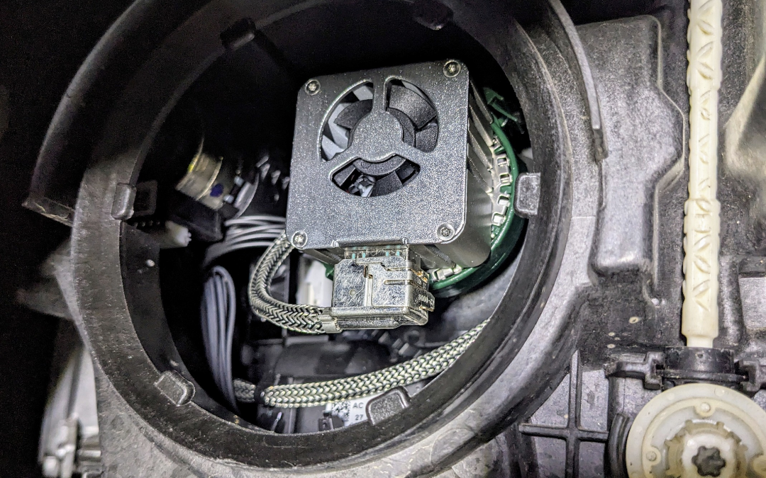

I recently switched from xenon D3S bulbs to LED D3S bulbs (JW Speakers brand).
A big improvement, plug & play. No errors or issues.
Do you need to remove the bumper to change the headlight bulbs to get access to the headlights or do you need to go through by moving the wheel arch to get to the back of the headlights?
No need to remove bumper.
Removing the wheel arch liners gives U plenty of access behind the headlights.
