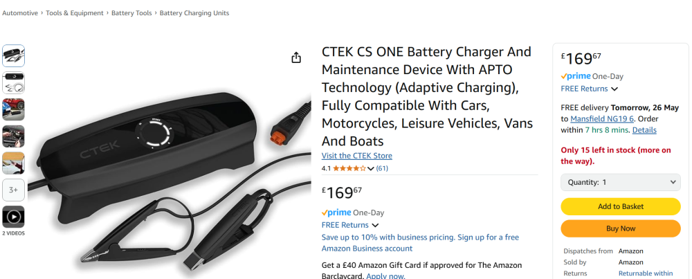

  • If the battery is fairly well charged at the start, then something like this should help to keep it happy. Assuming that the weather plays nicely, and your car isn't parked under cover: https://www.ha
  • Varta 700A 70Ah EFB+ Yep the CS One is around £170 still. I did use it on my previous Karoq. I also used MSX 5 on the Karoq.
