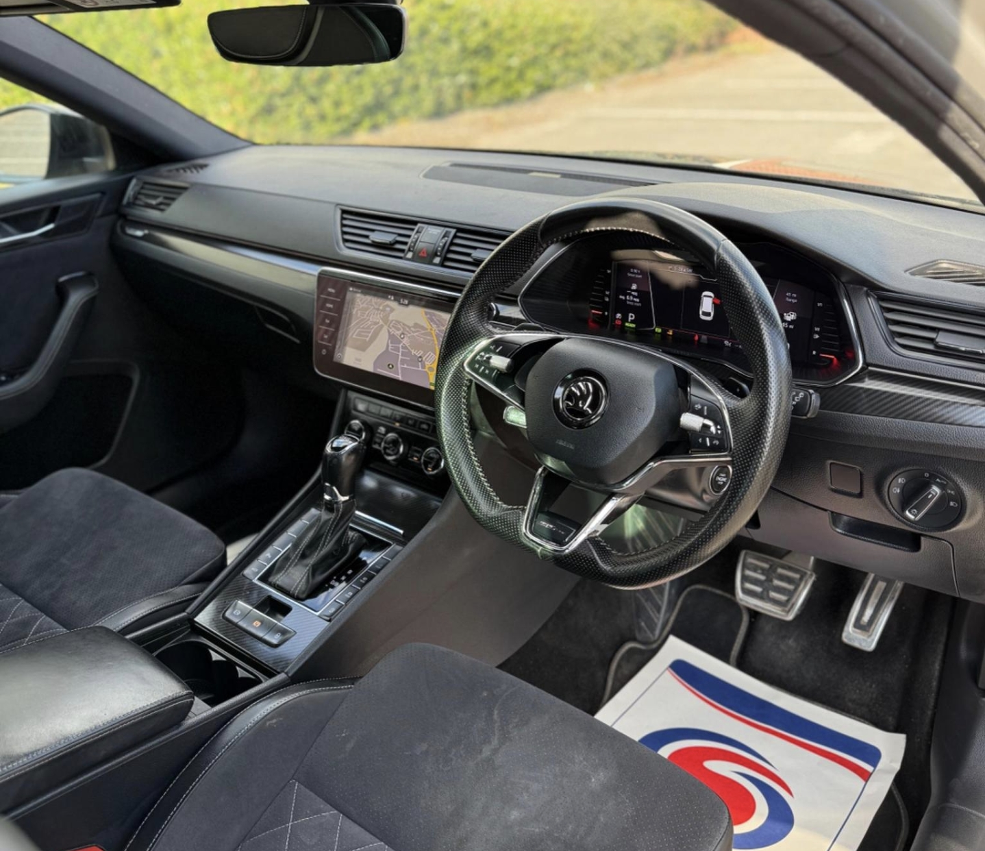

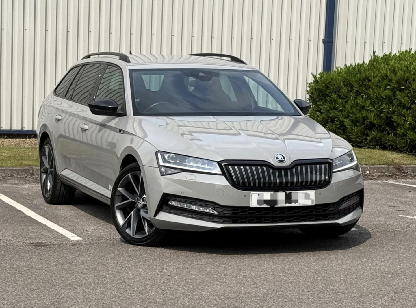

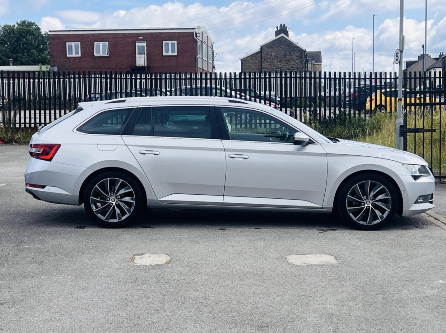

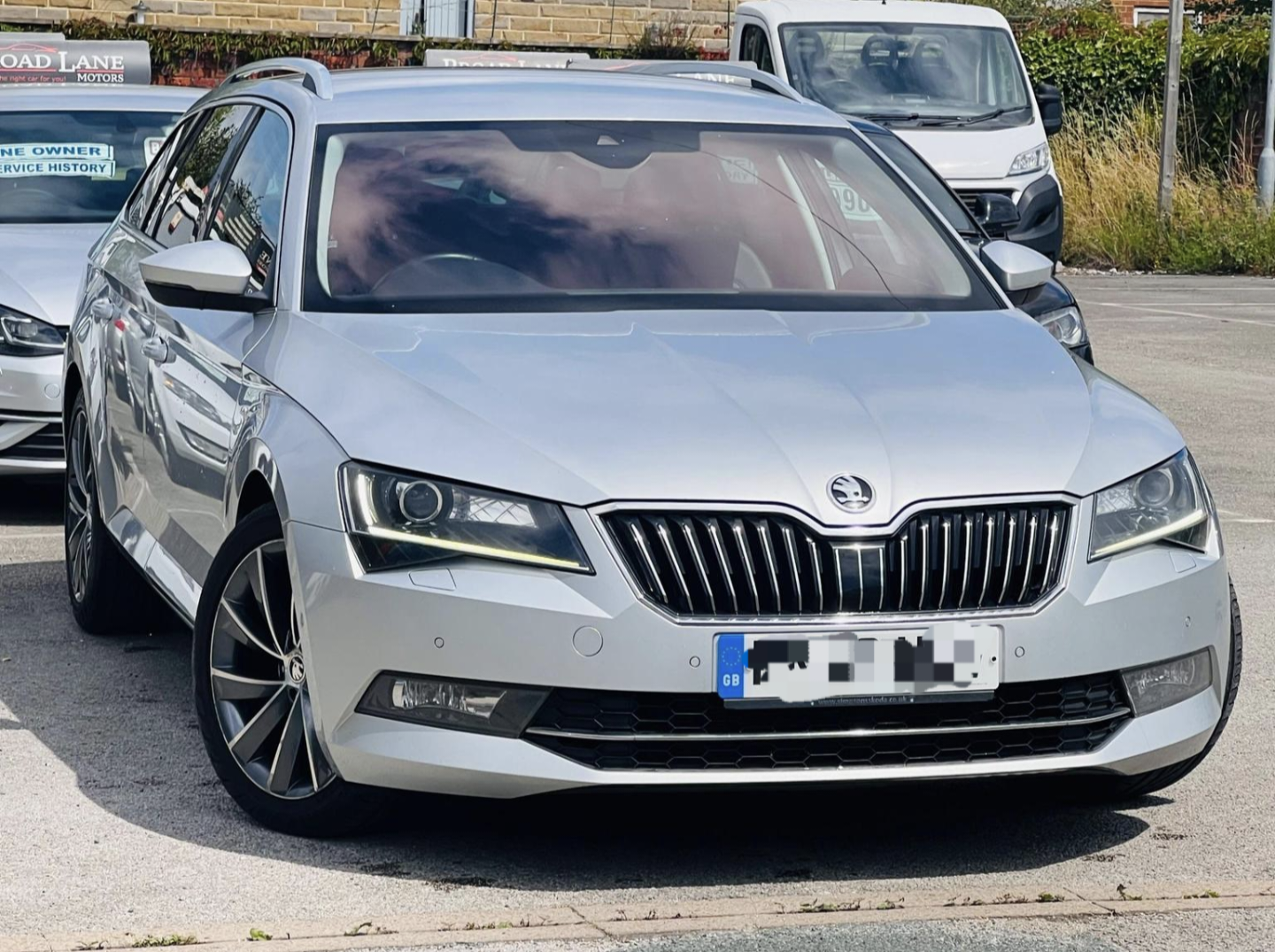

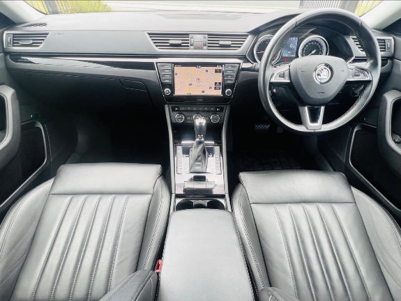

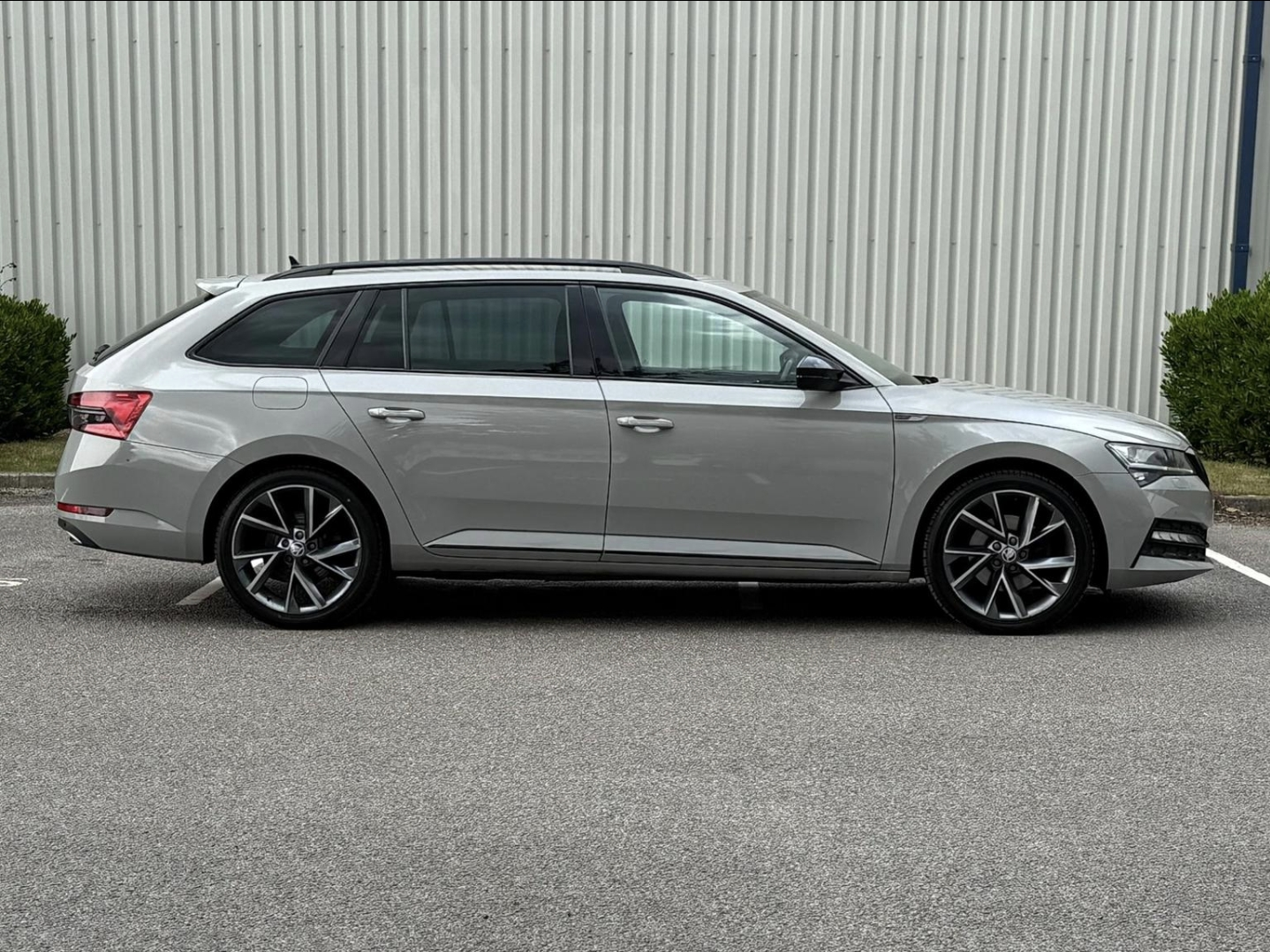

I drive an octavia and thinking of upgrading to a superb. I'm caught between two on auto trader, one is a fully spec'd sportline plus 1.4l hybrid from 2021 with 163k miles on it but full service history and gearbox services from skoda priced £10,500. The other is a fully spec'd Laurin and Klement superb 2.0 tdi from 2016 with 124k miles and almost full service history priced £9,500. Interior is a bit more dated as its an older car but the car looks well maintained and has just £35 annual road tax vs £195 on the 2021 car. Any idea which I should go for? I'd want to own my next car for at least 6 years...
I do about 400 miles a week with 250 miles on motorway and another 150 miles in the city and while diesel is better for the longer journeys I'm thinking hybrid might be a better option since I also drive alot of 3 - 5 miles journeys.

I would want a Battery Condition certificate for the PHEV.
I would want a 50 miles minimum test drive starting off with a full battery and run on Electric only to see how it is.
As well as the Fixed Regime 9,400 mile oil & filter changes with the 1.4 TSI were the spark plugs changed each 40,000 miles when the DQ400-e DSG was being serviced?
So 4 times now.

Thanks, it has had 8 service stamps since 2021 so I figure it got services about twice a year, that's an average of every 20k miles. It's also had 2 DSG services and the last one was around 110k miles so about 50k miles ago.

To be fair the older diesel seems like a more sensible and cost effective choice but the modern features of the 2021 are indeed quite tempting especially the virtual cockpit and matrix led headlamps. My only actual gripe with the 2016 is it doesn't have any record of any DSG service although it's had 9 service stamps at skoda and cambelt changed at skoda around 100k miles. Happy to carry out the DSG service after purchase but wouldn't want to bother if the damage has already been done to the gearbox.

The DPF on the diesel could be nearing the end of its life.
Frequent posts here for high mileage diesels with poor running and high consumption issues when this happens.
It is possible to get a report on the ash content in a DPF.

A Phev with that mileage is one battery/gearbox issue away from being scrap.
The DQ400e is extremely complex and expensive.

If my heart was set on one of the cars, I'd go for the TDI and expect to have to put some money into the DPF, EGR and probably the adjustable dampers on the L&K before too long.
