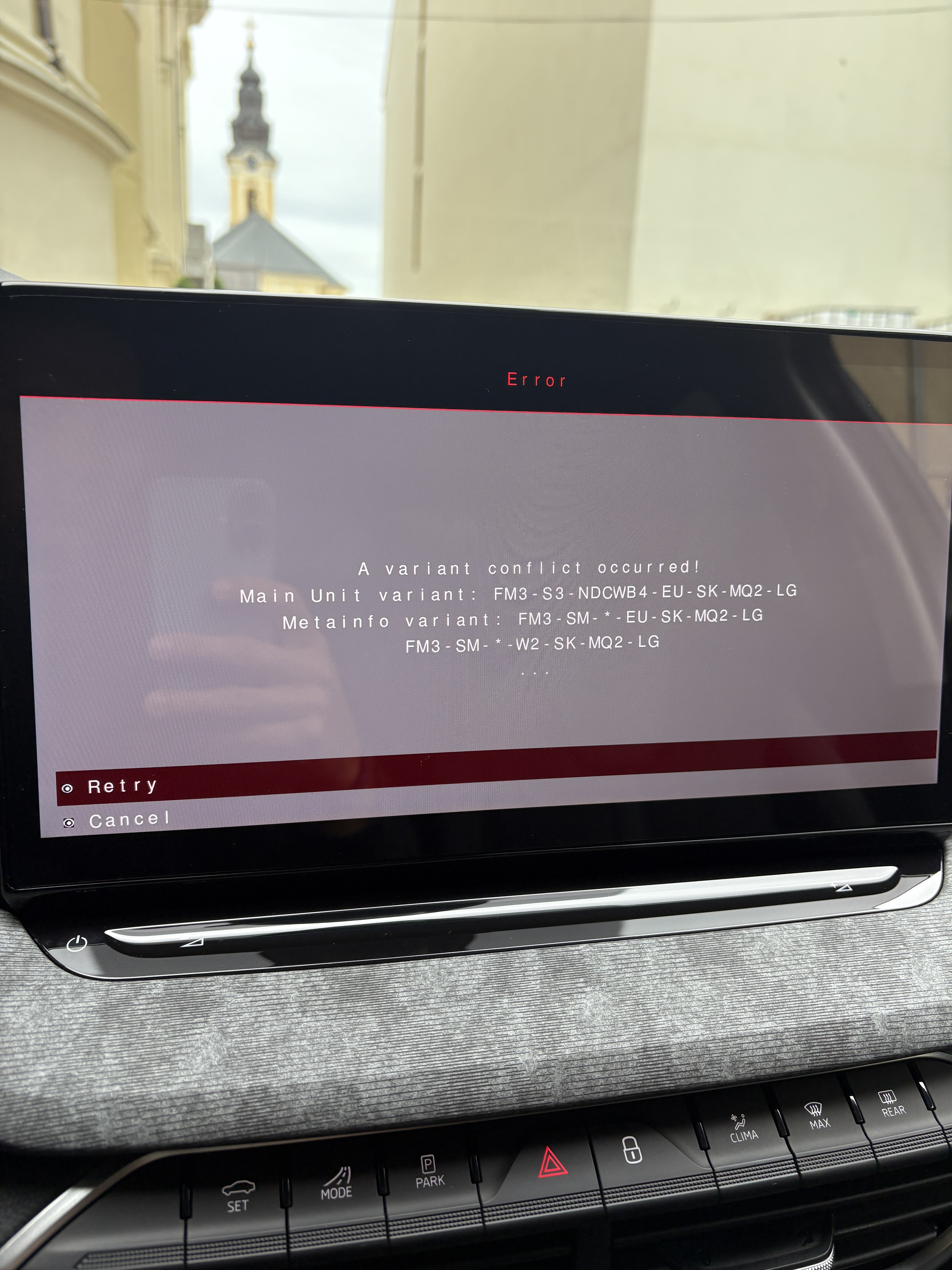

hello, I have a Skoda Octavia 4 fl with 13' navigation, I tried to update as it says here, but this message appearsIMG_3998.jpeg
You have MIB4 in the Facelift
You should be thankful that it threw out an Error, and you didn't brick your system.
The software on the facelift models (Octavia, Golf, Leon/Formentor) has nothing to do with the pre-facelift, since the hardware is different. Check you software information - you should have a version close to 2650. Do NOT try to install an inferior number version!
If you have annoying bugs on your system, try to discuss with the dealership. I've heard rumors about a major update for MiB4, but it's not yet released OTA.

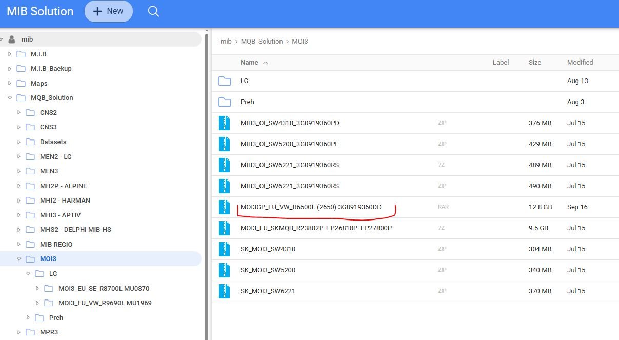

I don't know if I'm wrong, but this is probably the version for you?

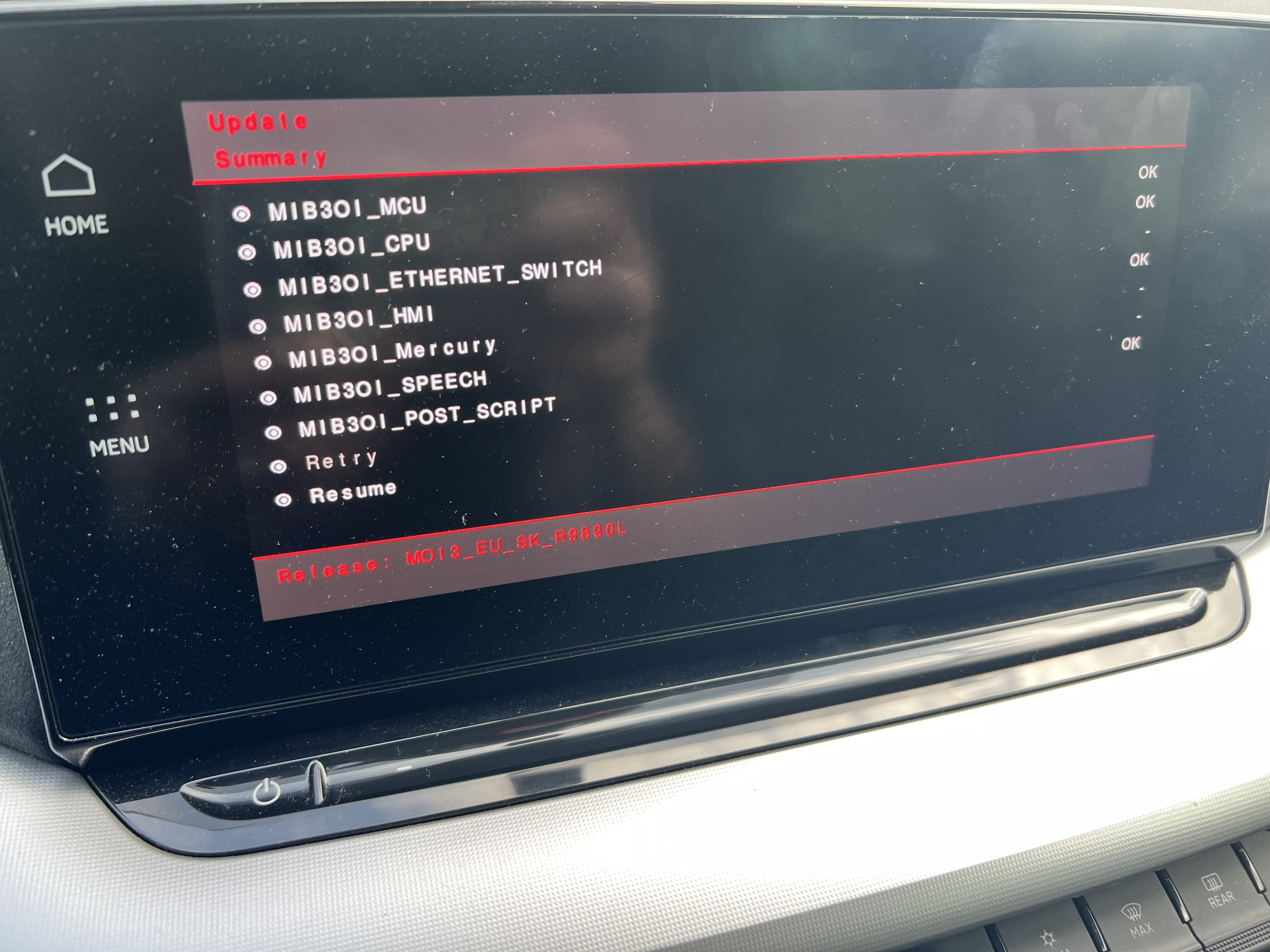

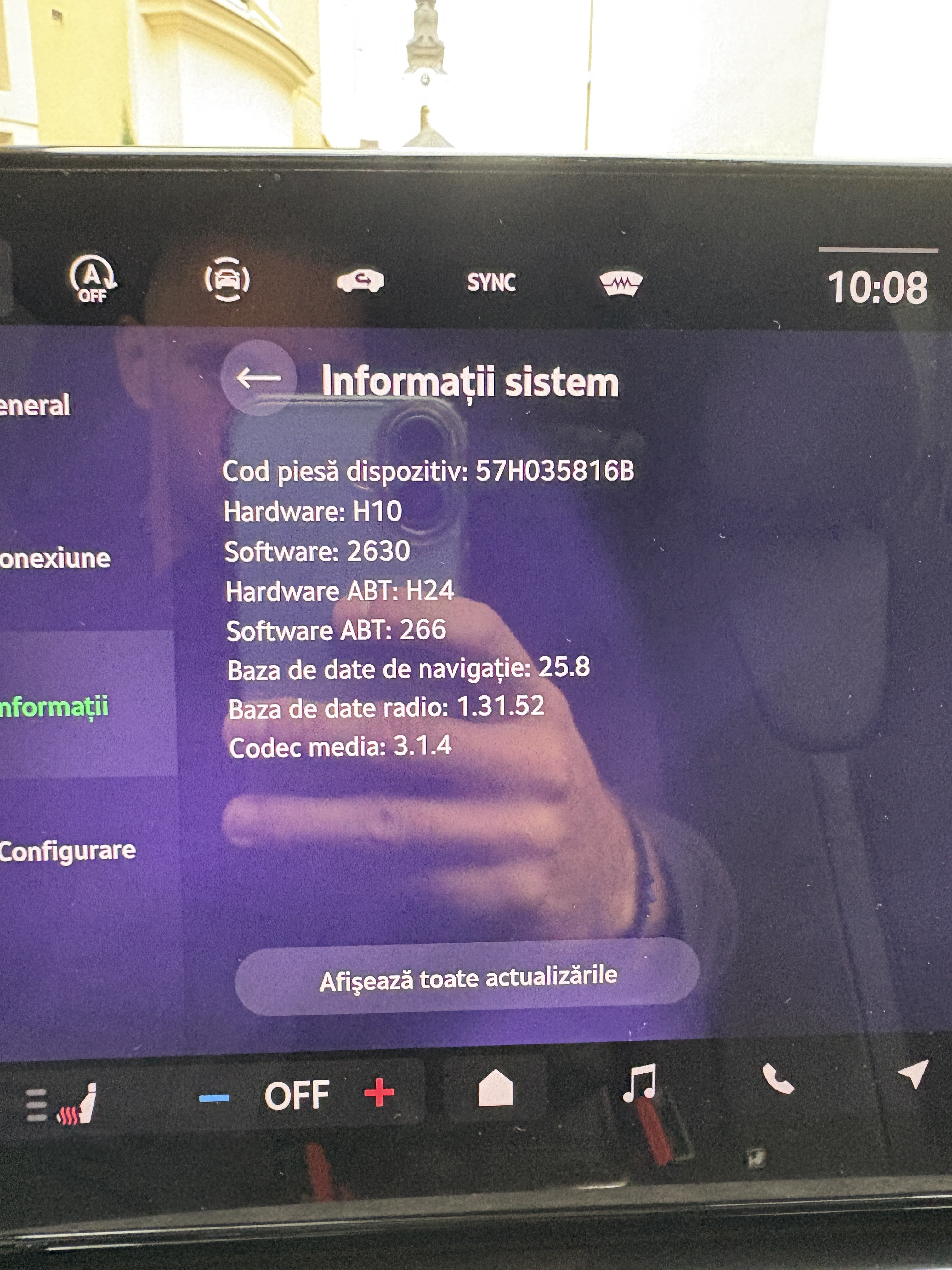

I don't know if it's good or not, I'm not trying anything anymore, I'm waiting for it to update itself, I currently have this version
You have mib 4!!!!!
15 minutes ago, Cairus said:
You have mib !!!
I know, I found out from here. I replied to jacekben76.

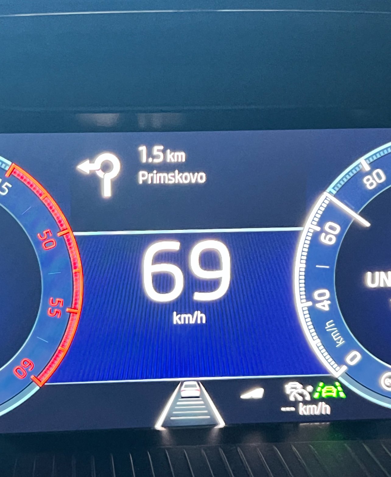

Hi2all
I see that new sw brings direction info arrows on instrument cluster display, from google maps ios app when selected route is active.
Iphone with ios18. Waze does not show them, only google maps and iphone is connected to carplay wireless.

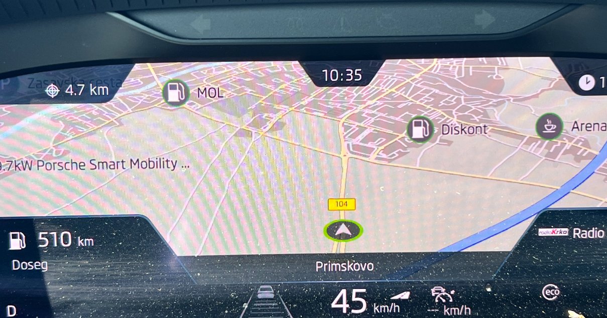

And when i change instrument cluster to be oem skoda navi screen, it has black binocular style frame, different than before, i would say it was without frame.
PS: sometimes still Home button restarts infotaiment, but not every time, 1 out of 10.

Yup, there was an update on the ios app last august. It's not due to the 1989 update.

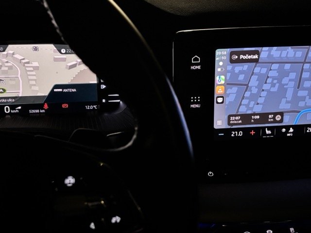

Nice, but my car did not shown directions until now, and it never displayed apple maps on VC.
Neither now ios 18 or 26, as you can see on infotaiment apple maps on VC oem navi map.

I’m still on 1985 and i have them new directions.
