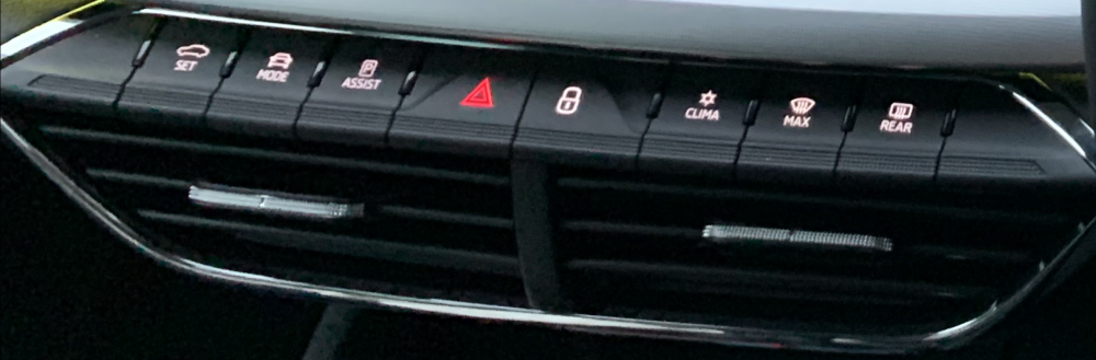

Hello. I’ve successfully updated my SO4 1.5 TSI to software version 1989 without any problems. After the installation was completed successfully, I immediately performed a factory reset based on your feedback from here. Everything is fine except for the fact that I no longer have Driving Modes and I cannot find it anywhere . I don’t have a physical button, but I know the option used to be available somewhere in the infotainment system. Thanks.
Isn’t there a physical button, centre console below screen on same row as air con physical buttons - second button from the left (UK Var)? Only reason I say this is I forgot that the button existed and searched through the virtual buttons only to realise there was in fact a physical button for driving modes.
I grabbed the photo from the internet but, if memory serves me correctly, that’s roughly where the “Mode” button is on my Octavia Mk4 1.5 TSI SEL First Edition.
Hi, thx for your answer but here is mine :))) completely empty and I am 100% sure that I had that option . Prob I have to re-enable it again at the shop
Just updated through USB, took around 10 minutes. Unfortunately the main issue i have it didn't fix, but all other things look fine
No you don't. Sorry!

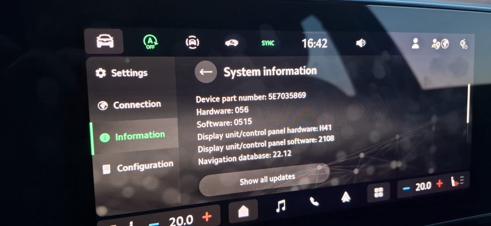

hi skoda fans,
i have some odd HW and SW numbers in my infotainment system and i cant figure them out....
can anybody help or give me a direction i should search for?
its an octavia 2024 1.5tsi selection, 10" infotainment system withouth home and menu physical buttons on the left.
OTA says up-to-date
Edited by emek
Because that's a new version of the infotainment system, so I'd leave it alone.
Also I don't think that the 1989 is compatible with it either, so the old adage of "If it ain't broke don't fix!" applies.
