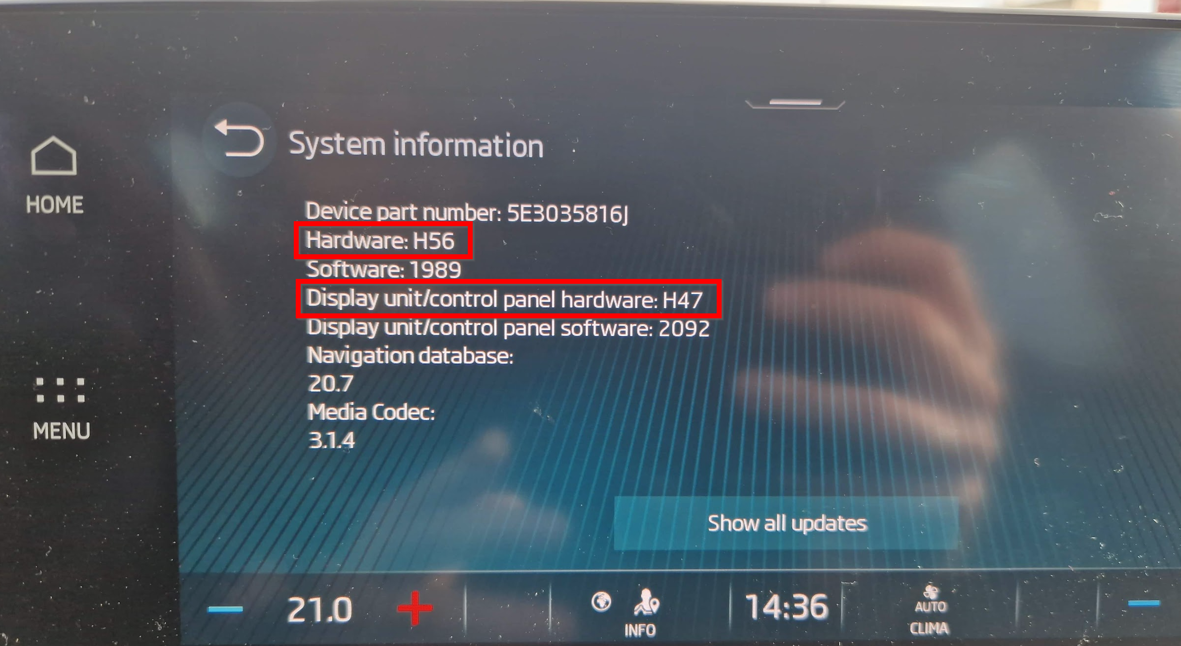

for problematic H44 and H47 you mean "Hardware", or "Display unit/control panel hardware"?
Display hardware version h44 or H47
Volume sliders restarts when you don't expect it.
Lots off troubles.

The display unit isn't updated by the system software though (It has it's own software which is shown as 2092 in the image posted above) it's the main unit behind the glovebox/dashboard that is updated with the system software updates.
Edited by WaveyDavey
Yeah correct but it is not the software that causes the problems. The main computer is oke. The screen hardware with the bugs is not communicating with the computer in a right way

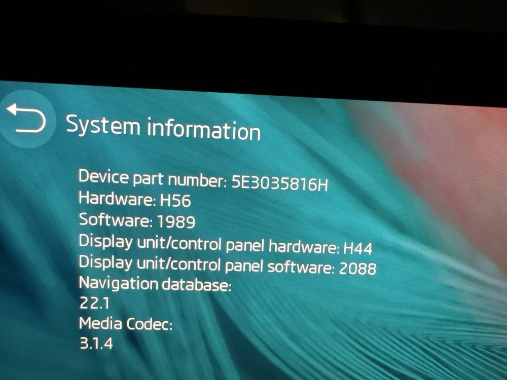

Skoda did the forced reset and then told me I need to book the car in, so I kicked off a bit as told service guy on phone I’d done that and he said bring it down and we’ll have a look, so they relented and said done a configuration on it ‘prob fobbing me off’ and see how that goes. I had no problems on the 45 min drive home.
Below is what I’m currently running 👍🏻
As repeated multiple times by multiple contributors…….
If you are experiencing issues after the update, and tbh even if you are not, do a factory reset via the settings menu. No guarantees this will sort your issues out but it’s a good starting point and seems to have done the trick for multiple people.
My System Information display looks identical to yours - device part number, h/w, s/w, display unit h/w & s/w and media codec all the same numbers - except for i have a later Nav DB version 25.6.
