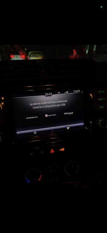

I did it today, worked like a charm.
Had some trouble disconnecting the antenna cable from the radio but otherwise it was really simple.
I used the clamp with the voltage regulator board and could read the chip from the first try.
Total cost was 9 USD including the ch341a and the radio keys both from AliExpress.
