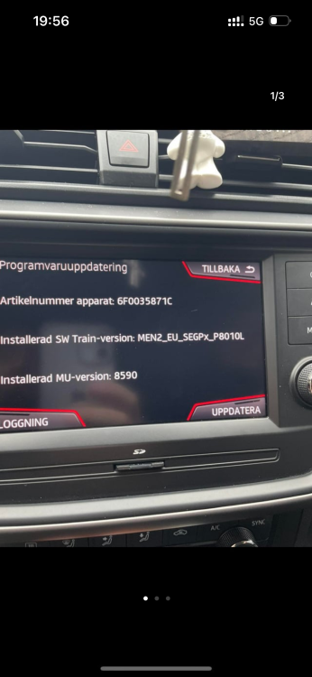

Does this work for this car? MEN2_EU_SEGPX_P8010L
I don’t understand, how you desolder itt and what is the reason?
No need to desolder, try with clamp.
Thank you very much for the topic and the explanation you have made. It really is not found anywhere else. Will this method work on MEN2_EU_SKGPX_P0080L? And my other question is can I use vvdi prog instead of CH341A. Thanks again for the tutorial
Hi, it will work on your train version. No idea about vvdi.
