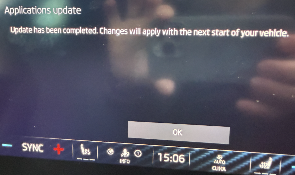

  • For the first time I had the confirmation screen that updates had been installed today:

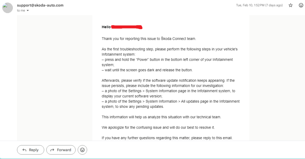

A fairly predictable response to my email of yesterday....
"As the first troubleshooting step, please perform the following steps in your vehicle's Infotainment system:
– press and hold the “Power” button in the bottom left corner of your Infotainment system;
– wait until the screen goes dark and release the button.
Afterwards, please verify if the software update notification keeps appearing. If the issue persists, please include the following information for our investigation:
– a photo of the Settings > System Information page in the Infotainment system, to display your current software version;
– a photo of the Settings > System Information > All updates page in the Infotainment system, to show any pending updates.
This information will help us analyze this situation with our technical team.
We apologize for the confusing issue and will do our best to resolve it.
A modicum of encouragement in that they're mentioning "... analyse the situation..."

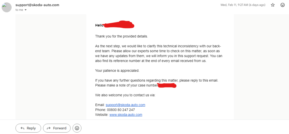

I also got reply from Škoda support, but like the others, it seems generic.
I had pretty much the same response initially on 6th February:
I've left my case number in the screenshot above in case you want them to try and link the cases.

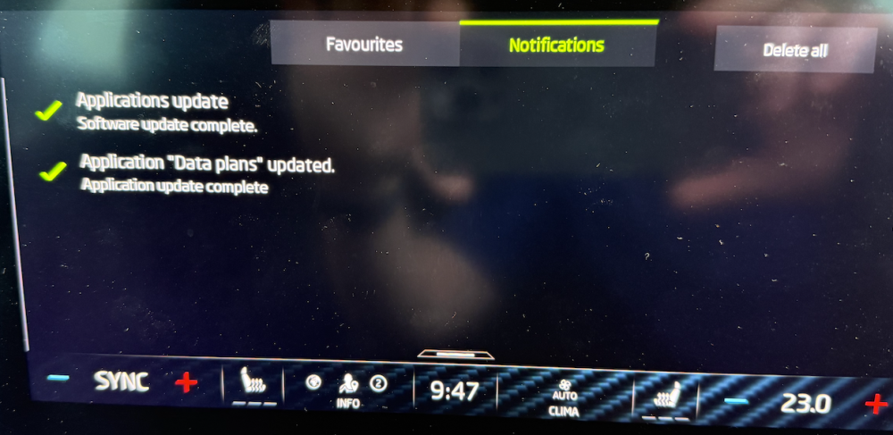

Are any of you 'Primary User' in your car? I have only ever used 'Guest'. I created an account and logged in, becoming Primary User and ran the update, and got 2 green ticks for the data plans and shop updates. I've not seen them before. Will see if I get another update tomorrow but I wonder if the update needs a primary user to work.

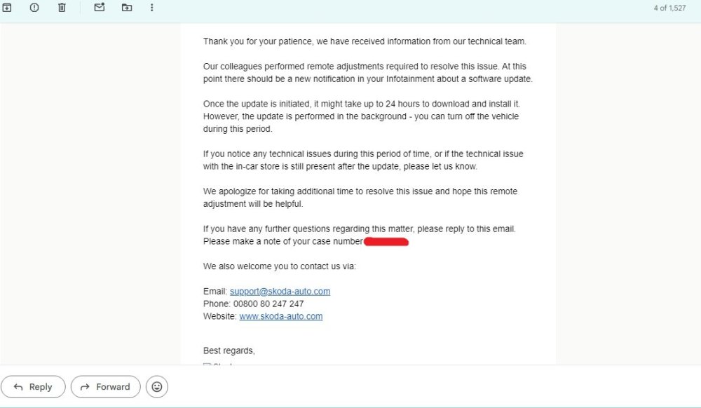

Yes, I'm logged in as primary user. I received the following 'update' from Skoda yesterday...
