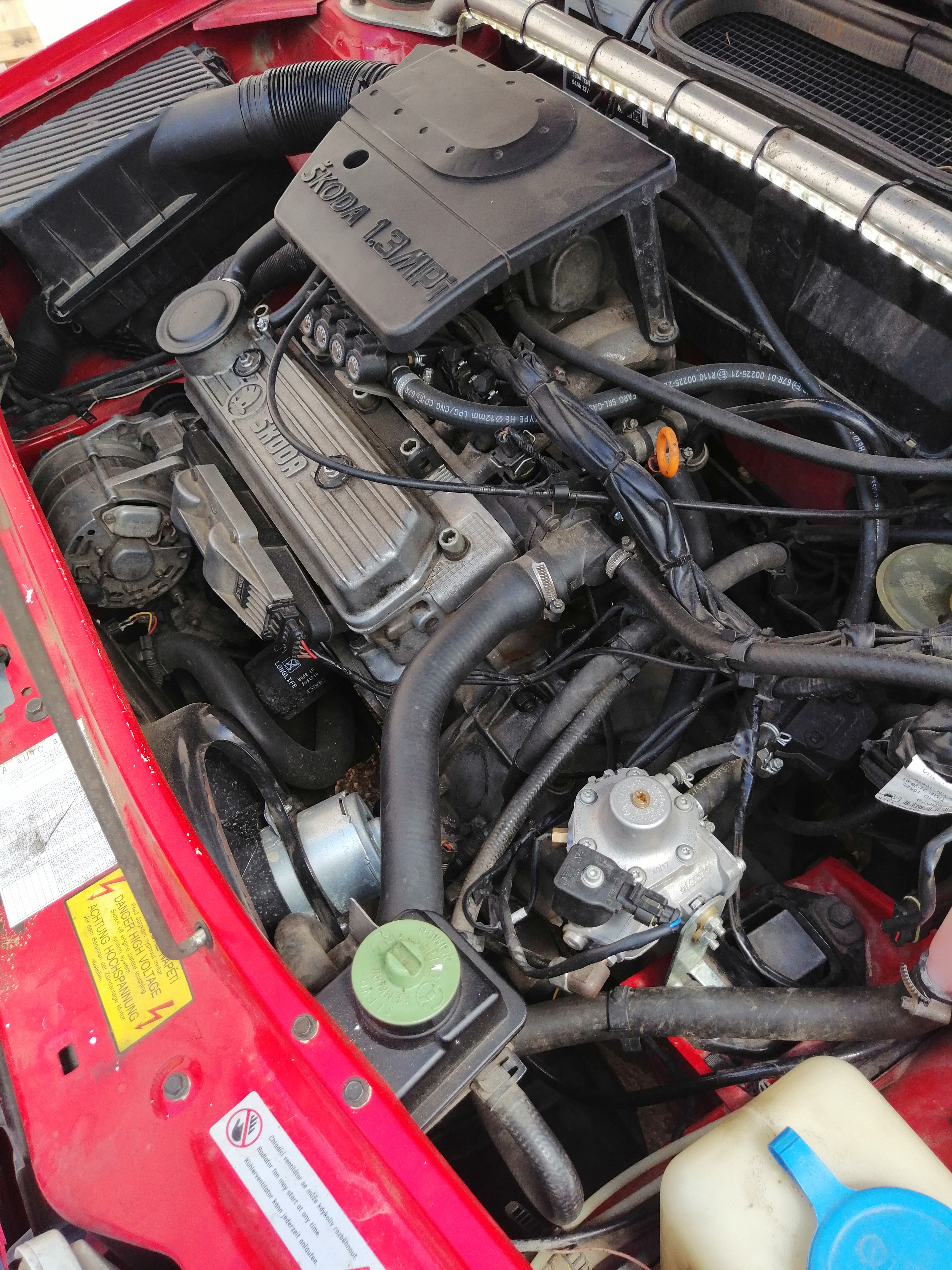

felicia 1.3l and lpg is a big no no
It has to be very fined tuned
Power loss is a threat a great one
also rough idle
car dying randomly (on stop lights)
car not pulling right
car jittering
CAR RUNNING LEAN AND INSTALLER NOT BEING ABLE TO TUNE IT
i got rid of it and i had paid 1000 euros for it
So please know what u doing before attempting anything lpg related on 1.3l engine

He attempted to re-tune it multiple times but to no avail so i deleted the lpg system
There are thousands of Favorits and Felicias converted to LPG without issue, some people even managed to run LPG only, without need for gasoline starts... So I think that your issue was caused by so-called "proffesional" or system, which was not suitable for Felicia

it may not be suitable or it may not be well tuned
I have decent knowledge on engine tuning (i ve performanced tuned dirt bikes and stuff with great results)
But i could NOT get access to the required software to tune my lpg system myself
And no other installer wanted to take responsibility of tuning my car (that was worrisome btw)
Edited by Thefeliciahacker
5 hours ago, Thefeliciahacker said:
Everything is possible in greece trust me on that
I trust you. It happens in every country. You need a 'wise guy', a gullible/passive guy, judicial loopholes, and corruption. Yet there is another less friendly path. You could have shoved his 'well-running' LPG conversion in his rear end (preferably with no grease) until he would have begged you to take your money back...:devil:
The only technical excuse for an LPG installer would be this: if the engine doesn't run perfect on gasoline, it will run like crap on LPG.
