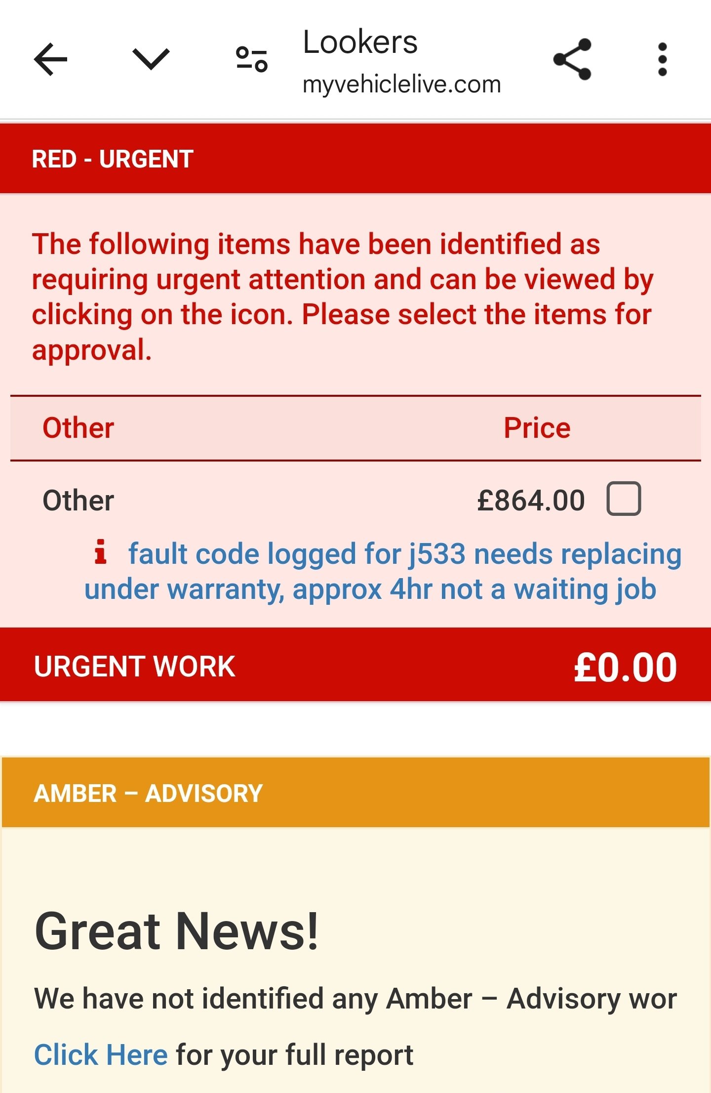

Today my car has been in for the 5th time of asking to get the virtual pedal working. And it still doesn't work! They found a disconnected set of cables & connectors which they reinstated & charged me £324 (am claiming back from insurance) But the infotainment system has been doing weird things, restarts, freezing, starting in sat nav mode and trying to send me to Calais. But also the car is also randomly applying the emergency brake. It turns out that it needed a new f533 module, today it went in for that and now my infotainment system is locked in a boot loop, won't start, but has offered me the engineering menu and says that it requires my S-pin which I set on my app, but won't offer me the keypad to enter it. It has also shown me a system information screen showing hardware and software as "unknown" I've also found that the it's clicking away quite happily as if the parking brake is applying & releasing or the gearbox is doing a reset. So going from no random emergency brake demands and a relatively stable sat nav with an odd glitch to an infotainment system that does nothing, And the car seems to be going into electronic meltdown, there's going to be a couple of bricks put under the front wheels to make sure that it doesn't roll anywhere. I think that I may well be changing my car sooner rather than later, because a garage giving me a car back in this state isn't acceptable.
Infotainment System Restarting endlessly
I've got my car going in for module replacement on Thursday morning, £864 for it, but done under warranty. Hopefully this should sort out my virtual pedal as well.
