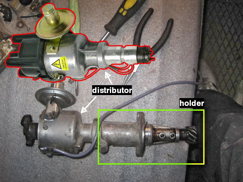

RicardoM replied to captain_crunch's topic in Skoda Favorit, Skoda Felicia, Skoda Fun and Skoda FormanEvery distributor has bearings. This one too. There are three bronze bearings that have all lubrication points. The holder has one long bearing lubricated.
Skoda Members' opinion is required
RicardoM replied to captain_crunch's topic in Skoda Favorit, Skoda Felicia, Skoda Fun and Skoda FormanYou wrongly assume that the distributor for Felicia 1.3 with carburetor is one part that goes to the camshaft. In fact it has 2 parts. A holder, that is removed only when the timing cover is removed, and the distributor per se. That is why removing the distributor means in fact removing only the top part of it hold in place by a clamp with a screw.
RicardoM replied to captain_crunch's topic in Skoda Favorit, Skoda Felicia, Skoda Fun and Skoda FormanInstallation is the exact reverse of the distributor removal.

RicardoM replied to captain_crunch's topic in Skoda Favorit, Skoda Felicia, Skoda Fun and Skoda FormanI respect that. Good description. Now we have a better image of the entire situation. The best thing you did was changing the gearbox. In order to get full engine power/peak engine performance/good acceleration, the following prerequisites are mandatory: good fuel delivery good engine breathing (both inlet and exhaust) good ignition and ignition timing good valve timing good compression Now, to answer your question, a stuck distributor affects directly the ignition timing, hence the combustion, hence top speed and acceleration.
