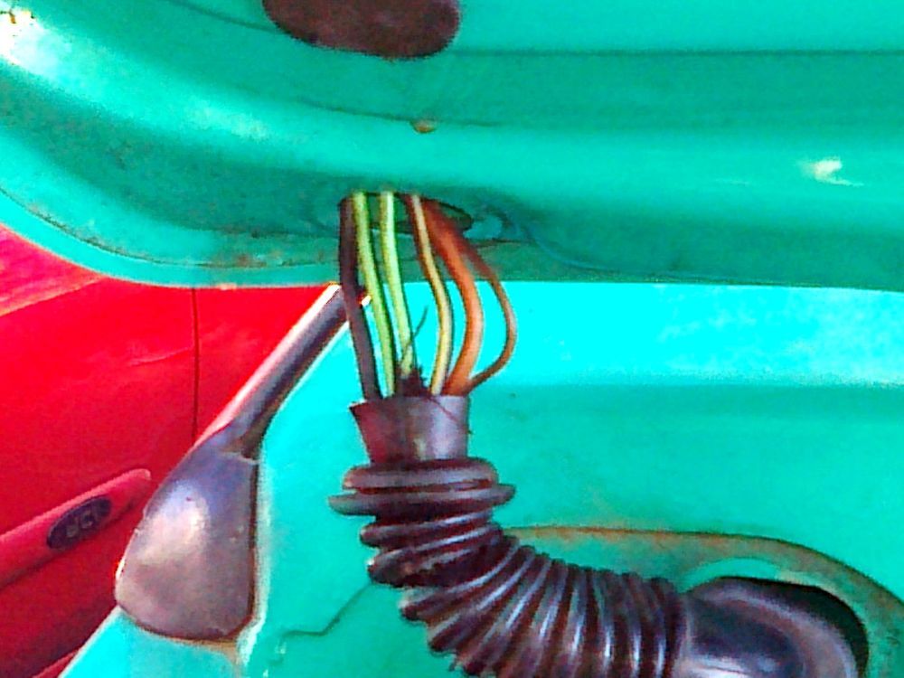

Actually there is no rear camera in that video. It is only the 5th actuator for central locking to open/close the trunk.
