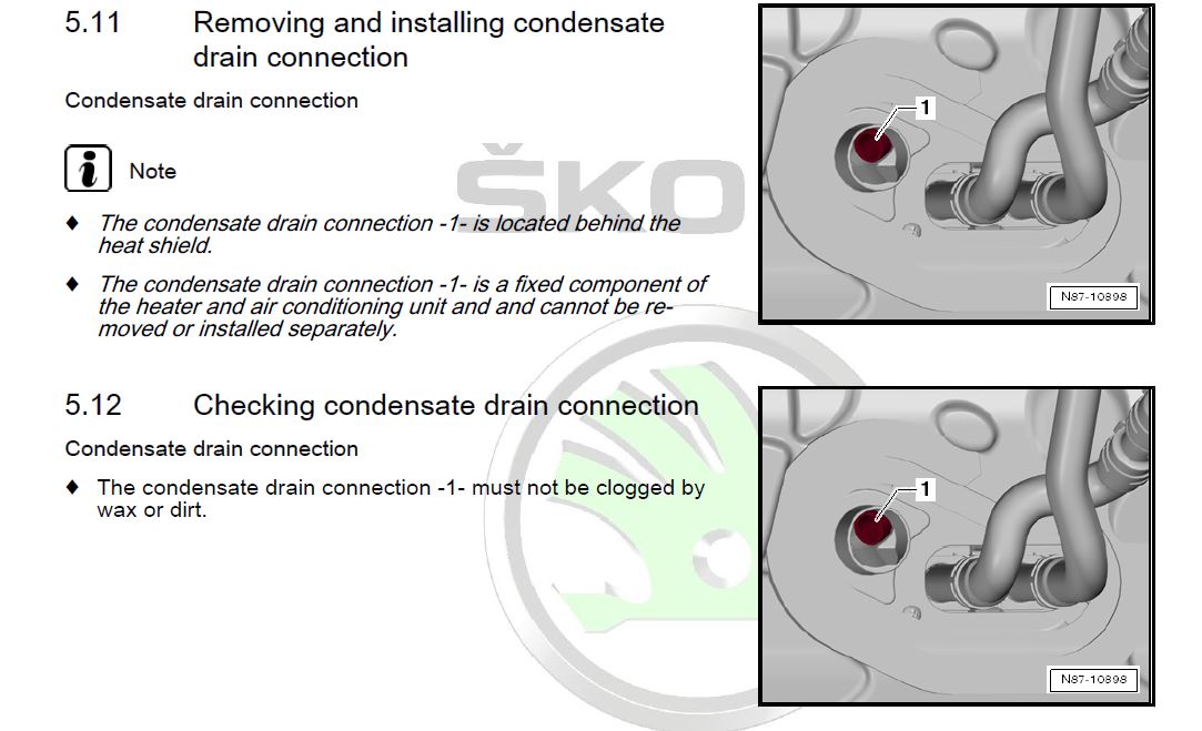

  22. This is all I could find.... See pic. If it's not clogged, it might not be condensation from the evaporator/heat exchanger, and may be that water has got into the ventilation system from blocked drain holes in the air plenum (just below the wipers). Or, the pollen filter is blocked, and not enough fresh air is getting in, or the fresh air/recirculation slider control is not working and damp air is recirculating.
