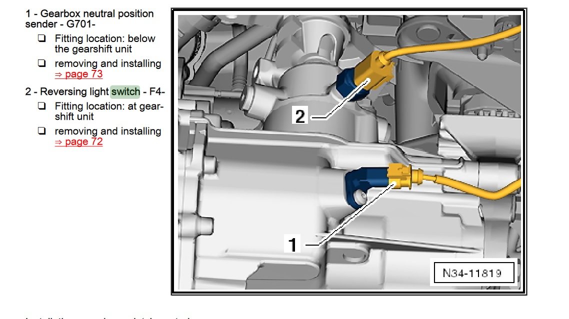

  2. After checking the light switch, the ignition switch is next to check - it's a common failure point. Here's the reversing light switch:

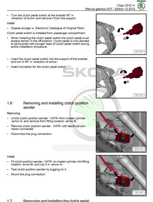

  8. Get someone to waggle the gear lever, while you try to look at where the cables terminate on top of the gearbox. It could be an obstruction or a problem with one of the cables. If nothing obvious, you'll have to pop the cables off the yoke (I will post a pic of this if you want to take it on). Then take a look at the shift mechanism:

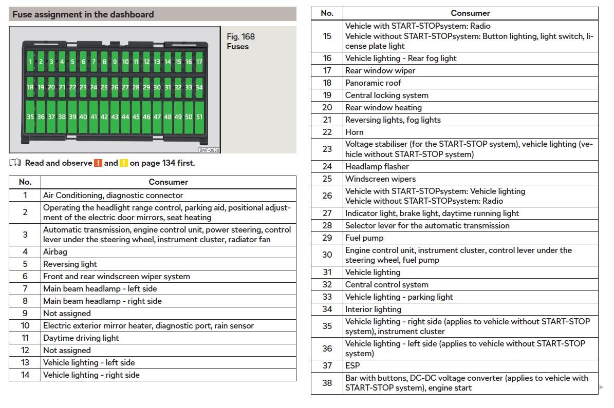

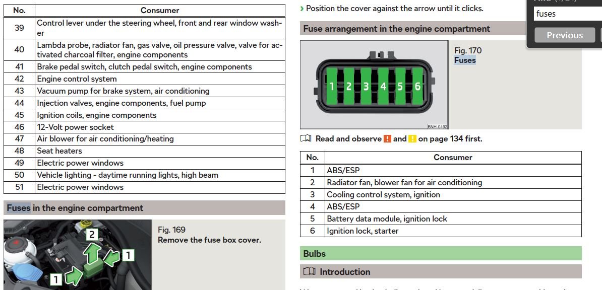

  12. Possibly earth continuity, but if not fuses, it could be the BCM is detecting over-current, and turning off the circuit. Test to see if the lights come back on if you disconnect all the stuff added.....
  13. Could be ignition switch. A common-ish failure.... It's part of the steering lock/ign key but will not require new barrel etc. Read more on the Up! Owners Club.
