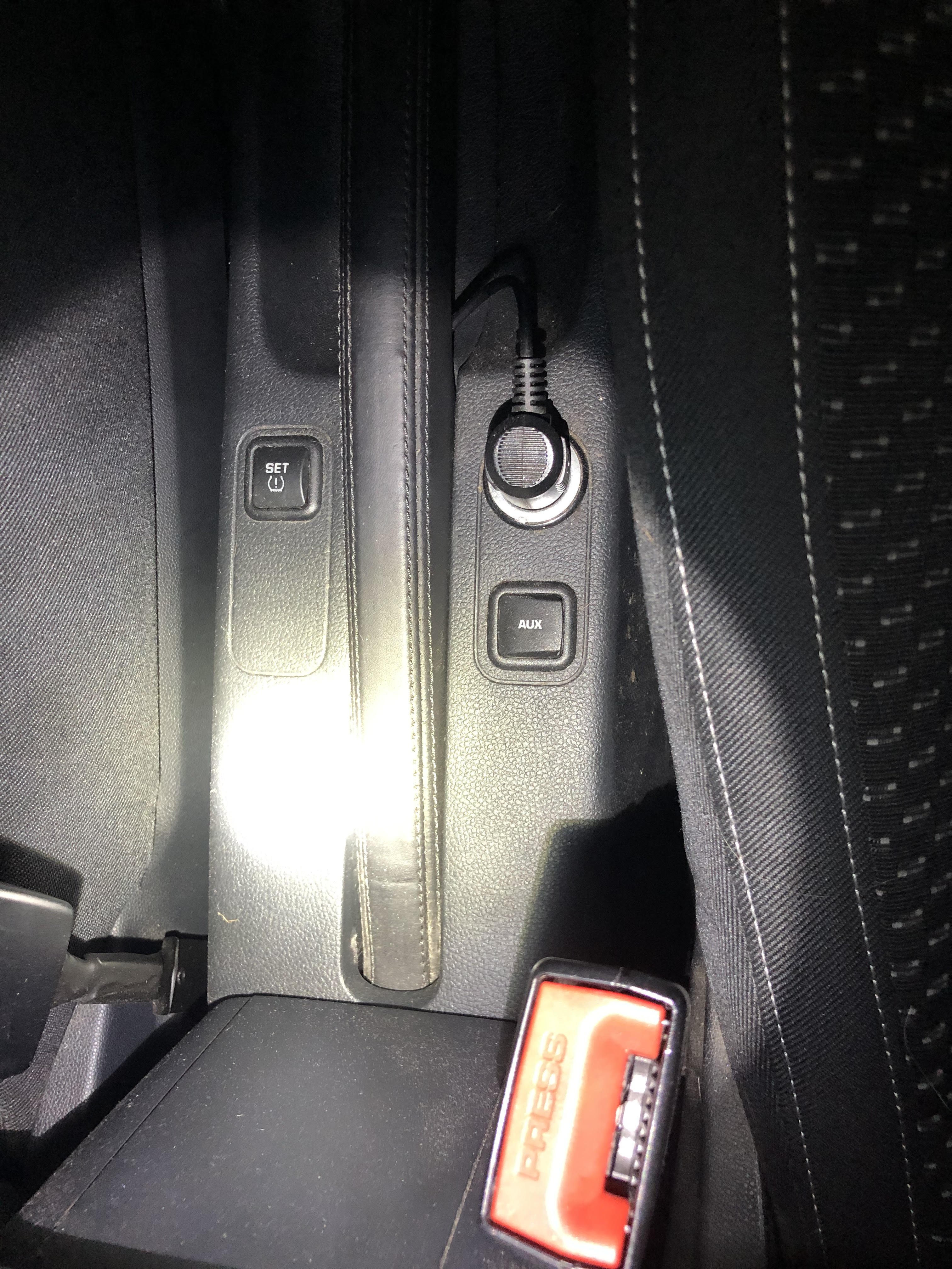

  5. Here it is in my vRS, I would "assume" it's in the same place in all if fitted. You may just have the swing radio, but no aux port. Probably easy enough to add one.
