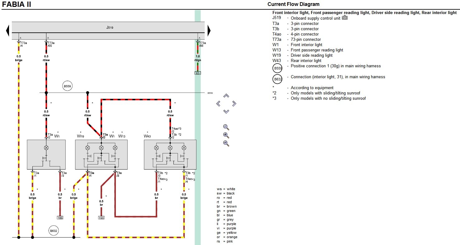

they are all fed from the voltage control unit on a RED / Black wire PIN 2 The feed is supplied when the unit gets a signal from the door contact switch to earth when that particular the door is open, then the unit provides the earth PIN 1, when manually turning on the switch on the light contacts to earth PIN 3 There has to be a positive feed there for you to be able to turn it on manually (assuming your light has a switch) I assume your lights had not "timed out" when you checked for voltage ?
