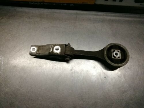

Fabia MKII 1.2 HTP - noise while driving
the knocking felt through the brake pedal AND potentially through gear change points to the rear lower engine "dog bone" mouting worn in my opinion, this dampens the engine "rock" which is at max when starting, so as it's worn (so I suspect) it knocks as the engine fires, again as you dip the clutch the engine "relaxes" and then as power is re-engaged it twists and knocks again. You feel it via the brake pedal as its bolted to the body / subframe under your feet. def worth a look "imo", Also because this mounting is potentially worn / knackered and as it's a rubber bonded mounting, it "may" also be the culprit for allowing sound to transmit through to the body from the running engine. Below is what it looks like, located underneath at the rear of the engine.
