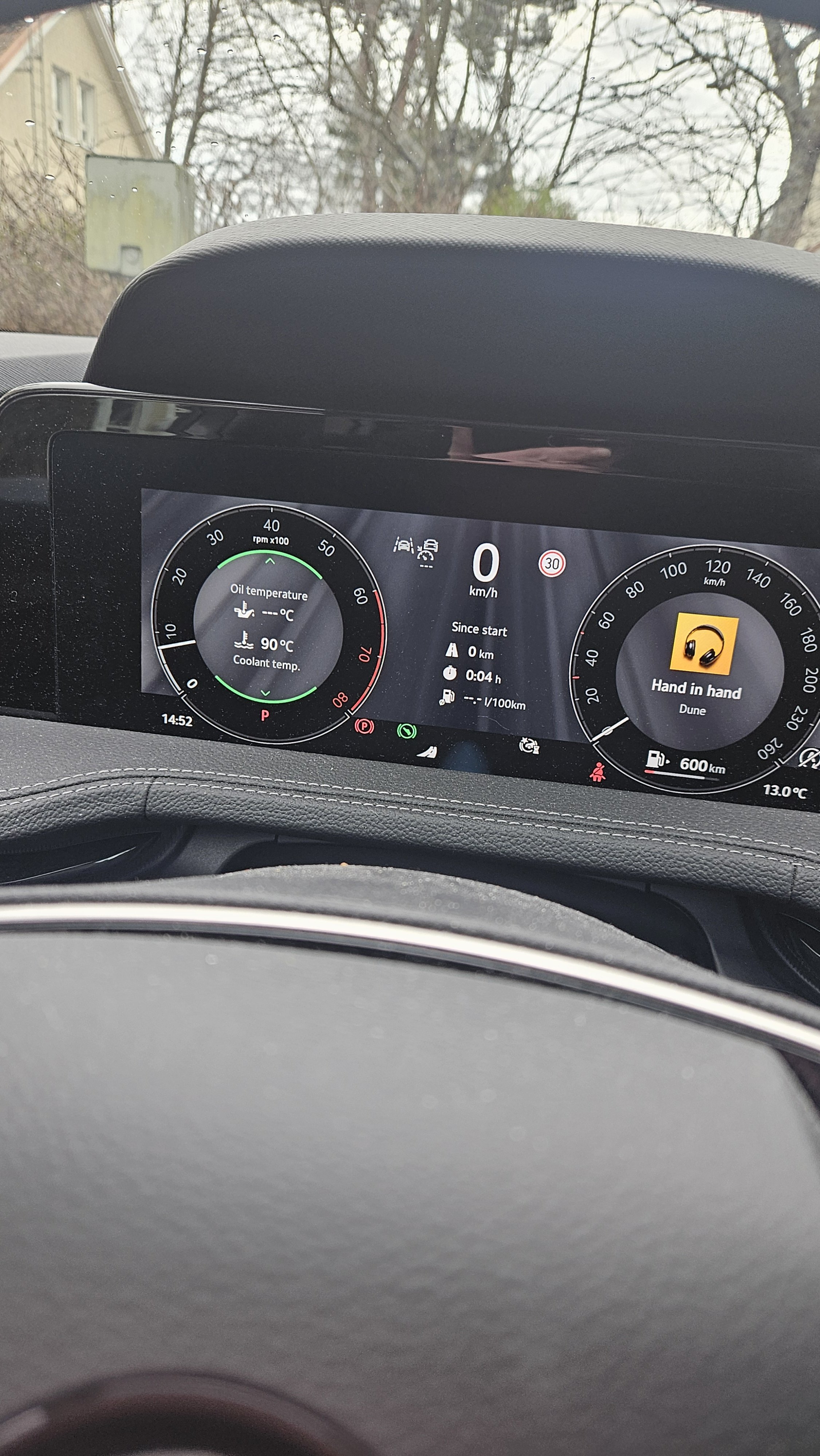

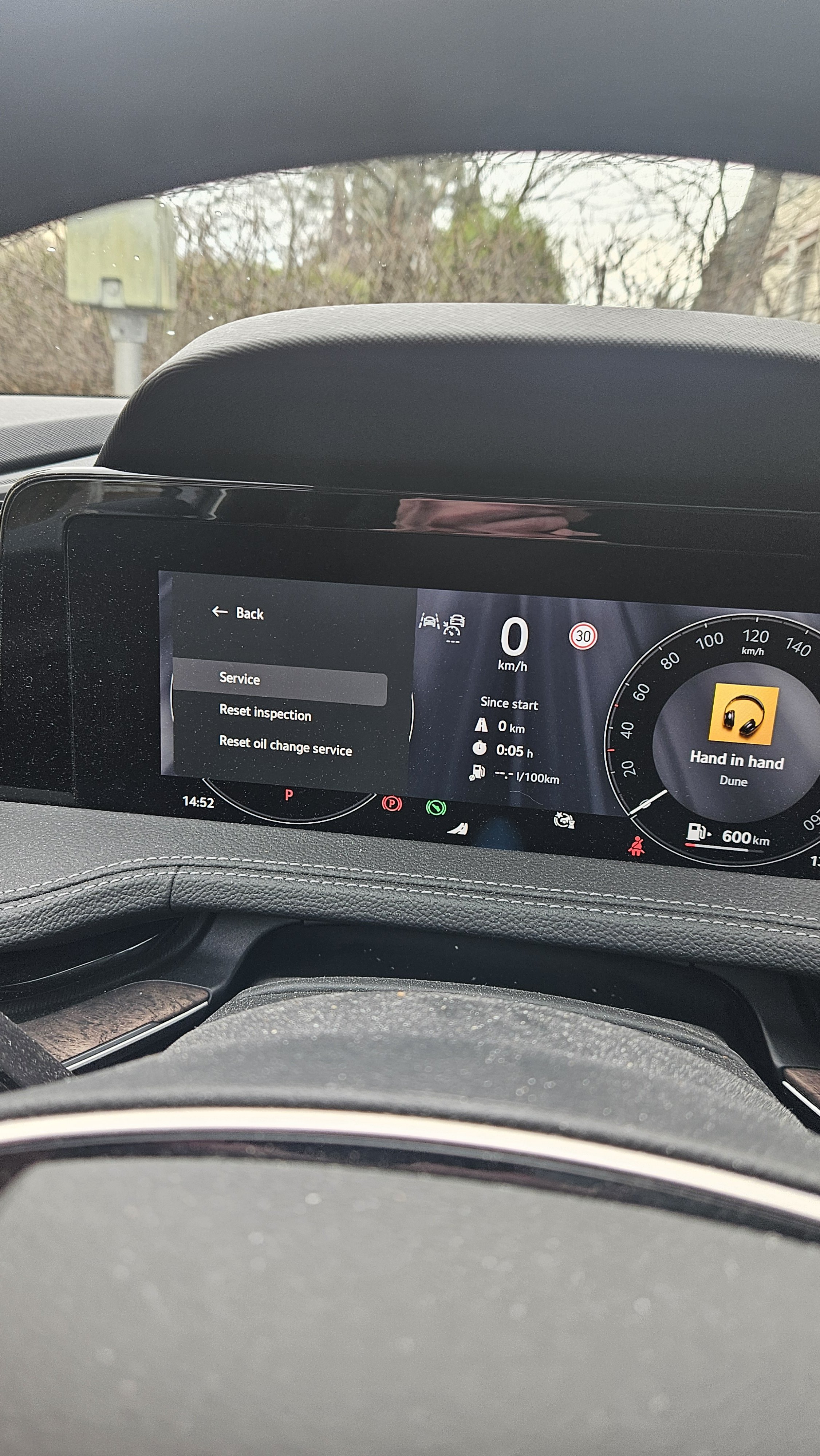

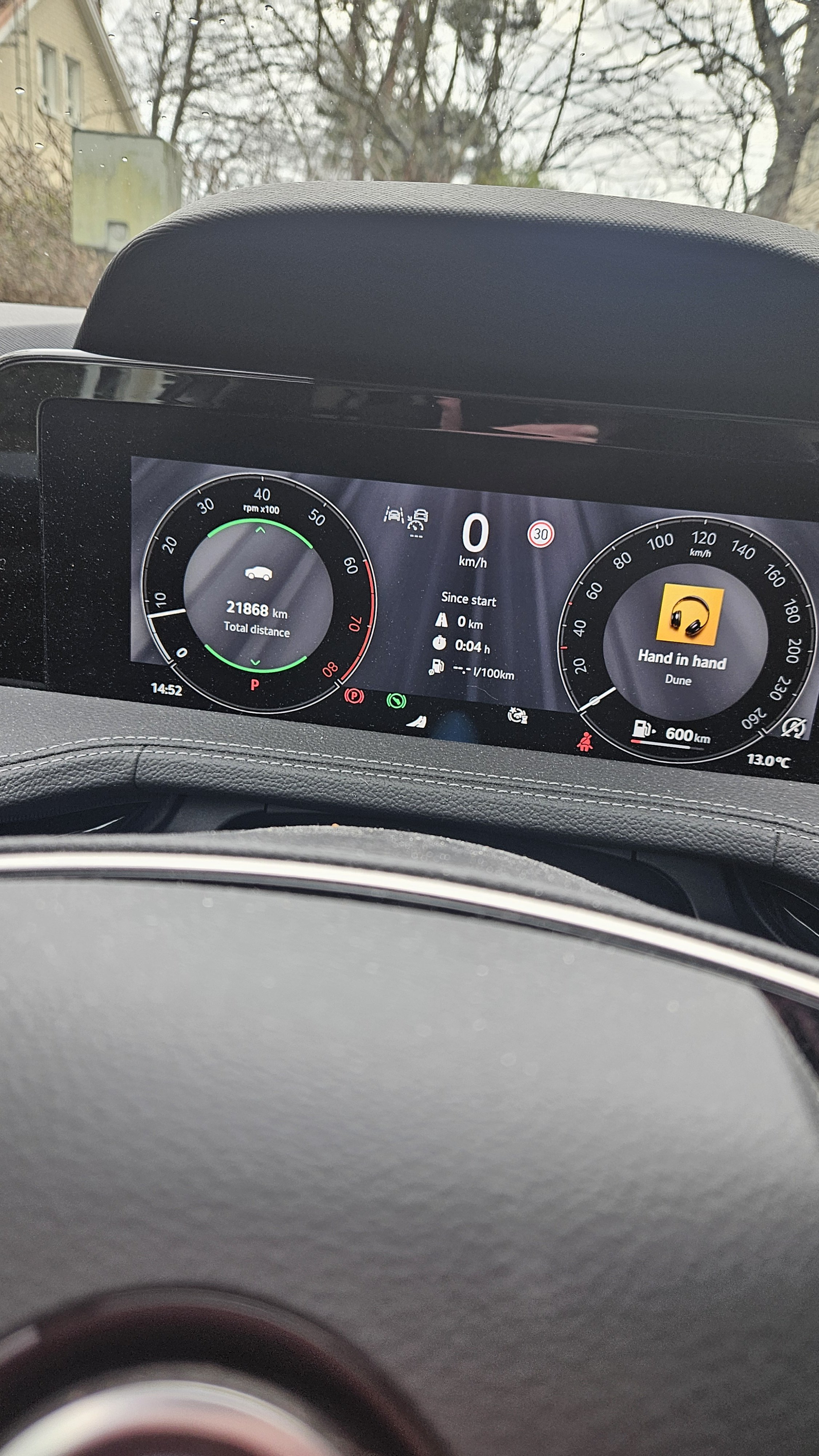

Oil change service
i didnt try that but dont recall an option to set it to a different schedule. But you can always try. I just wanted to get rid of the warning since i will get mine done with the overall service soon and it just annoyed me
Oil change service
(separate post due to size limitations) step 3 press the left button below the right hand scroller you changed it with in the above steps for 5 seconds and let go. voila the menu to reset. the button is the one with the left arrow and the little boxes on it I reset my oil service warning and now it is gone.
Oil change service
now that above post was usefull. howerever it works a bit different on a superb. after some faffing around i just found it. step 1 select the left hand instrument panel with the right side scroller by clicking it step 2 select the "total Distance" km/miles in there with the right side scroller by scrolling up or down
