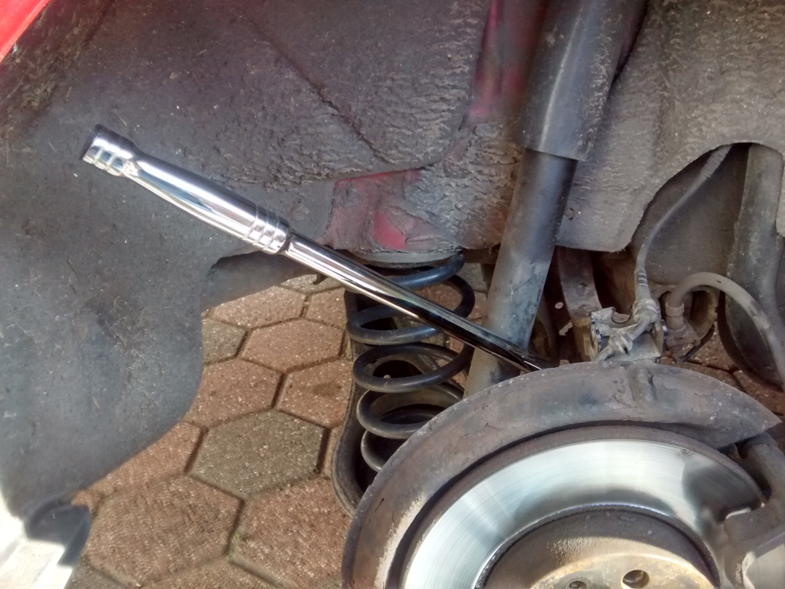

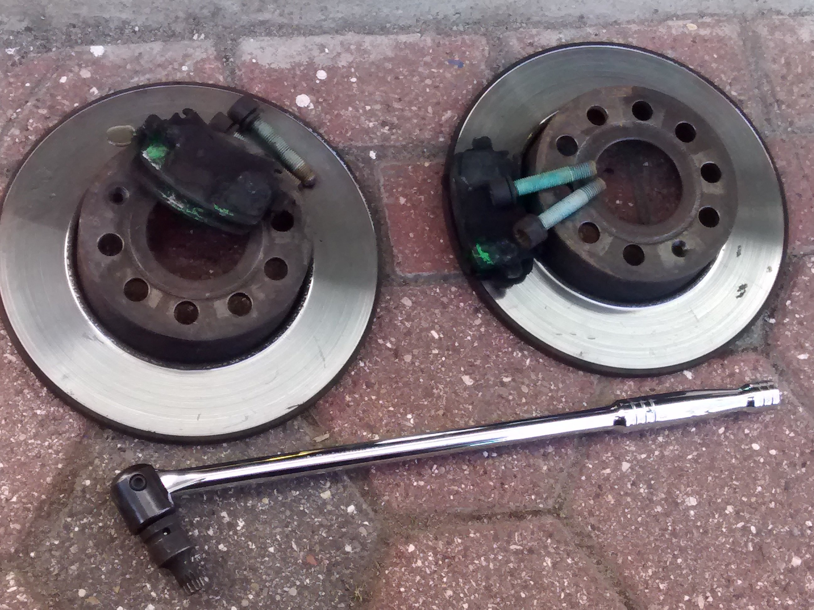

Rear brakes calliper carrier bolts, loosening.
Halfords 18" breaker bar is the perfect length as it just fits in under the wheel arch to provide you with enough leverage. I've done a couple on the drive so it is doable but only with the correct length of breaker bar.
