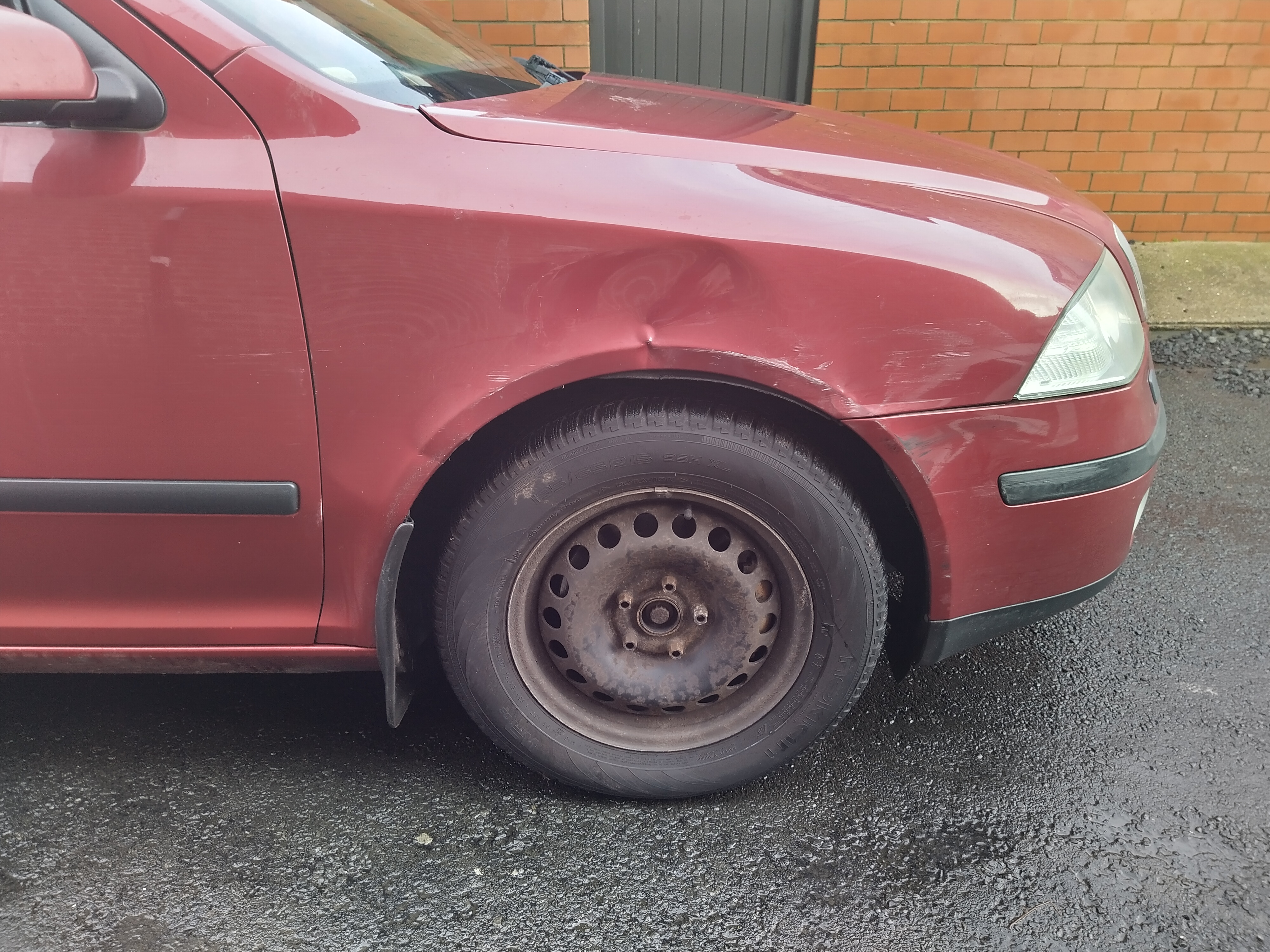

  16. Most likely to be uneconomical to repair. Someone bashed my wing and they wrote it off despite it just needing a wing.
  17. I was given 2 Options full settlement or full settlement less savage value and keep the car. I chose the later and purchased the car back for £400 then got wing from the scrap yard for £40 to fixed it up as at the time I was struggling to find anything reasonable as I didn't want to rush to buy something. I just sold it this week and made a small profit on it.
  18. same thing happened to me a few months back, a lady side swiped my car on a round about, it went through an accident management company from the other party. They didn't even come to assess the car and just asked me to take some pics and they came back that my car was a write-off despite just a minor scrape on the wing. However I got a very reasonable offer and the guy said if you are not happy with the price just take some examples from auto trader as you are suppose to be able to purchase something similar with the settlement. Have they offered you to buy your car back and get it repaired yourself, as that might be an option if the figures work out.
  19. Also try Facebook market place. Mine got minor damage on wing last December and insurance wrote off the whole car😞 so not surprised with the insurance quotes you are getting.
