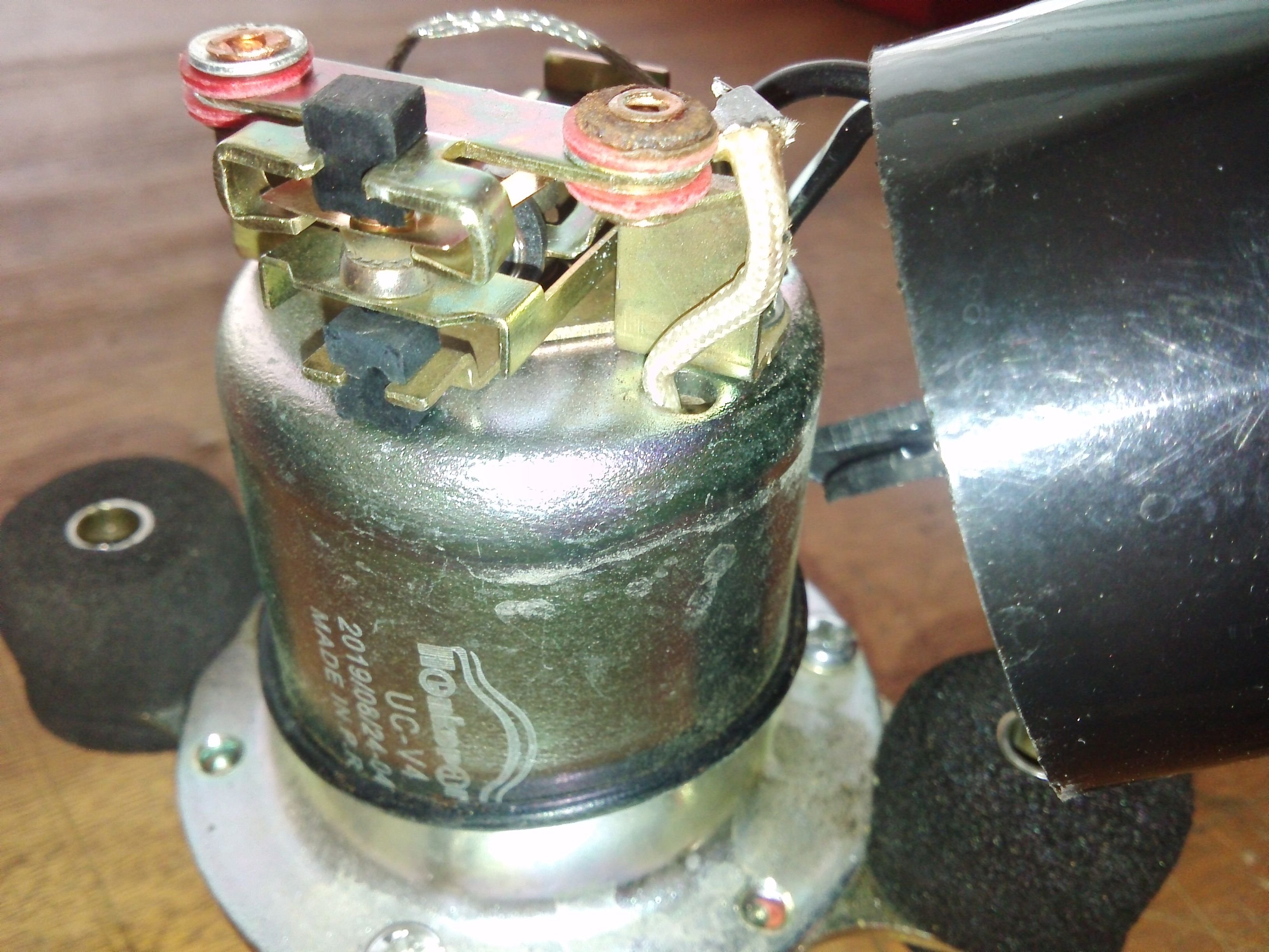

The balance! The keyword is balance. Both the fan blades and motor itself have to be balanced too like any other fast rotating part. One must consider this before attempting a repair/refurbish job. They have professional tools for this. An overlooked but very important detail.

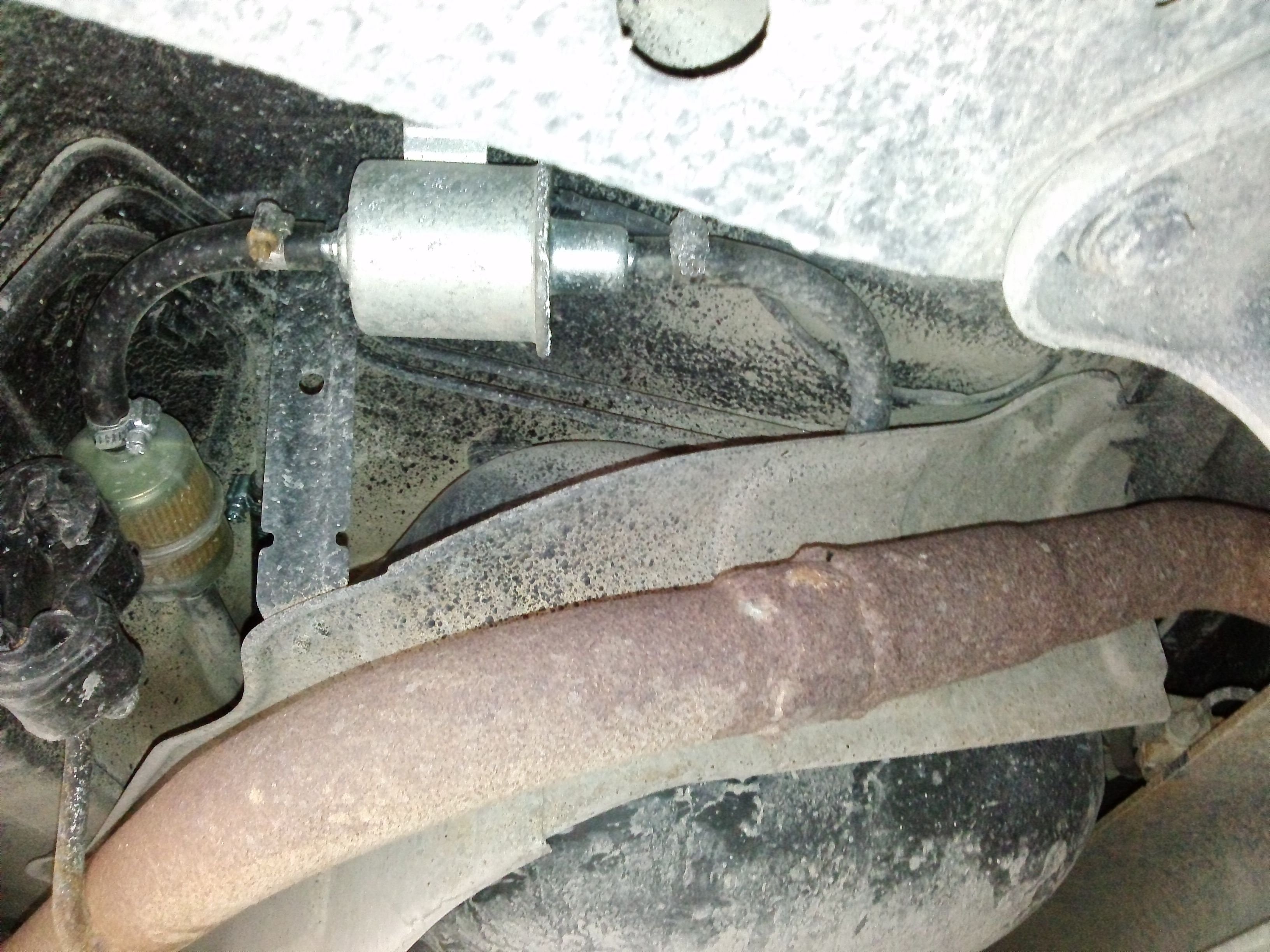

I want to add some personal observations and notes for the future mod attempts by fellow Škodians. Both fuel pumps I've used here are sometimes referred as "low pressure universal fuel pump". That means car enthusiasts around the world found them useful for general use. First one is from Bedford Rascal: With OEM code 15100-85501. Advantages: - Noise and vibration level is average. - It has its own vibration stabilizers. - Suction ability is better than HEP02A but I didn't measure exact height. Disadvantages: - It has to be placed straight up. Its not so ordinary shape could give you some trouble when installing in custom projects. - Fuel input and output parts are made from plastic. You have to be very very careful with your assembly. Input and output fuel hoses must NOT put any mechanical stress on the pump. Check 15:10 It has some kind of contact breaker mechanism inside: I've also saw one in a Japanese source with electronic circuit inside. Second pump is a HEP02A Advantages: - Very sturdy. All metal body. - Easy to mount. Orientation doesn't matter. - You can use it for diesel projects. Originally it's a diesel pump. - Inline free flow compatible. (Not tested myself. I read it from some other place) They use it in large excavators as priming pump for the main pump. If you are familiar with old diesel machinery you know its purpose. Disadvantages: - It's an excavator fuel pump! Very loud. I can hear it from back of the car even the engine is running. It's makes you feel like you are driving a Citroën 2CV Sahara. At least, when it gets warm, it gets quiet and bearable. - You have to take vibration stabilizers into account and design the mounting accordingly or you will feel it working on your bottom. - Suction capacity is low. I measured 40cm height maximum. I don't know which one is more durable in everyday use. I used my HEP02A last winter as a starting helper in cold winter days. It worked every time even in sub -15ºC conditions.

Long term review & update. Last fuel pump mod resulted inconsistent work, or at least made me thought so. It was cutting fuel supply like the tank was empty. Sometimes stopped working too. I thought it was overheated and damaged. Like I had mentioned before, another alternate was a HEP02A. I tried another installation with a HEP02A. I made this bridge and HEP02A was on here. Fuel line was connected to it. Result was same. Inconsistent work. Sometimes pumped, sometimes not. This was fuel pump mod V.2. Very short lived. Here is V.3. I think this is the best place. Pump will stay cool. Another important detail is; fuel pumps' suction capacity is very limited. You better keep it close to the fuel tank. Success? NO! Inconsistent work again. But this time I detected a pattern. Fuel supply stops when tank level reaches the same level. I didn't know there was a rubber hose inside of the fuel tank. After 30 years of fuel contact made the middle rubber part decay. I replaced it and now everything works perfect.

Since I can't edit my post above, I want to add that, I can't find any alternate fan from Bosch or any other reputable brand in my area. There are brands like Vika Ruby etc. (Importing is not an option at this time.) After some research, I'm %90 sure, the fan currently I have is from a Felicia. This one has only one speed and possibly 70W. That means it's over 20 years old. 😱 I think I can open it by prying the metal edges folded over the back plate. - Should I try to open the fan and replace the carbon brushes? OR - Buy a new one. Which one is more reliable? 20+ years old Bosch fan with new carbon brushes or a new aftermarket fan? (Vika) (New fans are 120/200W two speed models. I'll use only the slow speed.)
