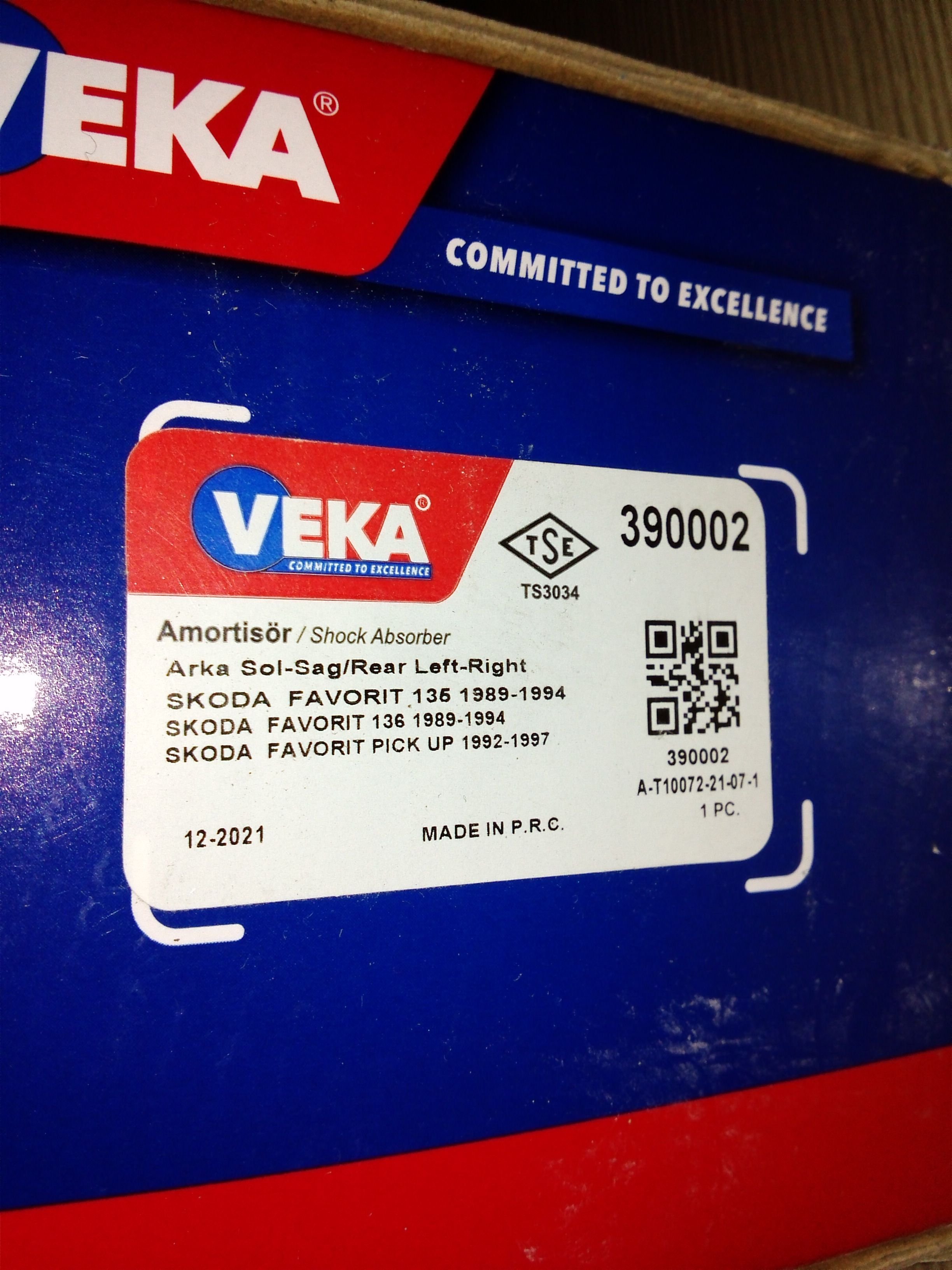

I think, a product carrying "Made In Germany" on it has its engineering made proper. I don't think it will cause you any trouble in the future. Good work by the way. Keep it up. Here is what I've installed. (The sticker on the product box) I don't think you can find this in UK tough. A more universal part locally sold is: Monroe 23821 Listed with OEM number: 115395001 Seller's compatibility list: (Meaning it will "fit" but doesn't mean absolutely proper!) Skoda Favorit L (89-92) Skoda Favorit LX (93-95) Skoda Favorit Pick-Up L (92-93) Skoda Favorit Pick-Up LX (93-95) Skoda Felicia 1.3 MPI Skoda Felicia 1.6 MPI ( AEE ) Skoda Felicia Combi Skoda Felicia LX - GLX (95-97) Skoda Felicia LX - GLX (98-01) Facelift Skoda Forman L (89-92) Skoda Forman LX (93-95) I worked a lot on the car, and I've encountered many "replacement parts not fitting" type of problems. For example, door handles. I've modified them a little bit to fit to their place. Some parts for our cars are not available any more. I'm also collecting knowledge to fit parts from other cars' parts. Feel free to PM me for any question if you don't like posting a topic about it. (I won't ask anything for return) Only thing I don't have a slightest idea could be SPI fuel system on your Favorit because I have a carb. system.

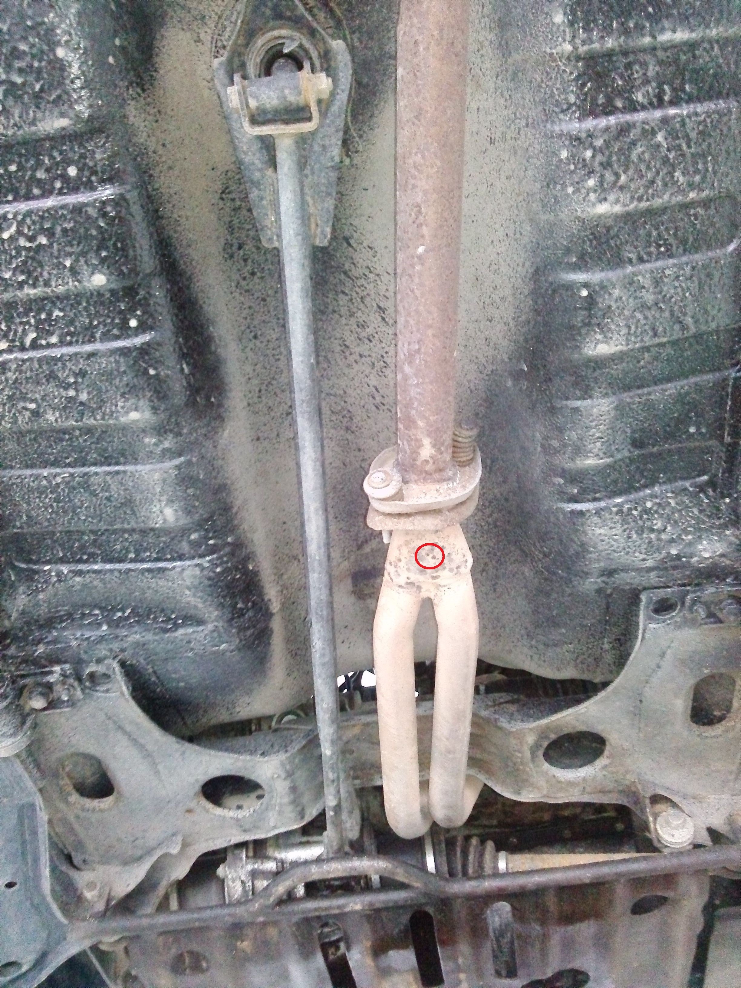

I think installing a lambda sensor and having an onboard gauge for reading it and plus, an onboard vacuum meter combination would help me adjust LPG and advance curve better. I'm currently calculating total costs & feasibility of such a modification to the exhaust pipes. - Is this a suitable place for drilling and welding a lambda sensor nut? Of course the sensor will be above that part. (Marked with red circle. ) - I know a lambda sensor needs to be hot to get accurate readings. Felicia MPI has shorter exhaust down-pipe and the sensor is much closer to the engine. Does the place I chose will be hot enough? Felicia lambda sensor location. - Injection Felicia or Favorits have this style of exhaust down pipes. Two main pipes exiting from exhaust manifold is connected together very shortly compared to pre-cat carb. Favorits. Is this exhaust style more restricting? Will I lose some HPs if I adopt this down pipe to be able to install a lambda sensor correctly? (A straight pipe will be placed to compensate the lost distance under the car) Post regulated-CAT and pre-CAT down pipes comparison. - Last question. Does using a cheaper narrow-band sensor will give me what I need?

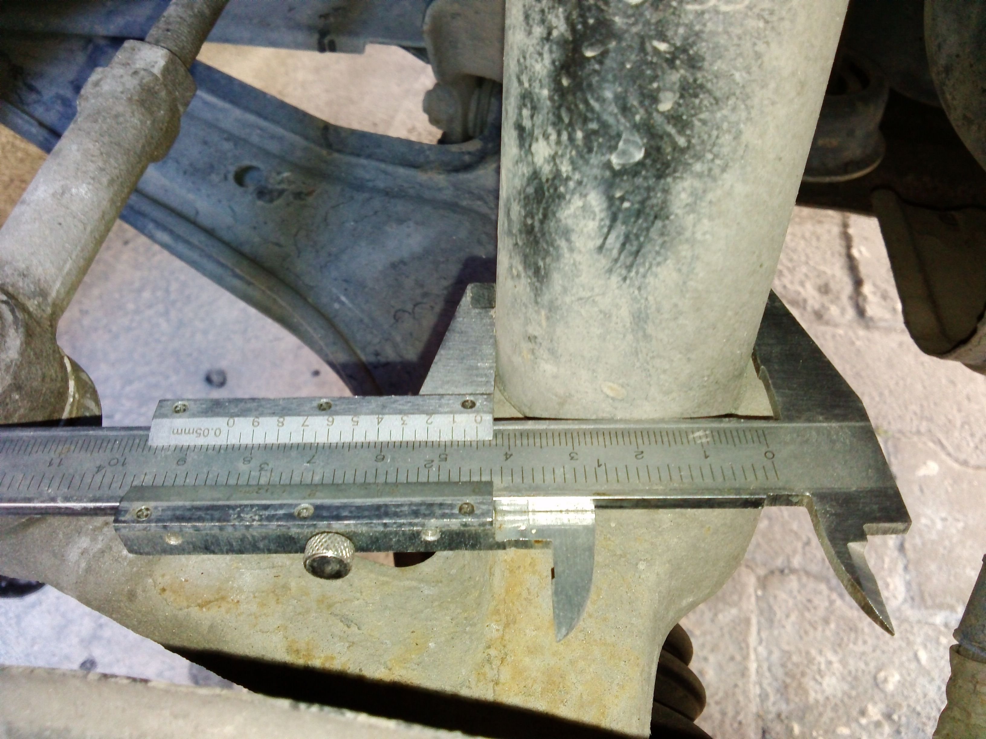

I've measured the strut's thickness from just above knuckle. Hope this provides any help for you. It's 45mm. Original Code: 115495001 VW Code: 6U6413031B Example product: Monroe G16130

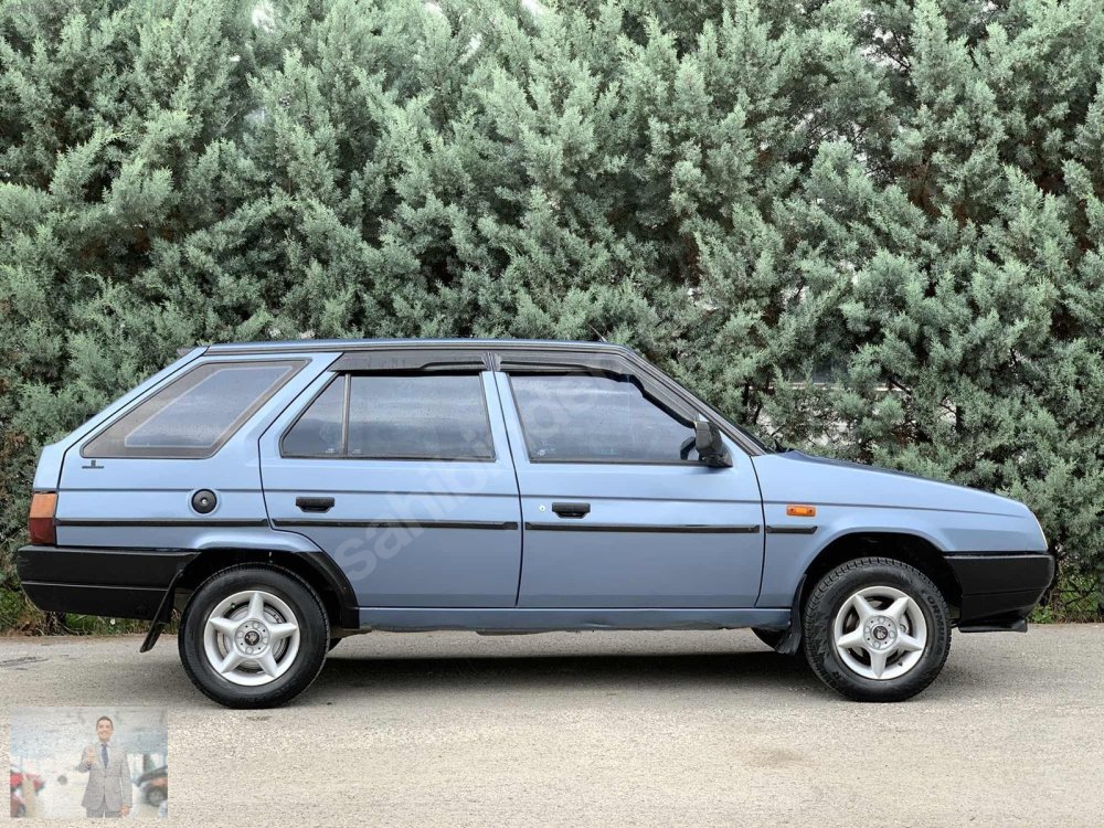

I'm asking about your general opinion first. What do you think about factory installed side strips? Do you like them? Does the car look better with these or not? Does the car really need them? Secondly, I'm asking about how do they look on Forman? First and most common option: Short side strips aligned to bumper line. From personal experience, they are not very protective because they are not installed on the apex point of the panels. Second option: On some models, (GLX maybe?) longer side strips are installed. These are also installed on apex point. Third option: No side strips. Fourth option: Painted or vinyl side strips as an aesthetic replacement for physical ones. I couldn't find a picture for this but I saw cars on the street like this. Which one would you prefer?
