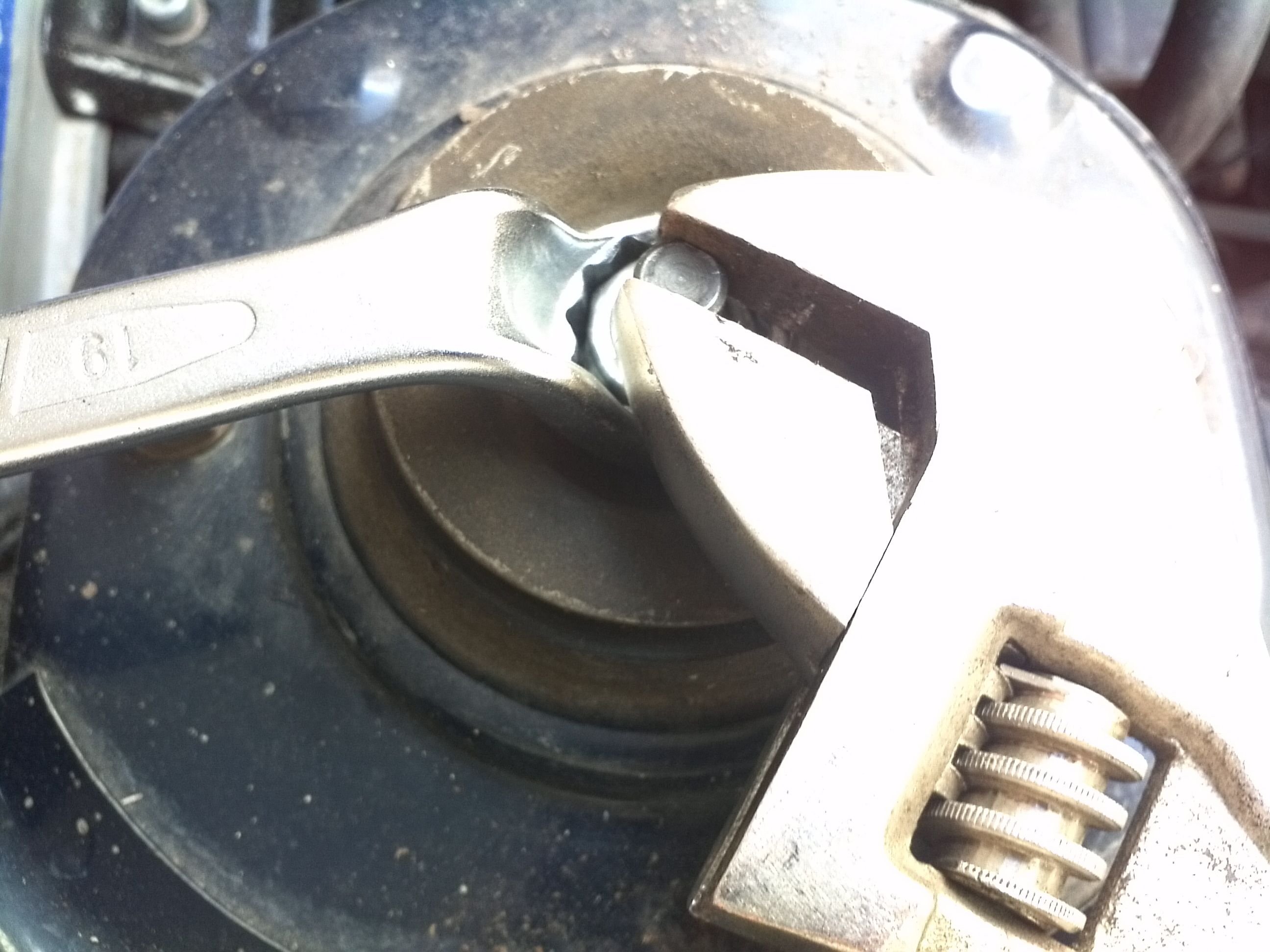

What is this bolt in front of the engine?
Shouldn't I worry about metal dust inside? Great ideas by the way. I'm glad you are active again. I missed your posts.
No, it's a metal cap. Like these: But very small diameter. Only 8mm.
Favorit front strut top mounts replacement
I've found something about it. It's number 32. It's an 8mm plug. Like a freeze plug but installed on an oil channel. N90796301 Now, how would you replace an 8mm plug on an oil channel without removing the engine?

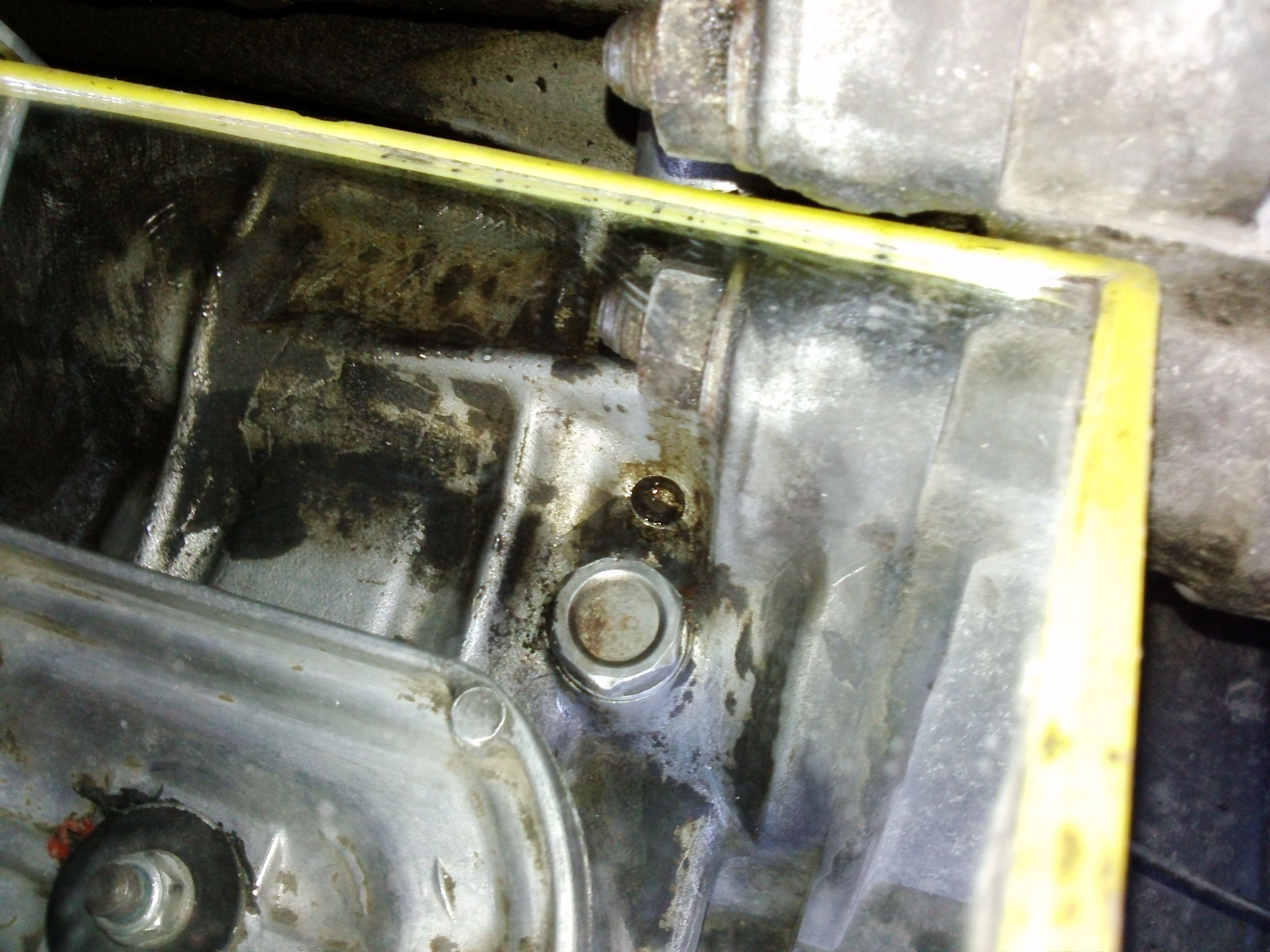

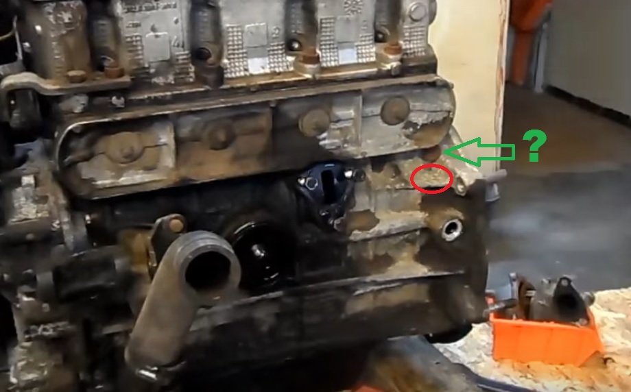

Bad news... I suspected from another source of leak and finally found this: Now please if anyone knows, what is this mysterious recess? This picture above is from my engine. I used a mirror to take the picture so it's inverted. The mysterious recess is well hidden from eyesight. It's just below the bolt I've asked before. I couldn't notice this before because it was covered in oily muck. It's angled downwards. I'm afraid it might be some kind of over pressure relief plug. If that's so, I think it's impossible to fix it without removing the engine? I can't imagine removing the engine because of this.

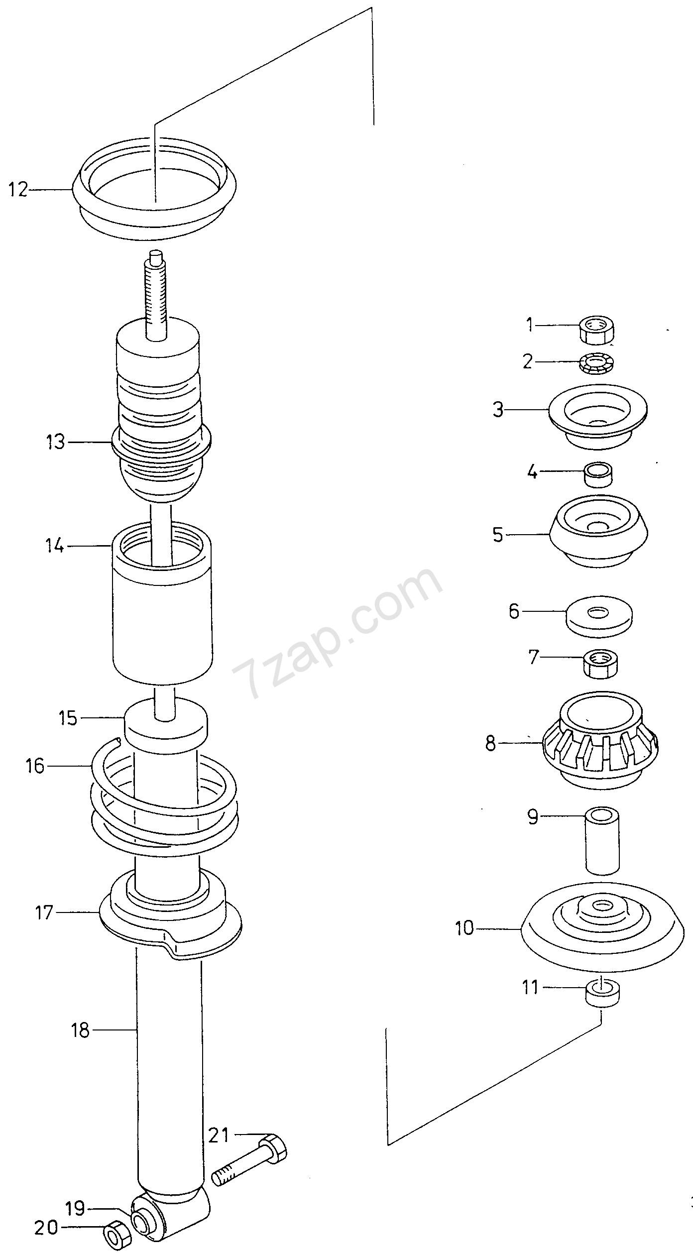

@KenONeill Thanks for your time and valuable input. Also, for the record. I used a set of (2x) new No: 2, 4 (fabricated), 5, 7, 8, 10, 11 (fashioned from standard washers), 13, 14, 18, 20, 21 No:15 is missing. It's near impossible to find. I even searched VW shops for Golf2 substitutes and had no chance. No:12 on both sides were in an unbelievably good shape after 30yrs. of use. Seems available on the market but not common. I used old ones. Also a good seller recommended to use old and original springs unless there is an utmost need. He told me that, aftermarket copies had a tendency to lose their stiffness and form in a short time.

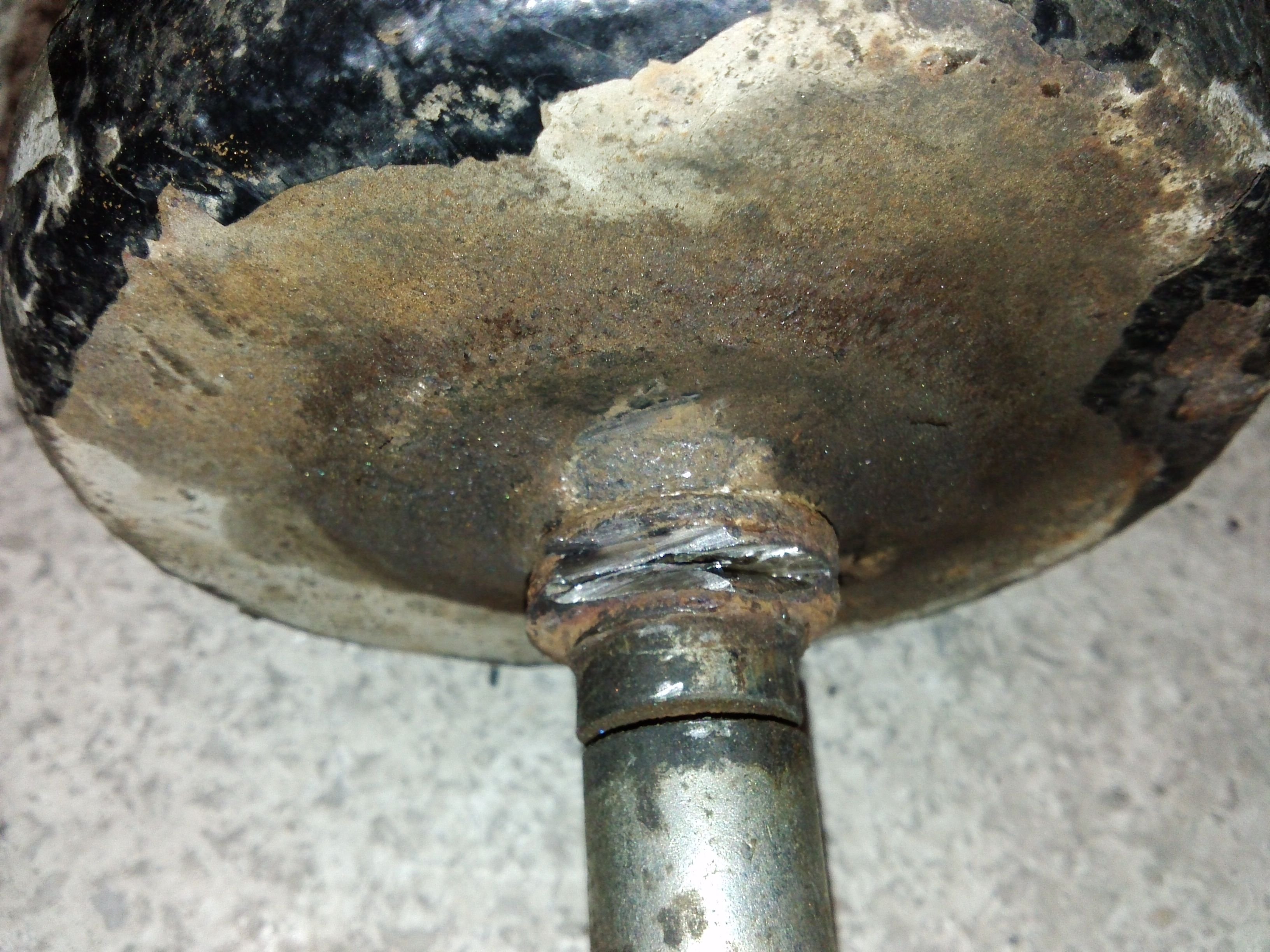

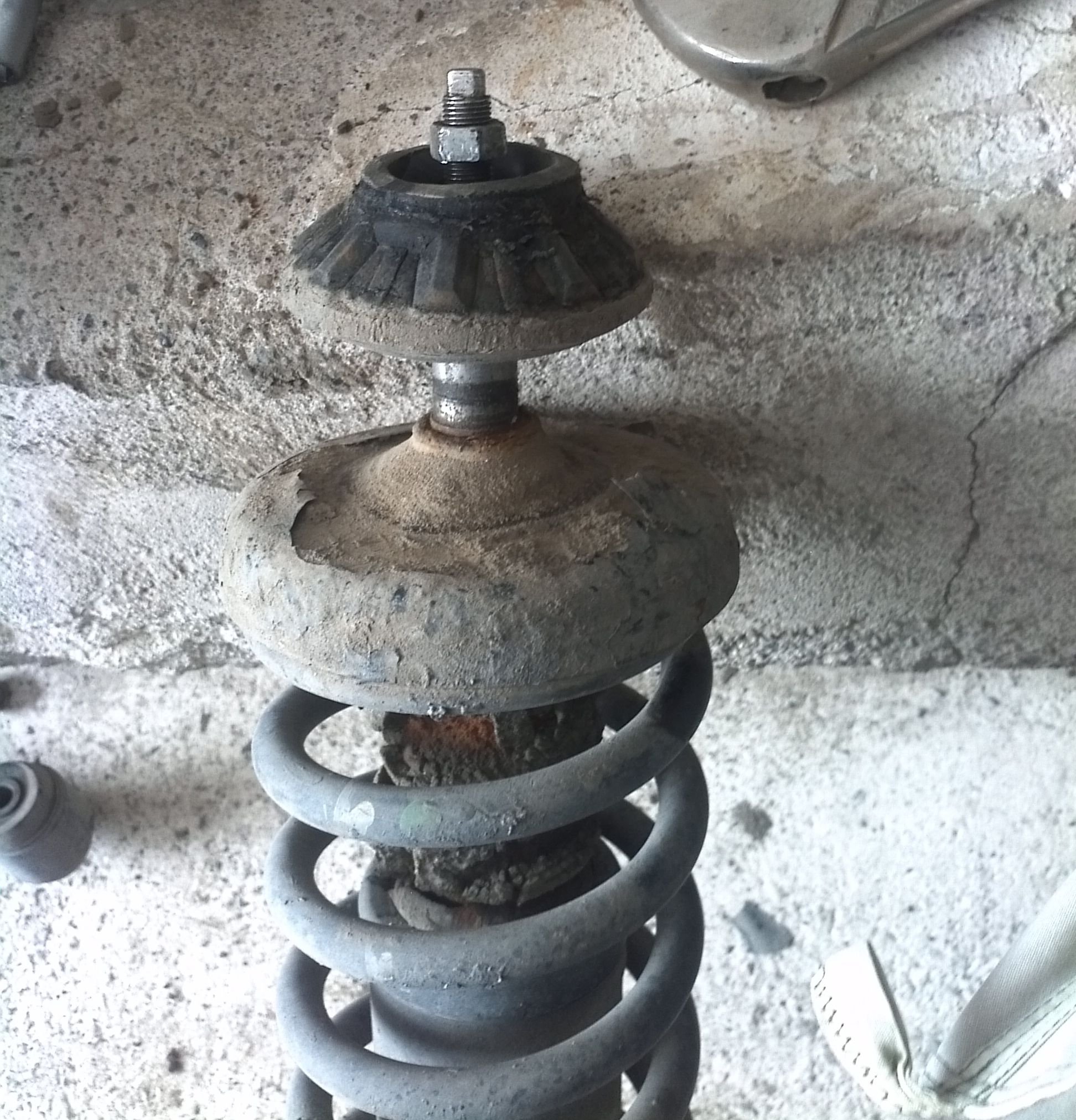

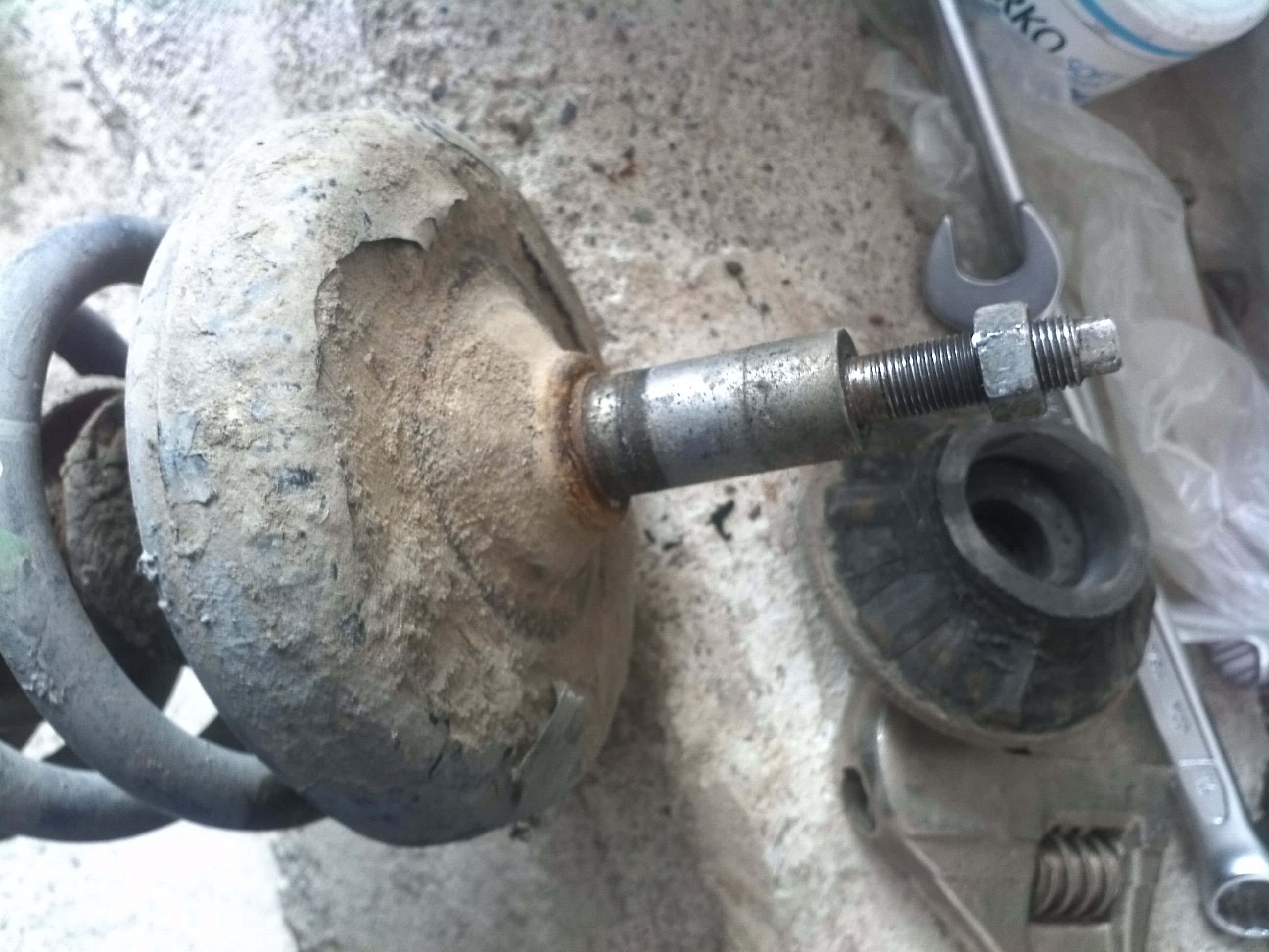

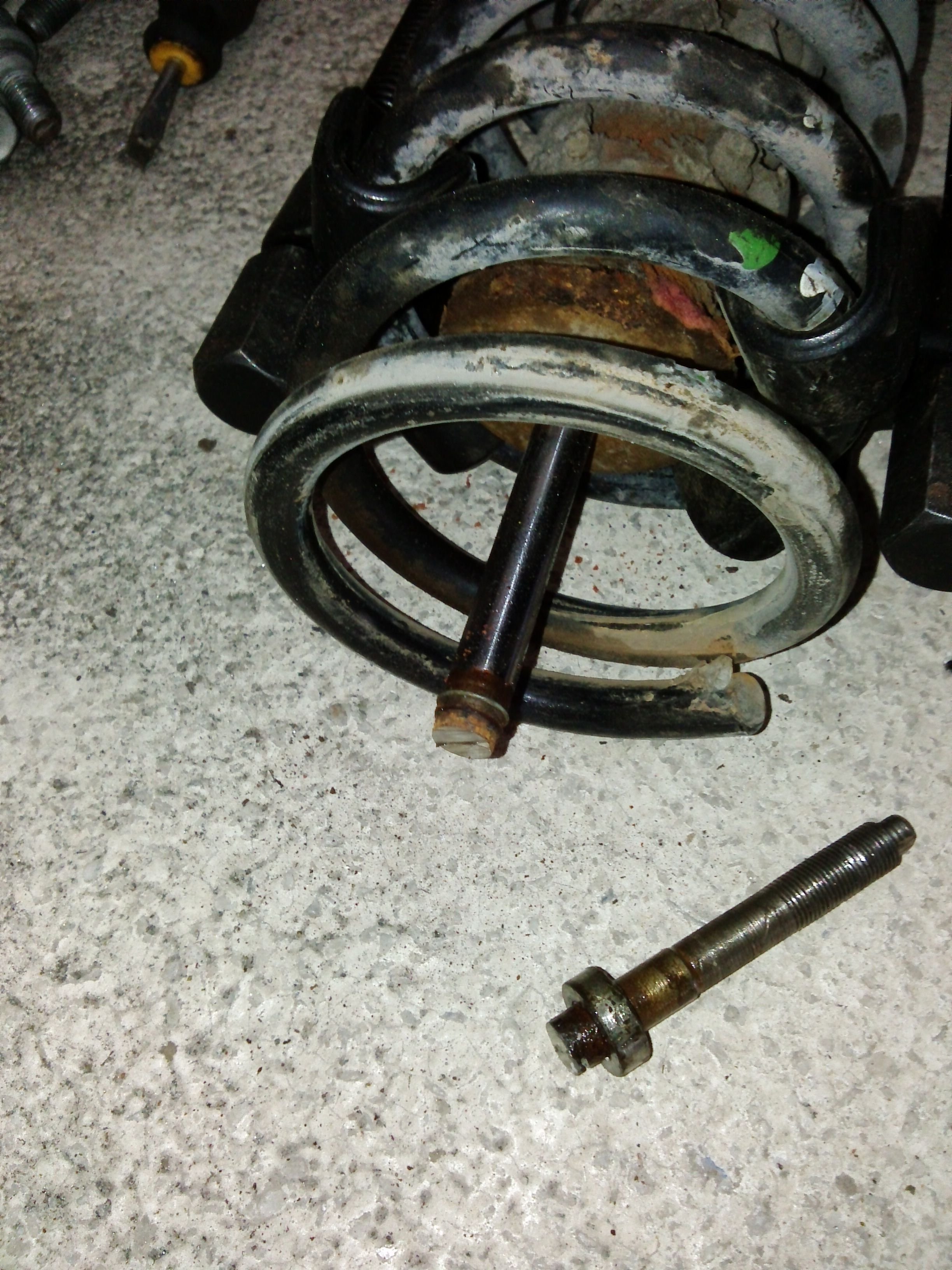

To clarify for future readers, you don't need a spring compressor tool for this job under normal circumstances. When installing new dampers, I didn't need compressors. Threaded end of the shaft is long enough to use its own nut to compress the spring. Here are some more explicit pictures to expose the nature of the concluded work. Just after pulling it out. I couldn't cut this without a spring compressor. Also, Bottom mounting nut (no:20) on one side has stripped. It also took the socket of the wrench along with it. I had to cut it too. No:11 was missing one one side. No:4 was missing on both sides. This is a tube shaped spacer to fit inside the rubber bushing. I had to find a metal pipe to cut pieces like that. Just a reminder for future readers; spring compressors are dangerous. There are horror stories everywhere on the net. Beware.

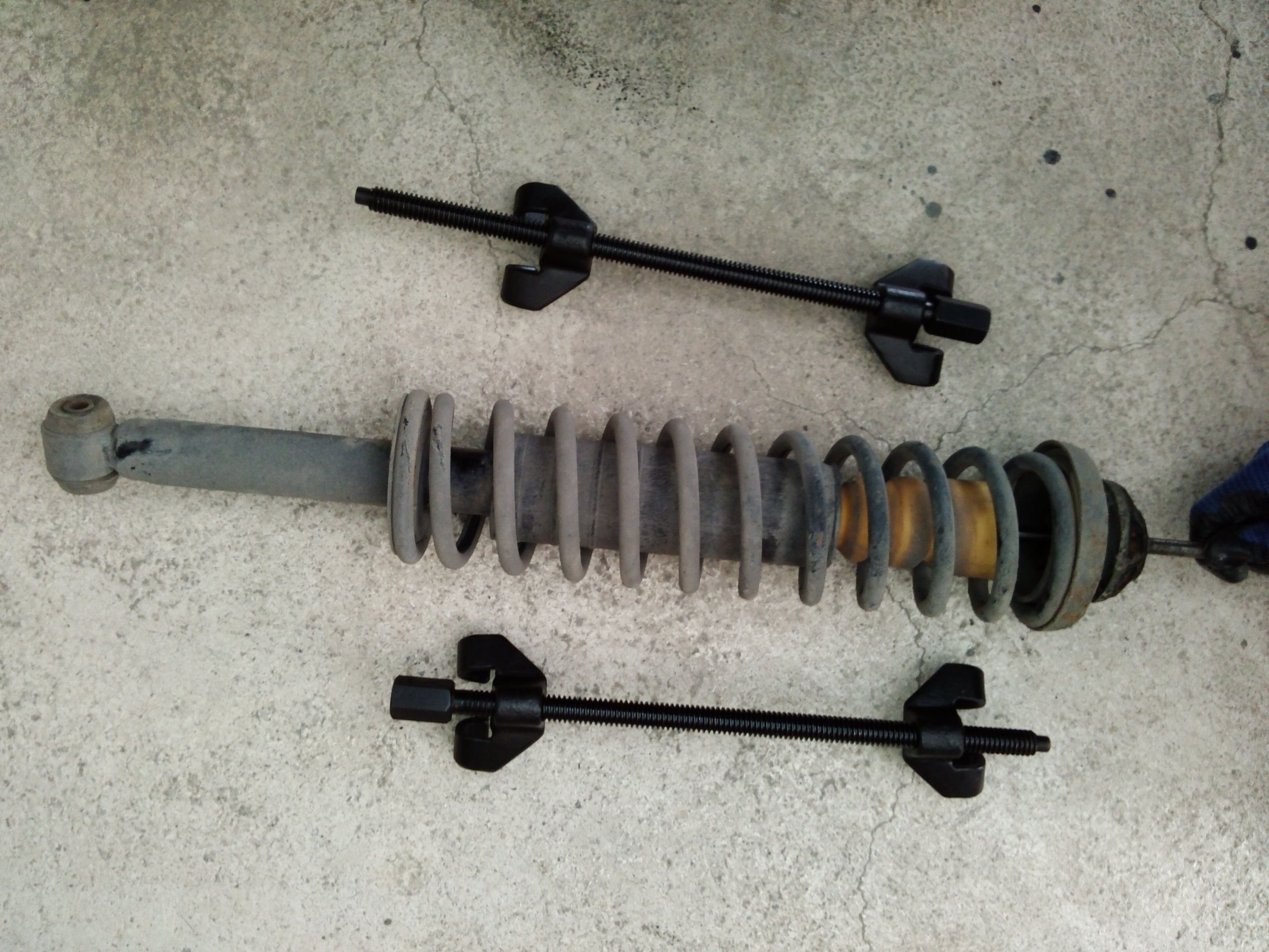

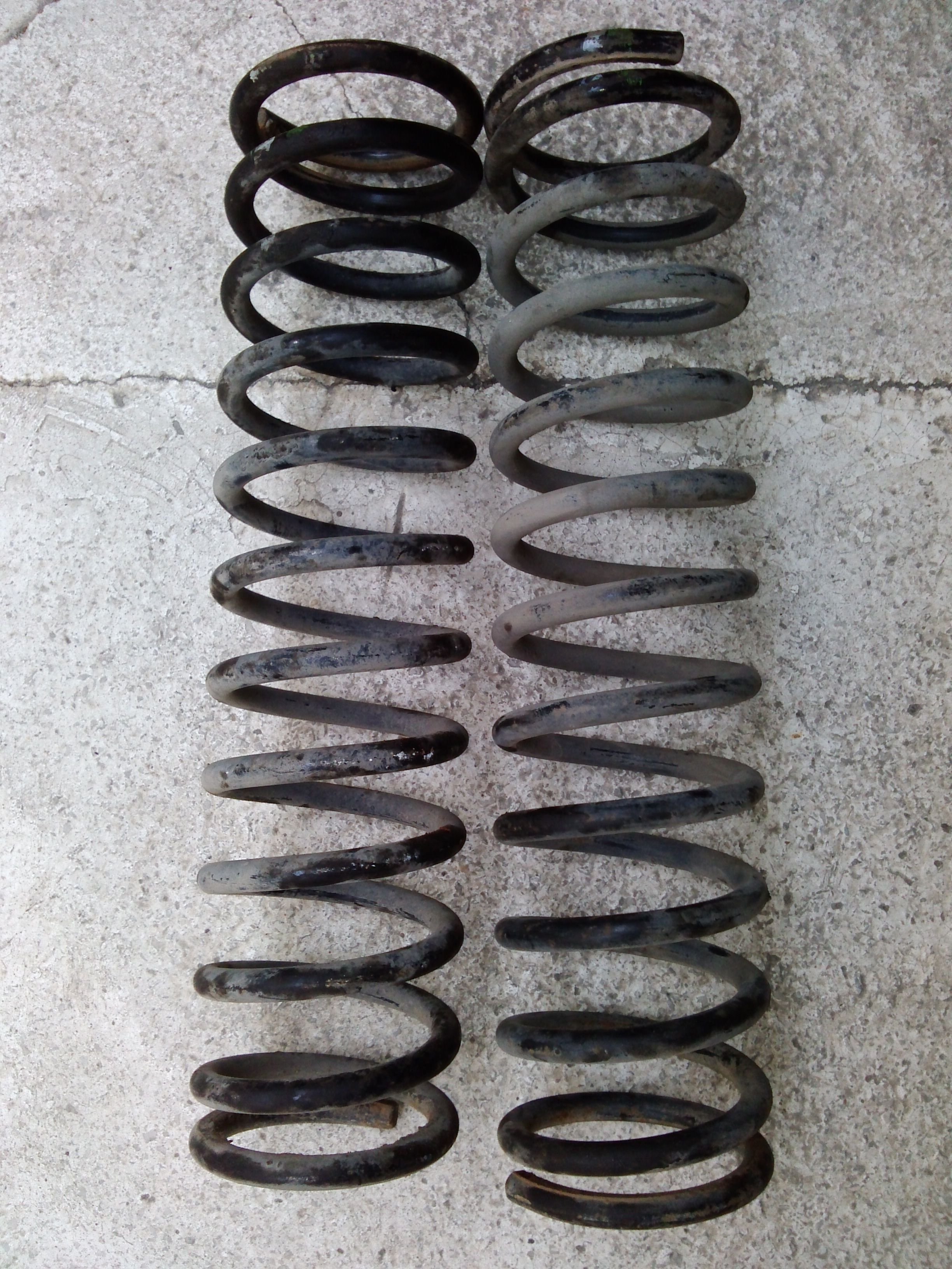

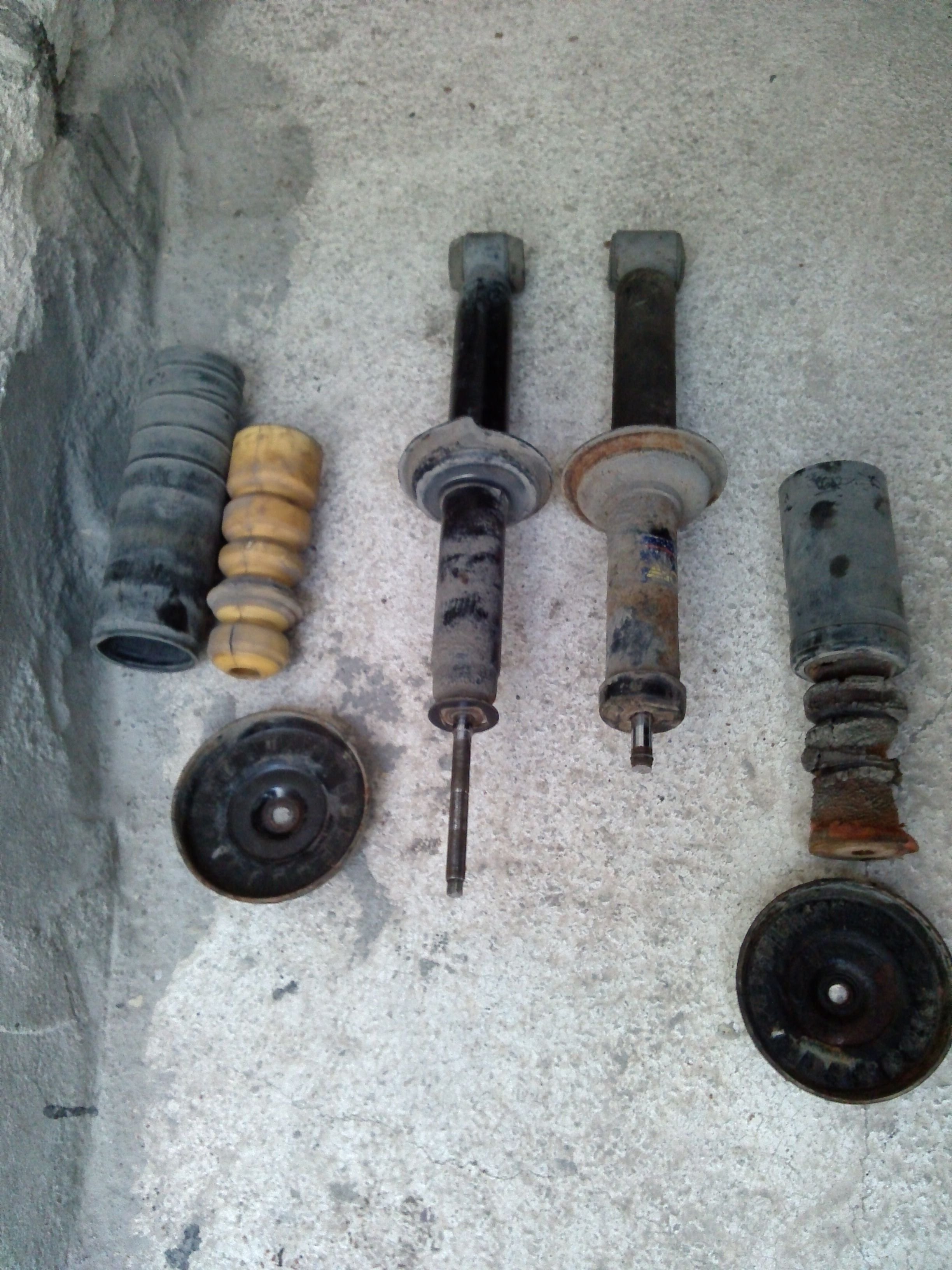

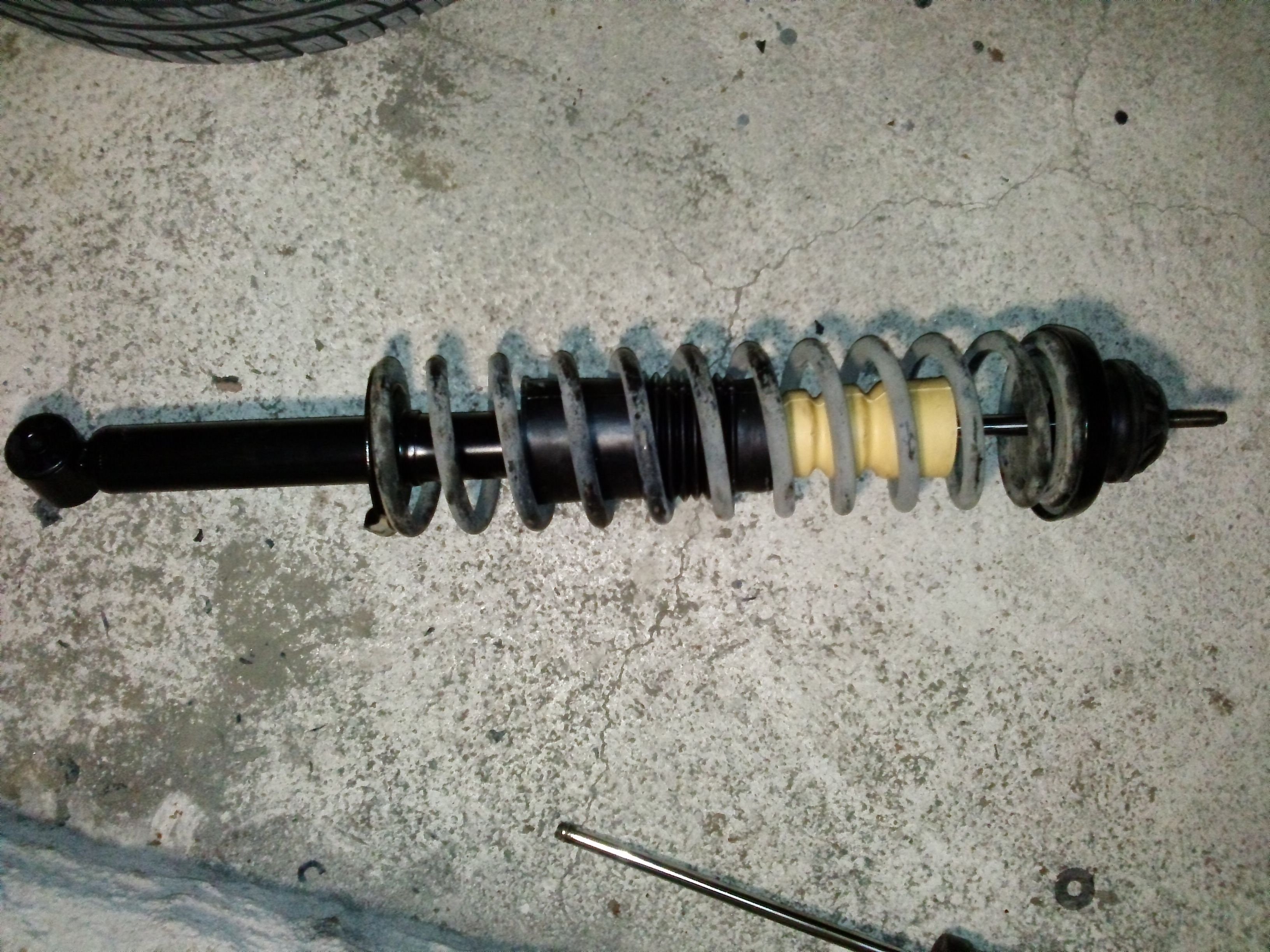

Thanks! Good find. That really saved the day. I decided to buy a spring compressor tool after seeing your post. Later, I've found out that, a spring compressor might not be needed BUT not everything goes smooth when working with old cars. Right? I removed both suspension assembly. On the other side they put washers here. They corroded so badly, I couldn't make them released. They were literally welded here with rust. I had to cut the damper's shaft to be able release the spring. If I hadn't bought it, the work would be interrupted at this point. Some of the parts after disassembly. Condition of the springs. Re-assembled.

Thanks for the quick reply. That means, I'll also need a spring compressor tool. Right?

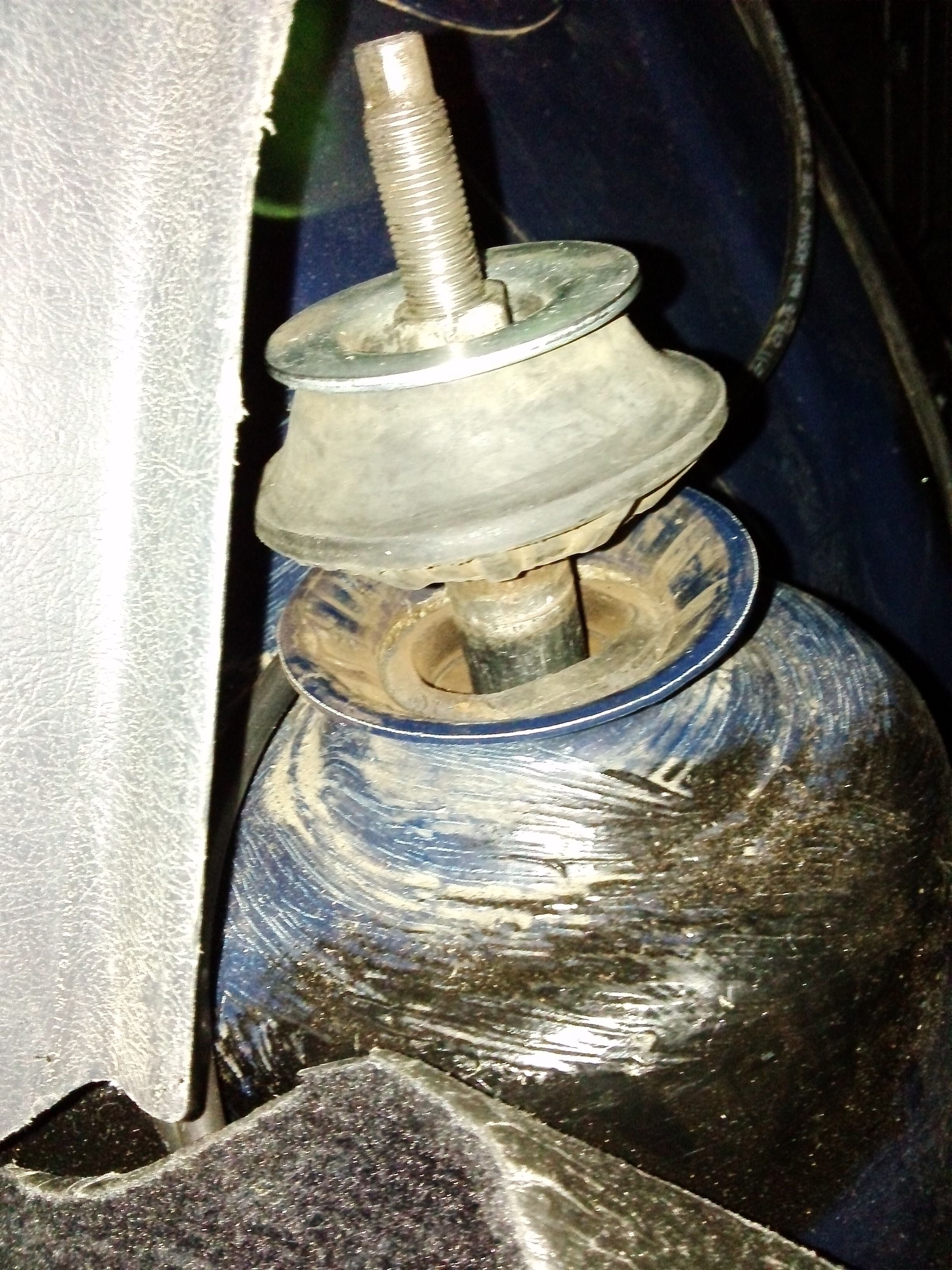

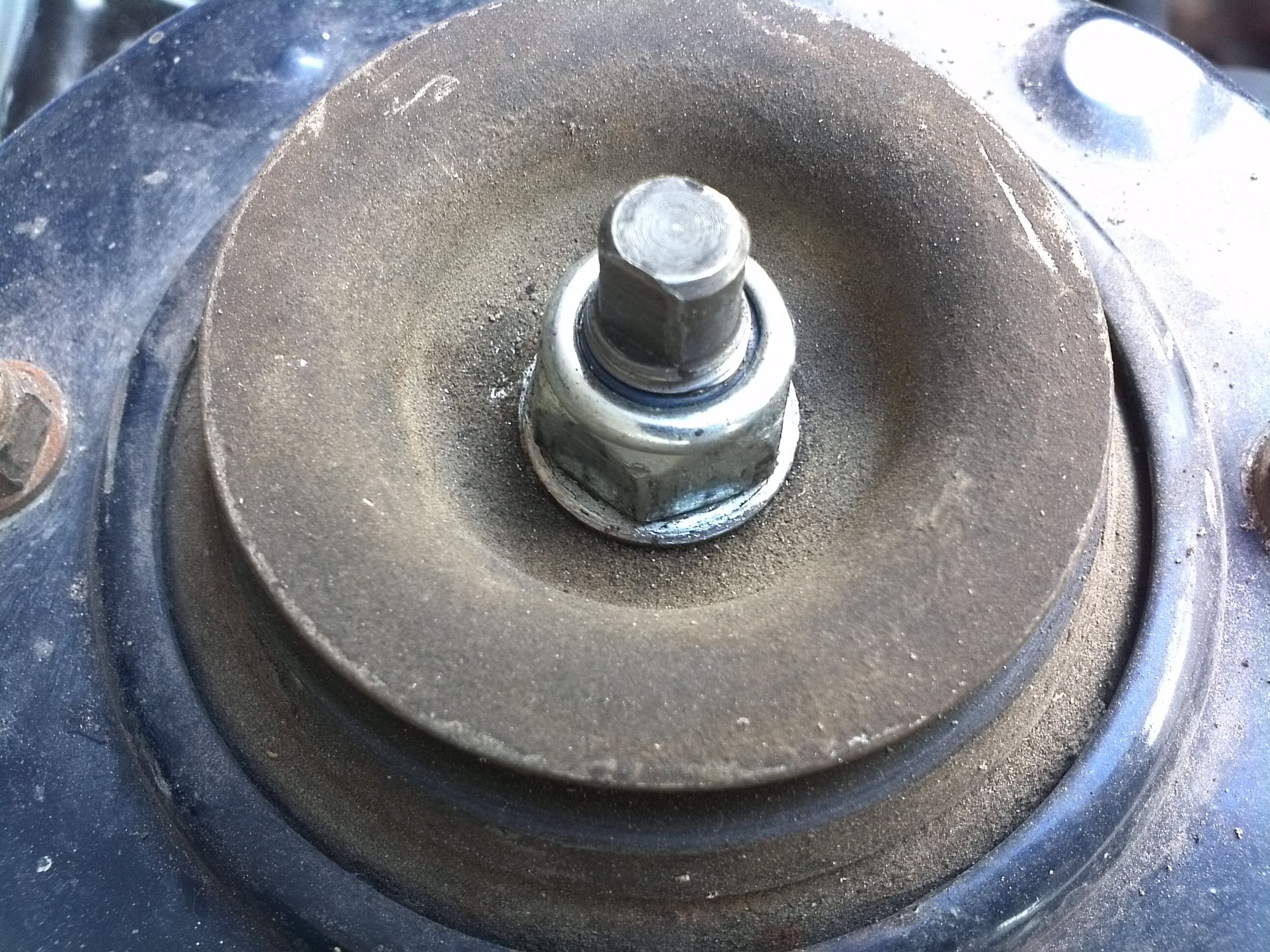

Could you tell me please, what happened here? - Rear right wheel is bouncing on bumps like a basketball, accompanied with a rattling noise. - When I press down the back of the car, the shock shaft pictured above is moving up and down freely. - I can easily rotate the shock shaft. The shock shaft seems to be completely displaced.

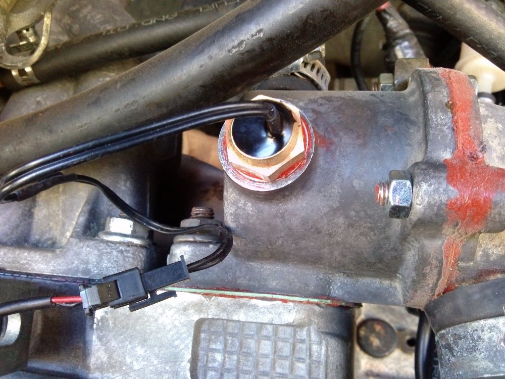

I've been thinking this for a while. Looks like, there was a warning LED for temp. on the dashboard of early Favorits. Using a dedicated LED like this as a trigger, one can easily add a buzzer too. That'd be a perfect warning system. New style dashboards (which I have) are missing this LED. Also, there isn't such a warning LED on Fellys too. Too bad. It's a stepback. Of course, with already what we have, one can tinker and add a buzzer to the temp. gauge circuit. Maybe using a small Mosfet, zener, and some resistors. But there is a more simple and straightforward solution without disturbing sensitive electronics. Do you still have this? (Asking because: Aftermarket temp gauges can easily be modded to have a warning buzzer or flashing light. One already have these functions can be found too.) Did you disable the temp display after this? If your answer is "yes" to all questions above, please look at this: Remember my recent topic? Asking about this plug? If you have this plug on Felicia block too, do you think what I'm thinking now? It's a coolant plug! According to 7zap data: https://skoda.7zap.com/en/cz/felicia/fel/2000-101/1/103-103000/#33 Its threads are M14x1.5 That's the same thread size what I've ordered from AX as a temp. sensor. (My replacement sensor for temp gauge mod above) In theory, you can screw this sensor above in the place of that coolant plug! You won't disturb your car's electronics and coolant hoses this way. What do you think about this now? Also, If I were you, I would make the 1.6 radiator conversion and add a double fan setup for it. Maybe something like this: Make the second fan to have its own circuit and fuse, also add a manual emergency switch hidden but close for you to easy access when needed. That's what I think as an ultimate cooling mod, worthy for your Trusty.
