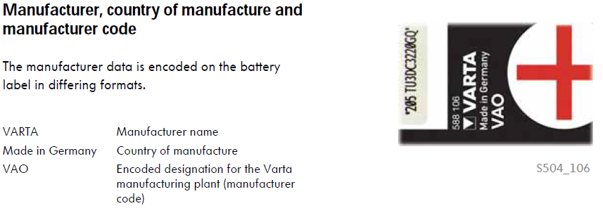

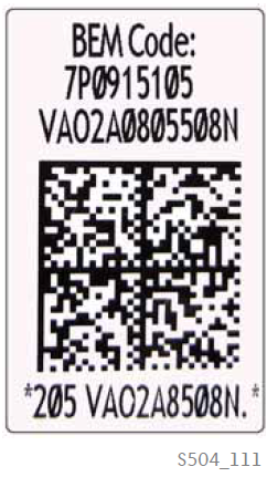

  24. That should be a fully charged battery at that point, and doesn't need charging. Could be wrong, but happy to be corrected. VAG don't help themselves, here in the same document... SSP504 Vehicle Batteries VAO VA0 Your extremely low SoC from leaving ignition on may have made things go crazy, you kicked the car up the ar5e making it think it had new battery, and it then started Alternator and cleared off the warning lamp. I agree 100%, only VAG would know this, but getting a definitive answer is difficult (look above for VAO / VA0 in same document) This is the only part I disagree with your statement of it needing to be in Binary format (serial number) Apart from that everything is all good, and should be helpful to others.
