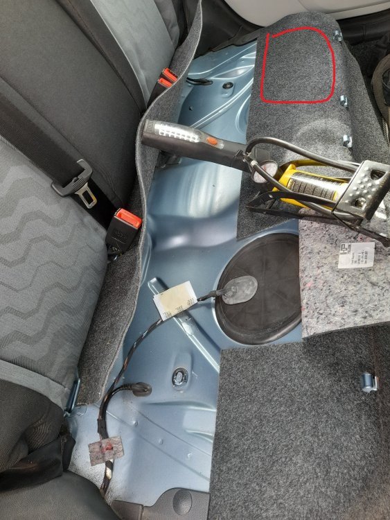

Try another fuel pump relay if the wire paths seem OK. Just because a relay clicks, doesn't mean it definitely works. The contacts can be badly burnt so that it doesn't carry enough current. Judging by one of your photos above, it's the one with 53 written on the top of it. The lack of fuel pump action when opening door may be an unrelated wiring fault, meaning that the vehicle voltage control unit (which senses door opening and triggers the fuel feed relay) may not be sensing that the door has been opened.
2008 Mk2 1.2 HTP - Reviving help
You will just have to work with Jocko's diagram, checking continuity of wires between the various points, especially fuse 30 terminal to fuel pump terminal (the blue/white wire path). Take out the fuse, use meter on resistance range to measure from pin of blue/white wire at pump connector, to each side of fuse. One side of the fuse position should show zero Ohms to there. You may need an assistant and possibly an extended meter wire. The brown/violet wire at the fuel pump connector should go to chassis/earth.
