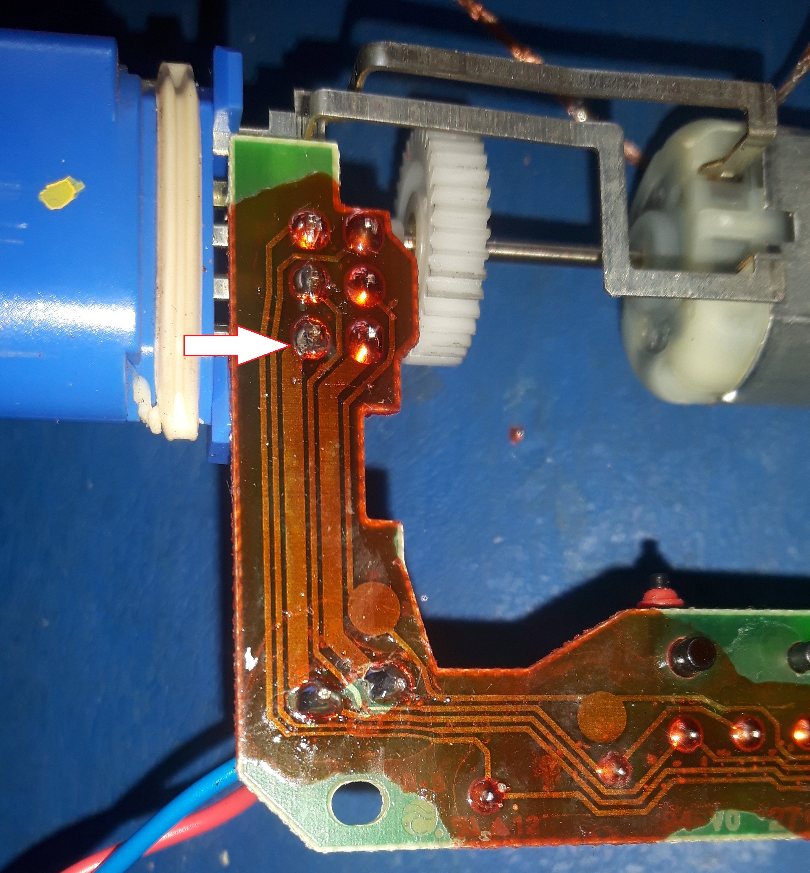

Yes, the engine ECU and its connectors are in the engine bay, as I said in the first sentence of what you just quoted! Don't do anything there, it's OK. Go back to the wiring diagram supplied by Jocko, and look at the bottom right side of it. It shows the fuel gauge sensor at the fuel pump, the wires from it, and their destinations at the dash panel insert (instrument cluster, in front of steering wheel). These connections sometimes go bad between the male part of the connector and the circuit board. The fuel gauge ones are pins 15 and 32, just about accessible without taking all the needles off. I've numbered the connections in this image. If you have a soldering iron you could try carefully re-melting joints No.15 and No.32. Ignore the yellow arrow on the picture, that was to show the immobiliser connections. I am not sure what voltage is to be expected on these. I don't think that the gauge not showing fuel level will affect the relay or ECU function.
