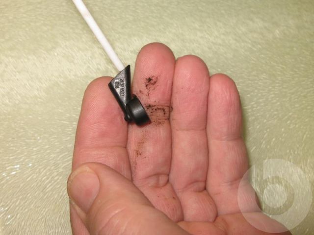

Thanks everyone for all the tips! I removed mine this morning and gave it a good long soak in piping hot water, poked it with a pin and blasted some compressed air though it from a can of aerosol duster (see gallery pic). Worked a treat !! All wishy-washy again at the back now :D :D

Just cleaned my jet. Easy as. Took jet off, ran motor, big spurt of brown gunk came out then nice clean fluid. Took a while to de-gunk jet in kitchen sink but all good now.
