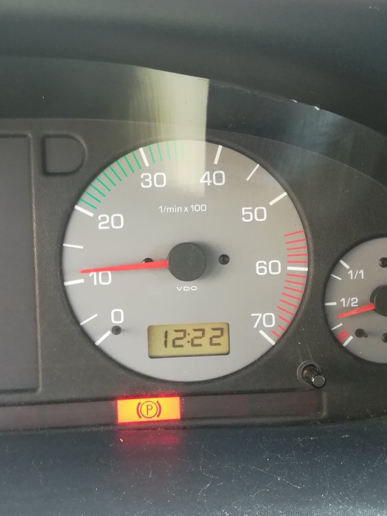

So, this ''compressor style" for you it's the normal Cold Start for a Felicia 1300, me except that days that i had this stupid-monkey 15W-50 i haven't seen it for:
a) The first years that my Felicia was Stock
b) ALL the days that my Felicia is modified
which means my car for 23 years has a problematic Cold Start from Day 1.
According to video that i posted from my car
https://i.imgur.com/Yy9NZgh.mp4
and other Felicia owners
https://www.briskoda.net/forums/topic/129452-felicia-combi-13-what-oil/?do=findComment&comment=5812797
have the same Cold Starts as me (Not as yours) although in much lower temperatures.
@HappySkoda had the same style Cold Start as me
https://www.briskoda.net/forums/topic/499328-how-much-time-do-you-warm-up-your-felicia/?do=findComment&comment=5610186
https://www.briskoda.net/forums/uploads/monthly_2021_12/IMG_20211212_122032.thumb.jpg.db9ec30da8ad0a3932608ef93ff6da62.jpg
and not as yours.

Uhm no but rpm needs to be veryfied using VCDS my tacho slightly undereads (around 250rpm) so what seems like 800rpm might infact be 1050rpm so I am getting the same rpm BUT WITH 15W50 as I should
24 minutes ago, D.FYLAKTOS said:
Also you crank more times and you take longer to build oil pressure... keep that in mind
I crank 5 or 6 times and light goes of as I pass 1000 rpm you crank 7 or 8 times and your oil light goes off at the same rpm. so if you want to split hairs you had more time turning the engine over (and also faster than me) and still you built oil pressure at the same rpms after you started.
