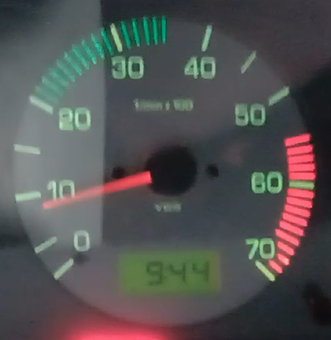

Here is the engine sound from that cursed 15W-50 engine oil.
See the sound graph, after the first crank the idle went to 900 rpm and stayed there, what i had all these years (needle at 1100 rpm and after 3:40 minutes to proper idle level) never-ever showed up with that ridiculous 15W-50 Total.
One of the worst decision of my life was to put that 15W-50 in my car, a terrible mistake and i regret it so much.
My Trusty was working like an old tractor and ripped my heart that i pushed more than 4000 with that stupid-crappy oil.
All i want is to behead the bottle cap, hang the bottle, stab and shoot it, burn the remains and throw the ashes to the pit latrine. 🤬
Absolutely normal, please take an unbiased look

Take a look at the needle, one click above 1000 rpm.
I think about it all night, absolutely impossible to torture my car in Highway and in Mountain Roads in high rpm with that stupid 15W.
Case Closed, never-ever again no mattter if they pay me for it, Eneos Premium 10W-40 Synthetic now is my new oil, with this i will make the trip (with my recently refurbished Koni suspension).
