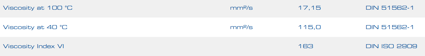

RAVENOL HVE High Viscosity Ester Oil SAE 10W-50
  • Viscosity at 100 °C - 17.15 mm²/s (DIN 51562-1)
  • Viscosity at 40 °C - 115.0 mm²/s (DIN 51562-1)
At least the Viscosity Index (VI) is shown as DIN ISO and not just DIN. As I put before I would not give too much weight (regard) to VI numbers, the other information is shown already.
