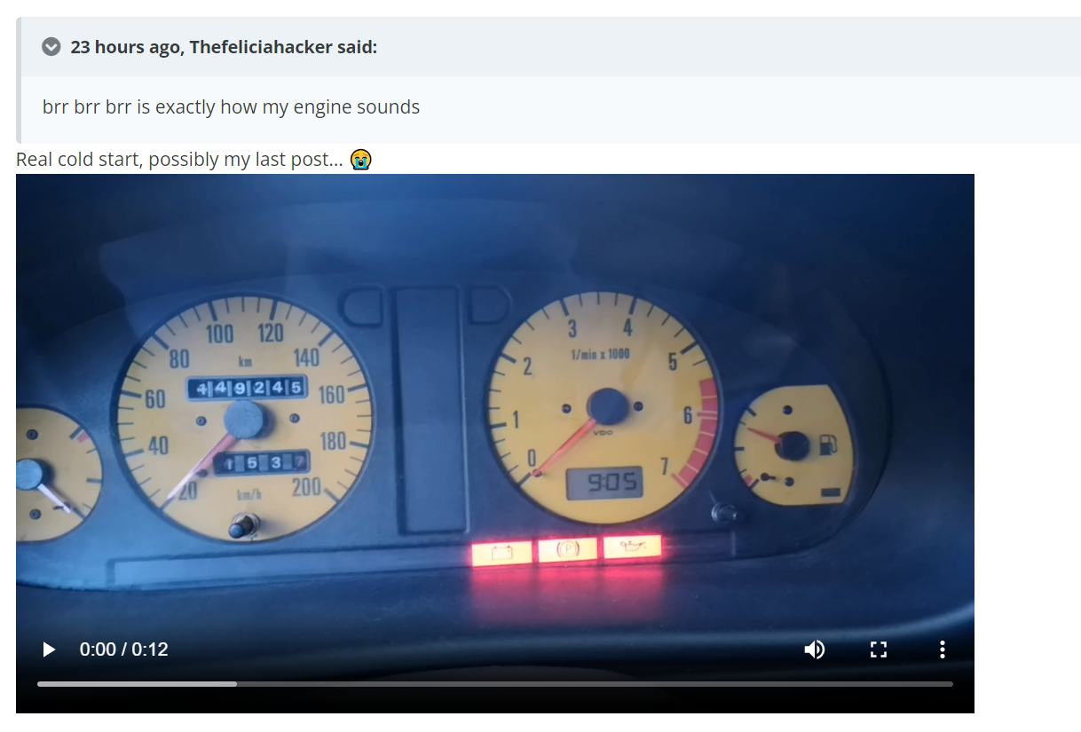

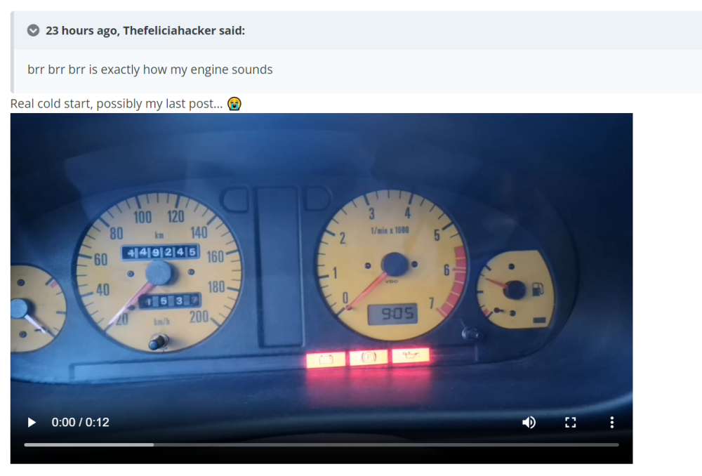

20 hours ago, Thefeliciahacker said:
brr brr brr is exactly how my engine sounds
Real cold start, possibly my last post... 😭
No video.
As for the ''rough'' sound, for 15+ years after turning the key the needle was going to 1100rpm and after a 3:40-45 minutes was making a small dive, few seconds idle trembling and then at the right spot.
Now with the 15W-50 everything is not good, i haven't see something positive except the sound of the engine when reaches the idle, it's a bit ''bass'' and that's it.
