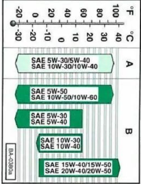

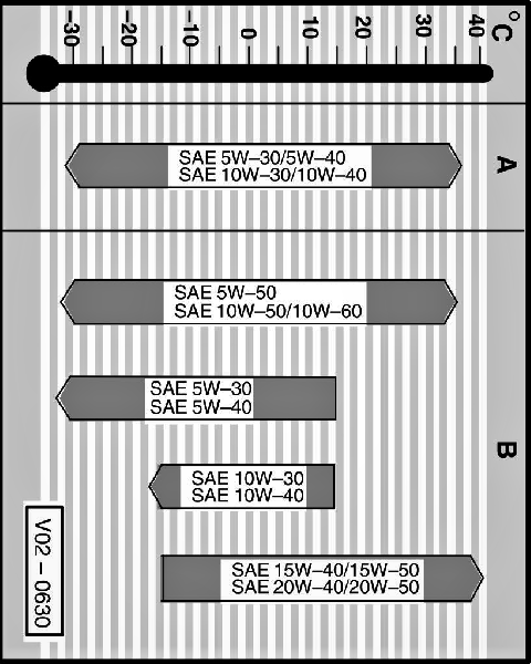

10 hours ago, Thefeliciahacker said:
So it seems that many more oil can be run but 10w40 is a no go for more than 20c environmental temp
Actually you are reading the diagram wrong. Yet, you have the excuse of trying to read a difficult/confusing diagram. Not sure who was the genius who drawn that mess, but you can't draw two or multiple viscosity engine oils into one single temperature interval.
When I say "temperature interval" I refer to the minimum and maximum temperature for a given oil where its viscosity allows easy engine starts and decent lubrication.
A better understanding of optimum temperature intervals function of the SAE number is the one below.
Also bear in mind a "thin" (for want of a better word/description) say 50 or 60 could drop to the 40 or 50 band with use.
Thank gawd for that chart, I don't need to try to restrict my wife's use of the car, well as long as it's below say a chart 37.  😀
Please correct me on the proper way to decipher information of that skoda diagram
The Skoda chart with green colour in the owners manual is the same with the grey colour (the 'latest" from German), does not offers the same informations like this:

What's the difference between those 2 charts? Green (Owners' manual) and Grey (Workshop manual, so called the ''latest").
There is no ''update''.
On the other hand, Skoda at 1998 told us about Halogen bulbs, didn't knew that some years after we could install HID and LED bulbs with much better performance in the same front light (which was designed for Halogen bulbs).

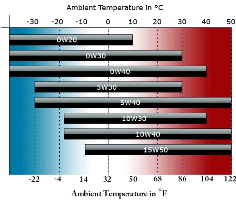

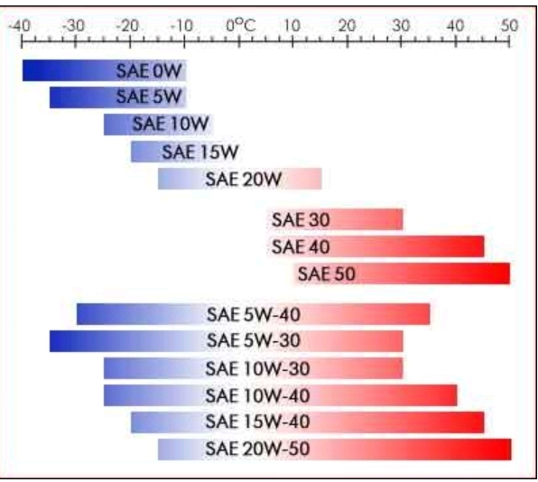

''Chart-o-mania'' or ''Give Chart to the people''.
I have lost the account from oil viscosity charts, anyone publises anything he wants about engine oils.
Take a look 2 examples, look the 5W-40.
At last "the penny drops".  With whatever chart, or other information, you have to look at the parameters, scales, testing system/specifications and ranges and allowances and the source.  A better product may be able to go further than a lesser product and for longer and less wear, meeting more than the minimum standard.  Like the UK MoT, it's a minimum statutory standard that must be meet once a year, at one point in time, much of it to one trained person's opinion, a pass does not mean the car is good in other ways and only that it meet the points I put. before and not necessarily better than the minimum standard required.
Now it may be the minimum or a bit above minimum is adequate for your wants and needs and those of the majority or vast majority of your vehicle model owners or you can decided differently if you want/need, it's up to you and you know you have lots of choice with oils and now so much information that you may feel you no longer know, as we say over here, "your arse from your elbow" but I am sure, as The Beatles almost sang, you can work it out.  You will come to your own conclusion.
"Enough already" with the charts, they have served their various purposes.  😁
