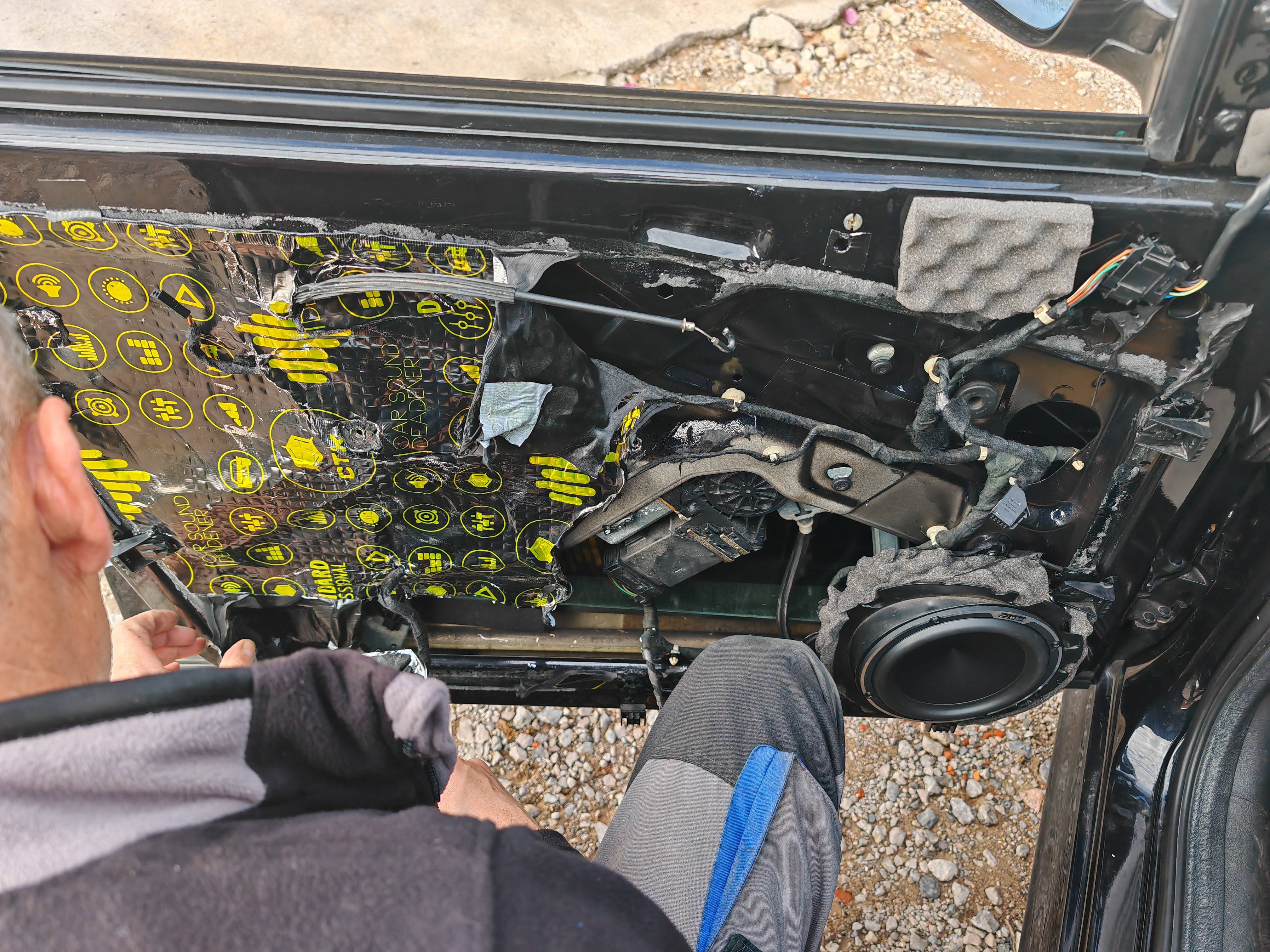

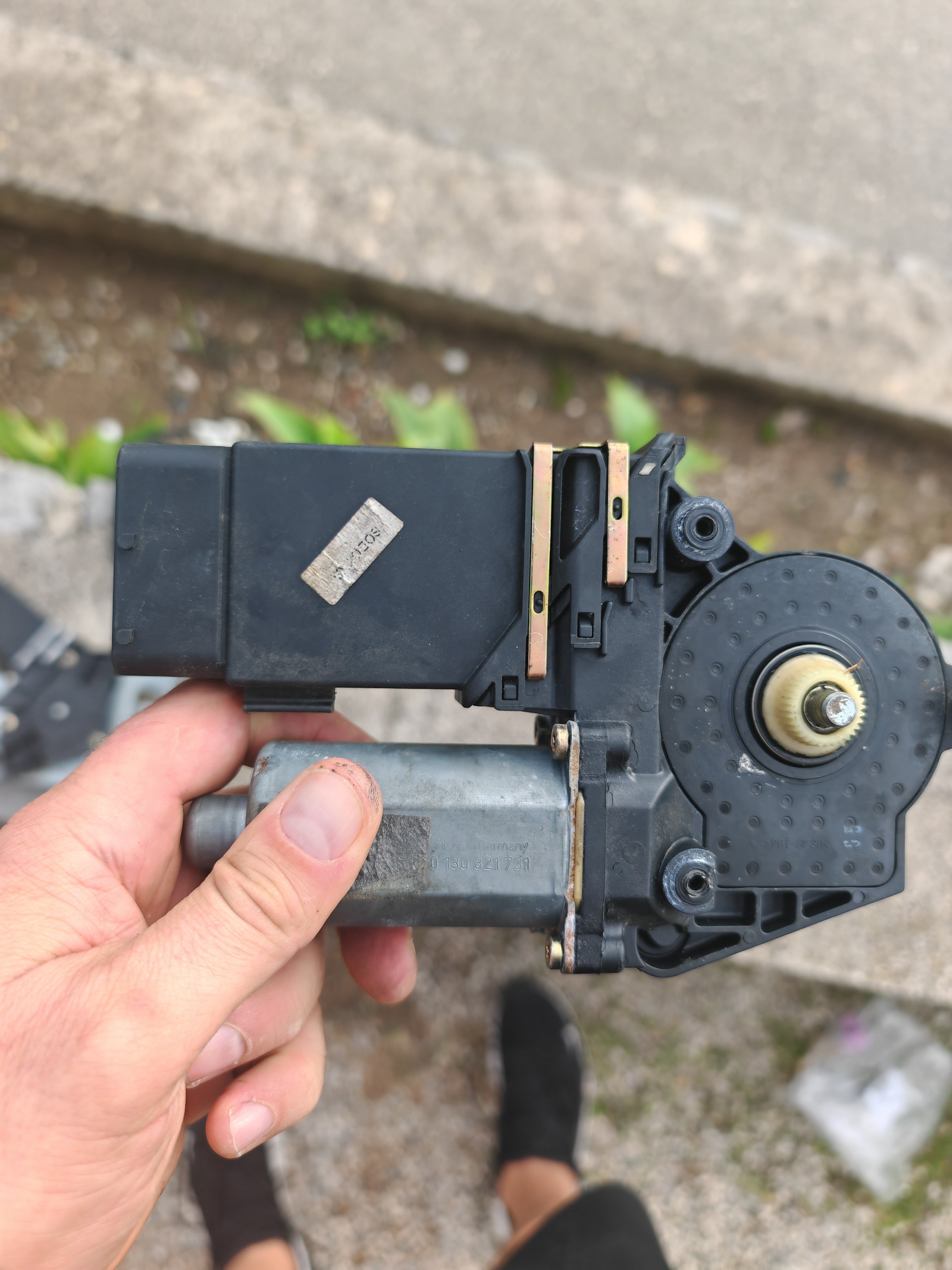

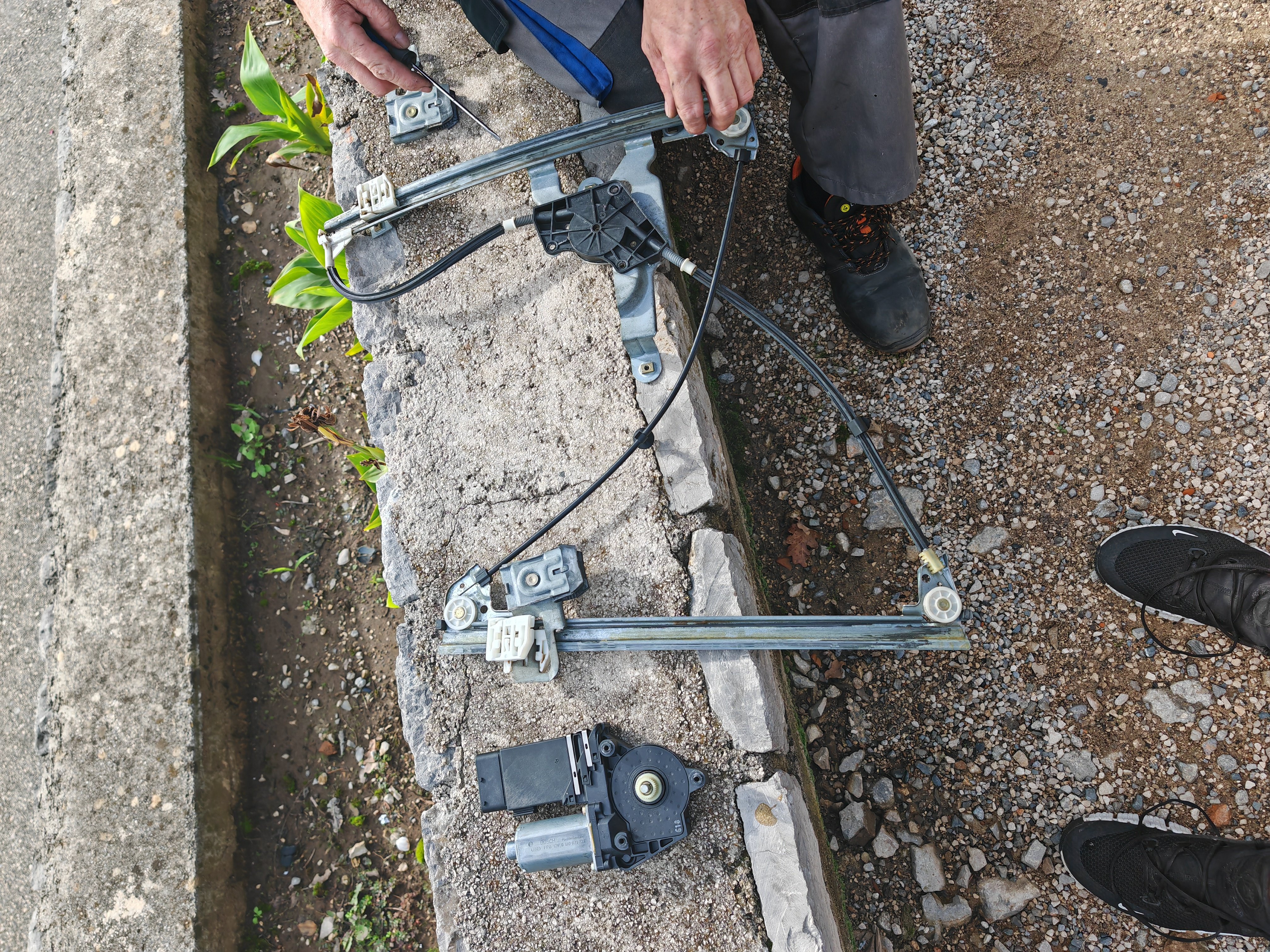

In the mean time my remote key unlocks all Doors but not the driver ones and can't lock any of them and Windows started uncontrolably going down and up. I changed key battery-no effect. Is it engine lock  or that Windows controler in door handle. It can unlock doors,except driver one but can't lock them at all and that red light on door is constantly on. Any help??? I Searched ETKA and there is green and black engine-must be phisycally checked-what means destroying all sound proofing of the door just to see which one I have, and I wonted to purchase it immediatelly so I can repair sound proofing instantly after engine replacement.
Sounds like window motor has corroded pins, or breaks in wires between the door and body, usually affects electric mirror operation also(only one mirror moves from switch)
Exactly, passenger Windows is mowing and driver one not. I Will buy New engine for insurance when dissmantling all that sound proofing to complete Job in one session.
Tnx for advice
Tnx for advice
check the loom between door and body for splits in the wiring , if all ok then you need a new lock mechanism
Ok,Will do so
  • 5 weeks later...

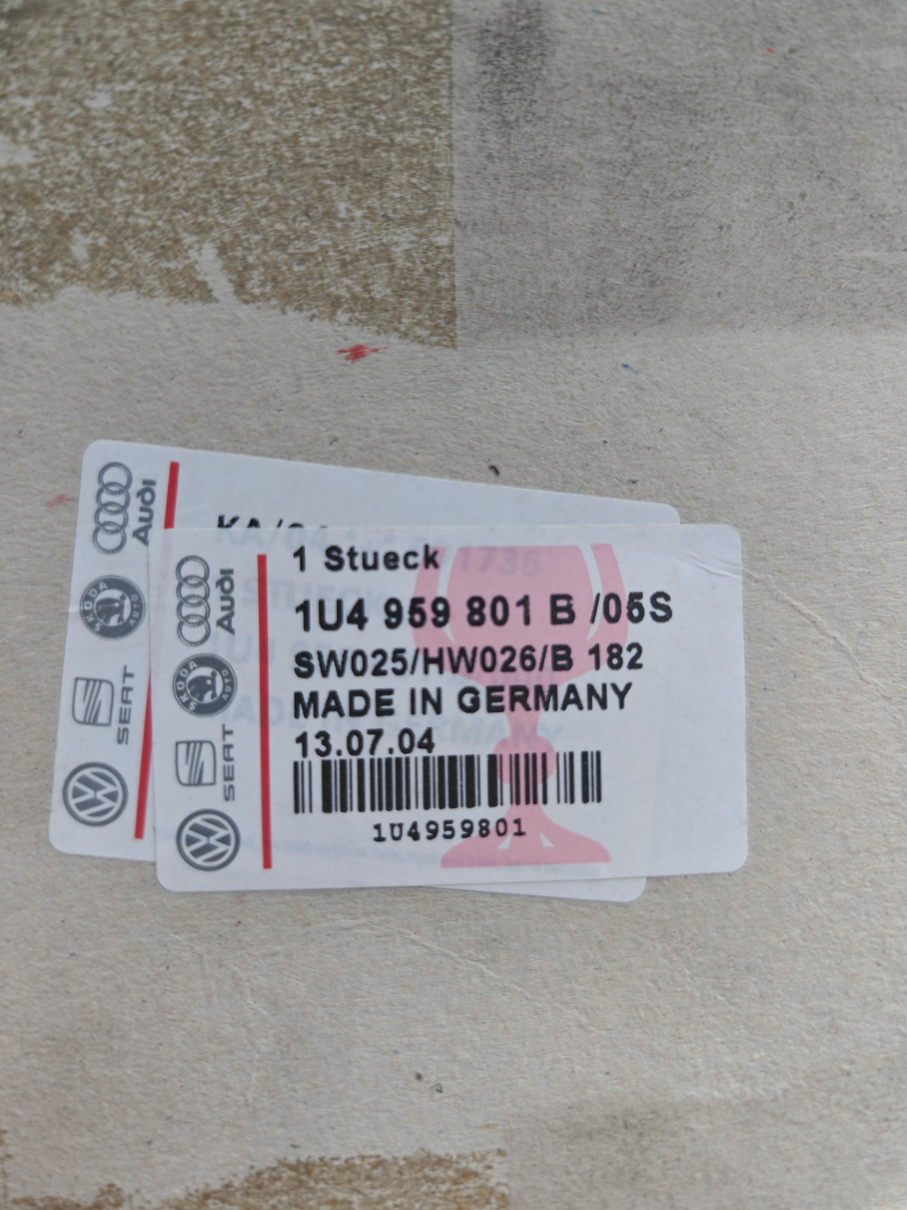

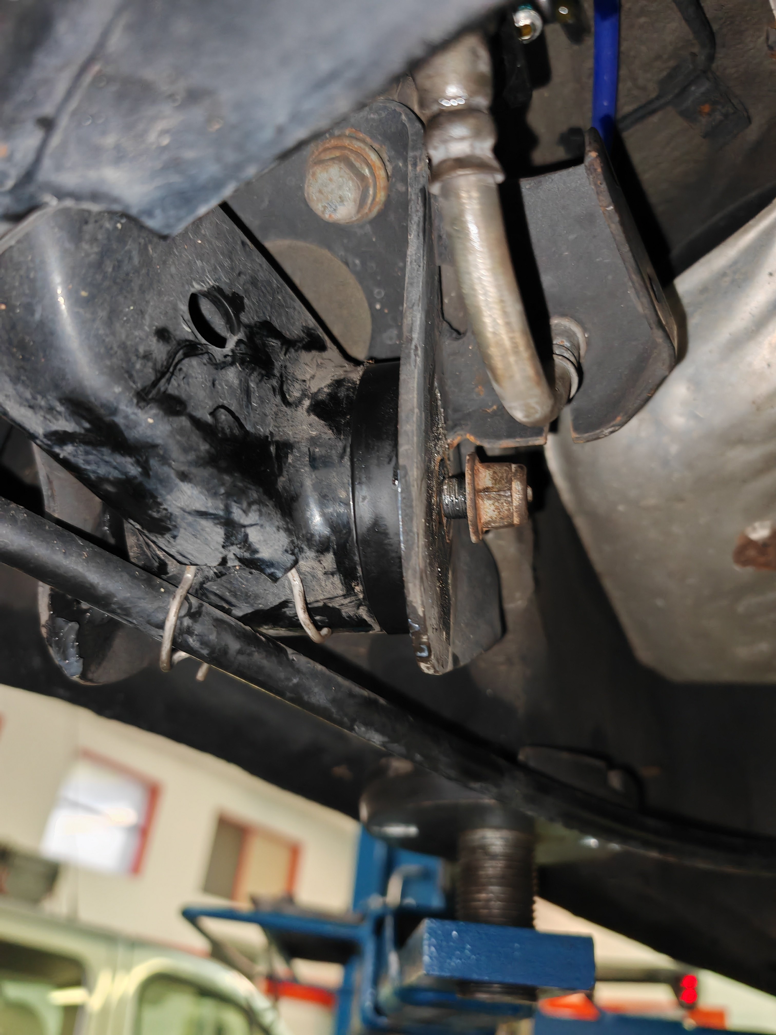

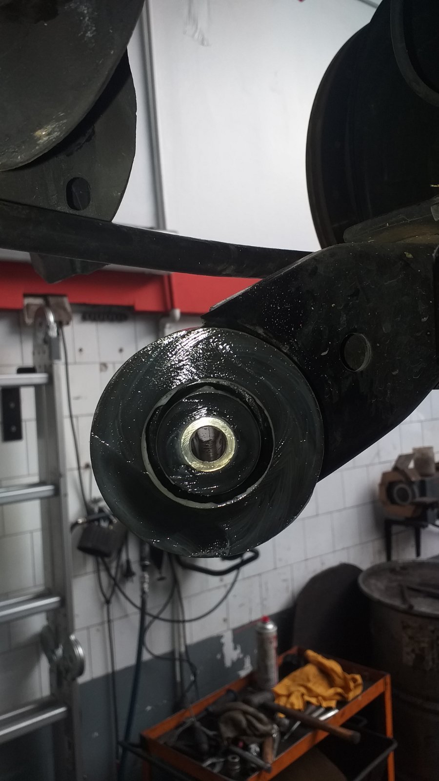

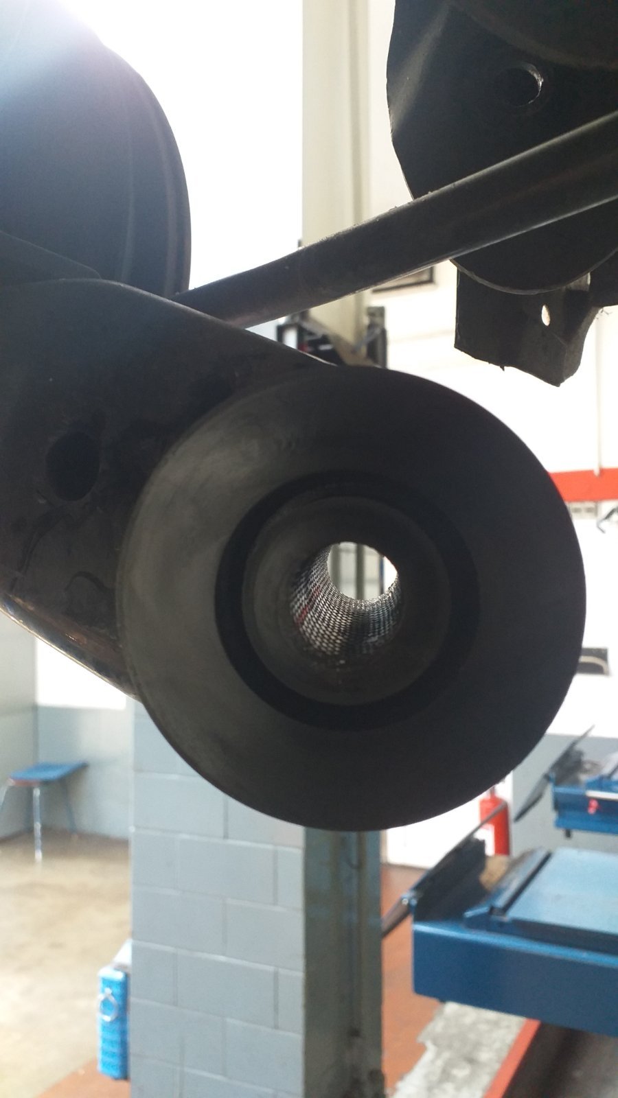

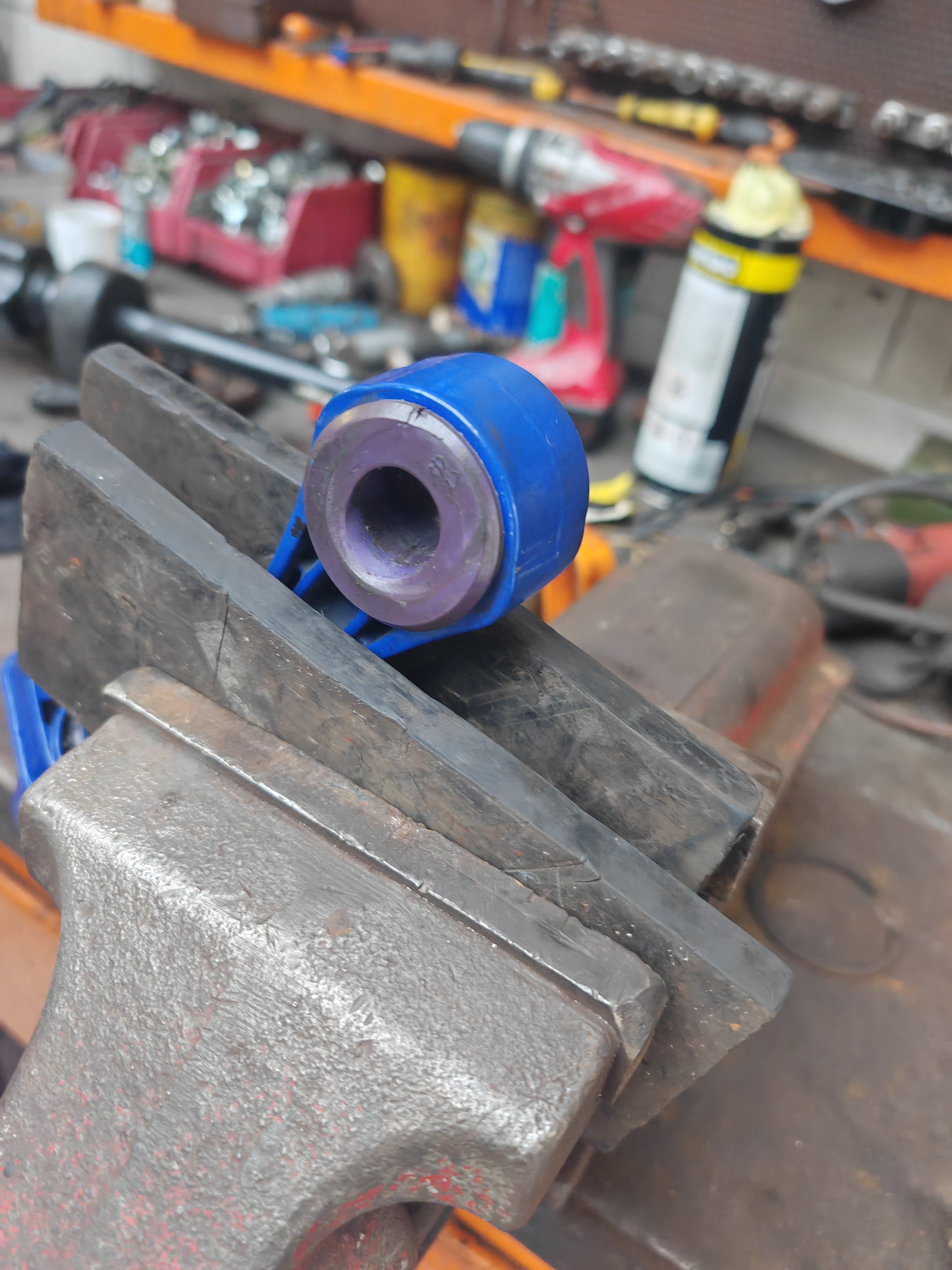

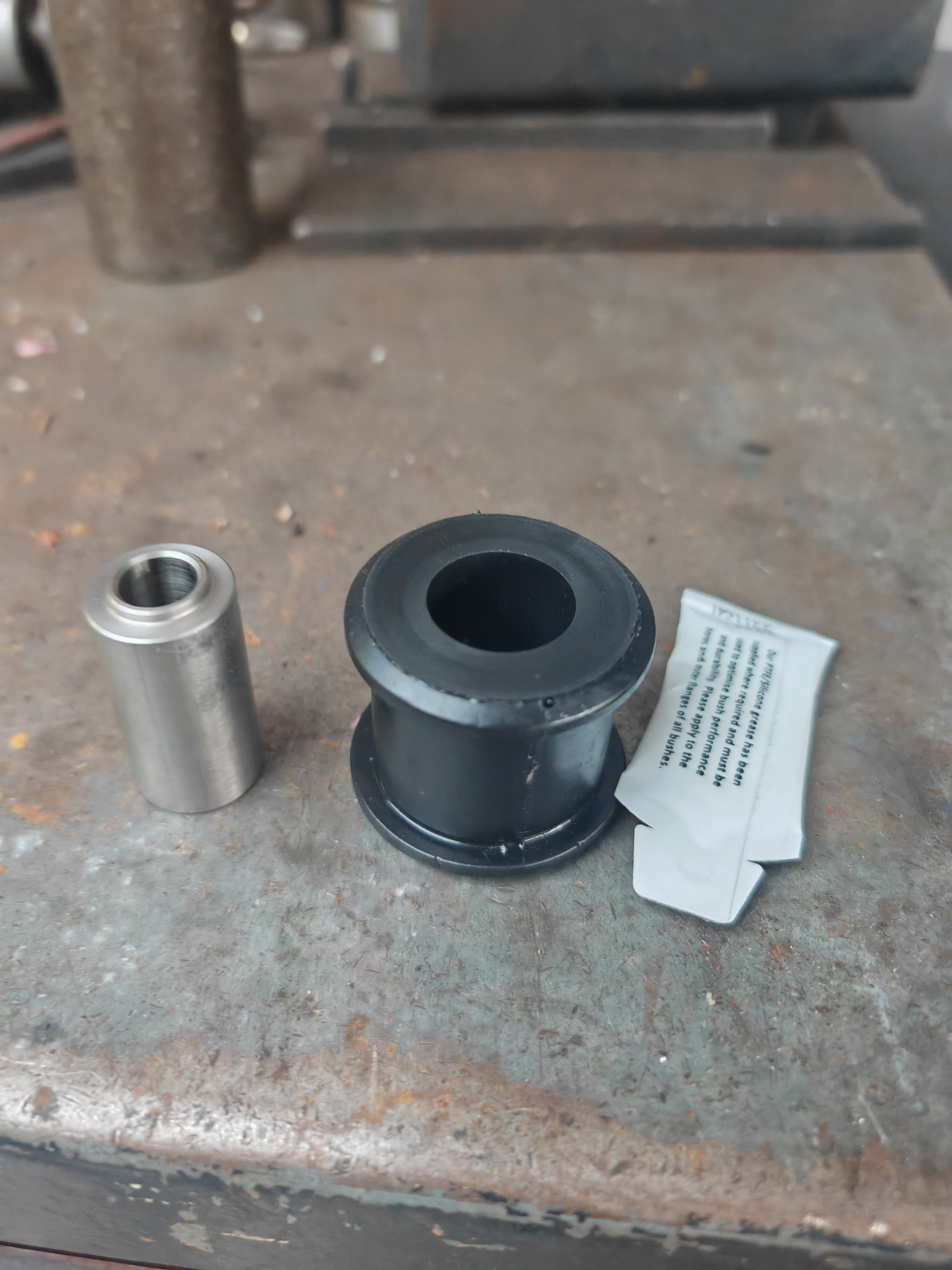

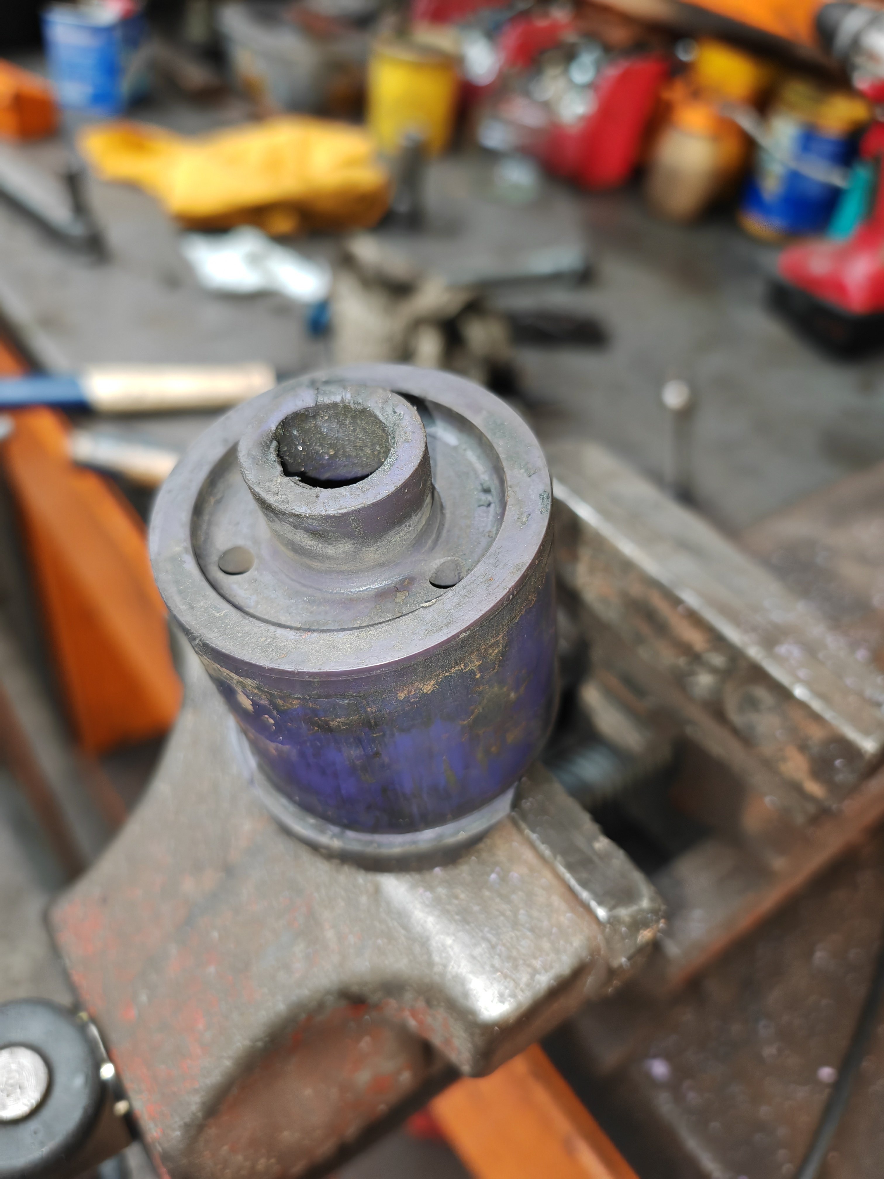

Finally replaced Windows control module in drivers door-central locking, side mirrors and all 4 Windows are working. Replaced front Dog bone bushing for Powerflex black racing series one  Now both are black. Waiting to replace rear Beam old Powerflex for New ones also Powerflex black racing series. Time for New Yokohamas Advsn Neova 08RS
aaaah the old control unit i taped it up after installing a replacement and the used a spray of ignition sealer to add to the protection

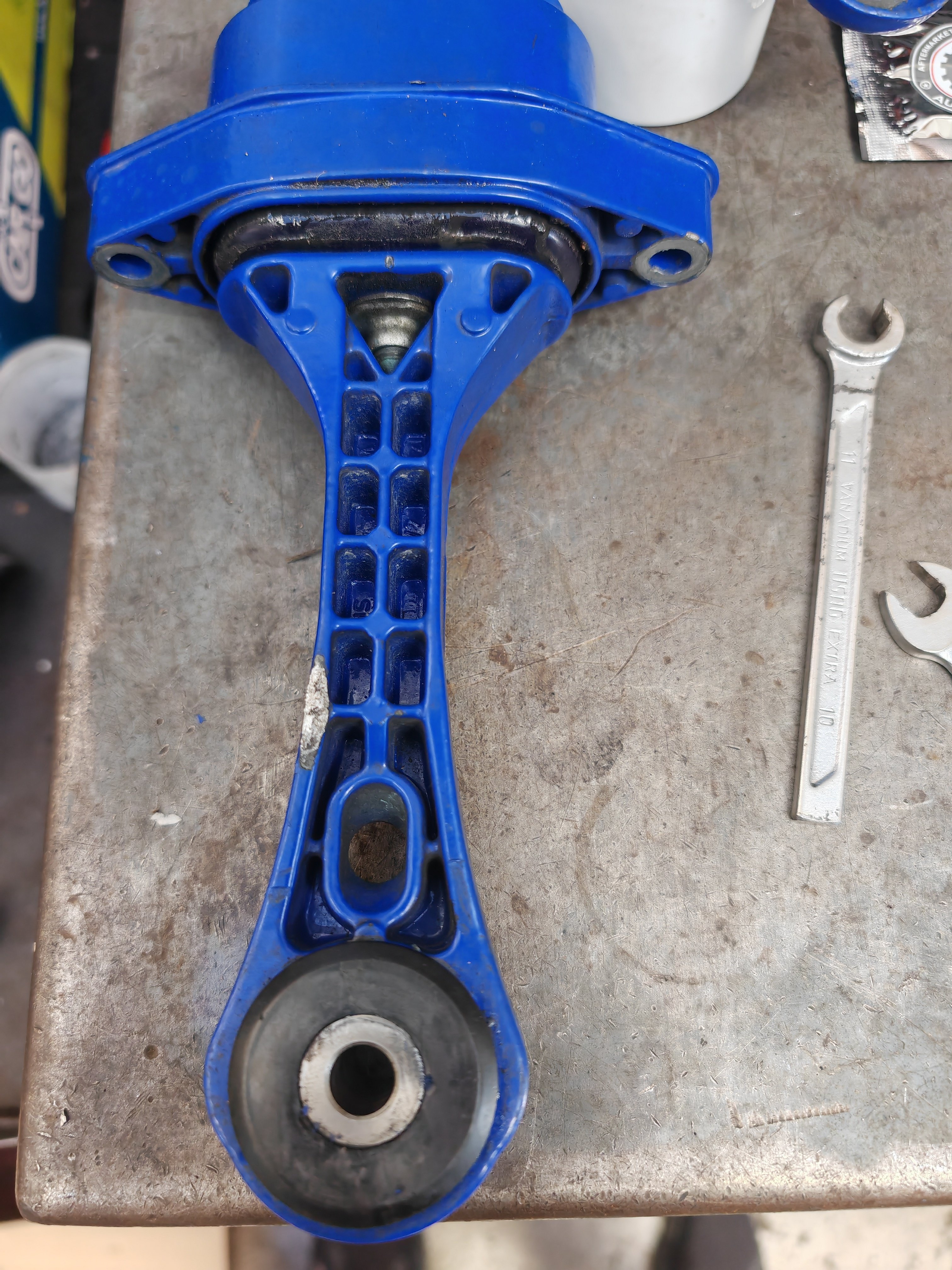

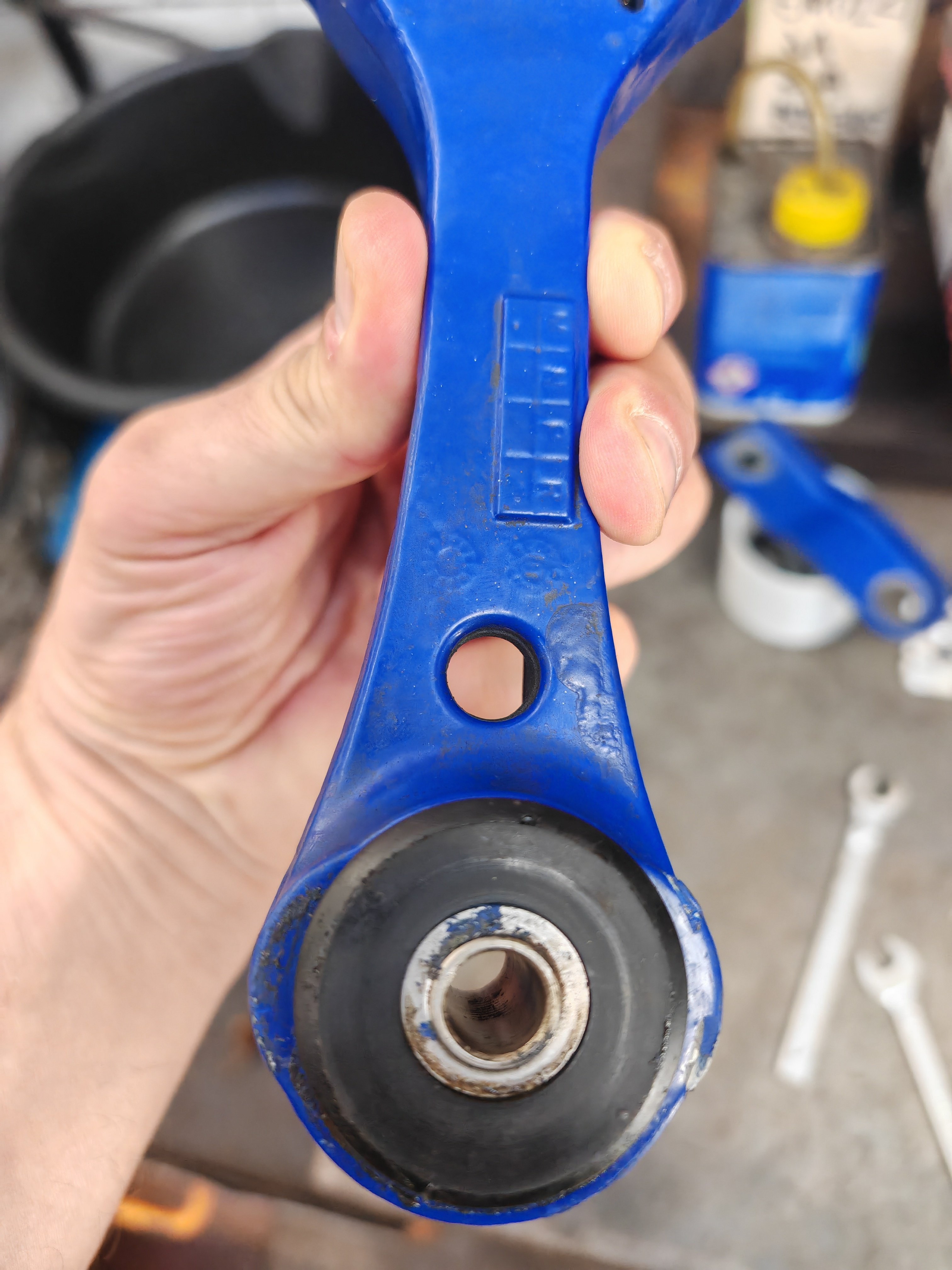

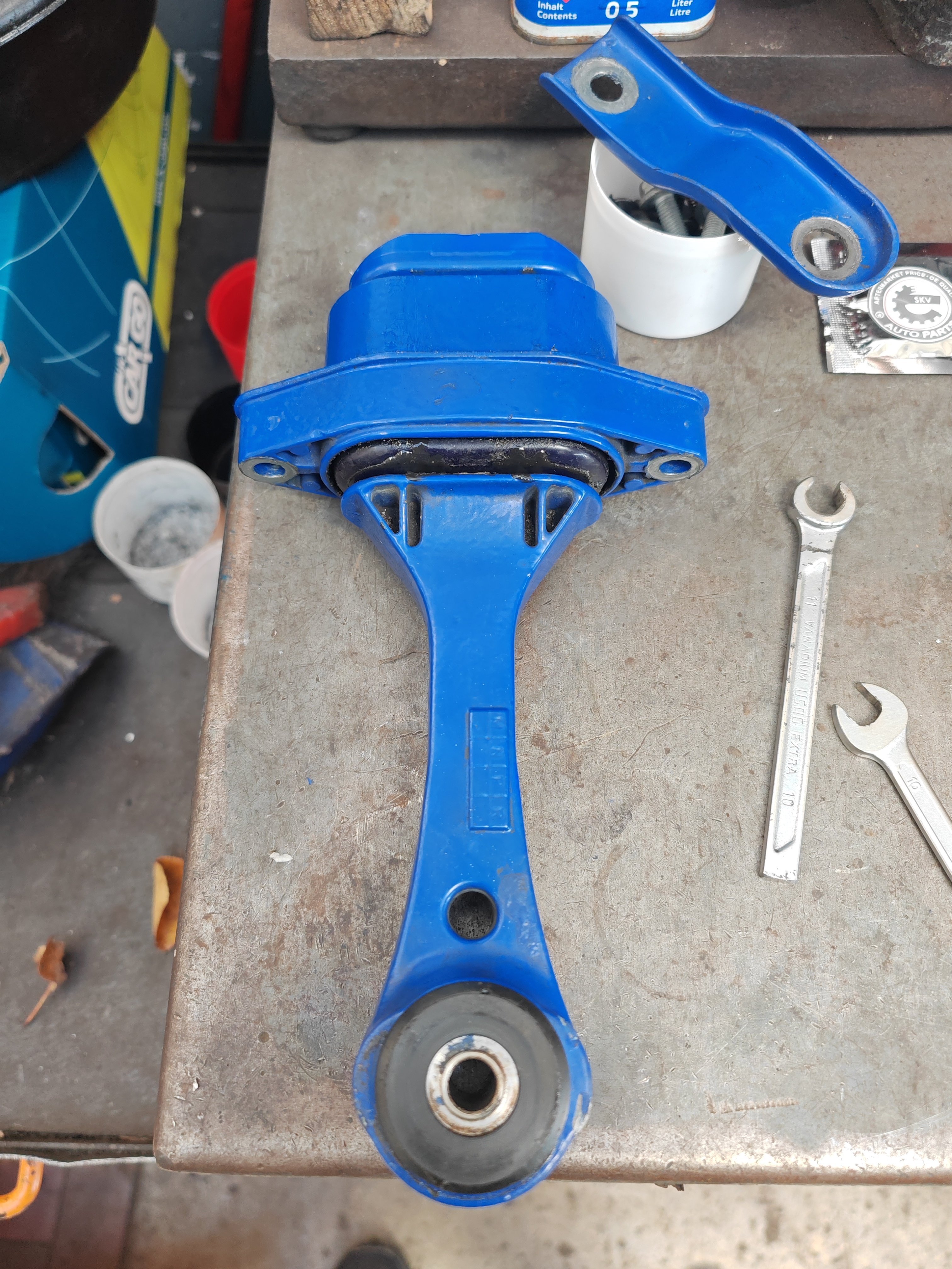

Finally complete picture of dog bone with front and rear Powerflex black racing series bushings

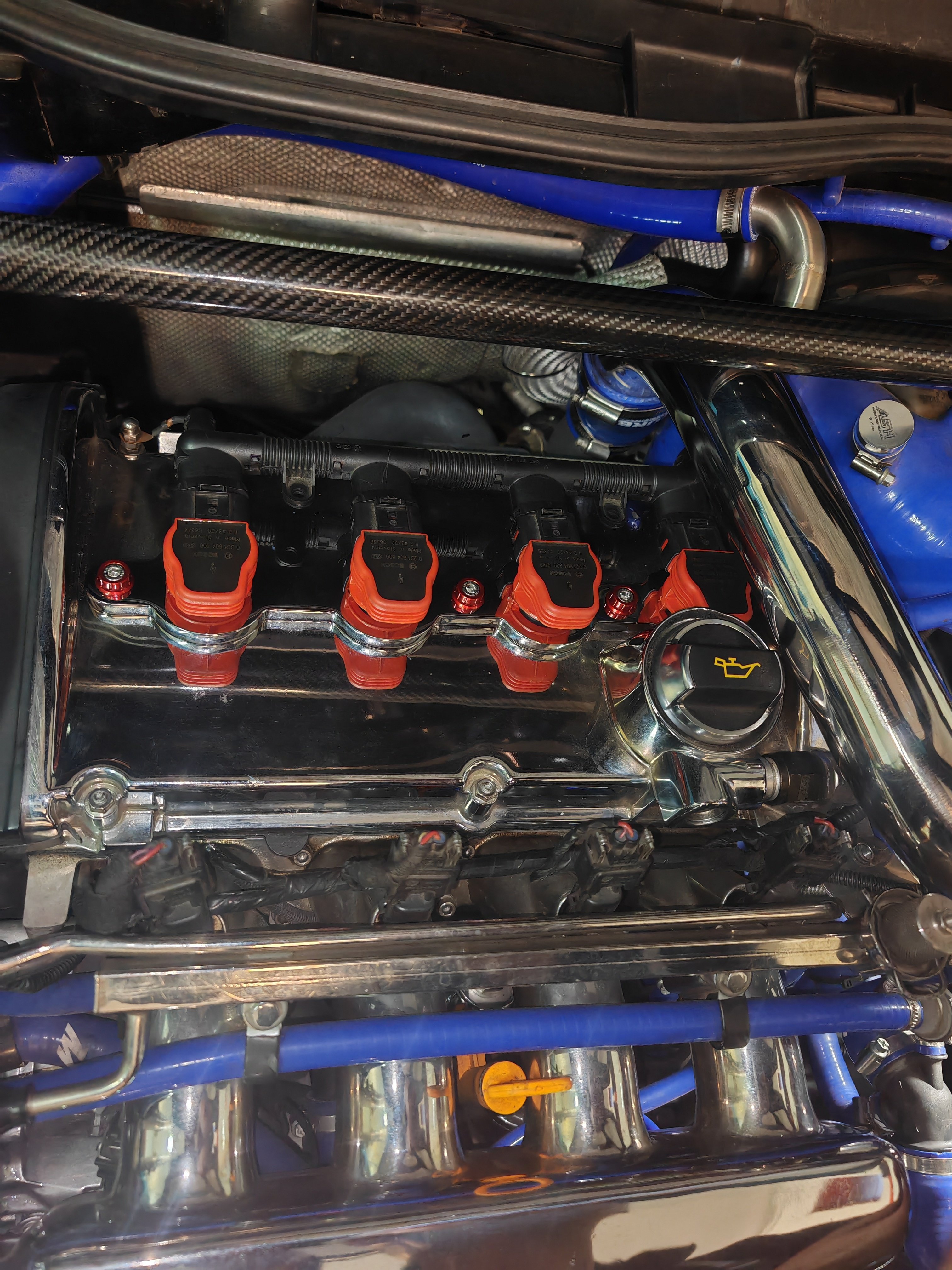

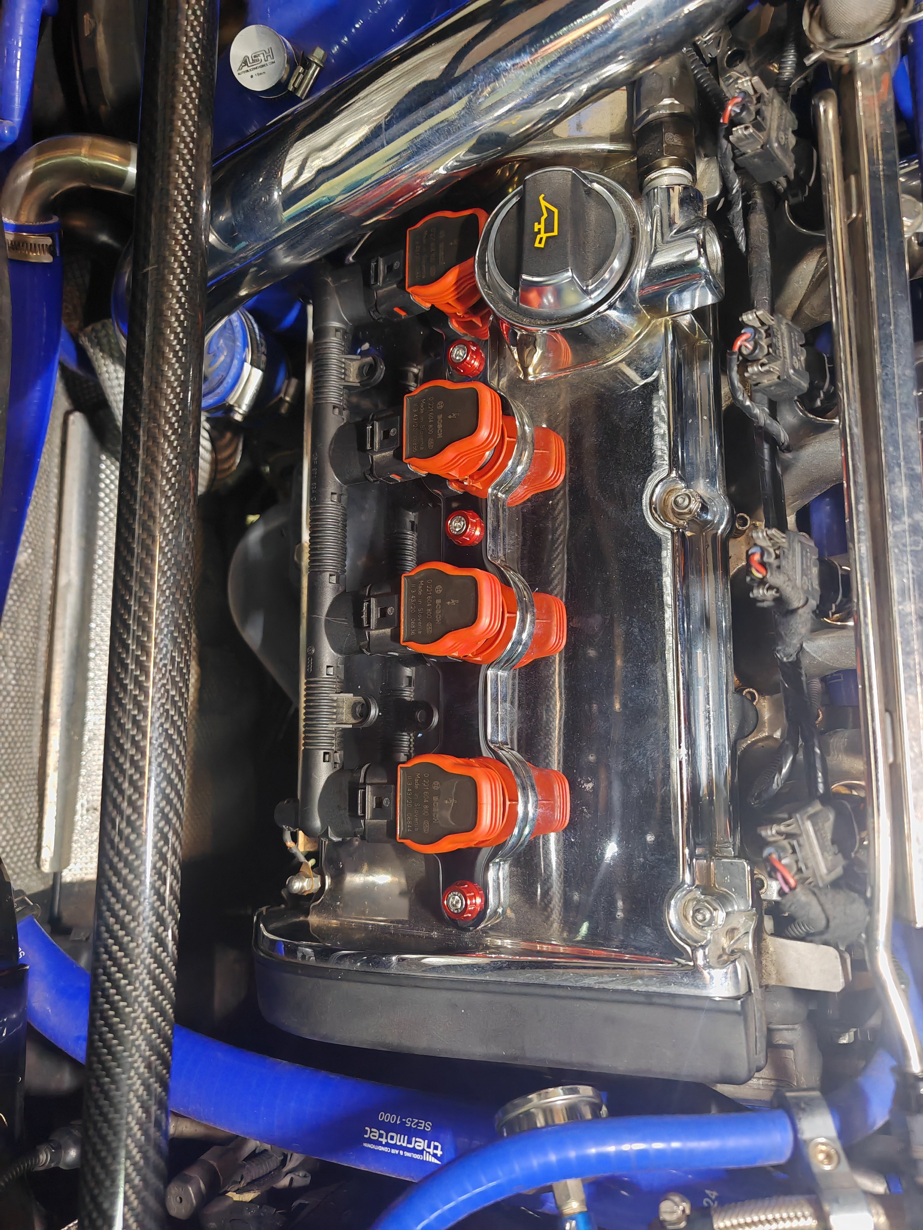

AGN valve cover R8 coil adapter finally installed 😇😇😇, first polihed than chromed

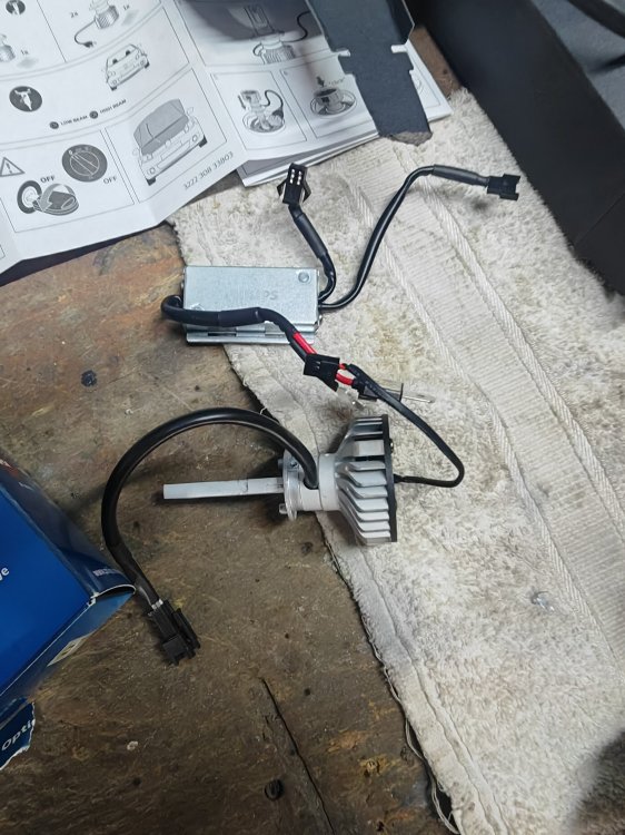

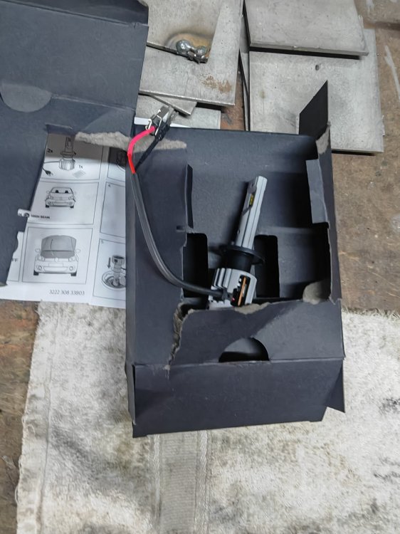

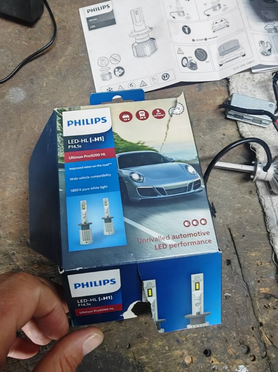

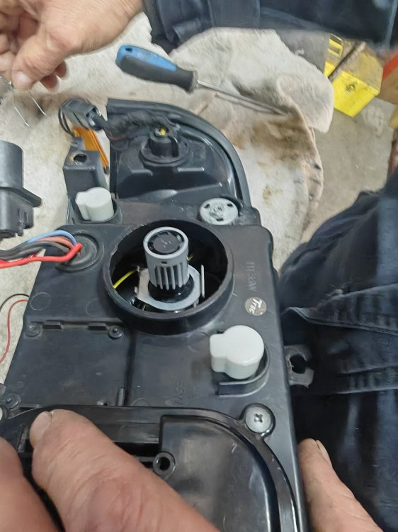

Also finally installed Philips Ultinon Extreme H1 leds-super Bright!!!

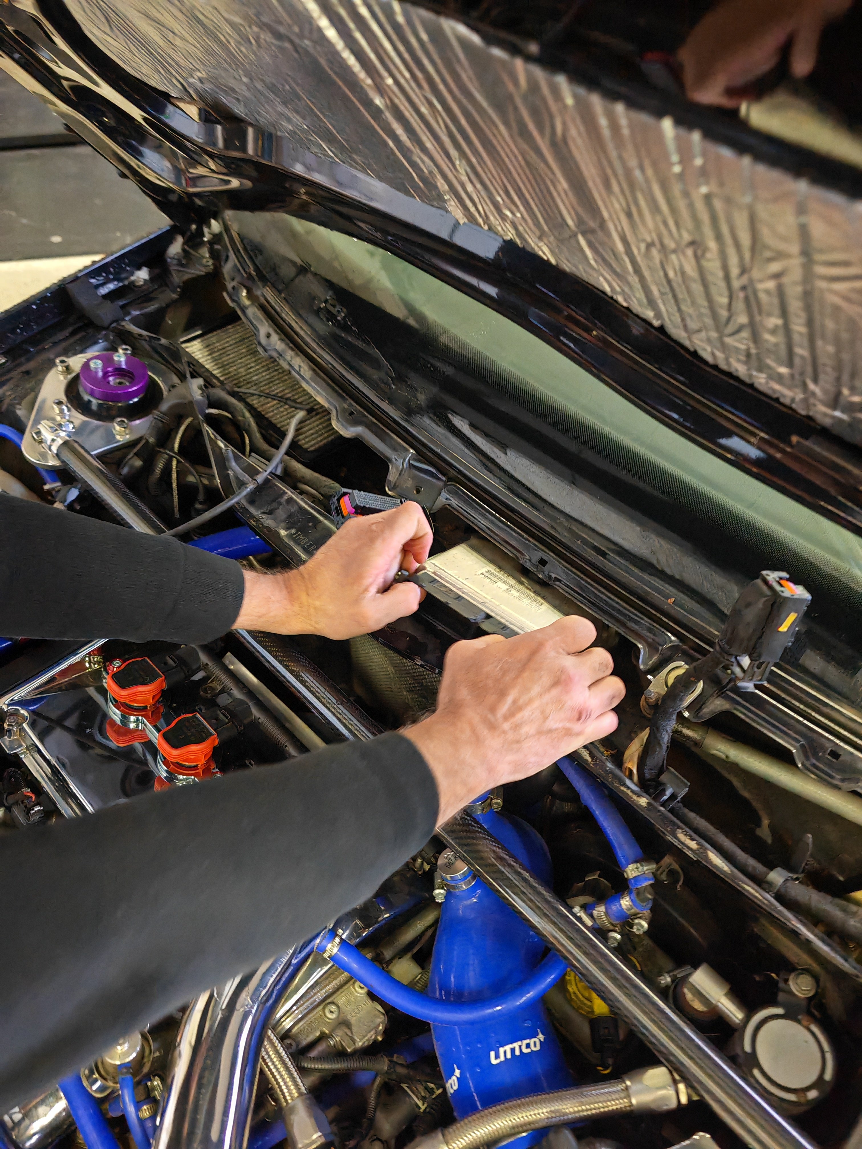

Also wraped whole air box from outside with DEI silver thermo reflective sheet. Fully insulated air system from air duct-silver thermo reflective to air box

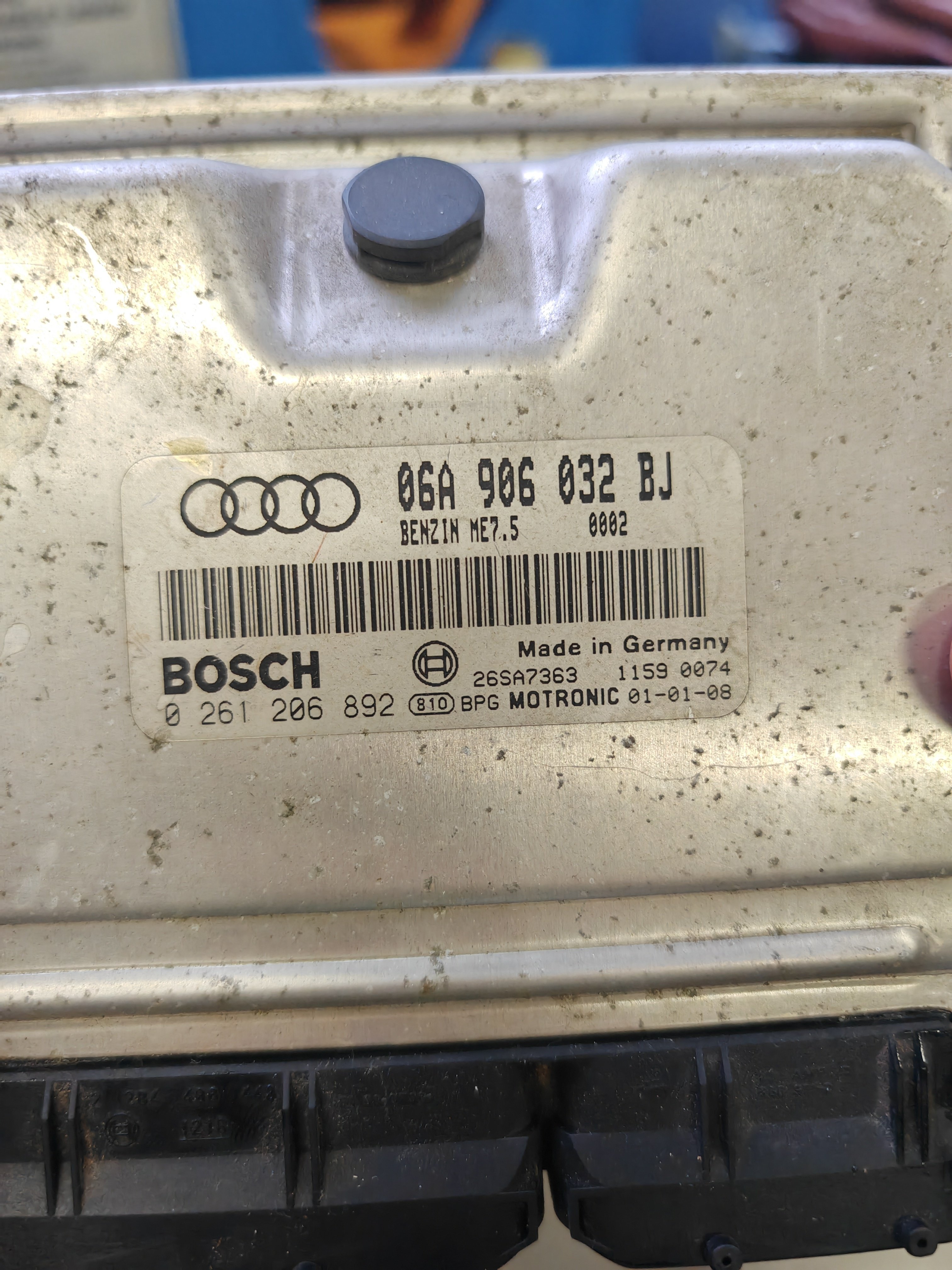

Finally replaced air conditioning filter. Did check also ECU. All functioning fine

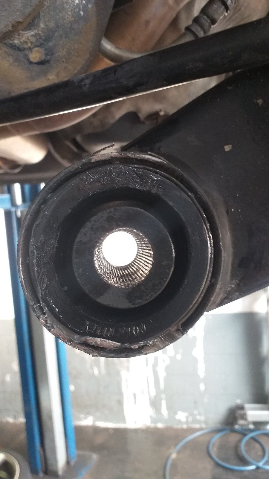

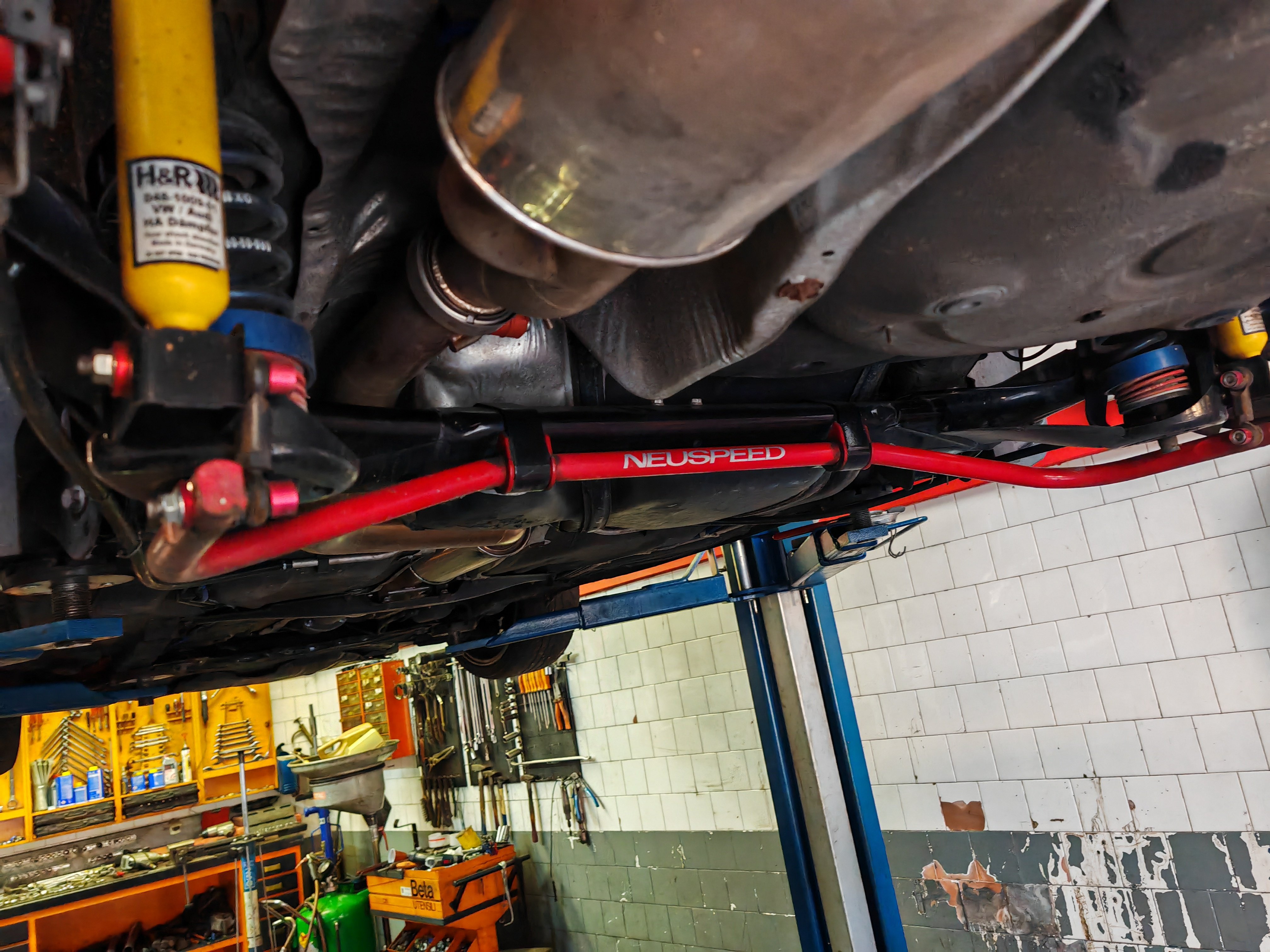

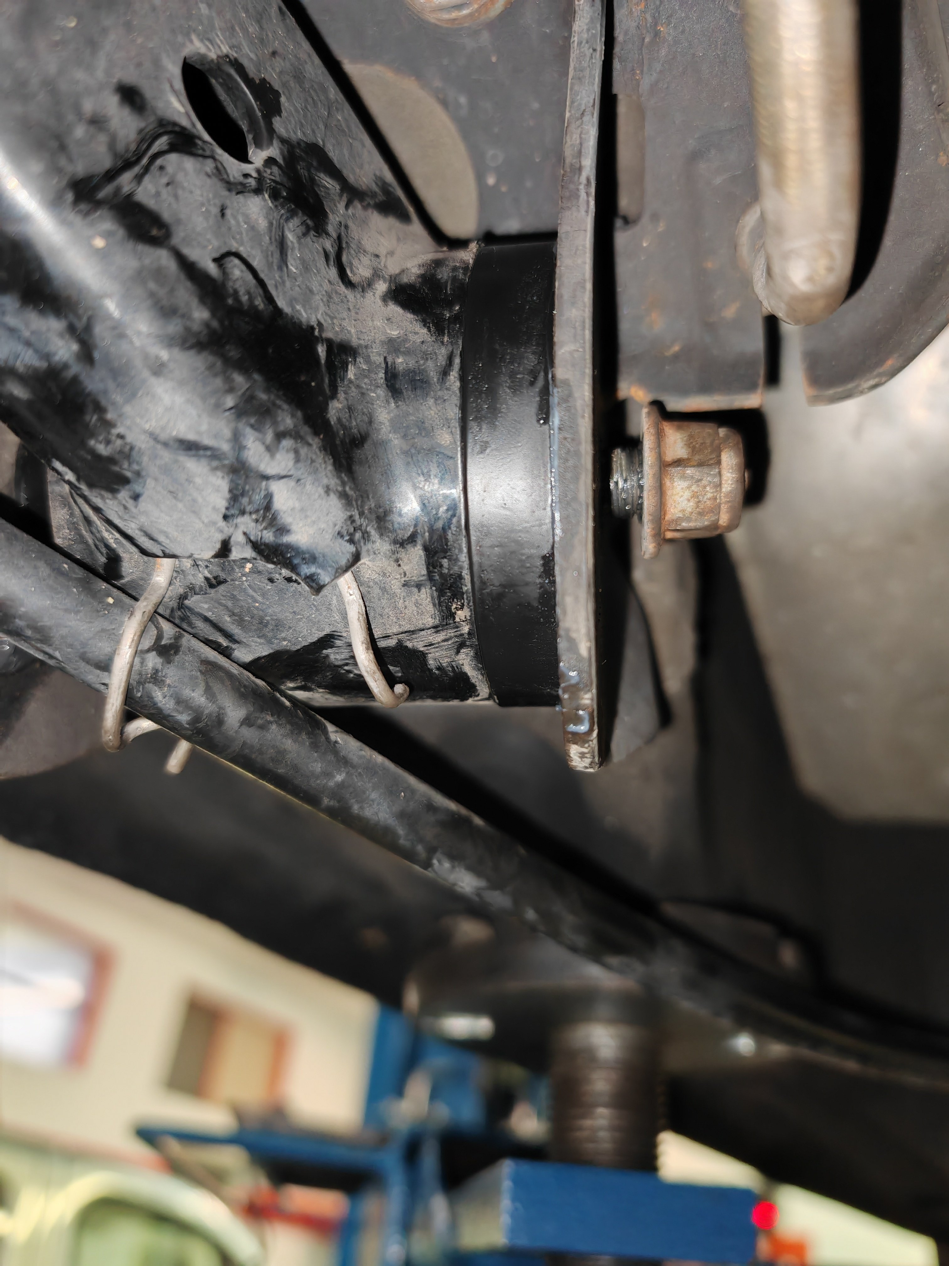

Finally new  Powerflex back racing series rear beam bushings im pllace💪💪💪

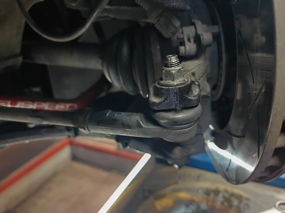

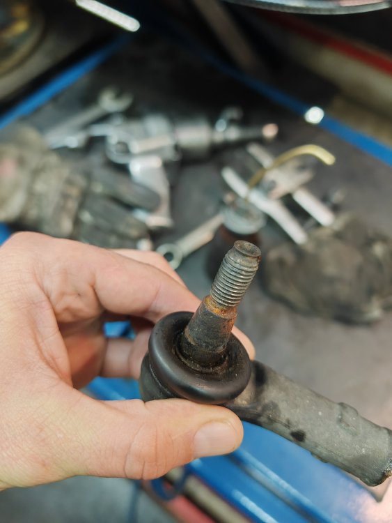

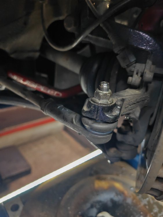

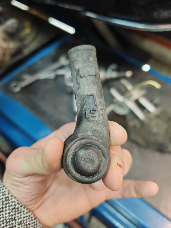

Front right tie rod end was gone so I replaced it for Lemforder until OEM one from eBay arrives
