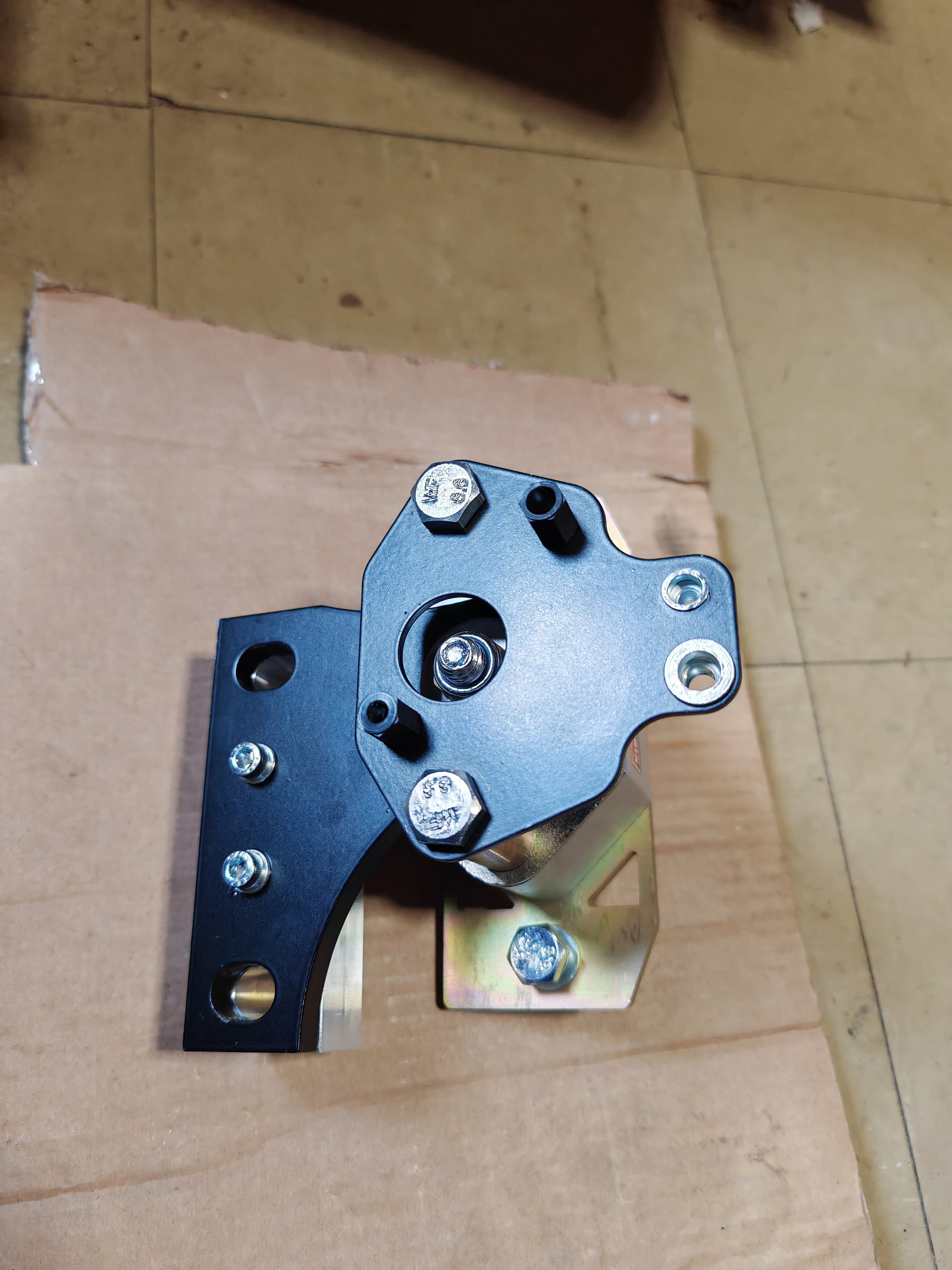

New KW top mounts completely sealed are ready for installation
do these make a difference as i'm using the poweflex lowered poly ones at present
Yes big ones, you can increase camber-better cornering and castor-even better turning into the corner. Probably less adjustable than existing Ground Control because both are adjusted sinultaneously and on Ground Control separatelly-easier to do but KW ones has sealed closed ball bearing-no dust comes in and preserves its function longer and also teflon ring that I expect to eliminate doing doing sound when turning steering wheel because of spring and alu cap rotating and causing noise, now it should be gone. Will update you after mounted. With lowering caps you have only stiffer upper Hood and less to press coil-longer suspension and coil-less compressuon on spring and shock but nowadays all the shocks are height adjustable without affect on spring height so only stiffer hold of shock you have and no camber castor adjustement which is crucial for direct and precise steering and handling or track use. My car is Like go cart plus precise with R32 steering rack only 2.5turn- but to direct on high speed-missing progresivne servo💪

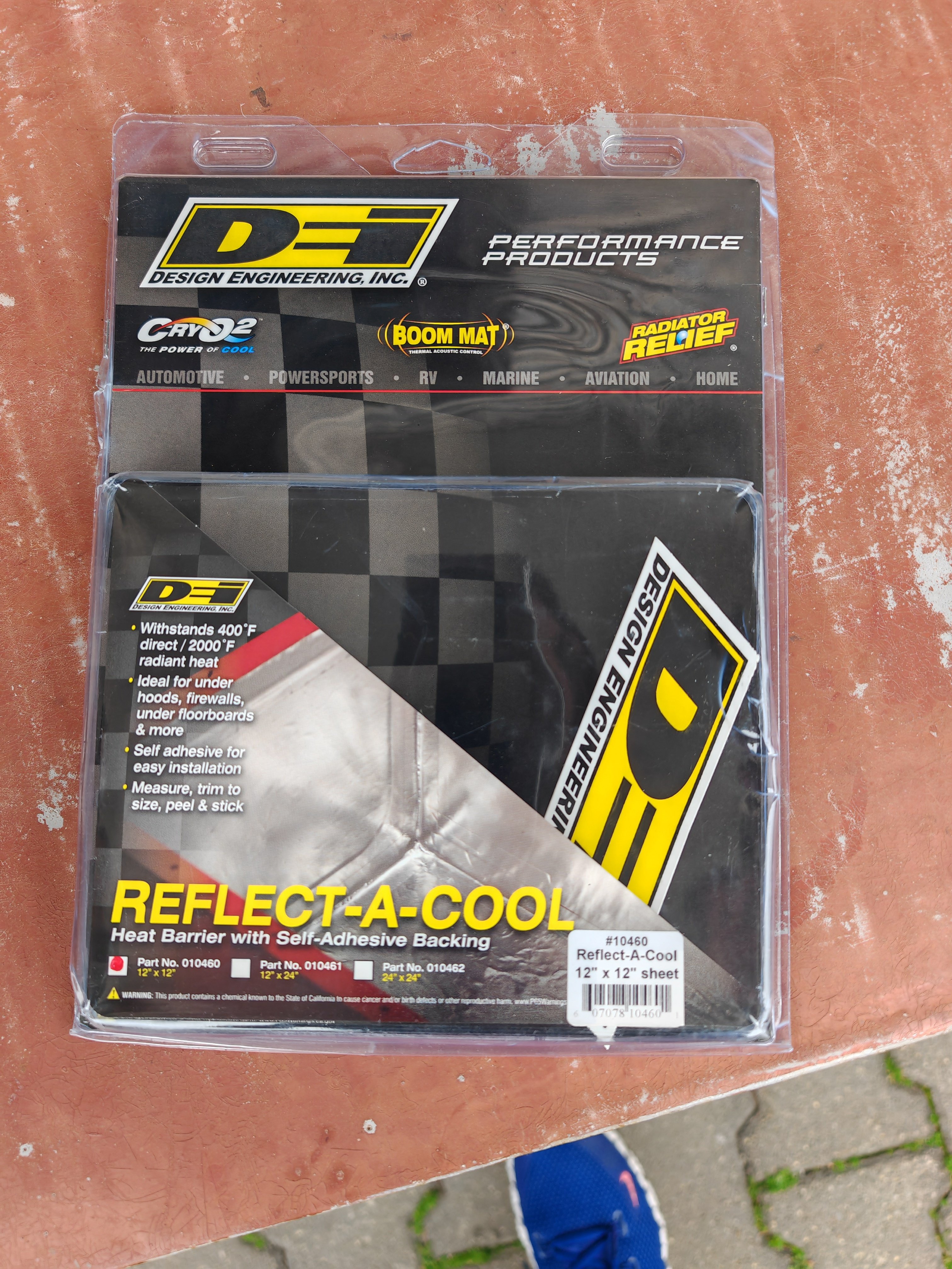

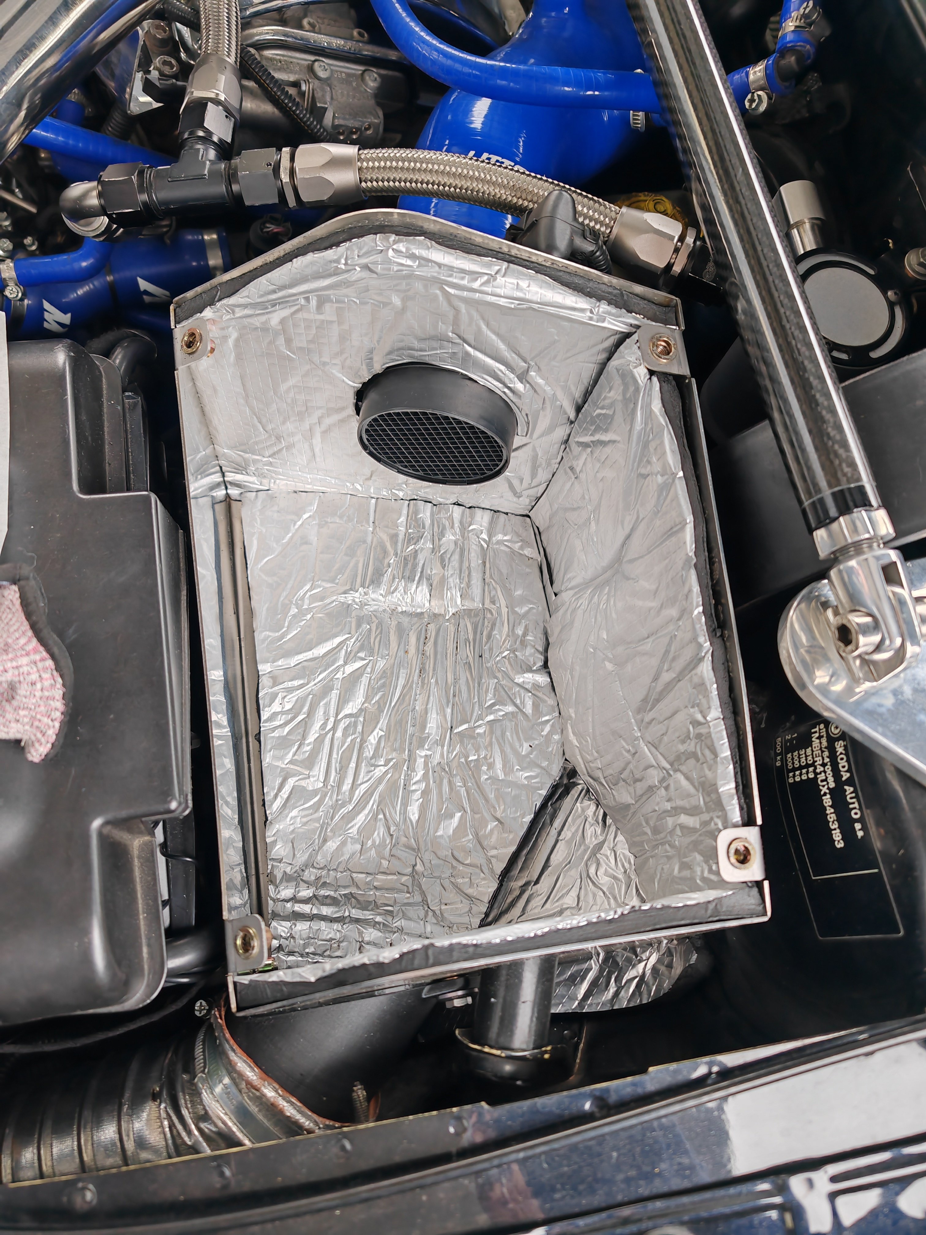

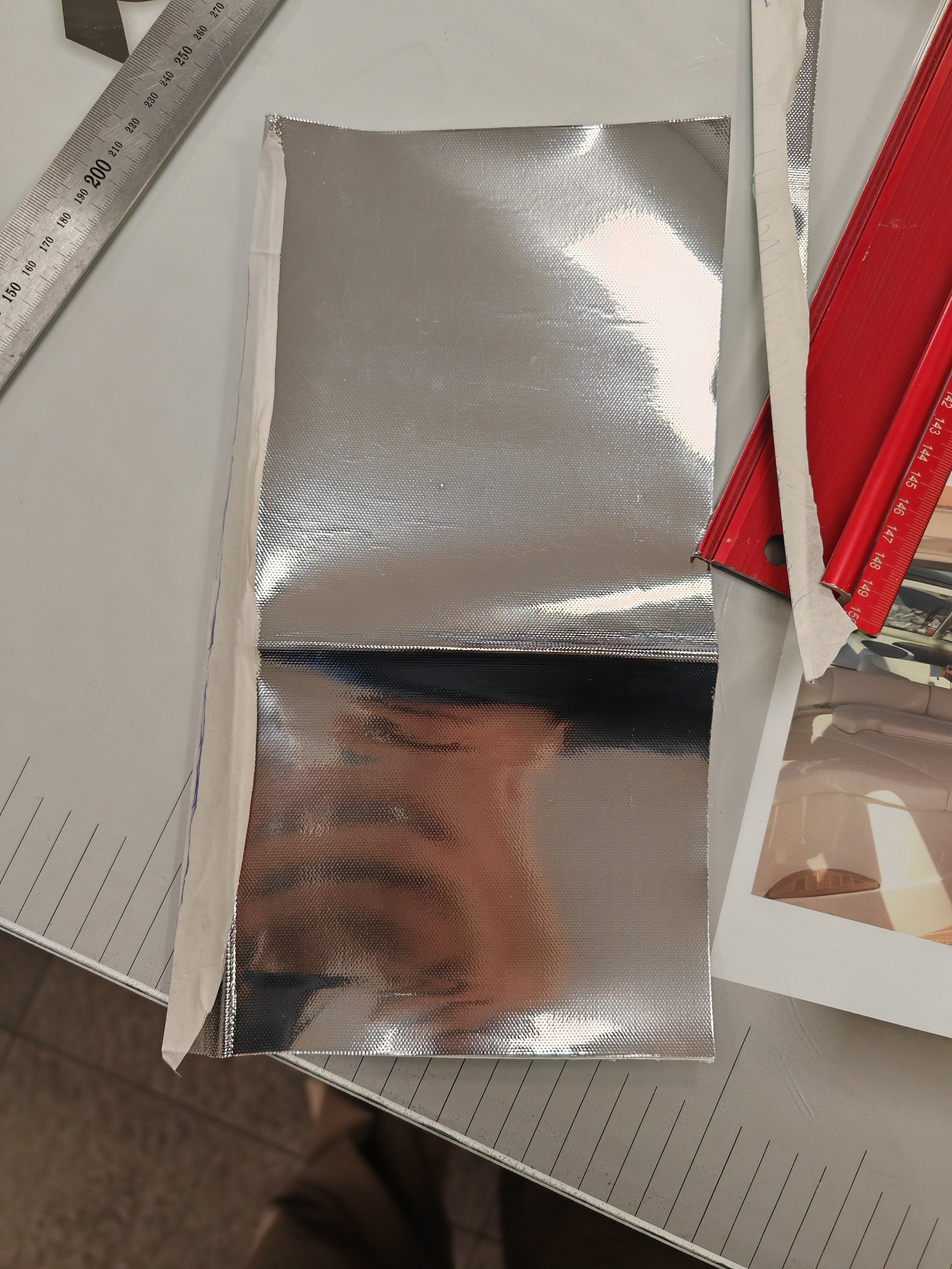

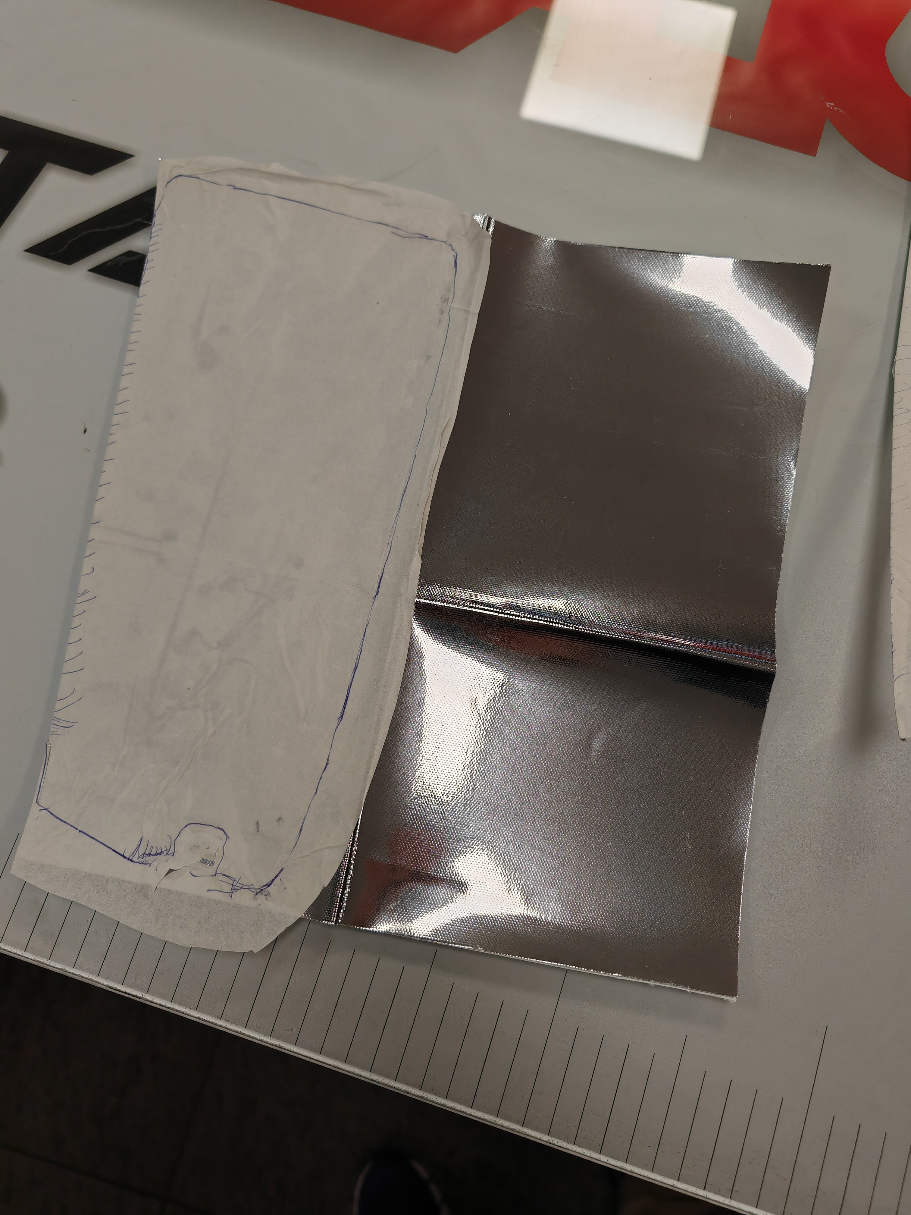

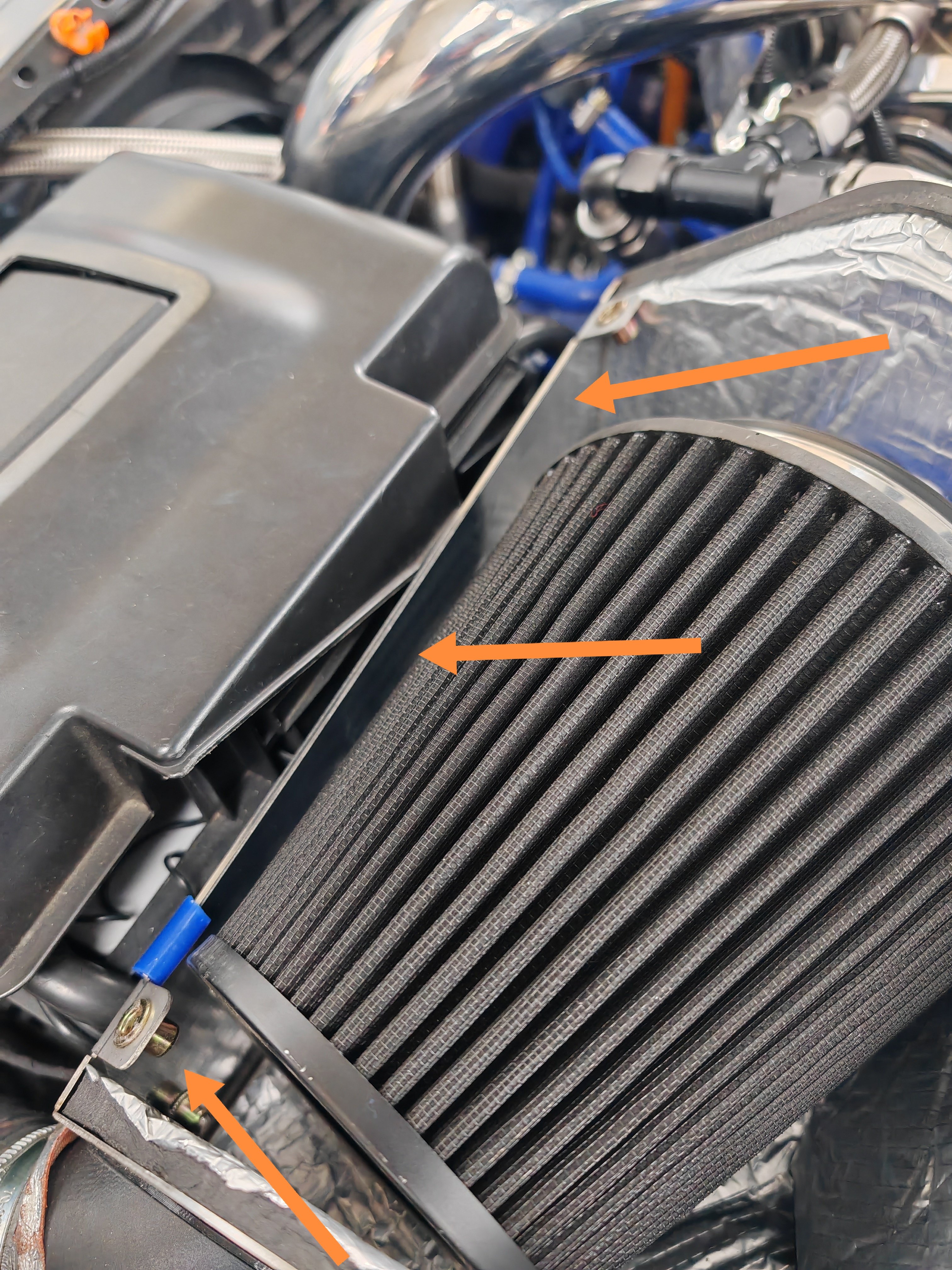

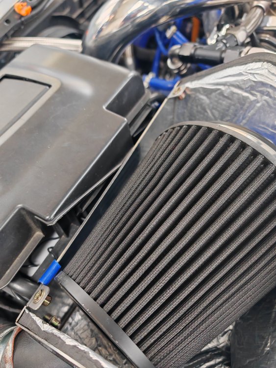

Yesterday I've Got DEI reflective sheat and mounted it on the front vertical side of the air box close to the batterry because I removed there 1cm alu sponge to have space for the air to go around whole air filter so now I've put this thin one there. Happpyyyy
Done by https://www.auto-sac.hr/
Edited by davojuri
GREAT WORK AGAIN

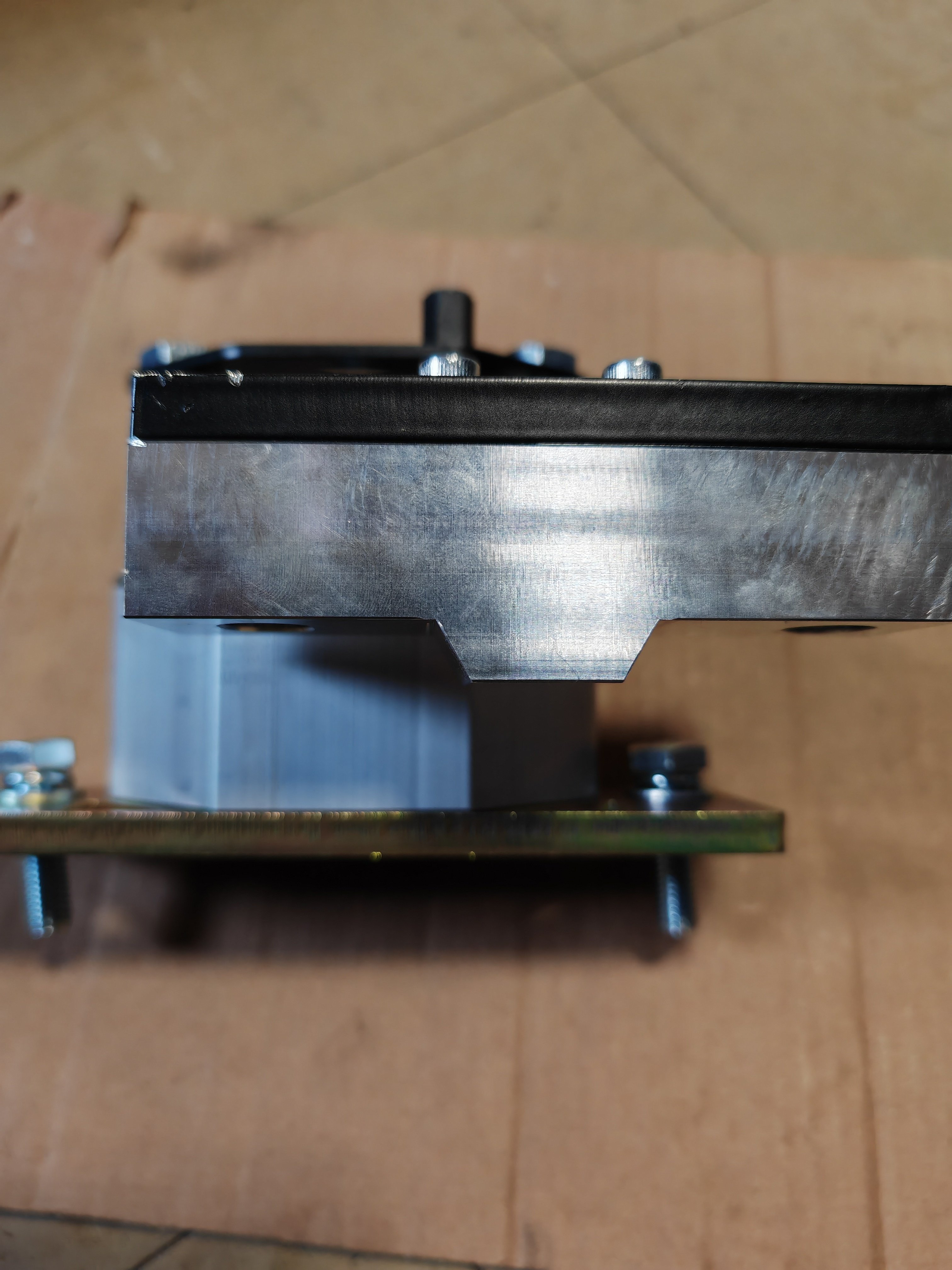

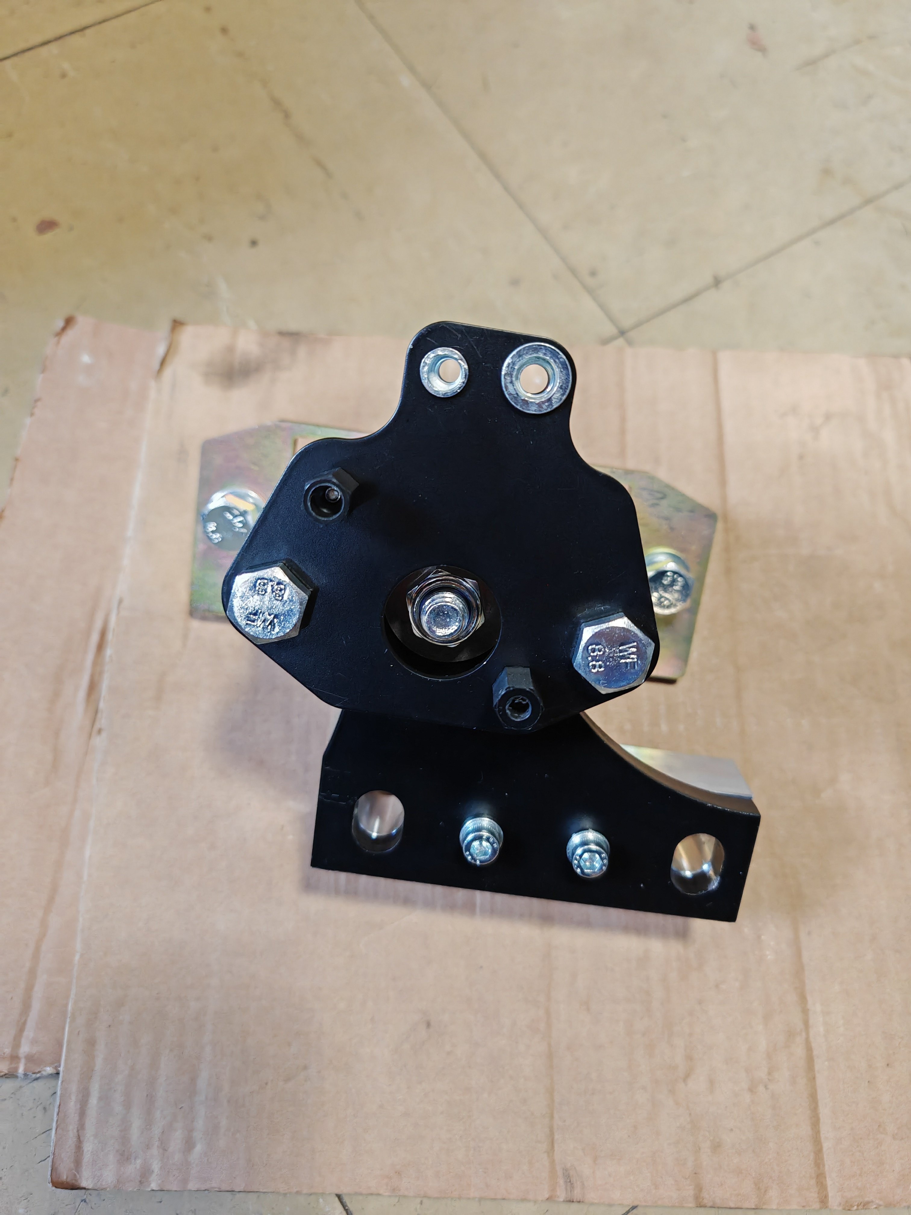

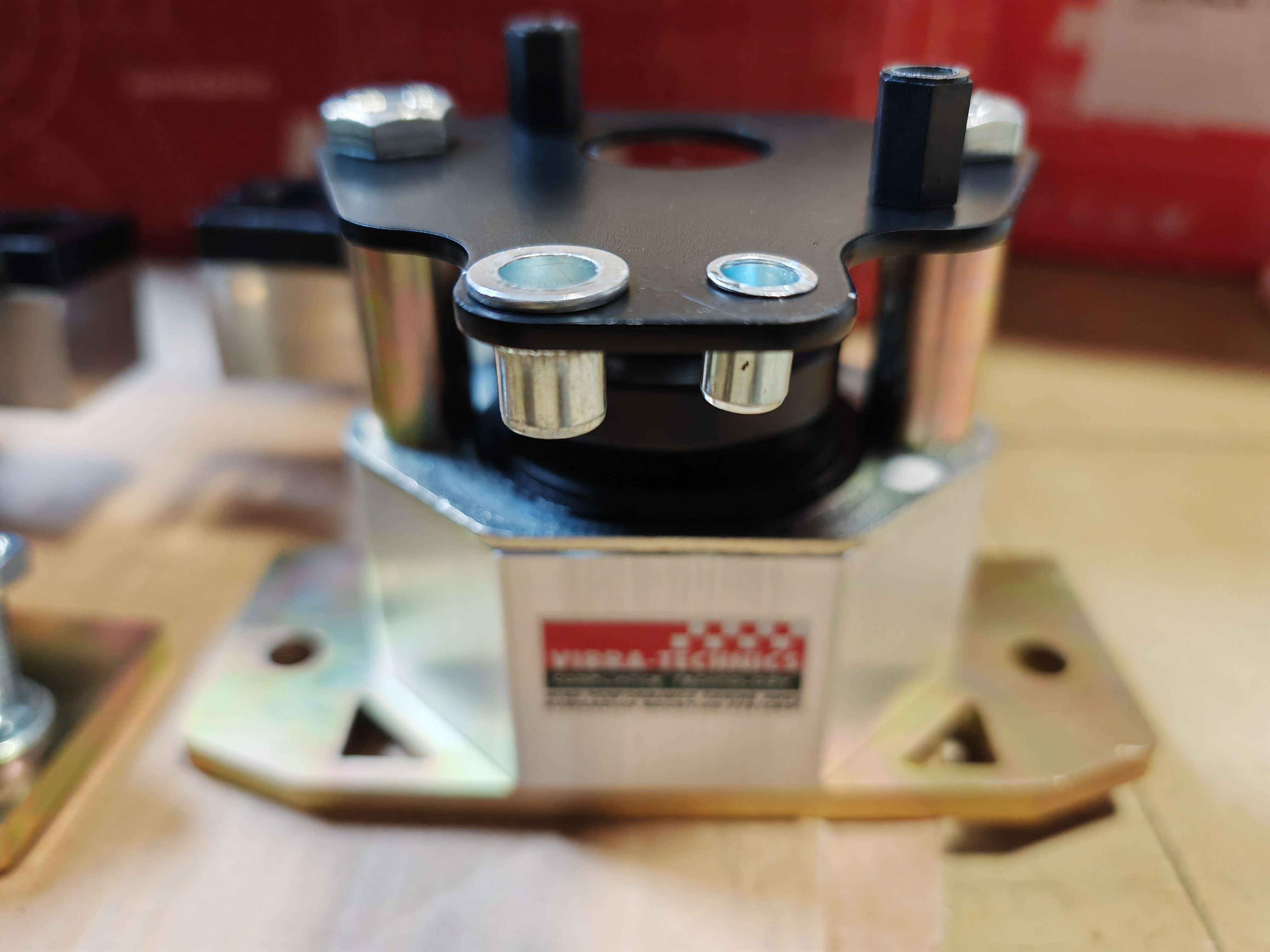

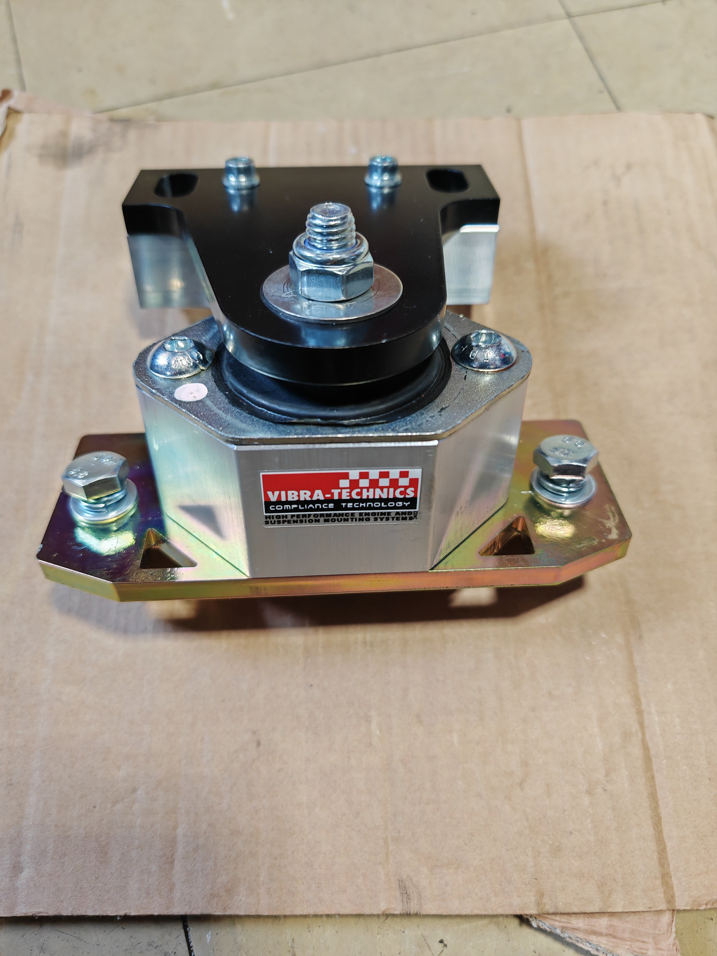

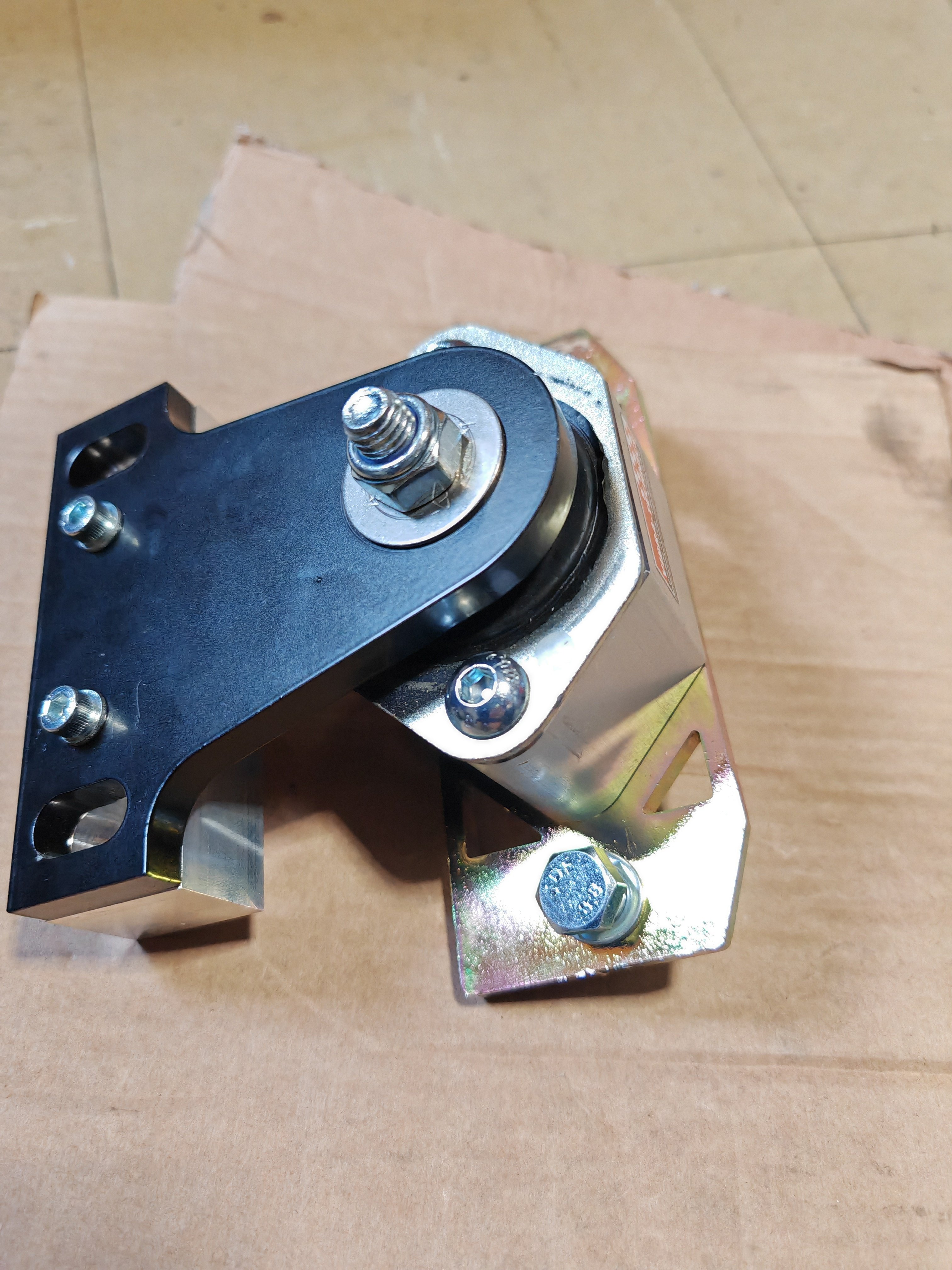

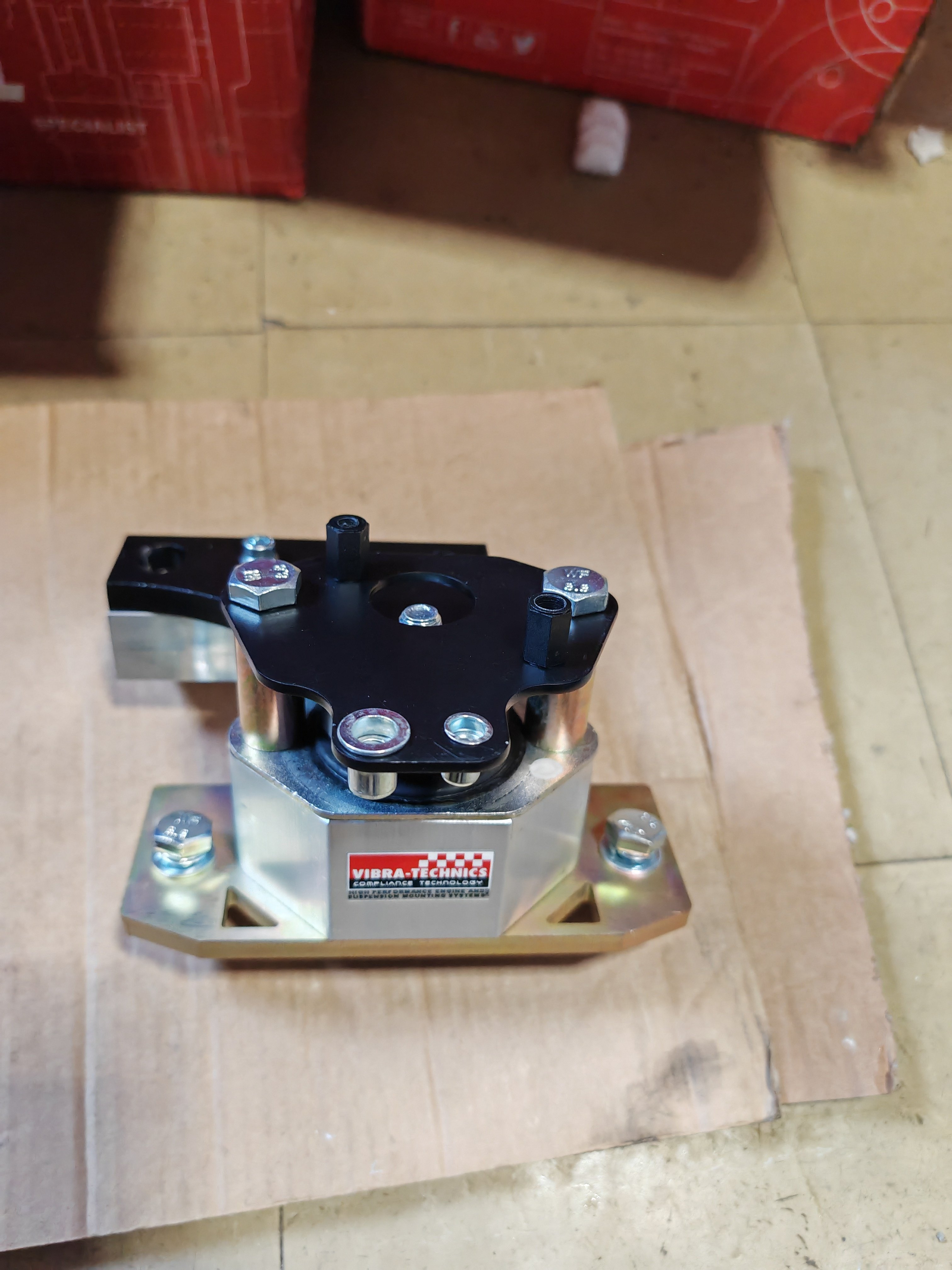

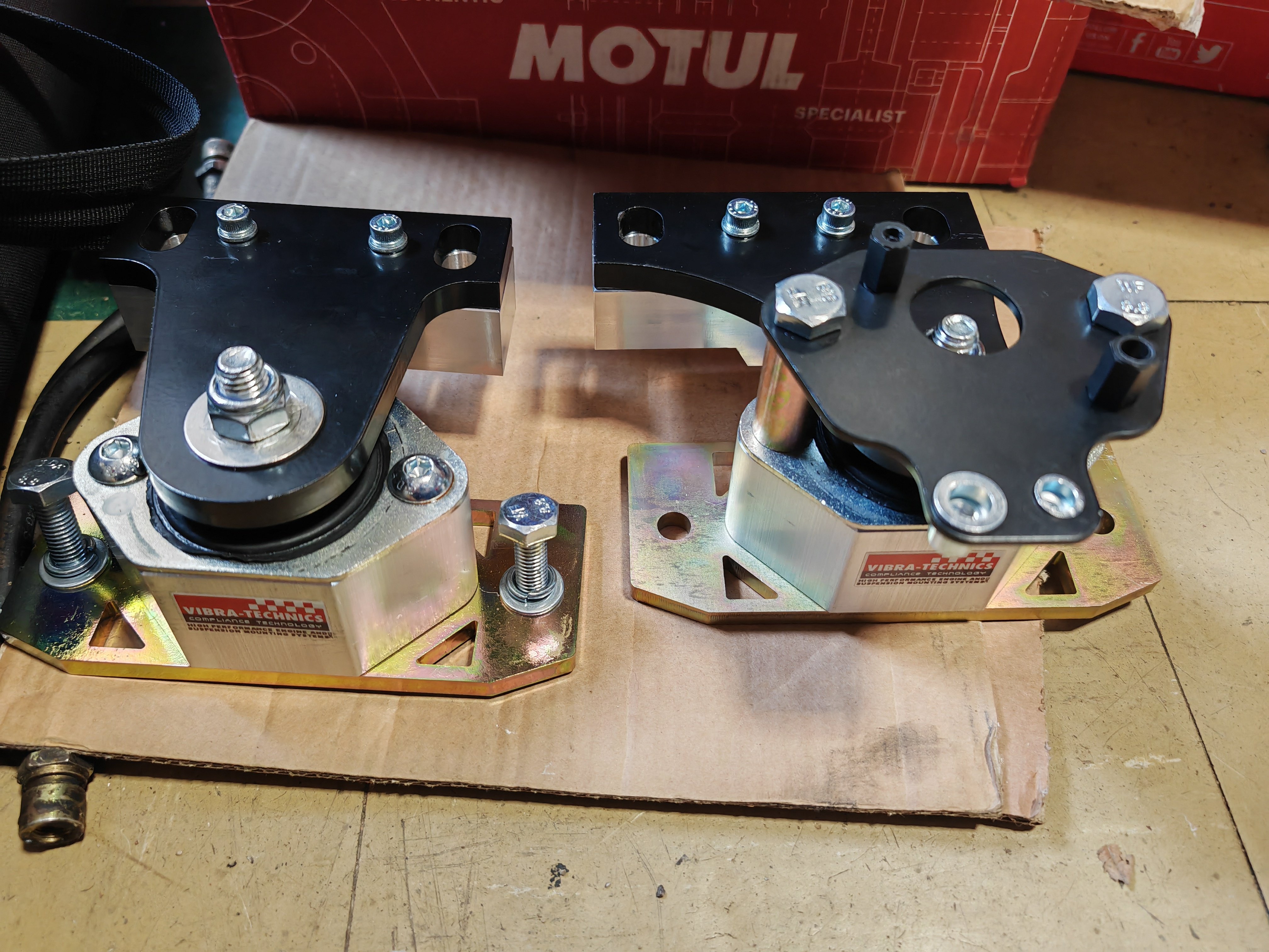

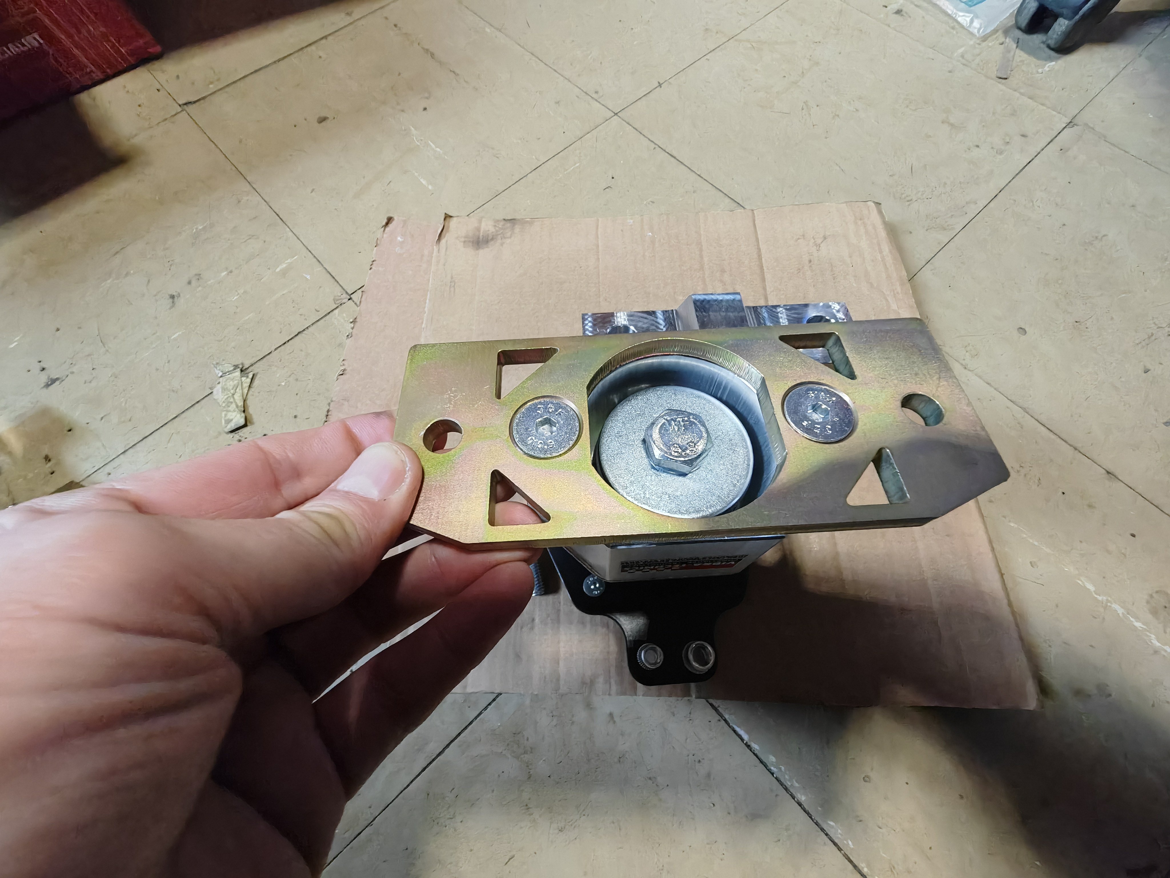

Today I've picked up Vibra-technics engine and gearbox mount Street performance
All black anodized and zinc plated parts will be painted in RAL 5002 -ultra marine  Blue,as all other components and alu parts will be covered with clear laquer to avoid oxidation
Soon time to instal lota of bits (15.3.2024)

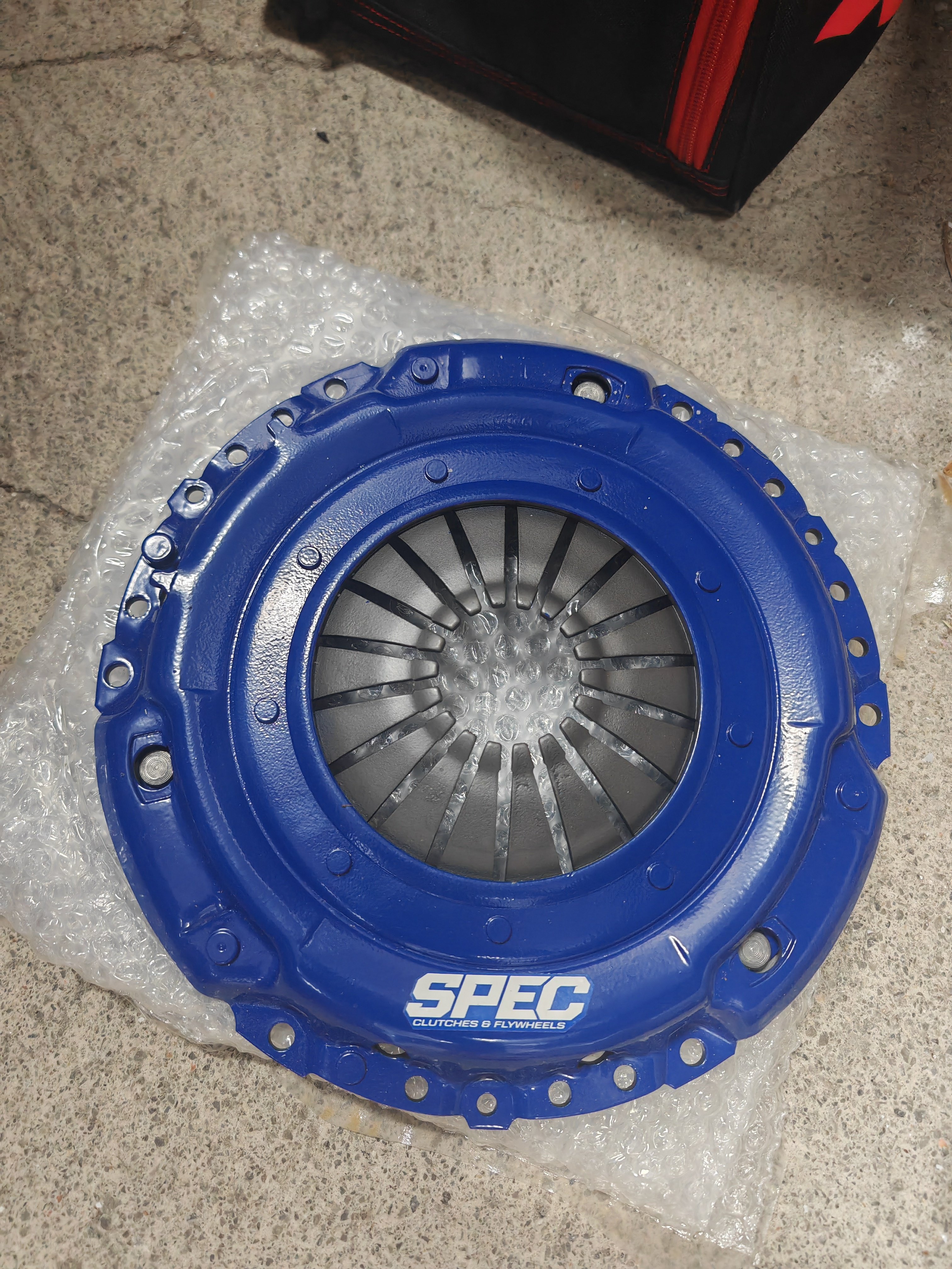

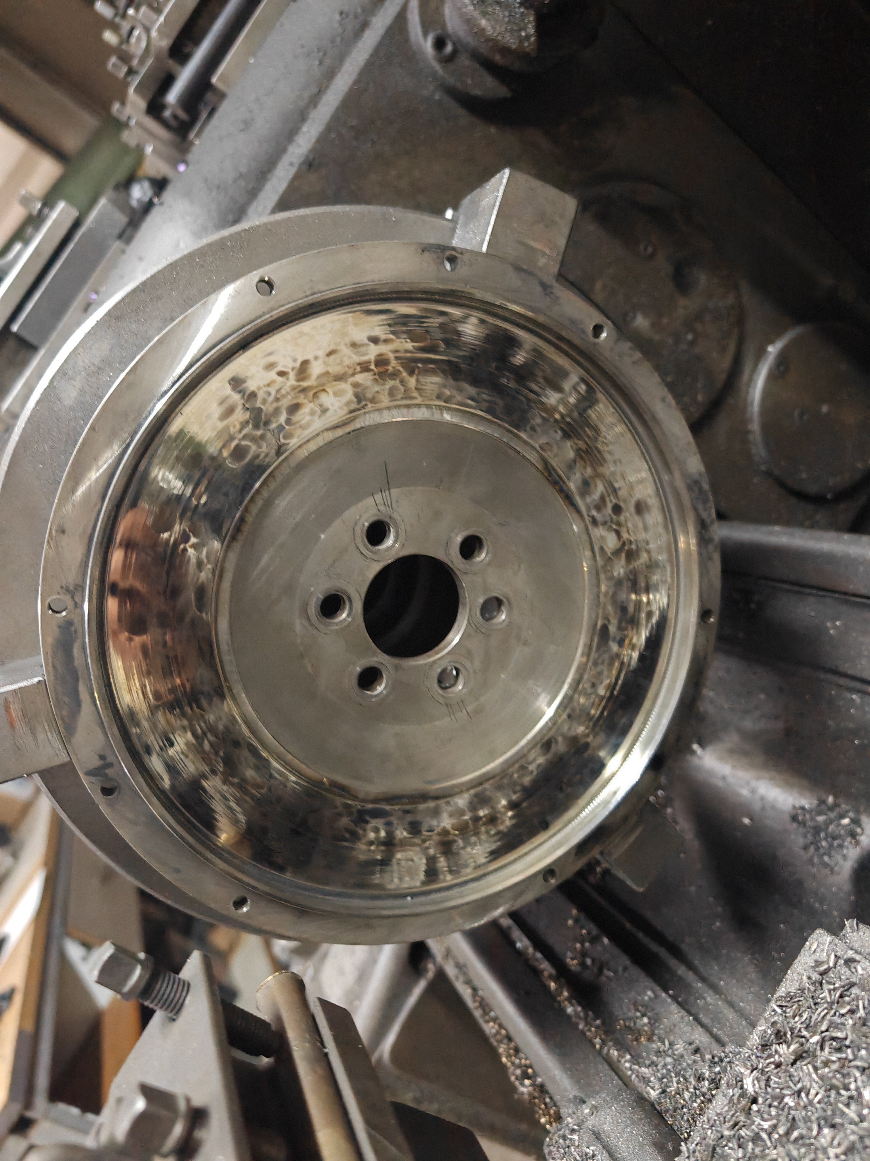

SPEC stage 3+ SV363F clutch

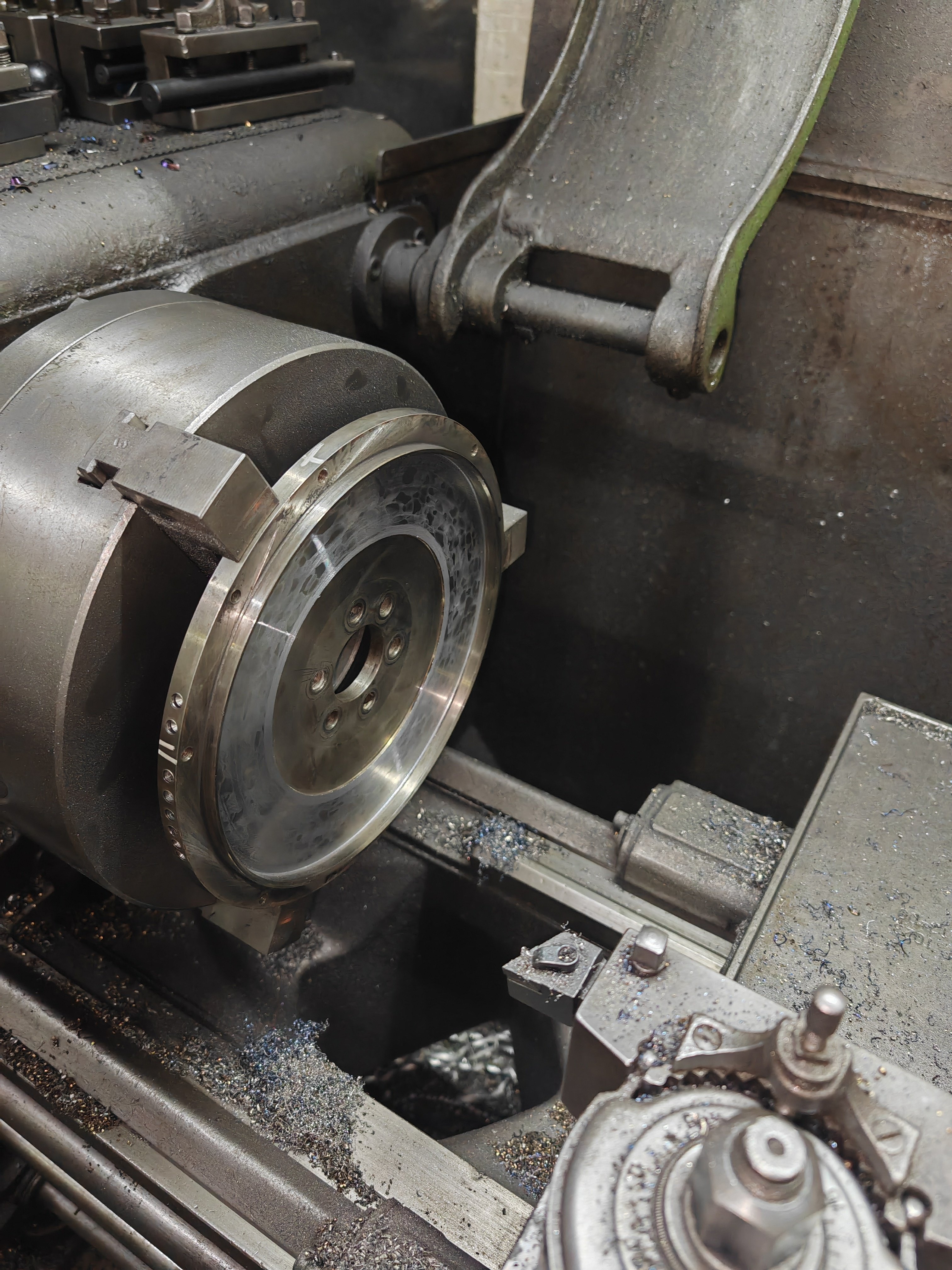

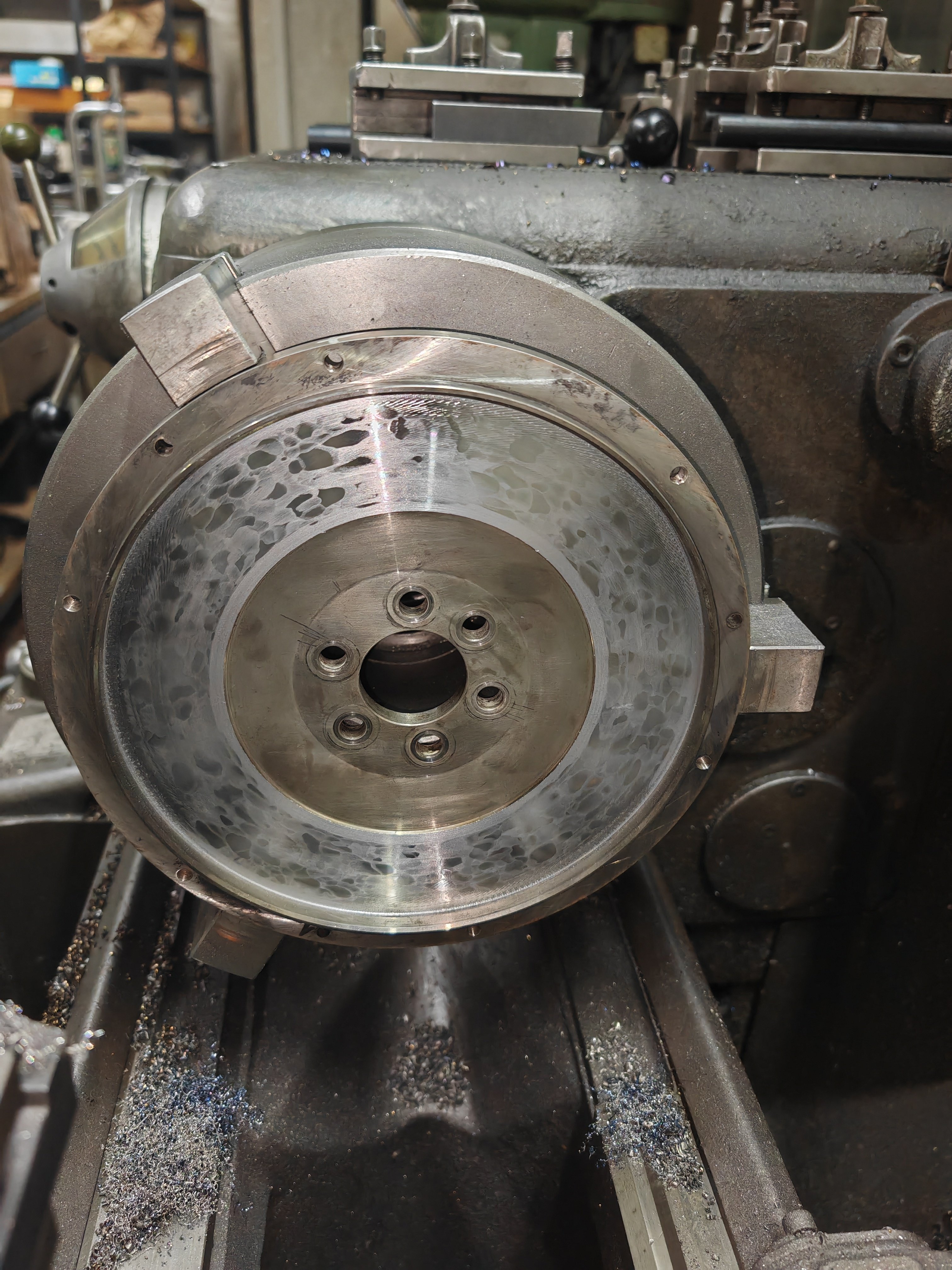

To be balanced with SPEC flywheel
ARP M10x25mm flywheel bolts
KW top hats
Vibra-Technics engine and gearbox mounts
Pinion brace reinforcement

On 11/03/2024 at 17:51, dubDEAN said:
GREAT MOUNTS
Any experience with those mounts regarding NVH?

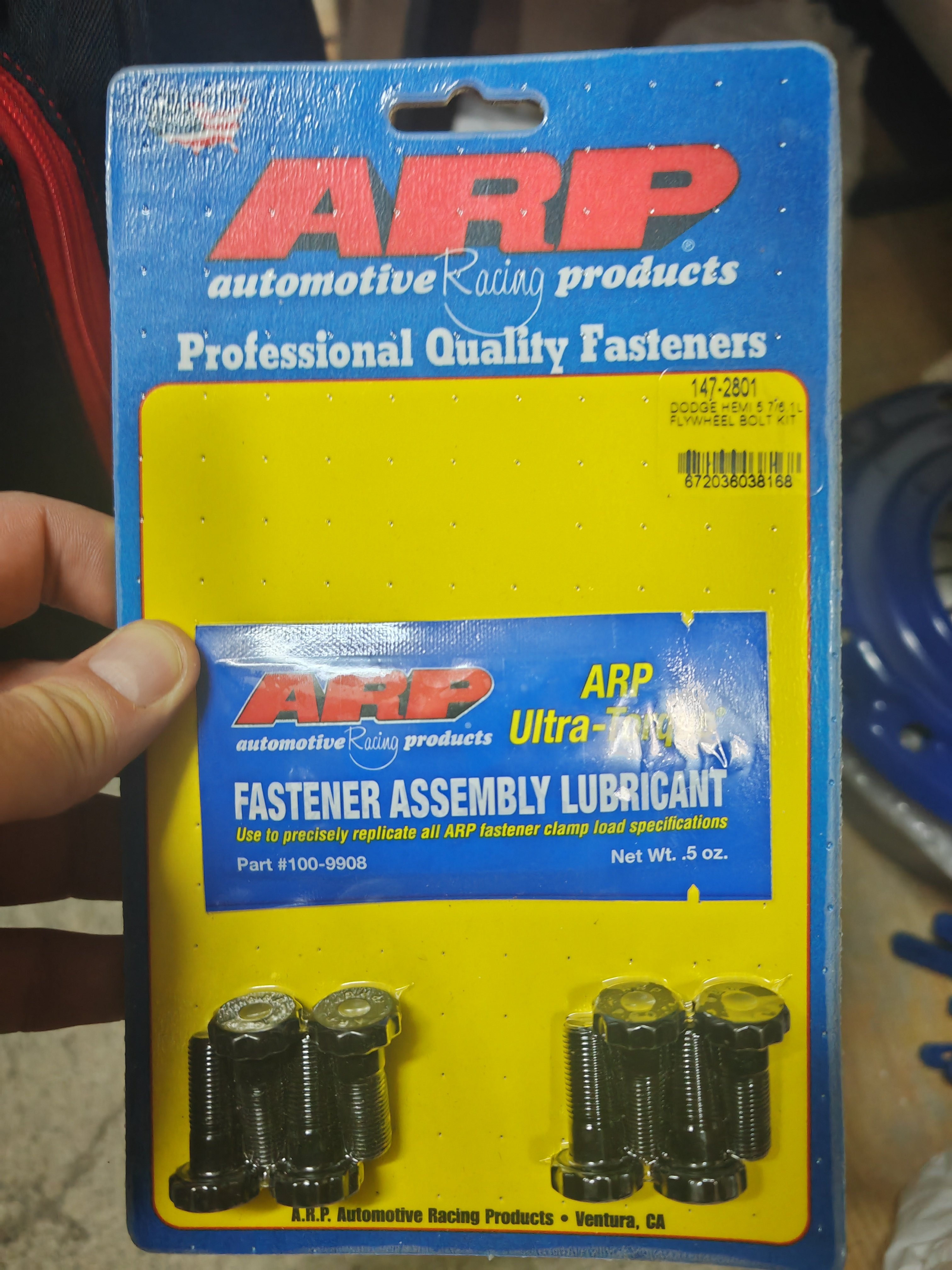

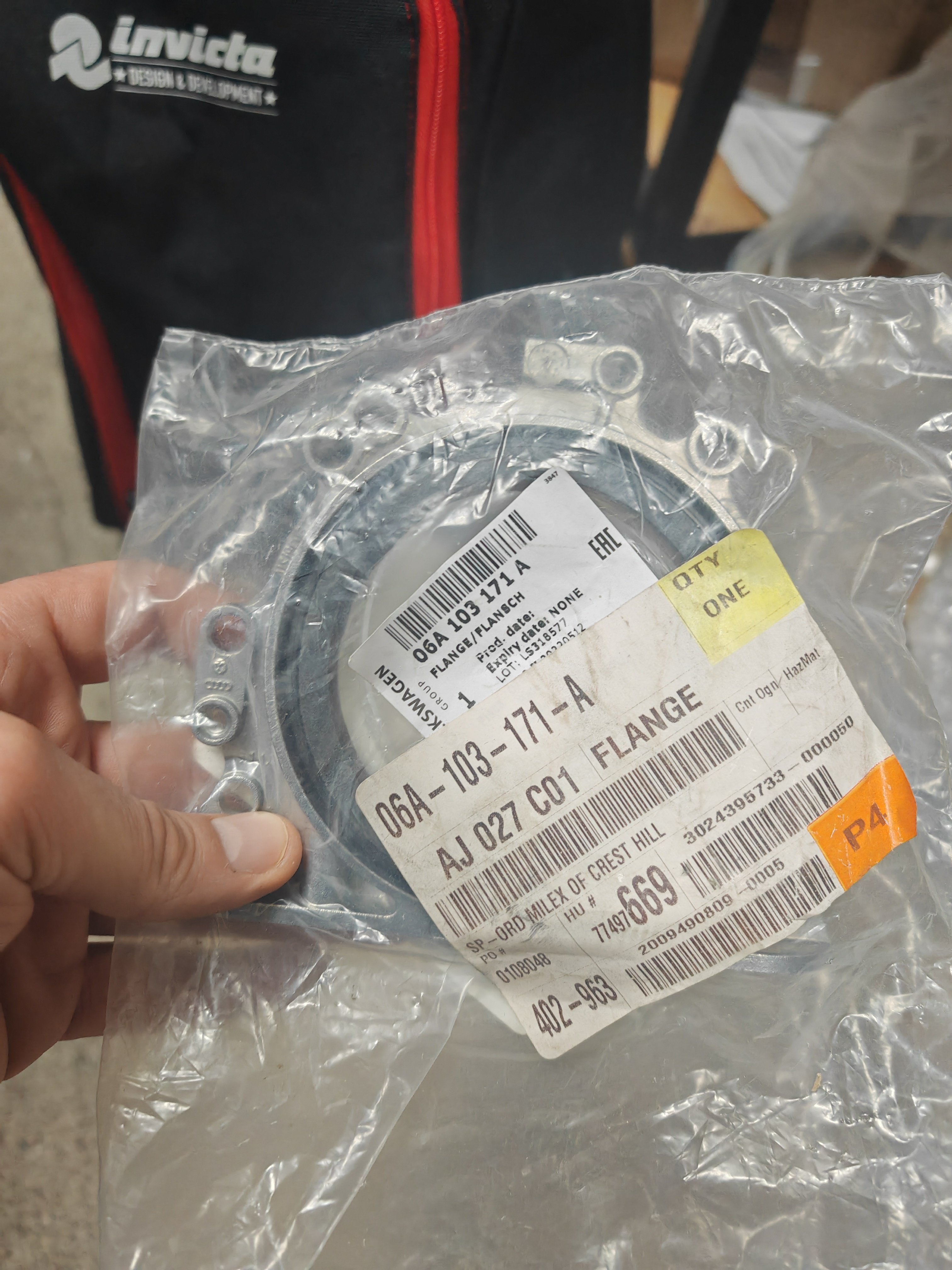

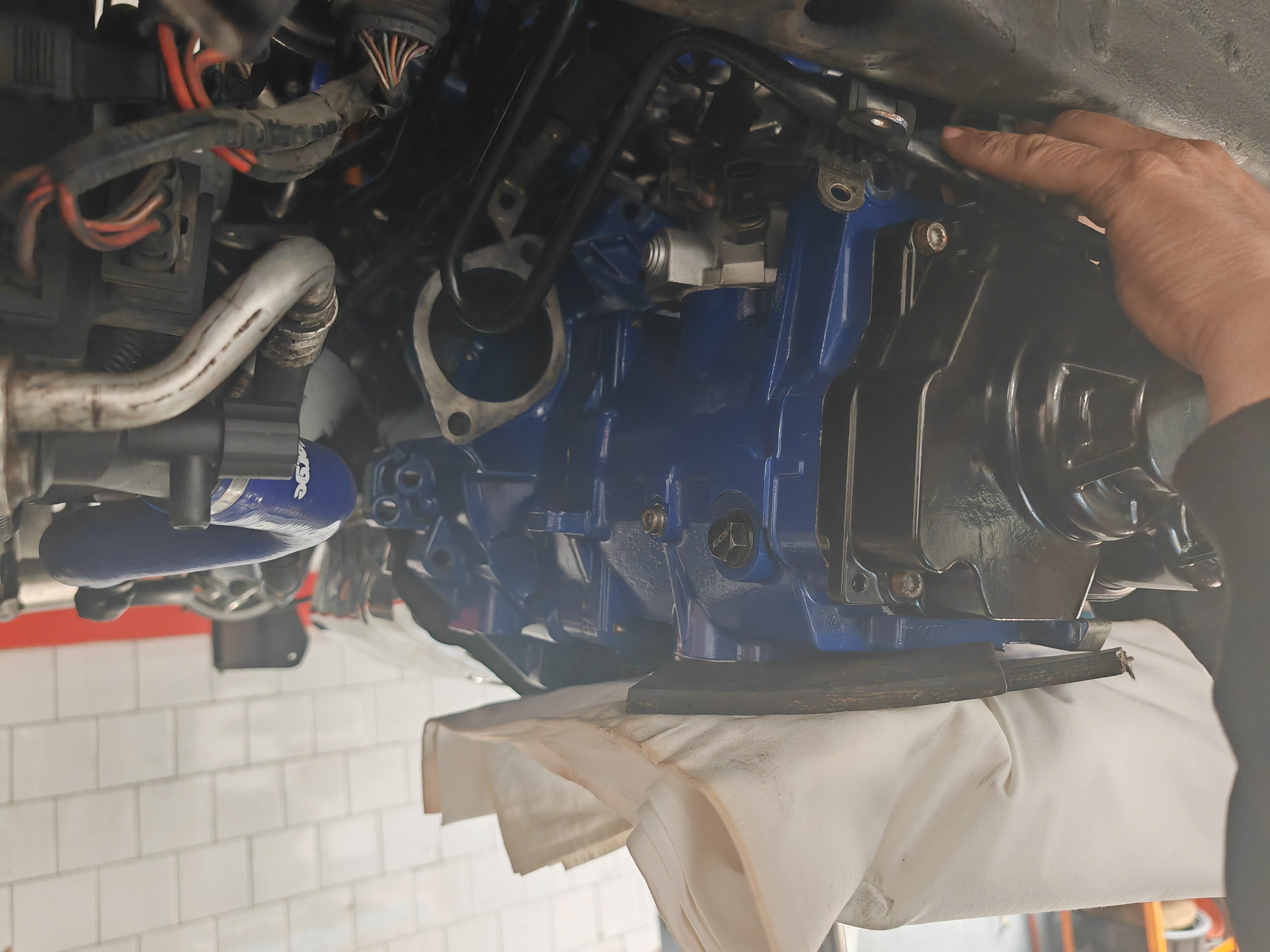

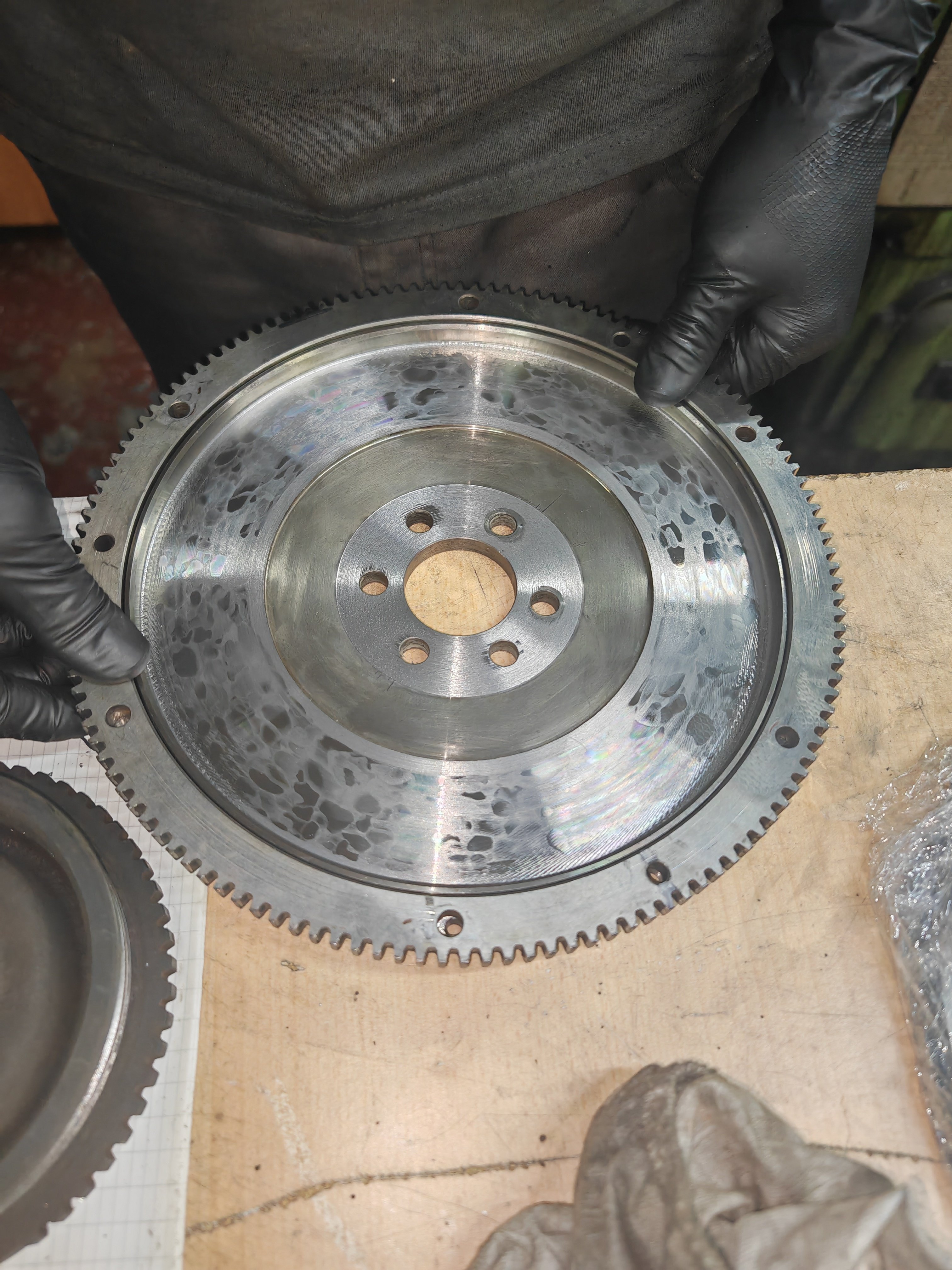

Getting ready for tomorrows scheduled tuning
Parts are ready, missing picture od input shaft brace. Will add later
ARP are 25mm long from Hammer, because 19mm ones are to short. Been running on 10.9 25x1.0 ones tll now,now time for ARPs
Edited by davojuri

And regarding quoting myself you're right. It was my mistake,I wanted to quote DubDean for his comment Great mounts to see of he has any experience with them. Corrected. Tnx👍🙂
i've not used the kw ones (do you have a part number?) i've used the silver project ones years ago
They are the same as my old Ground Control that was the first one to make them.

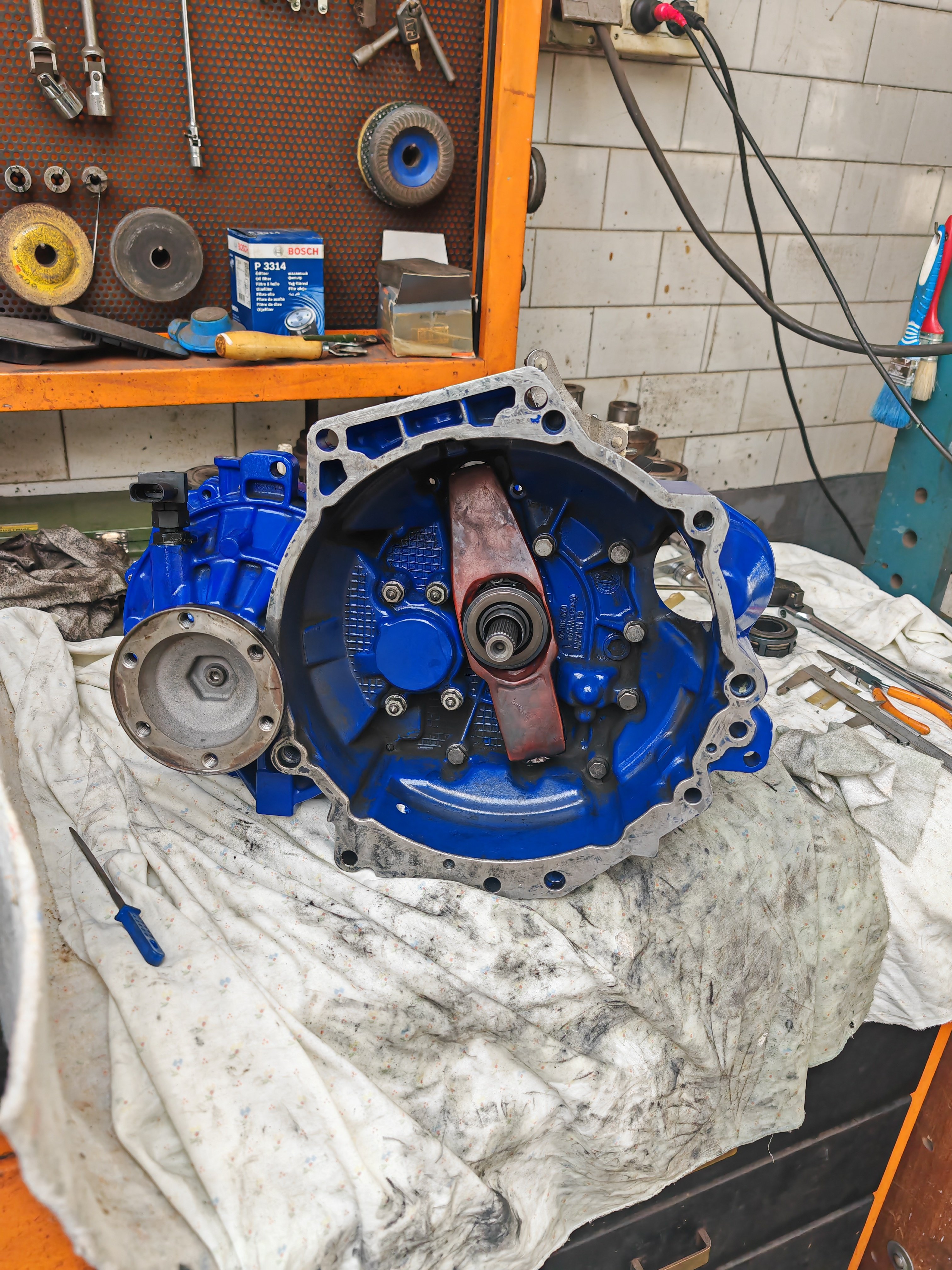

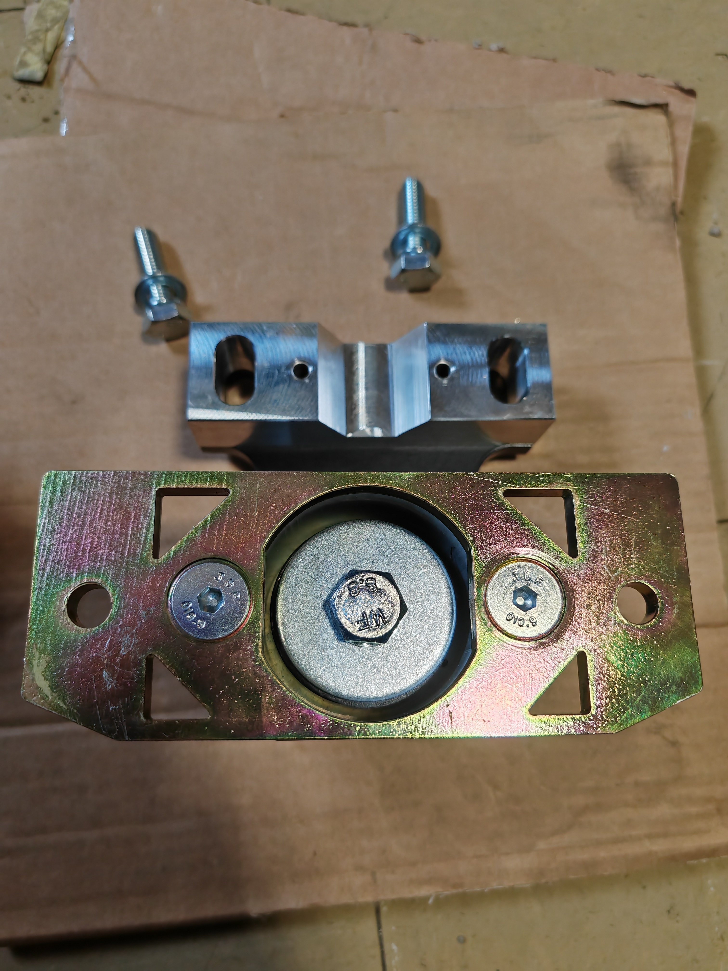

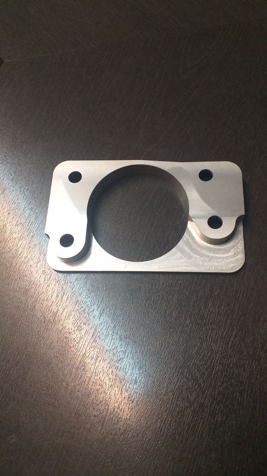

Here is the pinion shaft brace which allows for 800hp-tested,and my internals are already reinforced. If you go back to my gearbox assemblly in Cacak Serbia, 10 or more Pages back you can see it
Edited by davojuri
That means i Will have clutch and gearbox capabble of 700Nm plus, ready for the last step: forged,stroked, CNC ported, ceramic coated, big turbo, new engine.
i've used the AKS pinion brace from VRS Northampton version of this for a good 5 years now since getting the Wavetrac diff fitted

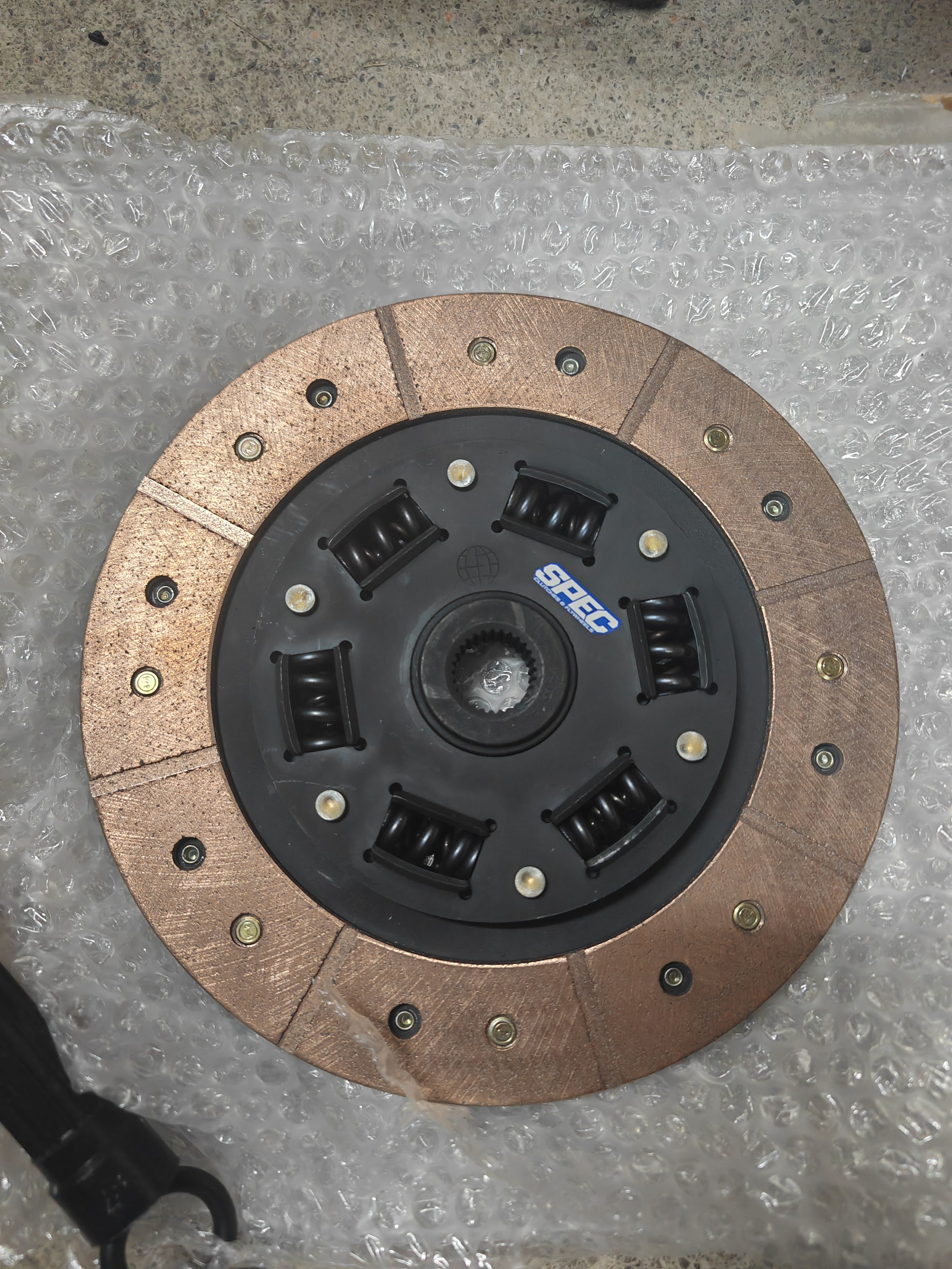

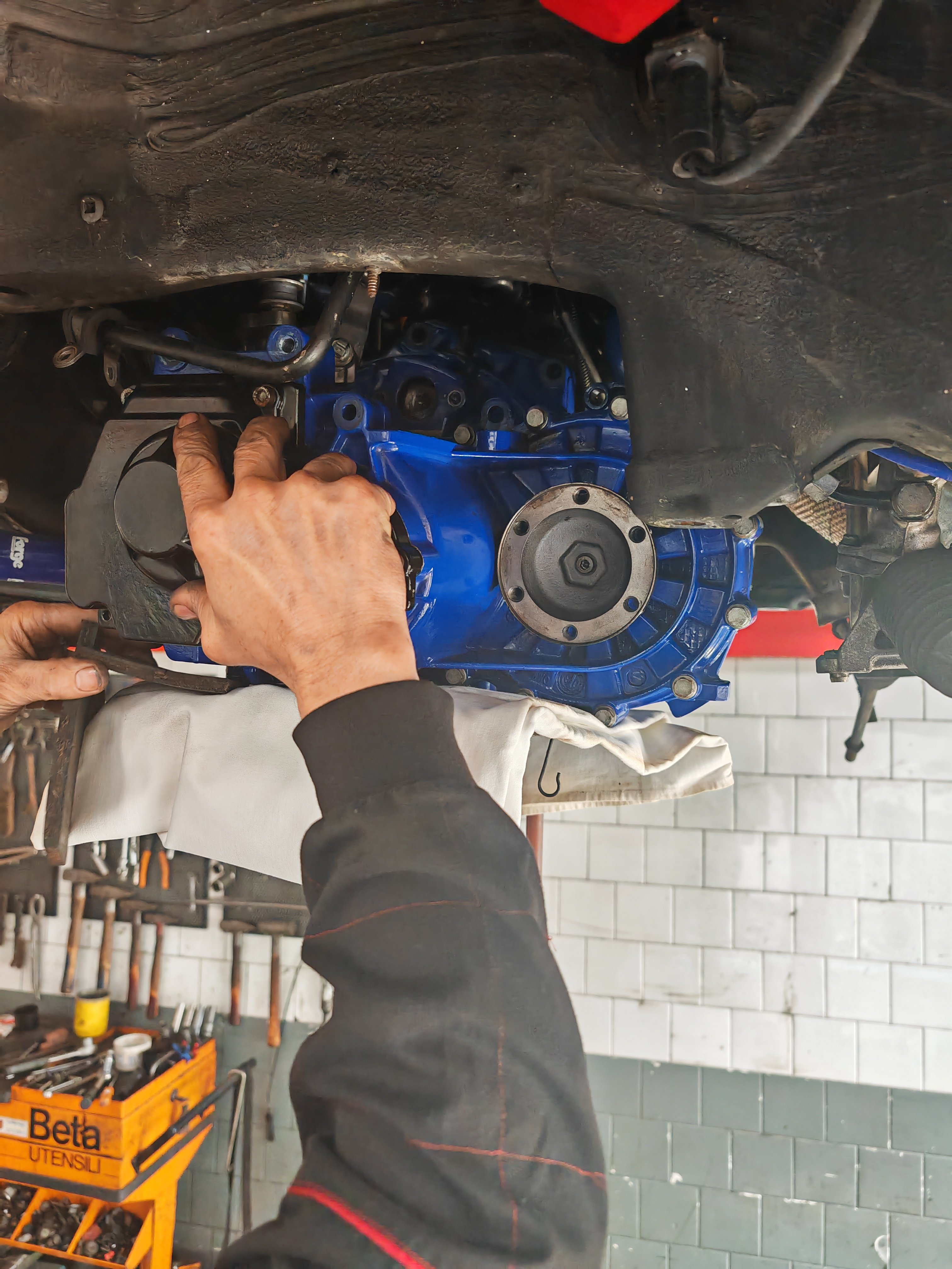

Work in progress

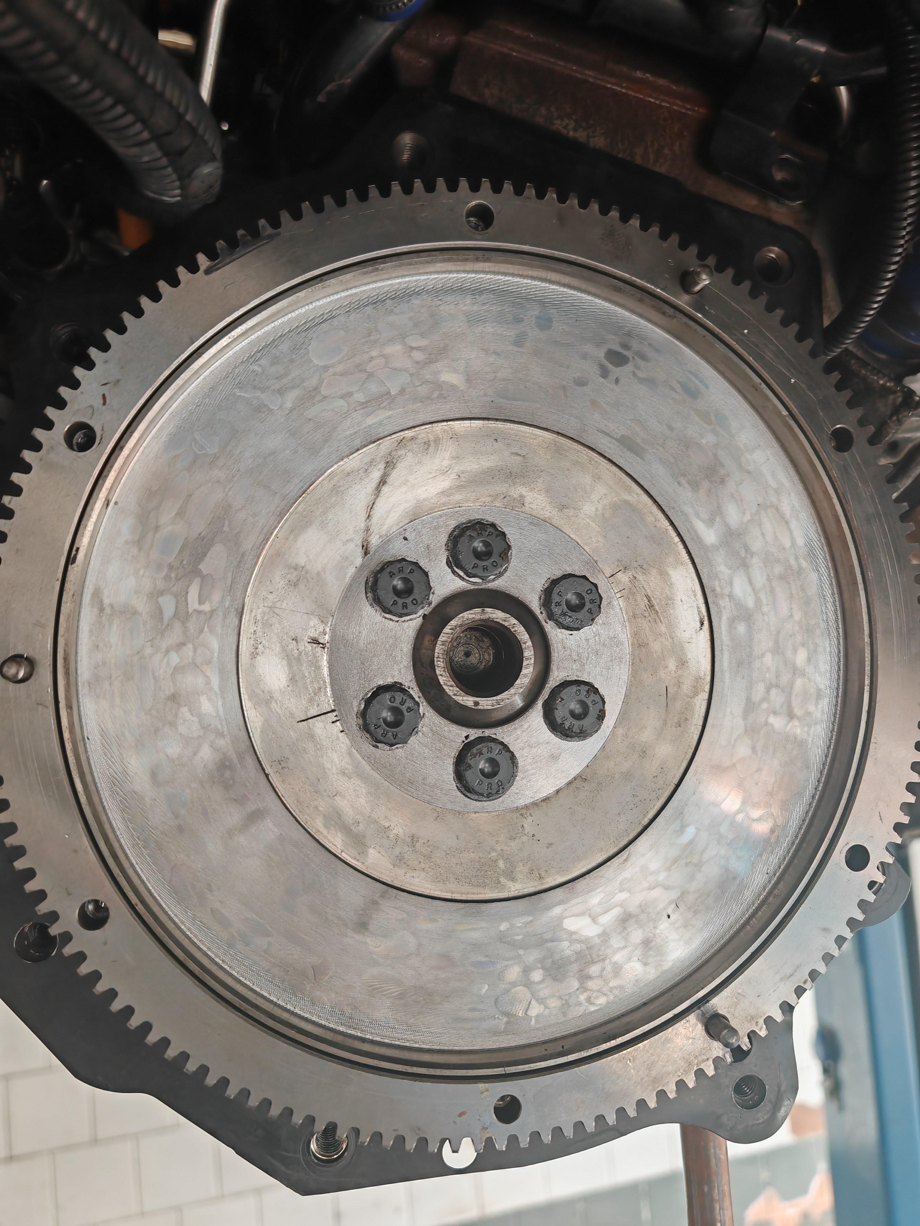

Flywheel un place with 25mm x1.0 ARP bolts torques to 70 FT lbs, friction disc and pressure plate to,checked if it releases, and it does.
