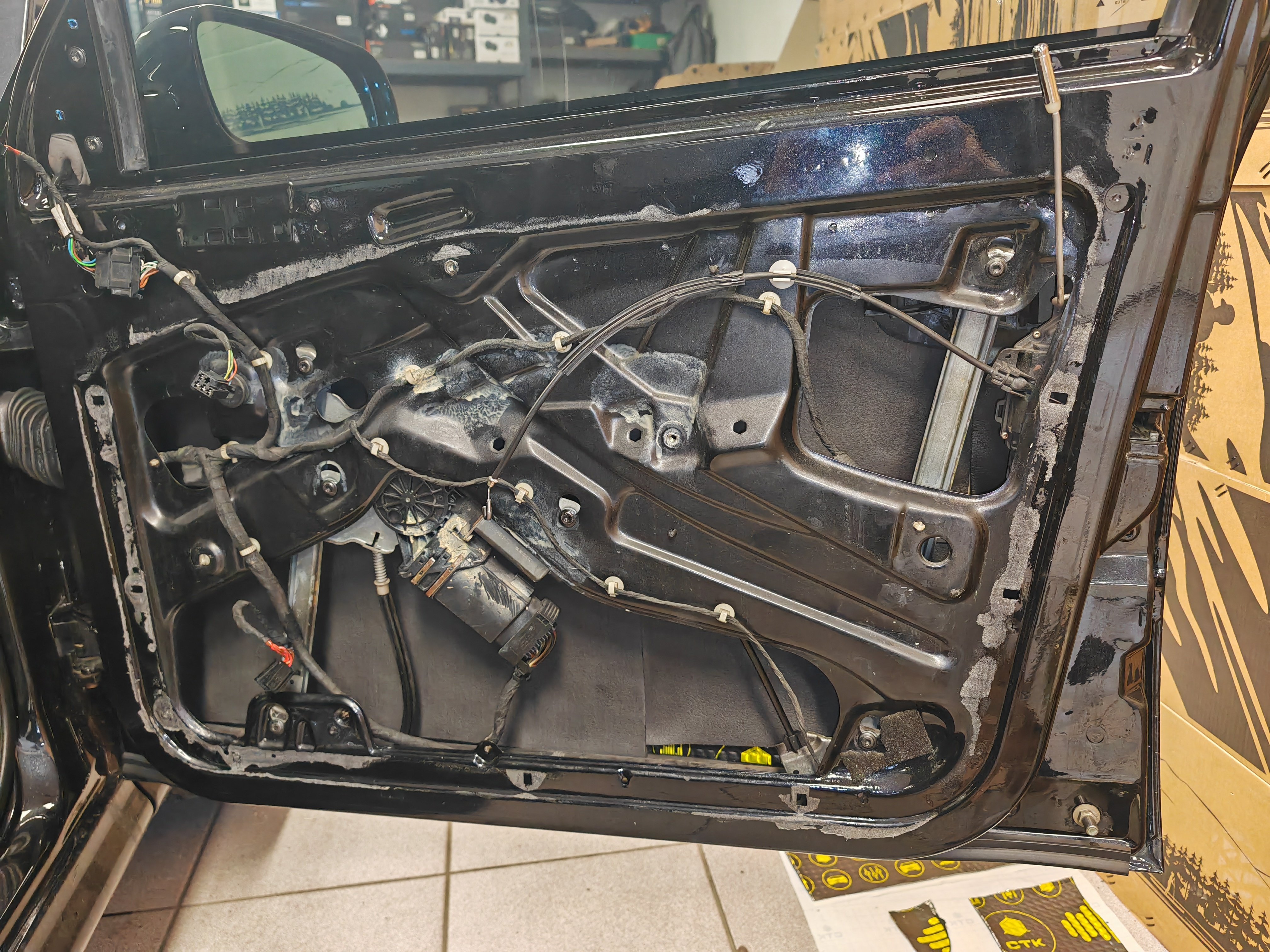

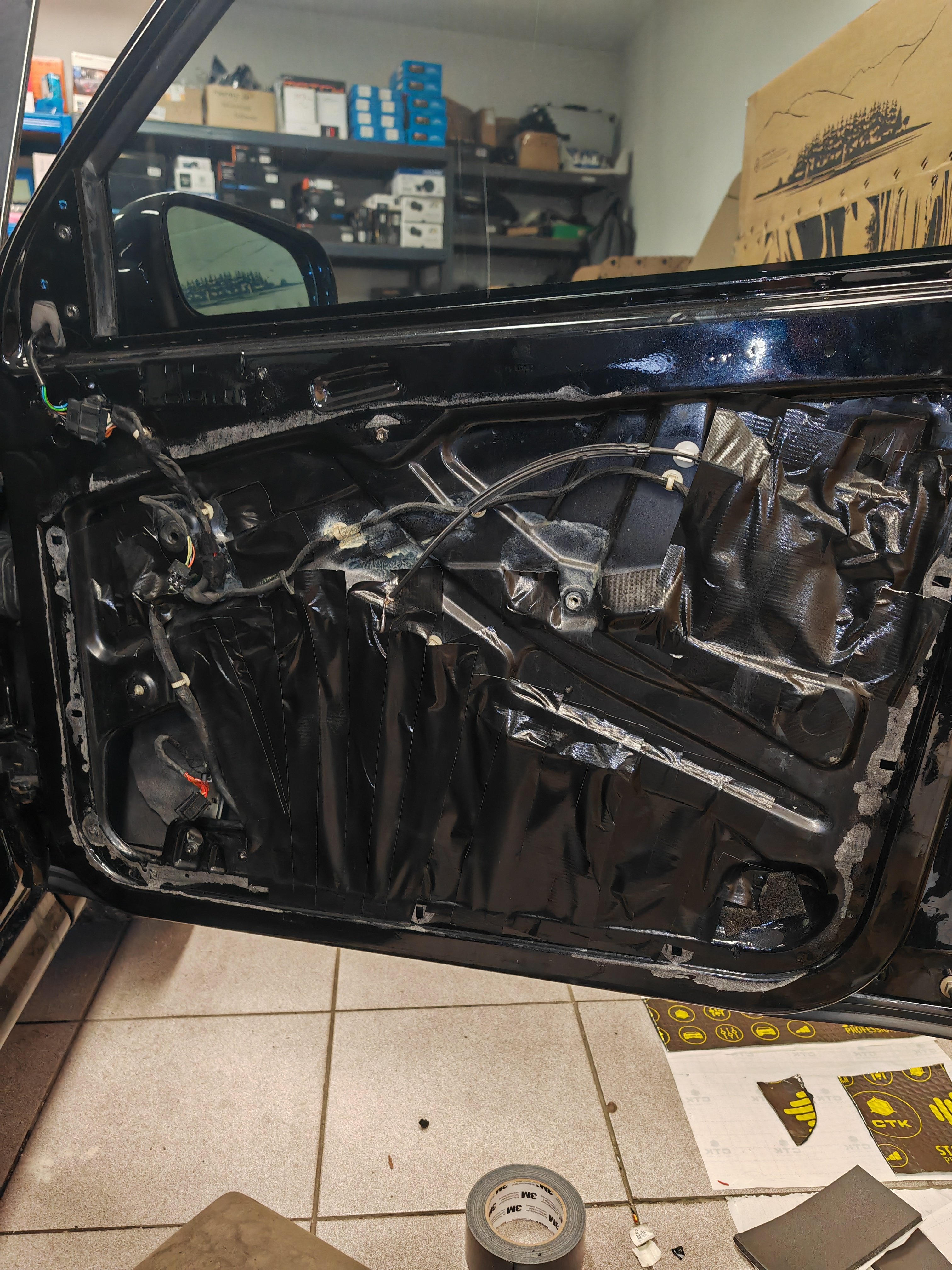

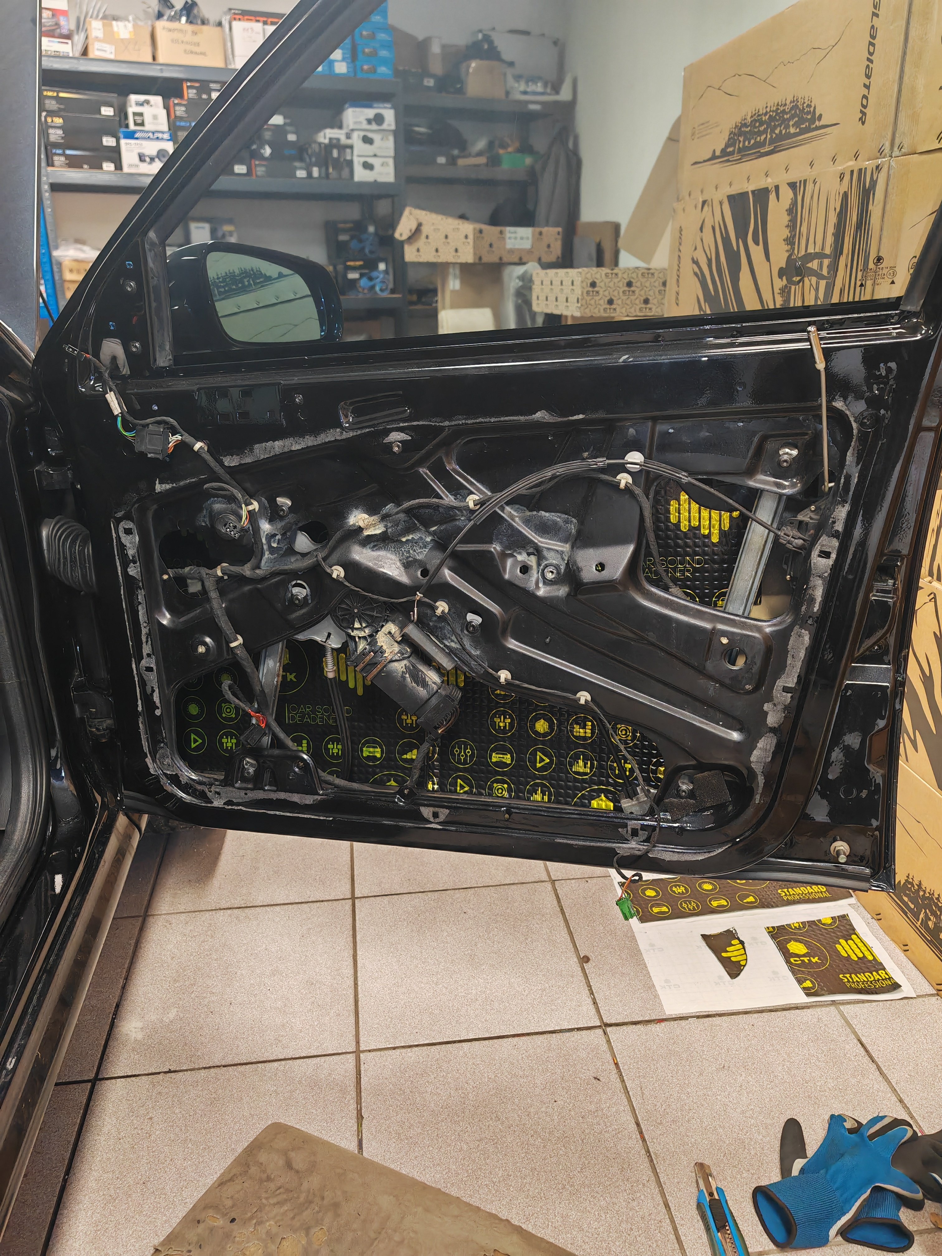

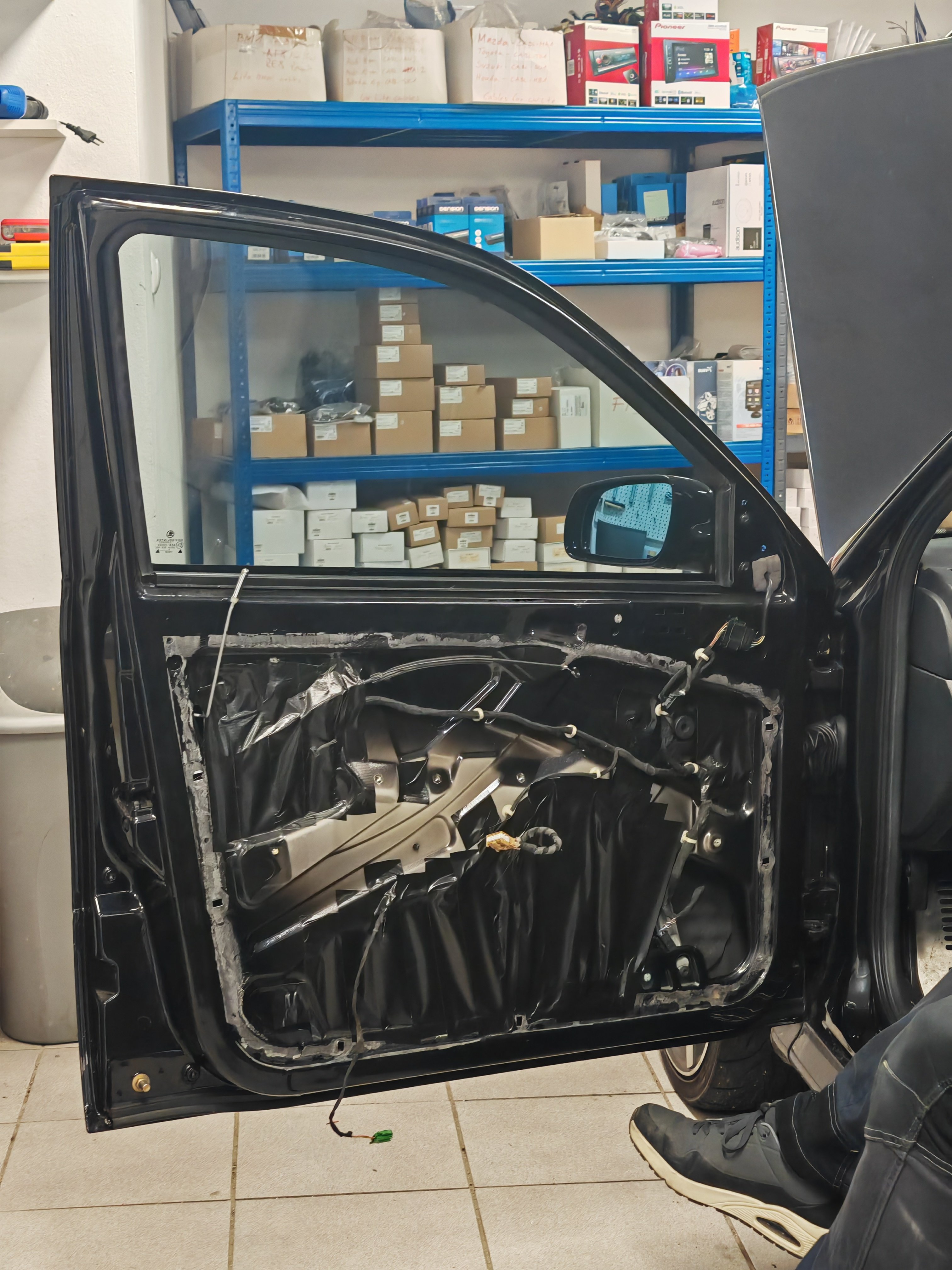

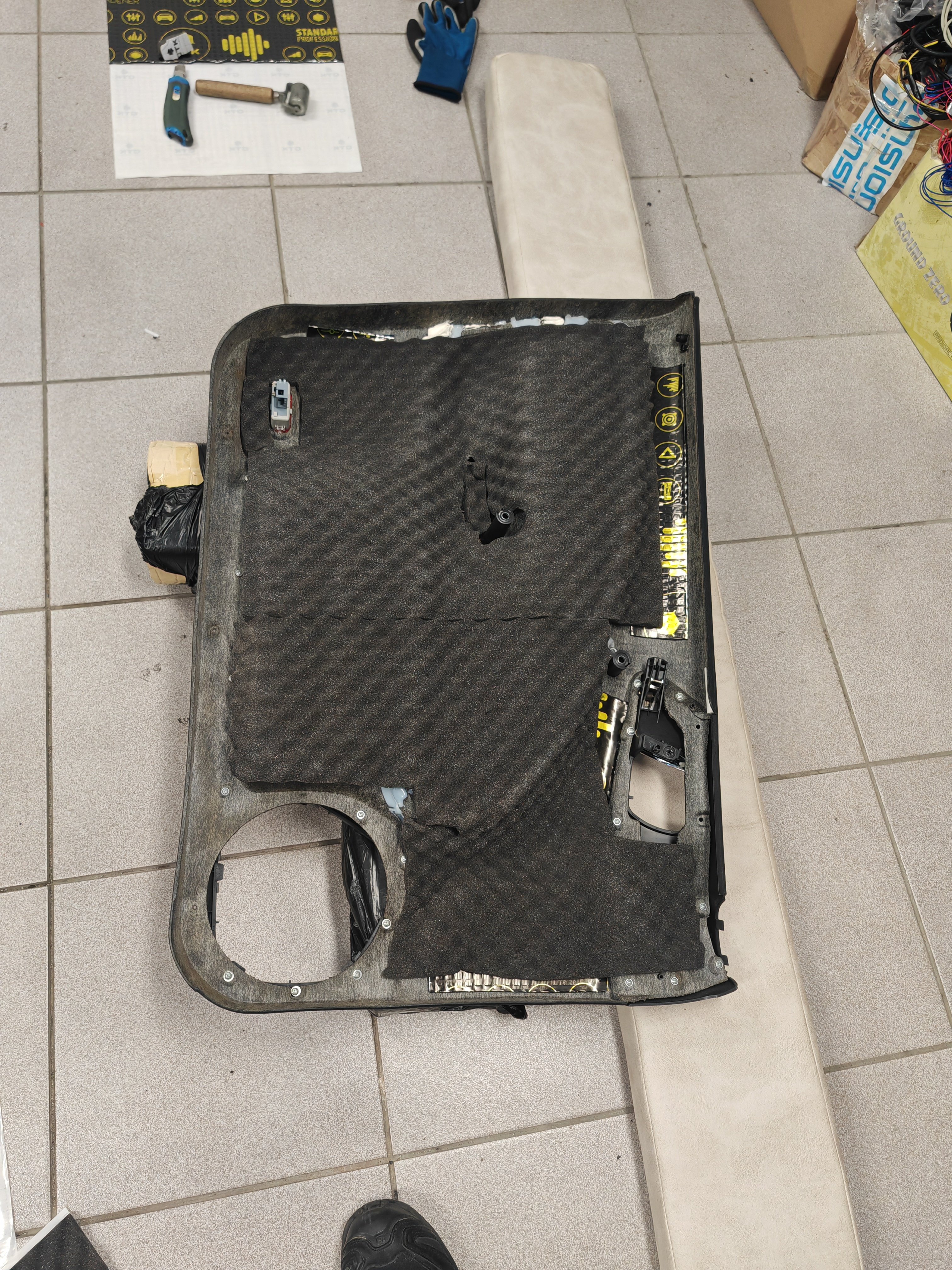

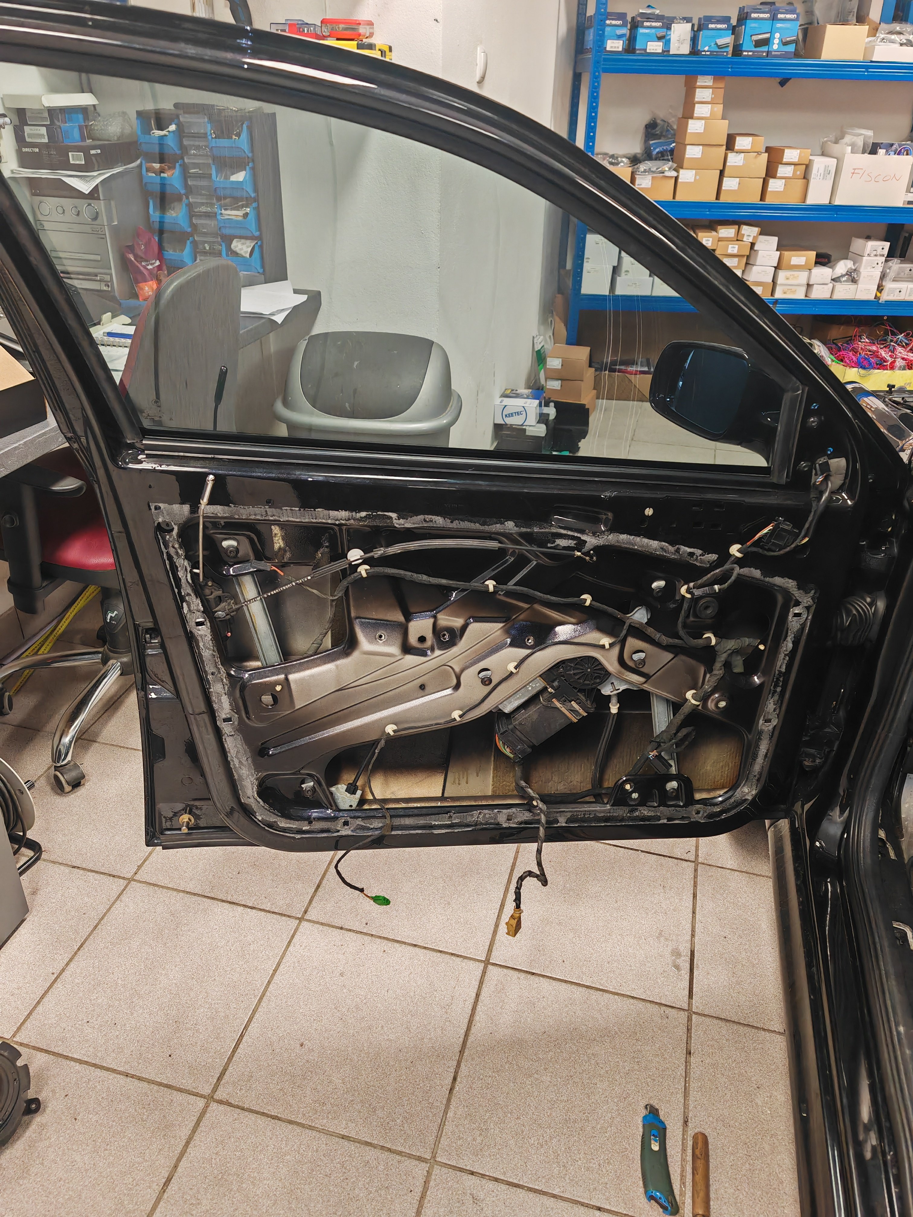

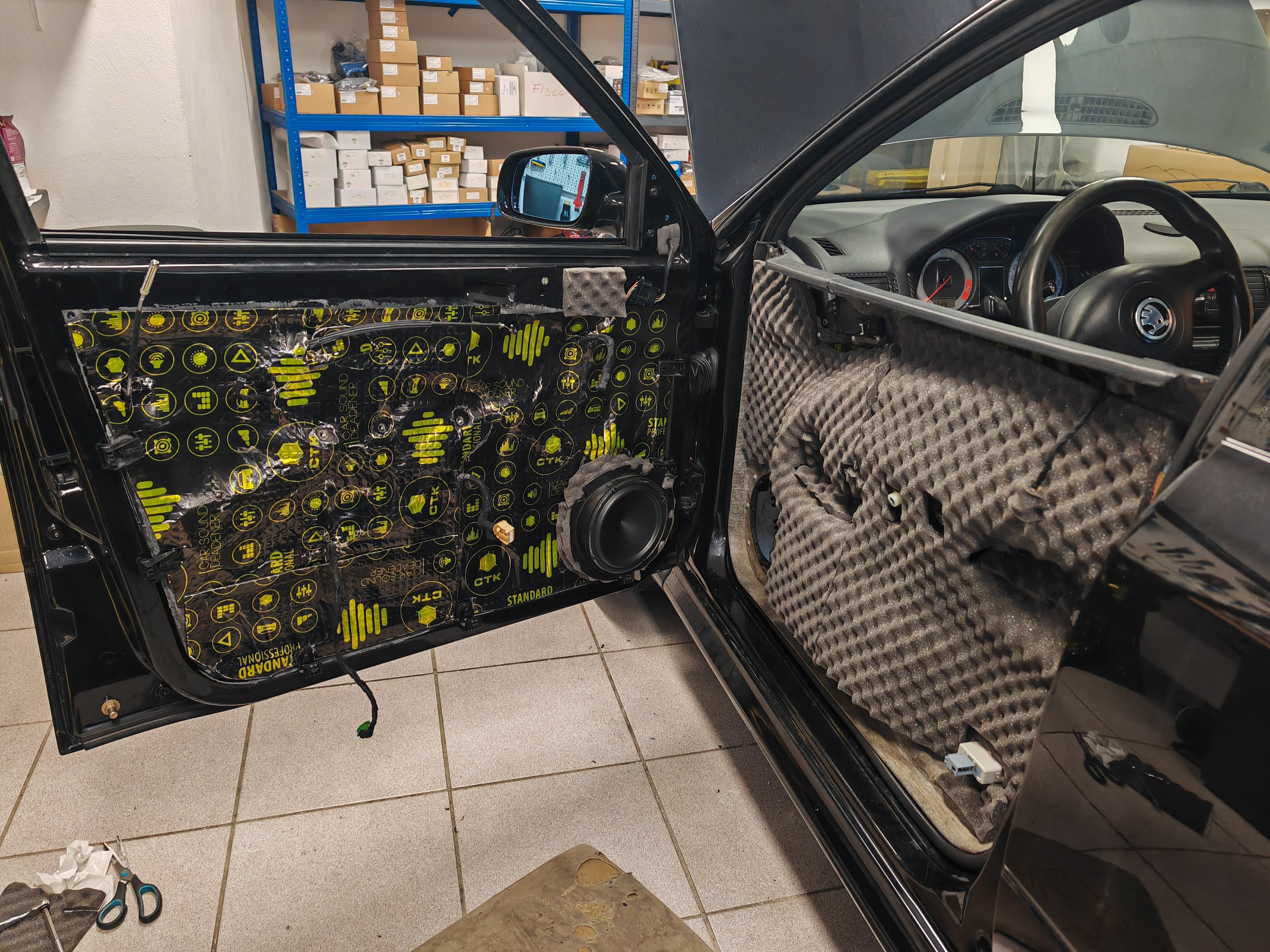

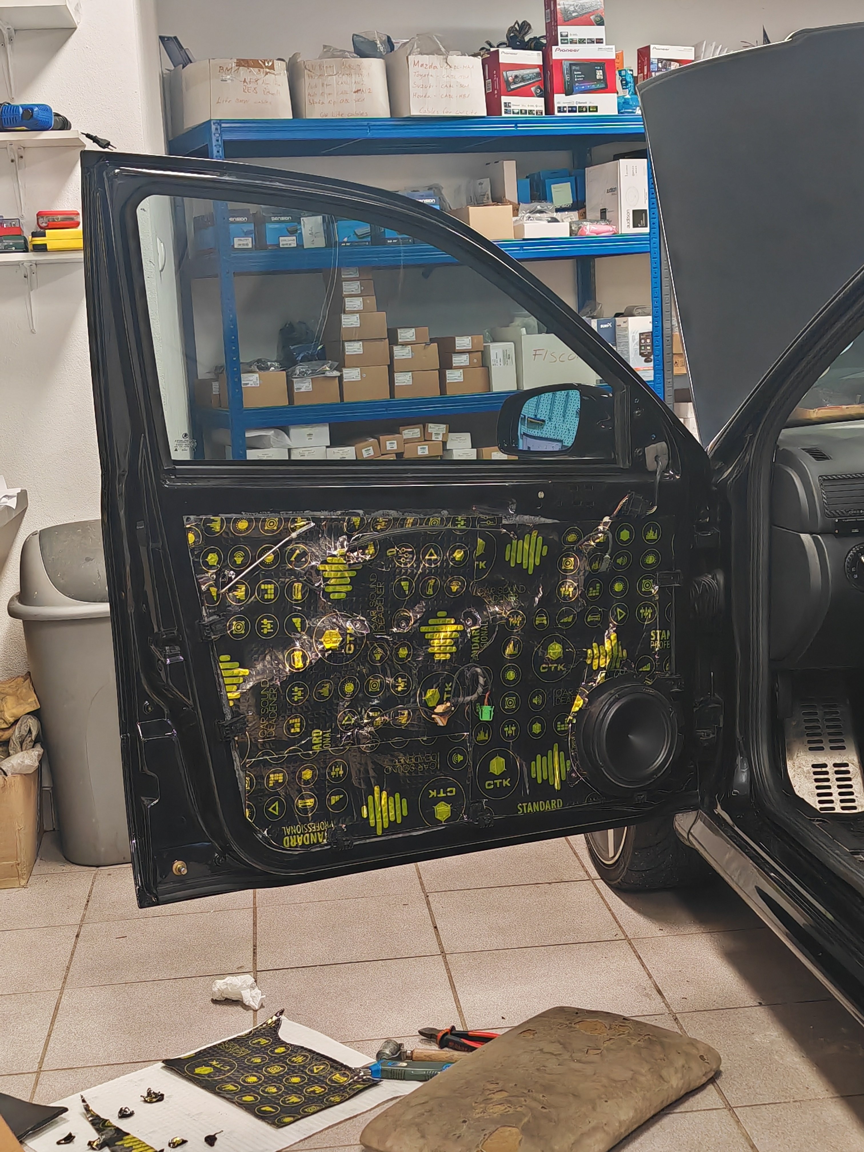

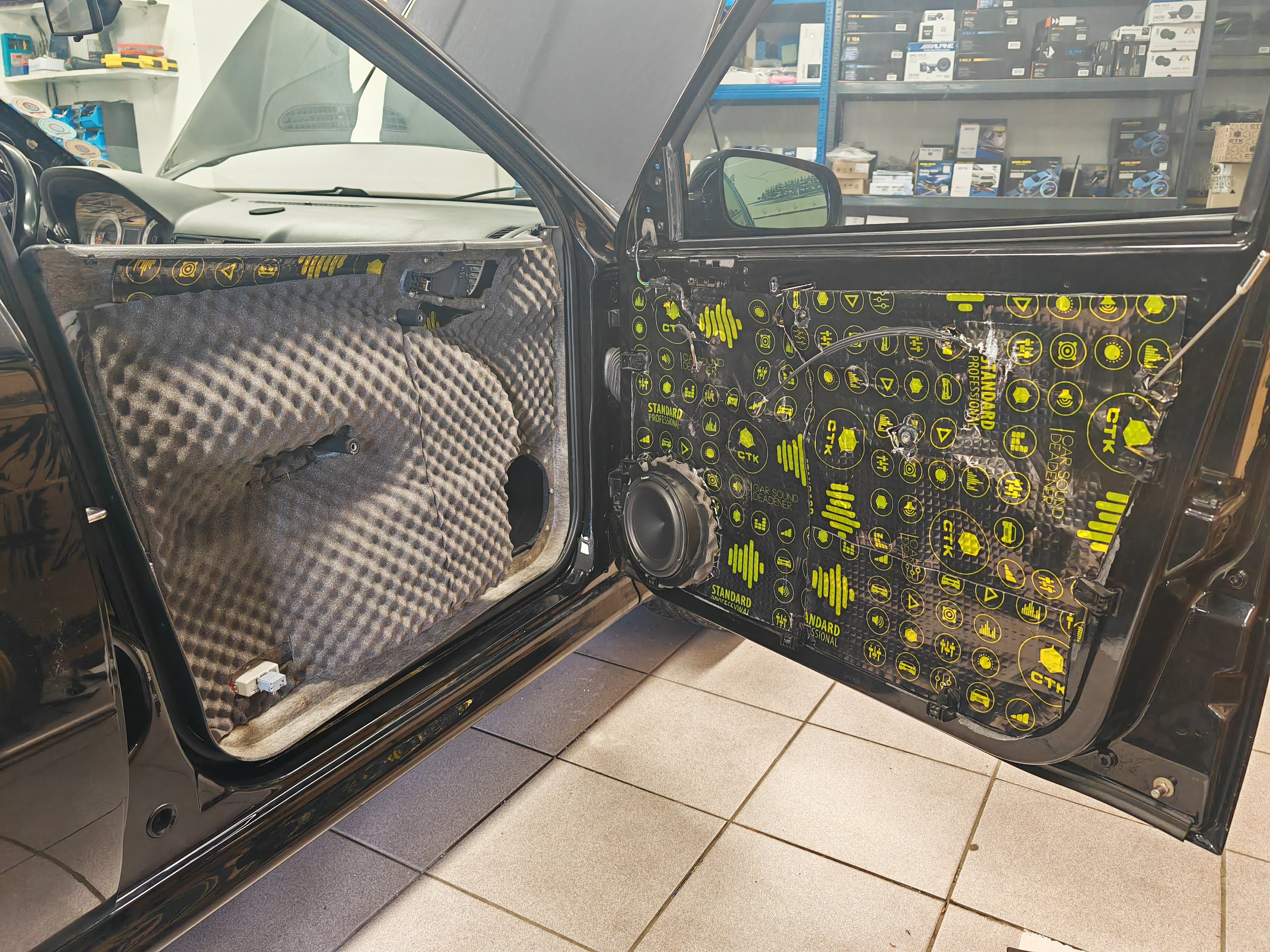

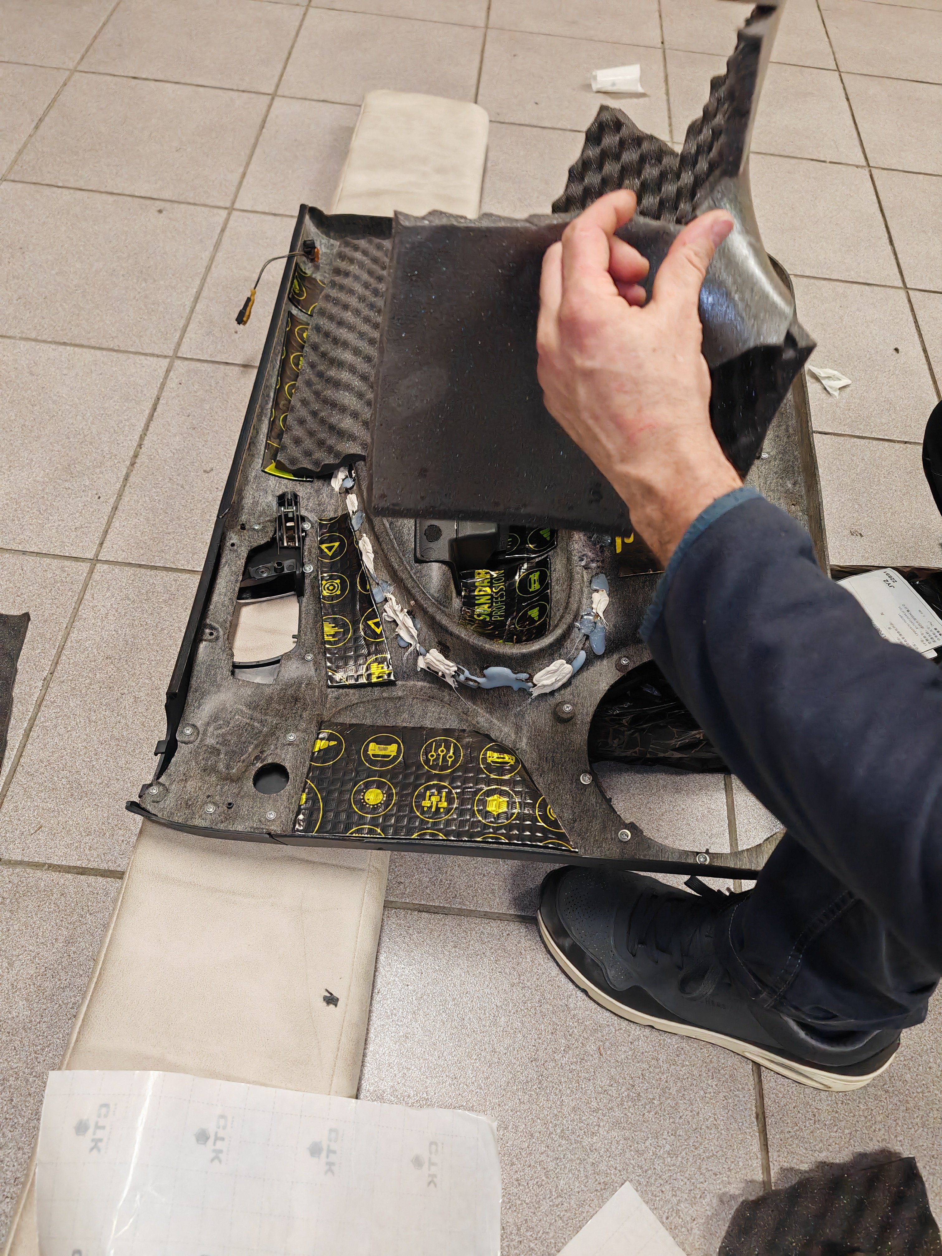

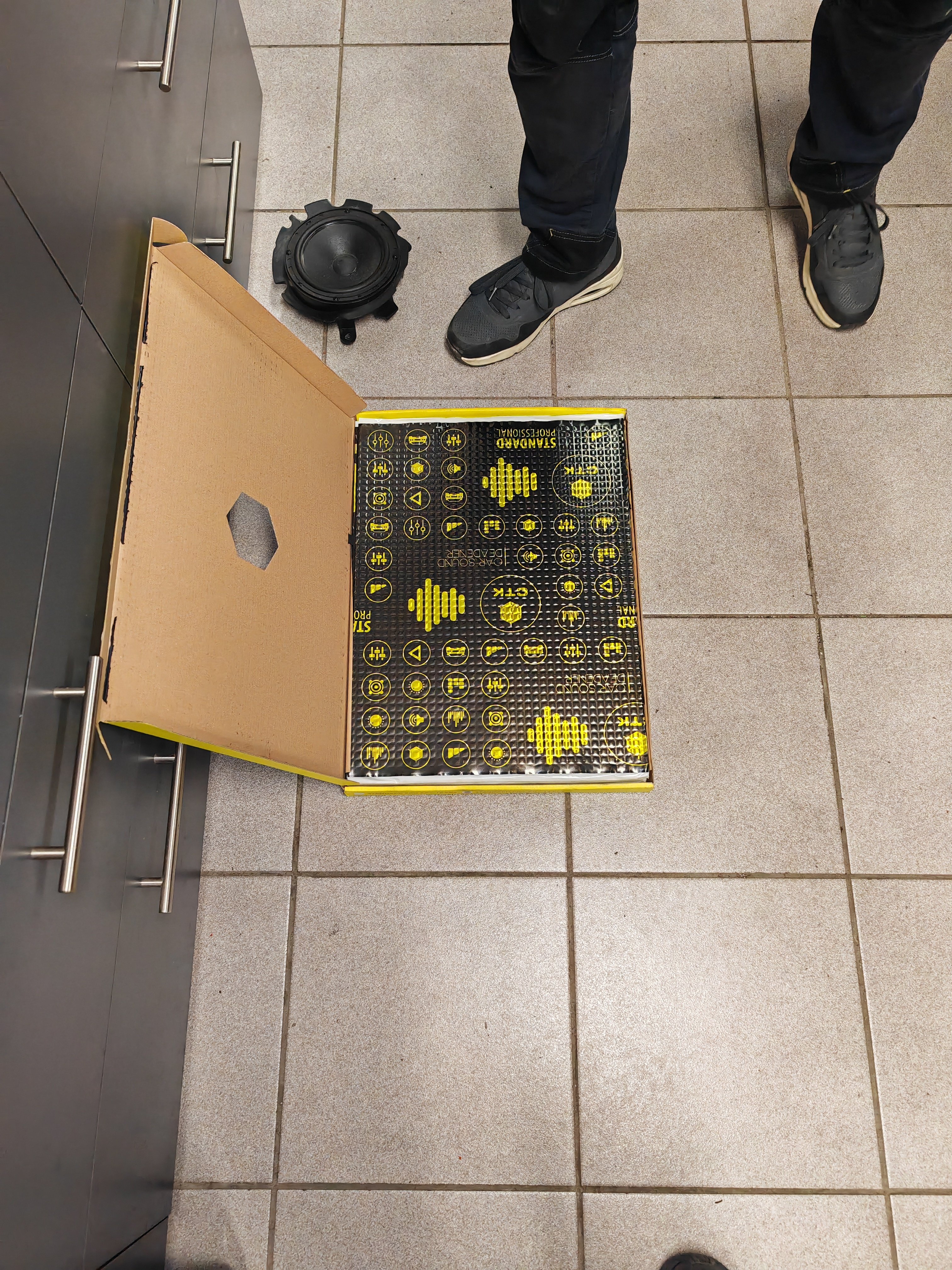

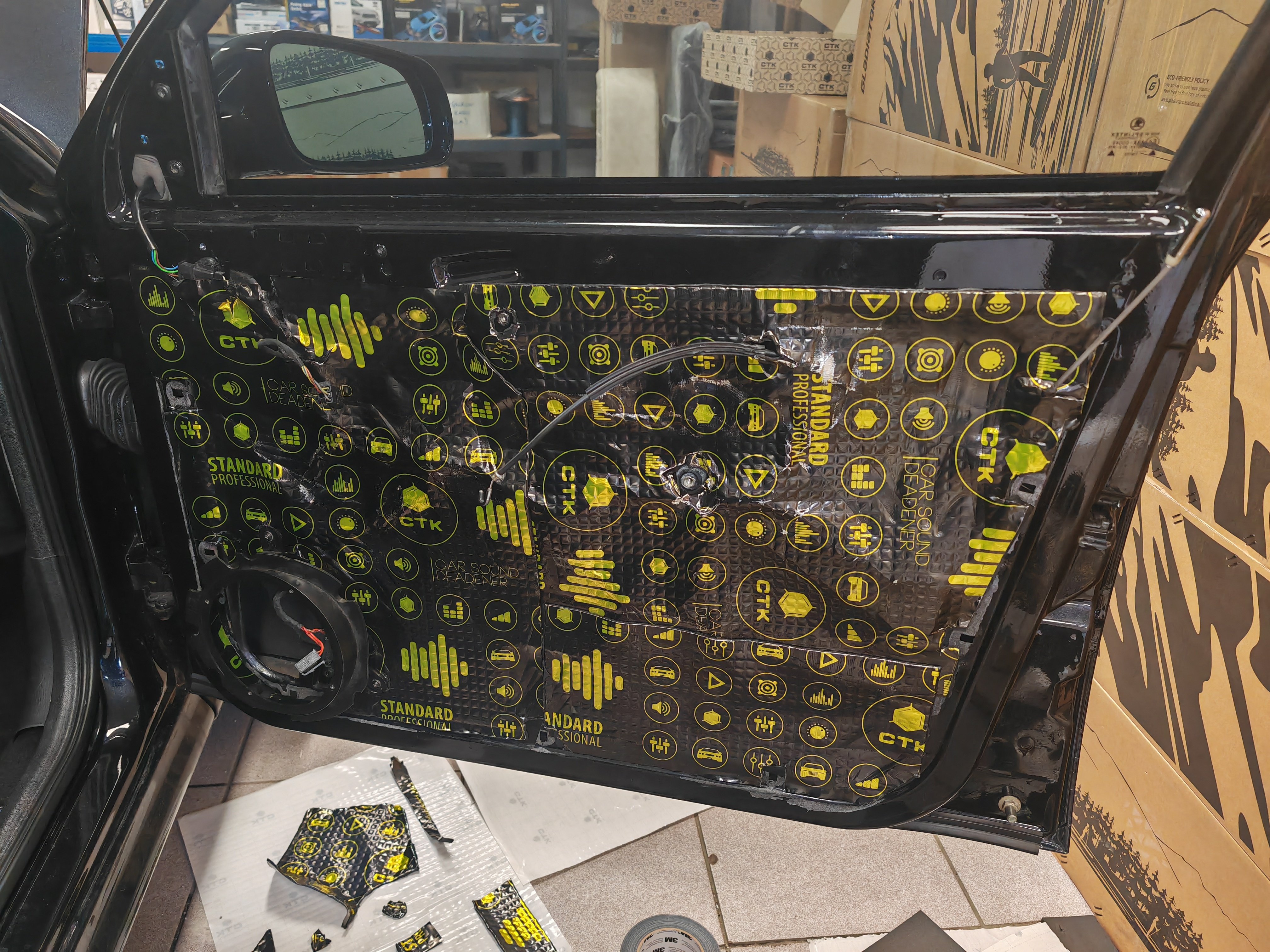

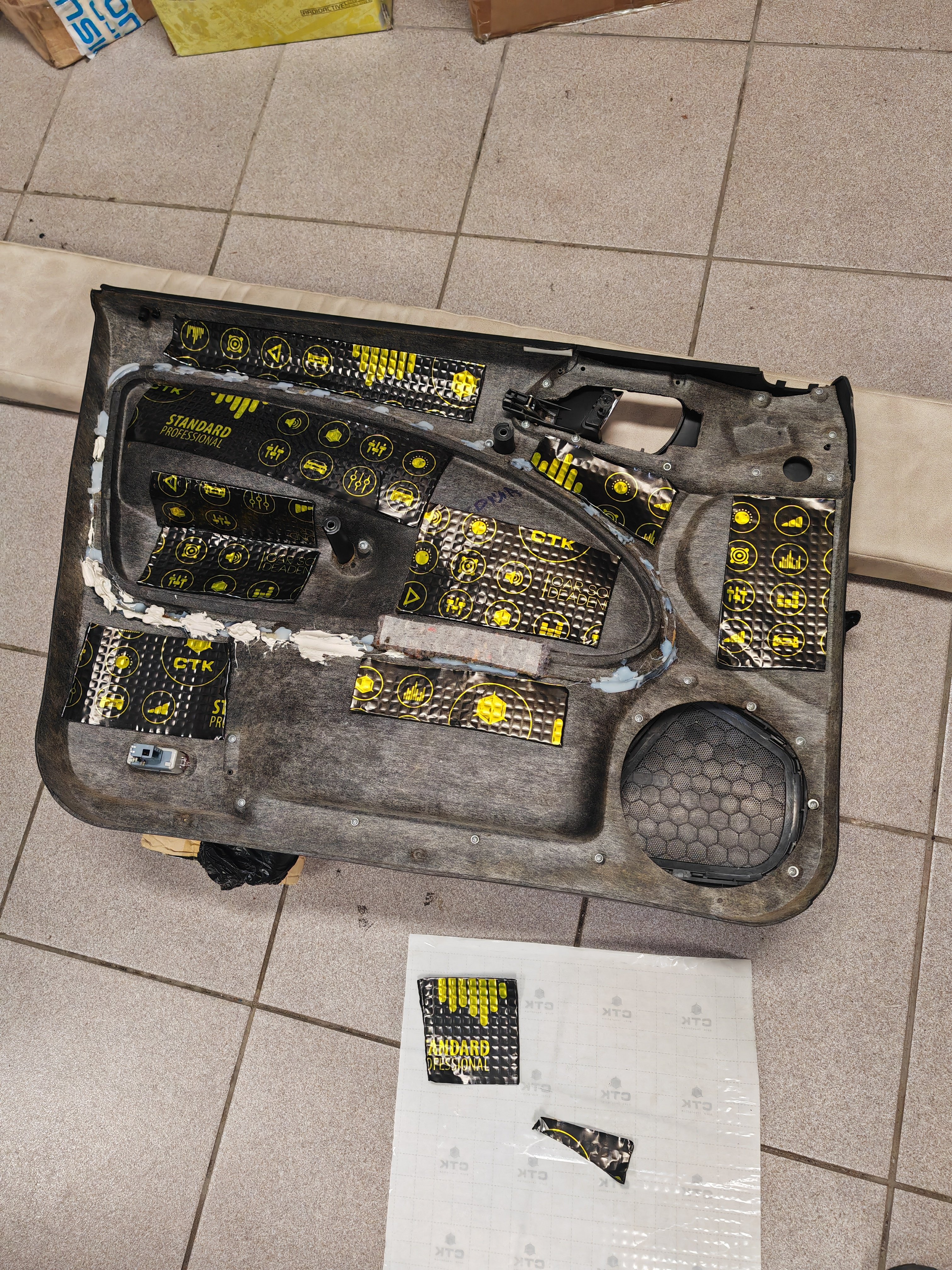

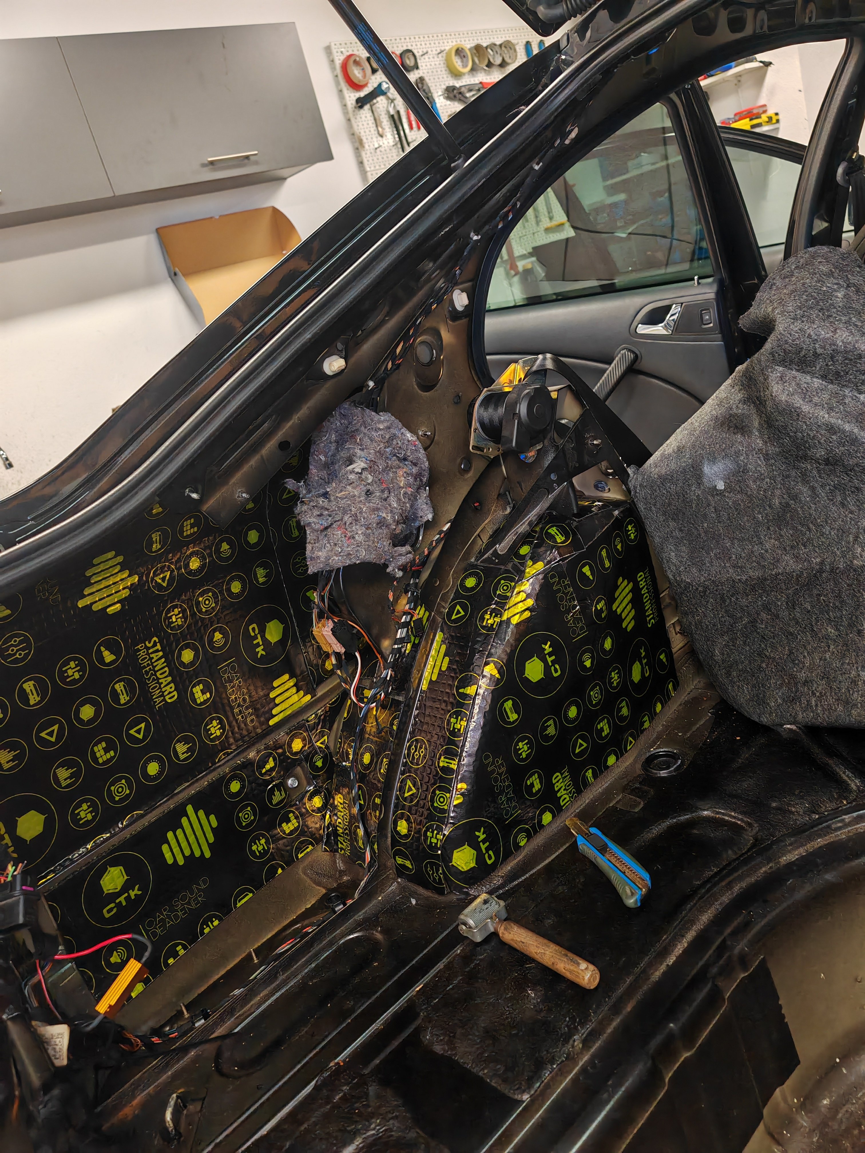

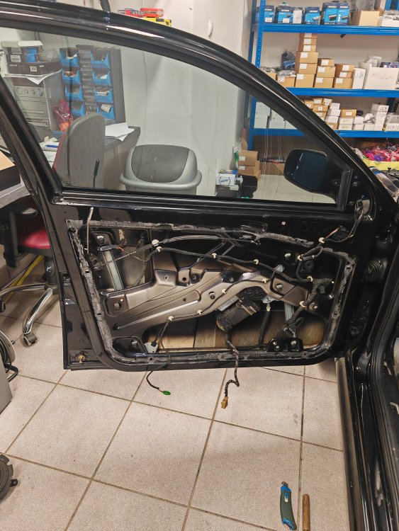

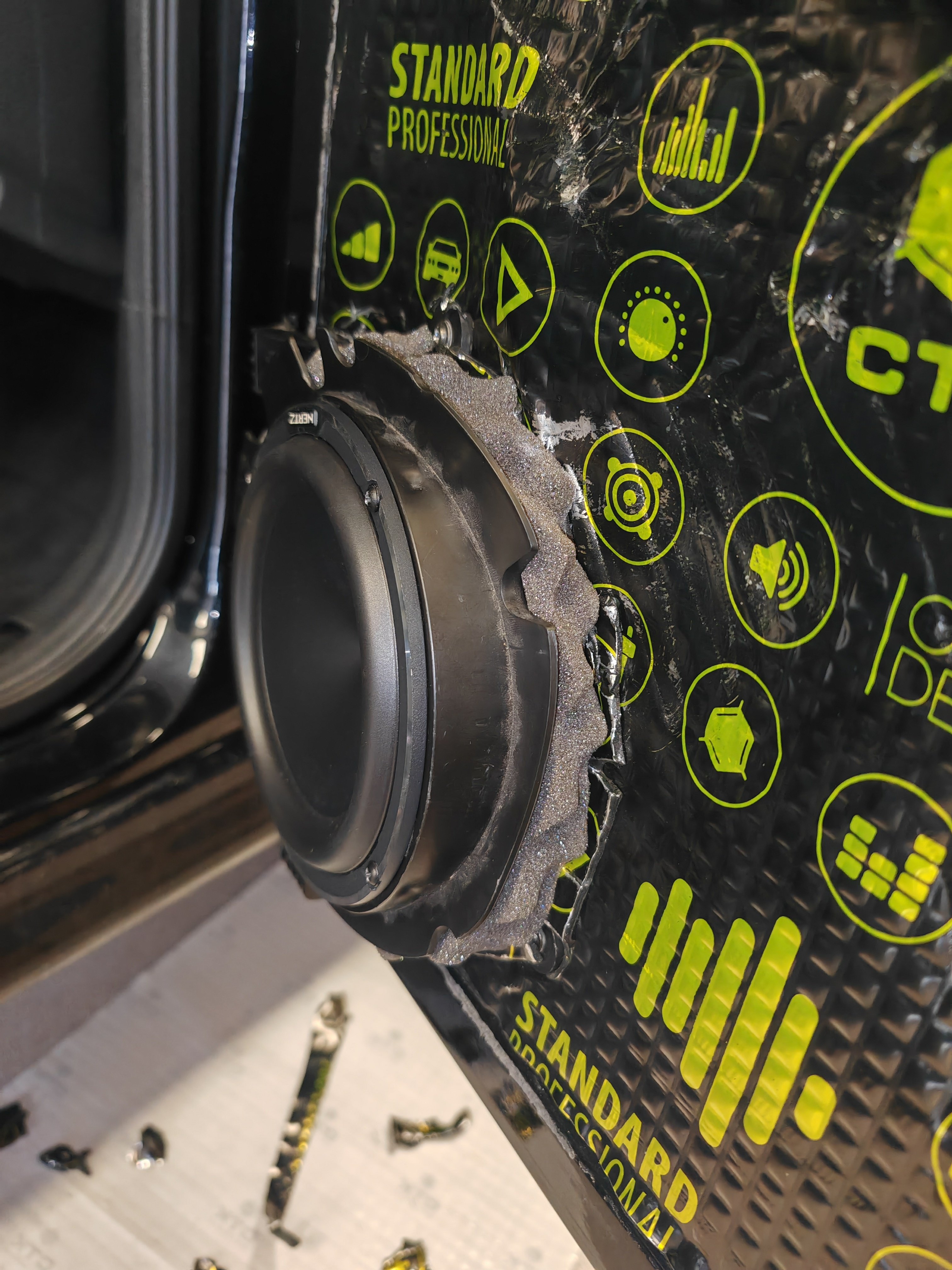

IMG_20240212_094759.thumb.jpg.1c9d55778b9eac3ea10d646a9ee934ec.jpgFL door dismantledIMG_20240212_094810.thumb.jpg.b67088fdcdfec43b8f277c696ebbca56.jpgFR door dismantledIMG_20240212_094817.thumb.jpg.4149368f828fbe7c76a62812236eb650.jpgButyl standard proffessional insulation better than profi one because of better adhesive propertiesIMG_20240212_101548.thumb.jpg.bbcf4e26a93f441731cbd583464132dd.jpgFR door first butly layerIMG_20240212_102944.thumb.jpg.1373437ec463785327ebc8a21aa24531.jpgFR sexong sponge layerIMG_20240212_112051.thumb.jpg.1f34753f95e918da7e80c5ffa801b3e3.jpgFL 3M duct tape for holes closureIMG_20240212_114734.thumb.jpg.4cda739d47123fcb539414d396c57dda.jpgF3 3M duck tape holes closure because during hot sumer time it loses its property due to jest expansionIMG_20240212_123838.thumb.jpg.3e2d7669da4cbda090ed82e2a7aa682a.jpgFR thrid butyl layerIMG_20240212_141310.thumb.jpg.bafe01be6e90a5ba0dc1022e6e83d3af.jpgFL third butyl payerFL door first inner butyl layer

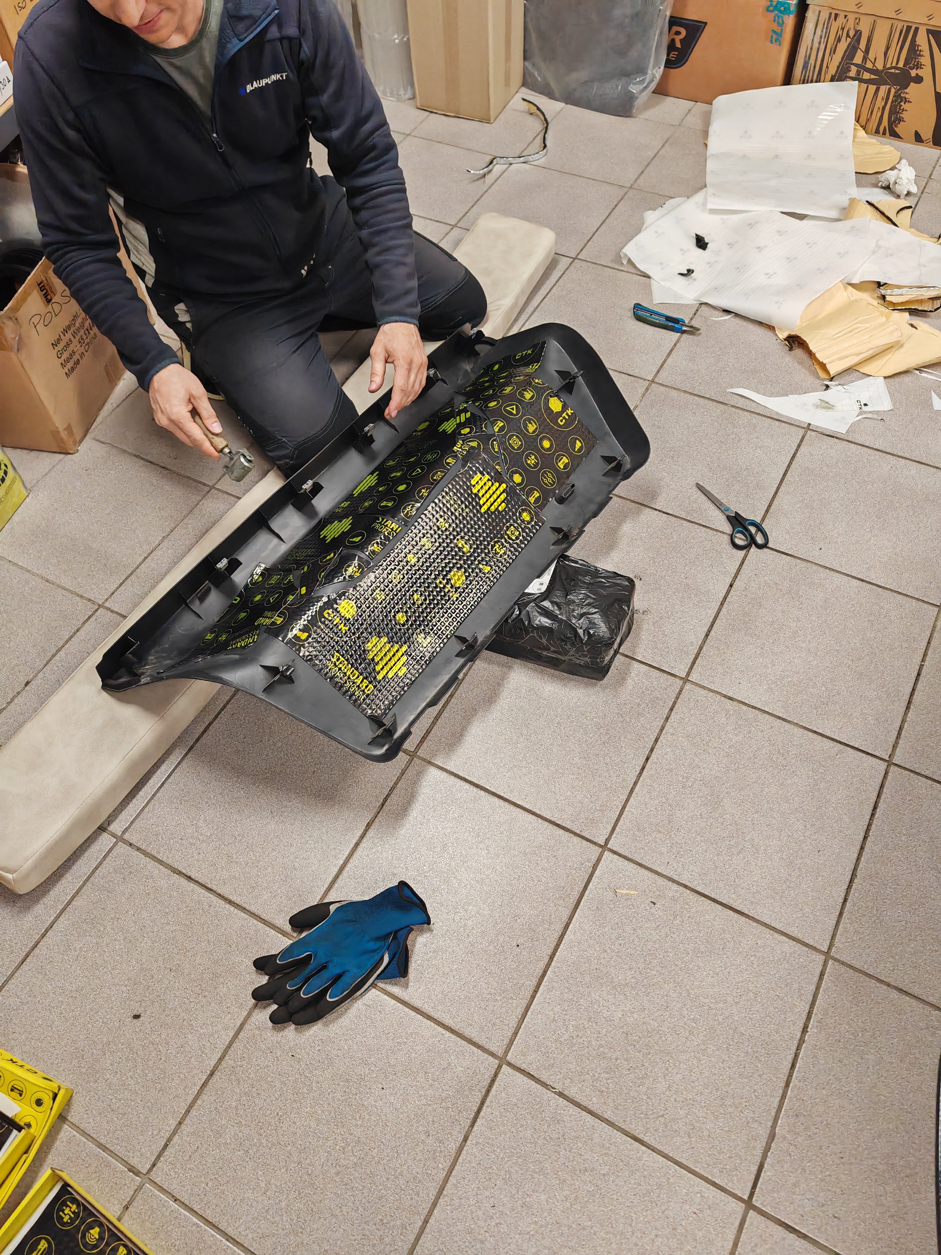

First butyl layer on door pannels and second CTK wavefix
All together 5 layers on the front and all rear doors.

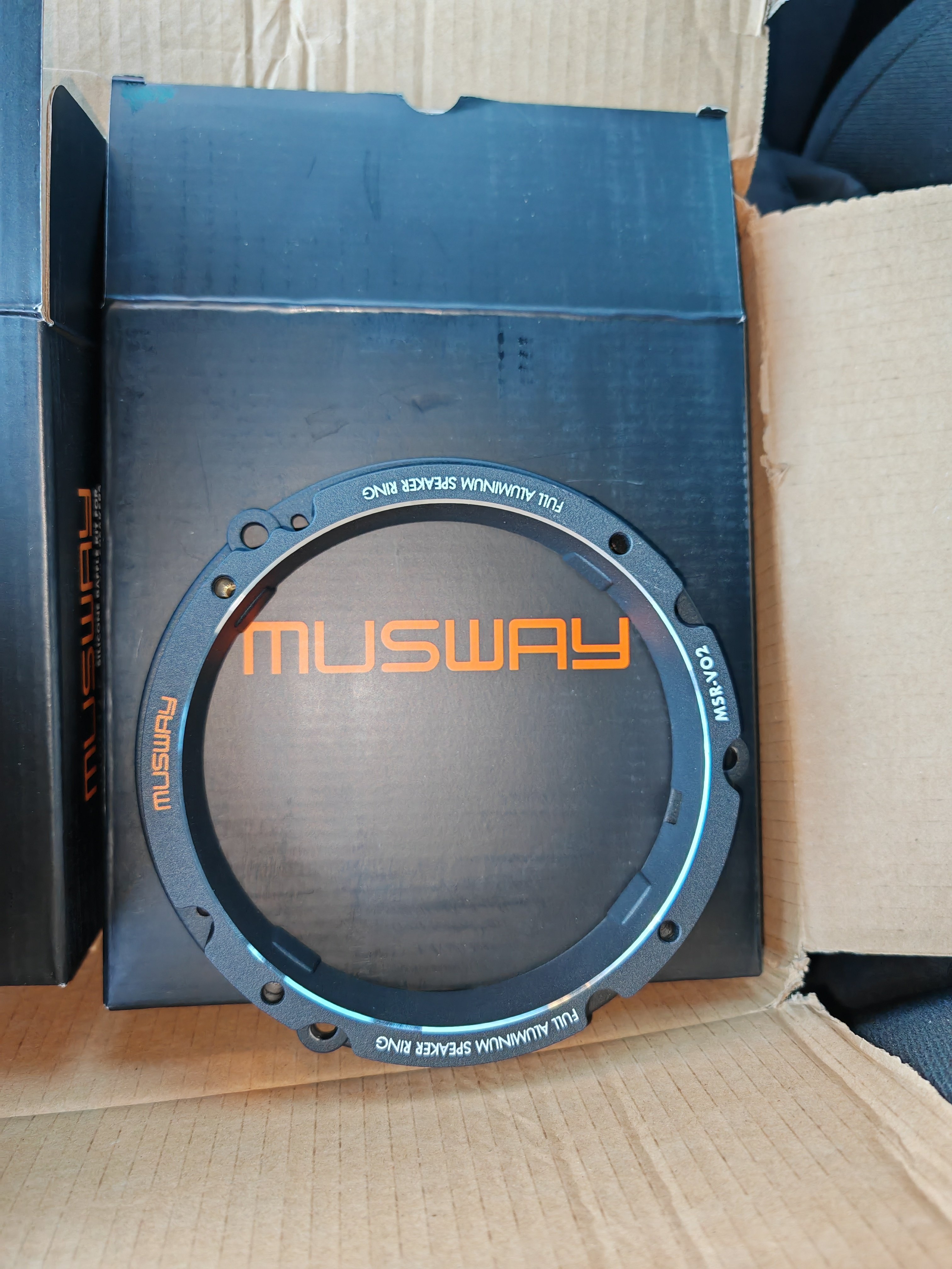

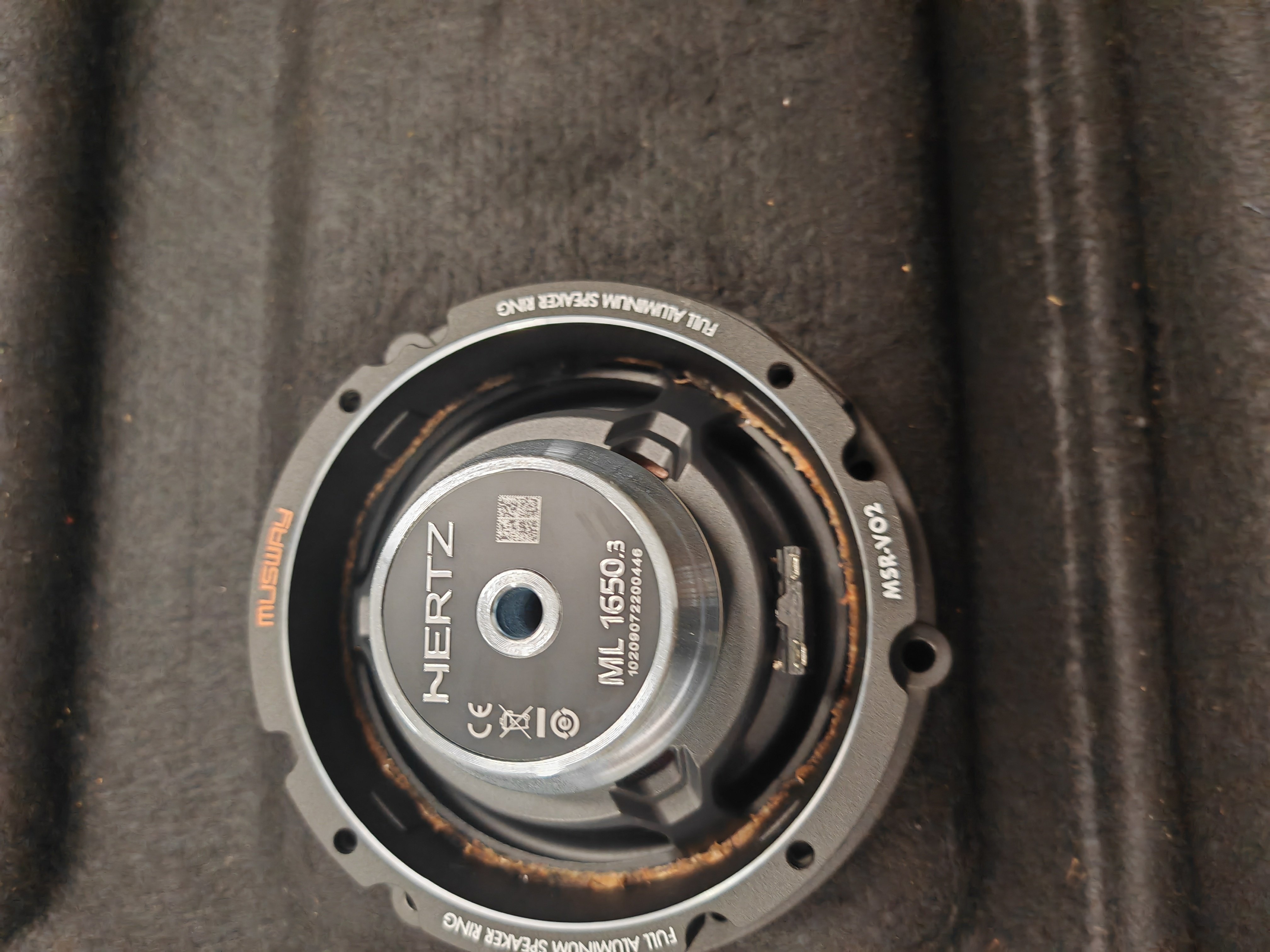

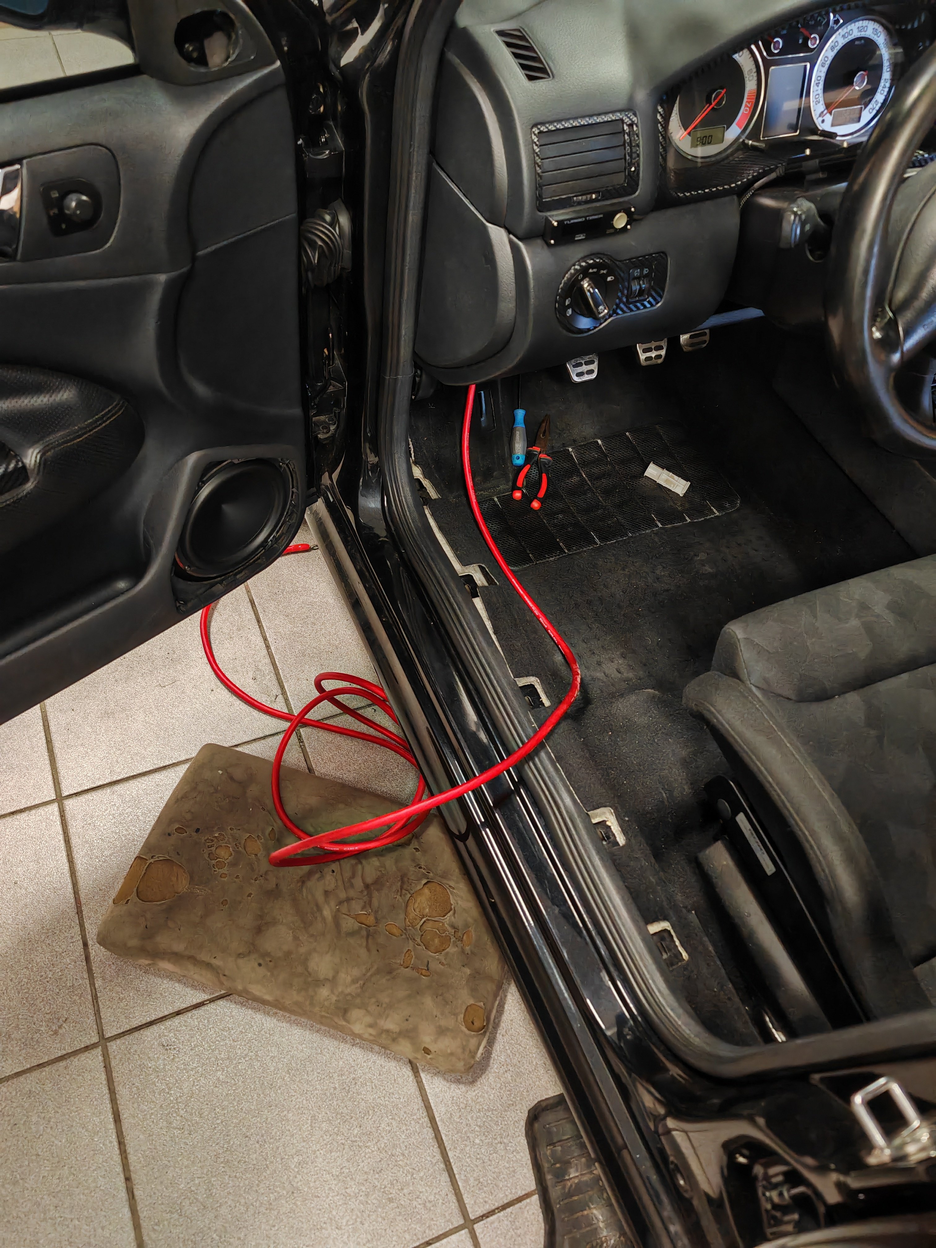

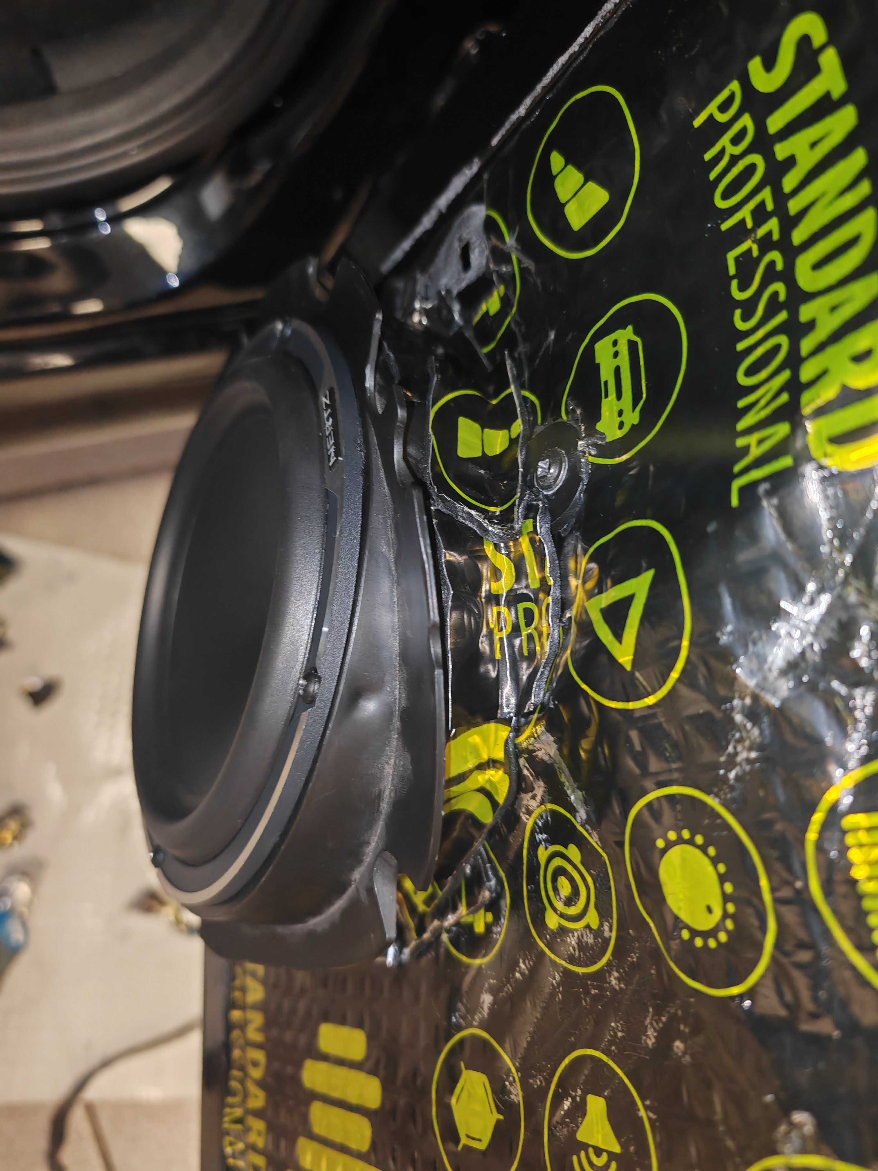

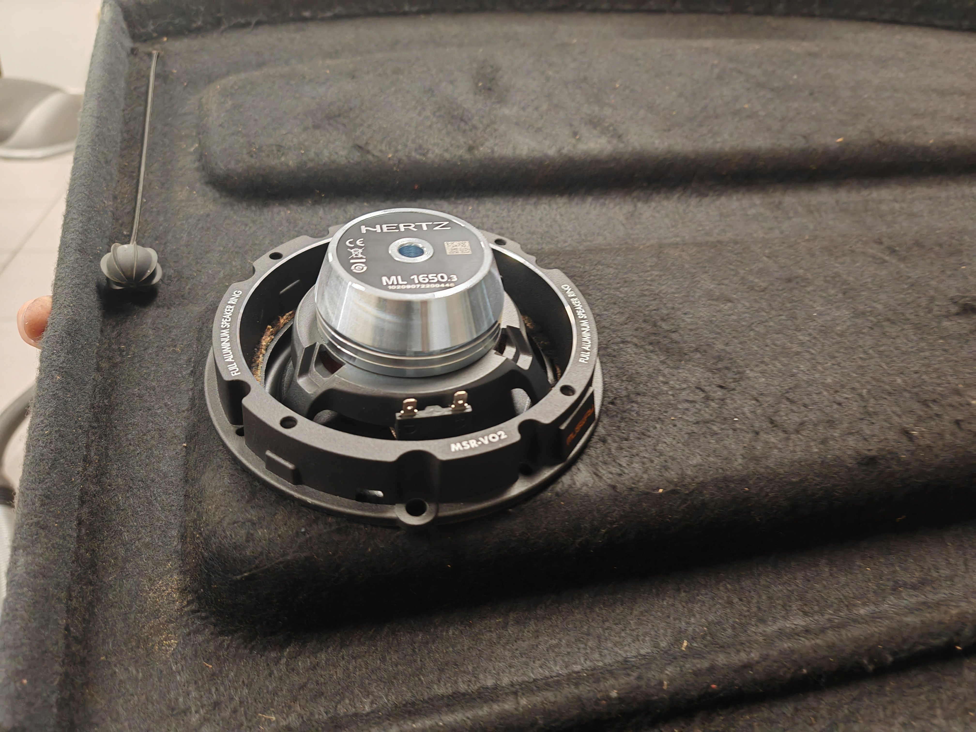

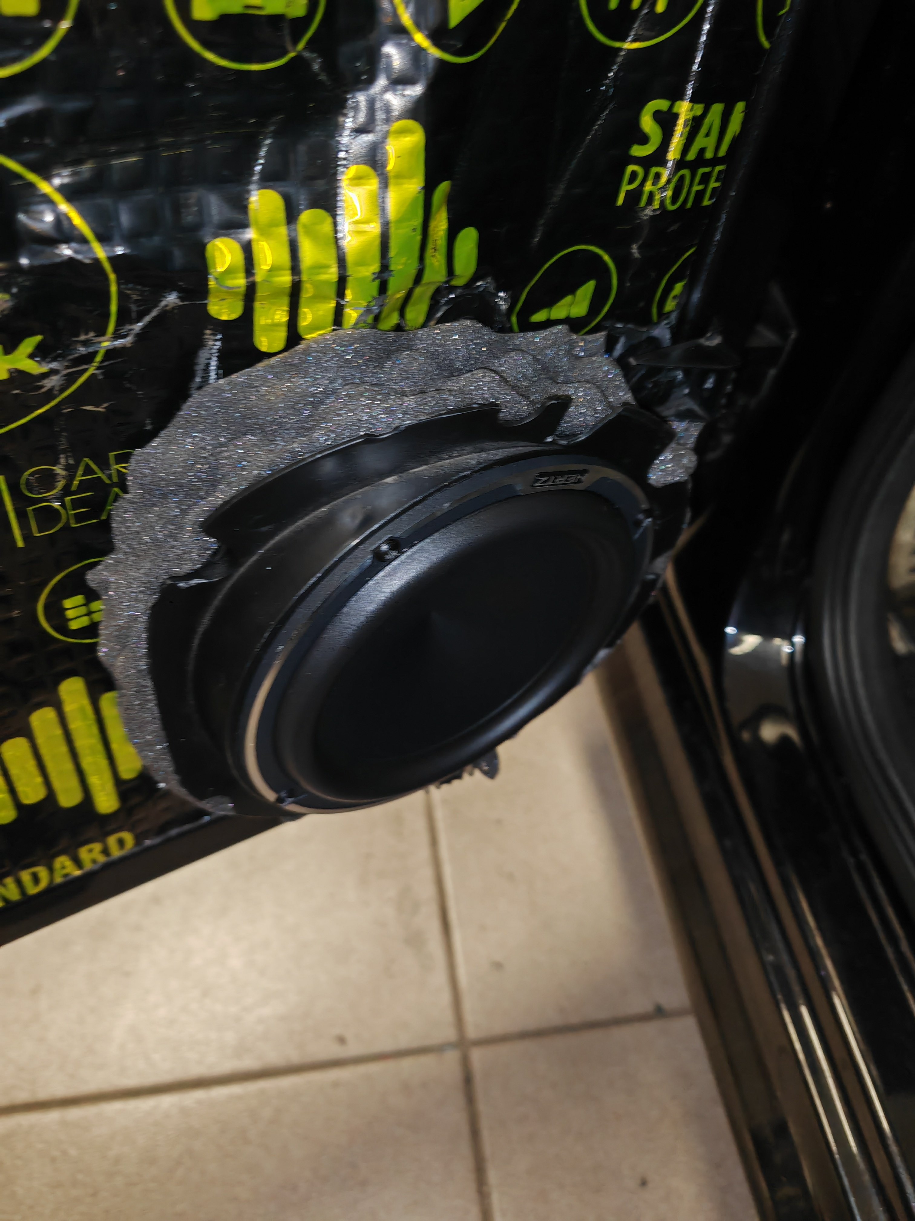

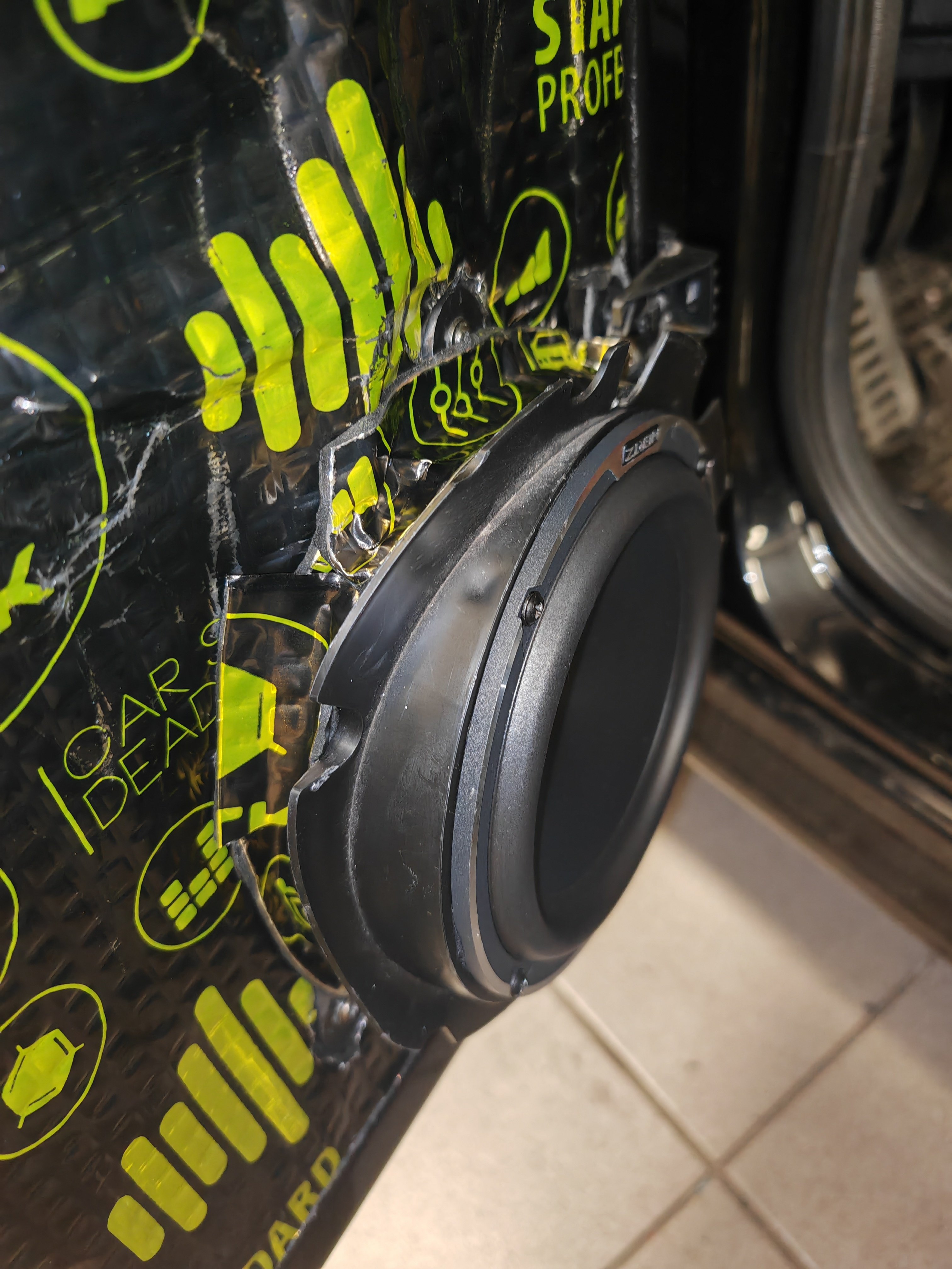

We used OEM mounts for front woofers speakers because Musway alu rings despite being told "plug and play" won't fit. But we used them on rear shelf for strenght and extra fancy look. We additionally extra insulated and closed all holes in OEM mounts on two layers

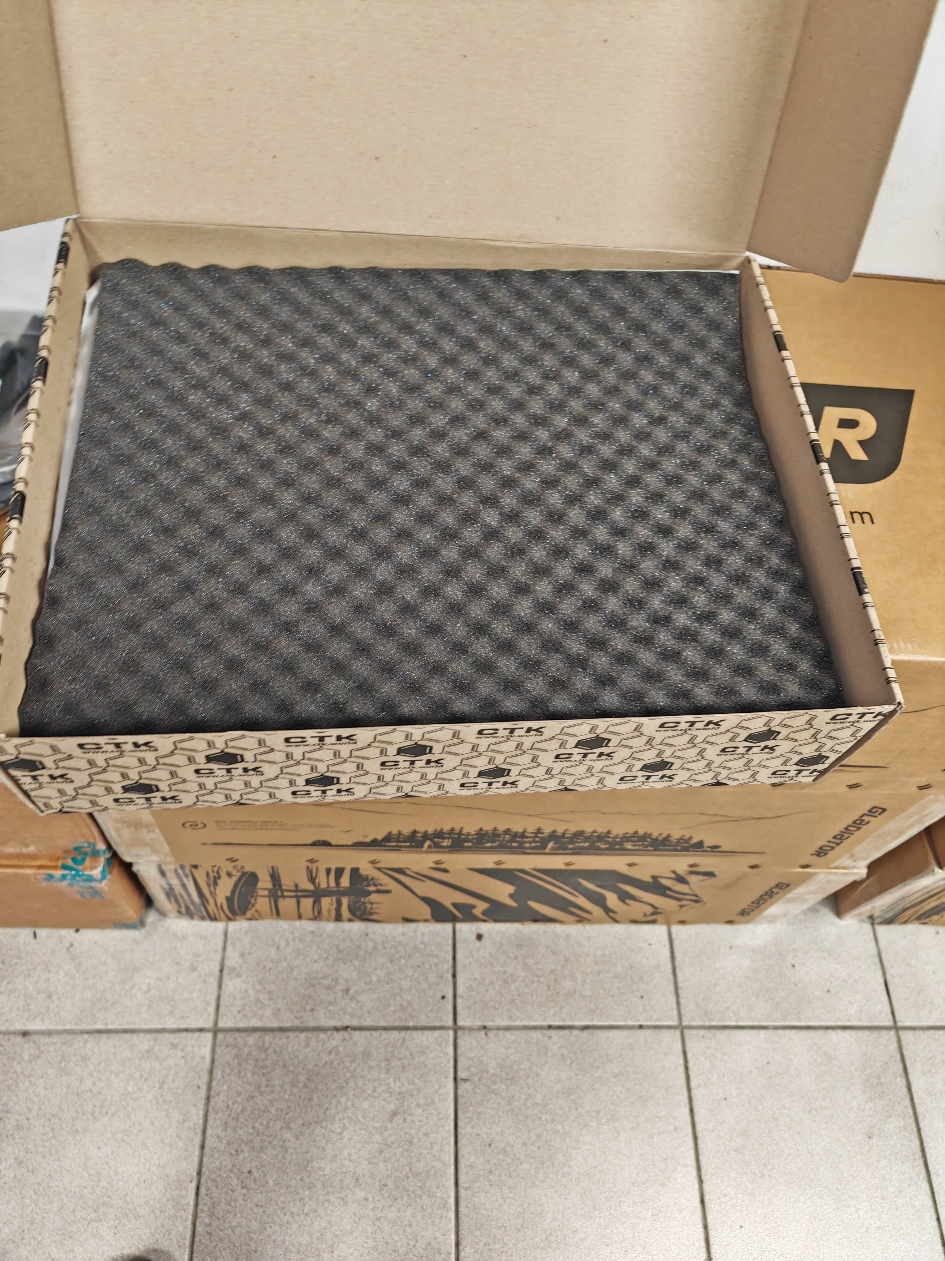

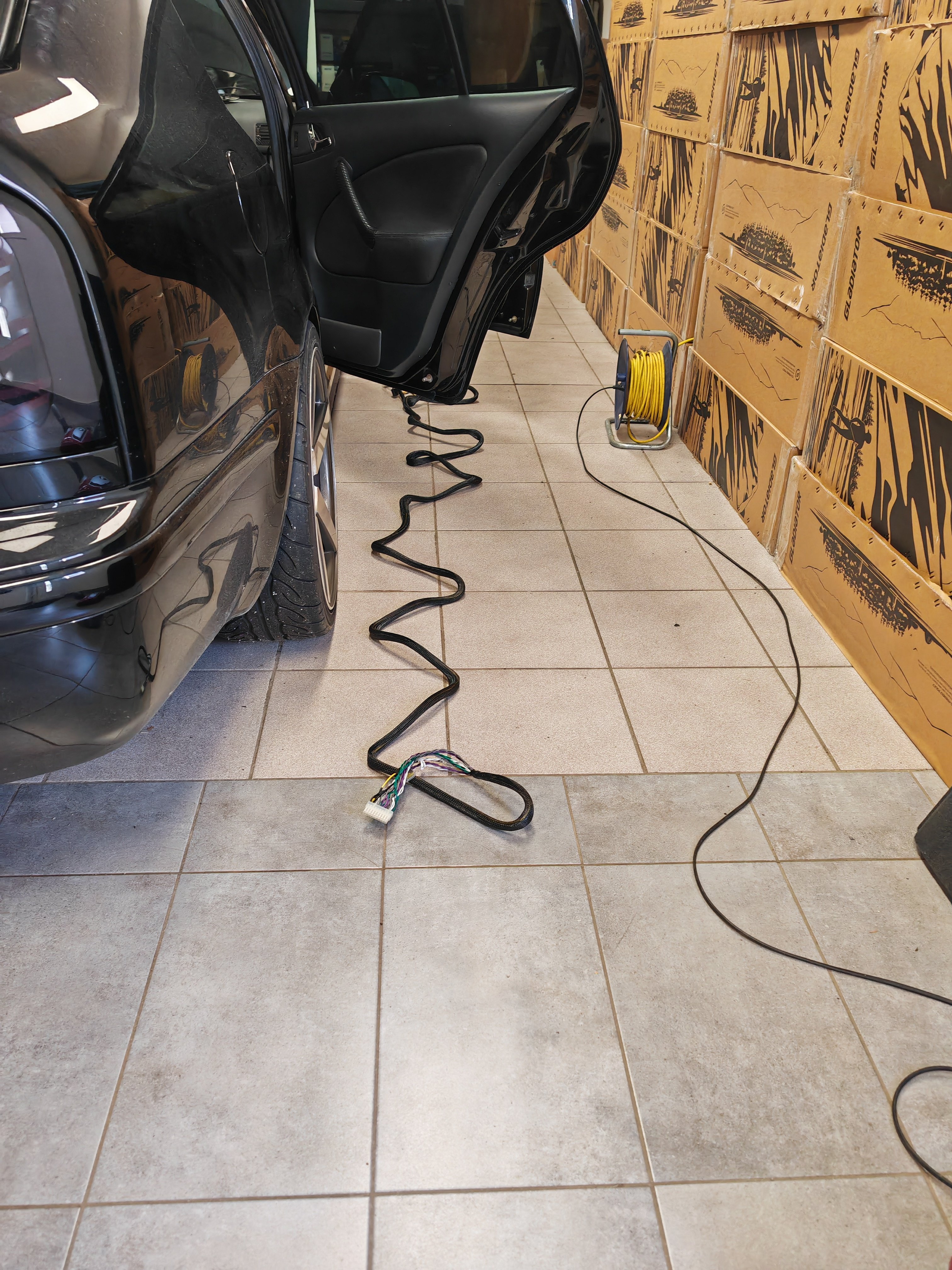

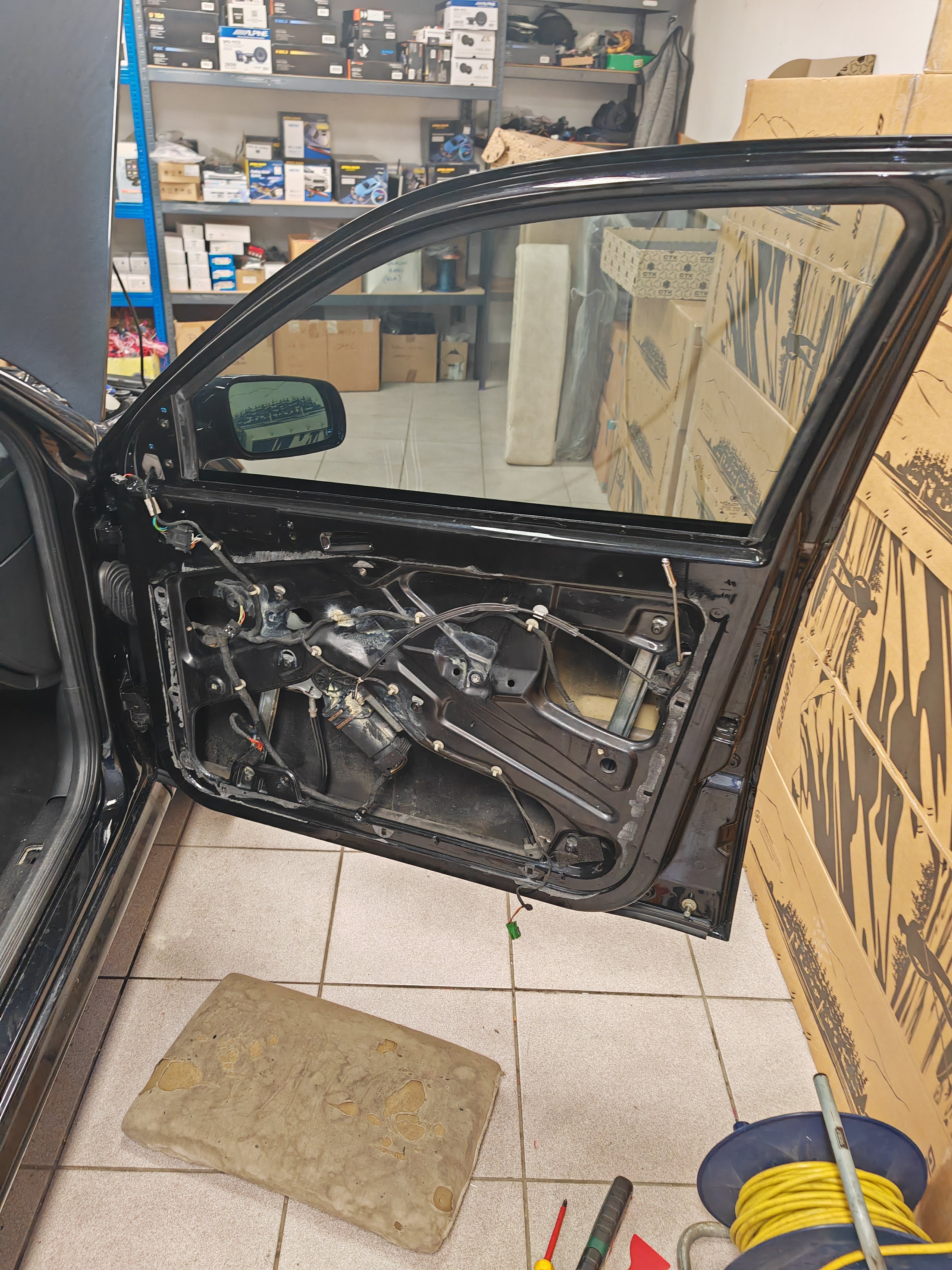

We've spent whole two day just sound proofing the car. Front and rear Doors in 5 layers, 3 on door itself and 2 on pannels, two layers on hood and 4 layers on 5 door-2 on door,and 2 on pannels

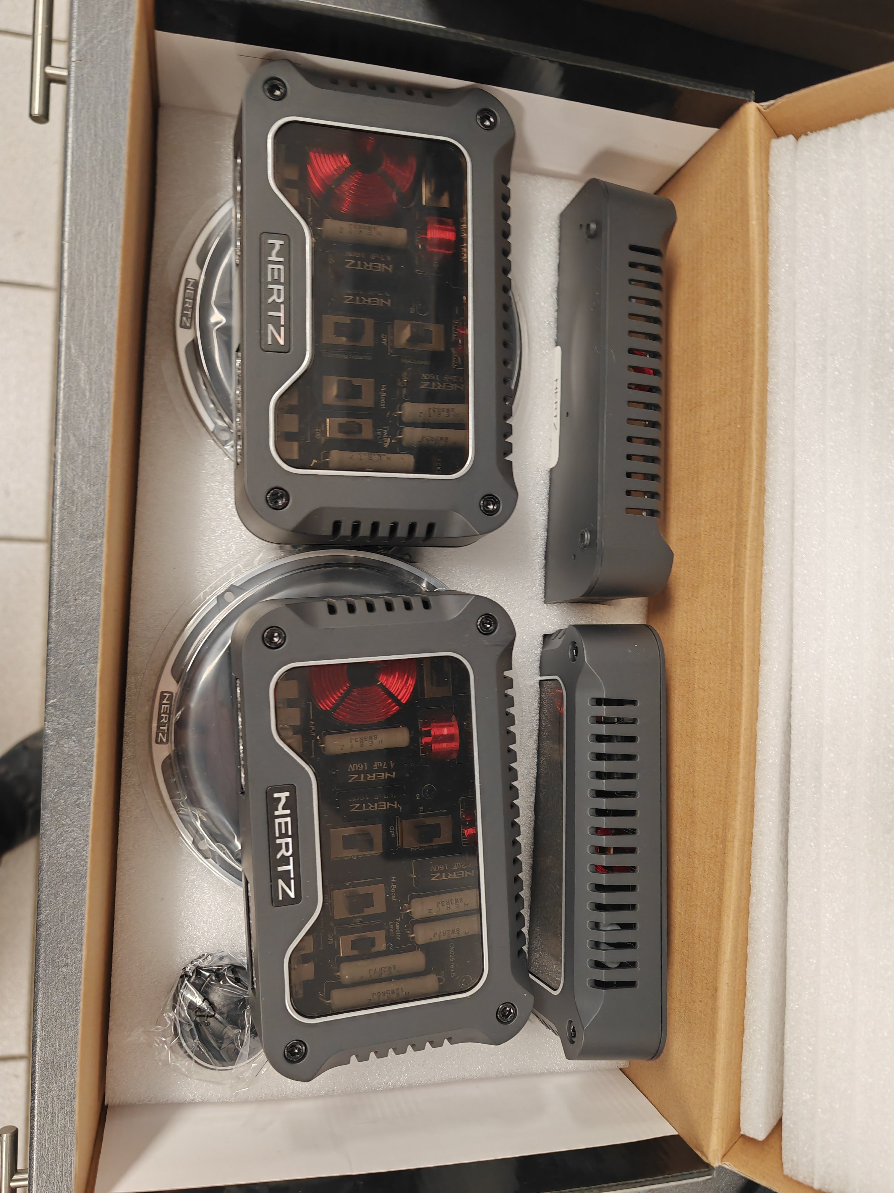

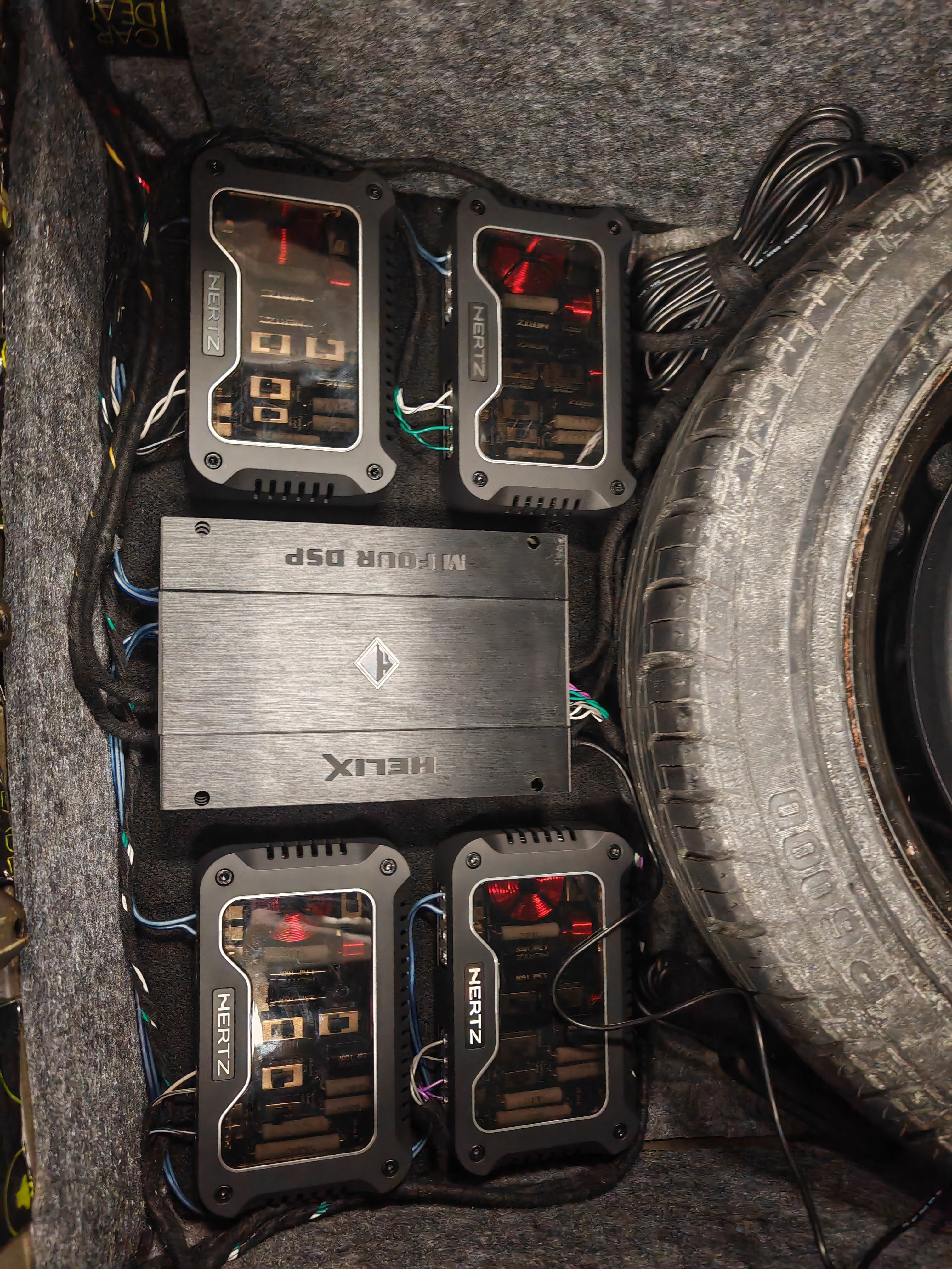

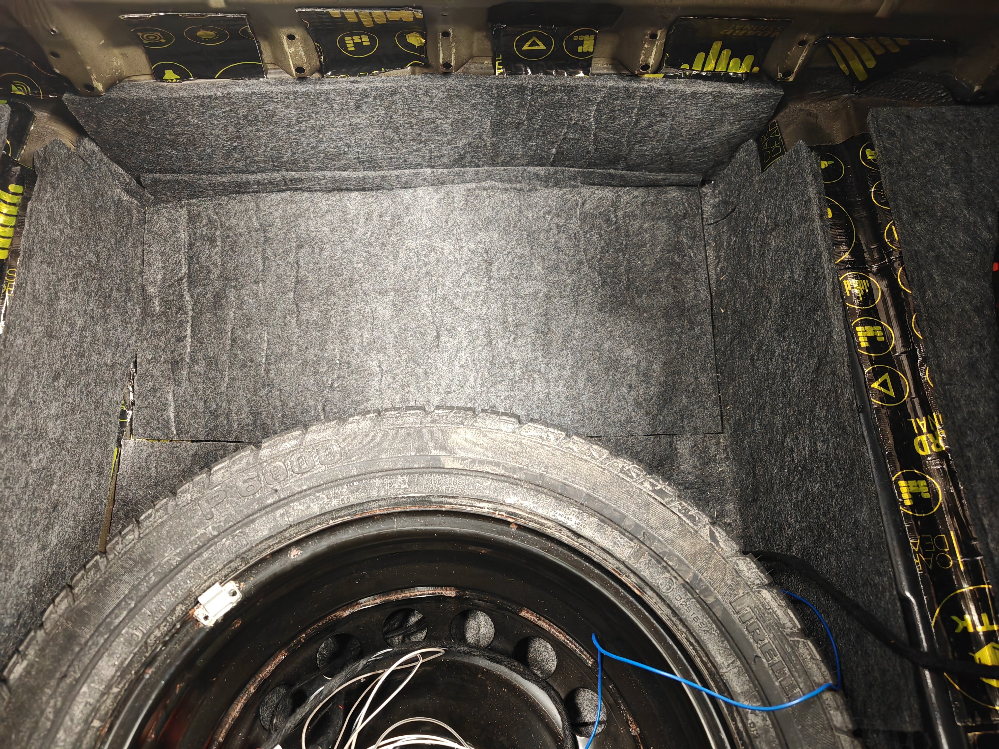

Trunk and roof are insulated in 2 layers and floor im one layers. We've used CTK for all and some STP sponge. We fitted Hertz Mille Legend 1650.3 two way system 300w (,EISA 2915/16 award) in front doors-woofers, tweeters are to be mounted in cnc'ed alu pods on A pillar,and rear where OEM woofers were also in alu pods OEM speakers are all removed, rear woofwes will be in rear shell fixed with Musway MSR-VO2  16,5cm alu adapter rings, and JBL sub hub 800w design award 2018 in spare tyre and Helix M four DSP amplifier with all four crossowers in back of spare tyre. Phoenix gold TX series amplifier install kit. Audiotec Fischer Conductor one touch remote control EISA award best pepduct 2021/22. Complete pictures  and video follow up to come when finished. Can't wait, after all the upgrades it was time for some deep basses to come. We Will put also cable for Alpine Halo 11" unit and reverse Alpine HDCR camera, untill that upgrade Denissin BT,USB micro sdhc  reader for Symphony MP3 player,hehehe, stay Times😇💪

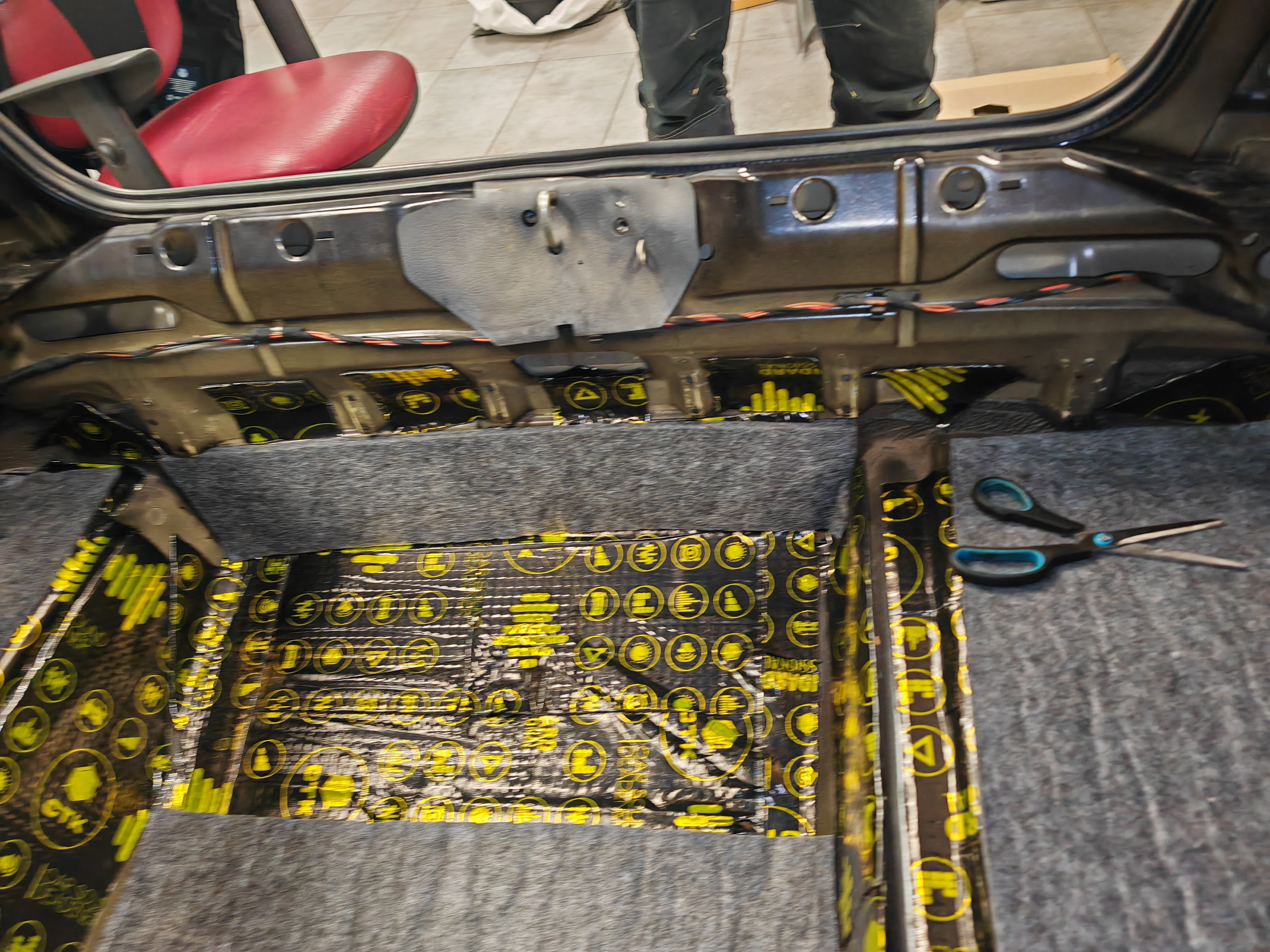

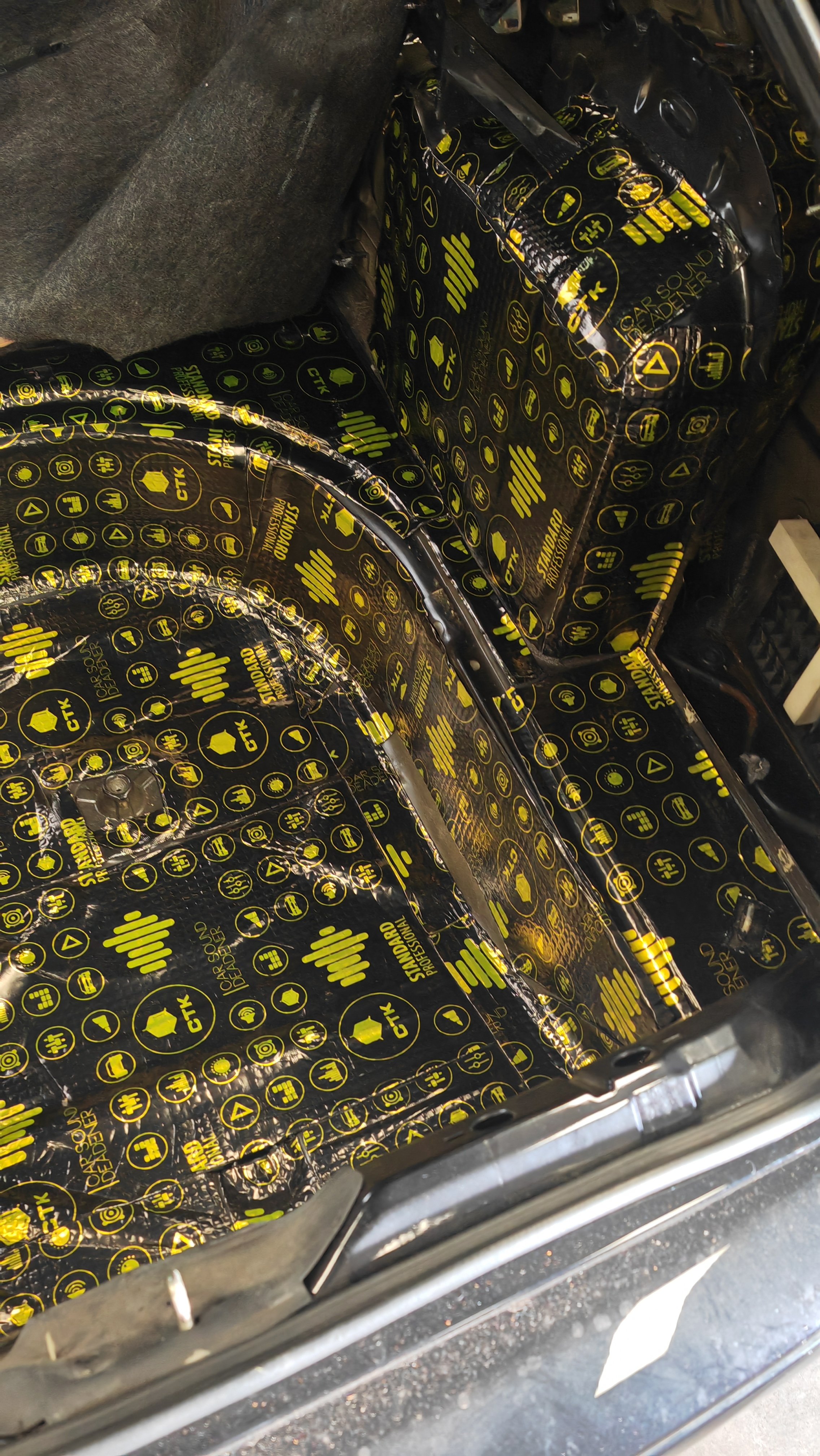

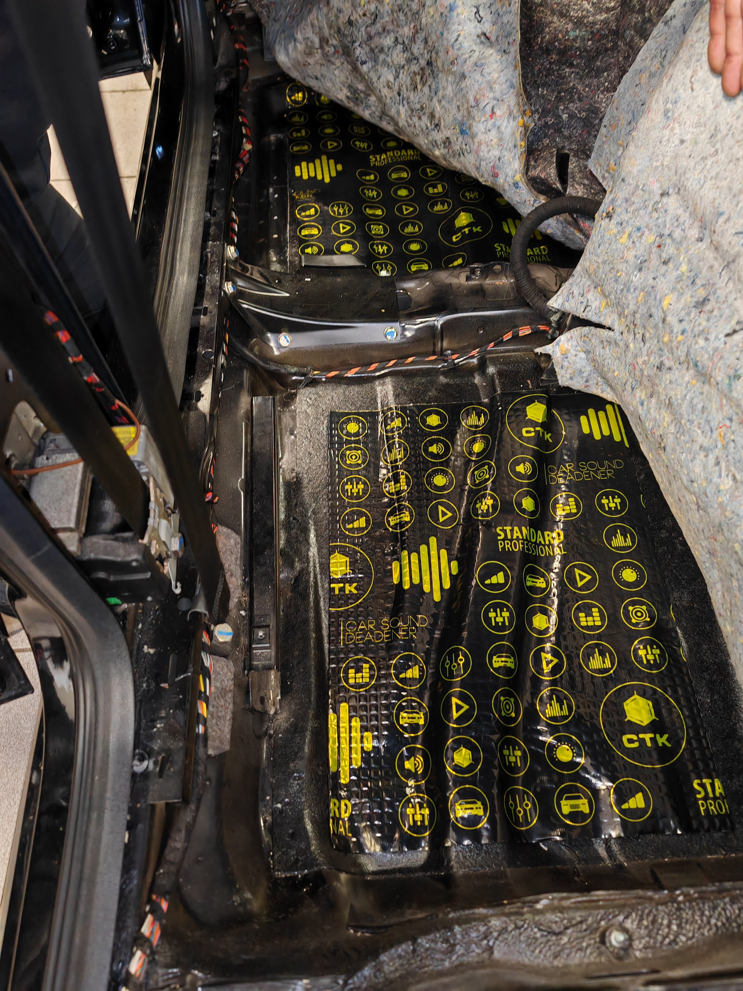

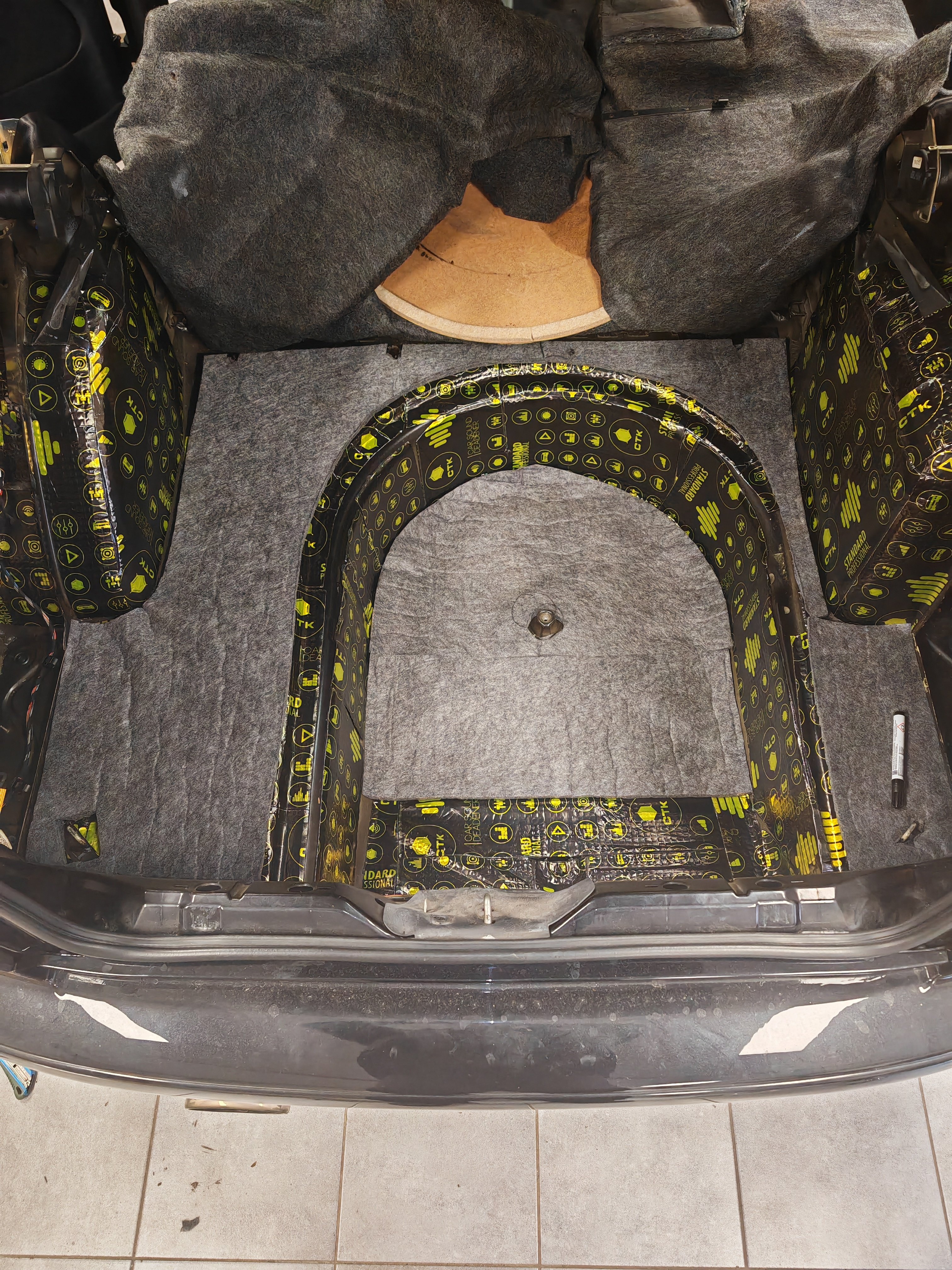

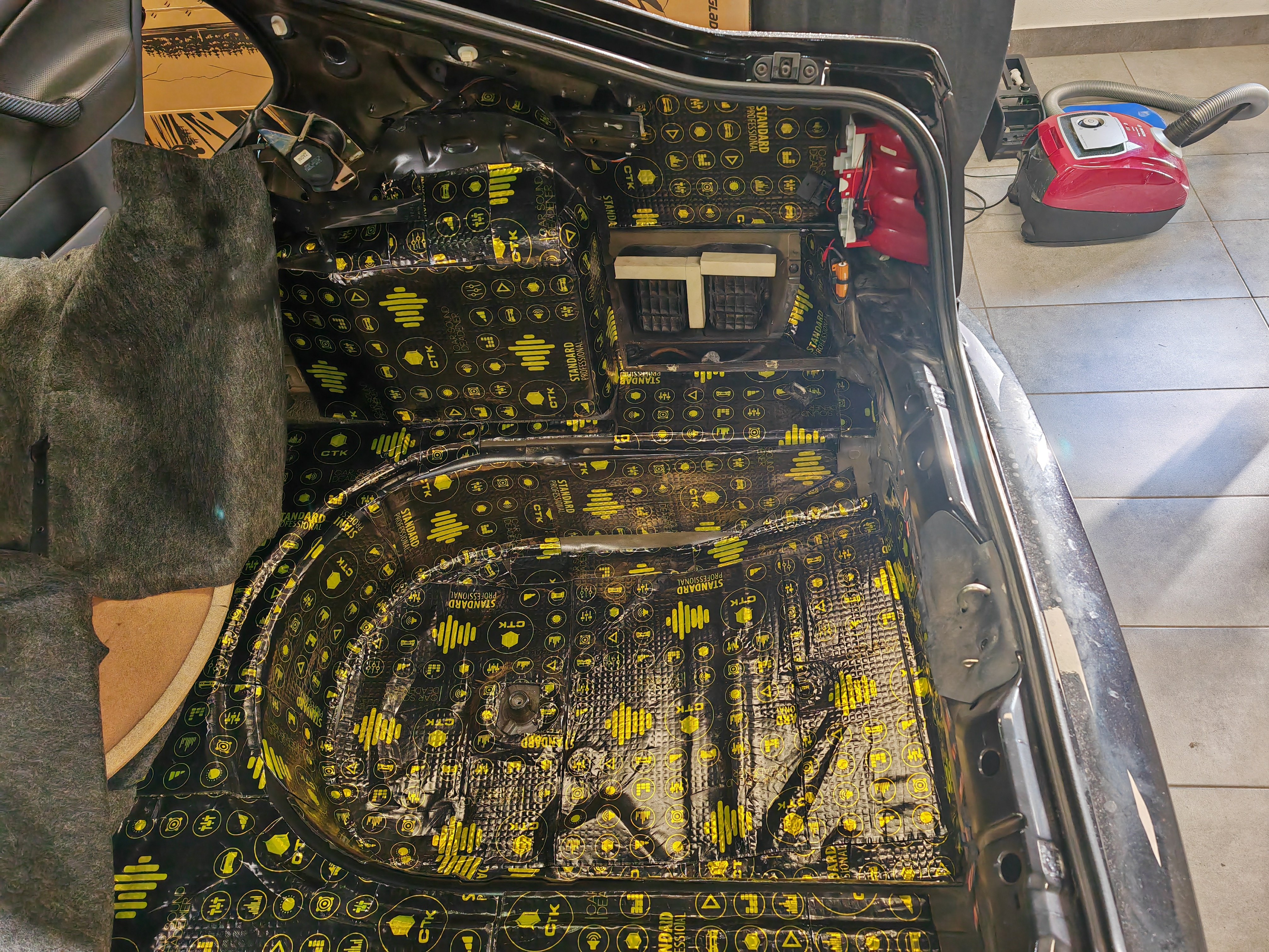

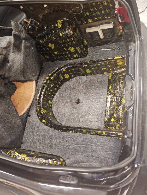

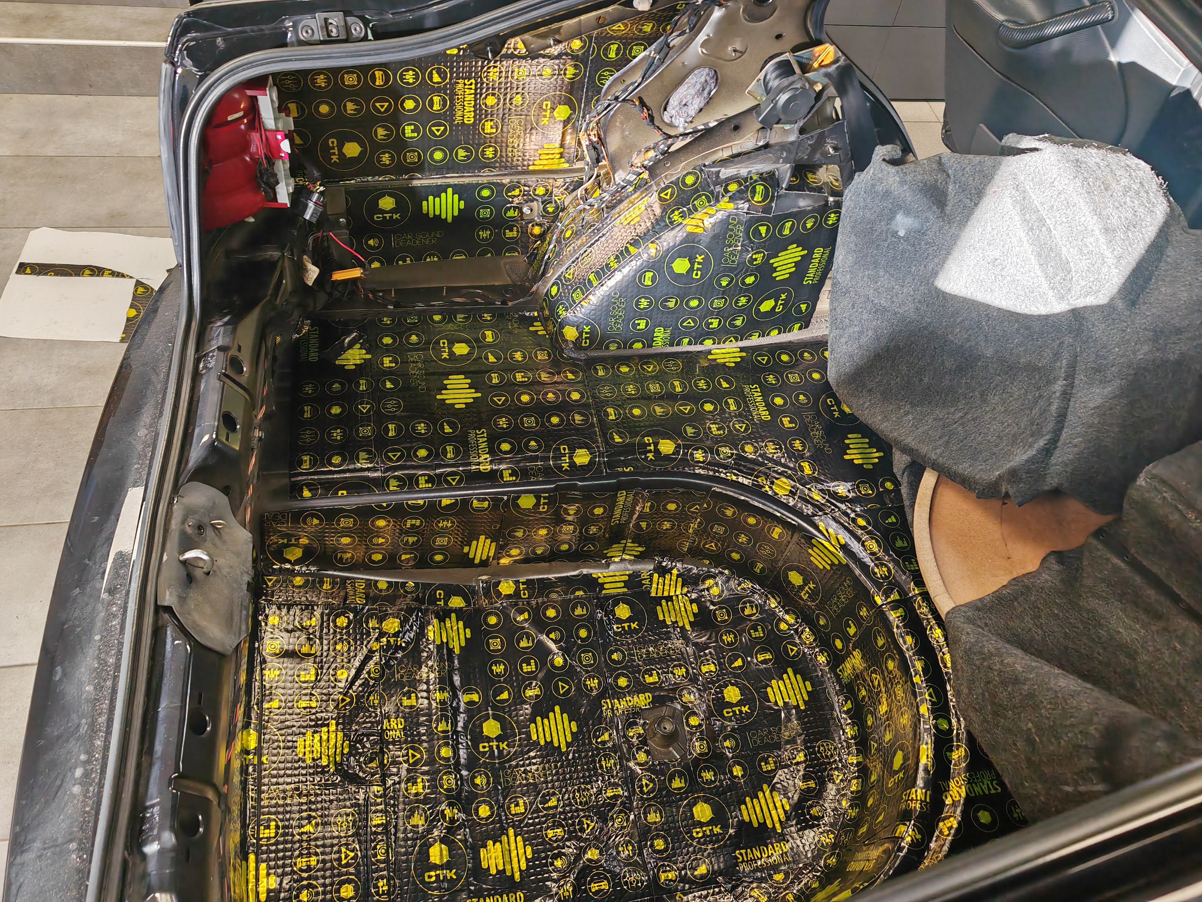

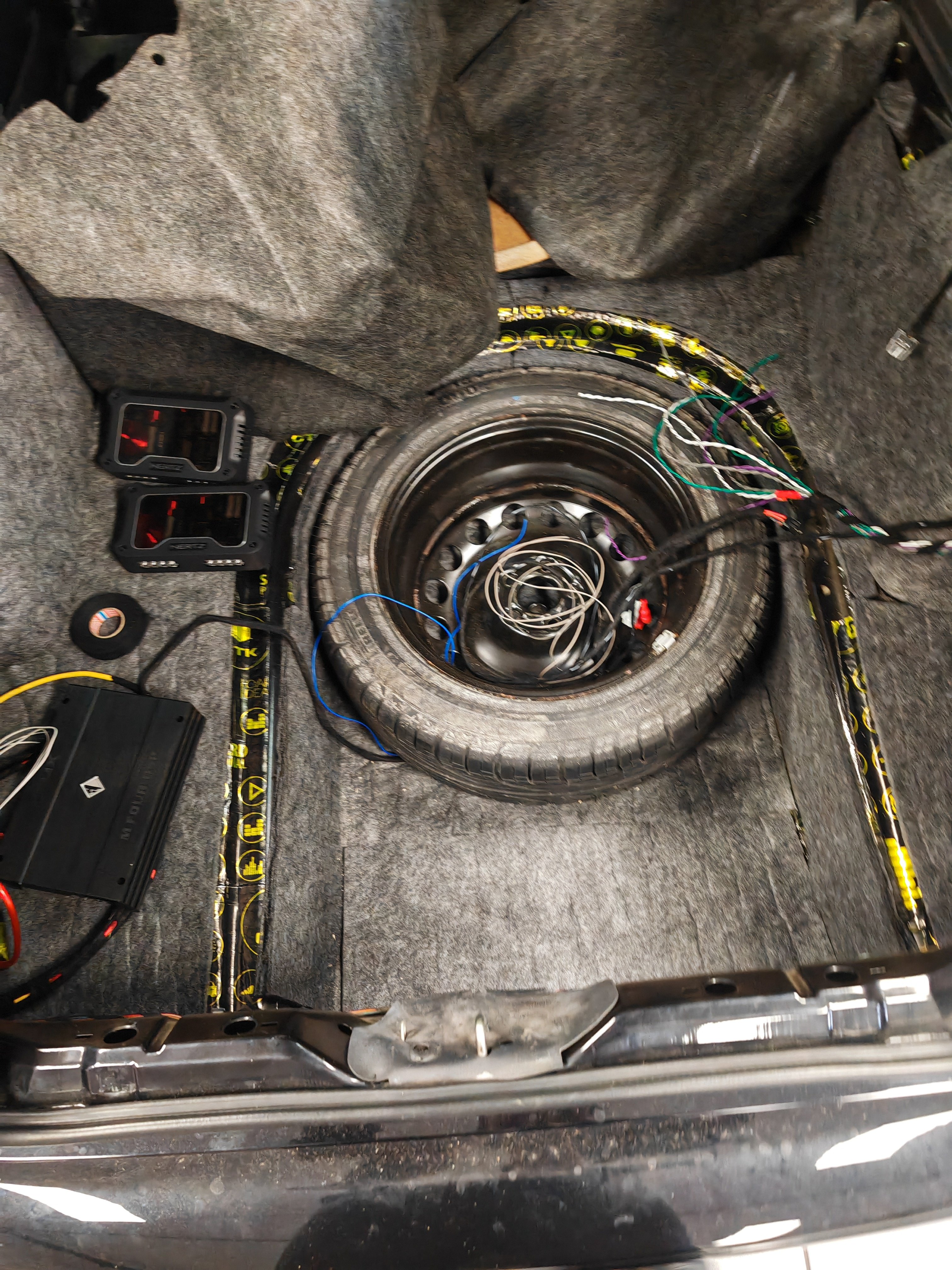

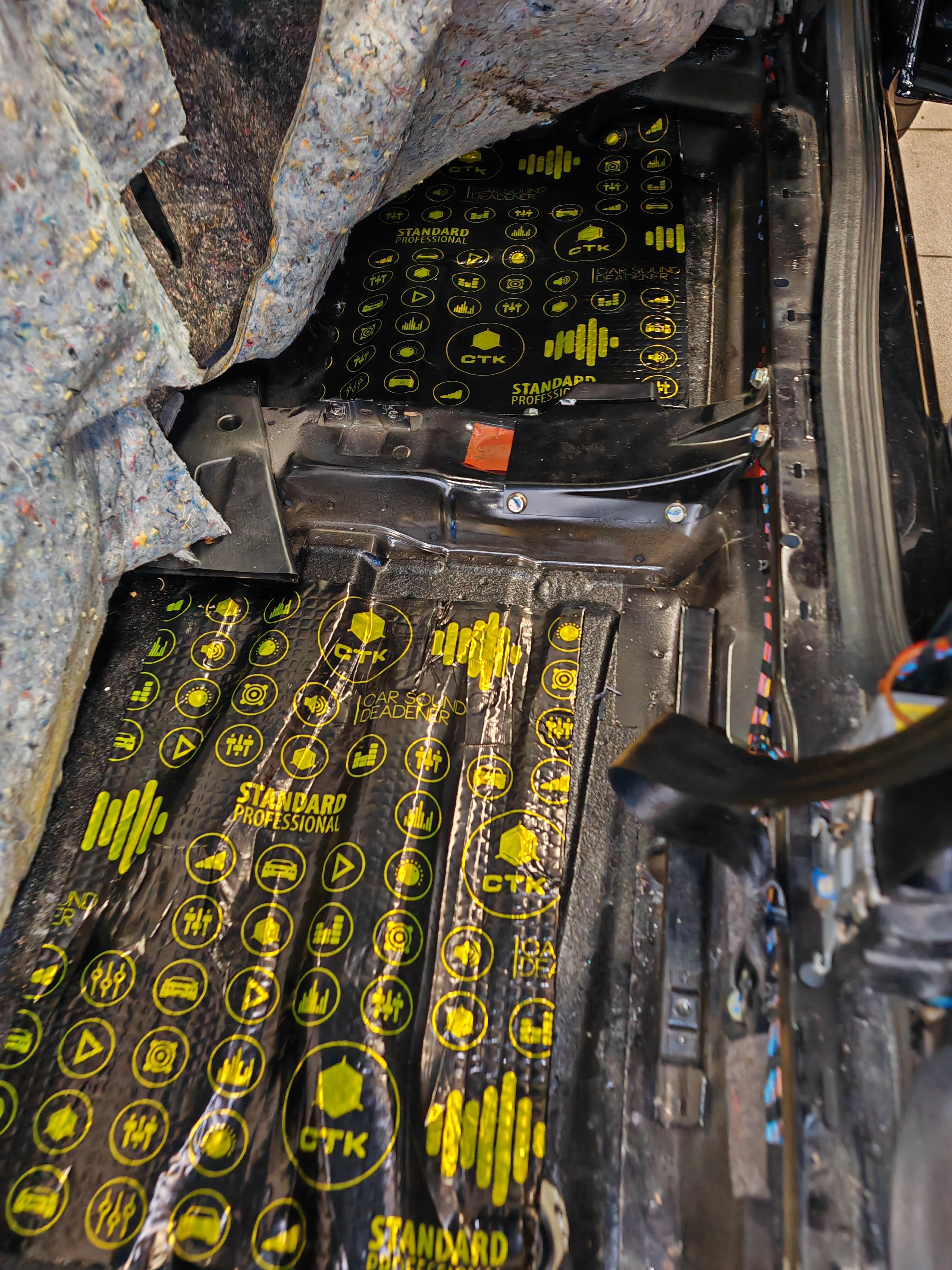

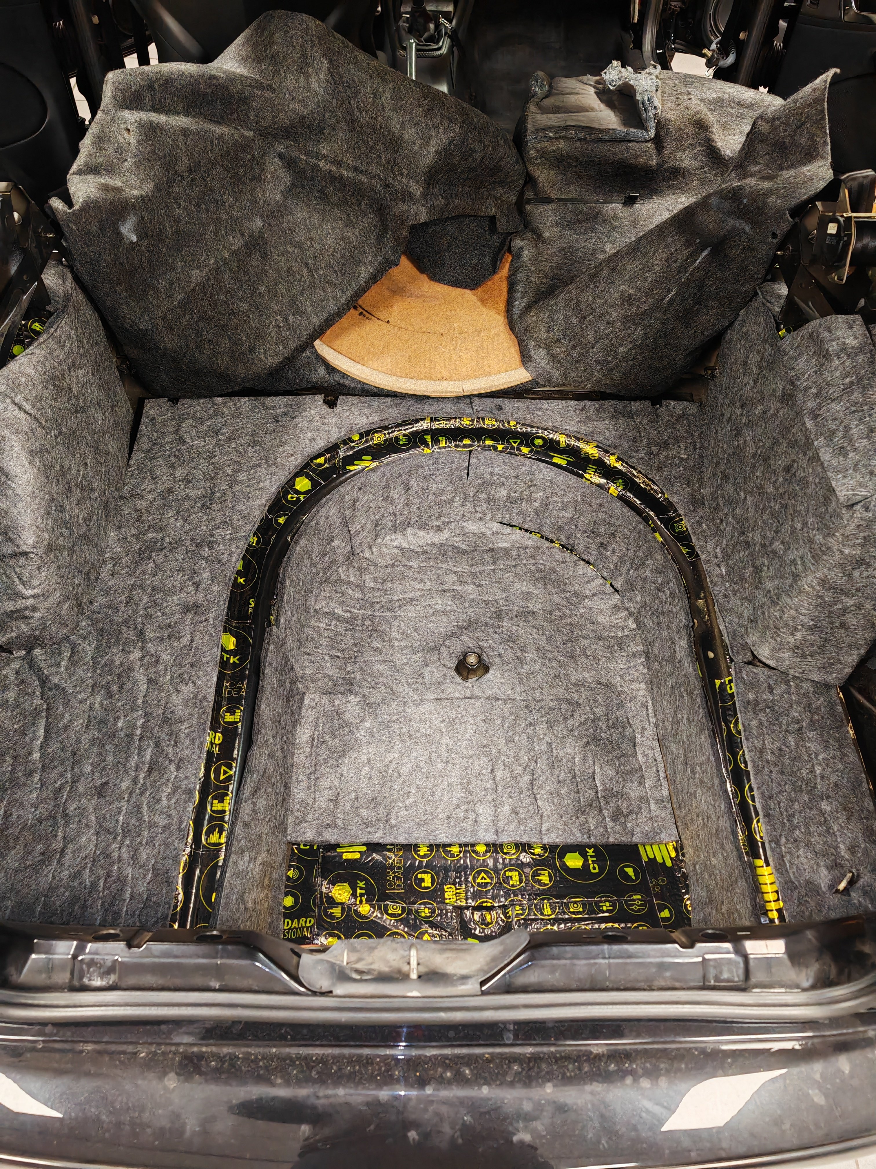

Floor dampening, under front and rear both sides with 4 big butyl plates were done.

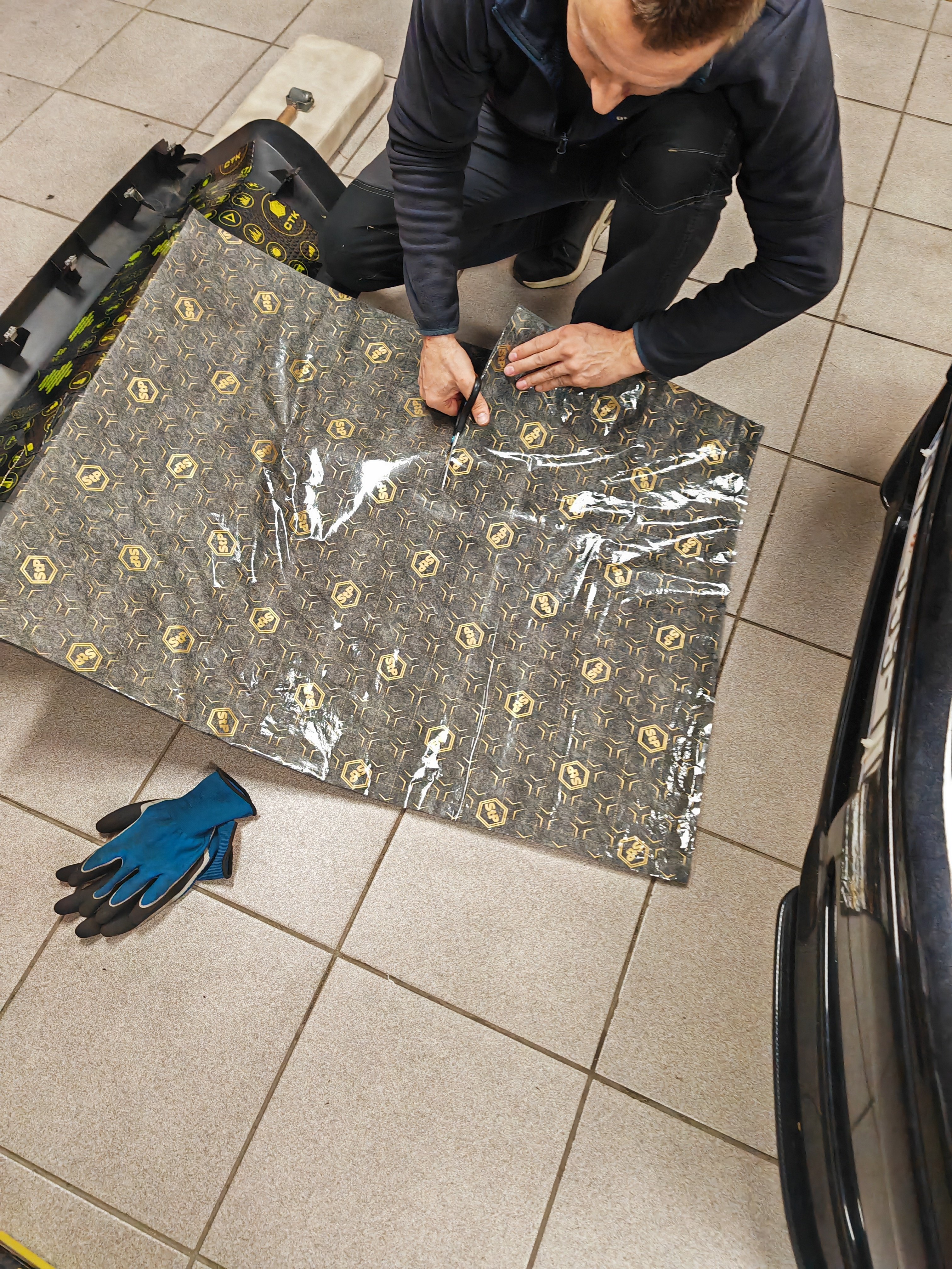

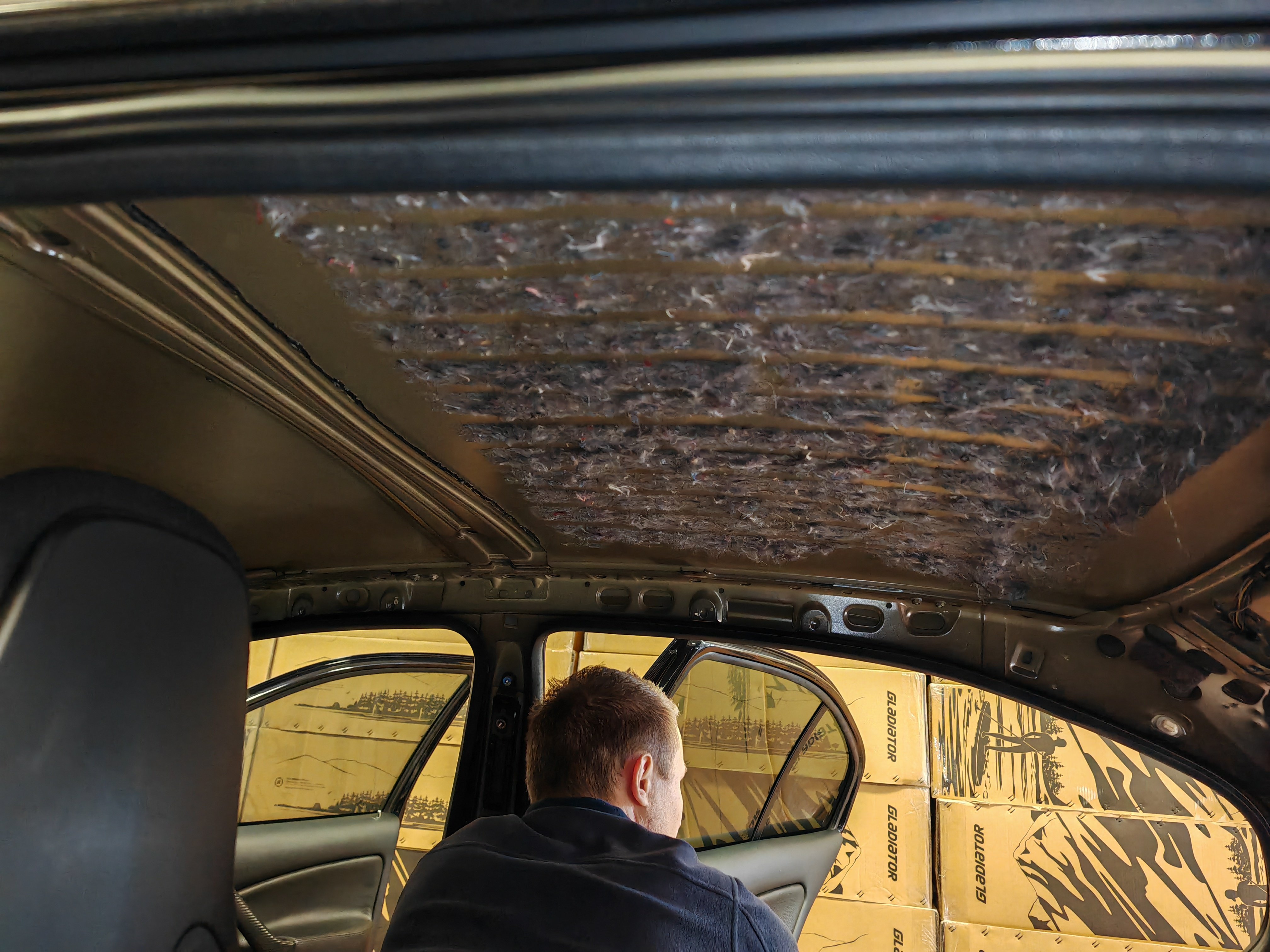

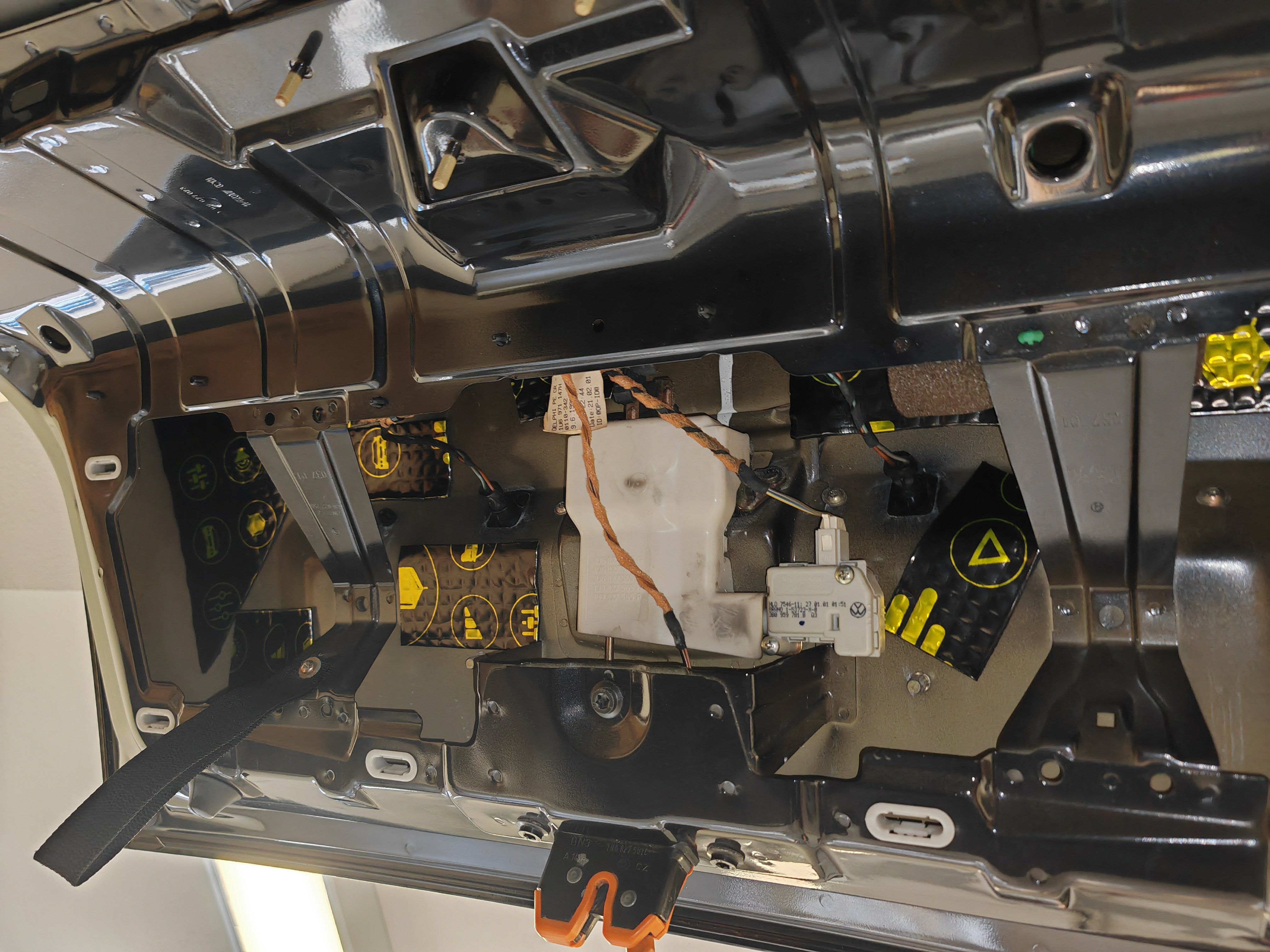

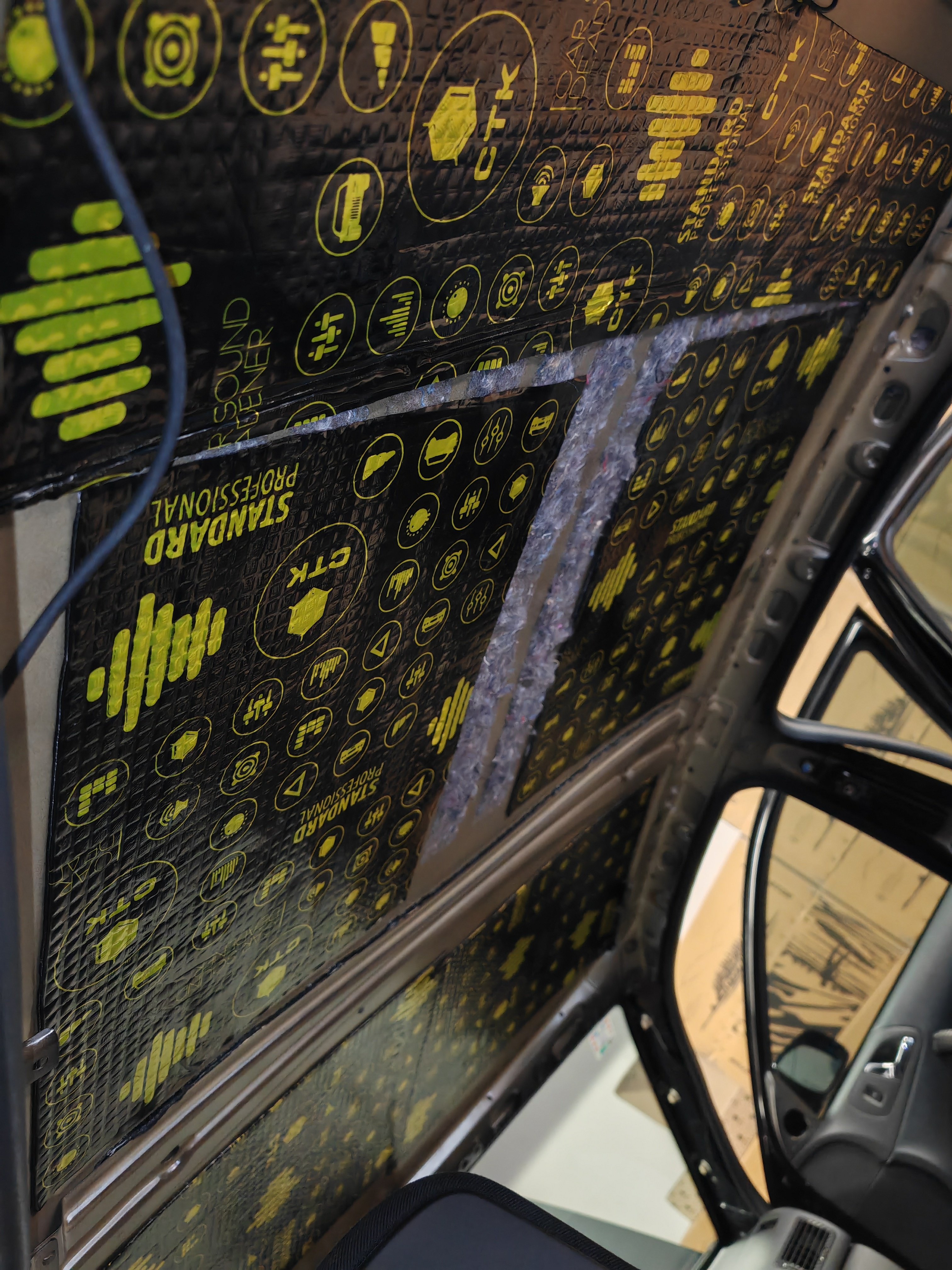

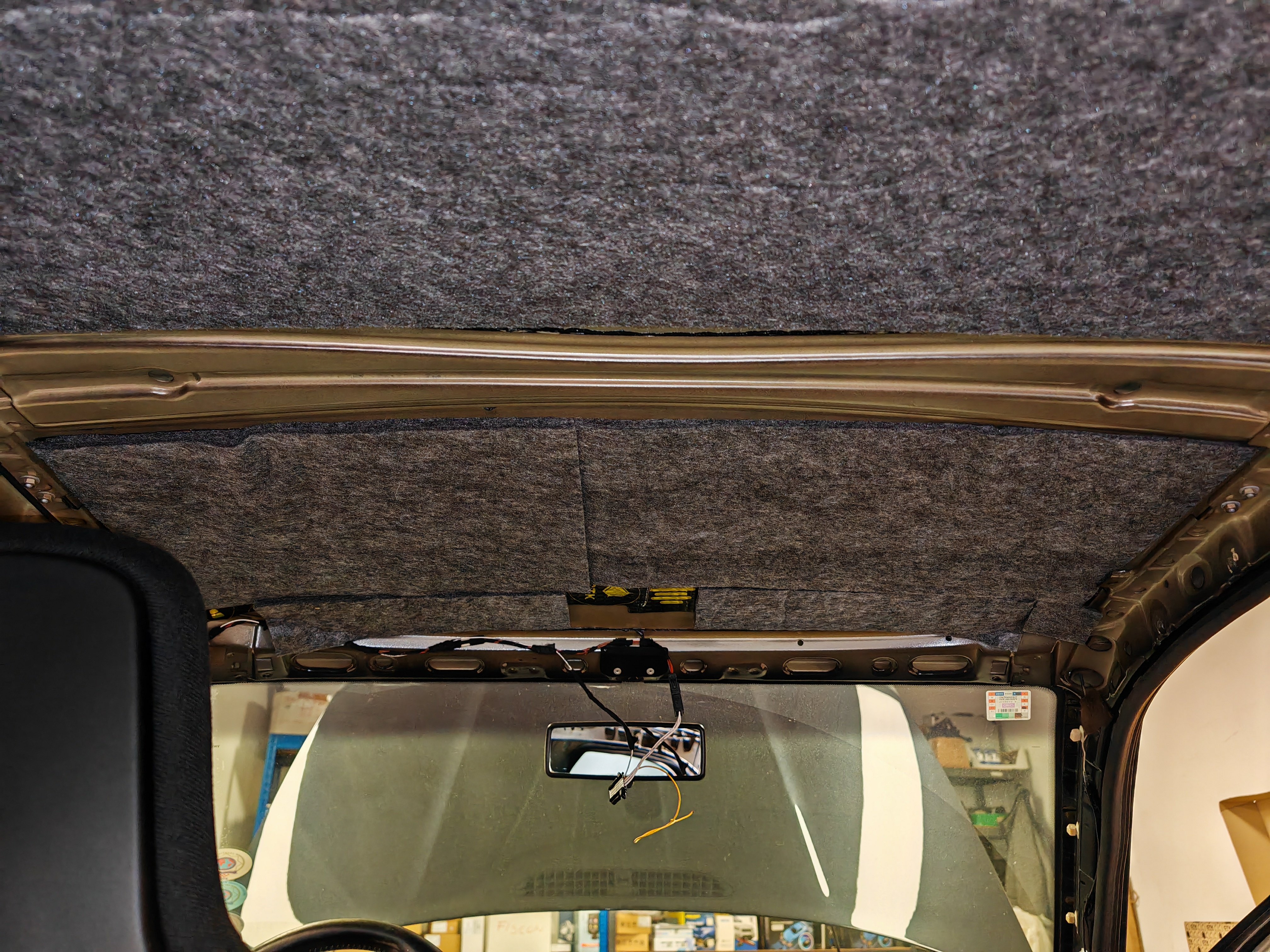

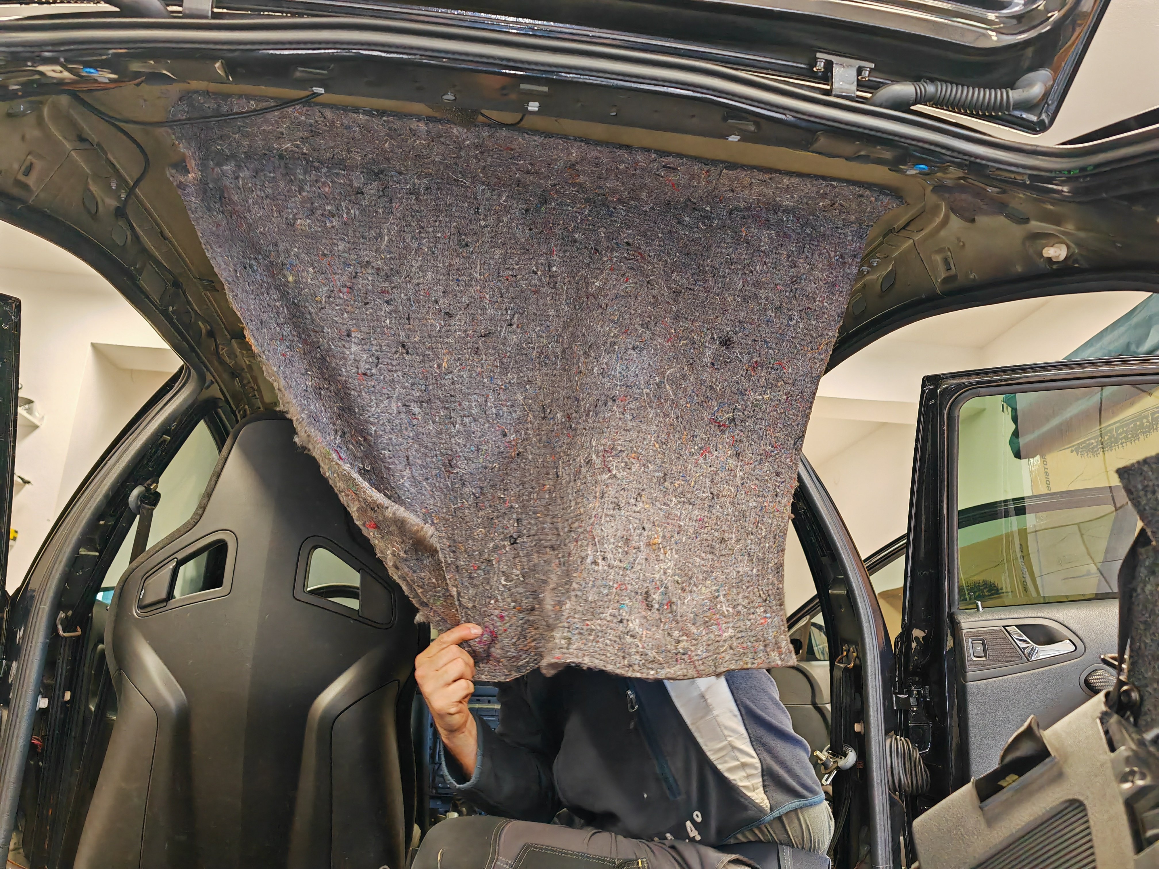

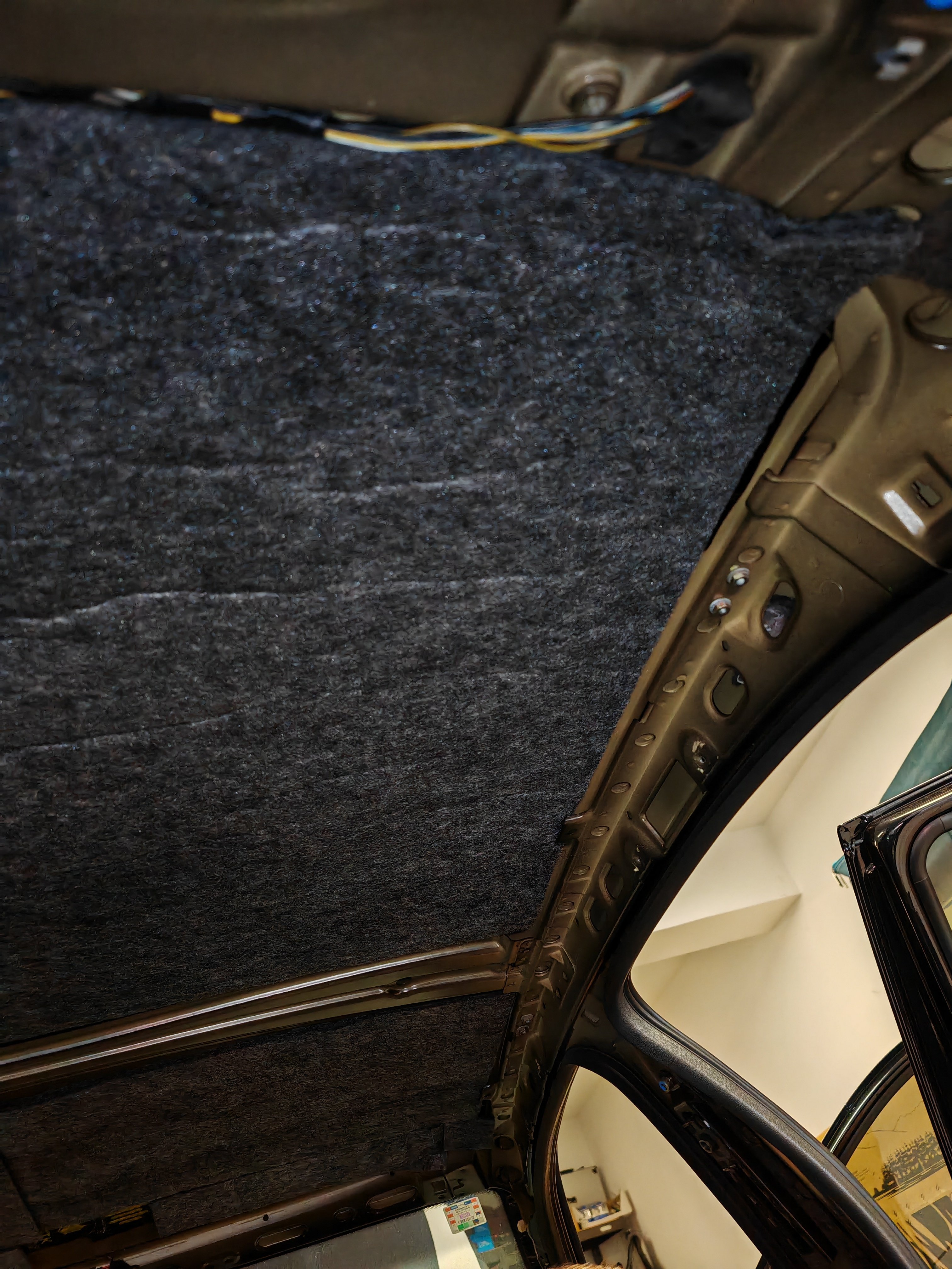

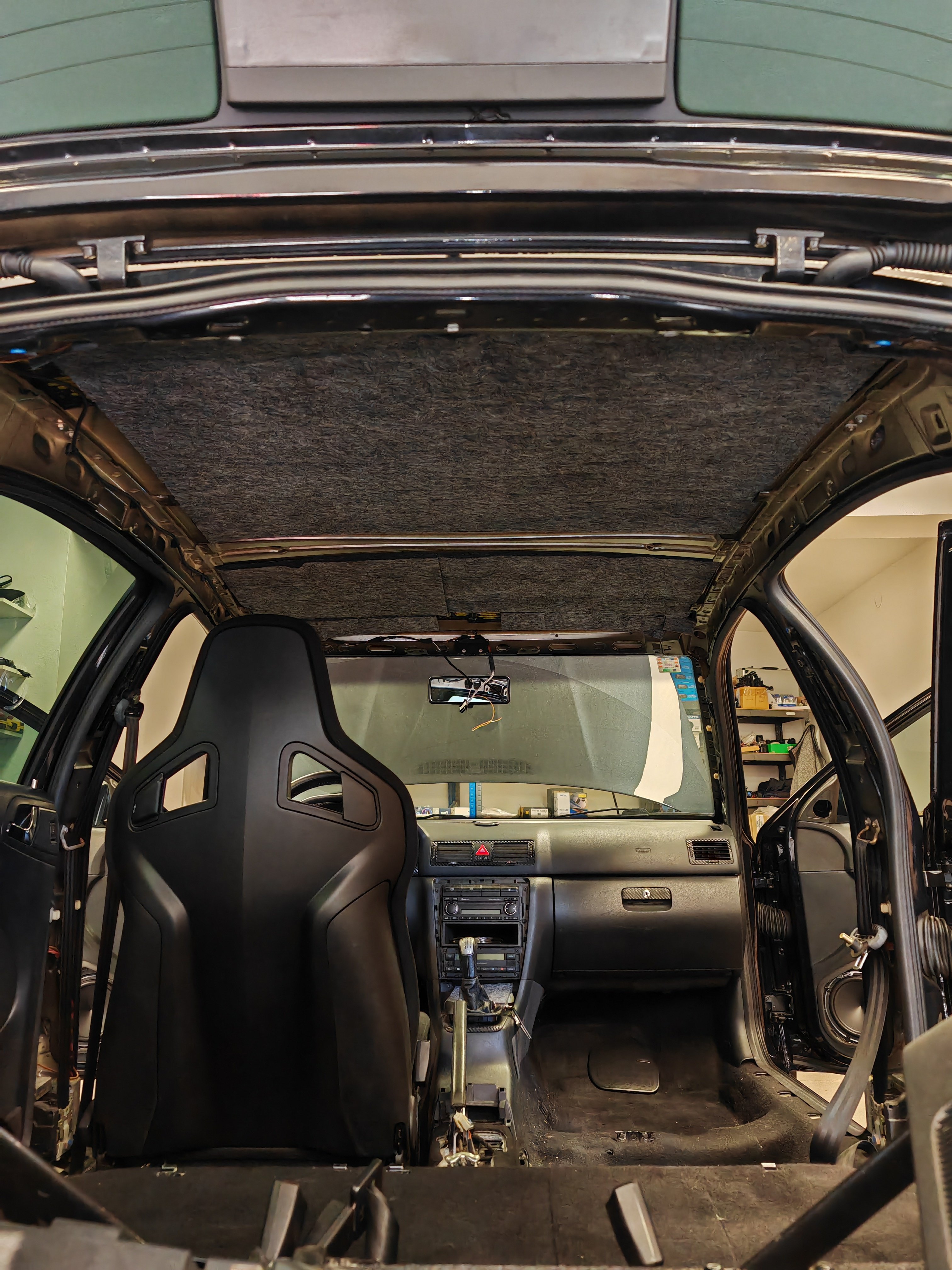

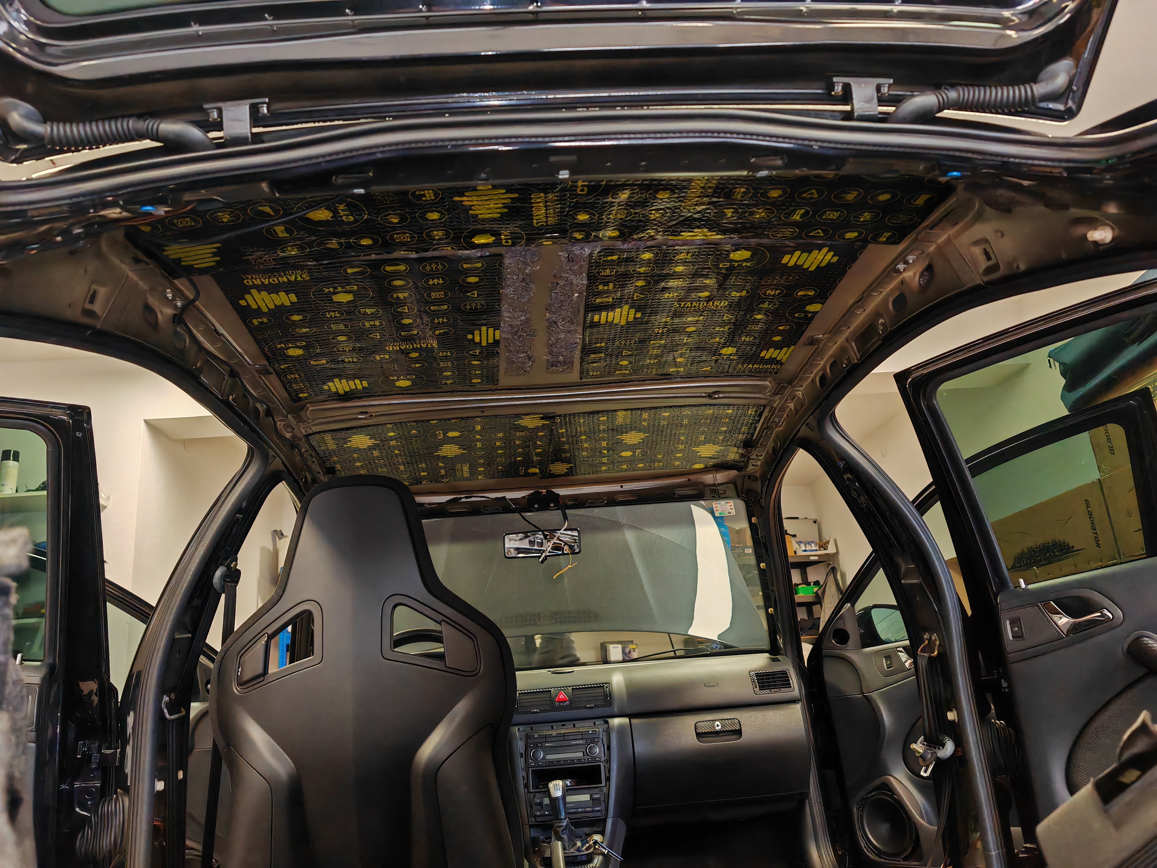

At roof we had rear half covered in very thick fabric, centimeter or more. We removed it and cut in small pieces to fill cavities on inner rear fender. We covered whole roof with butyl plates and sponge ones in second layer.

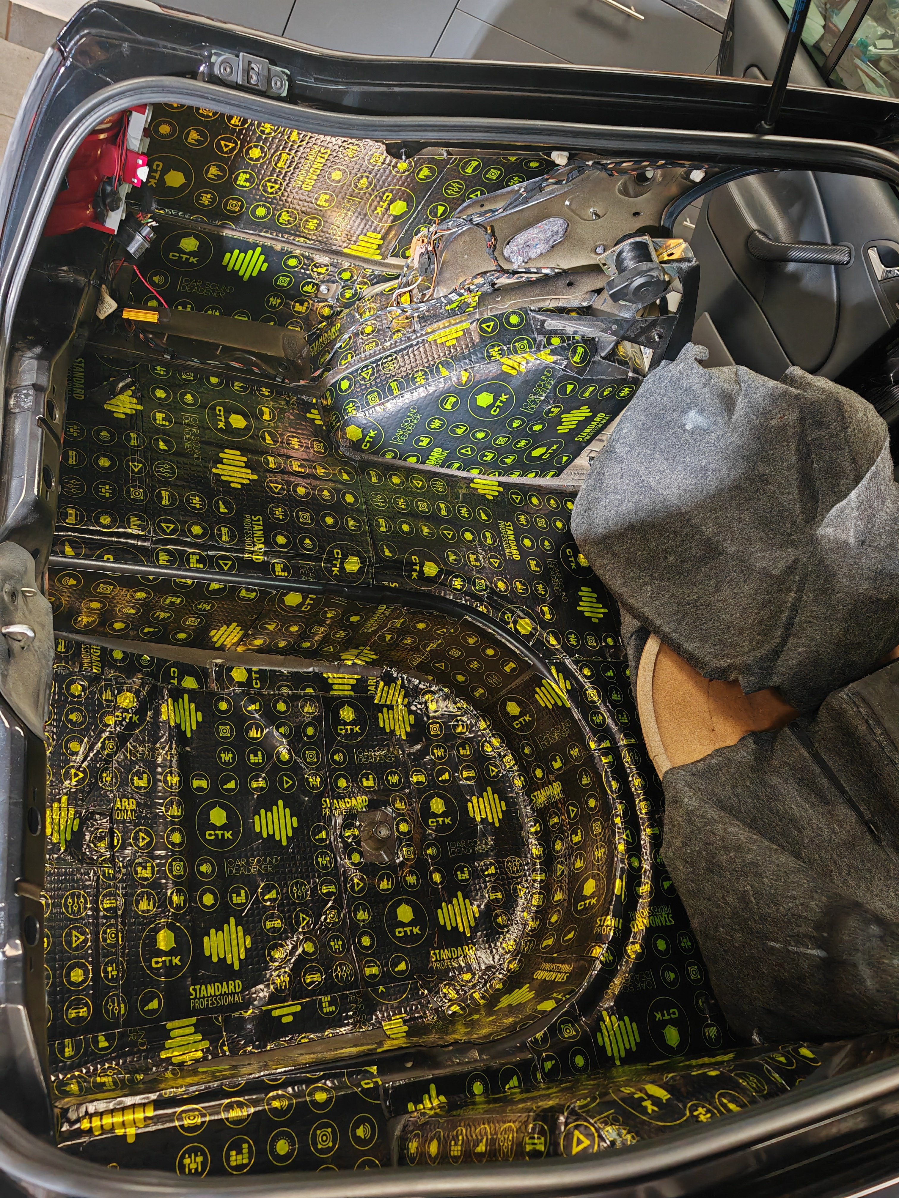

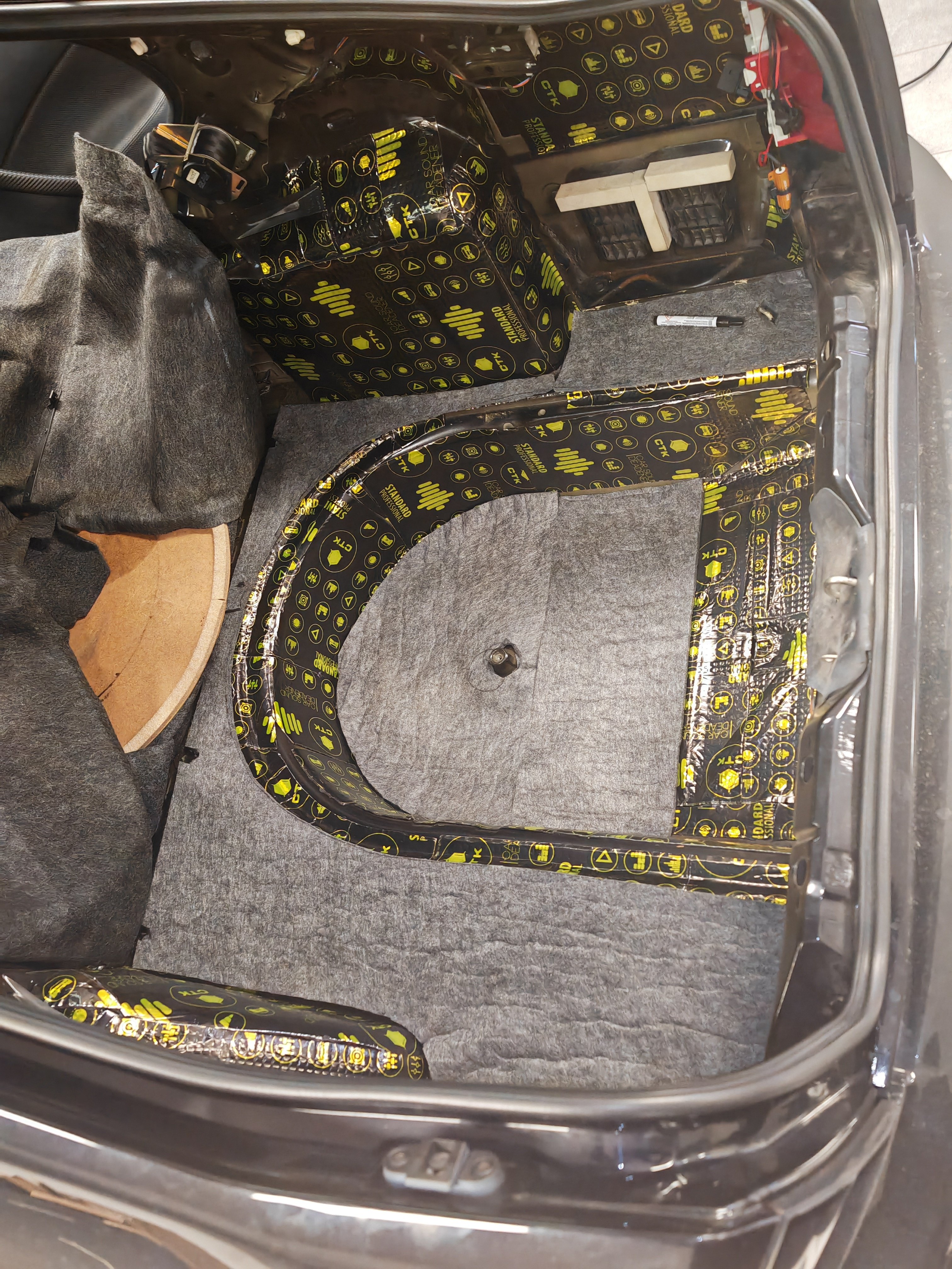

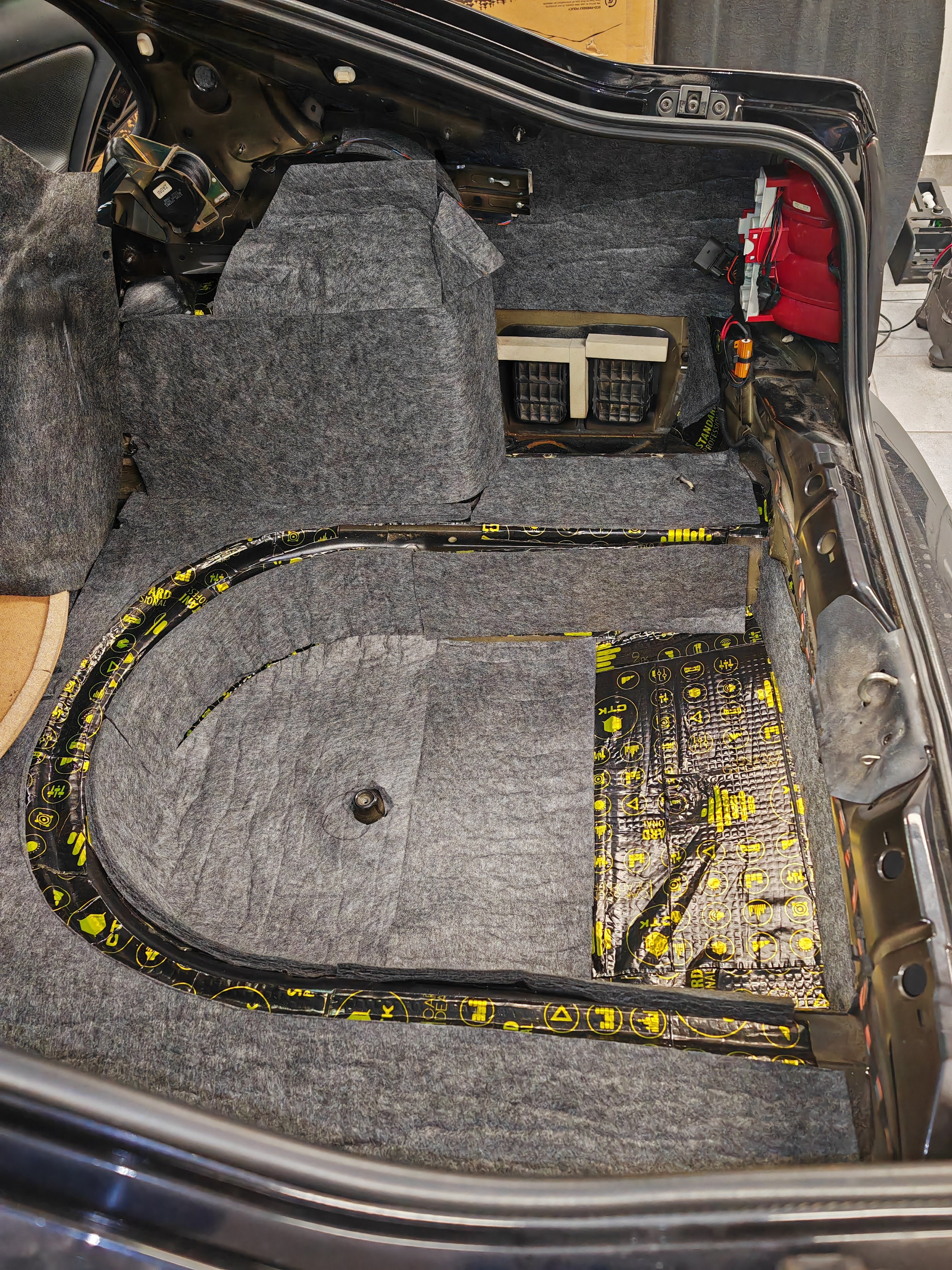

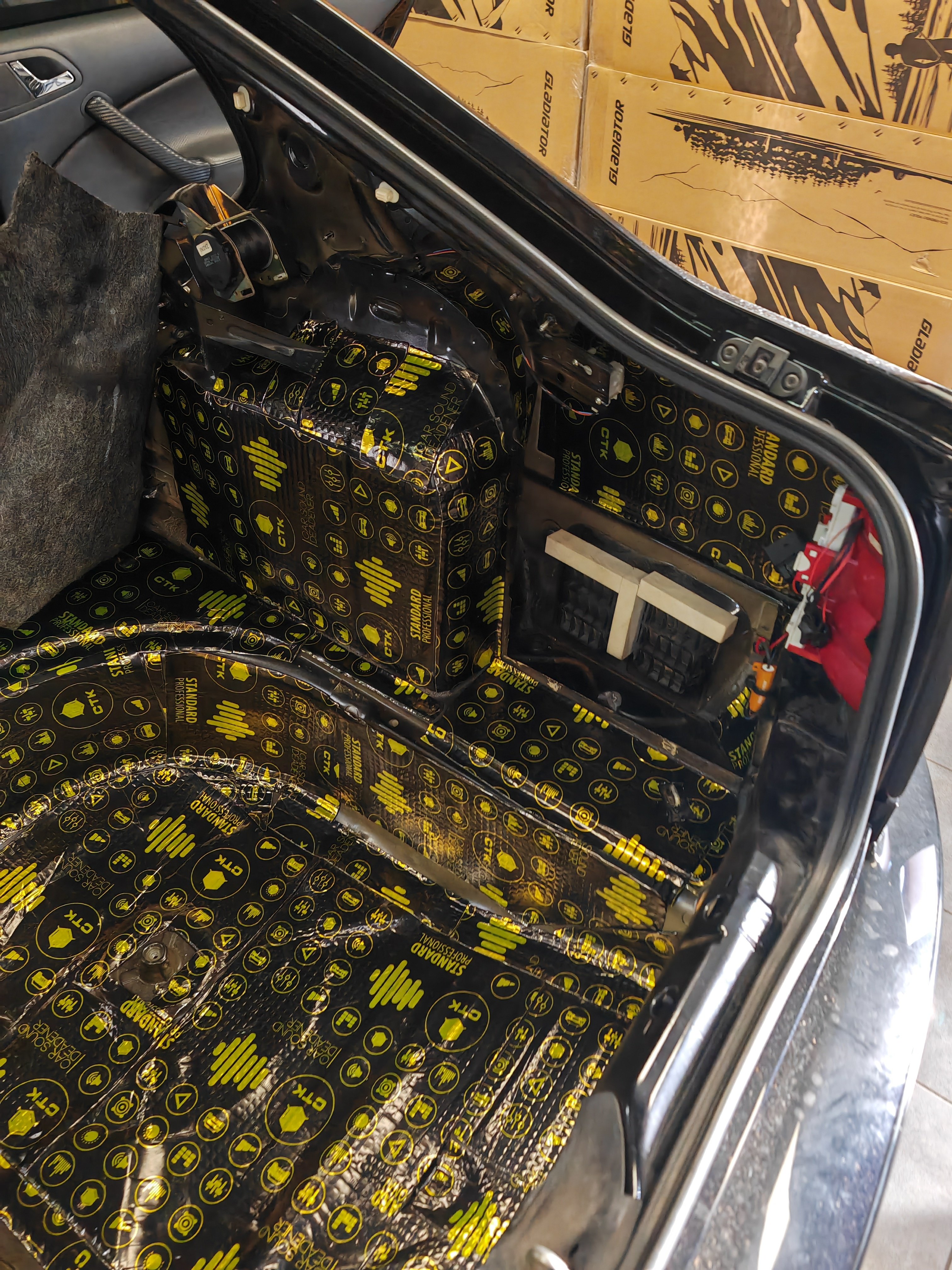

Trunk 5th door insulation was made in 4 layers, Butyl and sponge on inner sheet and butyl and 1cm STP acoustic felt on cover panel.

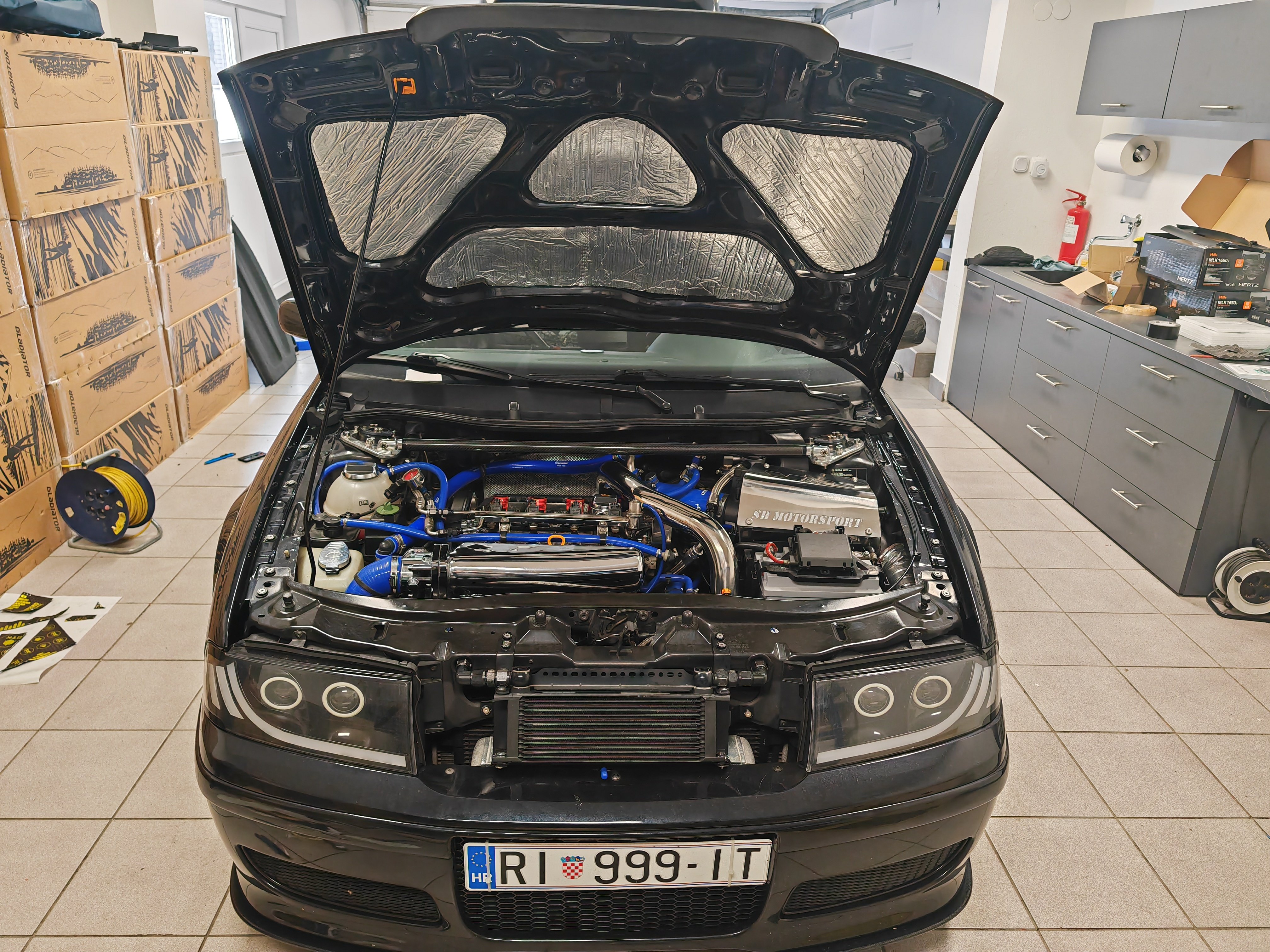

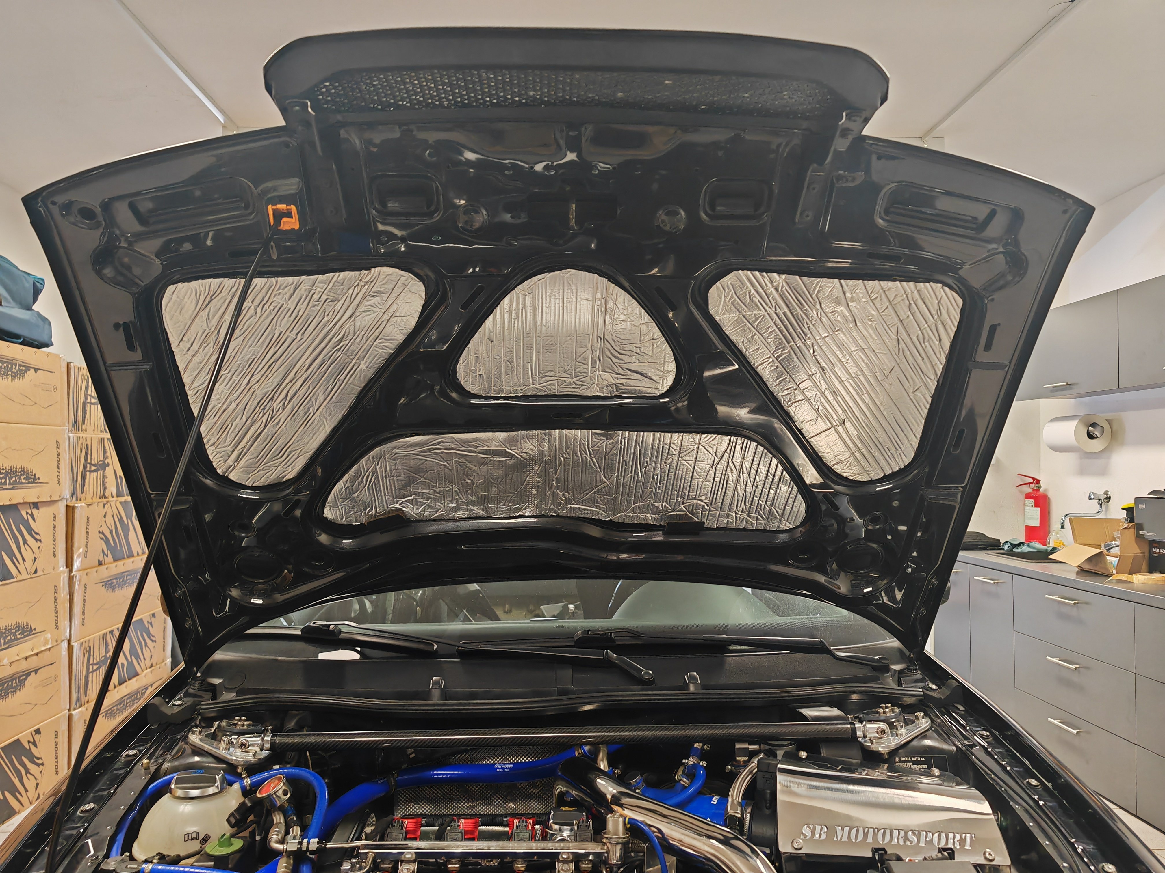

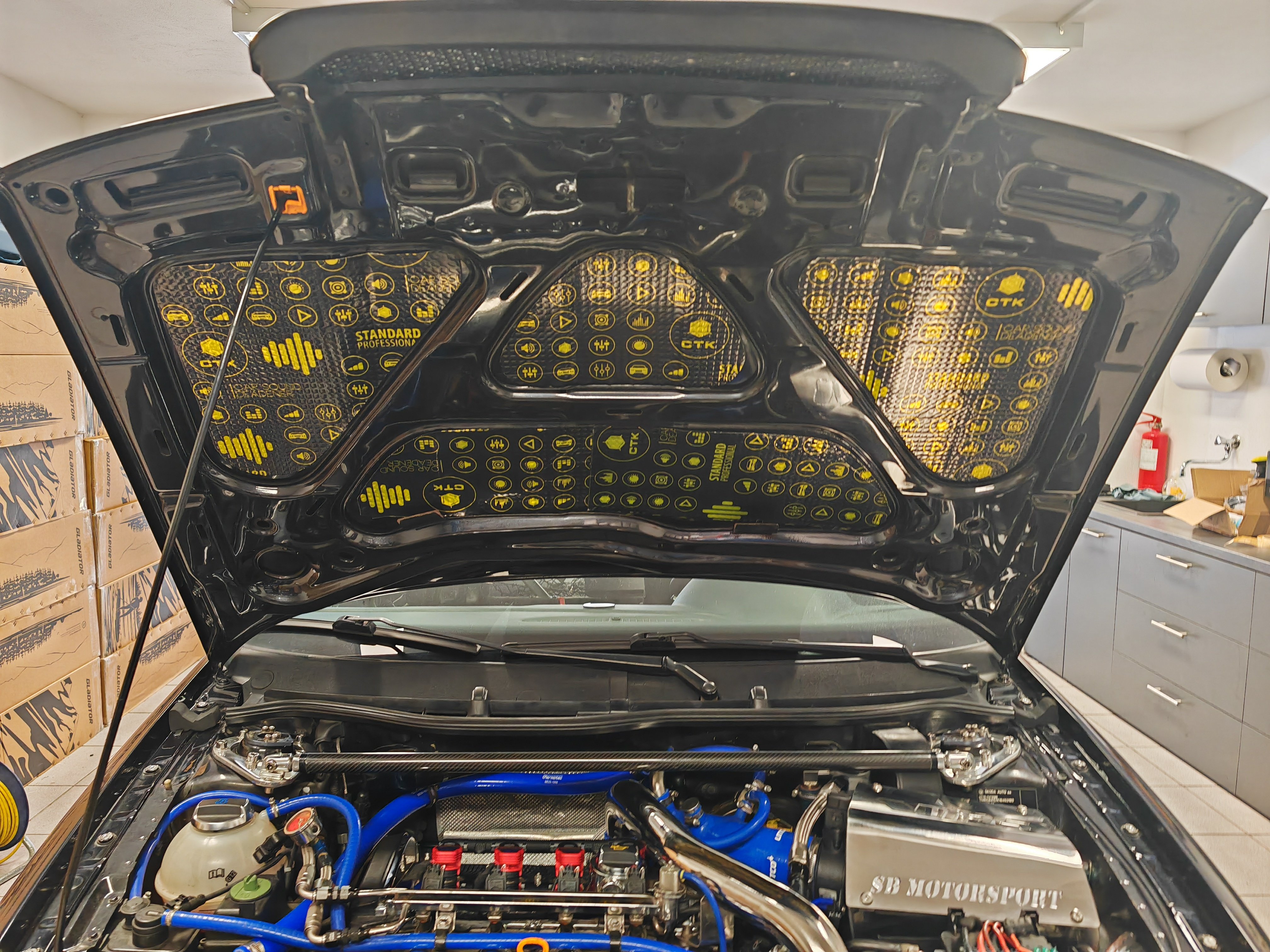

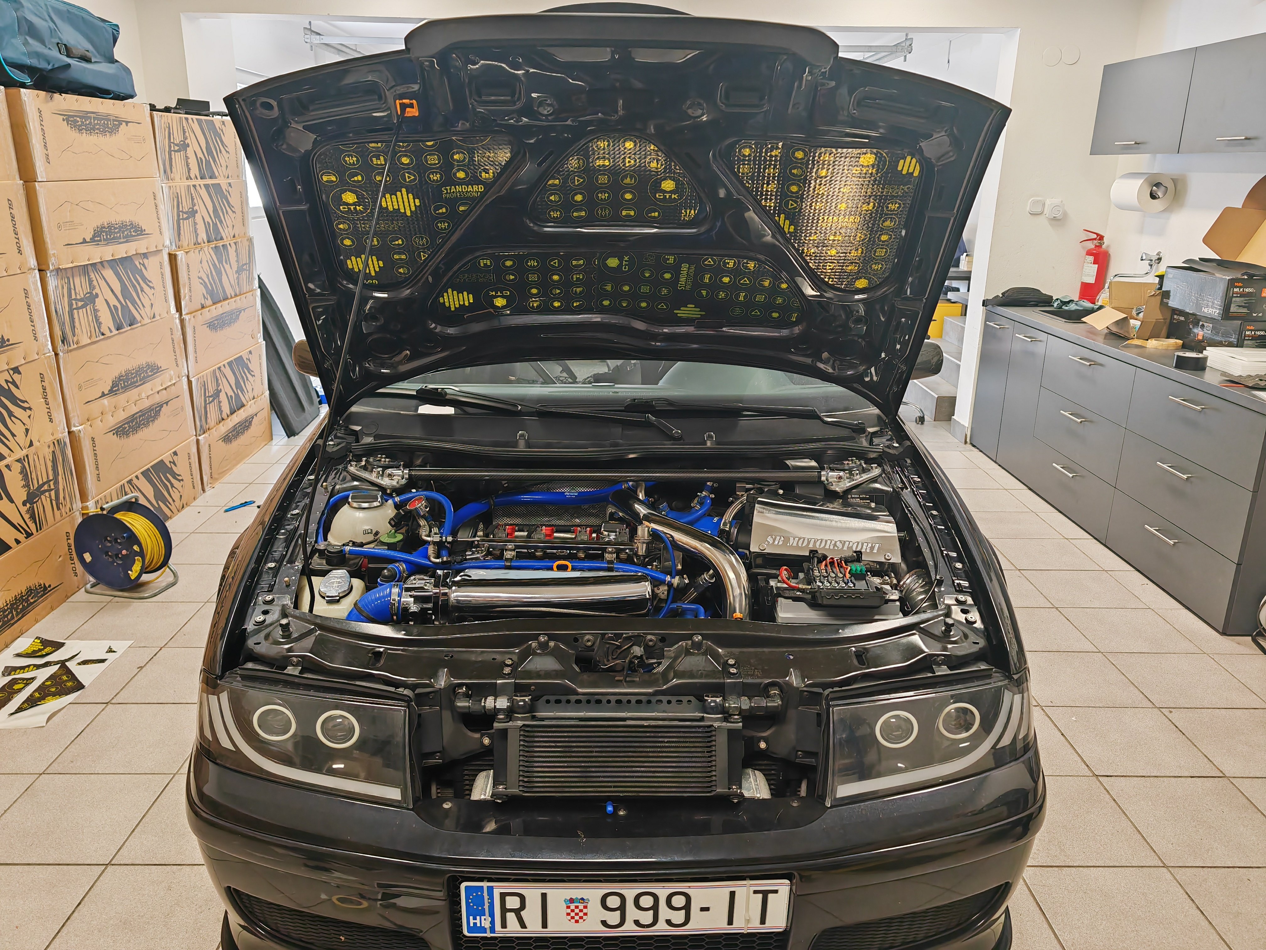

Hood was done in 2 layers, butyl and reflective alu sponge 1cm

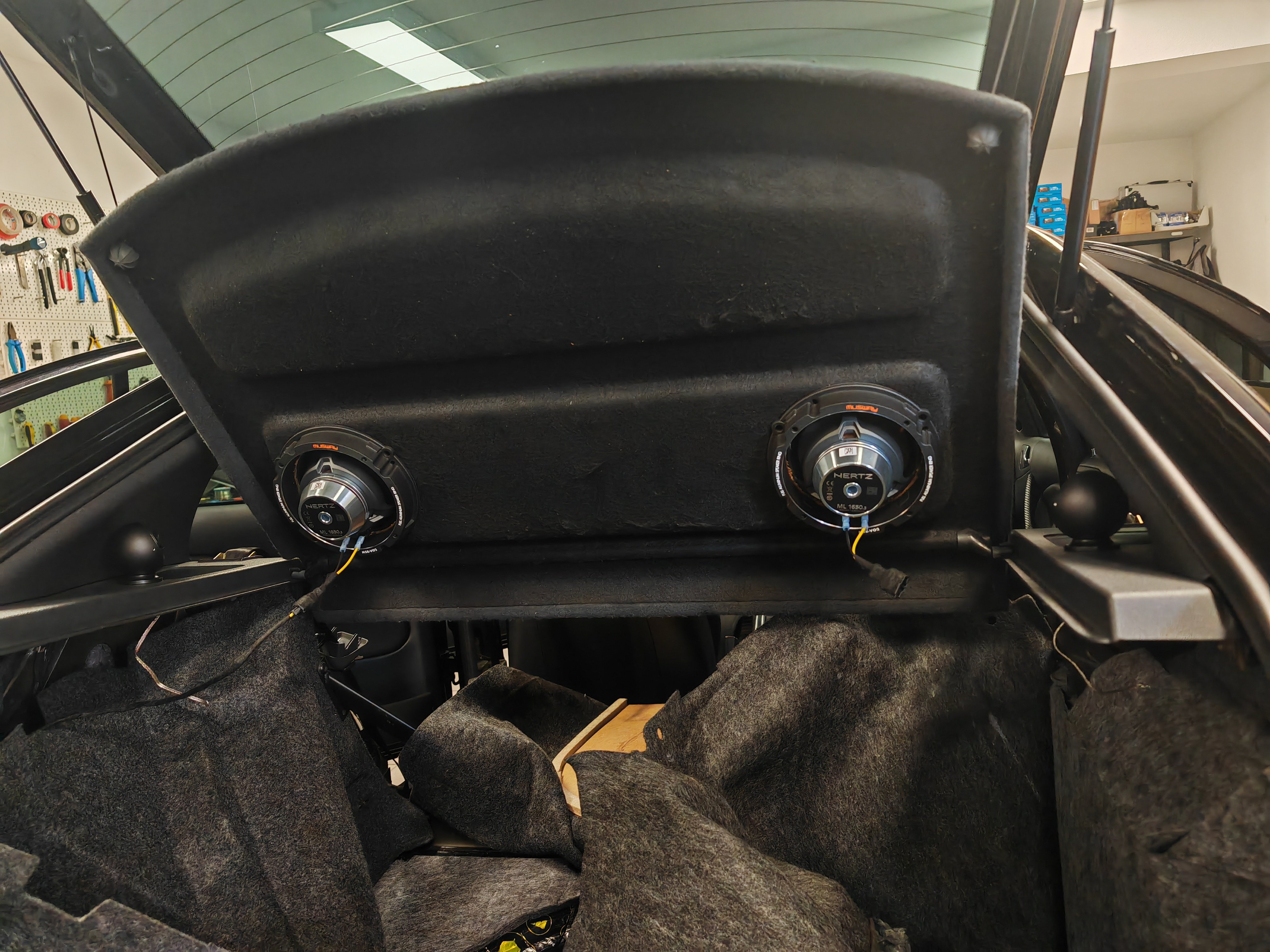

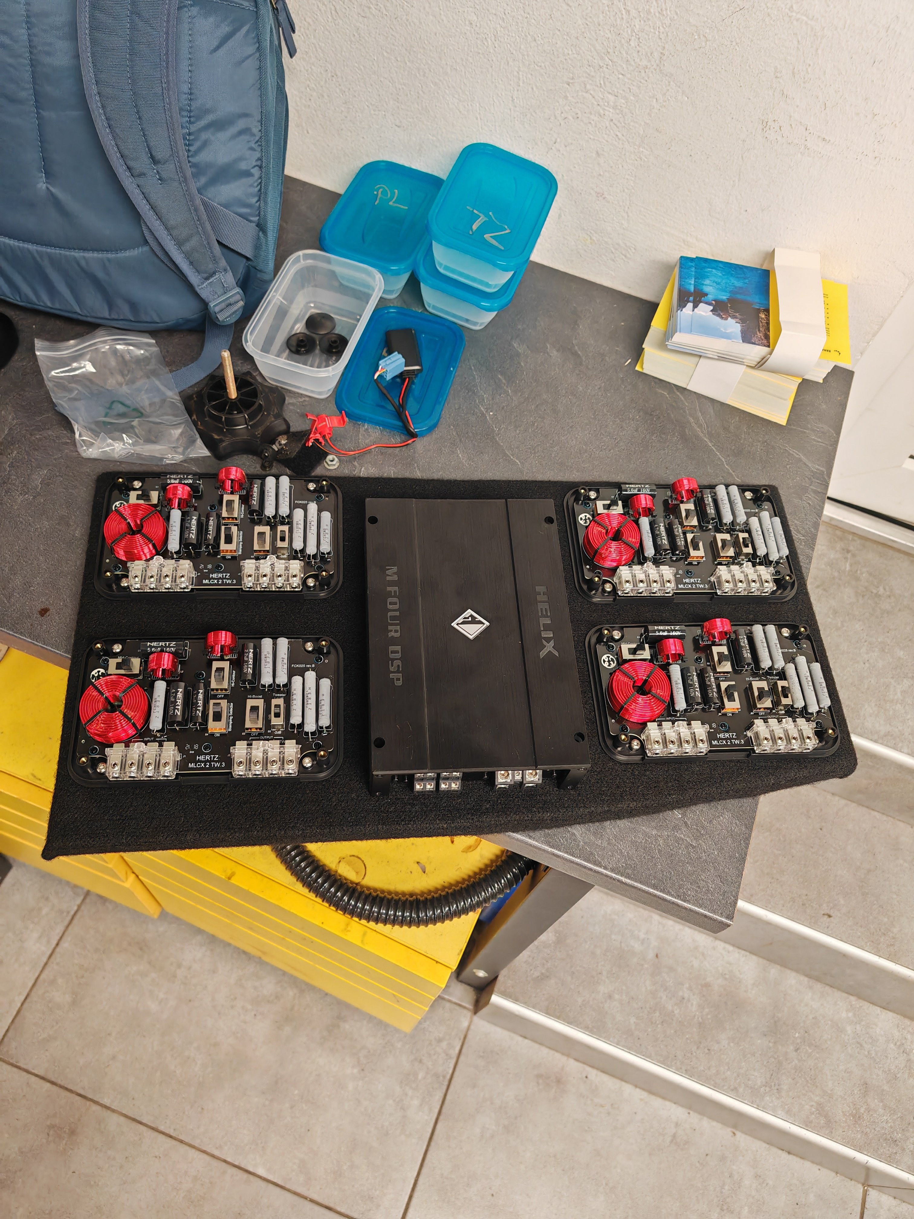

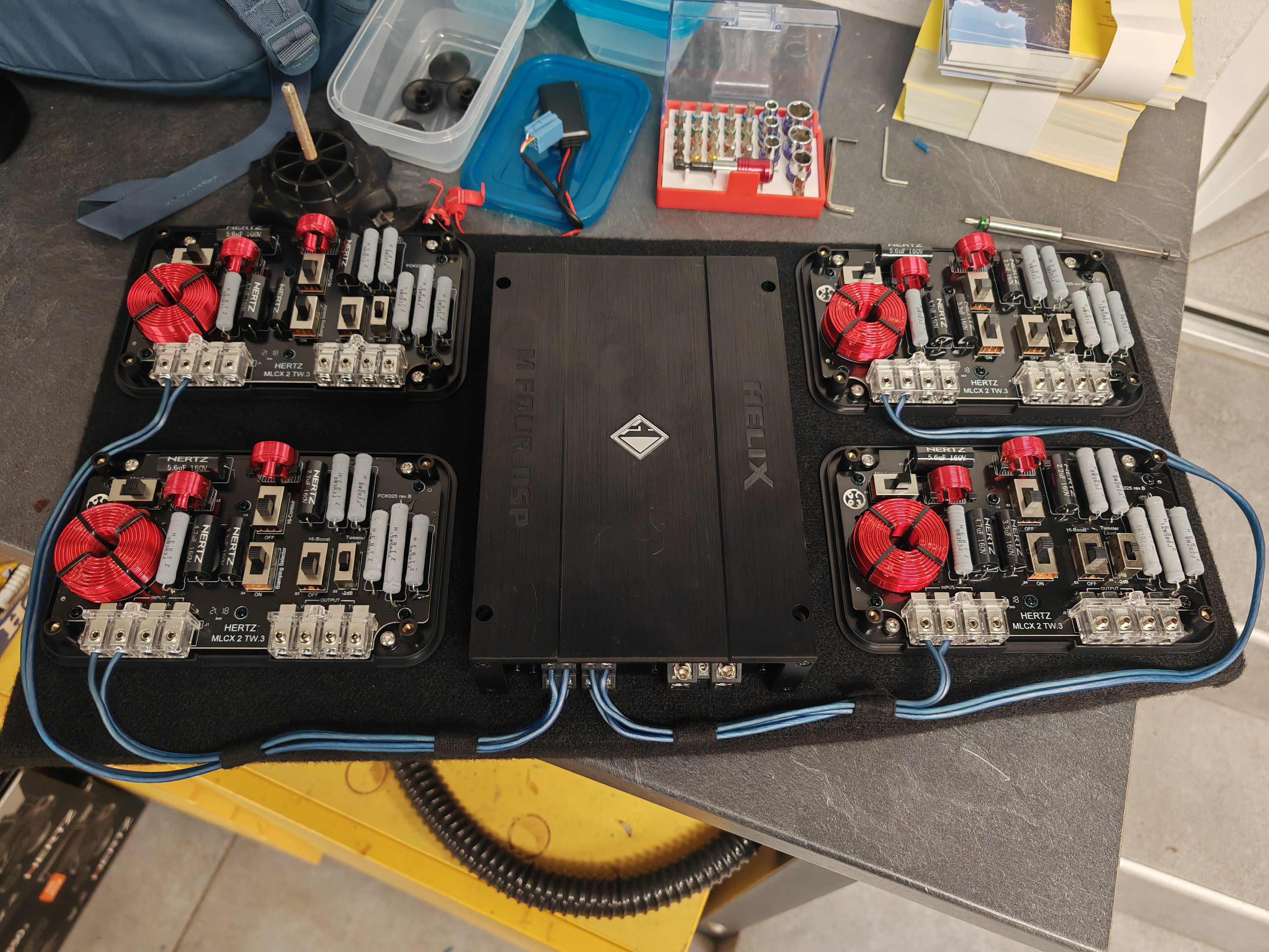

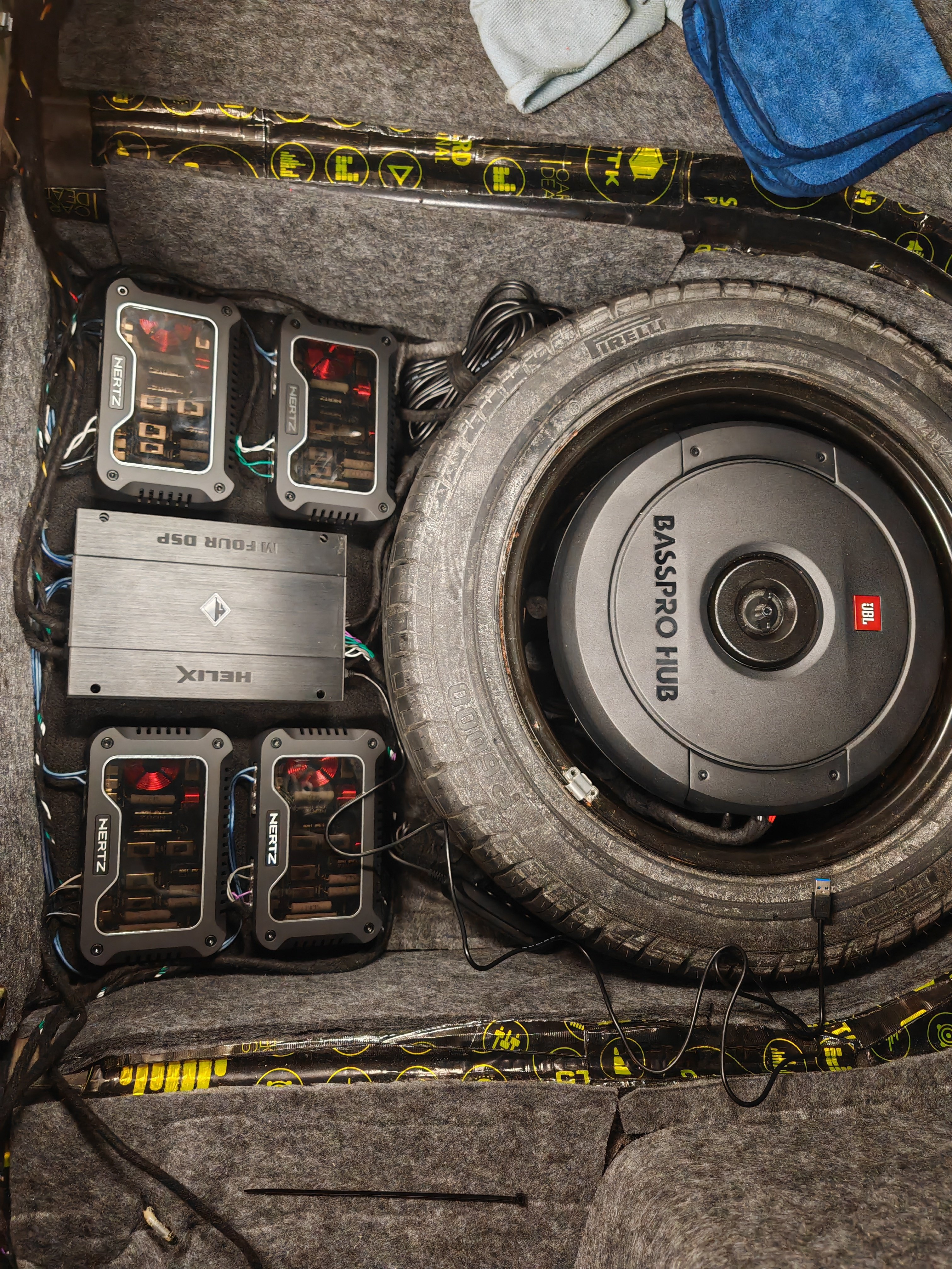

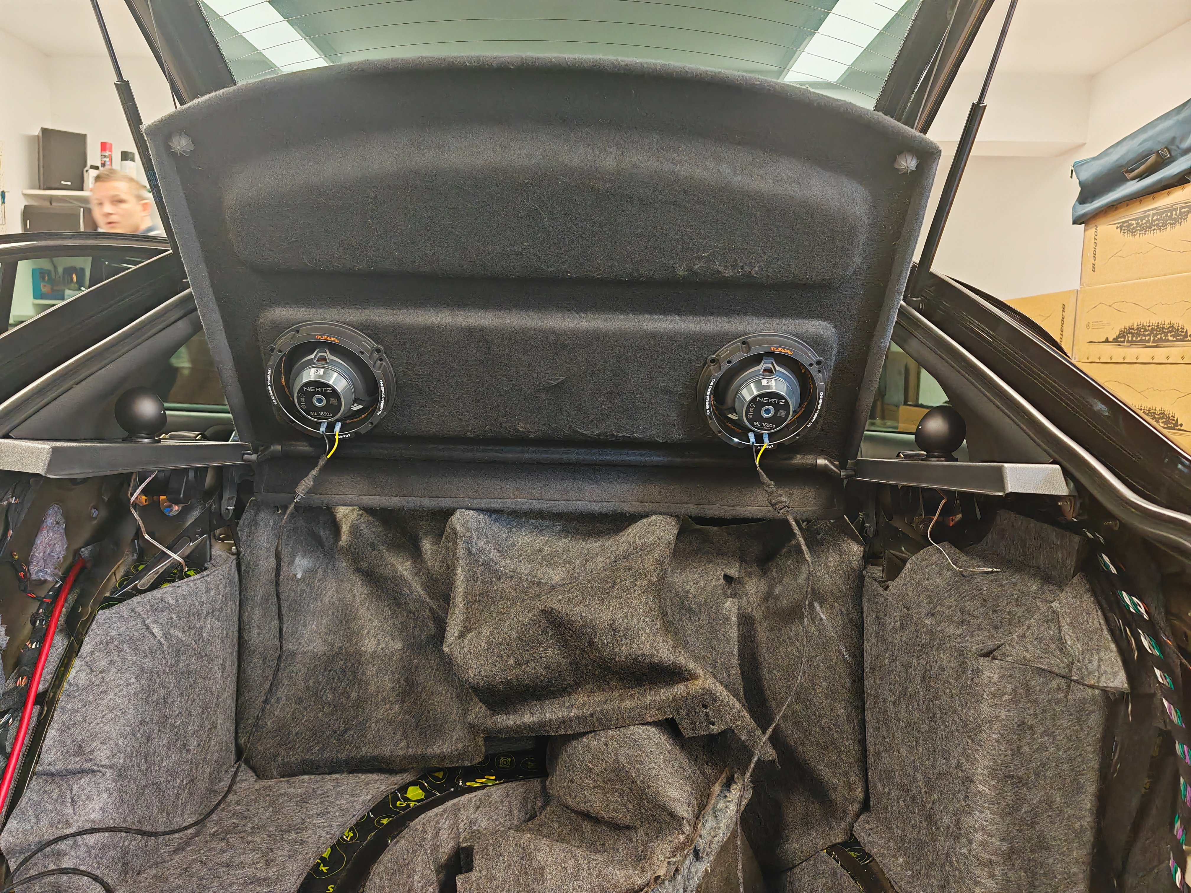

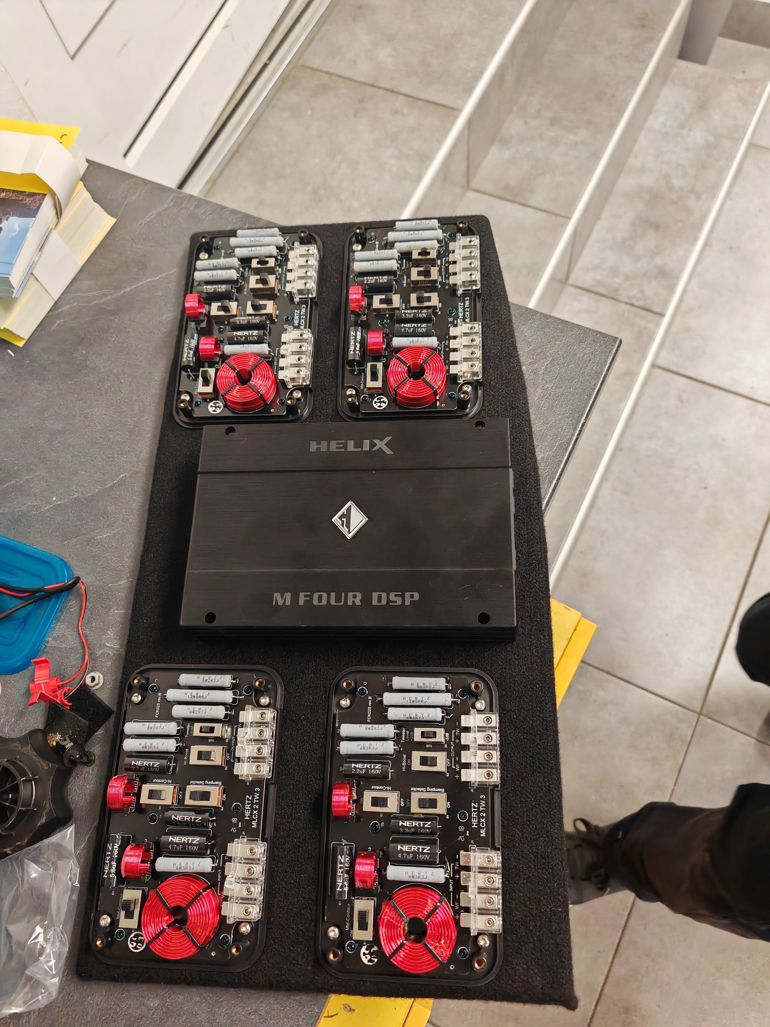

Rear shell and trunk insulation, JBL BASSPRO HUB, Helix M Four DSP smo, 4 Hertz Mile Legend crossowers to come together with tweeters in custom alu pods and AUDIOTEC Fischer conductor-EISA award for BEST product 2021/22💪😇

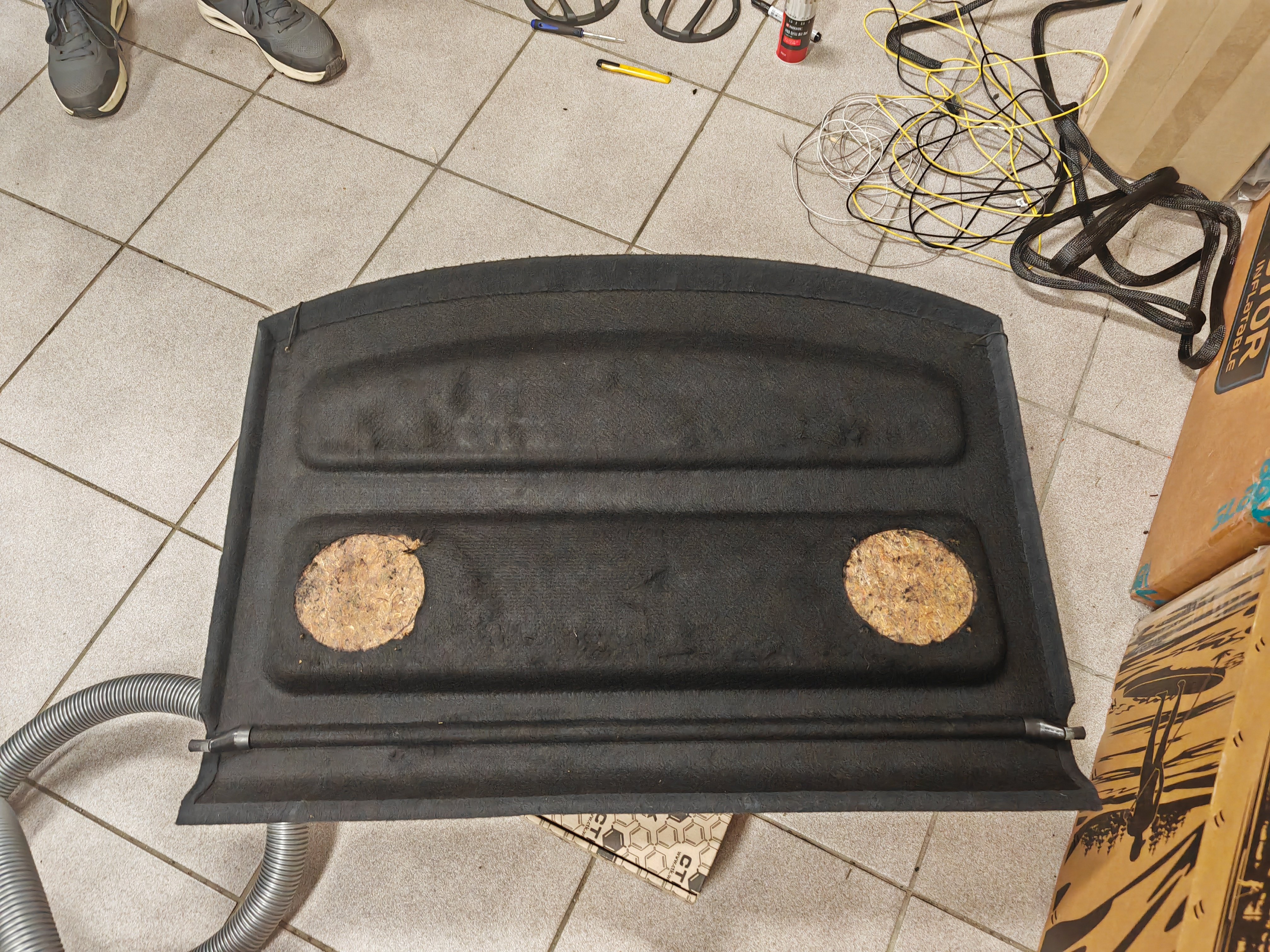

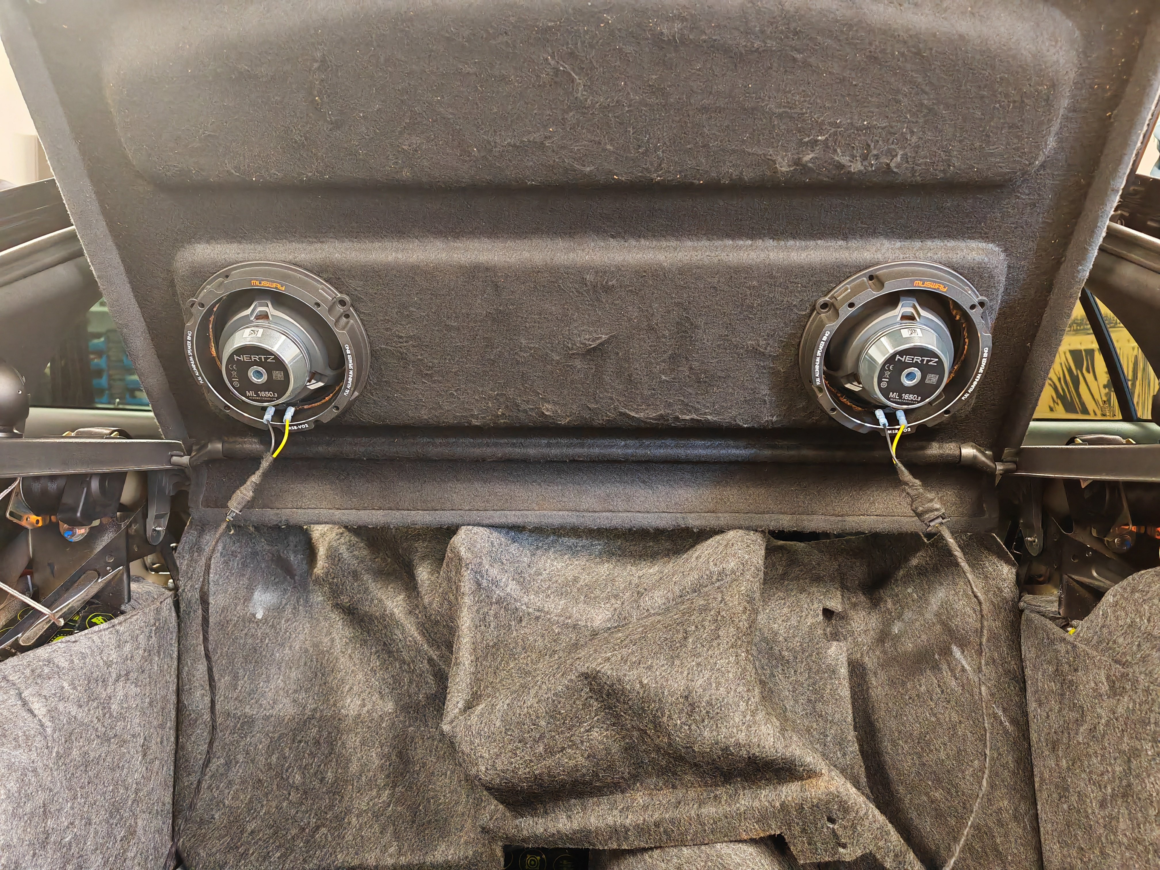

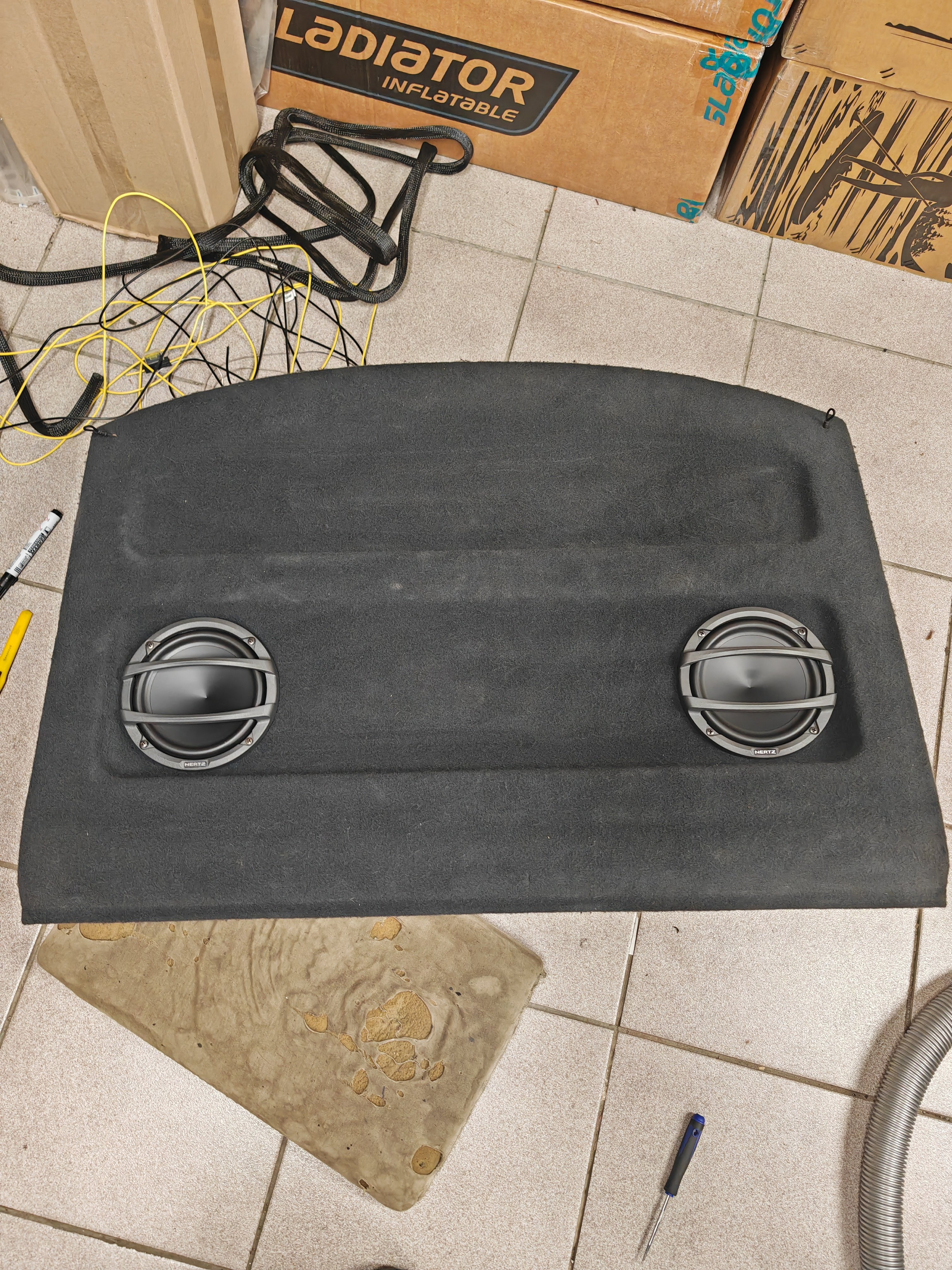

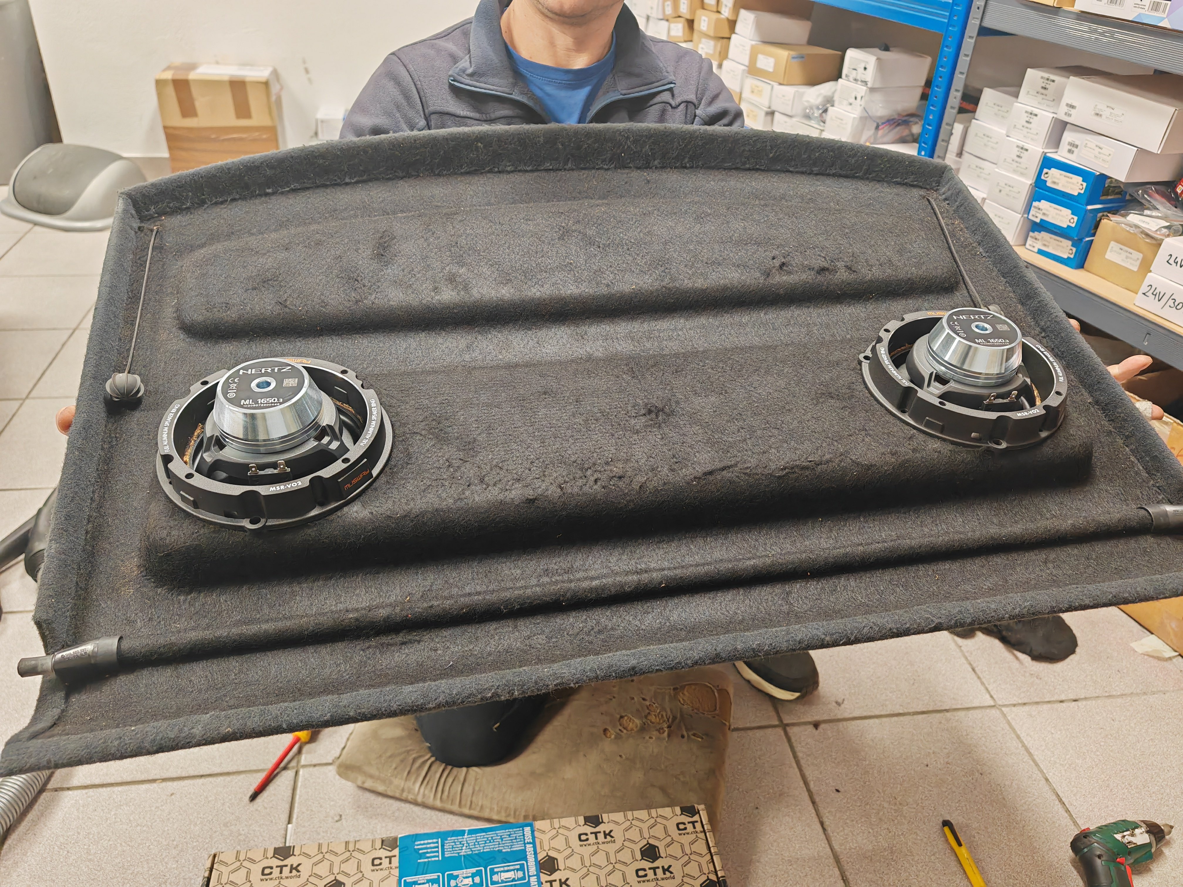

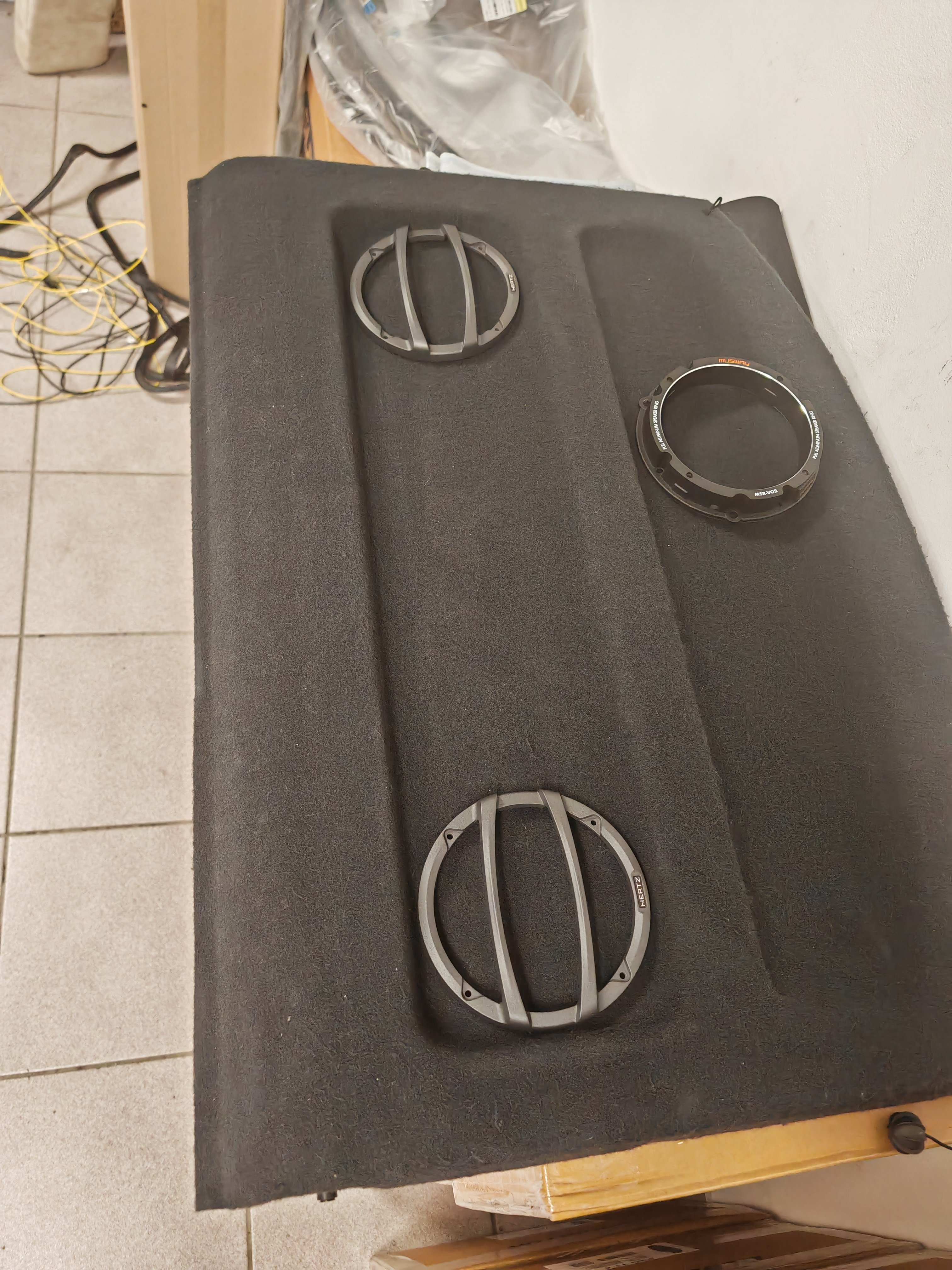

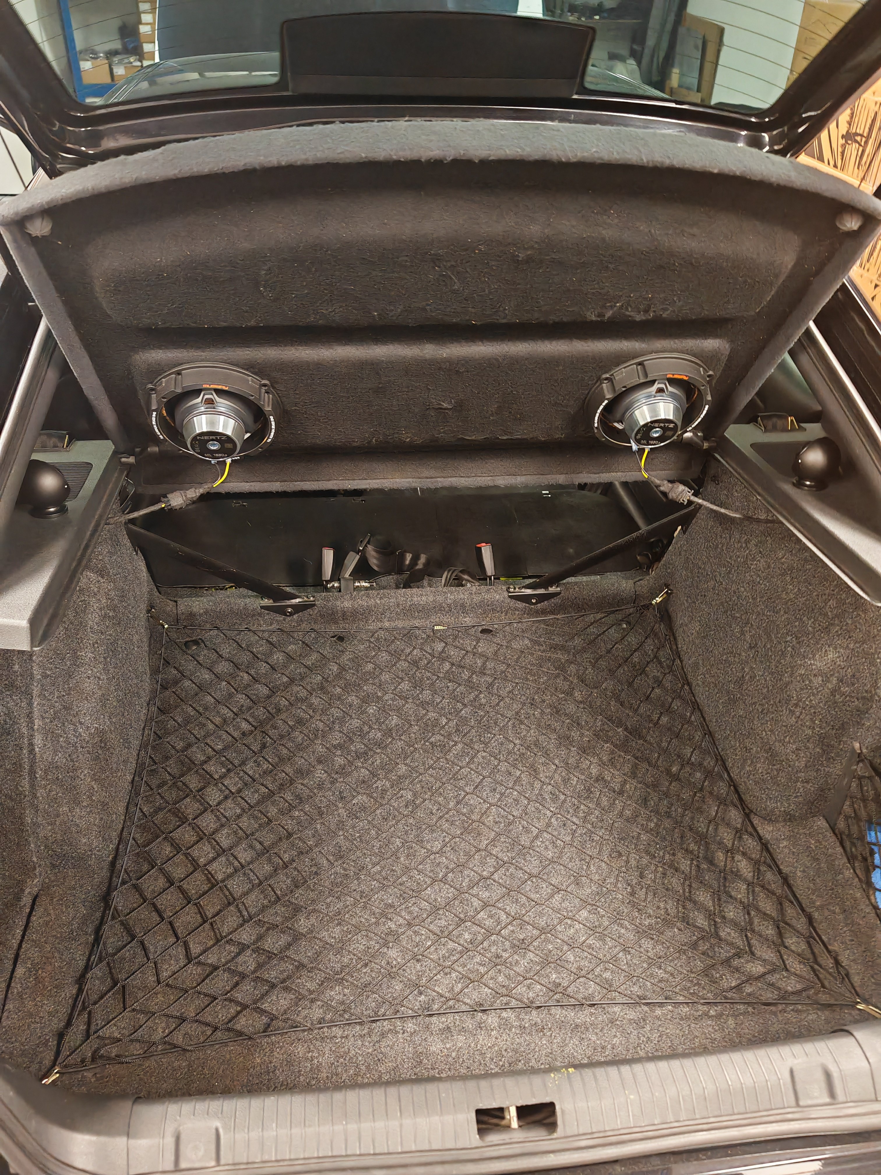

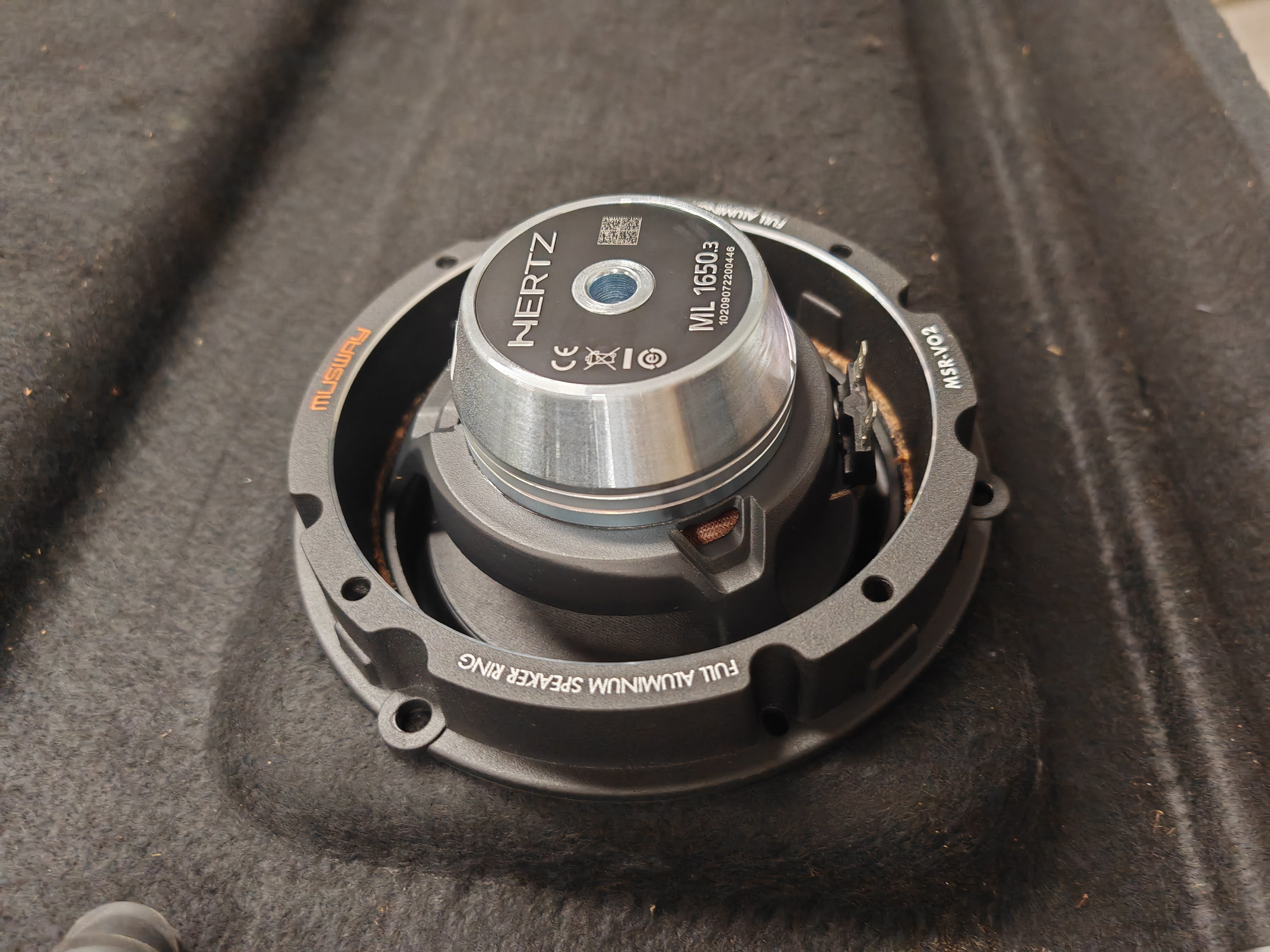

Rear shelf turned to be two layers of wood with alu plate in between.-noticed it after cuting the holes. We used Musway alu adapter rings (intended to be used on front doors but hole pattern differs) from underside to additionally stiffen it and it turned perfect. They have  fast connections on each side so shell is easy removed when needed.
Edited by davojuri

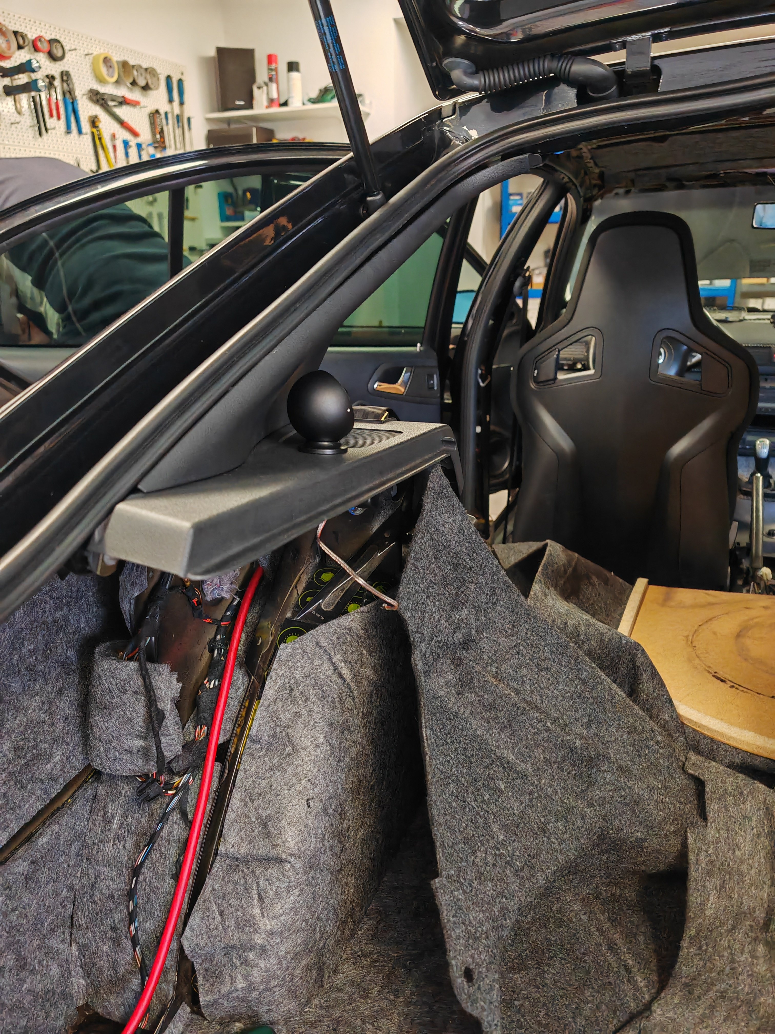

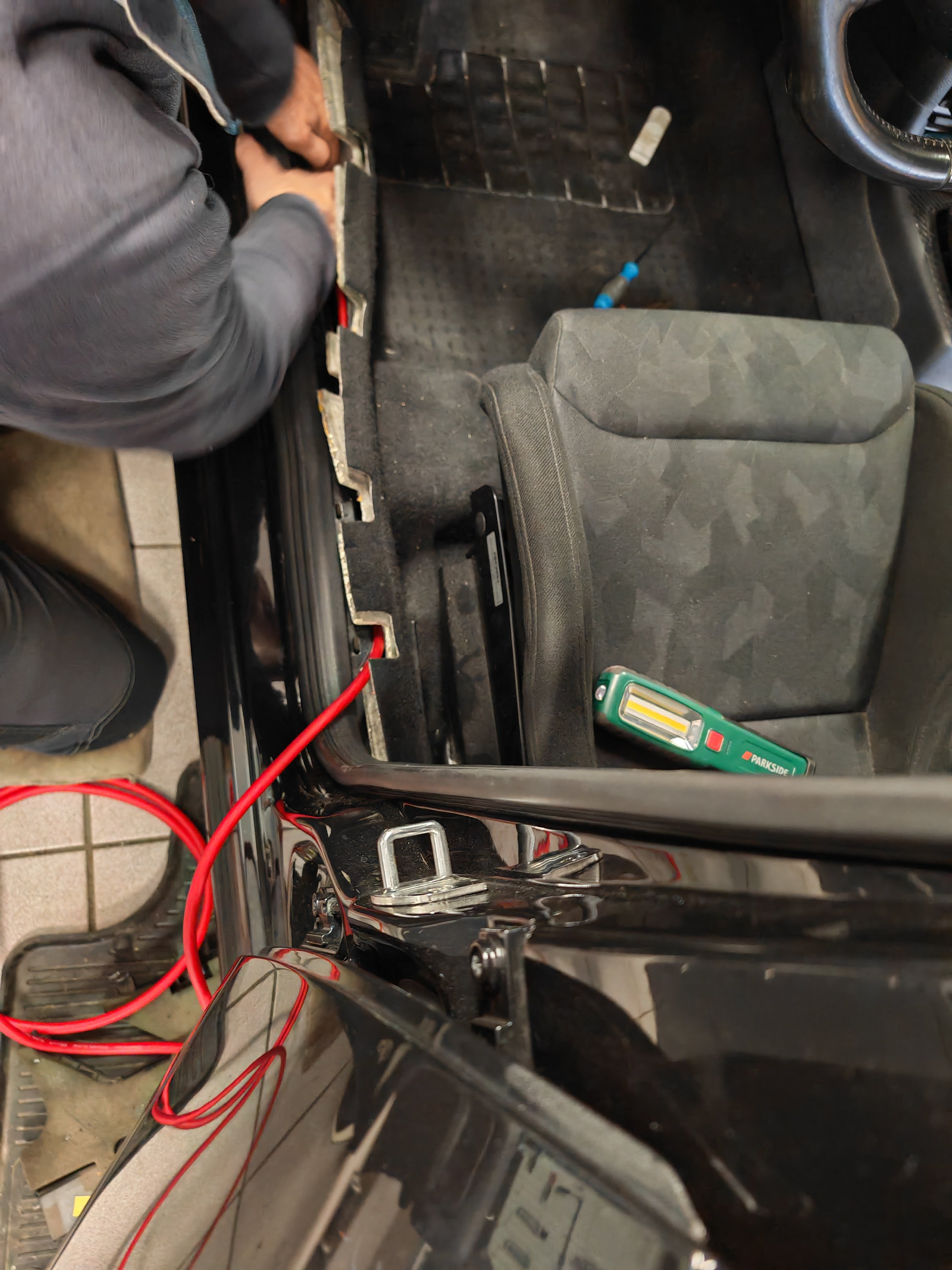

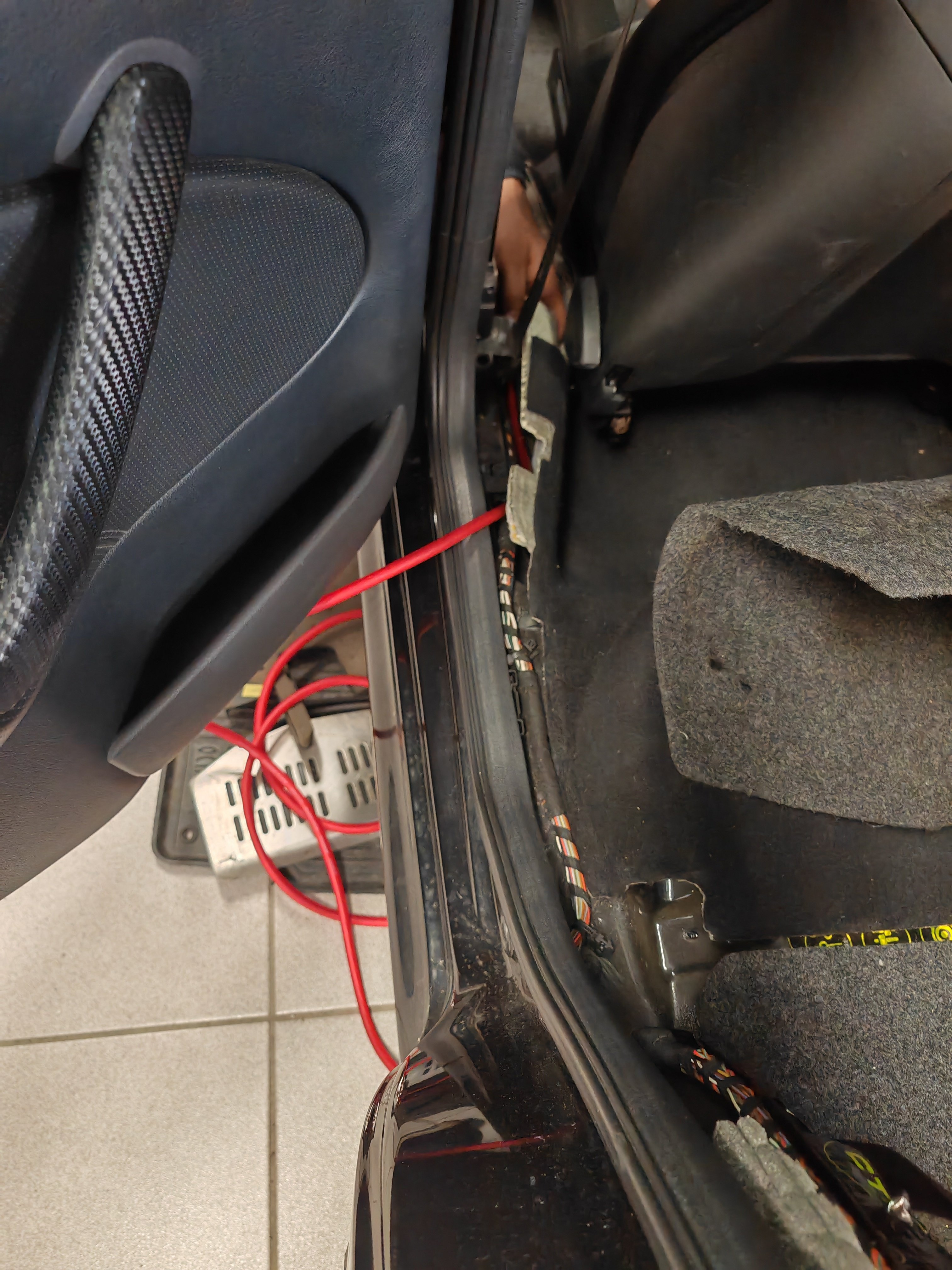

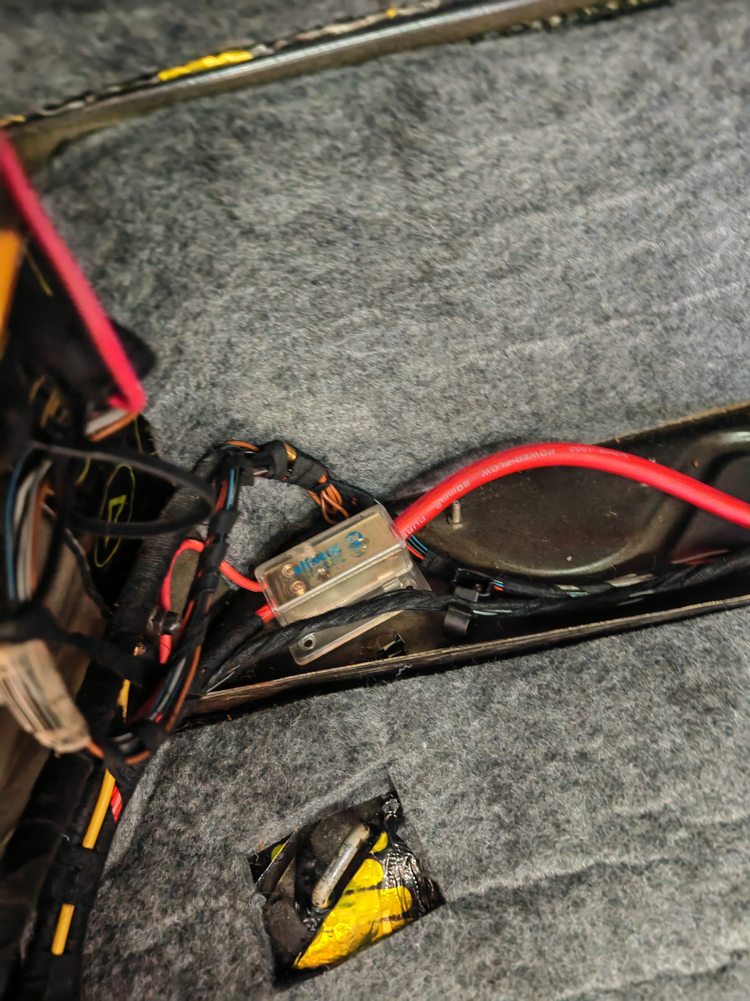

Ampncavle on driver side and anotjer Cable for Alpine Halo 11"innnear future on passenger side

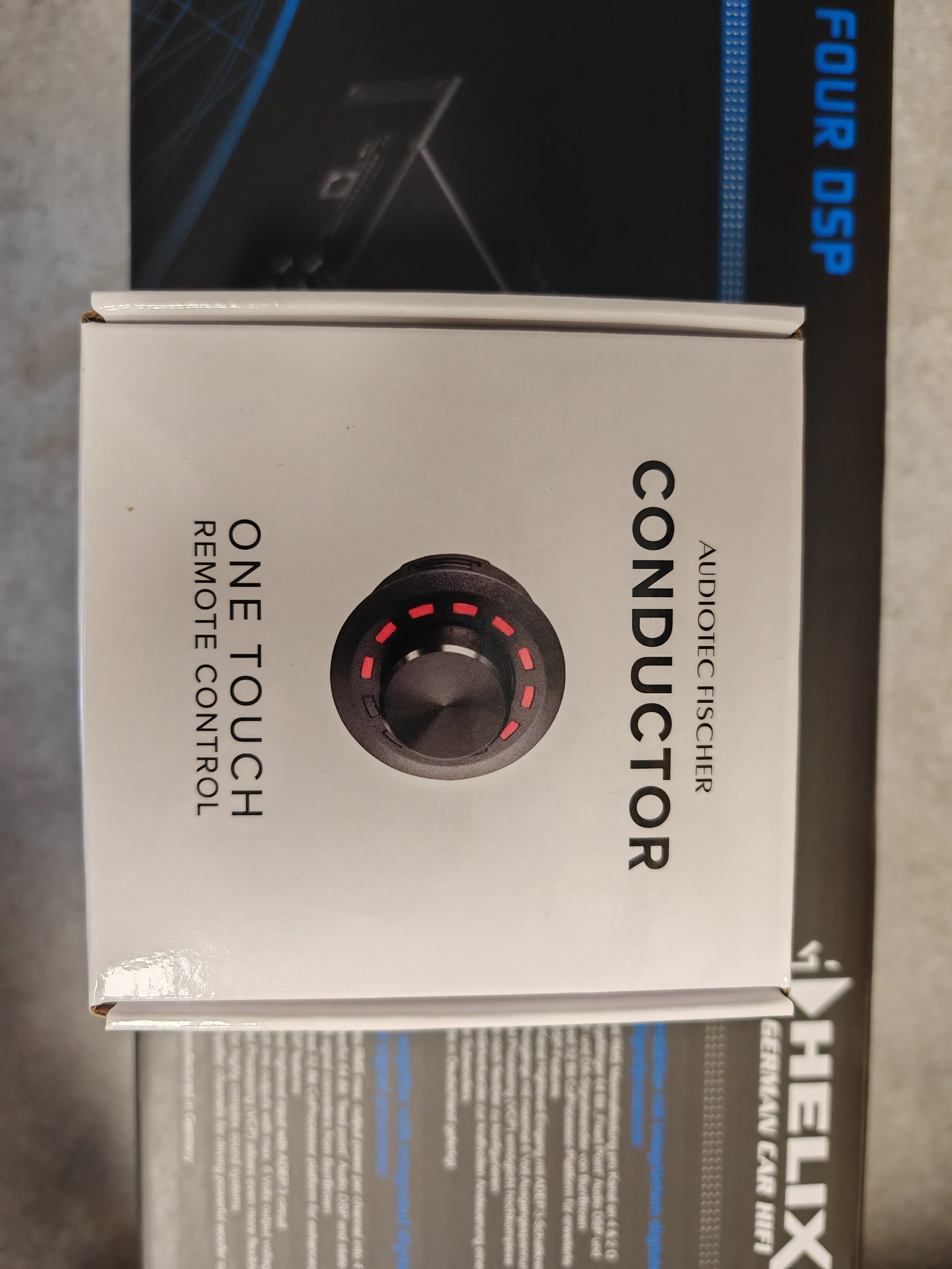

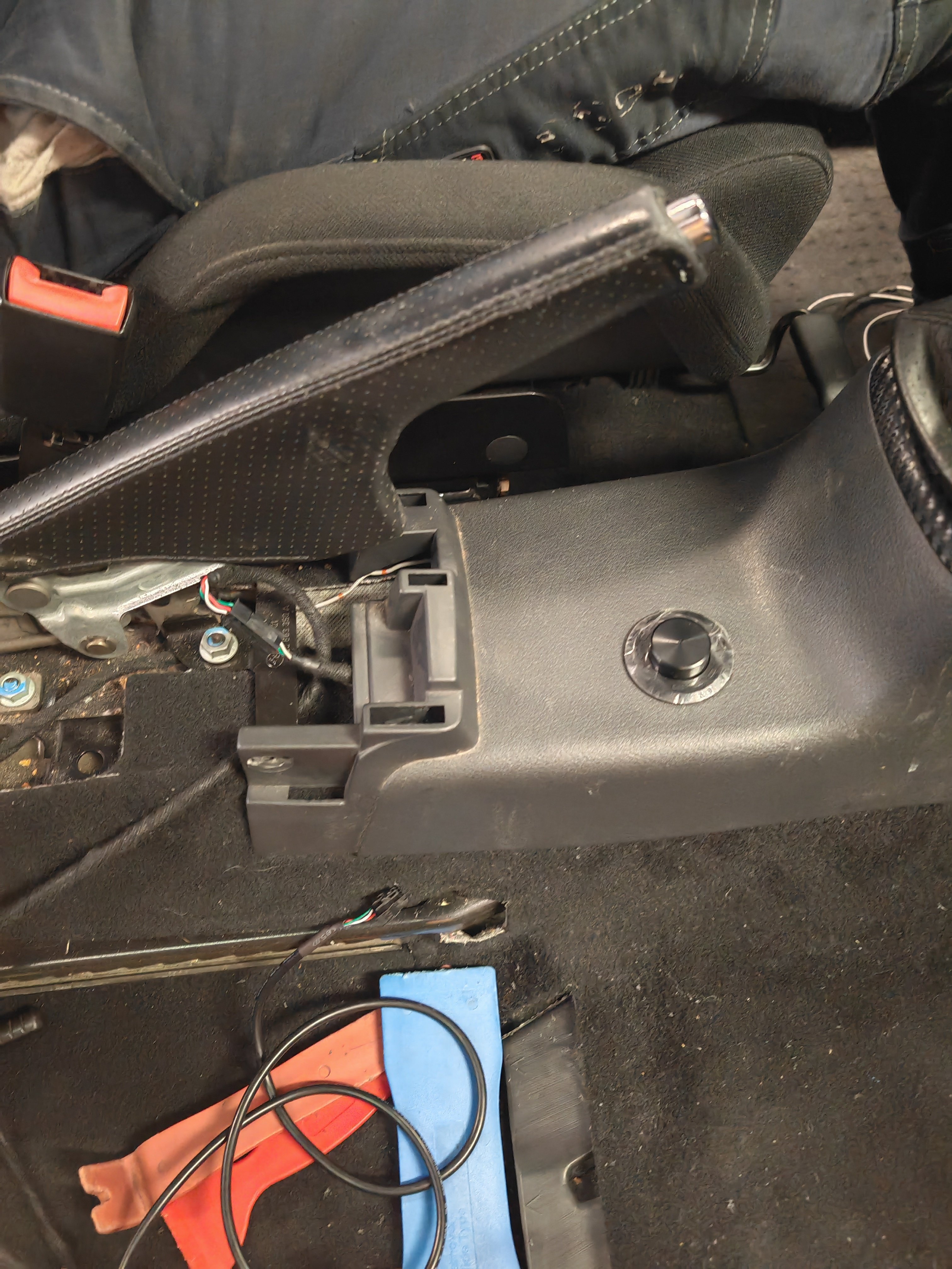

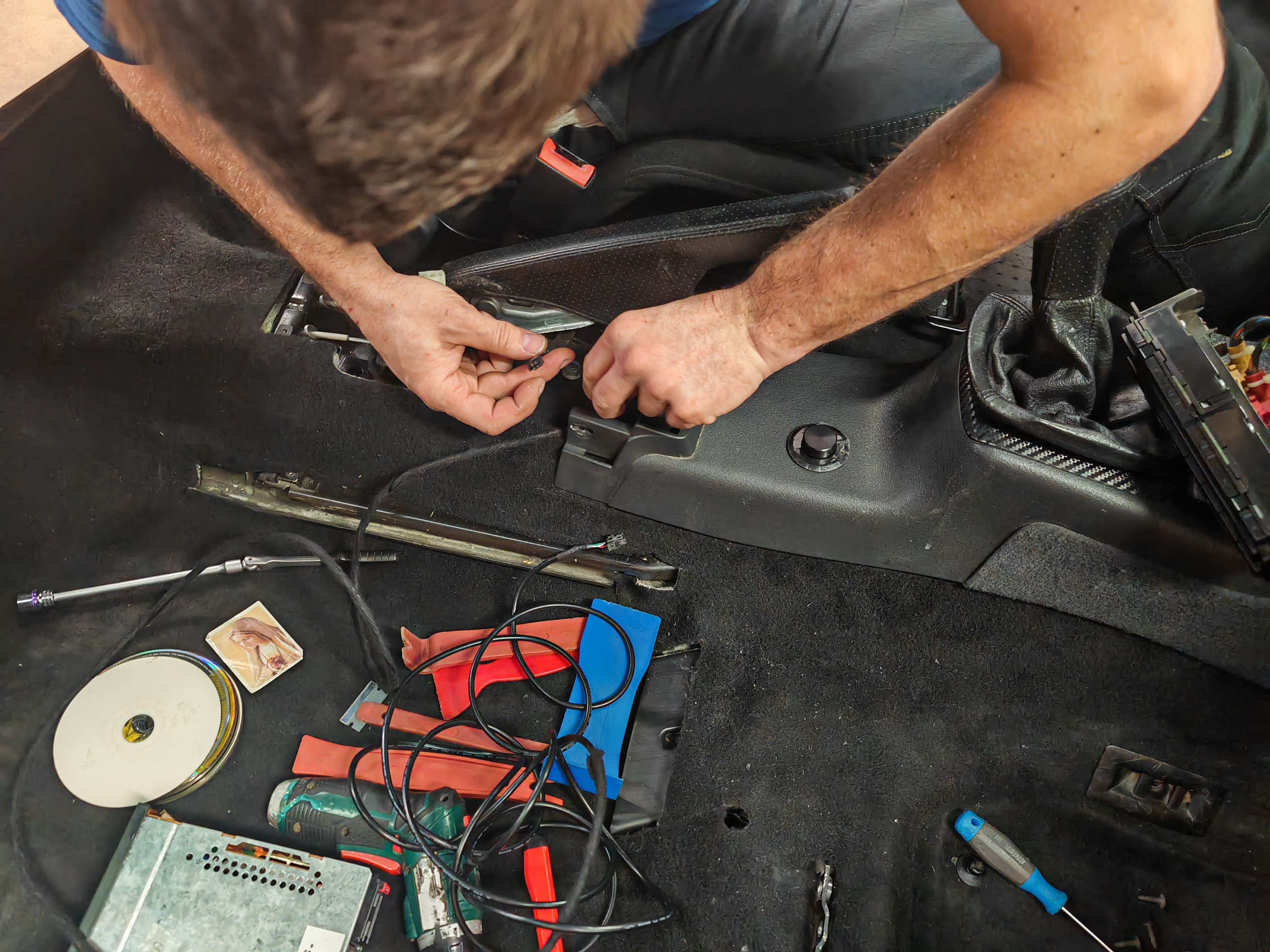

Behond the gerabox stick-shift we installed Audiotec Fischer Conductor for sub control and other programable controls in future when upgradeIMG_20240214_112938.thumb.jpg.670d2efa2eb9d4bdad26eb7734556cc5.jpg to Alpine Halo11

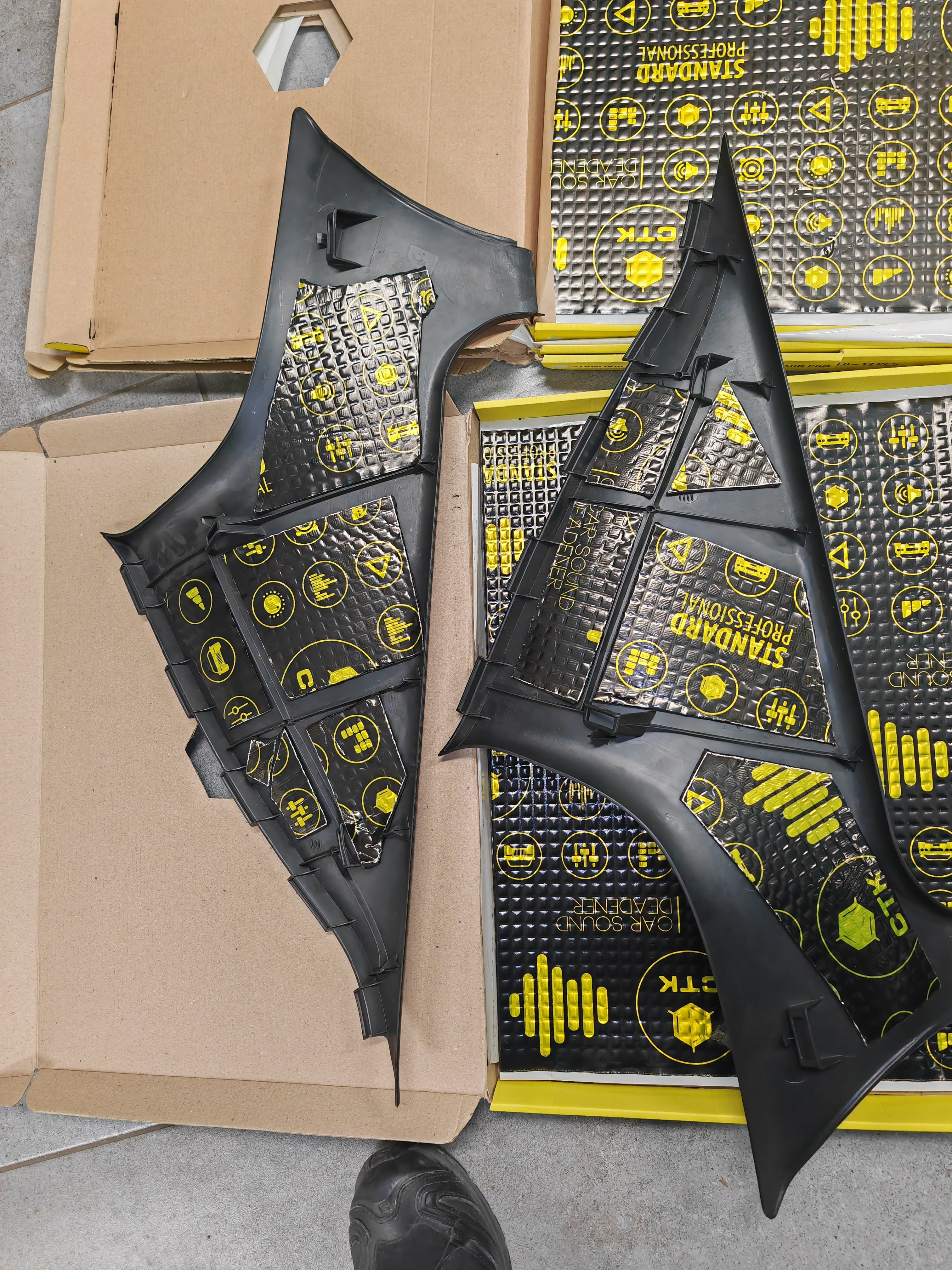

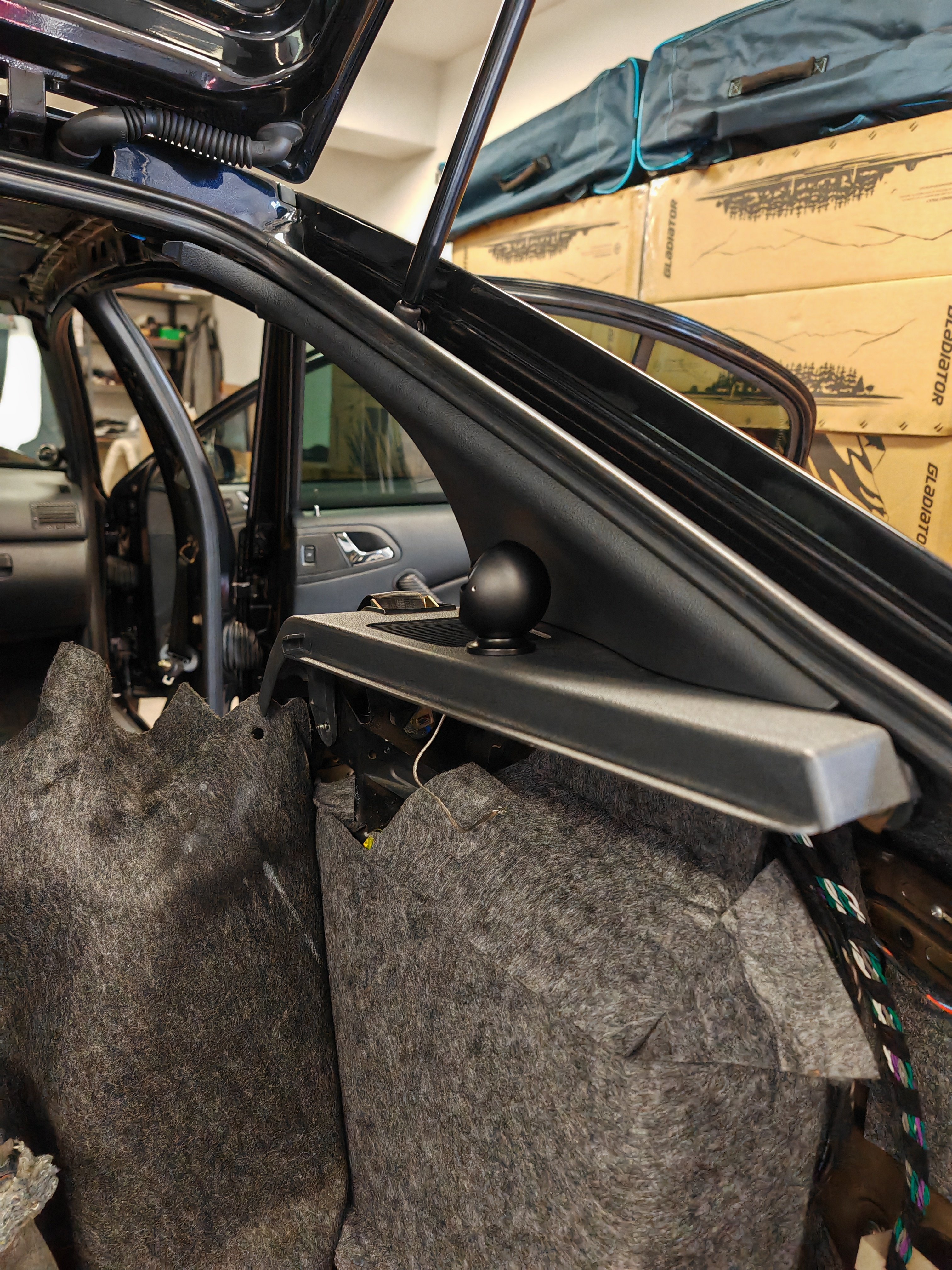

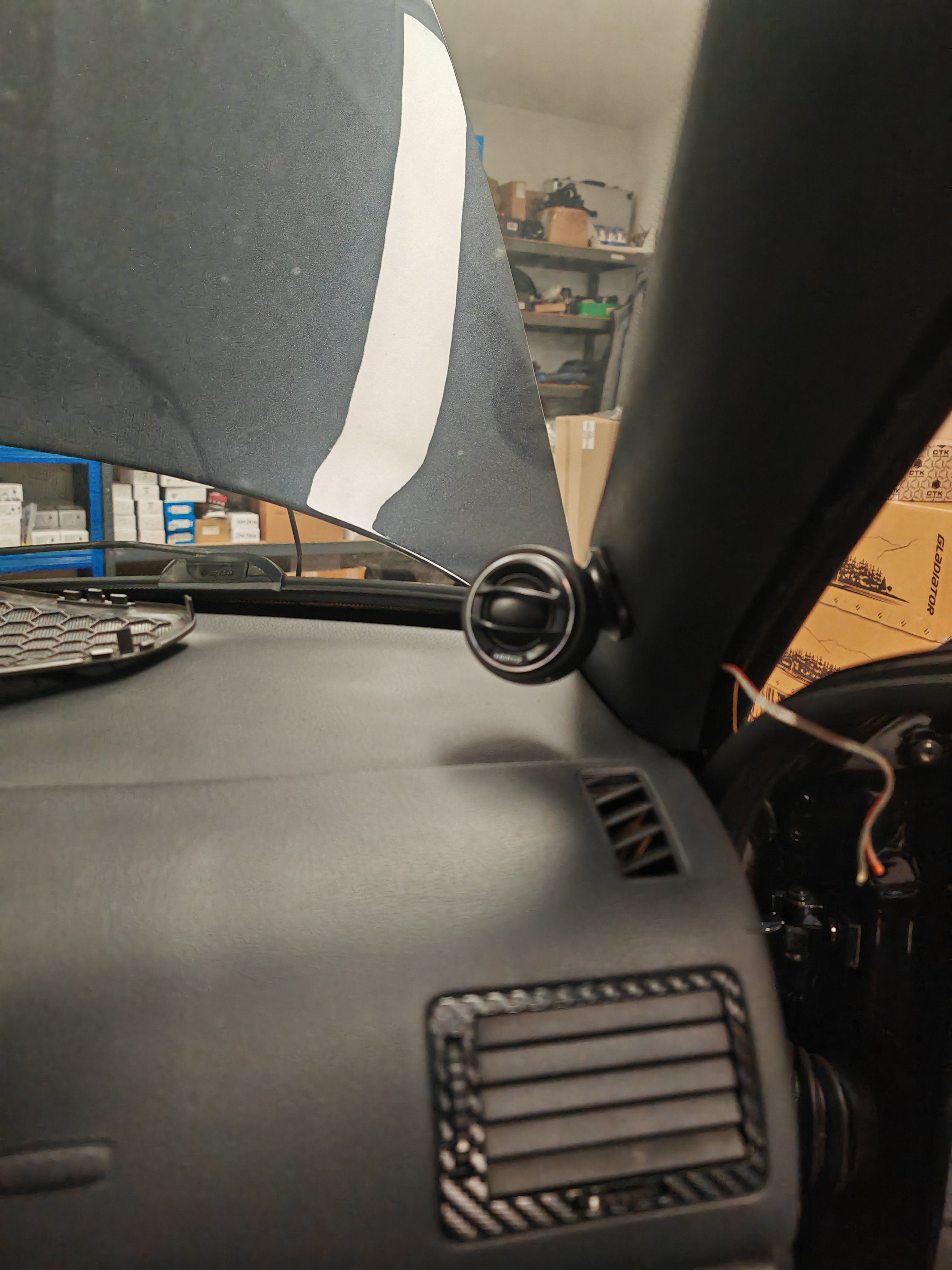

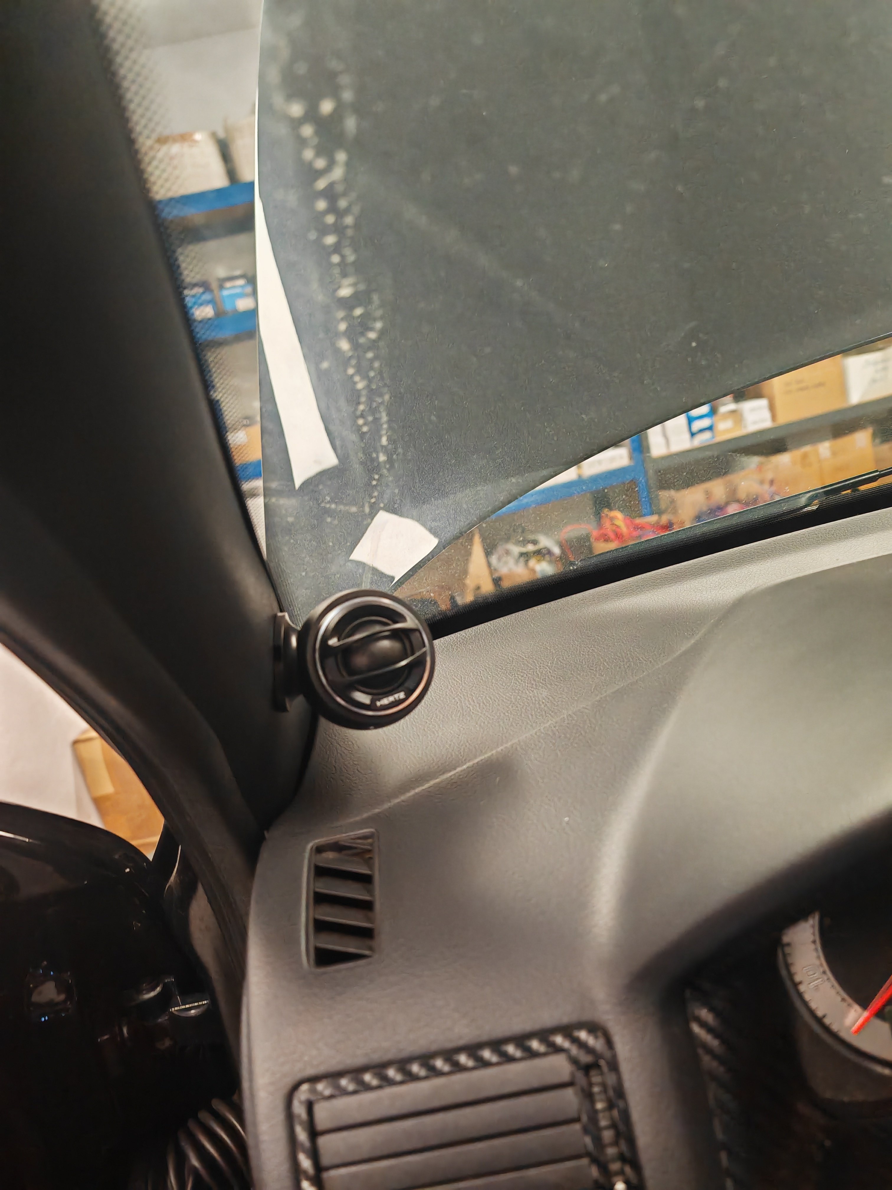

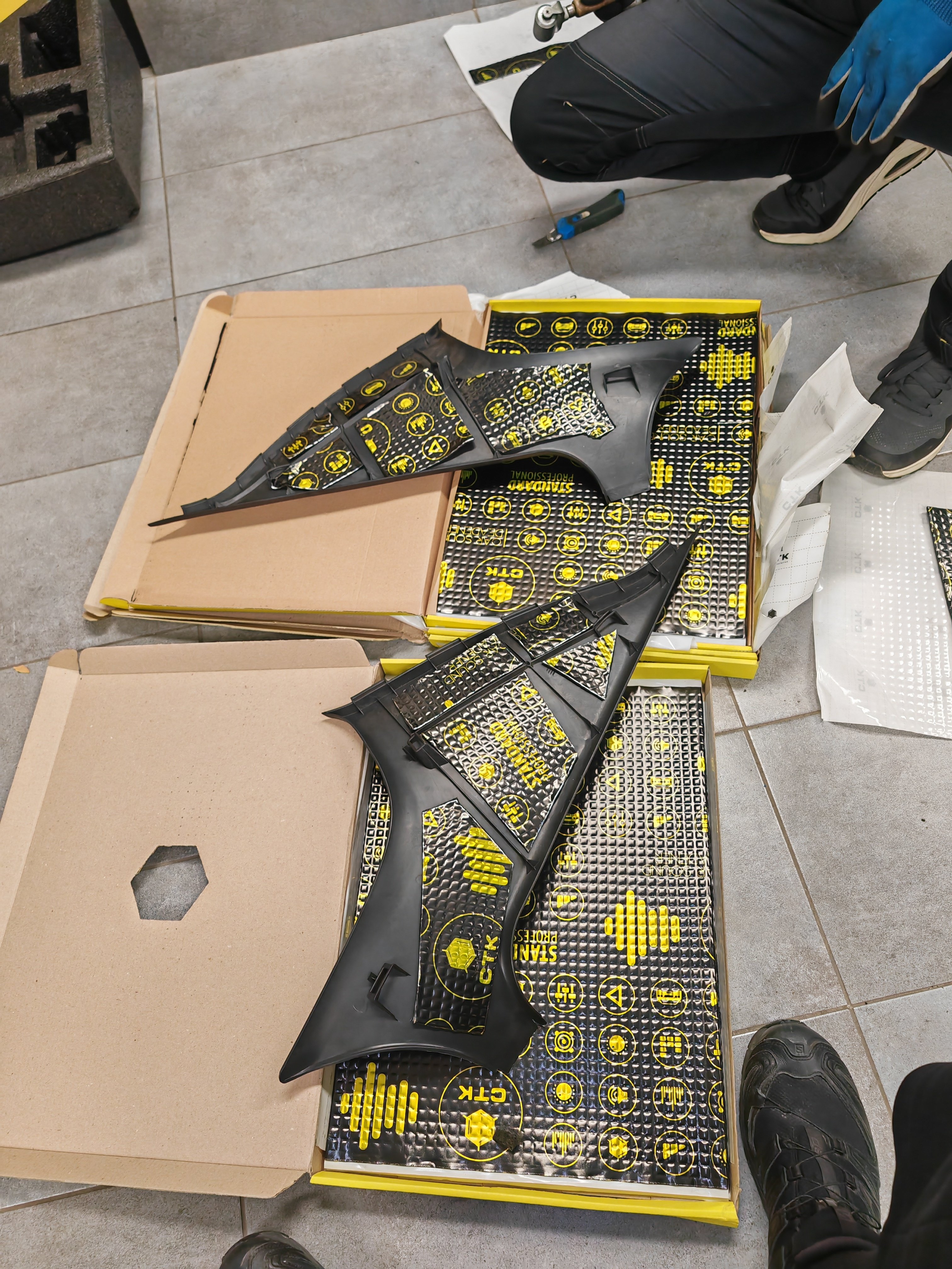

Custom tweeter alu pods black powdercoated for front A pillars and rear ones behind C Pillaras where rear woofwes were. Insulated C pillars with butyl

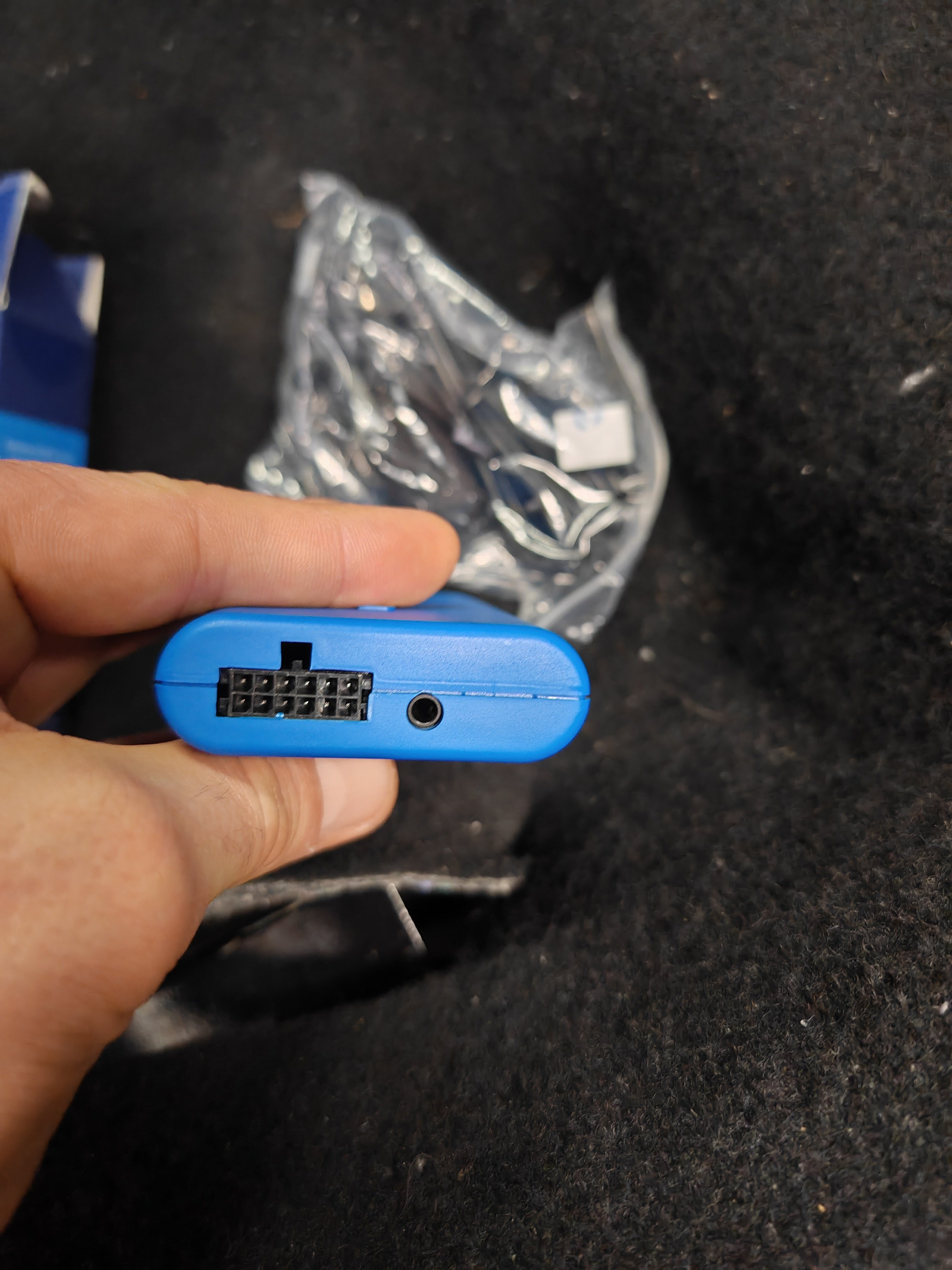

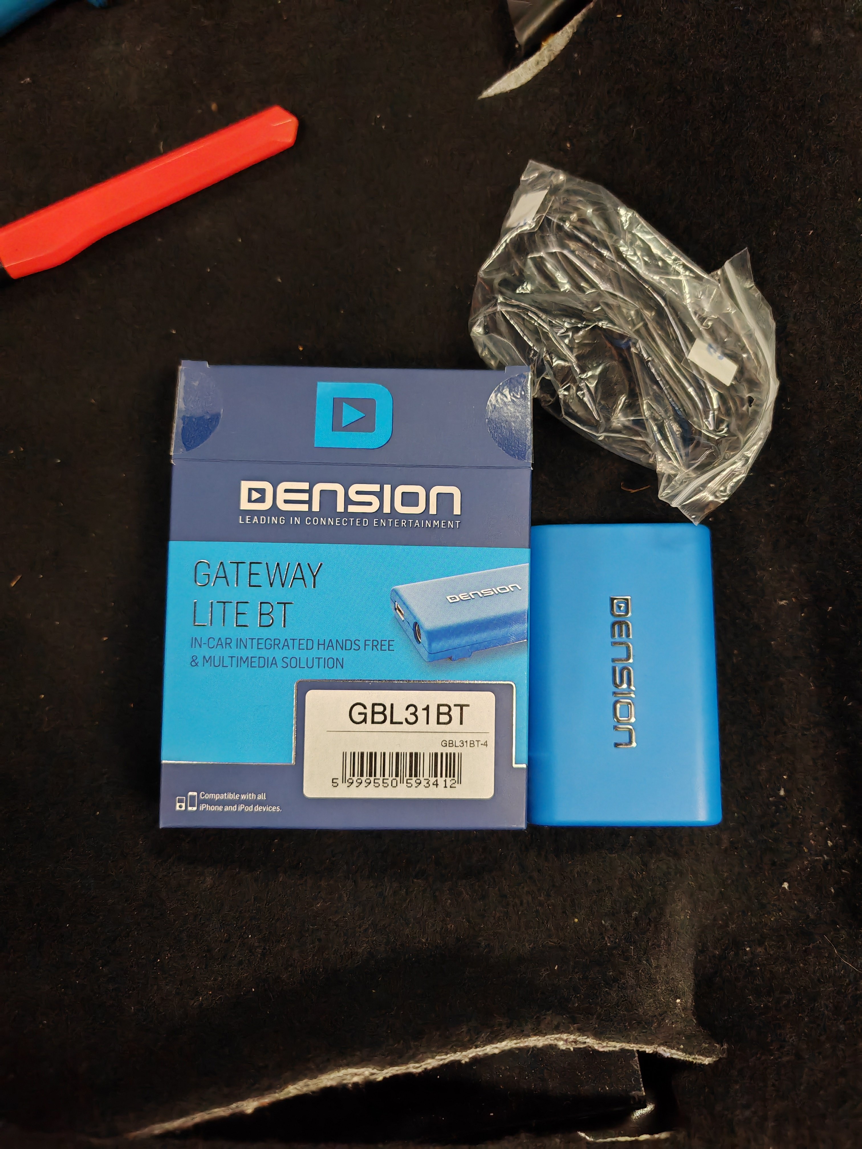

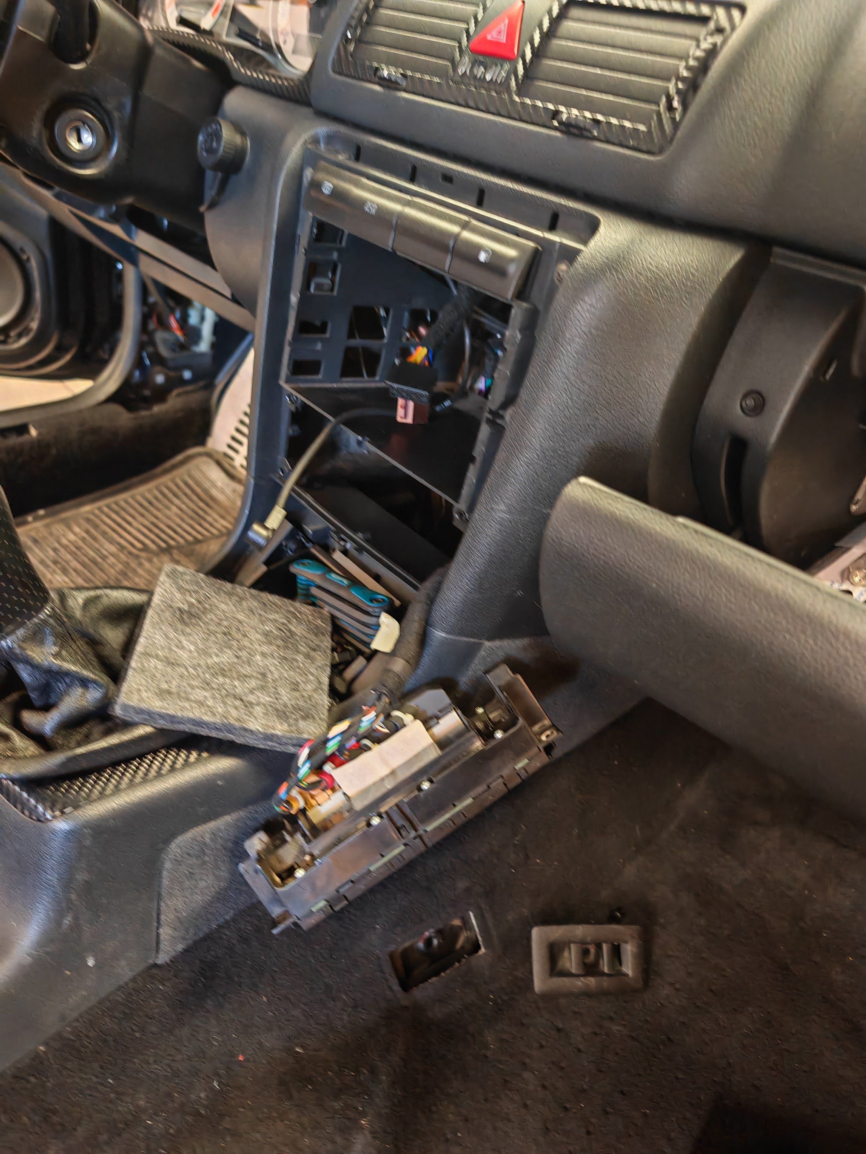

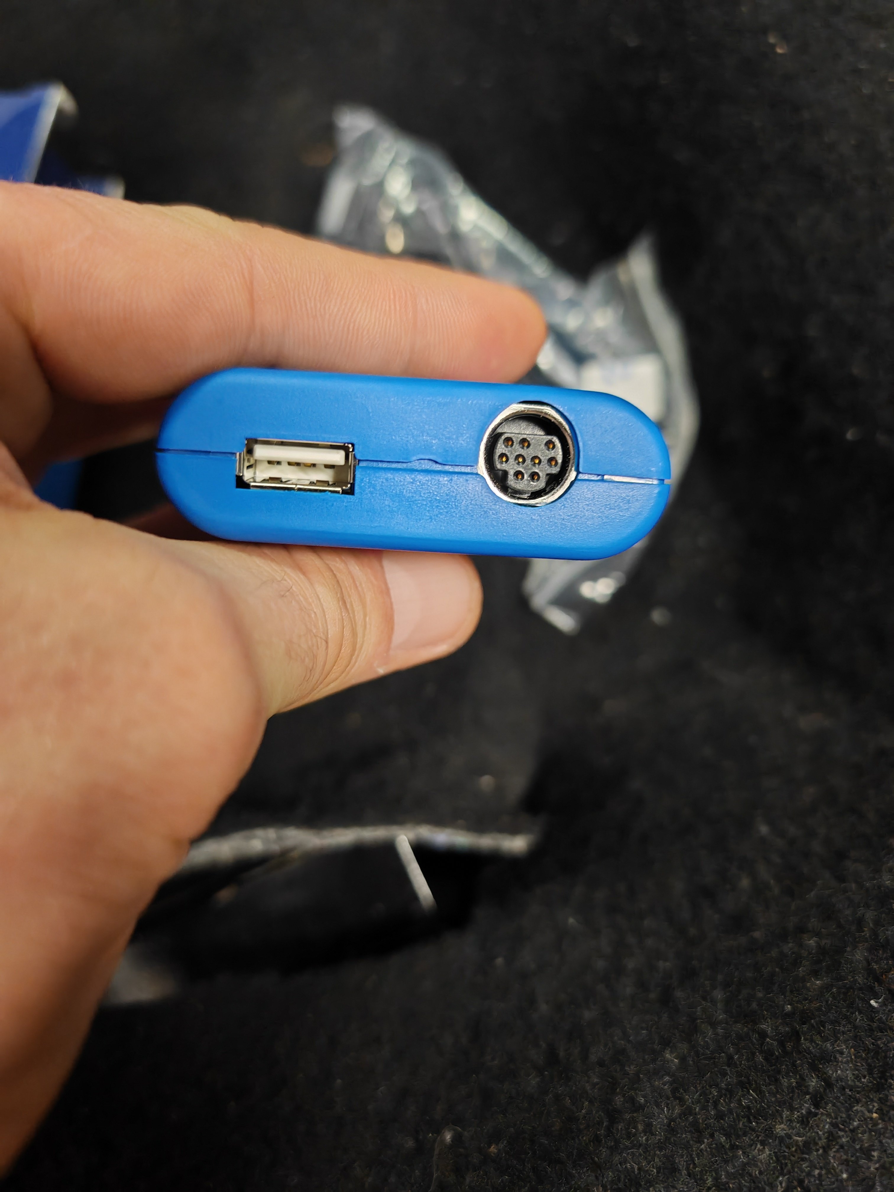

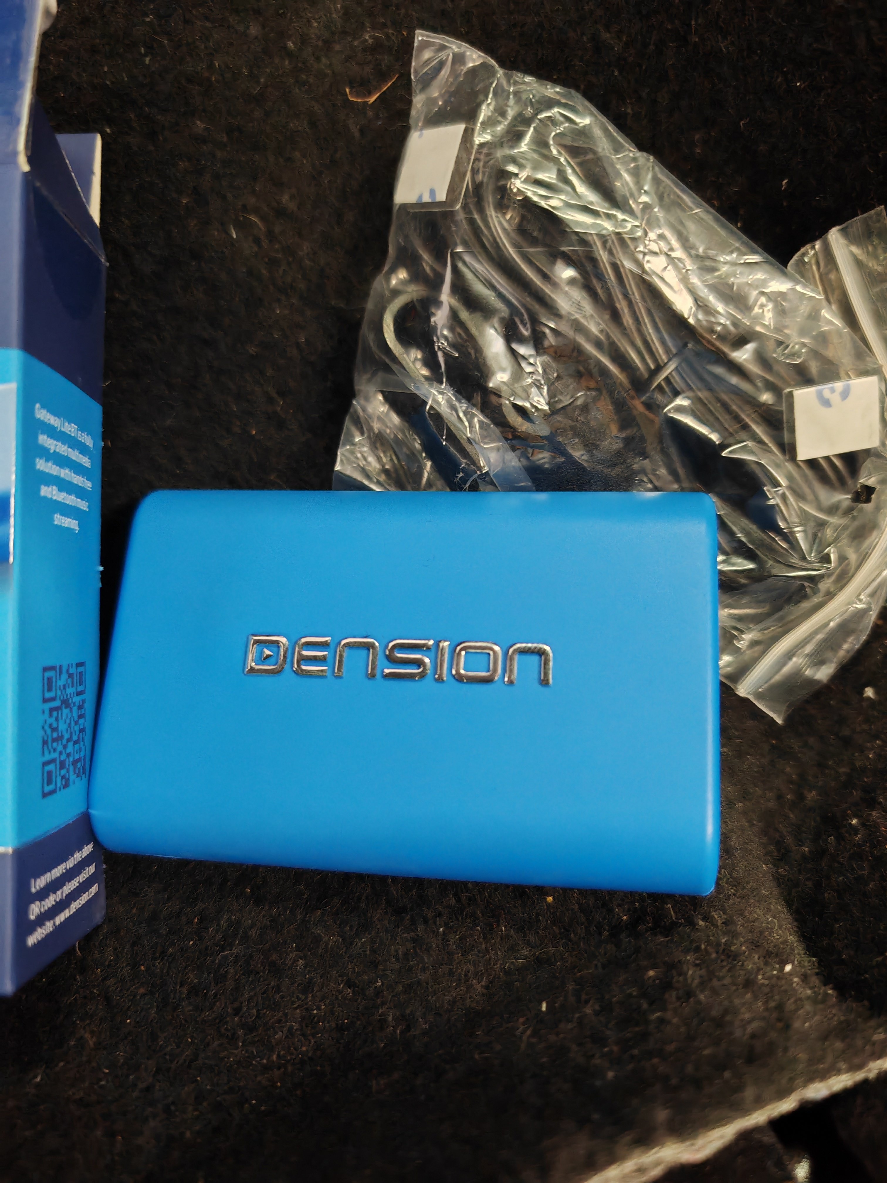

Installed behind the dashopard Denision gateway  lite BT USB reader with extension cable in compartmemt bellow Symphony MP3 Player-stealth look

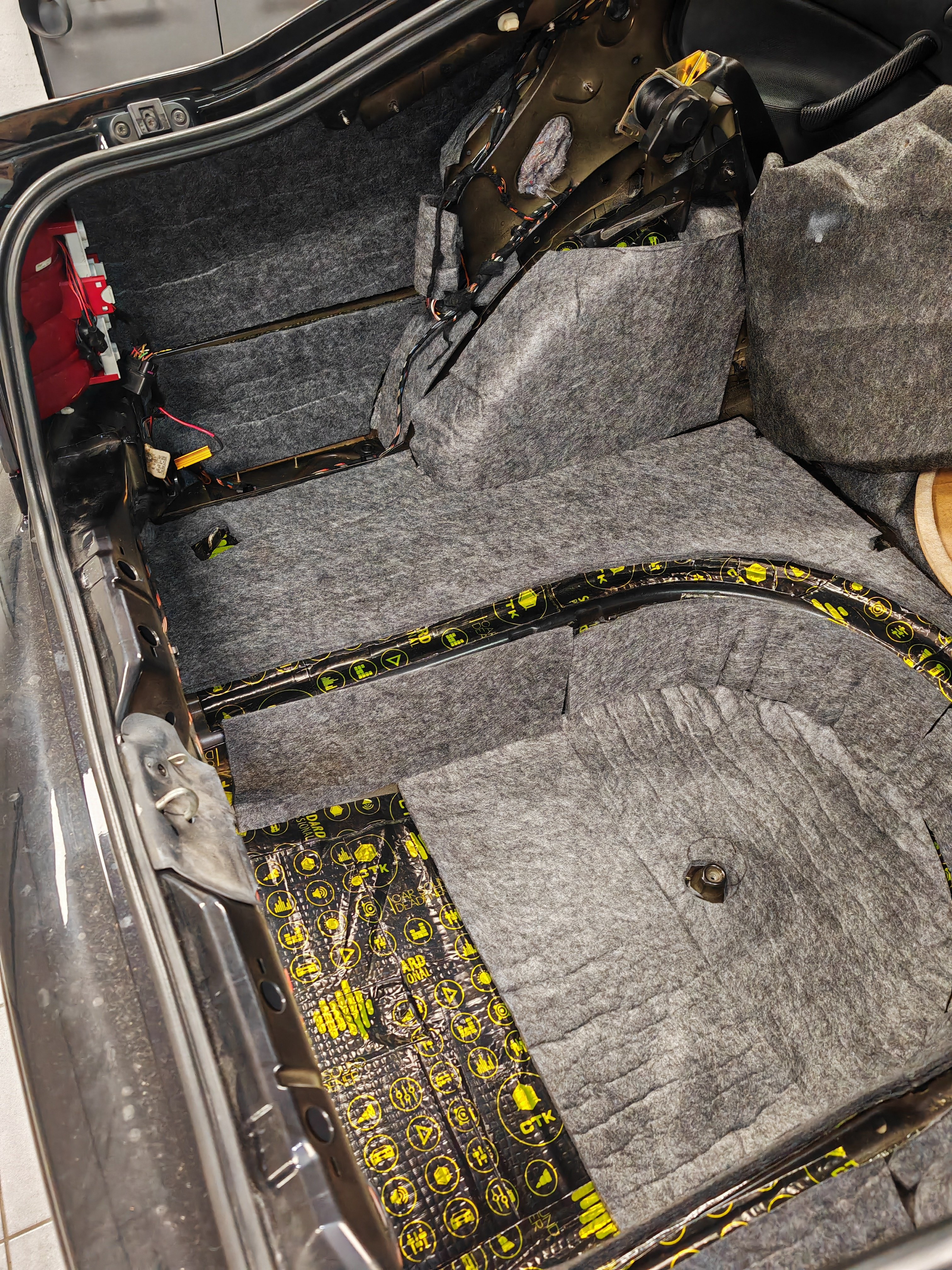

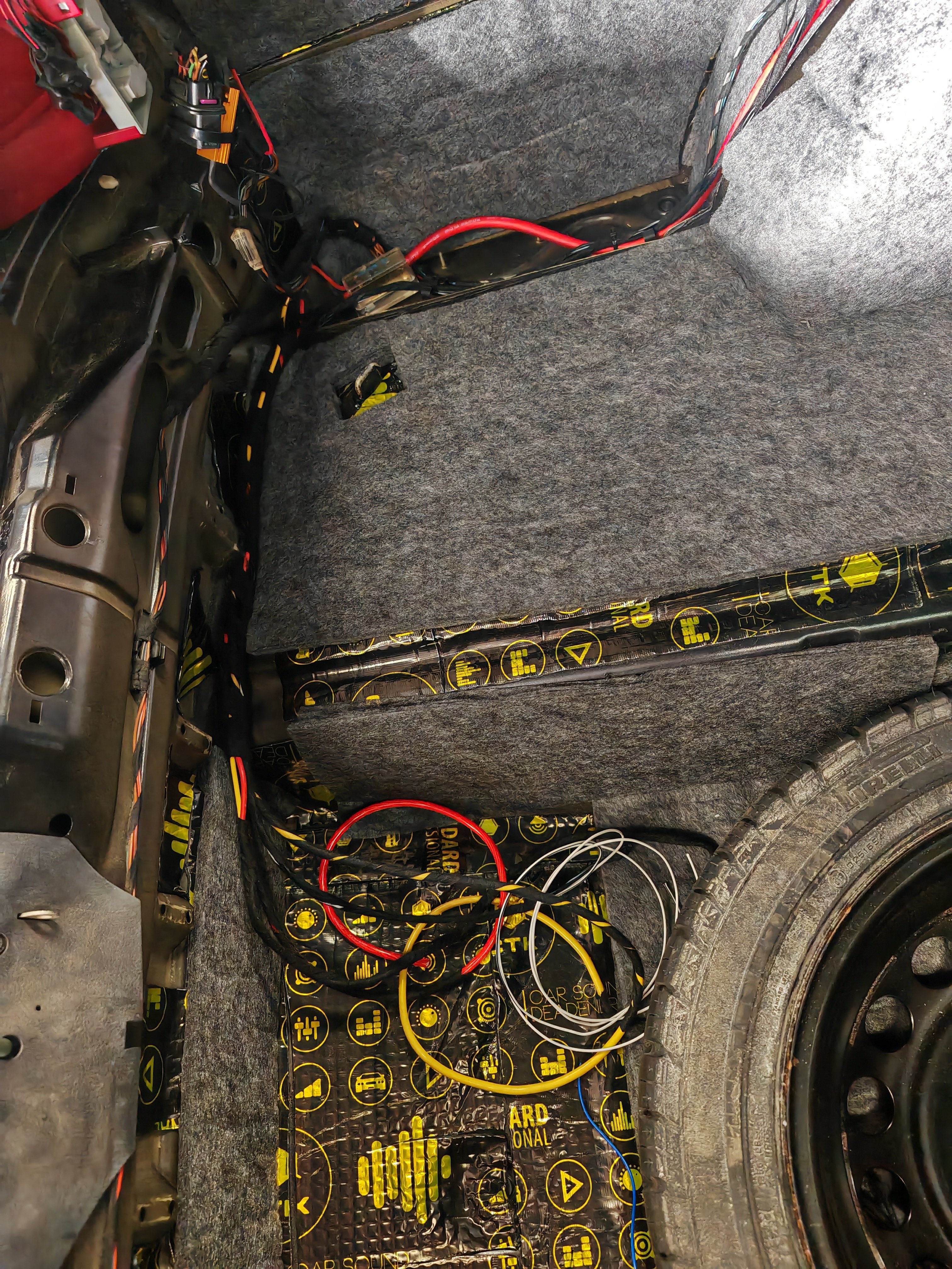

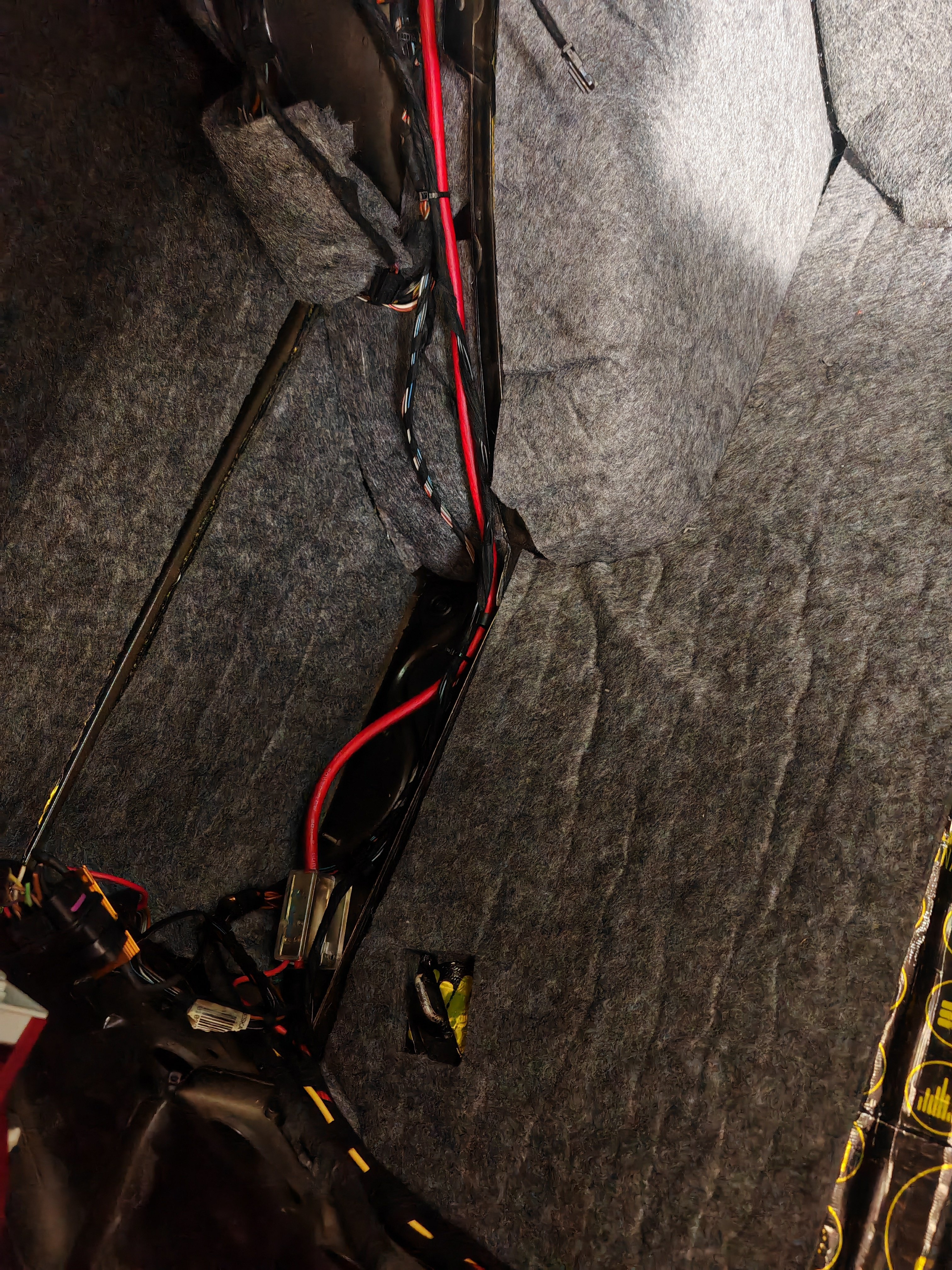

Trunk insulation in 2 layers

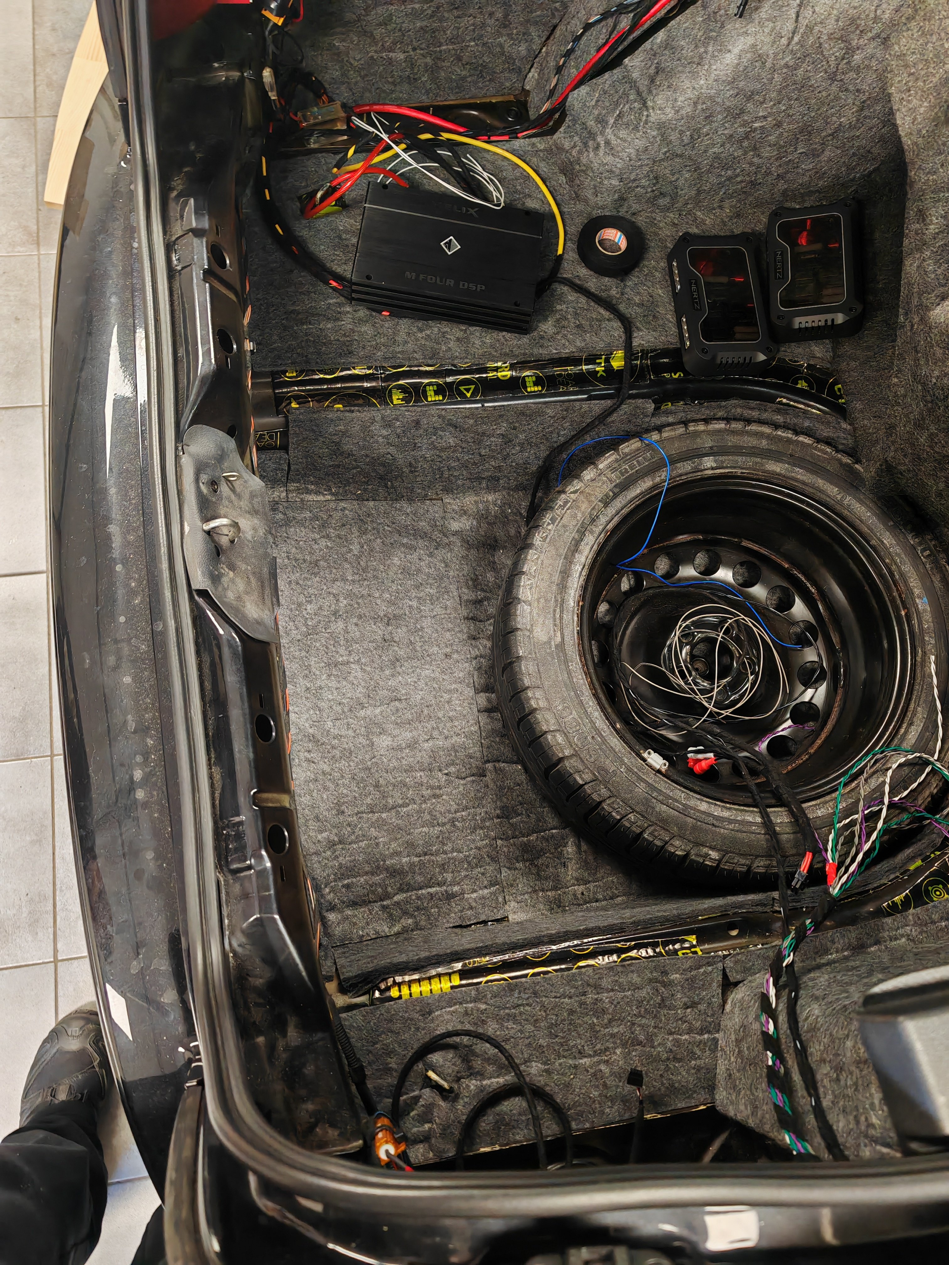

Helix M Four DSP amplifier and JBL basspro HUB and Hertz crossovers  in place
All clean and nice

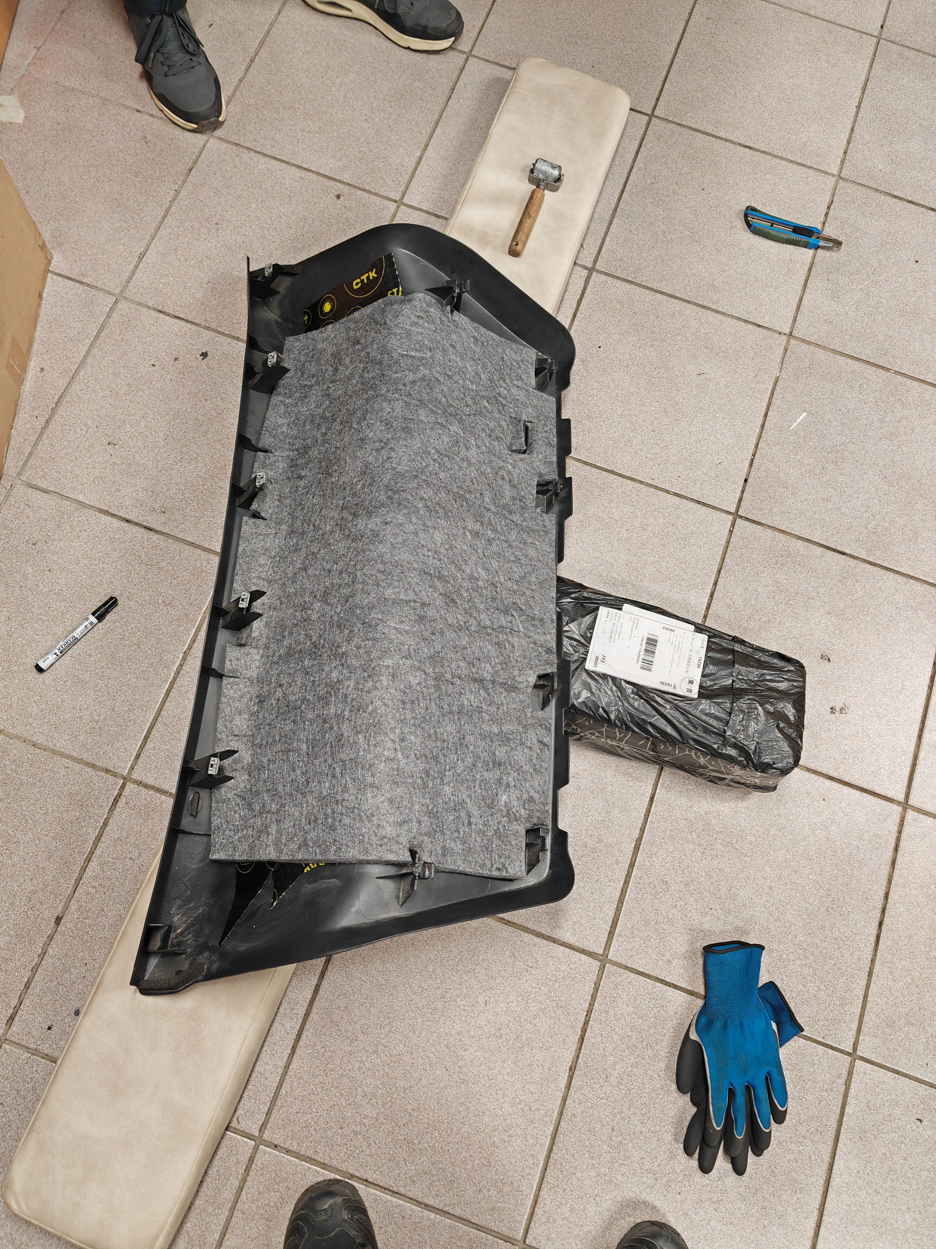

Assembled all plastic parts for B and C pillar together just now.

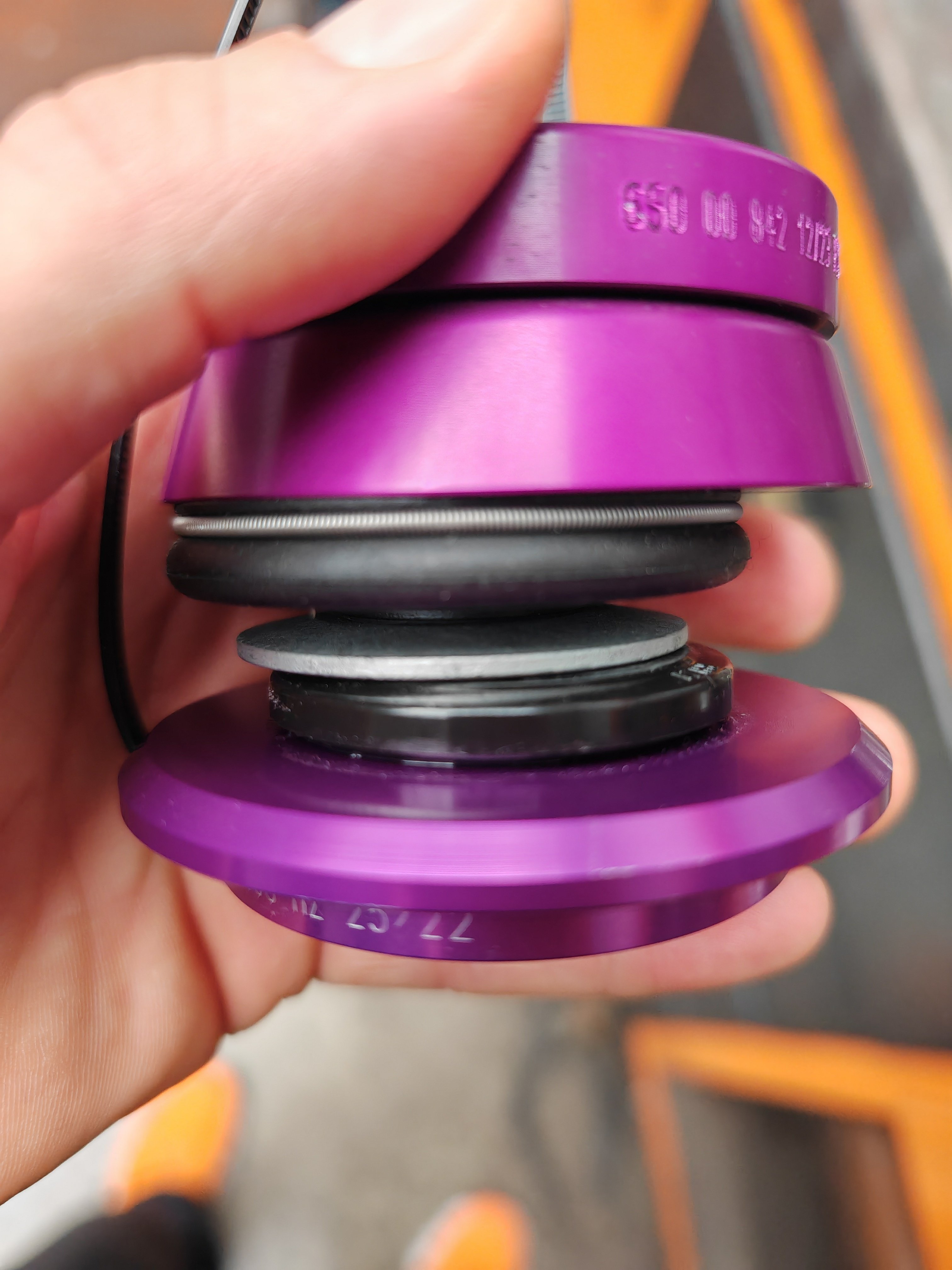

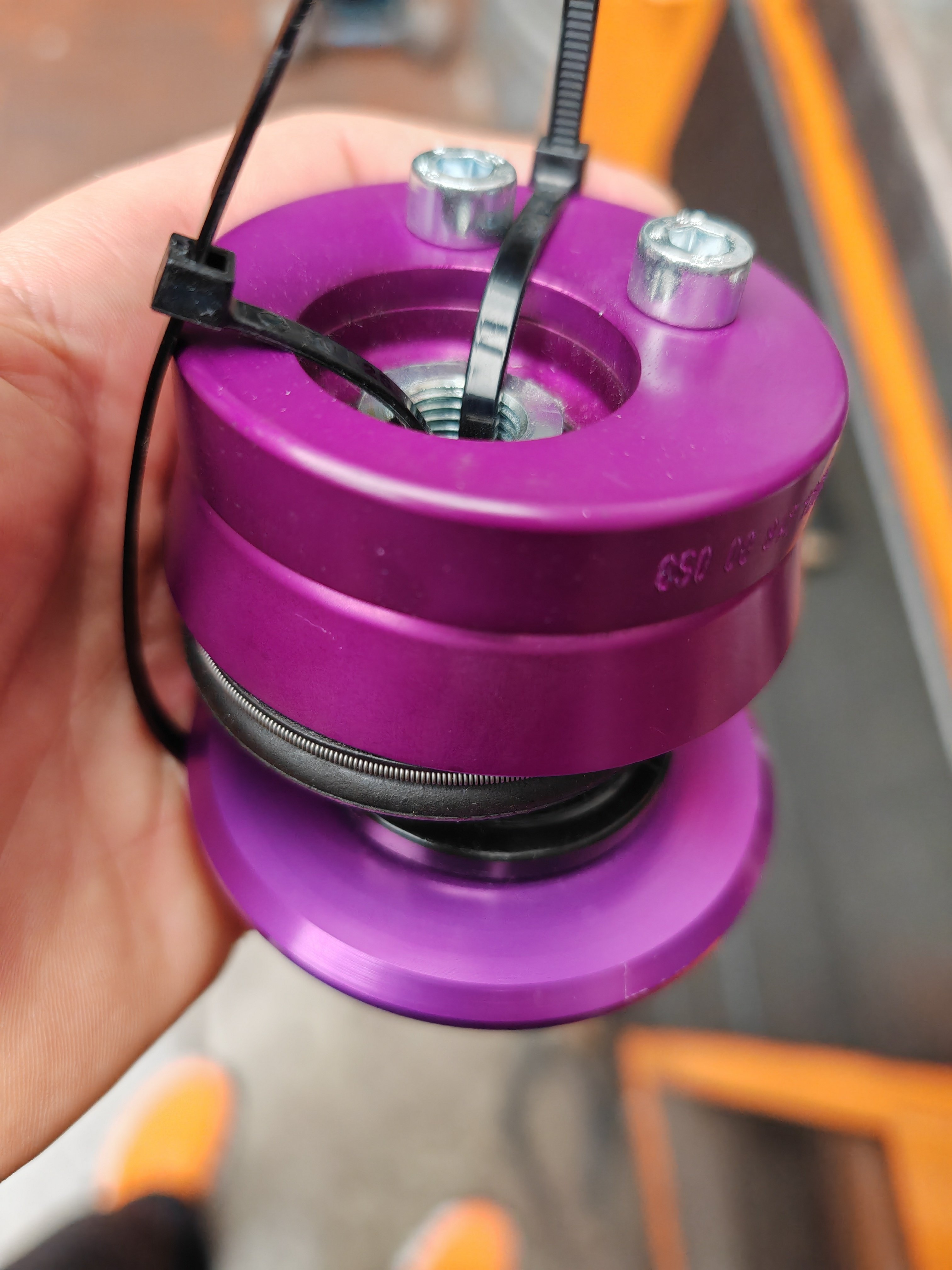

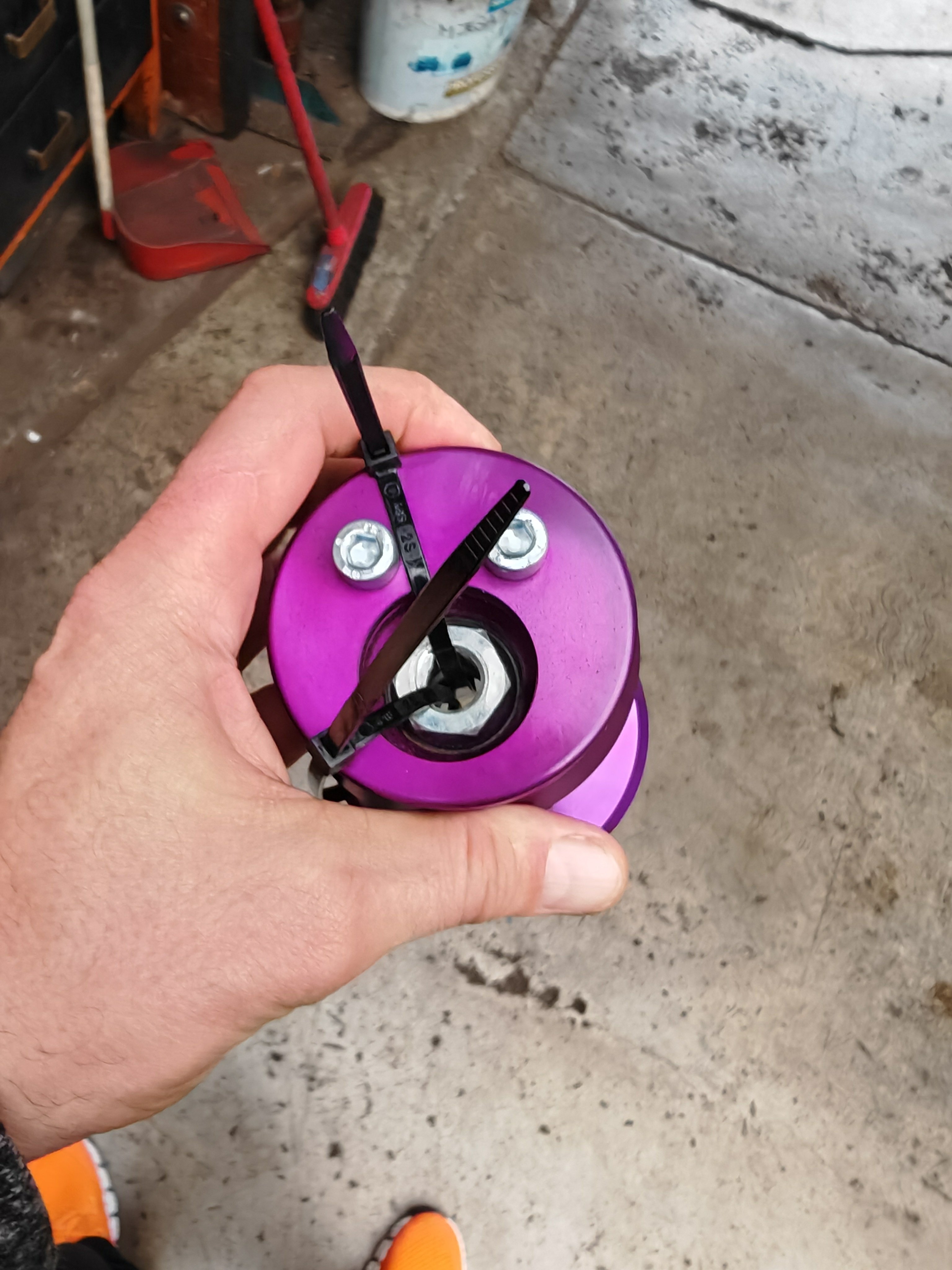

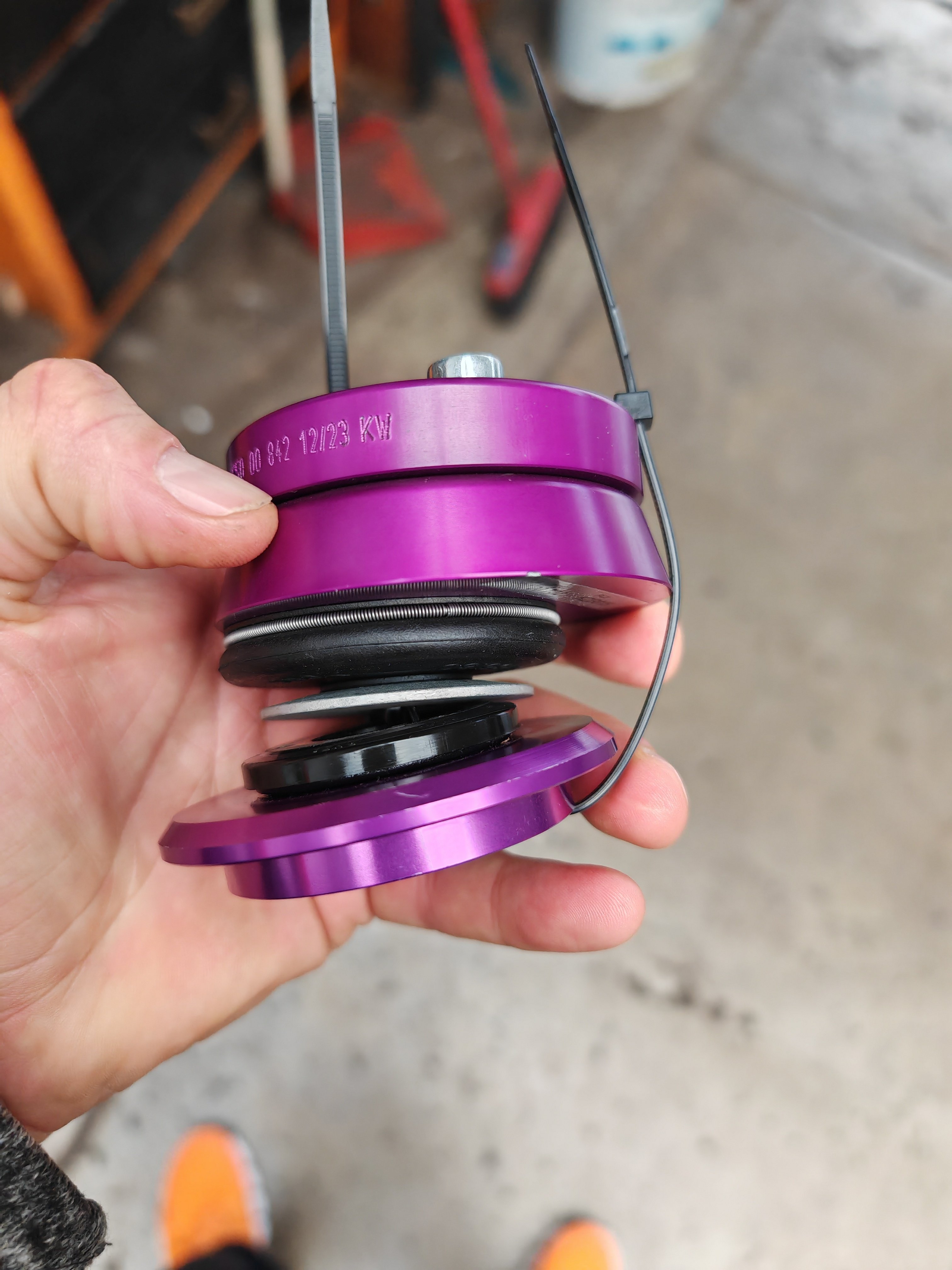

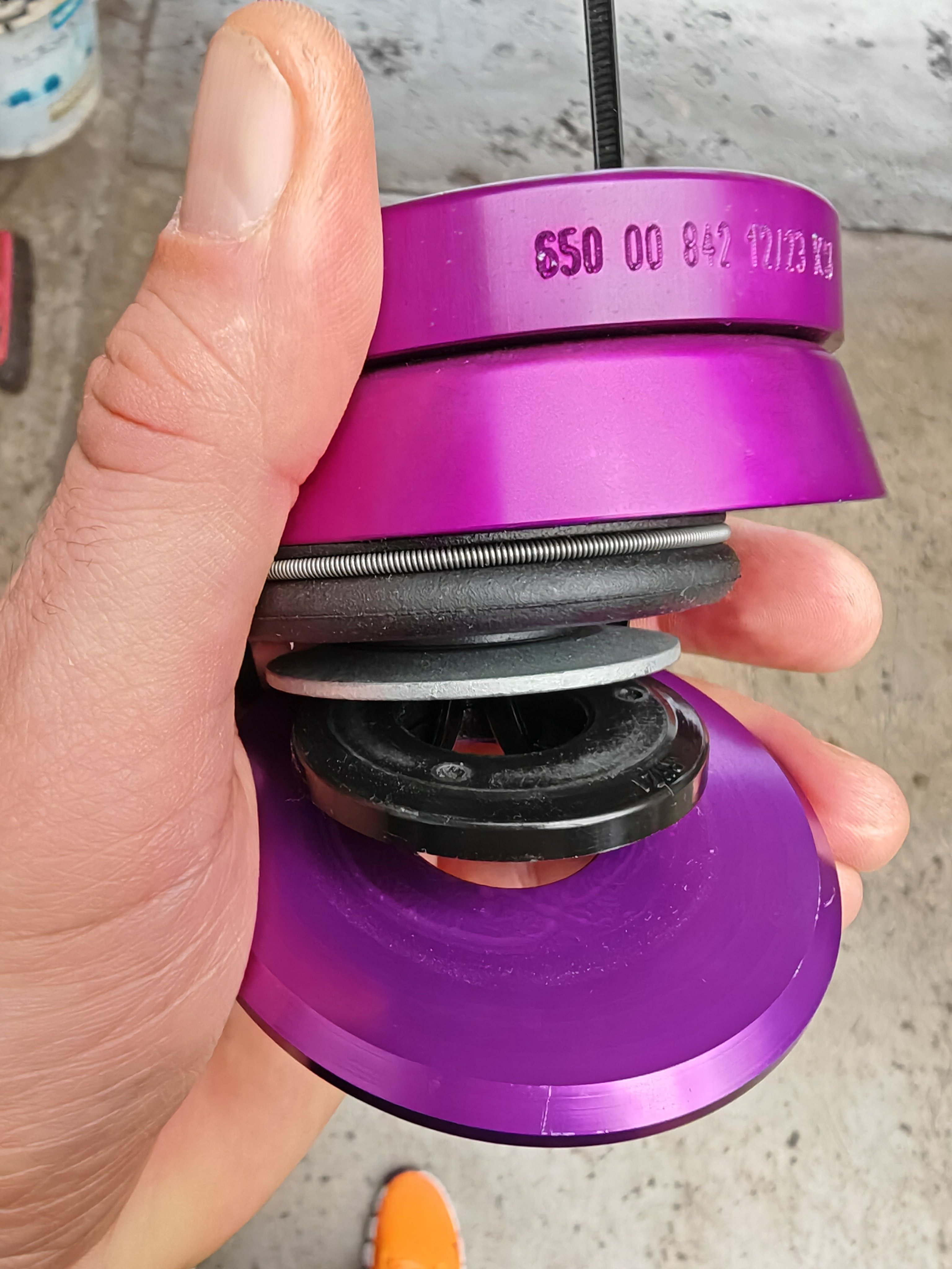

New KW top mounts completely sealed are ready for installation
