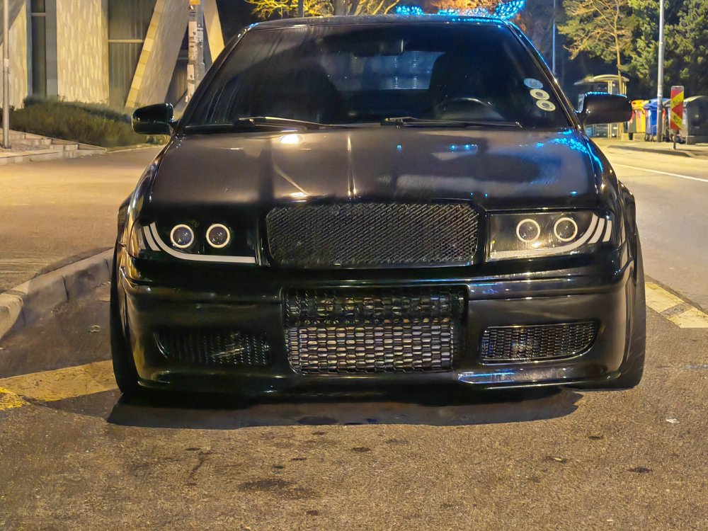

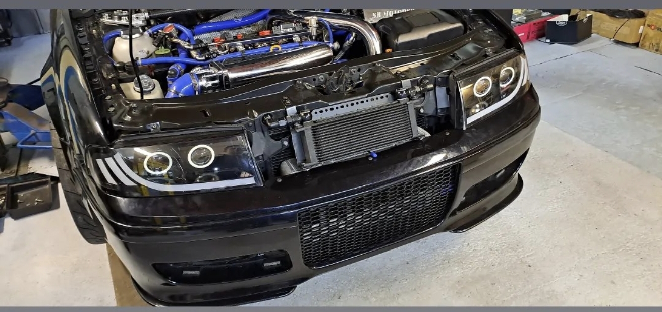

  • Tom from sem motorsport decided to make some more  of his big port passenger side (LHD) intakes for me after seen my build thread. At first he rejected me,and after few days me being desperate and con
  • Pay attention to fine precission tools and protein drink
5 minutes ago, dubDEAN said:
did you not close off in the corner next to inner wing?
No,that's why we put some rubber there also, but is sits so close you don't need it,and otherwise ProRam Large filter wont fit. All done on 3d scan model on comp-all simullations
Edited by davojuri
love the level of geek , looks great and waiting on my delivery 😛

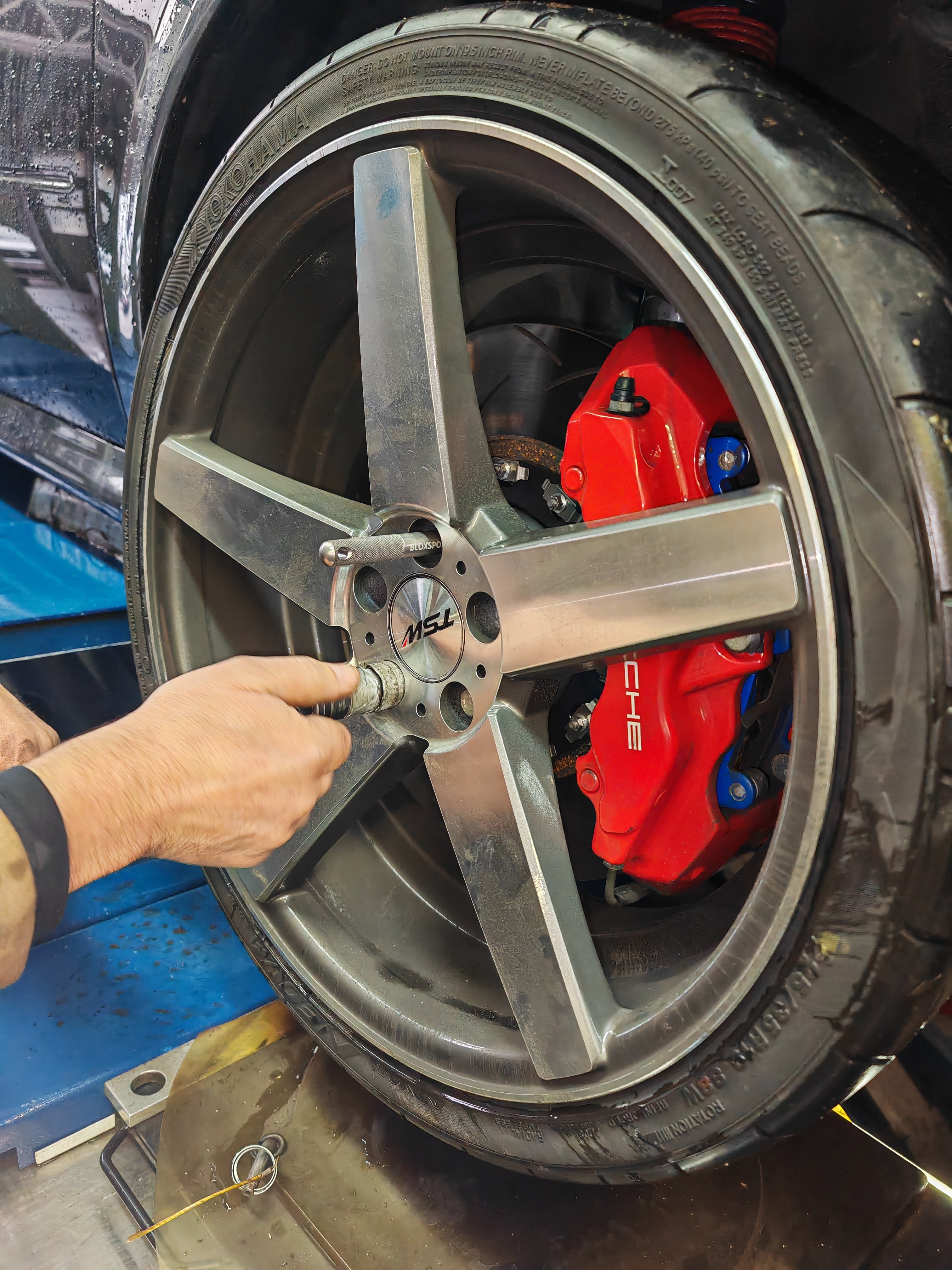

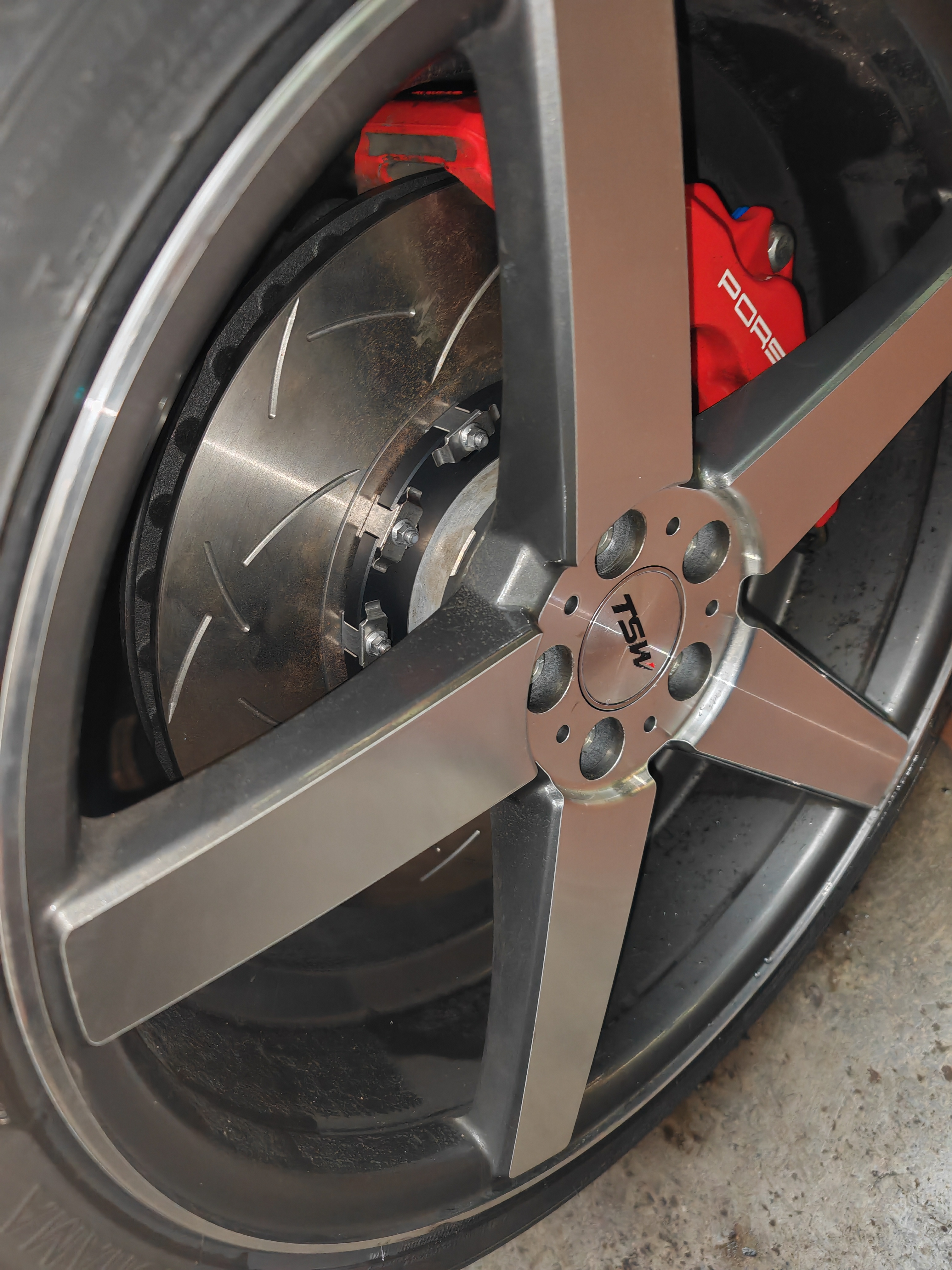

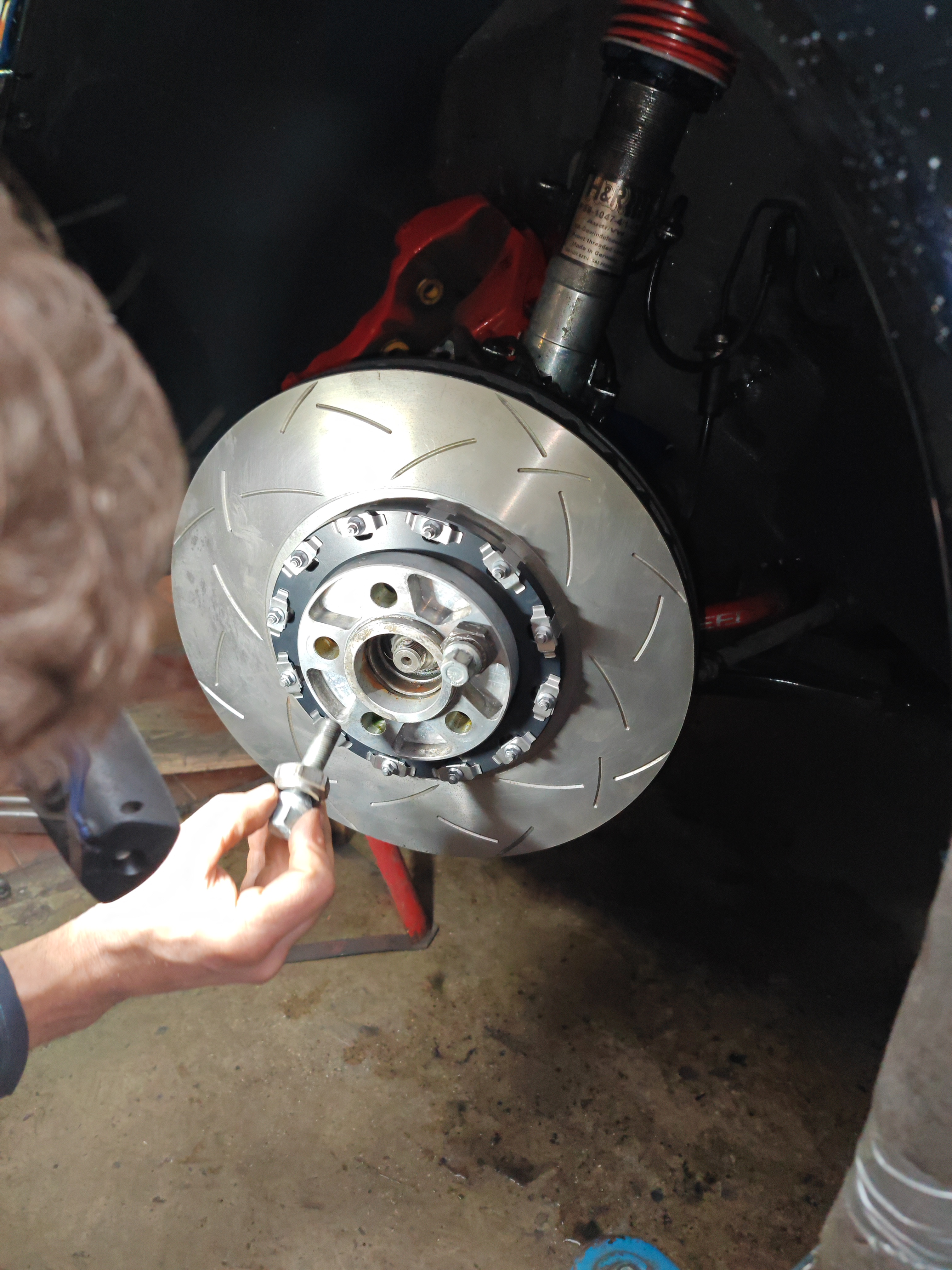

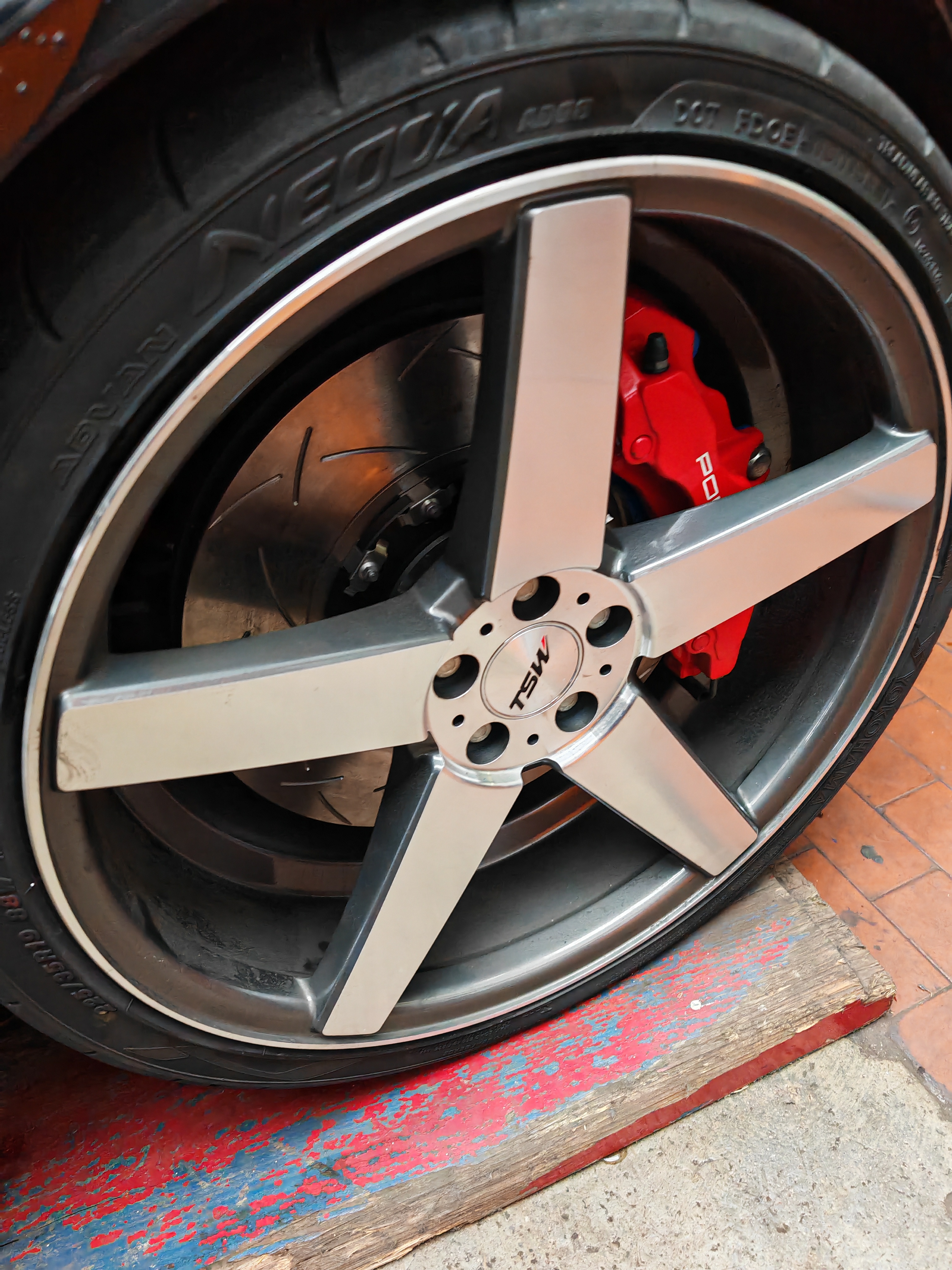

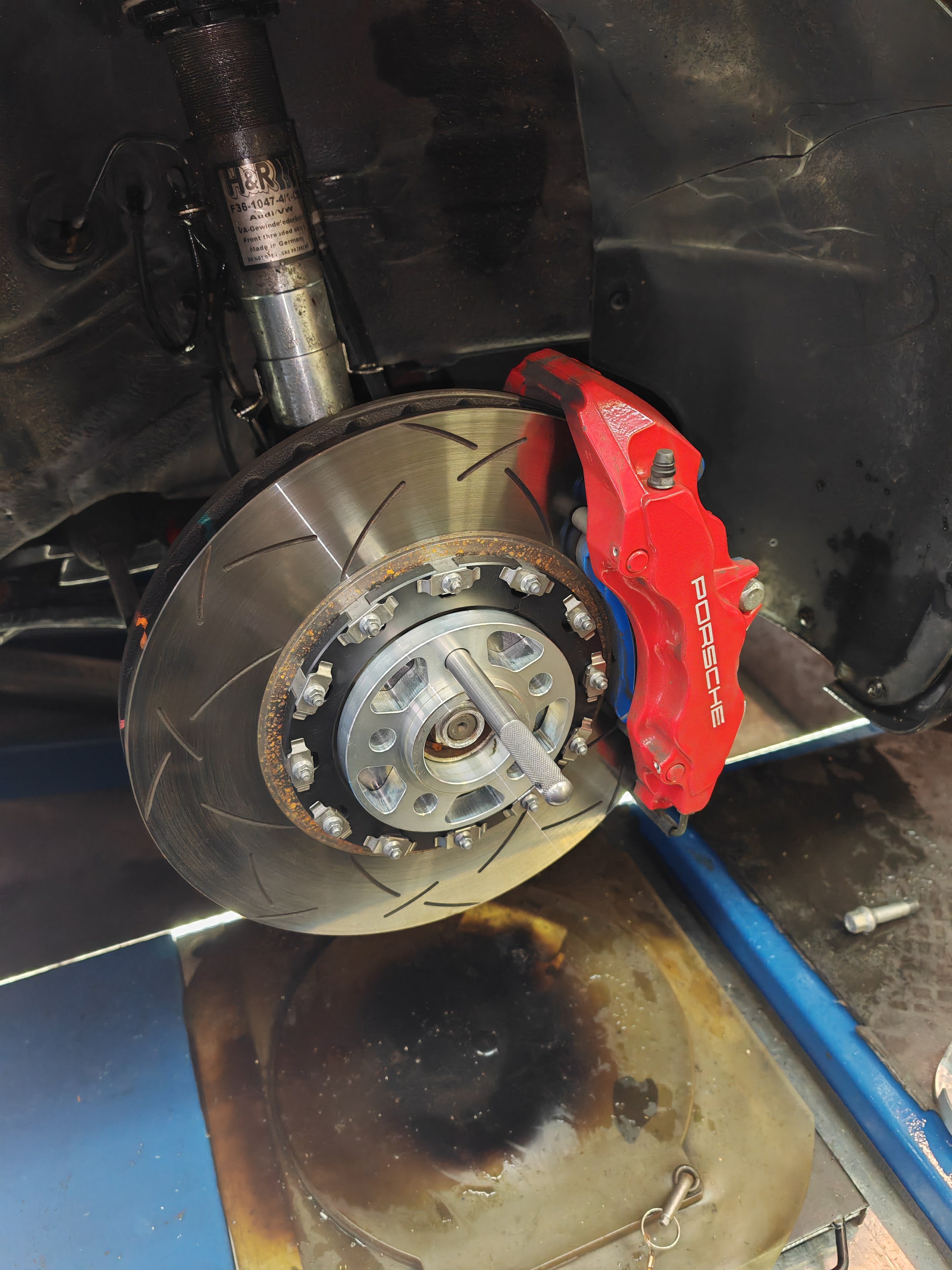

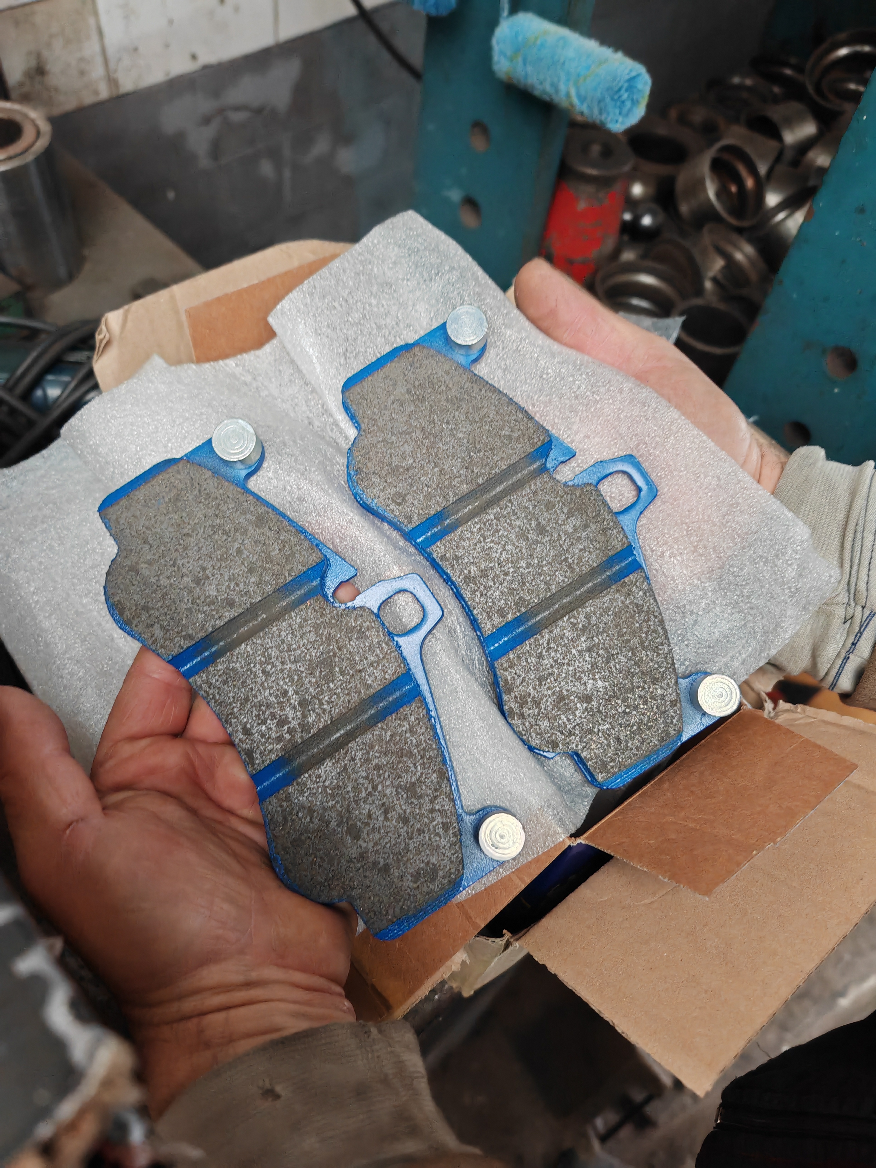

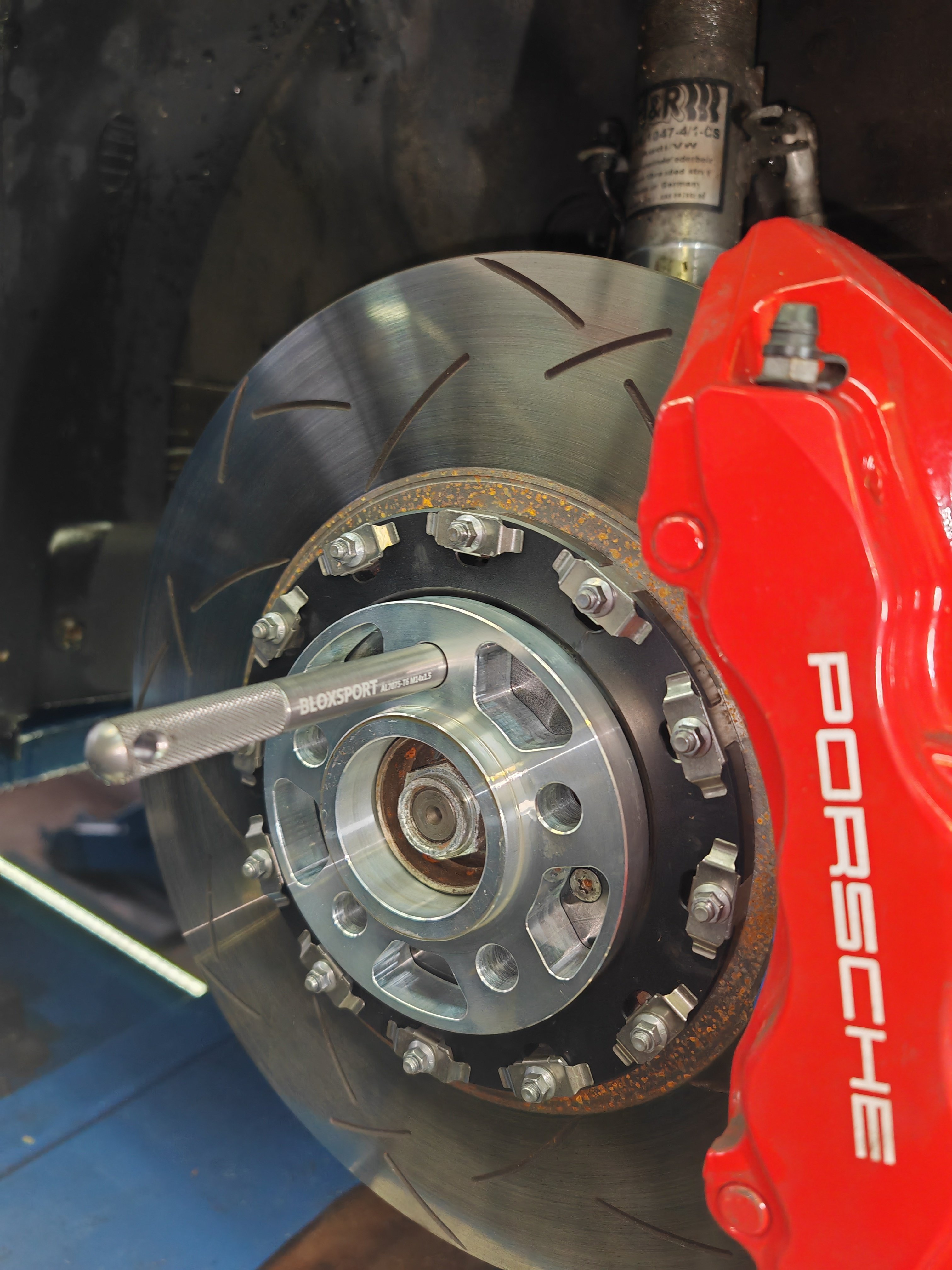

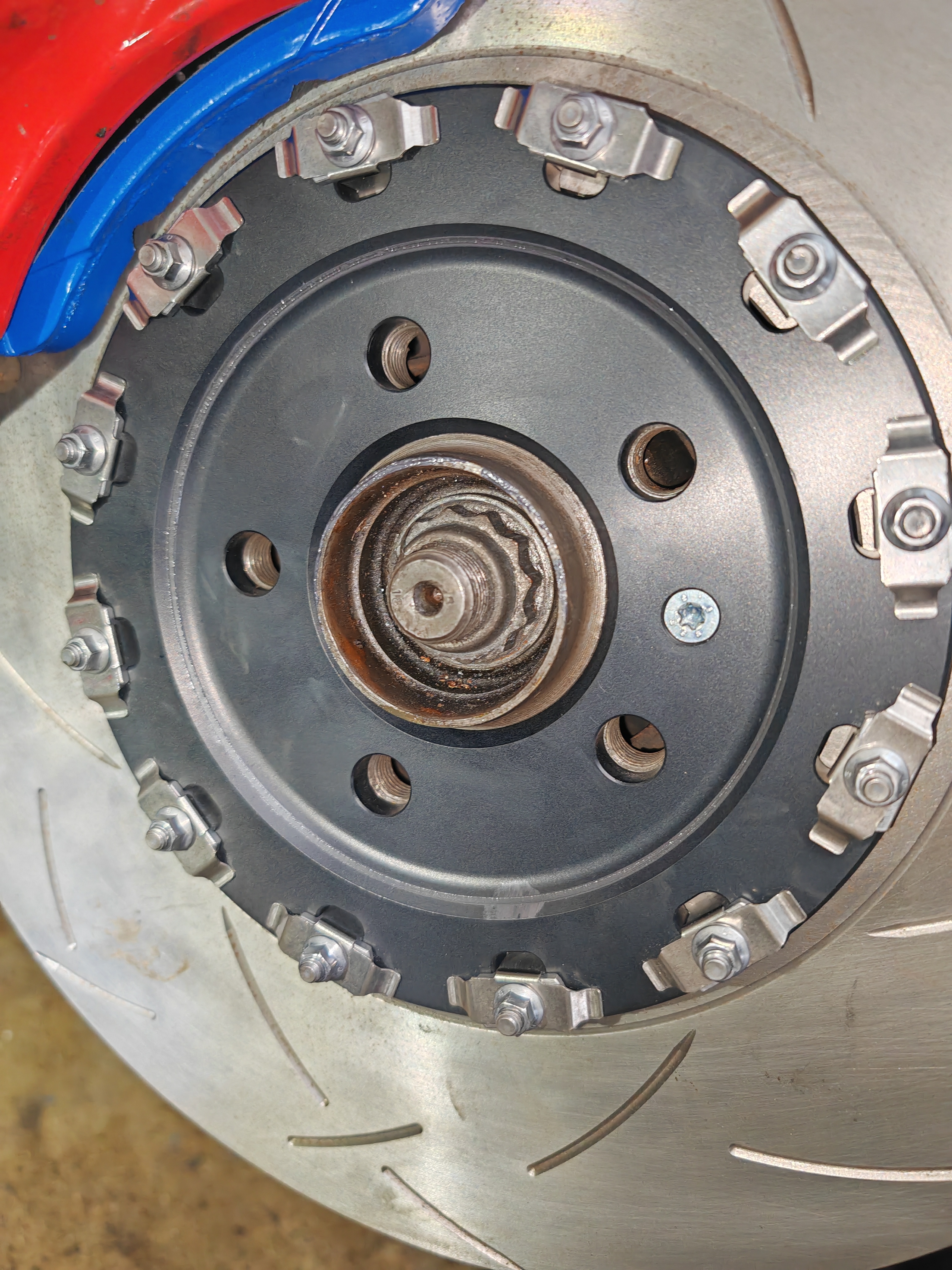

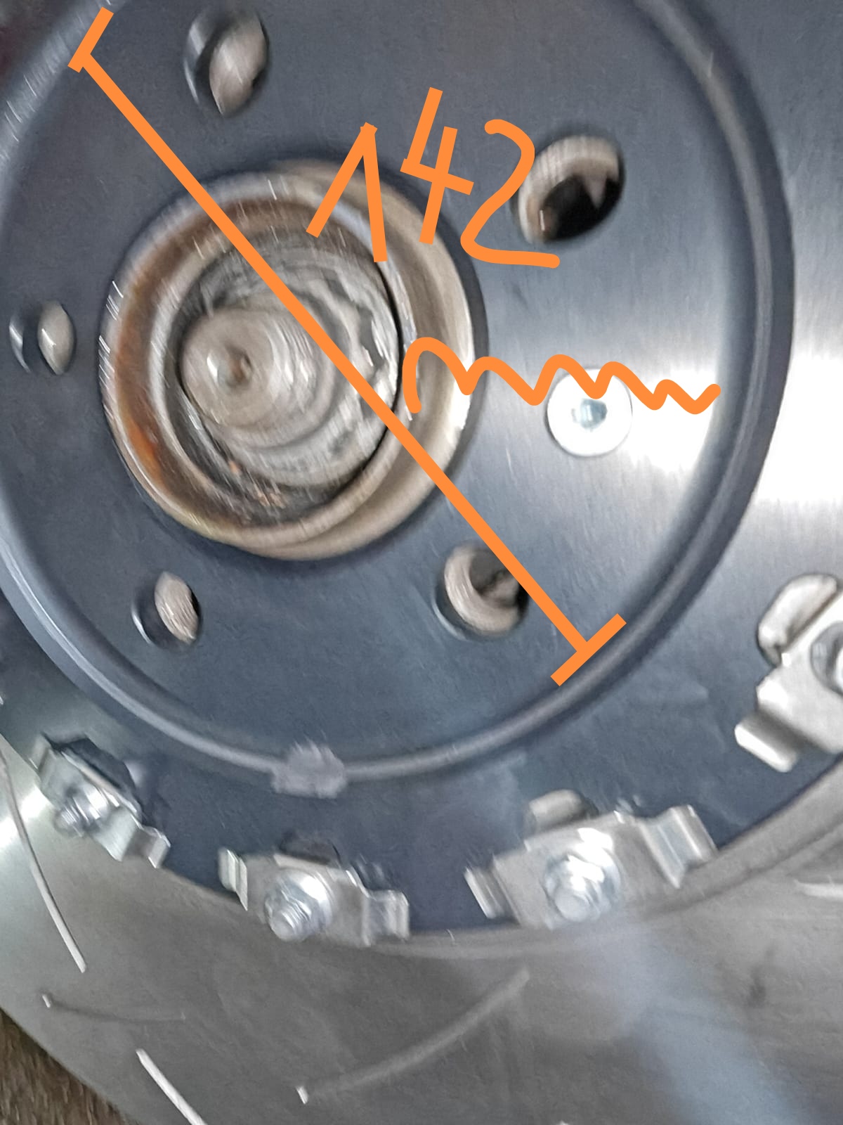

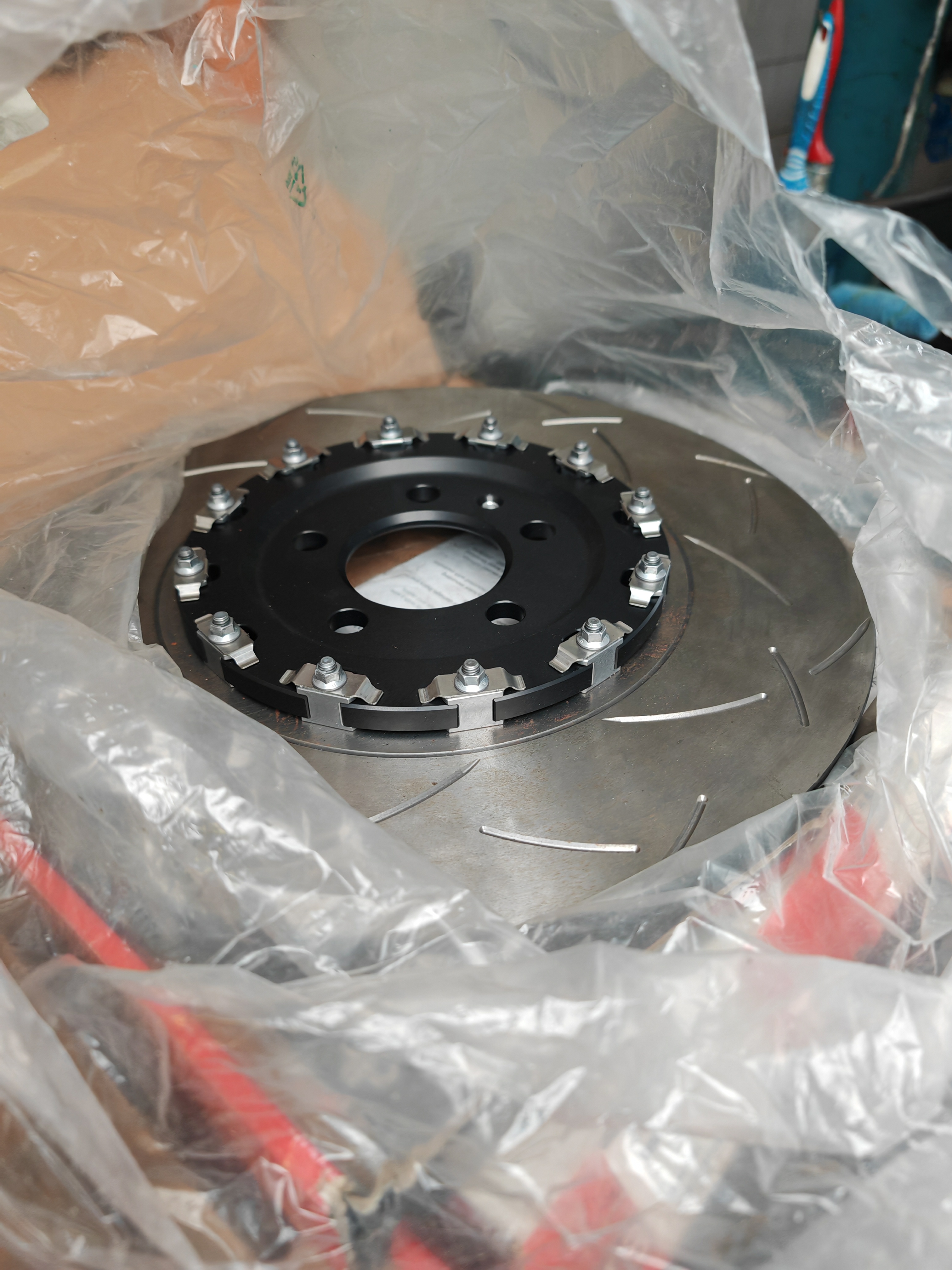

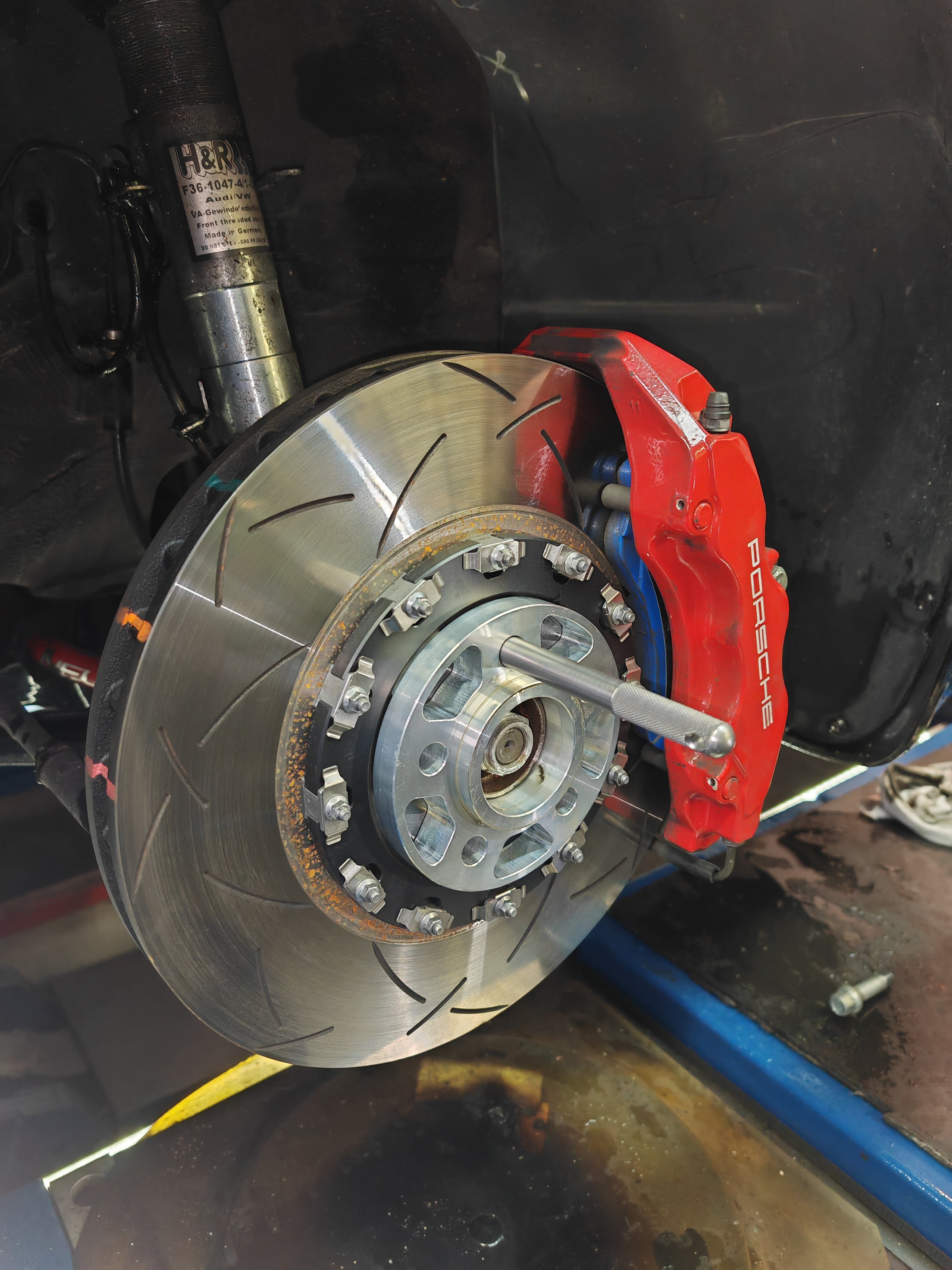

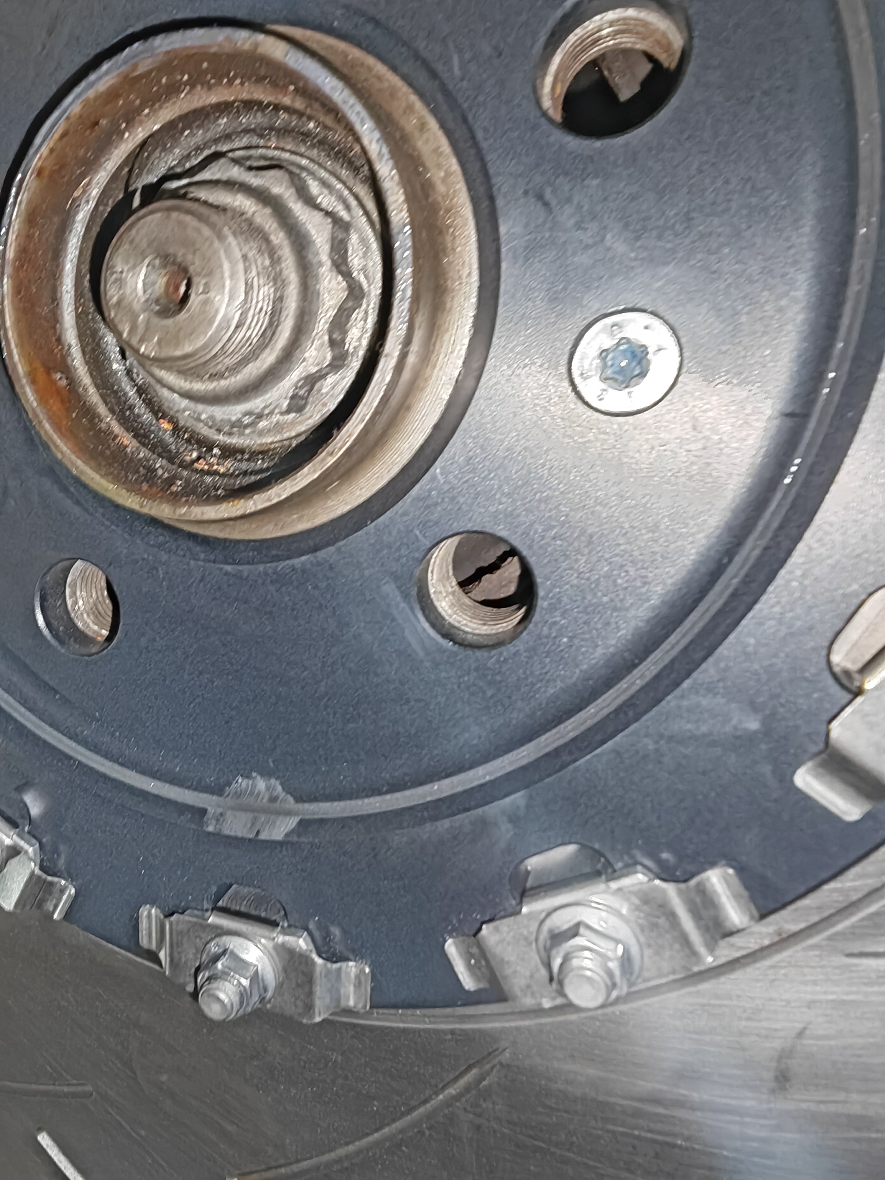

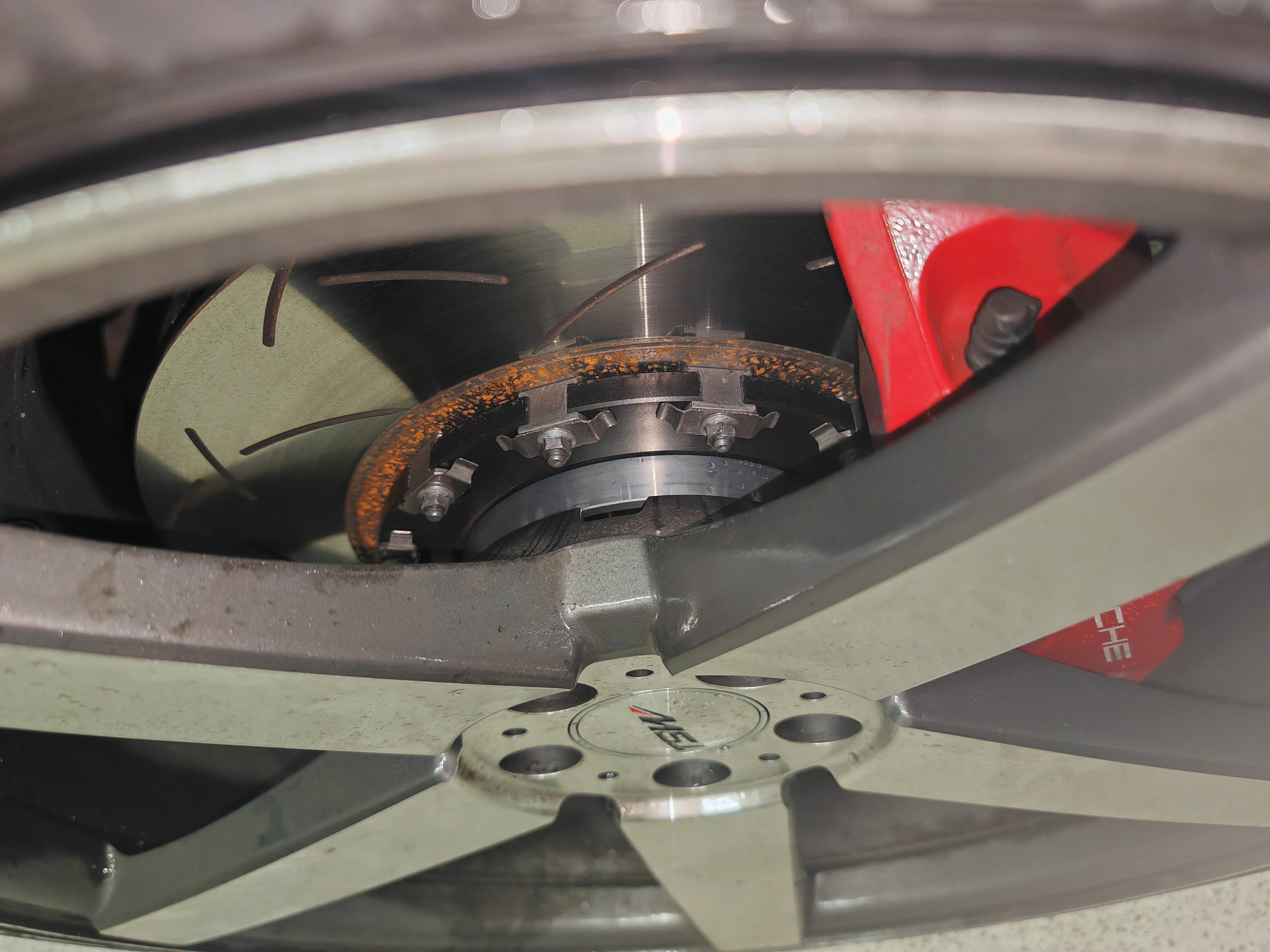

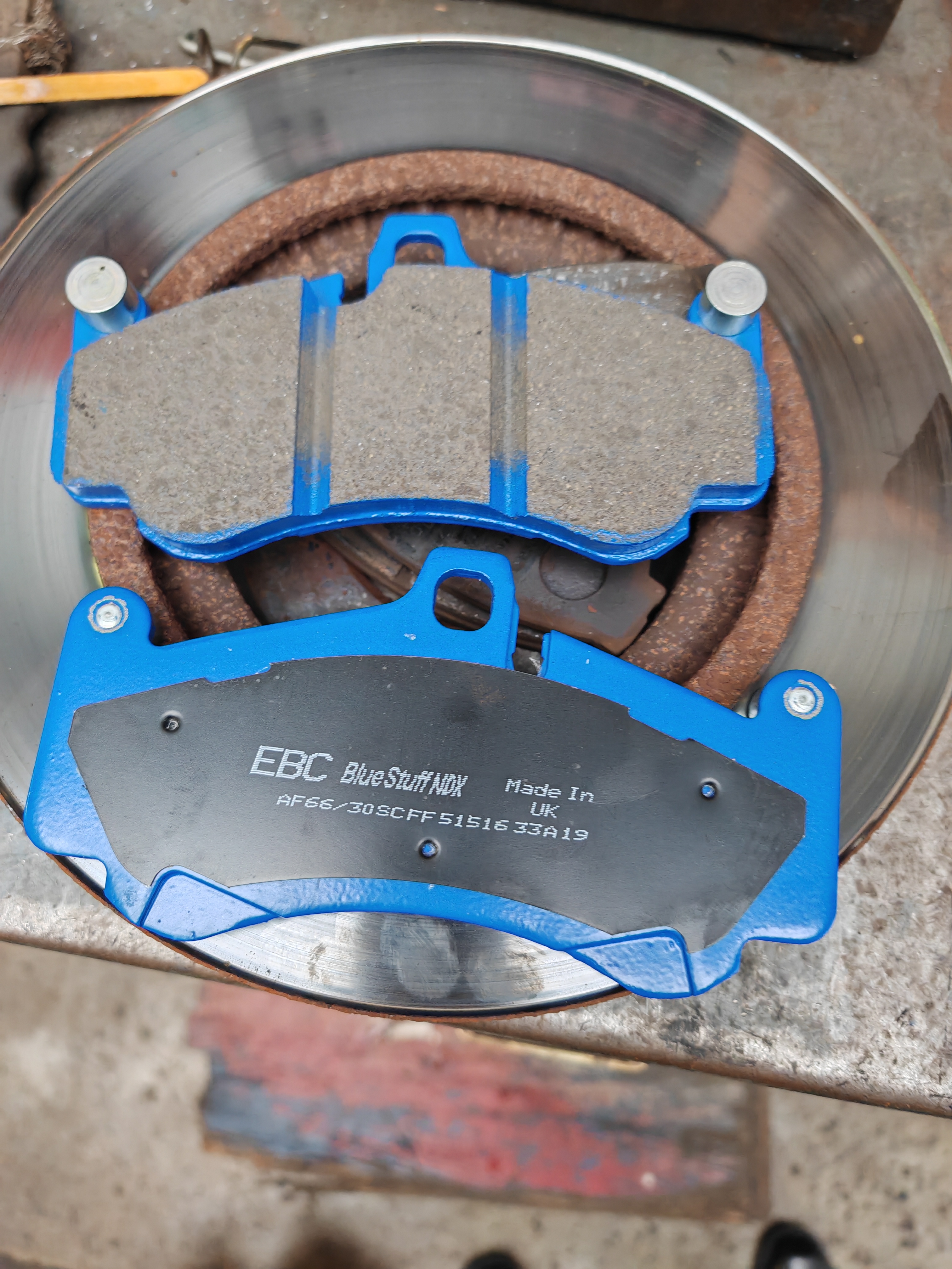

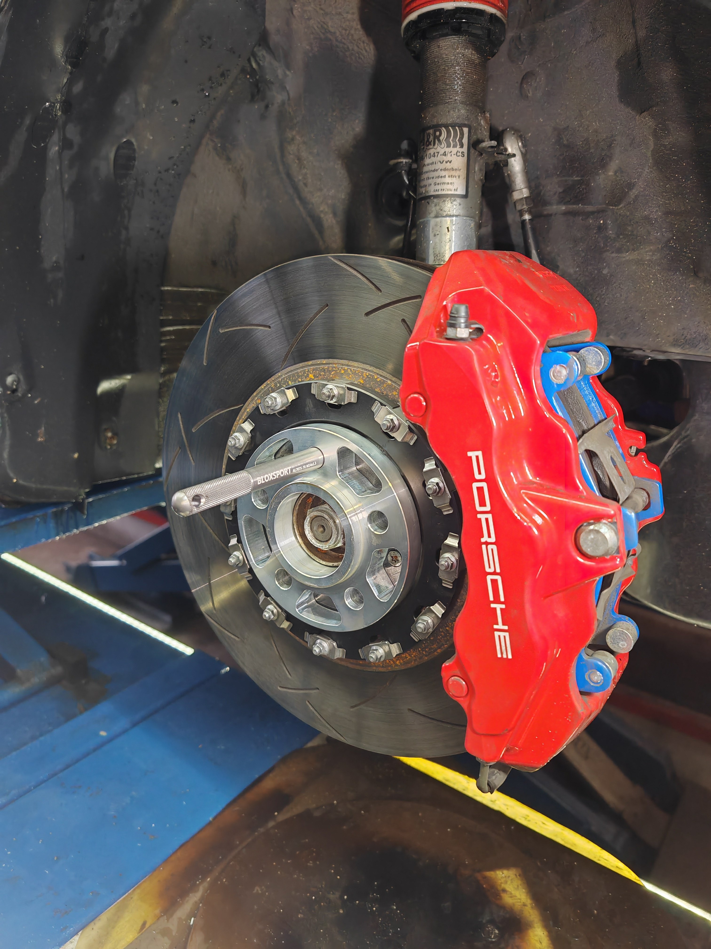

Finally today on my 54th birthday I installed my new custom brake discs DBA T3 5000 series discs, with custom full floating hat 6081alu, black hard anodised and AP Racing H bobbins with McLaren anti rattling clips, all together balanced to 0,1 and 0,3g by www.elmet.hr -balanced part on disc I painted with blsck thermo paint up to 800C for rust protection.

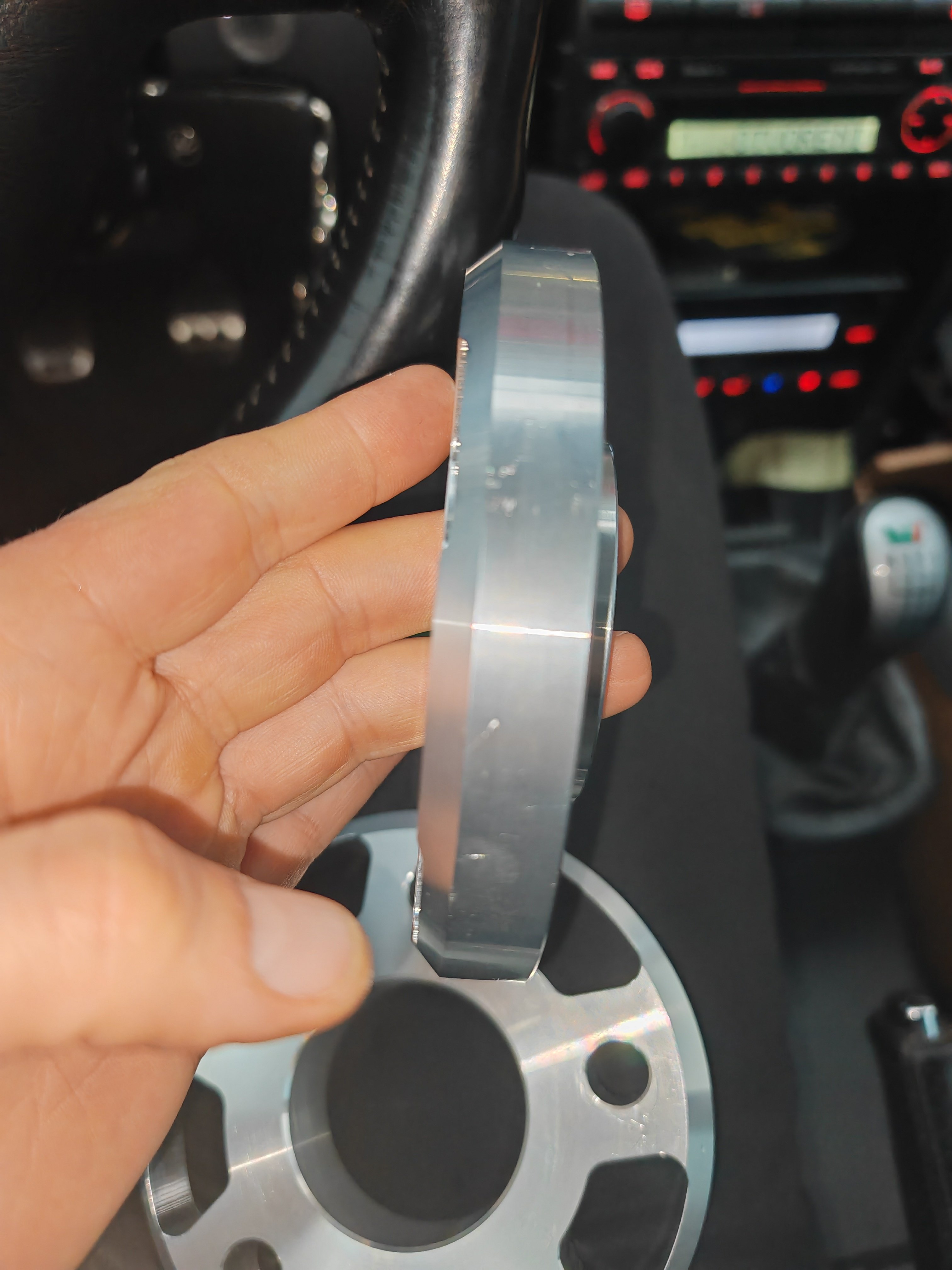

Fit is perfect in one hundred of mm in the very center of the calipers espetially when the measurements were taken from already machined old discs from 34 to 32mm but you newer know which side was more machined than other, so to find equal ET is little experience magic. We did it perfectly, but my friend didn't take on count 21mm spacer and outer thicker part for bobbins starts to raise little to soon over 45degree angle and when we used grease on the backside of spacer it was obvious that it sits only on that conus-grease Mark only there, hat completely clean-so for first aid we machined spacers to 130mm to accomodate them,and new spare hats will be 142mm before conus raise for thicker outer part.
Raining outside so I can't perform EBC reccomended brake in procedure as they suggest (has one more step than for yellow ones).
Happy as a kid

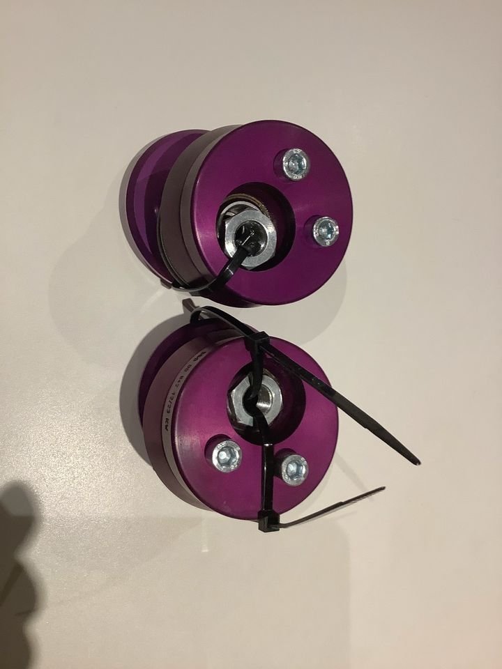

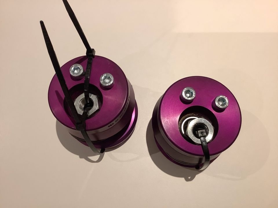

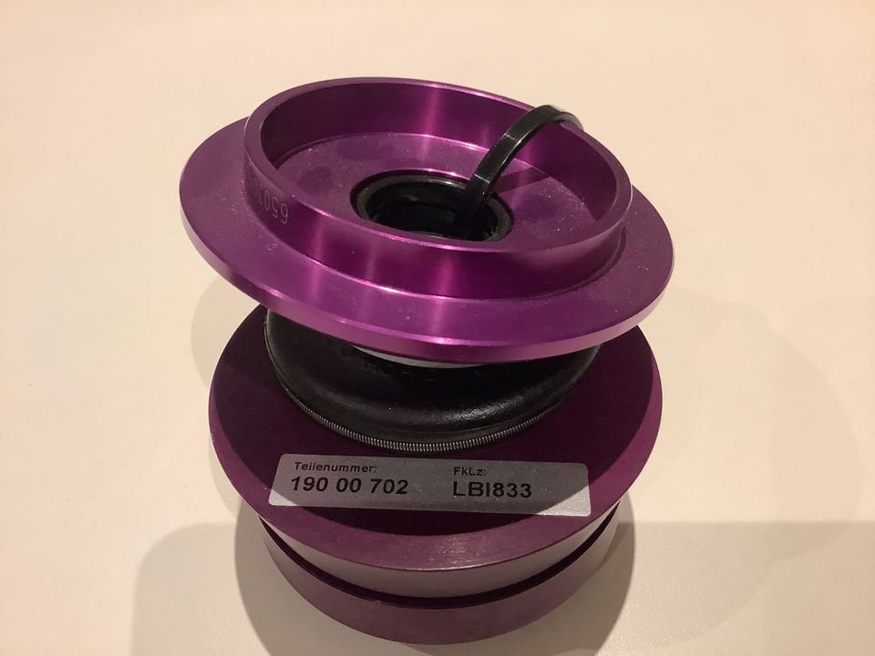

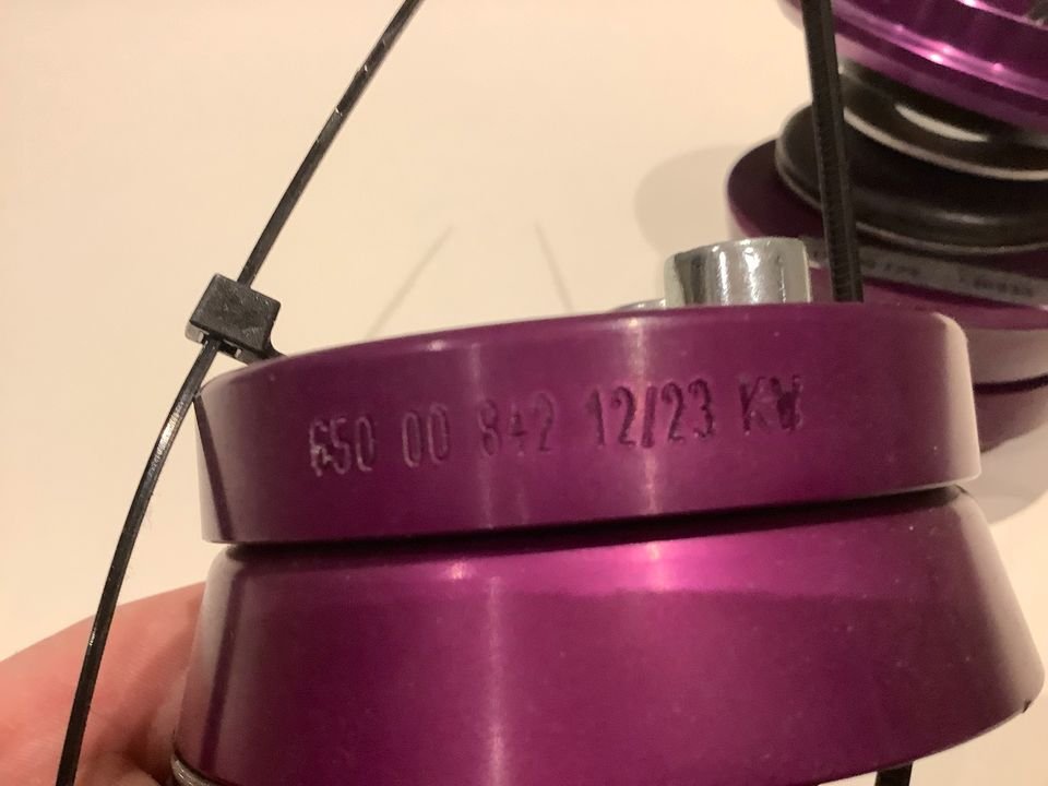

Bought new KW camber plates
19000702
time to replace good old Ground Control camber/castor plates.
Thing I don't Like is doing doing sound while turning steering wheel and noise over bumpers from ball bearings. Good thing is wide range of adjustement.
I expect German  quality and closed seal system-long lasting and due to the fact www.gepfeffert.com installs them on large scale on very expensive cars so they must be quality improvement over my old ones. More pics to come

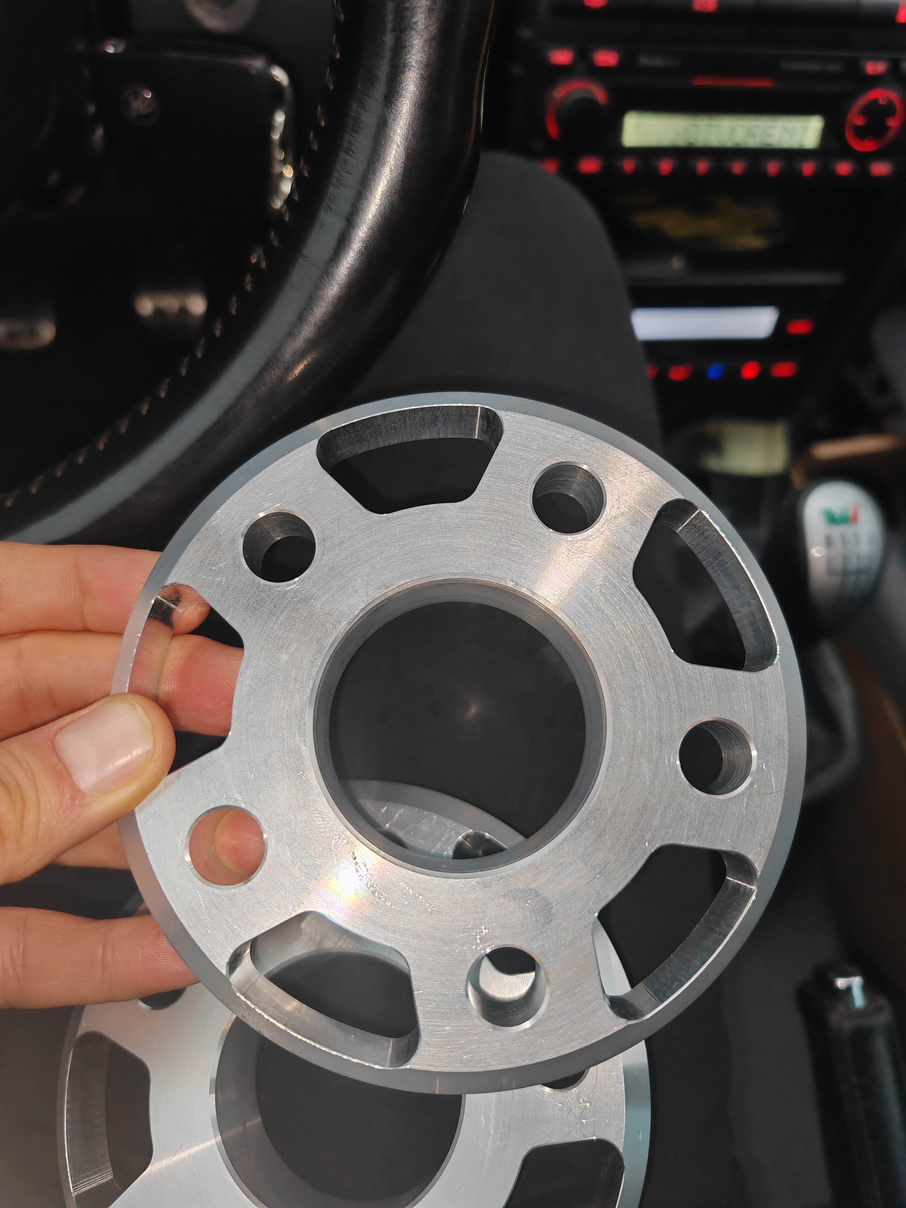

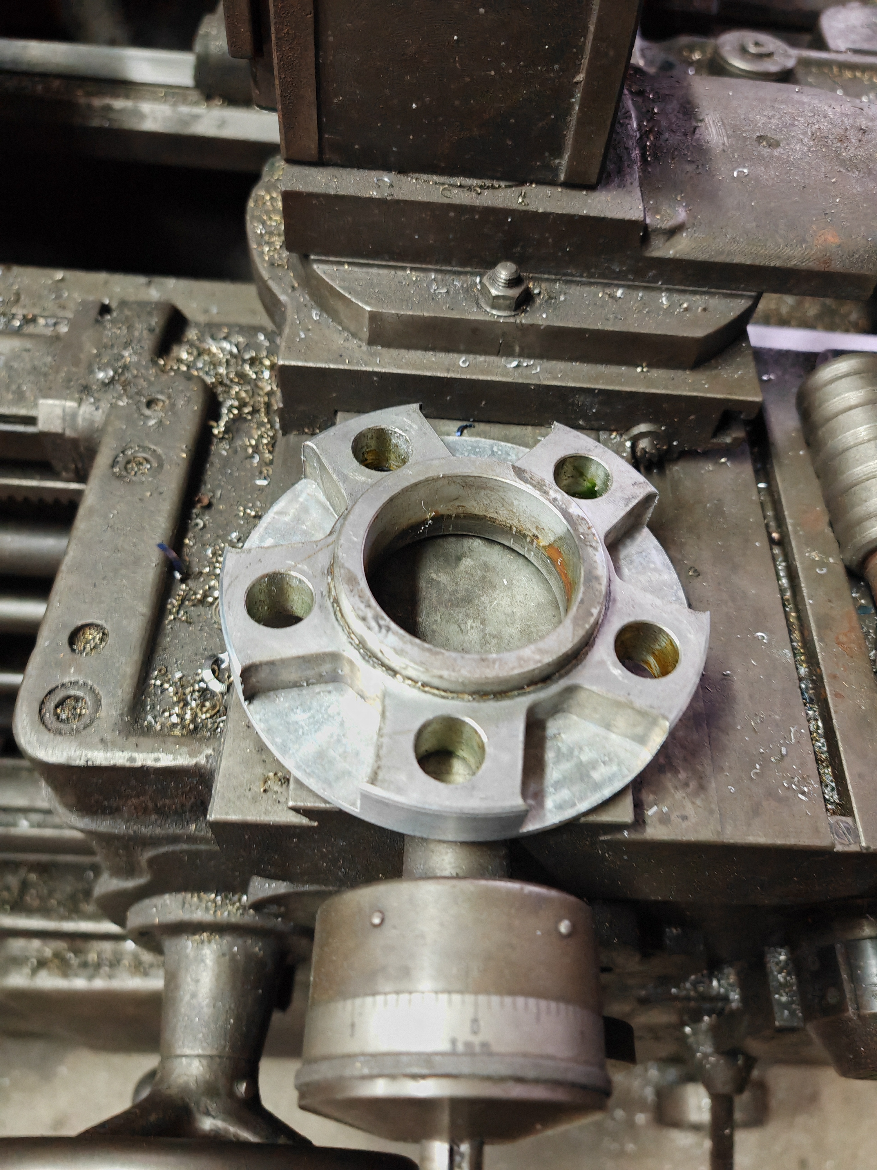

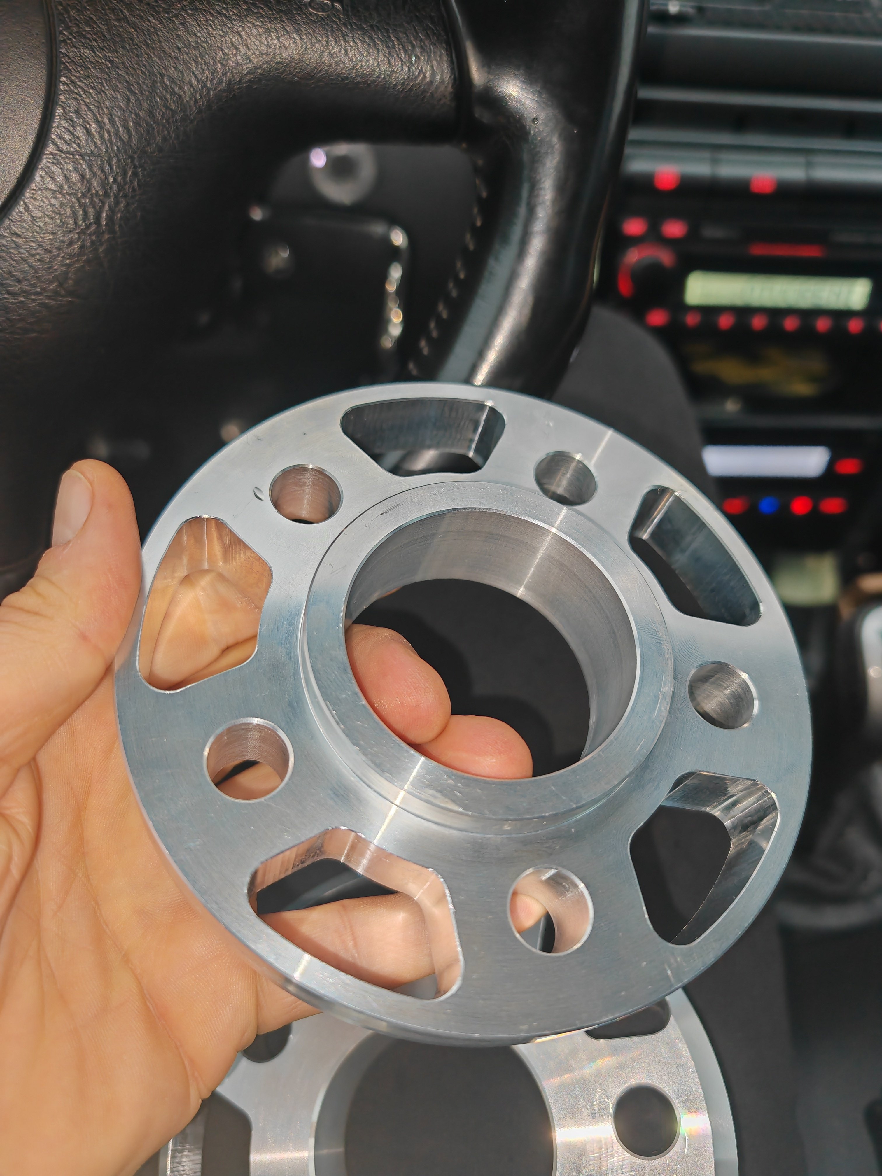

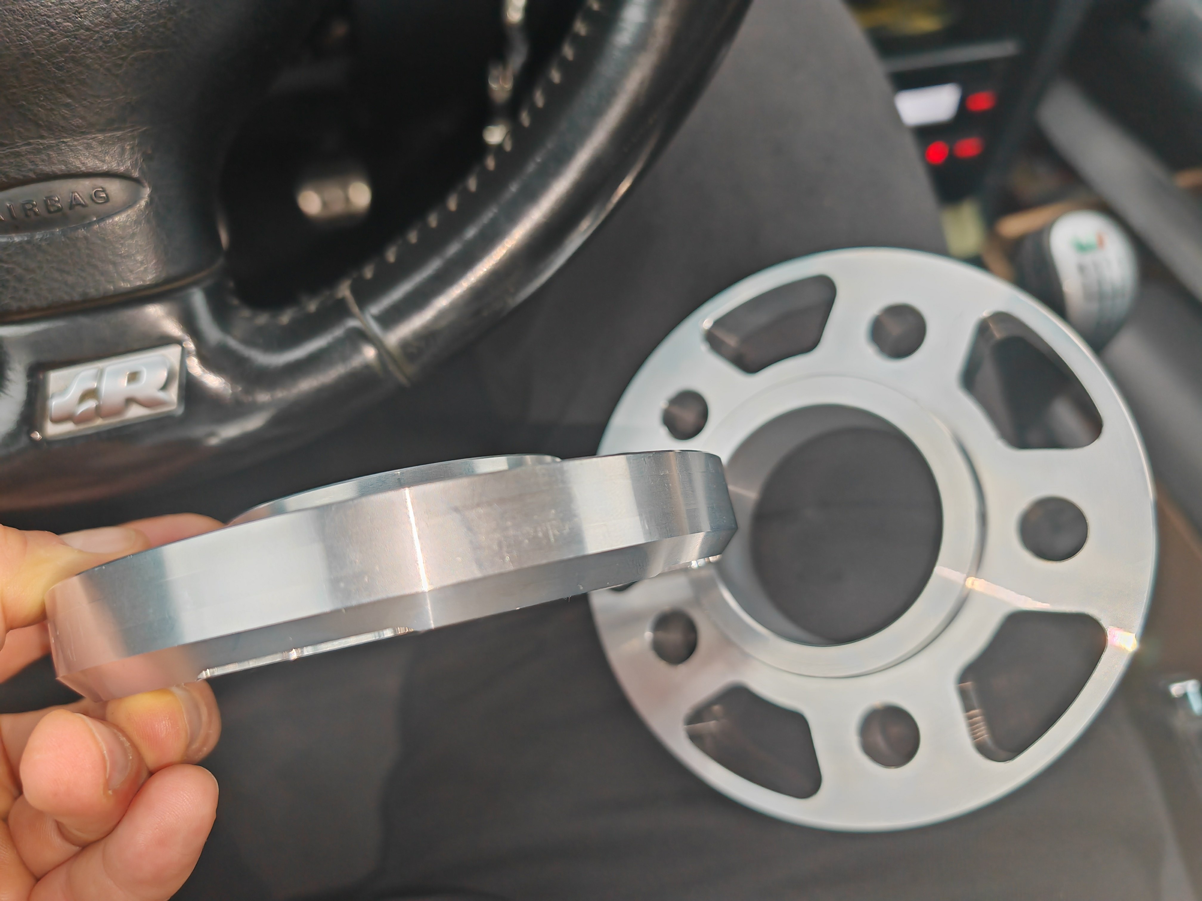

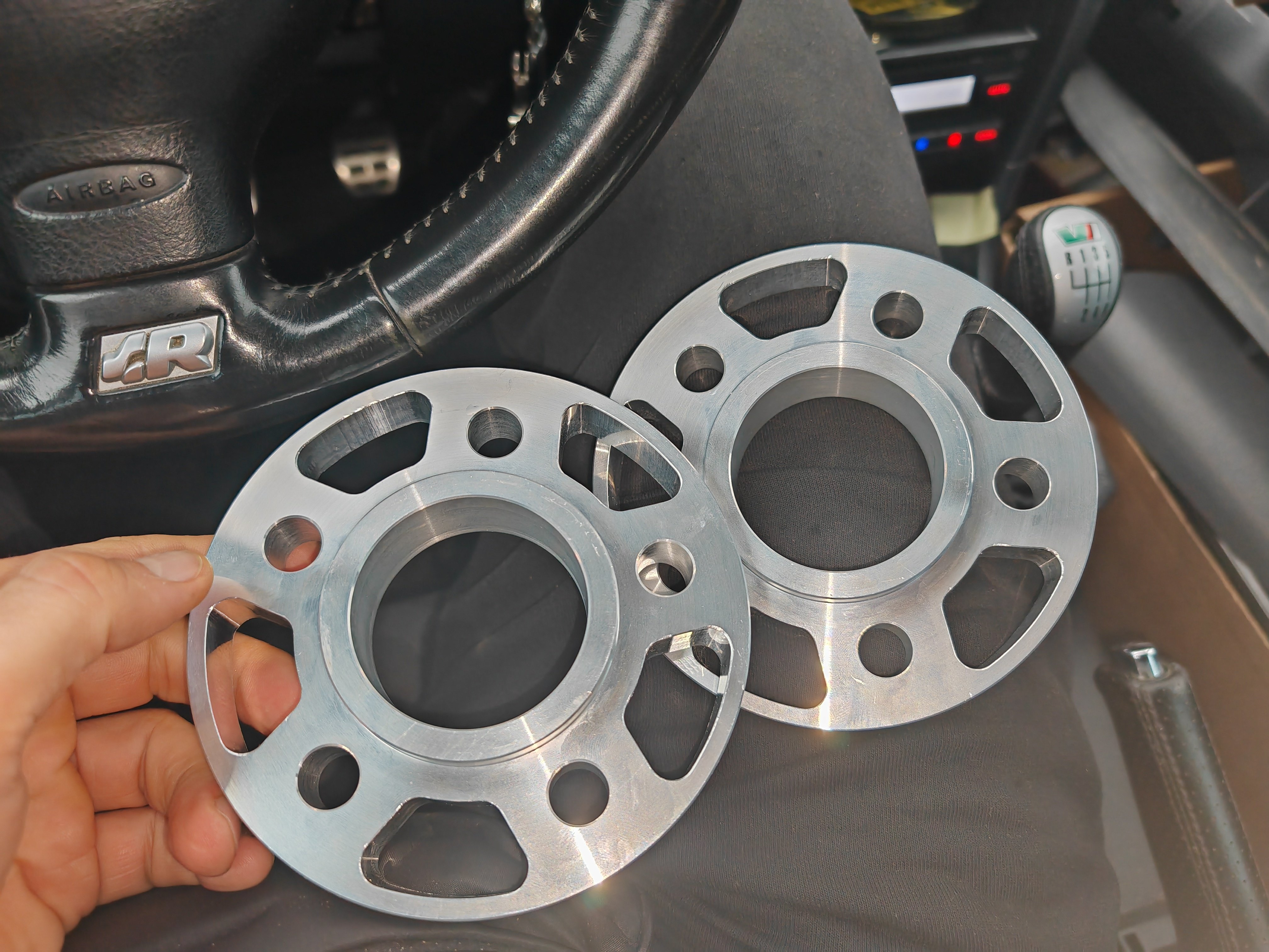

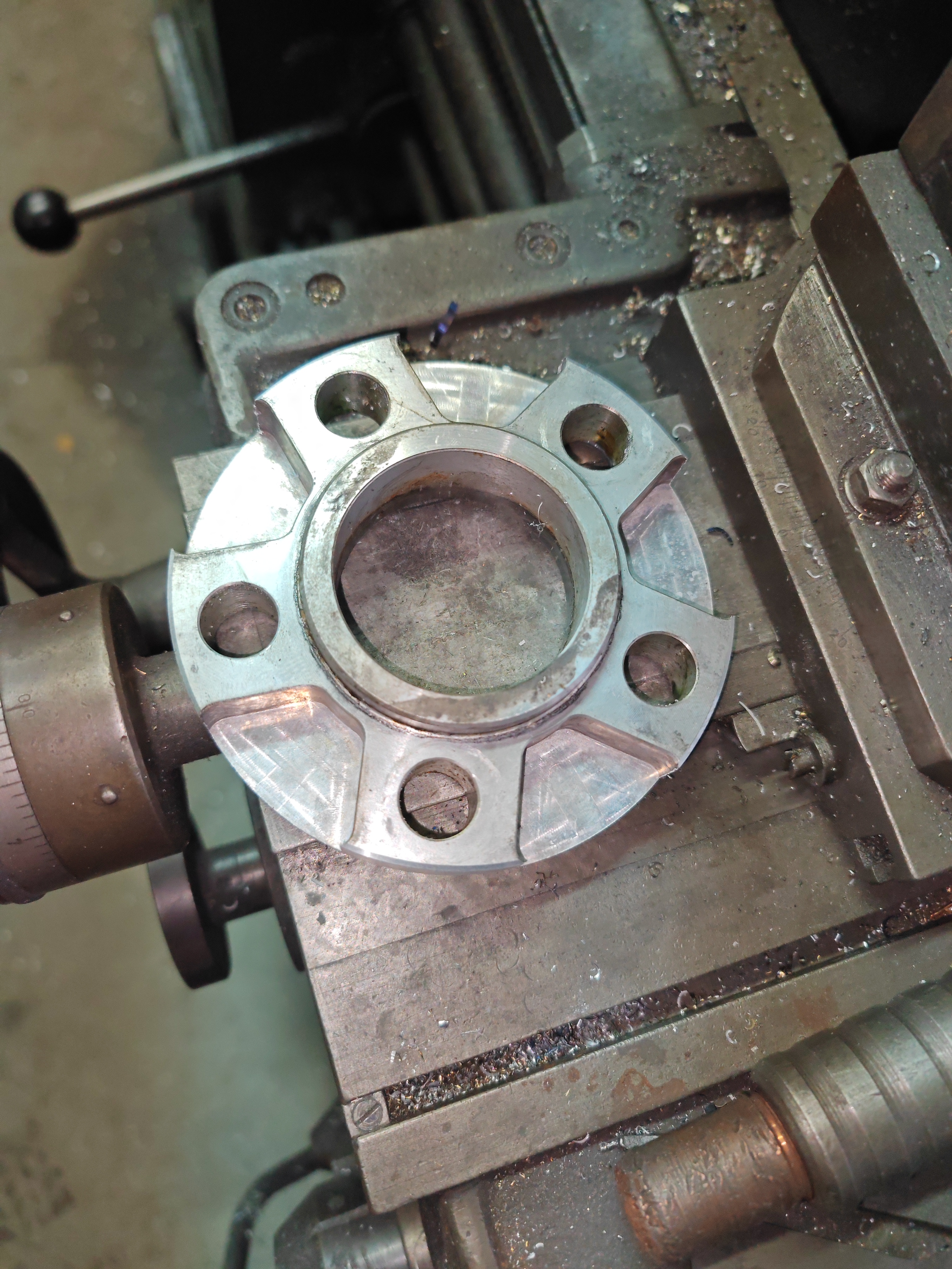

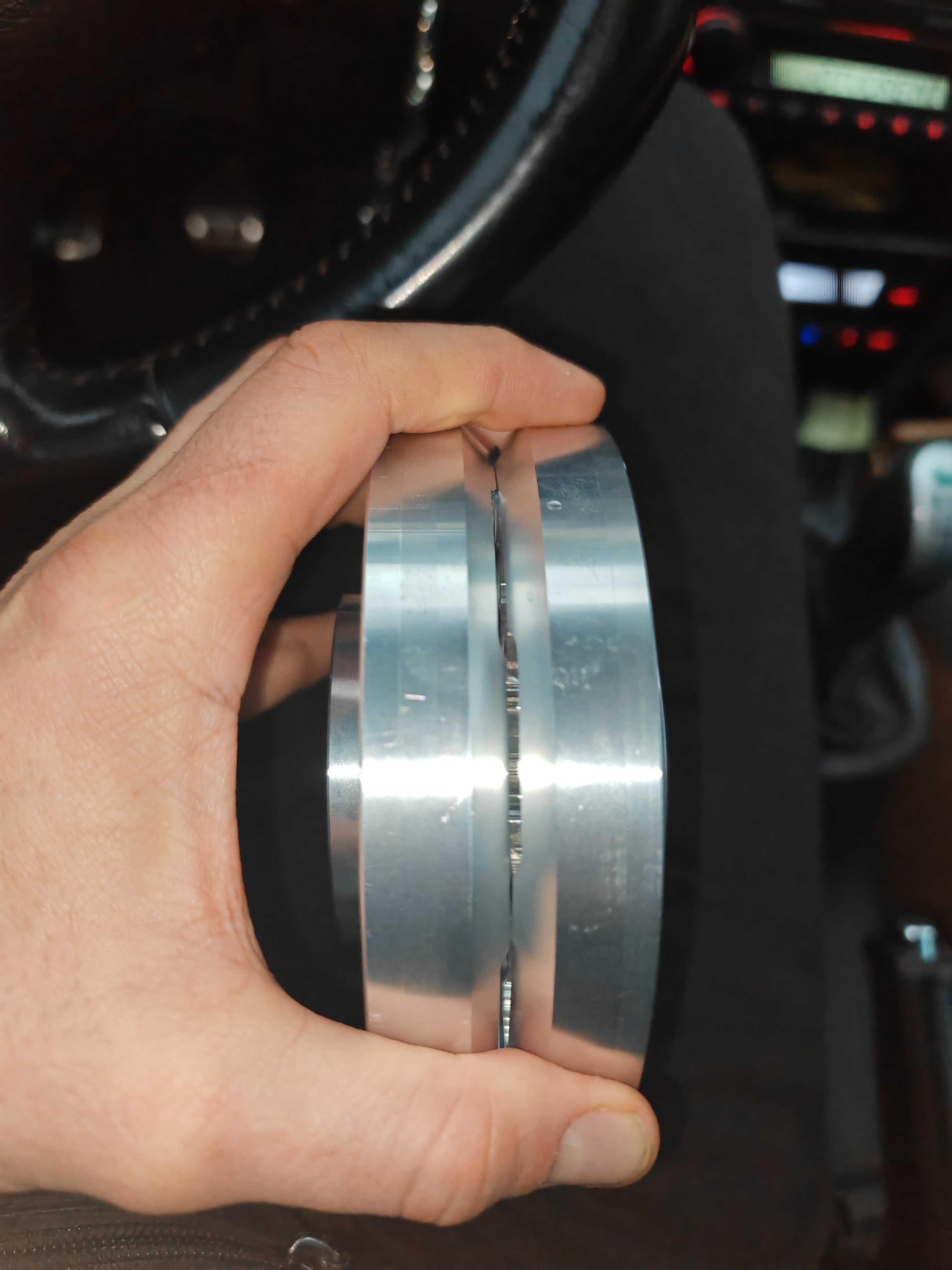

So new 21mm spacers are done with conus on backside to accomodate existing center hat which has 130mm contact surface. They are 140mm front  with 128mm back spacers made of 6082alu.
Hubcentric 72mm without any centering rings.
Same pattern as wheel so they are extra light.
Design borrowed from 42draft design.
In plan to make new center hat (drawing already corrected) with 140mm contact surface for new flat 140mm spacers and one more spare pair of discs that should also be drilled from 6,4x9mm to 9 mm to have them aside as spare parts now when I have drawings,materials and possibillity to make them.

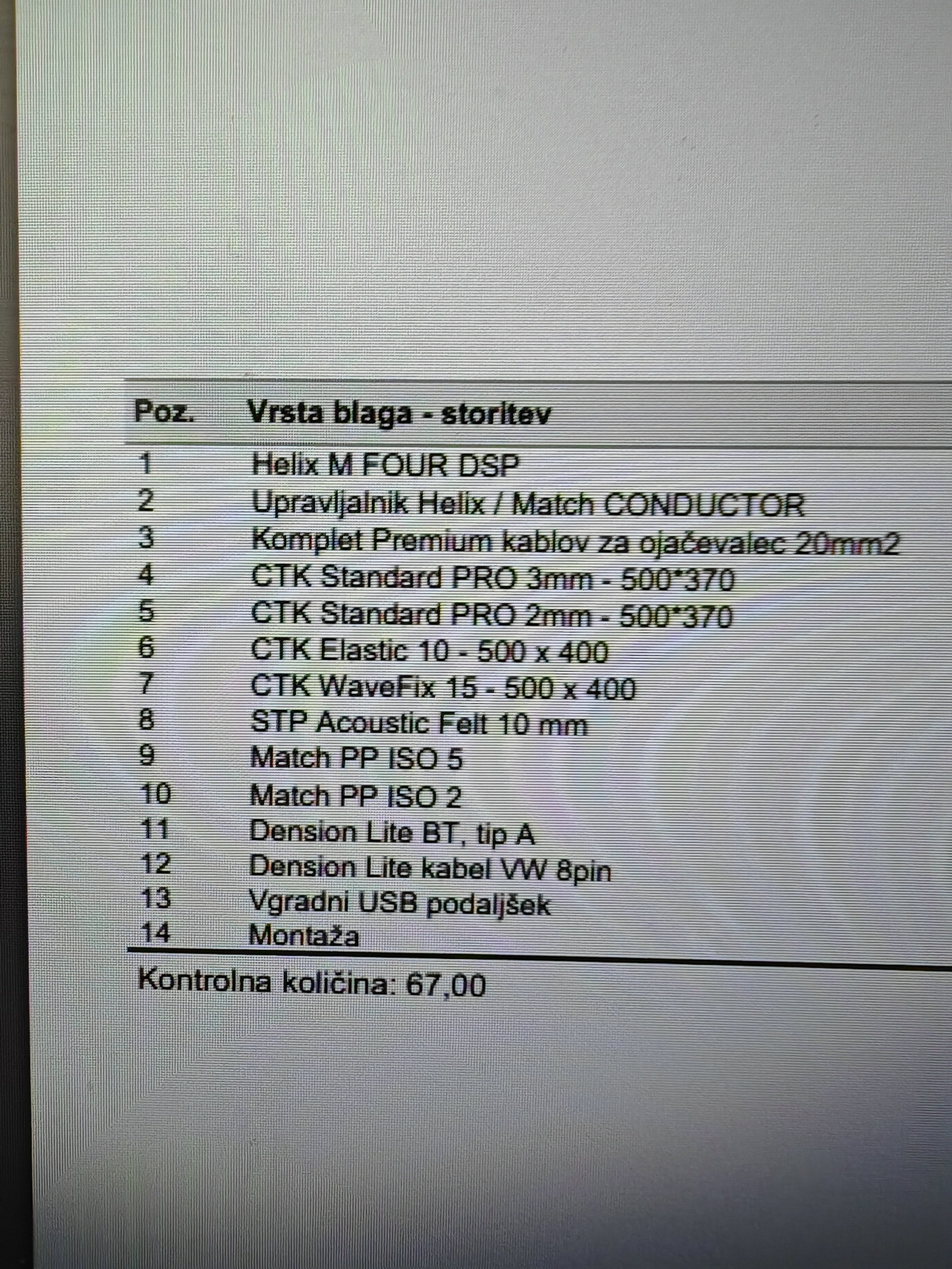

List of part that I purchased and we installed them directly in shop https://www.supersound.si/izolacija-vozila/
