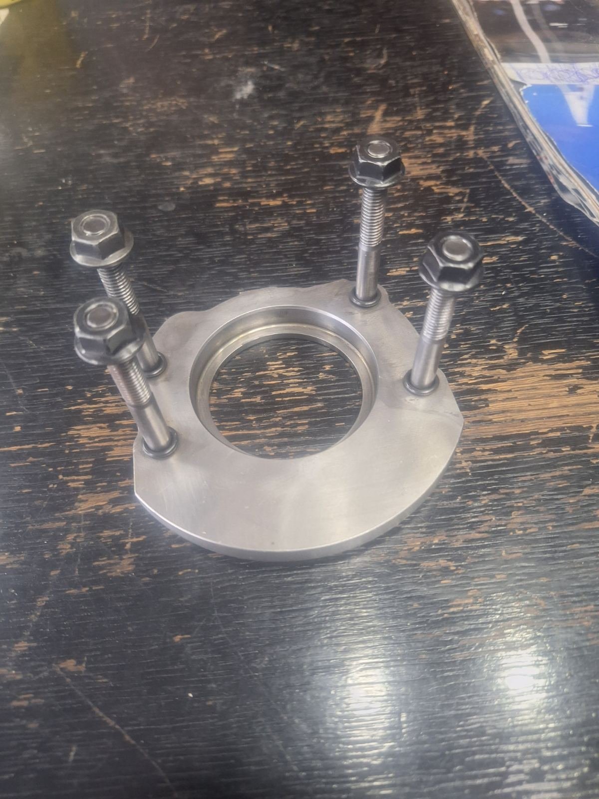

My friend Loctite is for sure one option. I just found here at page 12 that I already have custom made reinforced that part so I asked my friend in Čačak, Serbia Miško Herc tuner to make new one with longer bolts, that's the proper way of instaling it in my honest opinion. Will keep you upfated

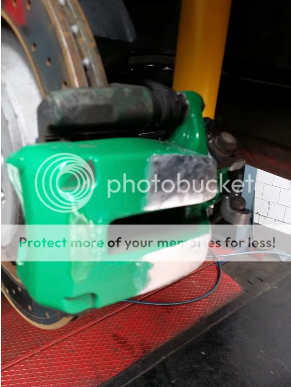

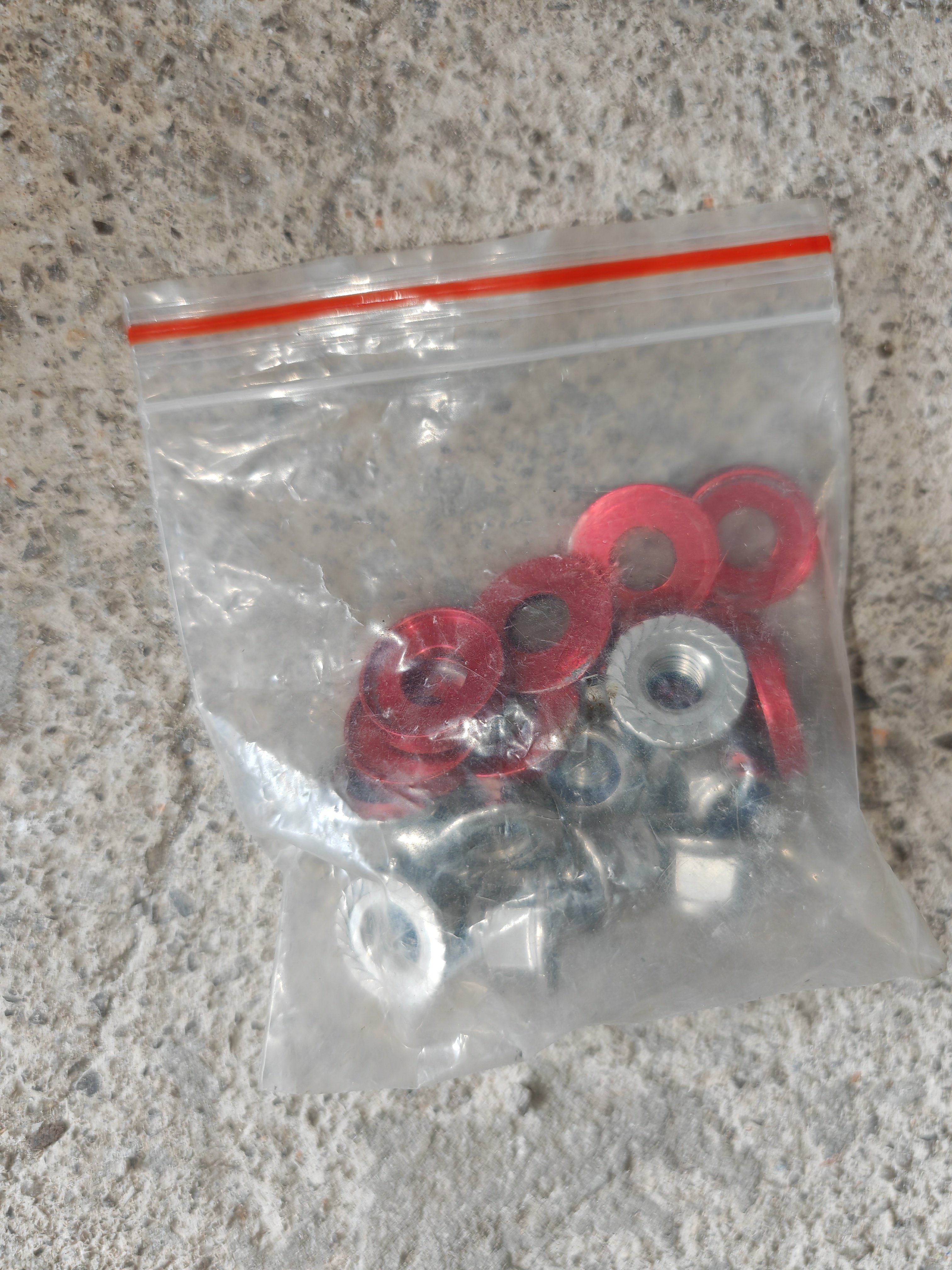

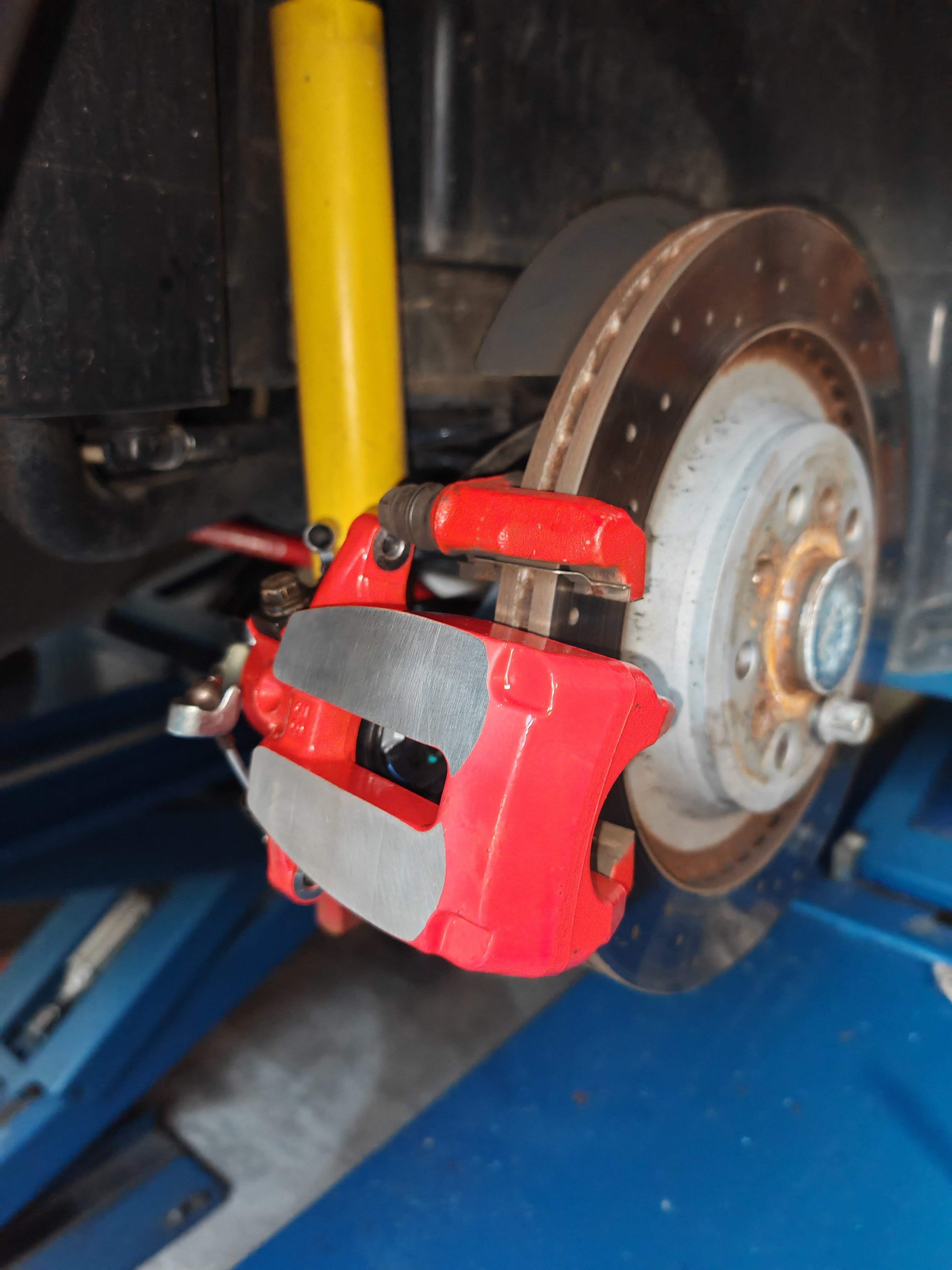

Had to replace old TRW right rear caliper because it was producing squeling sounds when in reverse than also in forward driving-blocking the wheel-piston rubber went off.
I bought this time Essen red ones,not green as last time but anyway I had to machine them again due to the new stupid wheel design-lack od space (with old 19s didn't have that problem). Painted that machined part in Foliatec 3020 Porsche Brembo red and now enyoing sound free new caliper

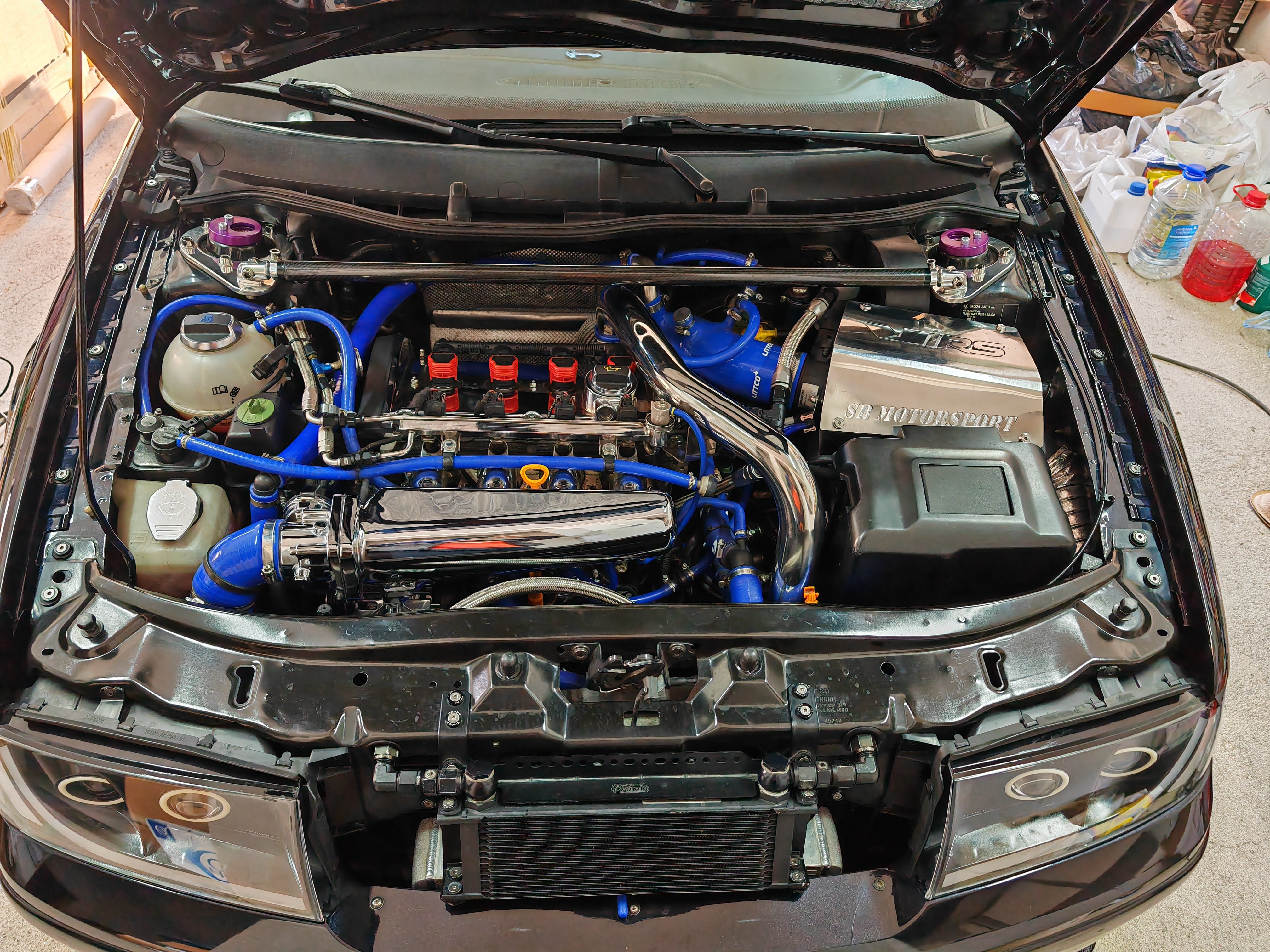

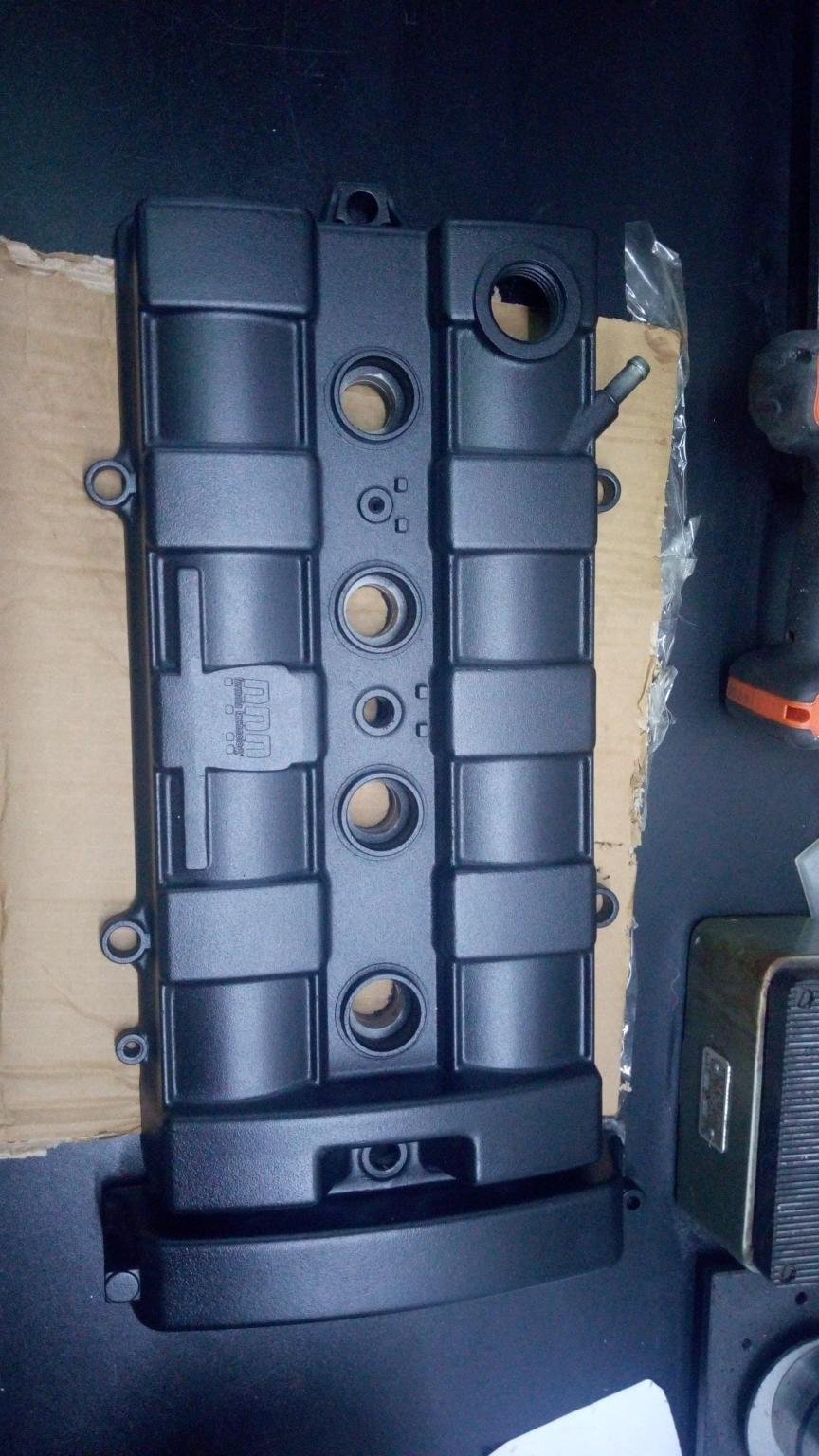

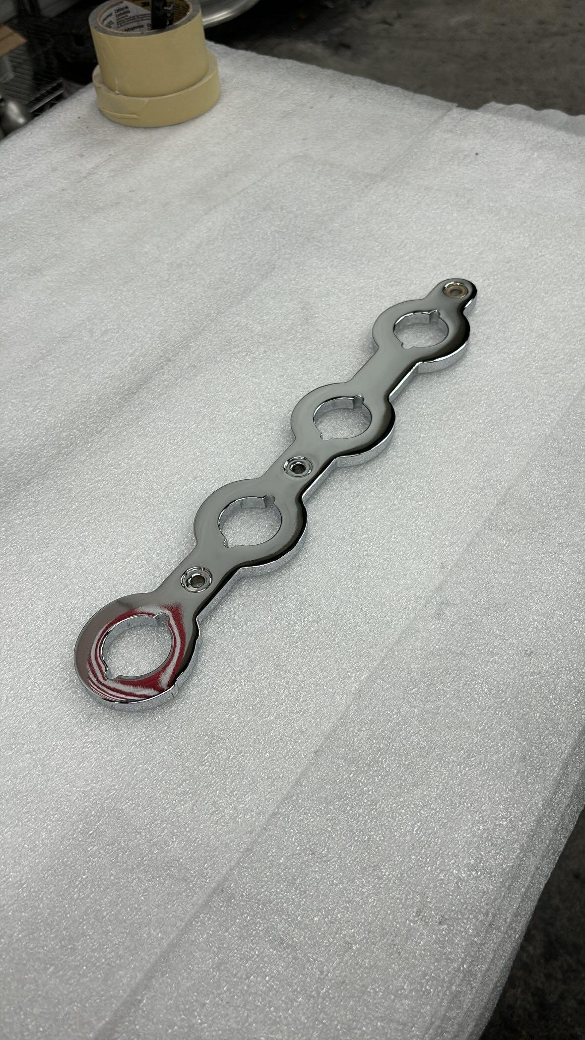

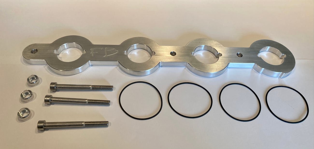

so any more awesome updateyes forsure, Here is R8 coils pack adapter that suits perfectly my AGN smooth cover. Waiting to get it and than first polish and than Chrome it Like other existing parts

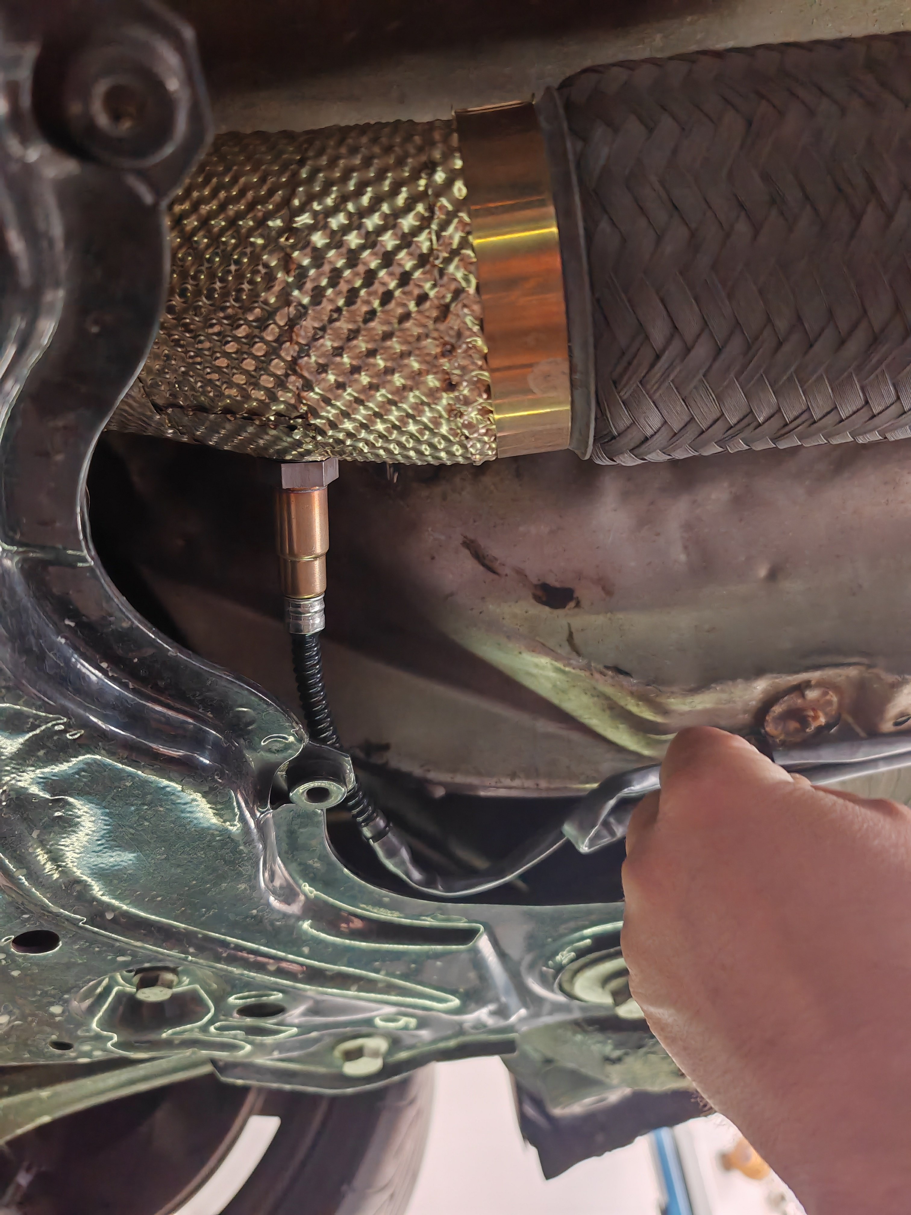

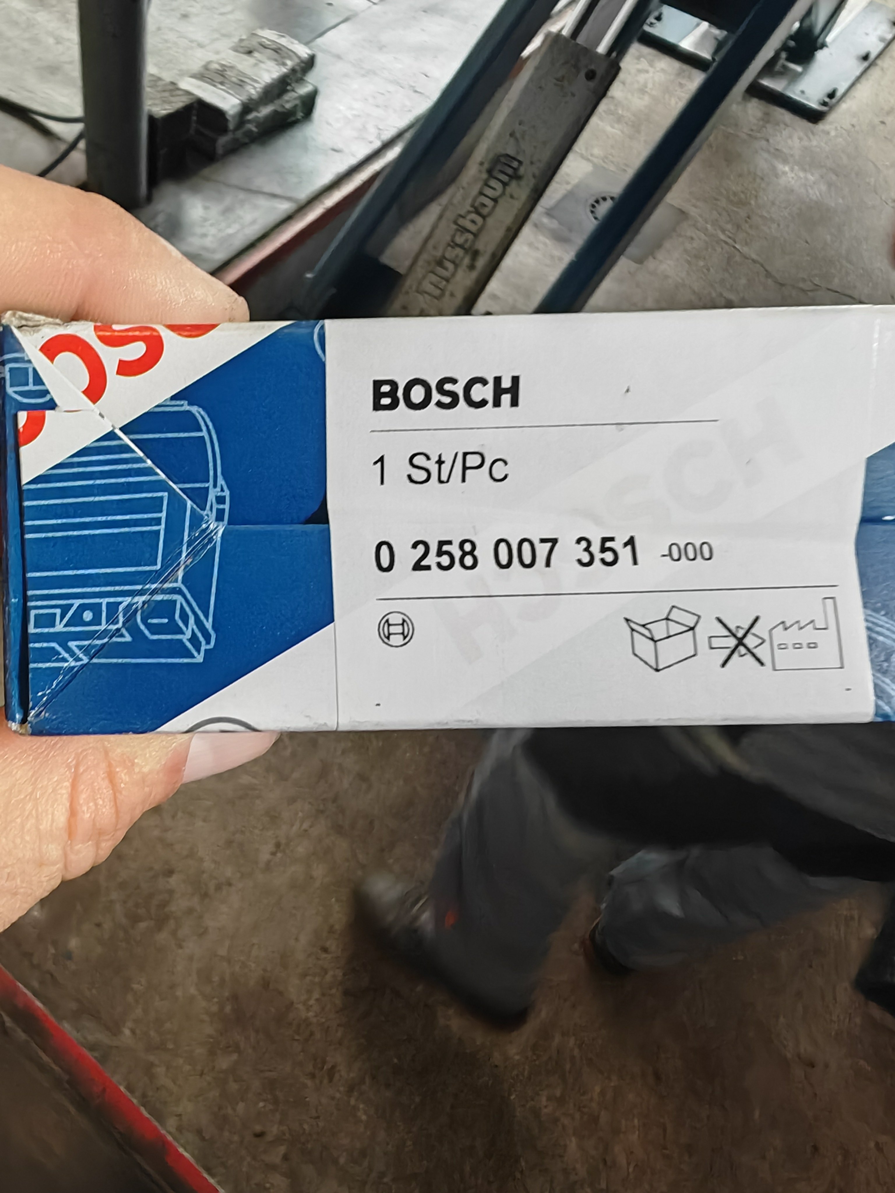

Had misfire error codes and after replacing MAF,Sparks and Lambda still present. Only thing remained was FPR and fuel pump. Looking at fuel pressure gauge when applying pressure to the FPR we figured out at www.rsrmotorsport.com (only one who decoded OEM ecu for new RS3 in the world!!!!) pump is not following it. It was Lamborghini Galardo (the same as on LCR) 8L0 919 051H 4 bar pump. So I ordered used good one. Can't wait to replace it because I was lean on full throttle above 4-5trpm

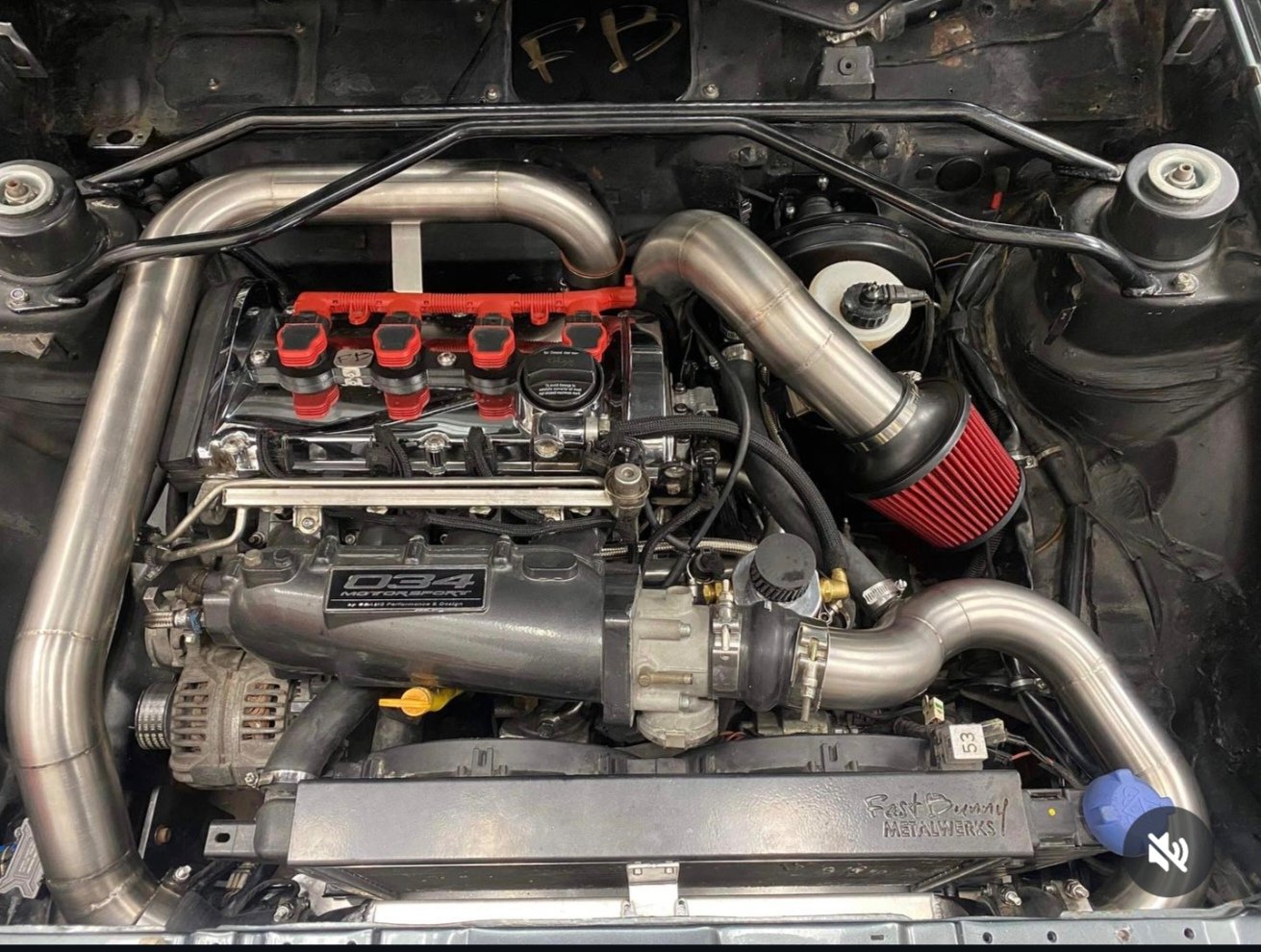

very nice loving the pipework on the other picture too
On 2nd or 3rd picture, others engine bay or mine?
both look mega

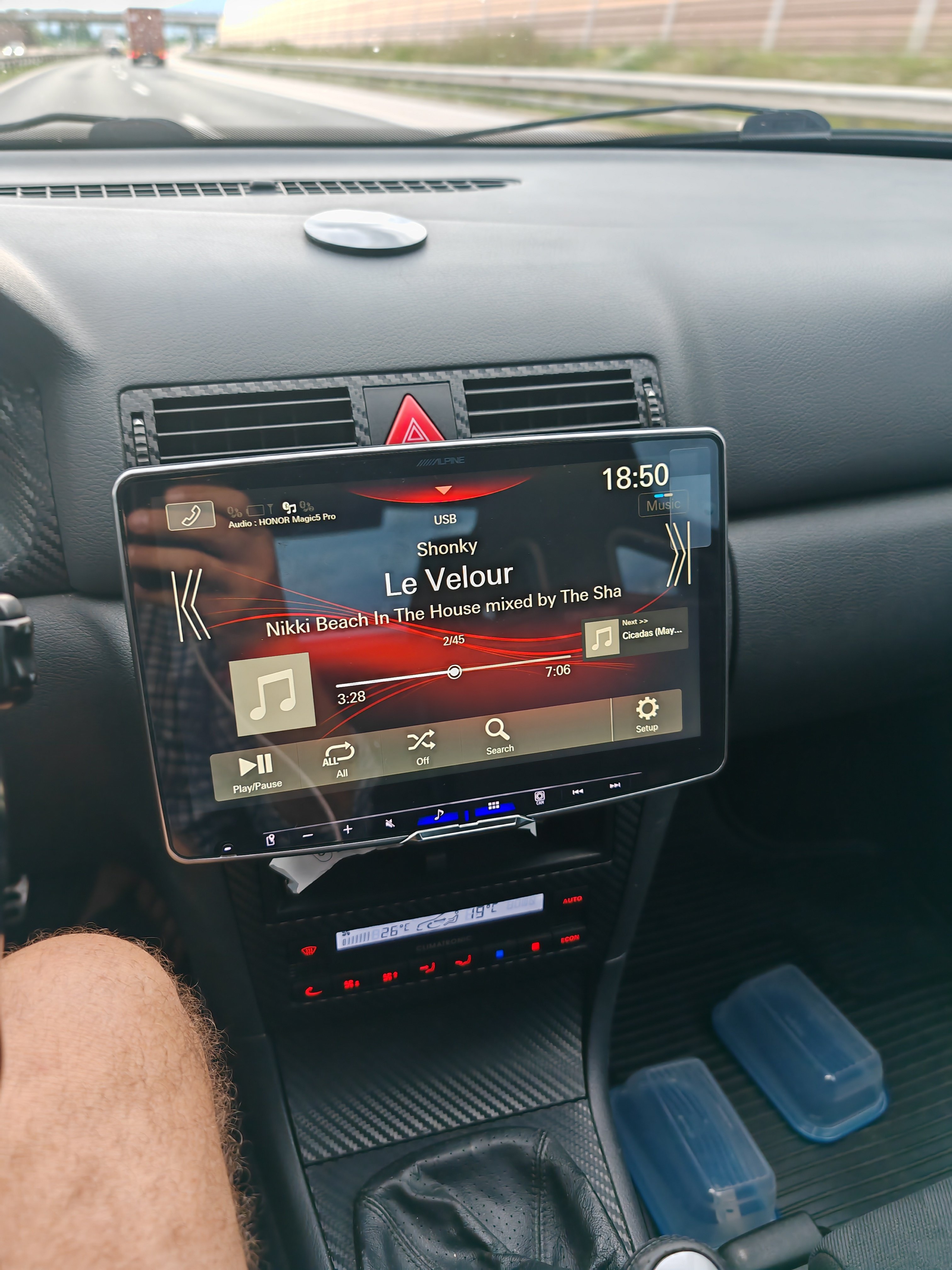

Alpine Halo 11
On 24/07/2024 at 07:08, davojuri said:
Alpine Halo 11
now thats fancy

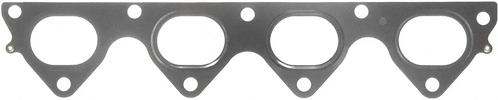

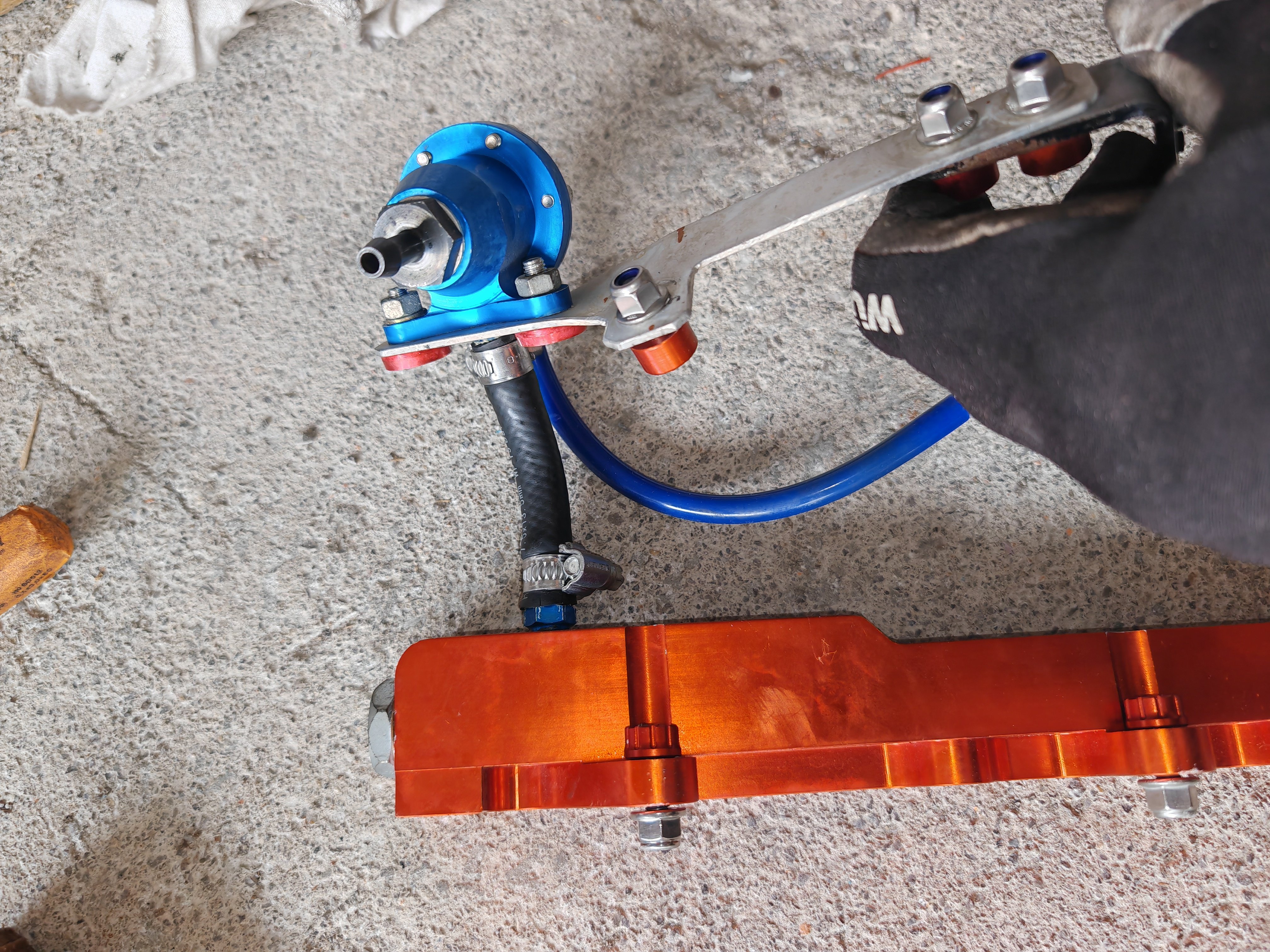

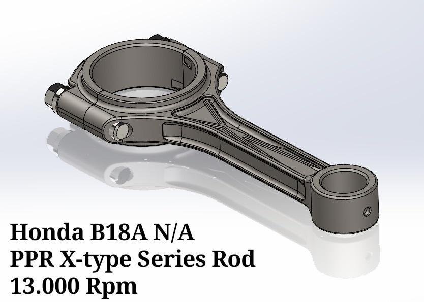

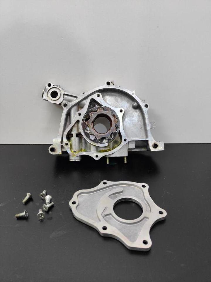

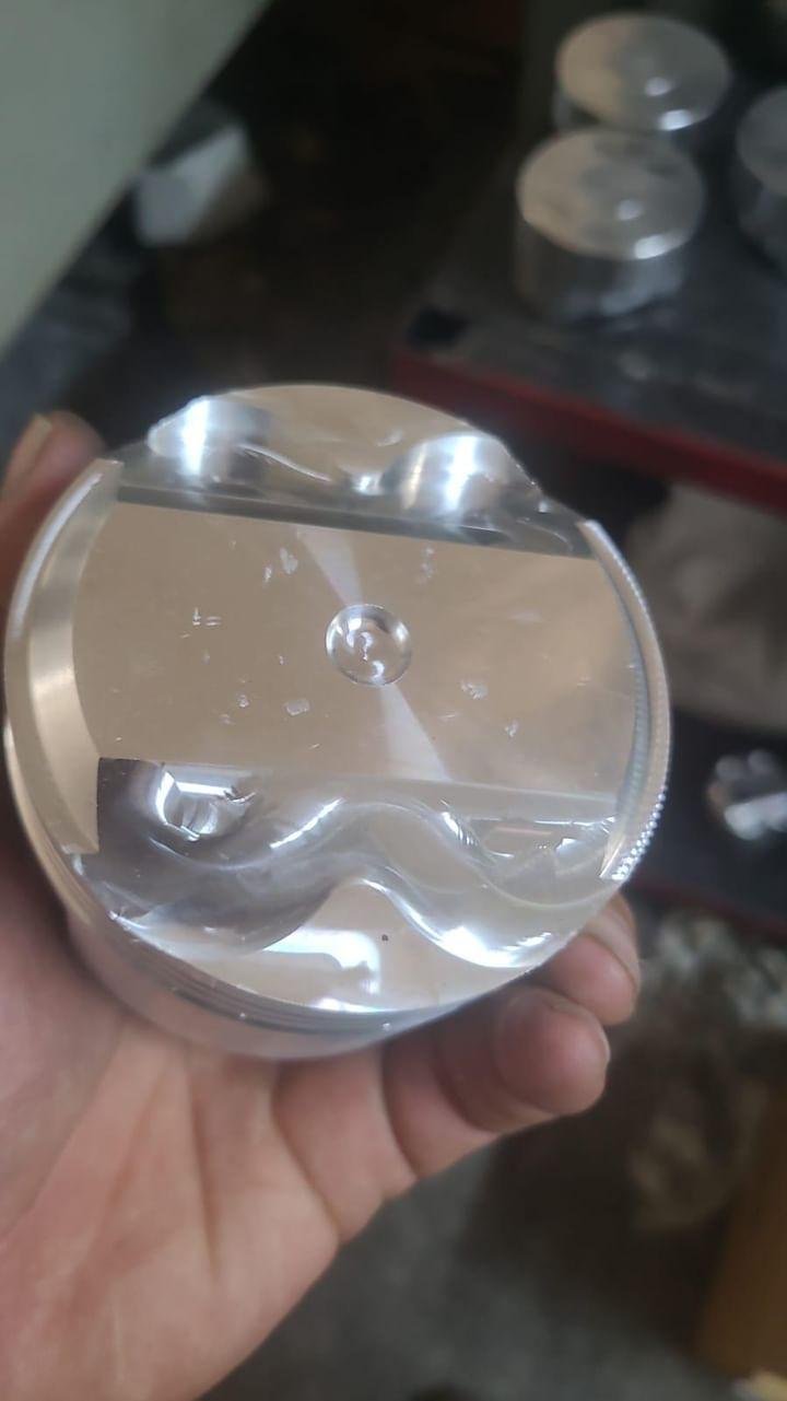

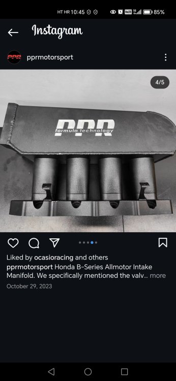

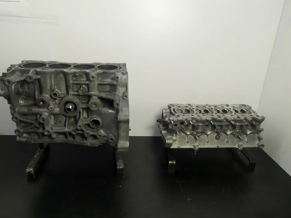

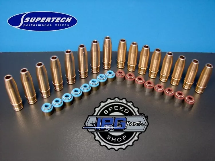

I was sure I Will built stroked forged 1.8T first but Here is how I Progress with B18A All motor NA NON VTEC bored to 2.0l. for my CRV RD1
New complete engine is ordered from https://www.pprmotorsport.org/
I bought B18A block due to his better and stronger construction than B20.
Plan is all motor NA 2.0l NON VTEC,
rev limit 9900rpm
Stroke Will remain the same but bore 84mm

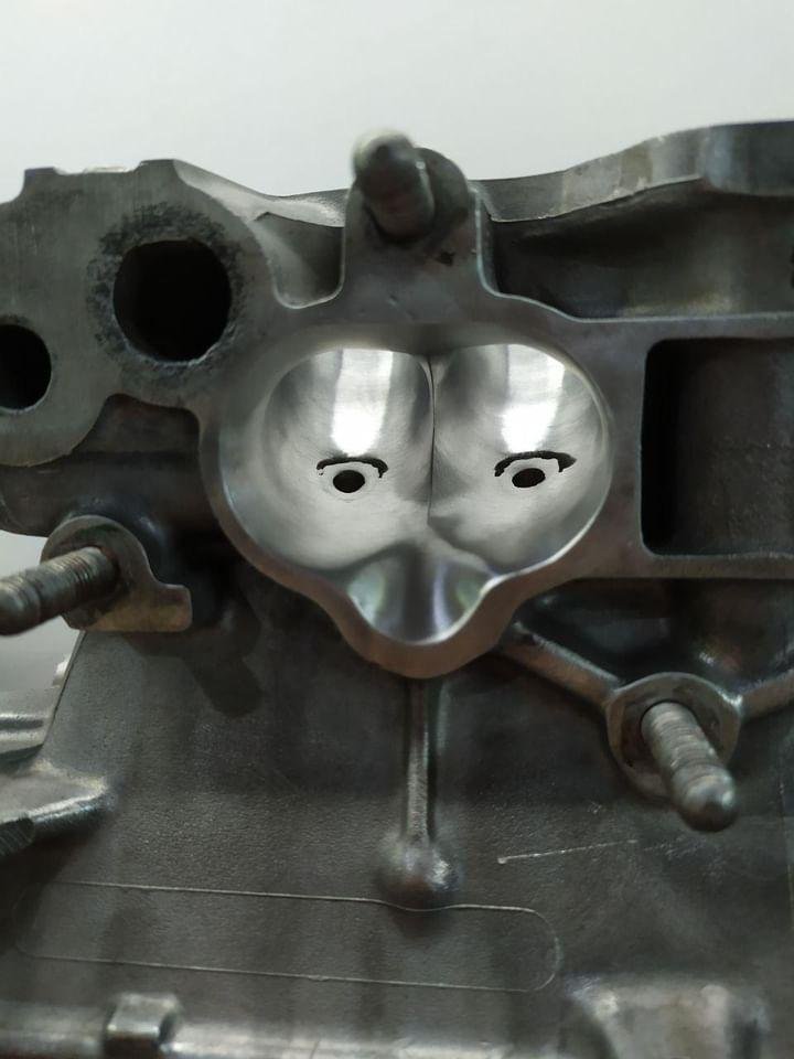

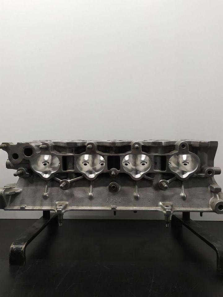

Block and head are soda blasted,and head is already CNC ported and hand finished.

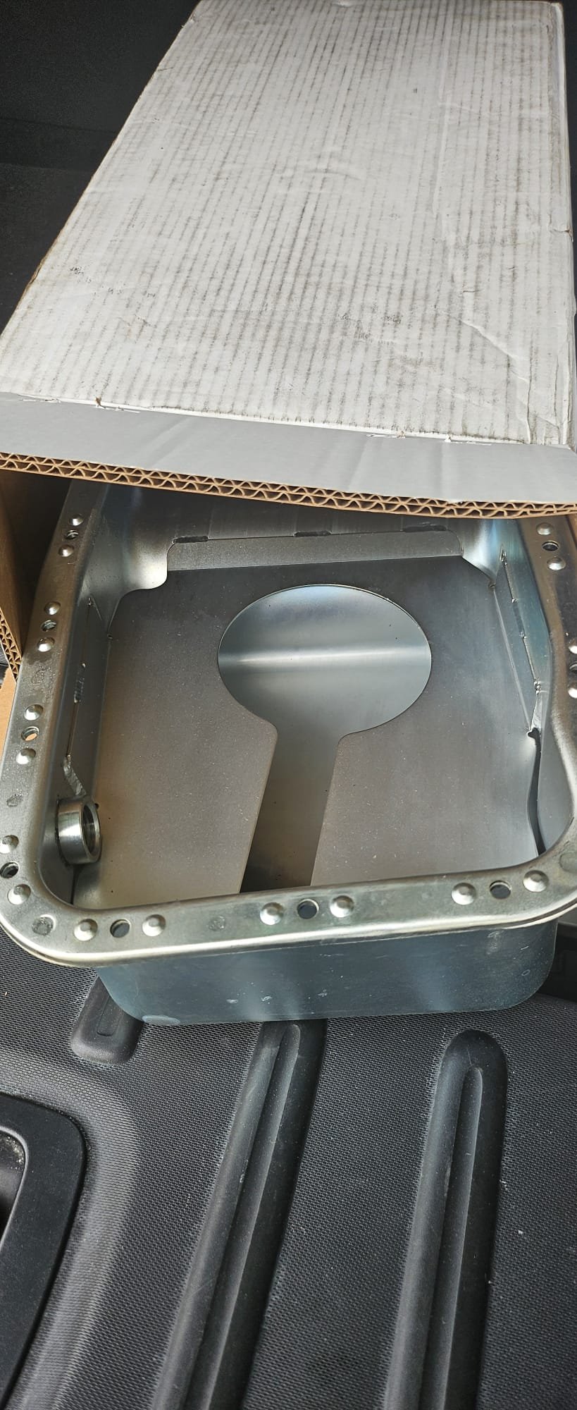

Moroso oil Pan.
Moroso oil Pan stud kit
Red washers for oil Pan stud kit

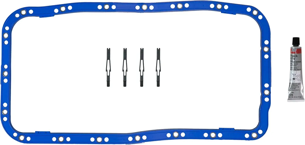

Felpro oil Pan gasket
Felpro exhaust gasket port matched to cnced head ports
Golden eagle main griddle kit with GSR tray,oil Pick up, dovel pins and ARP studs,
OEM crnak stroke 89 lightened (on inner radius to retain rotarional mass-torque) micropolished,
Custom vanadium X type rods rifle drilled

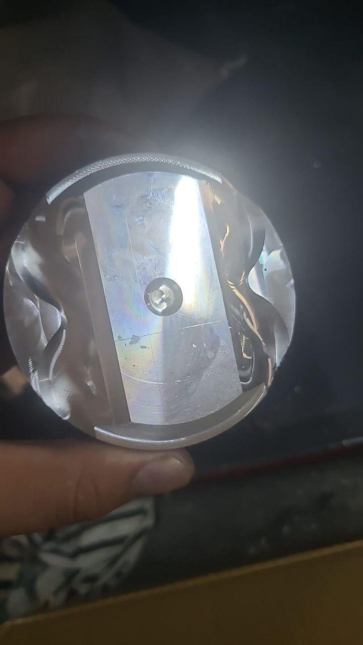

Custom 84mm pistons CR 13,2, with Center hole for ignition
Wet sleeves,
Block guard,

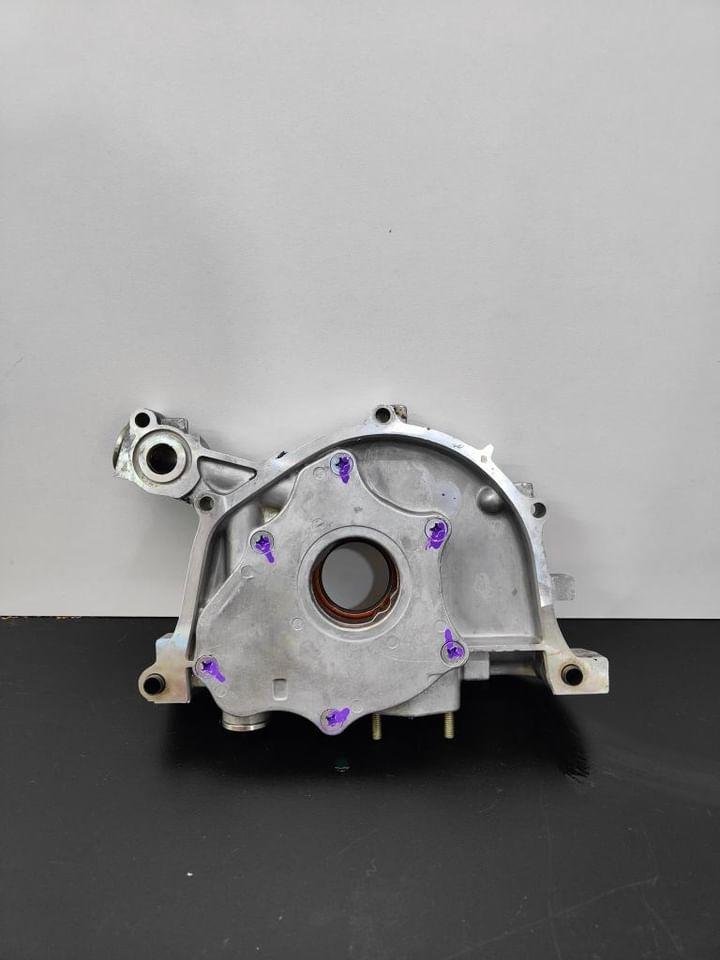

Ported oil pump
Vanadium head bolts
LS NON VTEC head ported polished
BC stage 3 NA cams
Adjustable cam gears
Custom Springs
Custom vanadium retainers
Supertech valve seals
Supertech bronse valve guides
Titanium coated 1.5mm oversized valves,

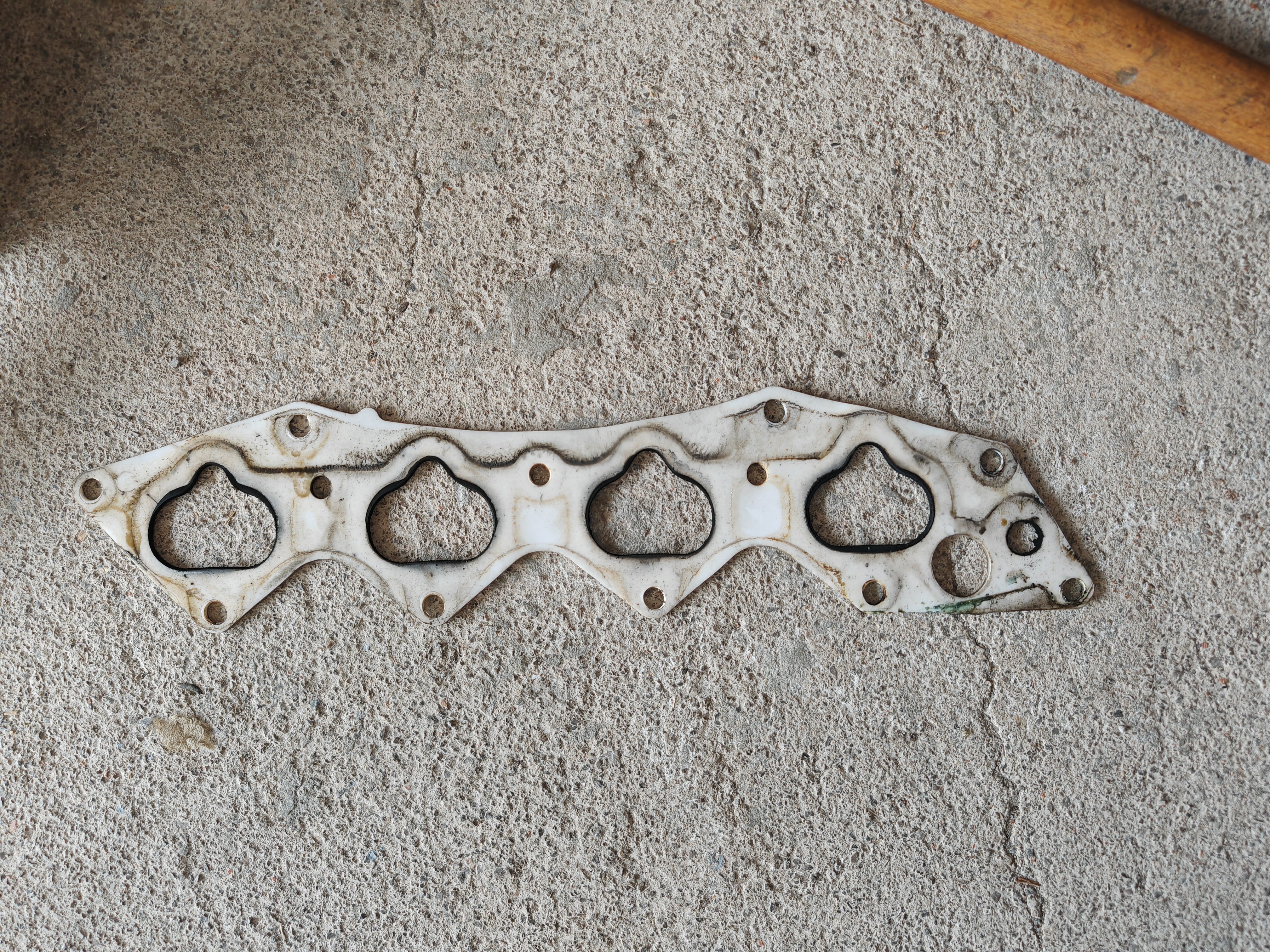

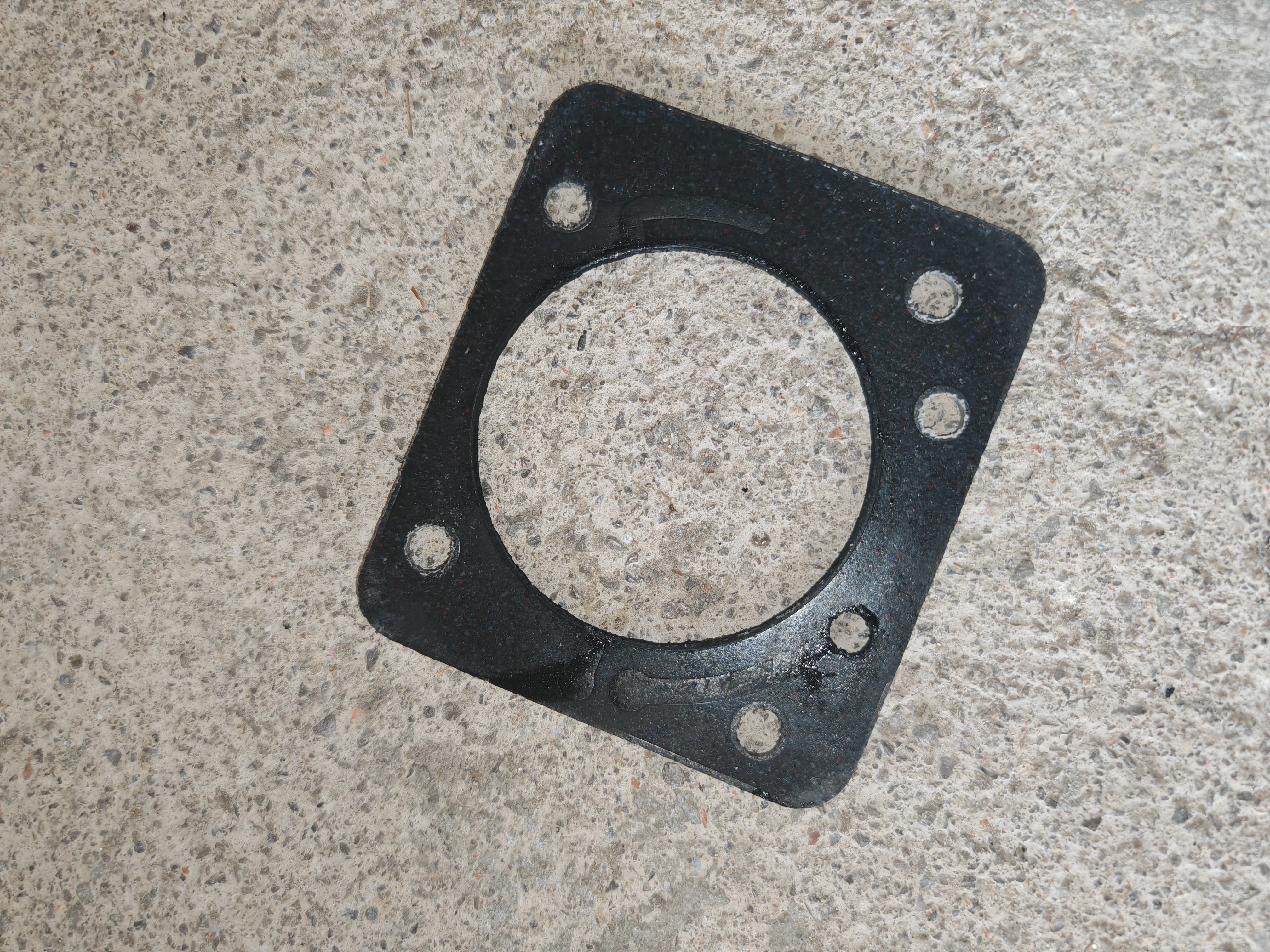

thermal intake gasket,
billet intake, port matched to jead
TB 80mm,-port matched to intake

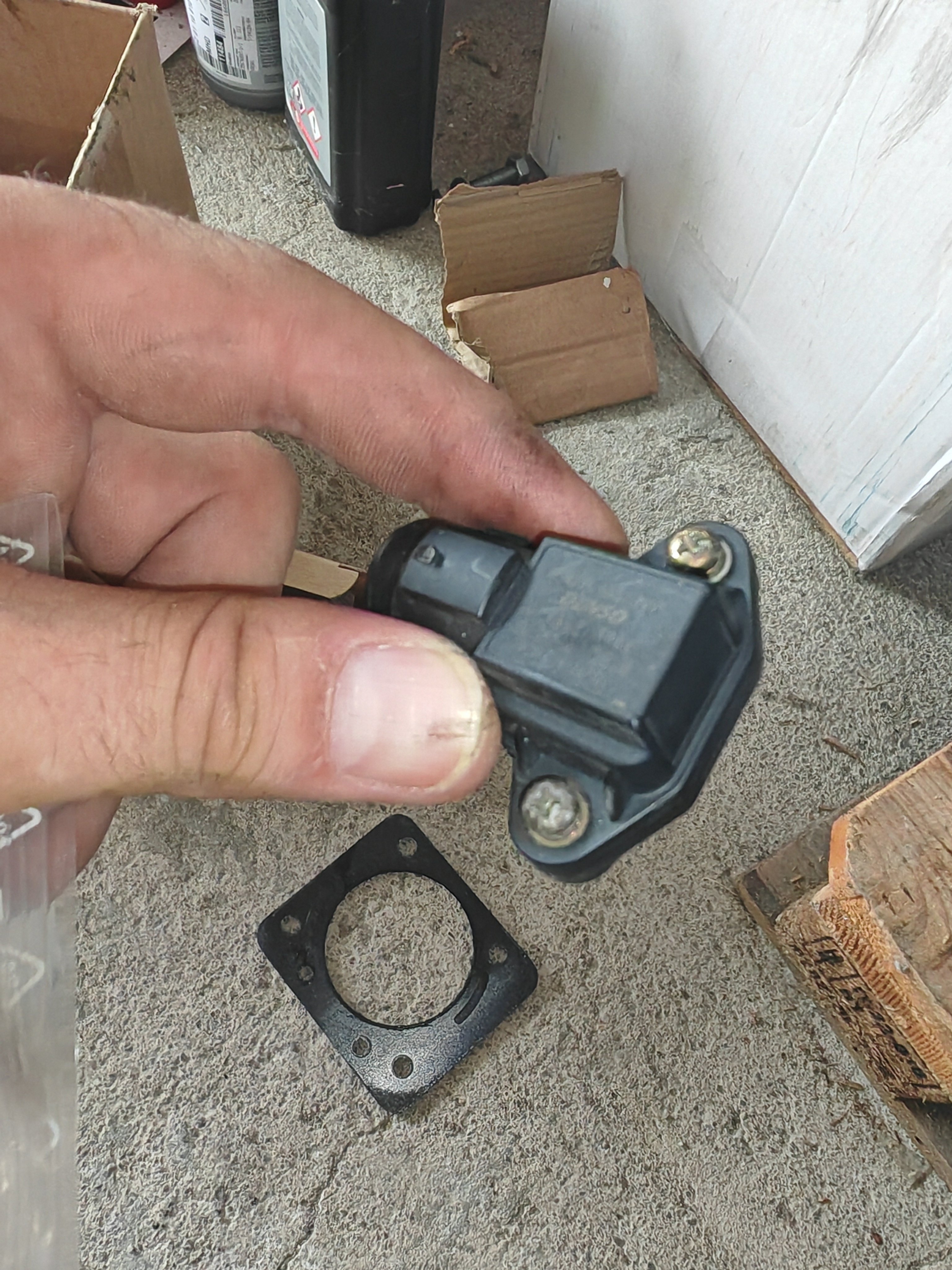

thermal TB gasket,
thermal MAP gasket
Billet thermostat housing

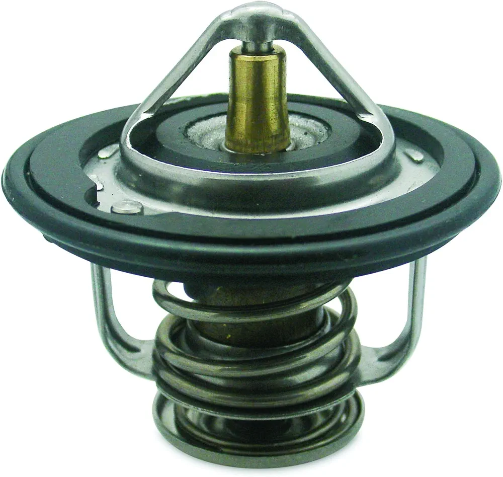

Mishimoto low temp thermostat
Mishimoto low temp fan switch
Nissan GTR R35 injectors,

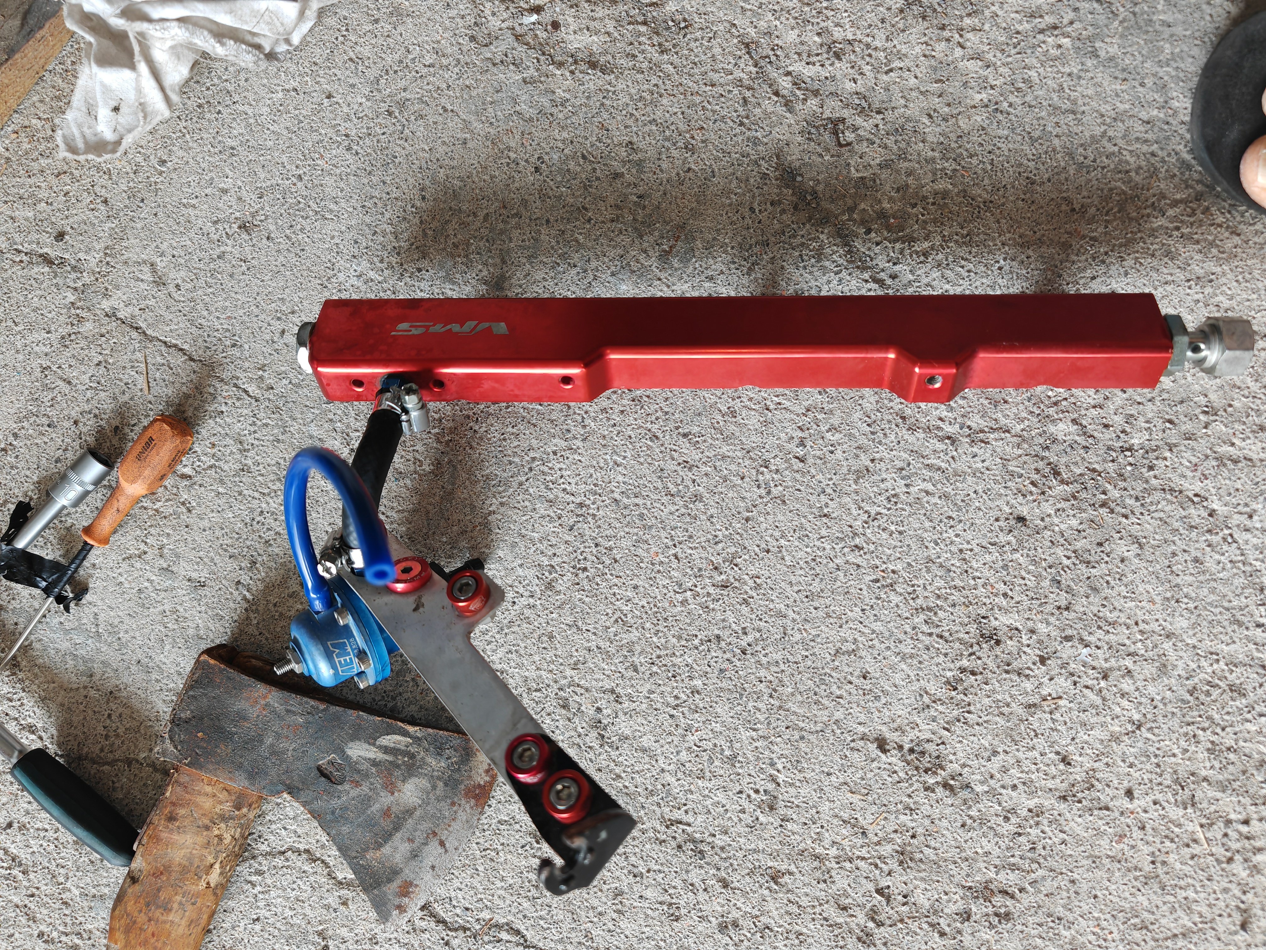

billet fuel Rail,
AEM FPR,
STI Street super damper,
Competition clutch stage 3,
Conpetition clutch single mass light steel flywheel
Edited by davojuri

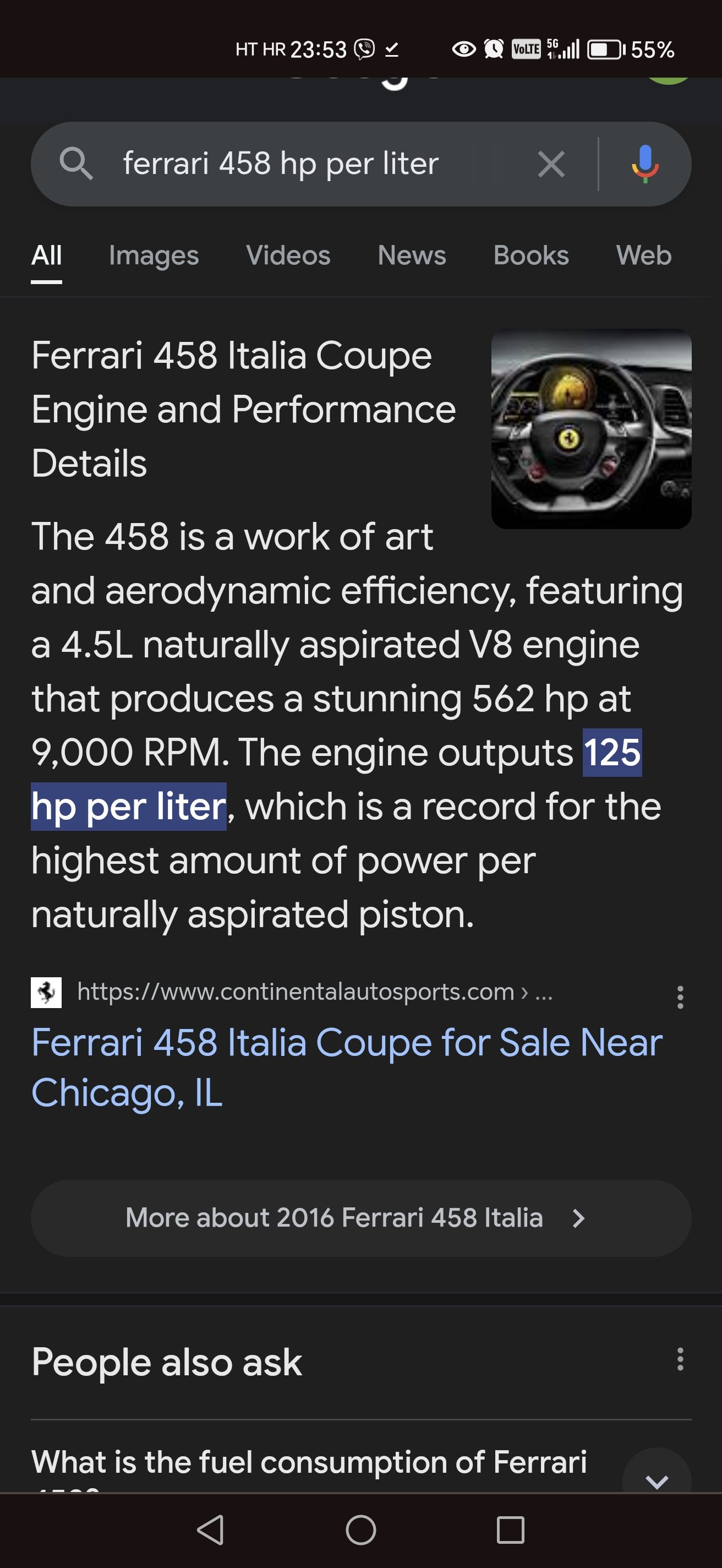

First IT was S2000 with 240hp 2.0l engine, 120hp per liter, than years after it Ferrari 458 with 125hp per liter. We are sure with this build  for 250hp and aiming 300hp Mark😇😇
Will keep you updated

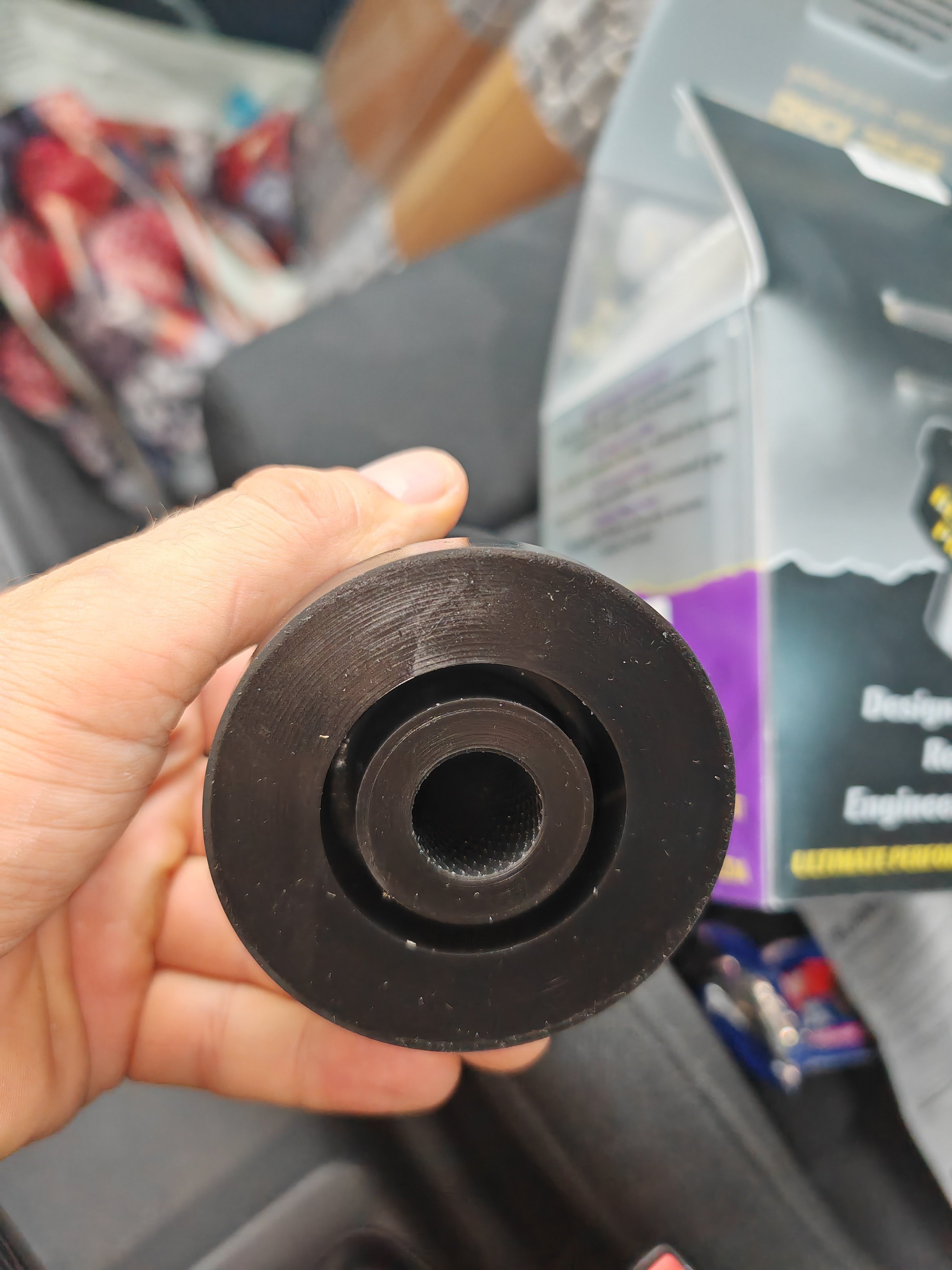

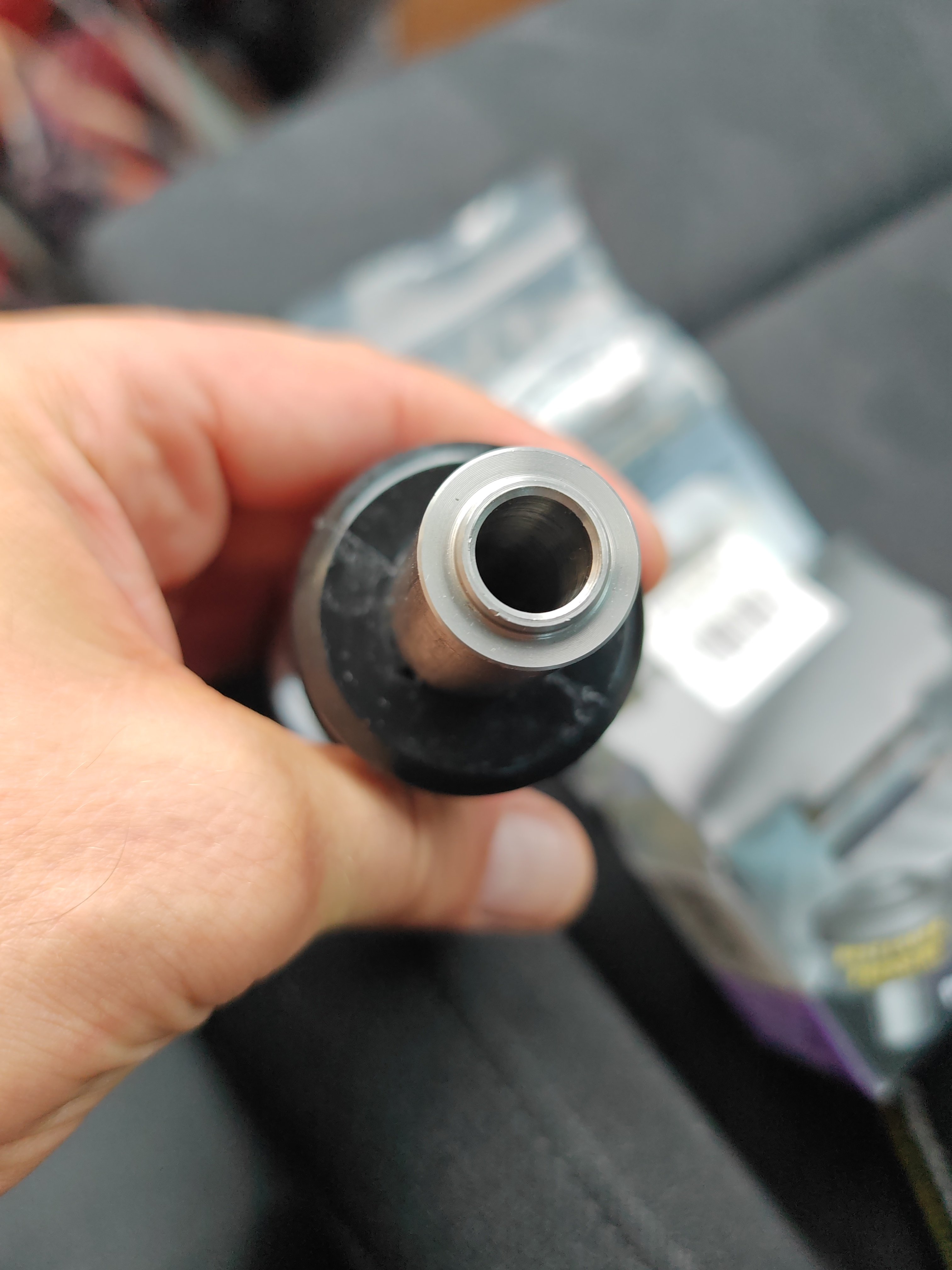

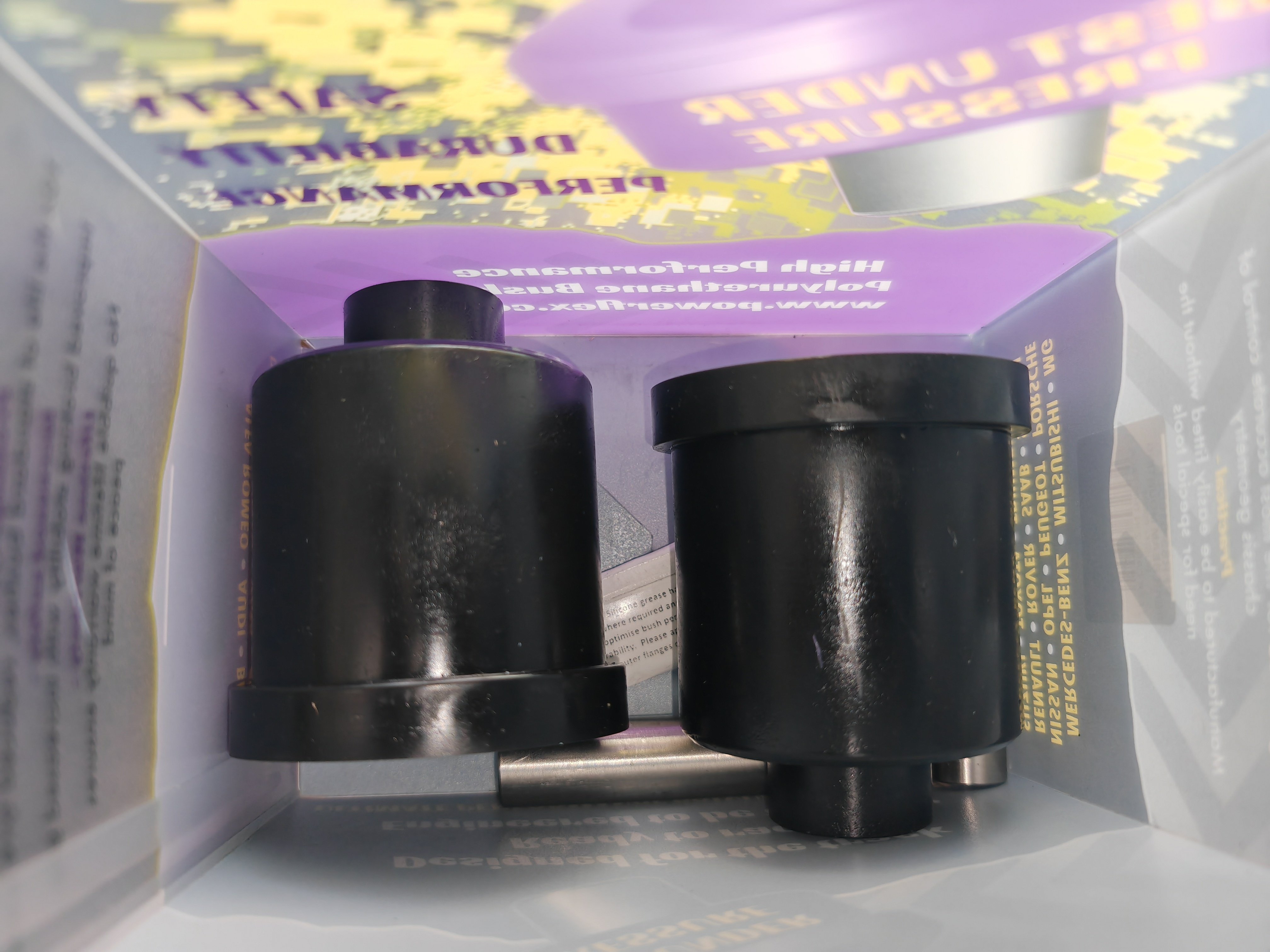

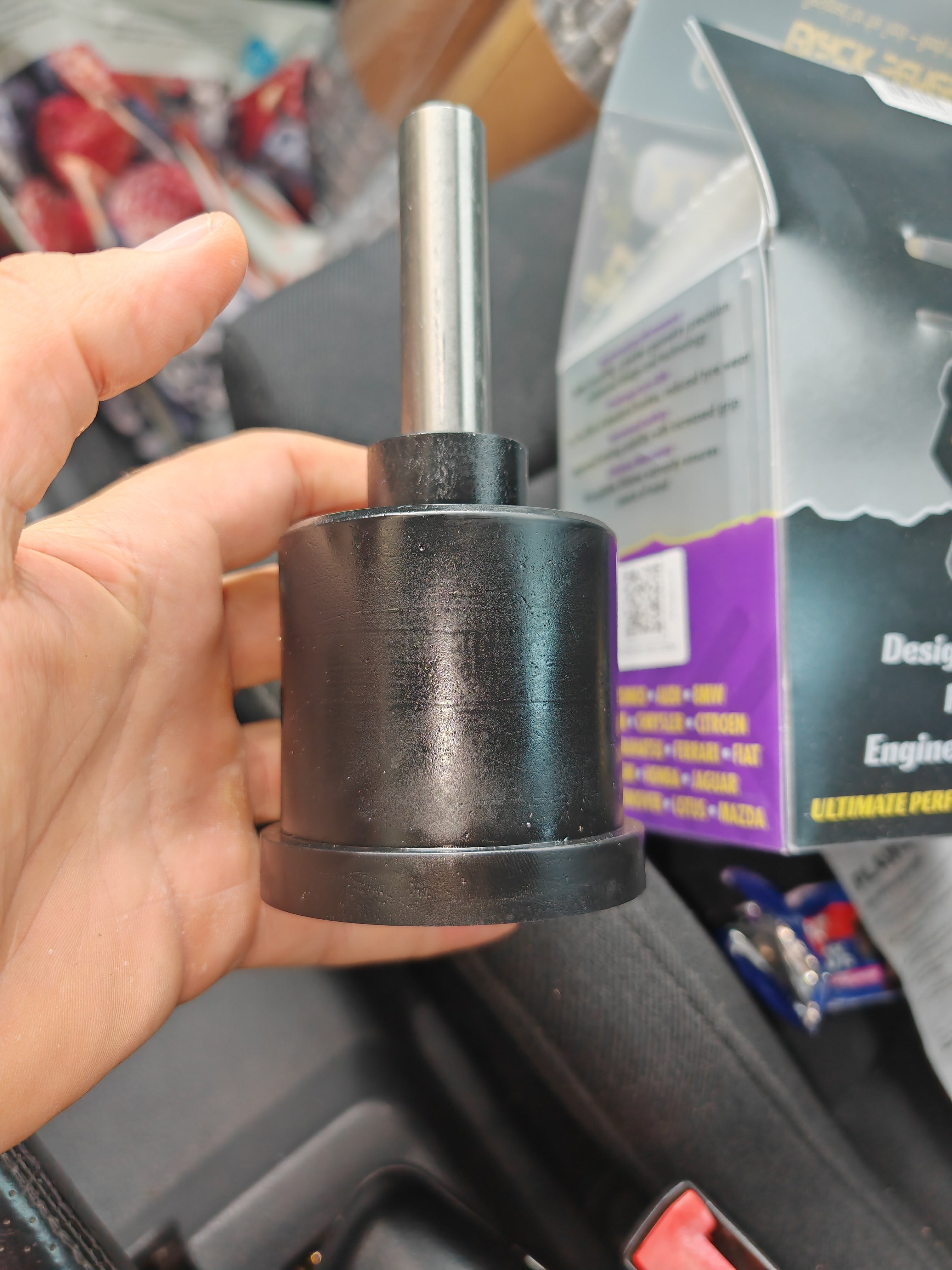

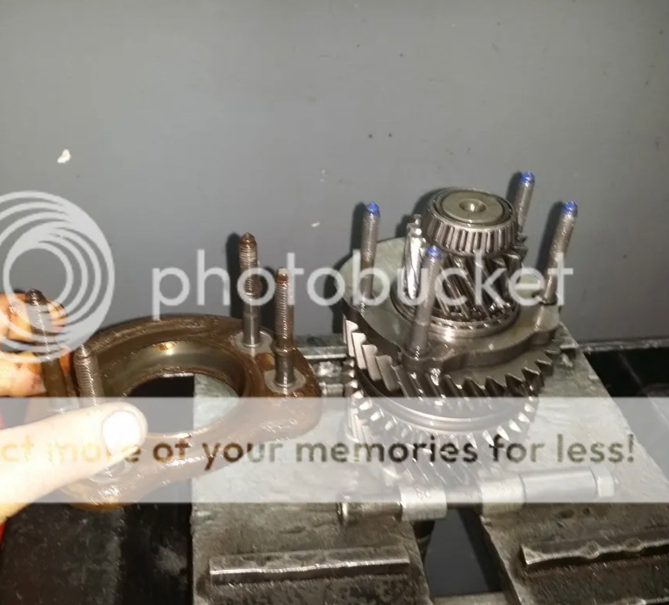

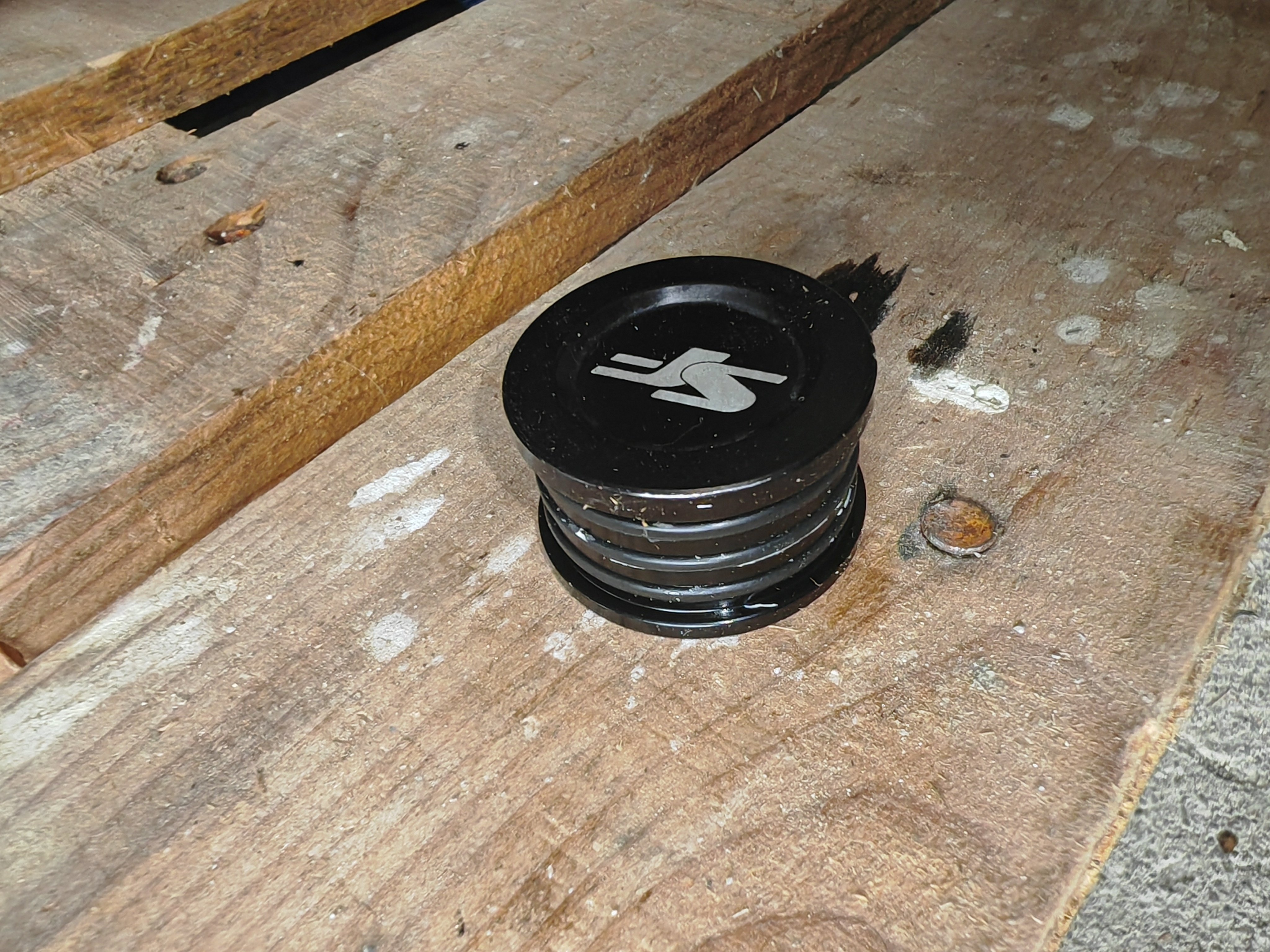

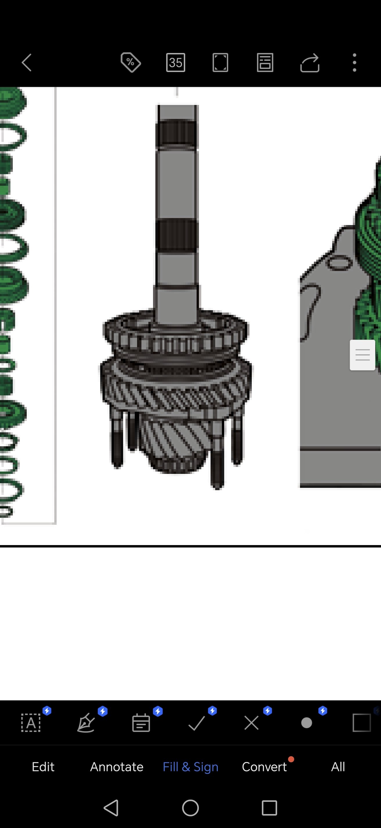

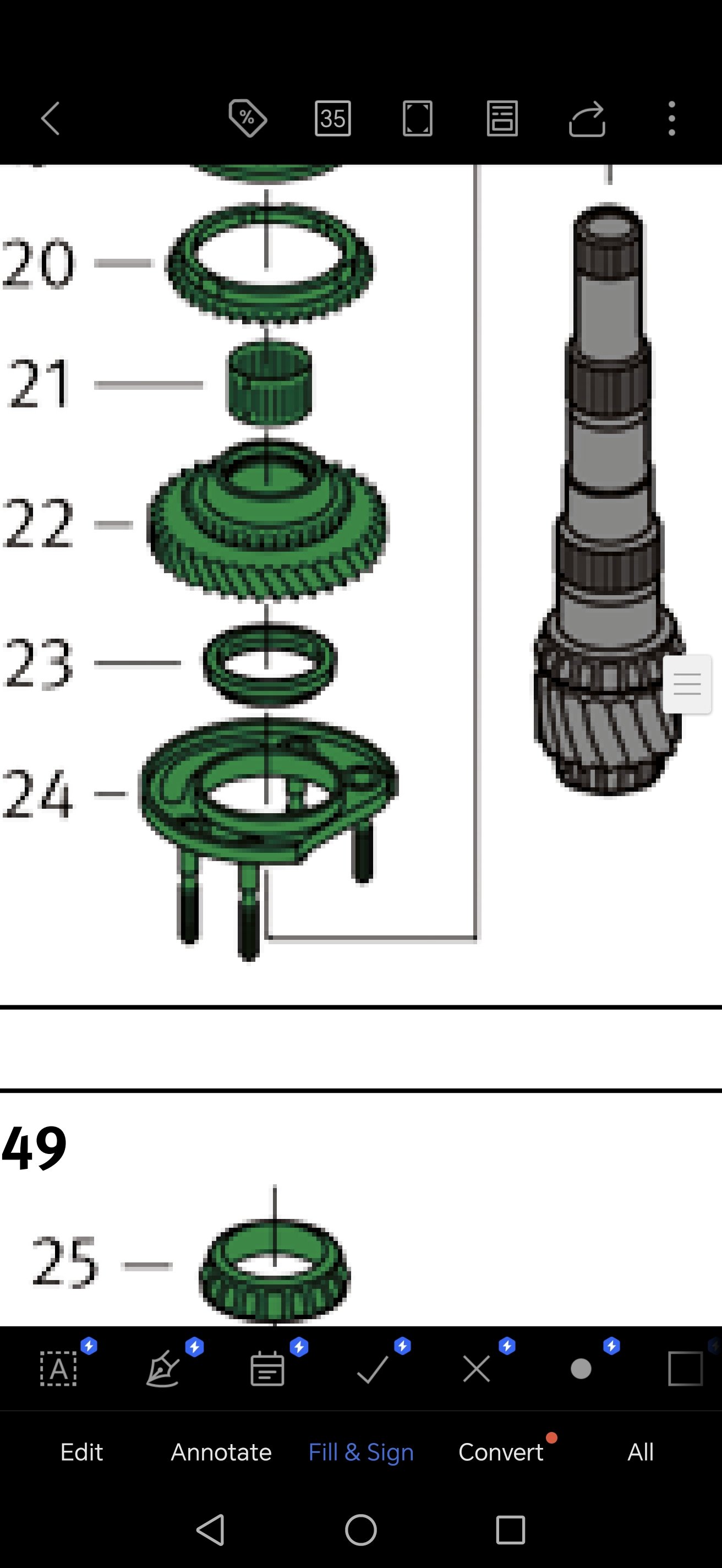

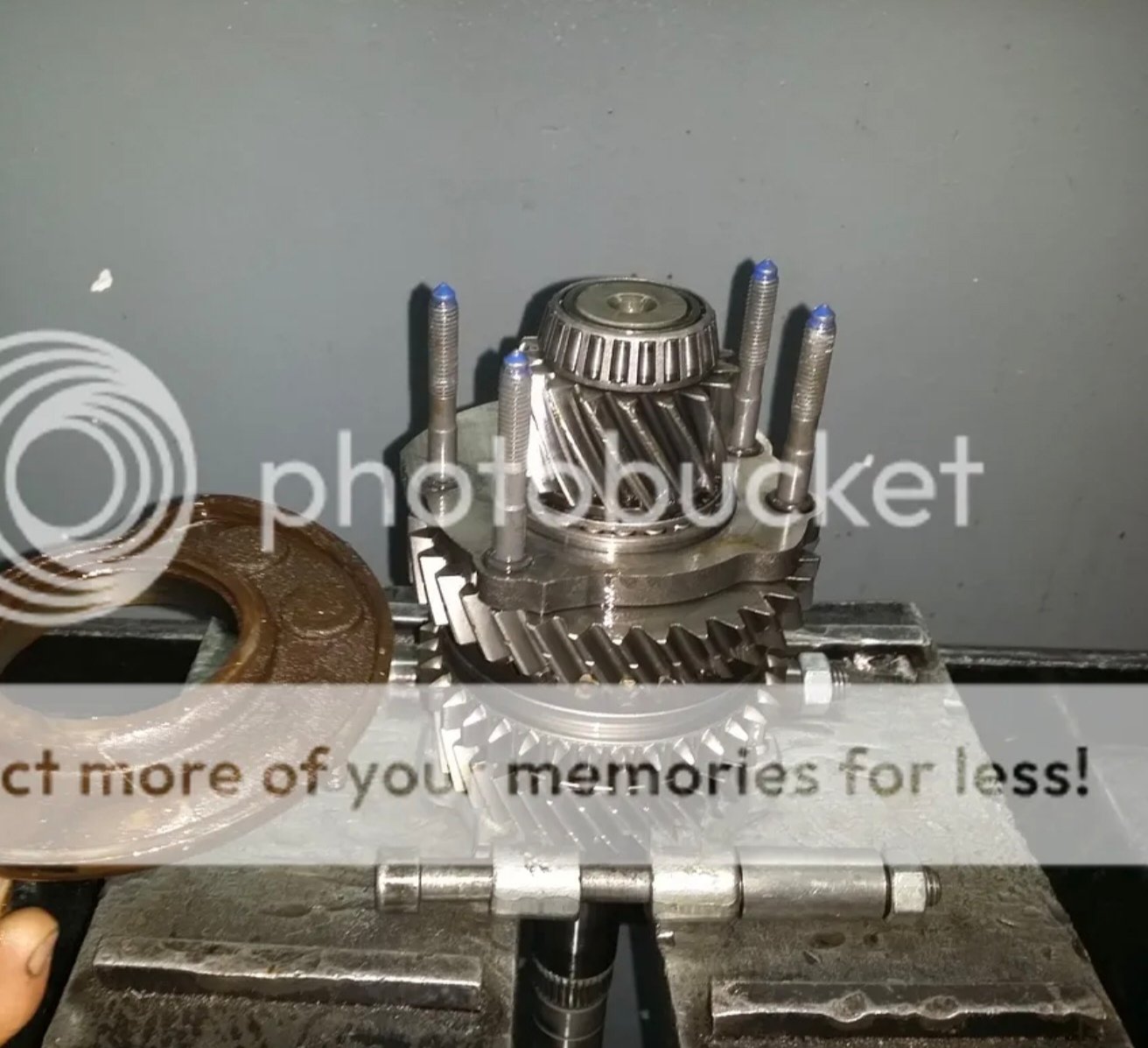

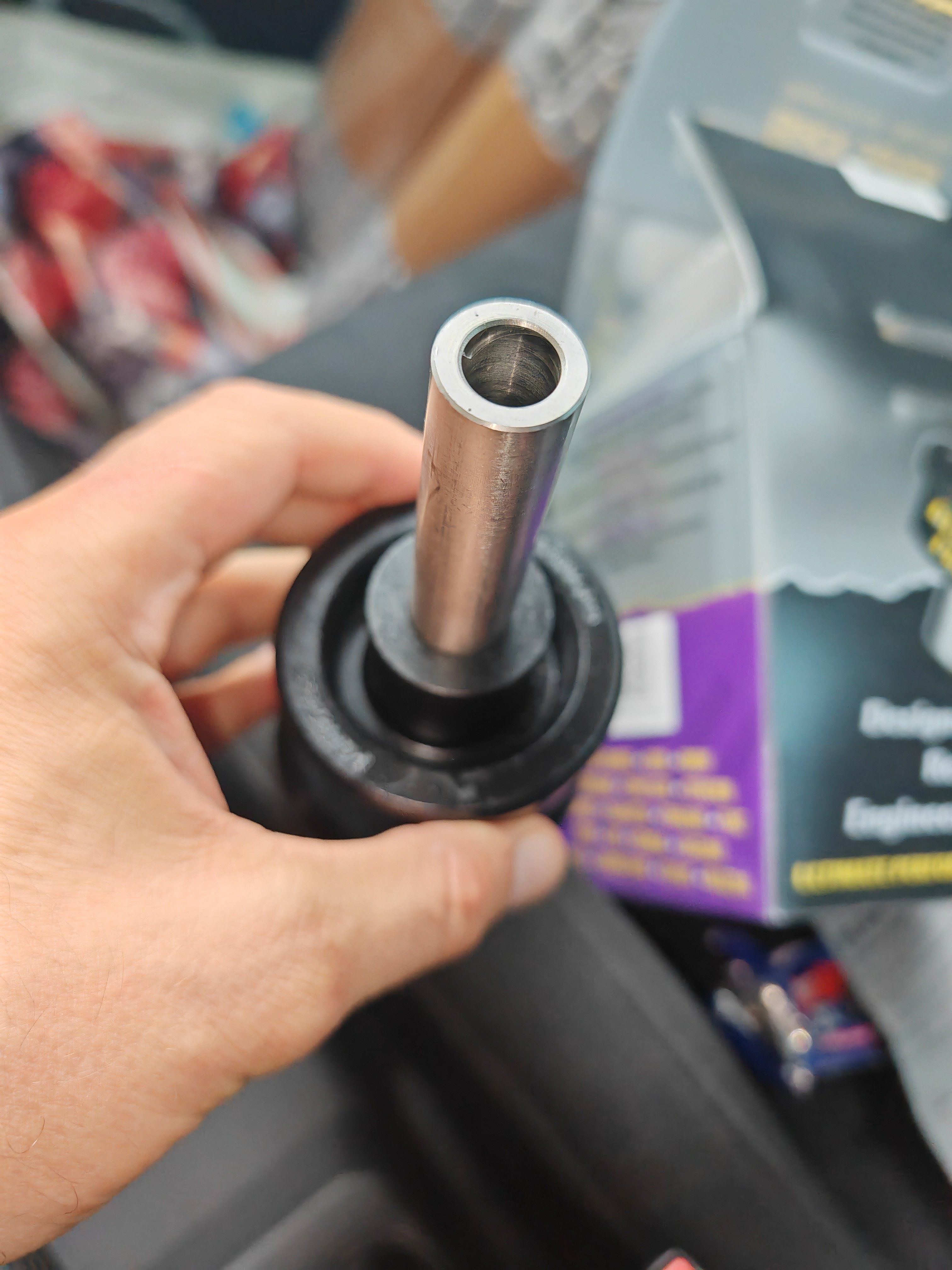

This one Will accept pinion Shaft brace nuts on whole thread lenght

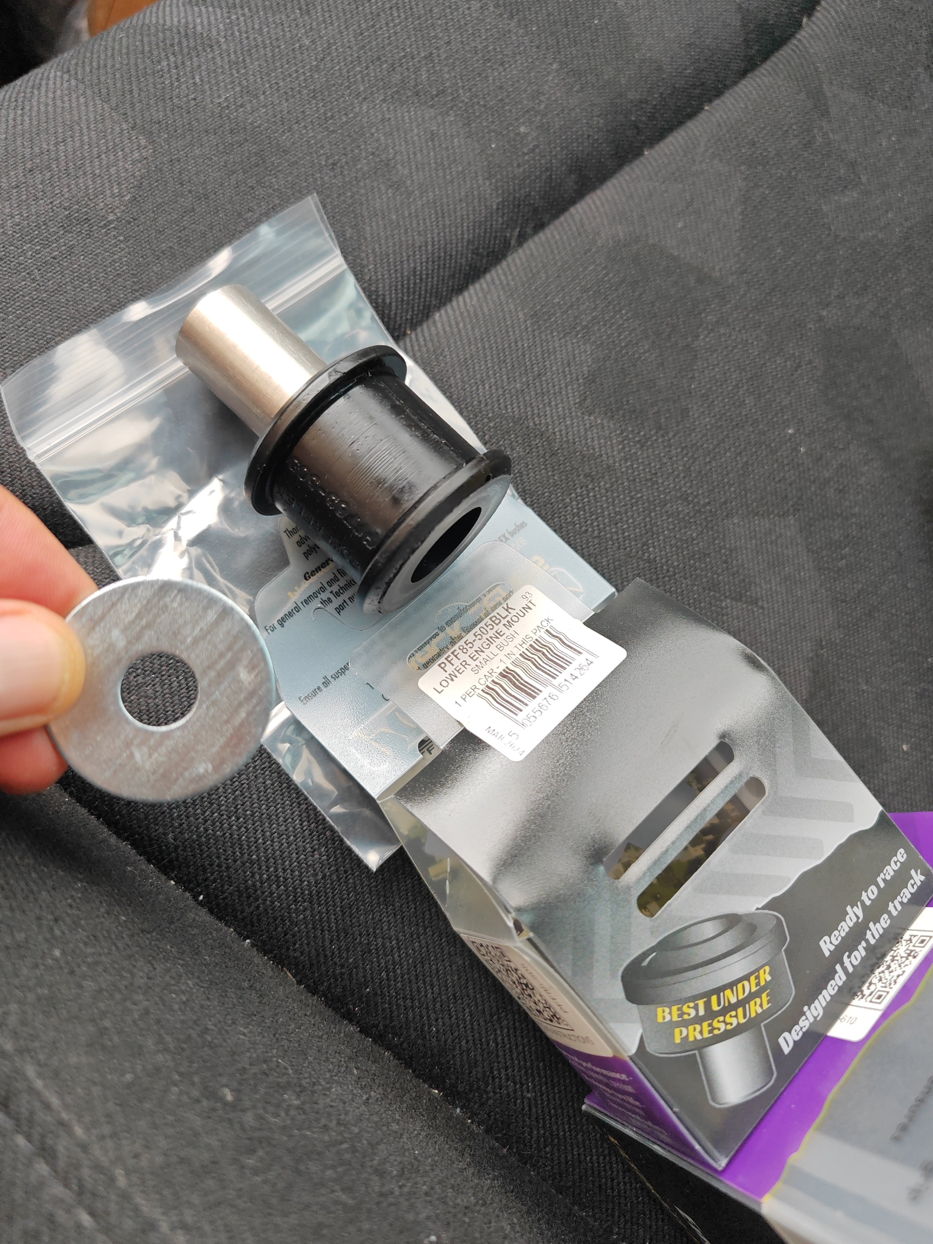

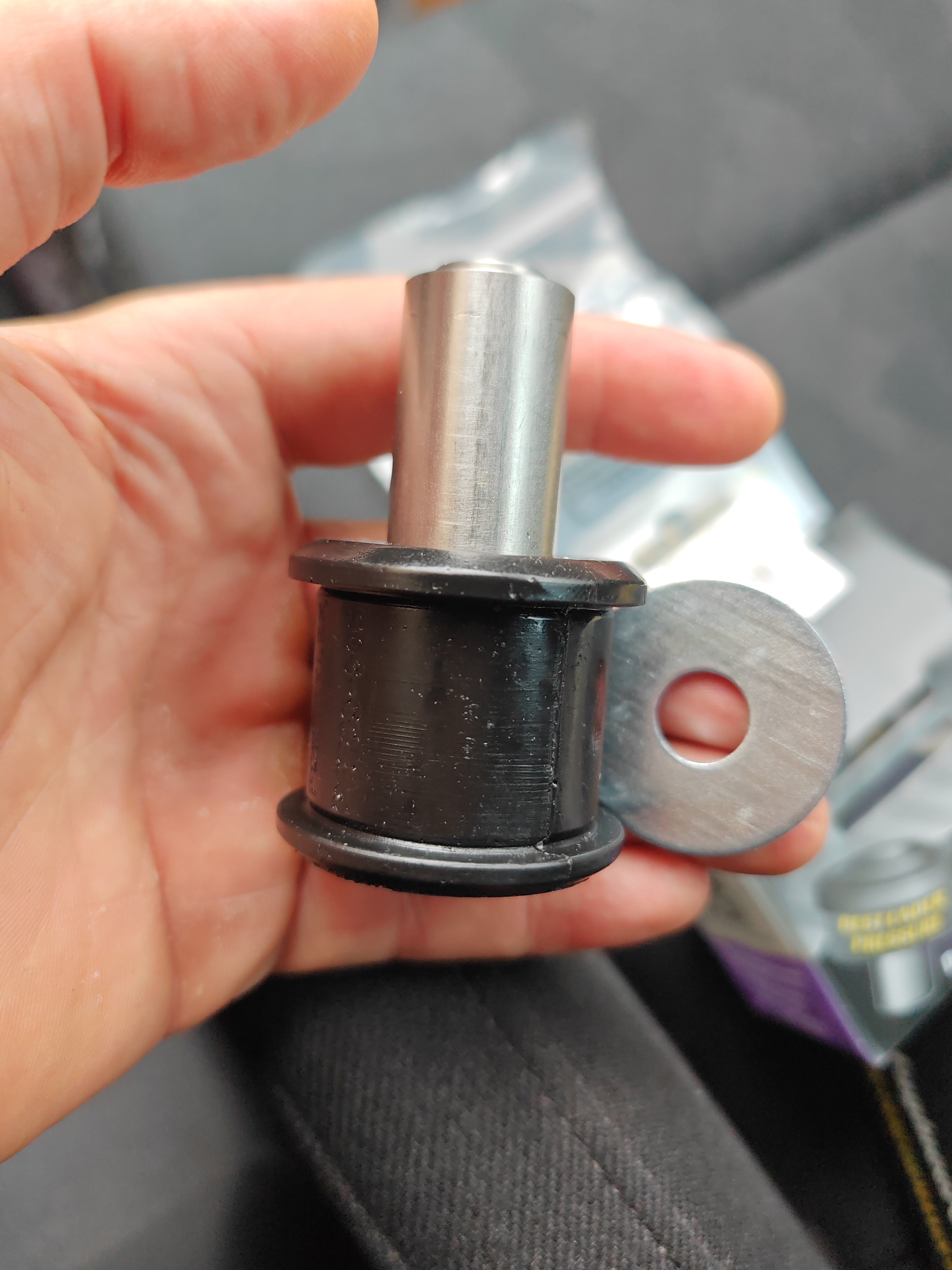

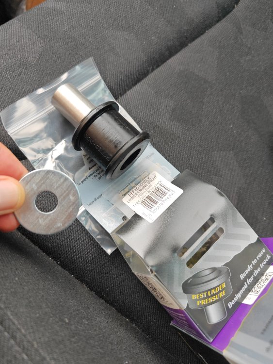

Picked up Powerflex black series rear Beam 69mm bushings and also black series  Dog bone small bushing. Had Powerflex Blue ones on the rear beammfor long time and they softened and SuperPrp small Dog bone bushing also deformed a little. Time for Black series
Edited by davojuri

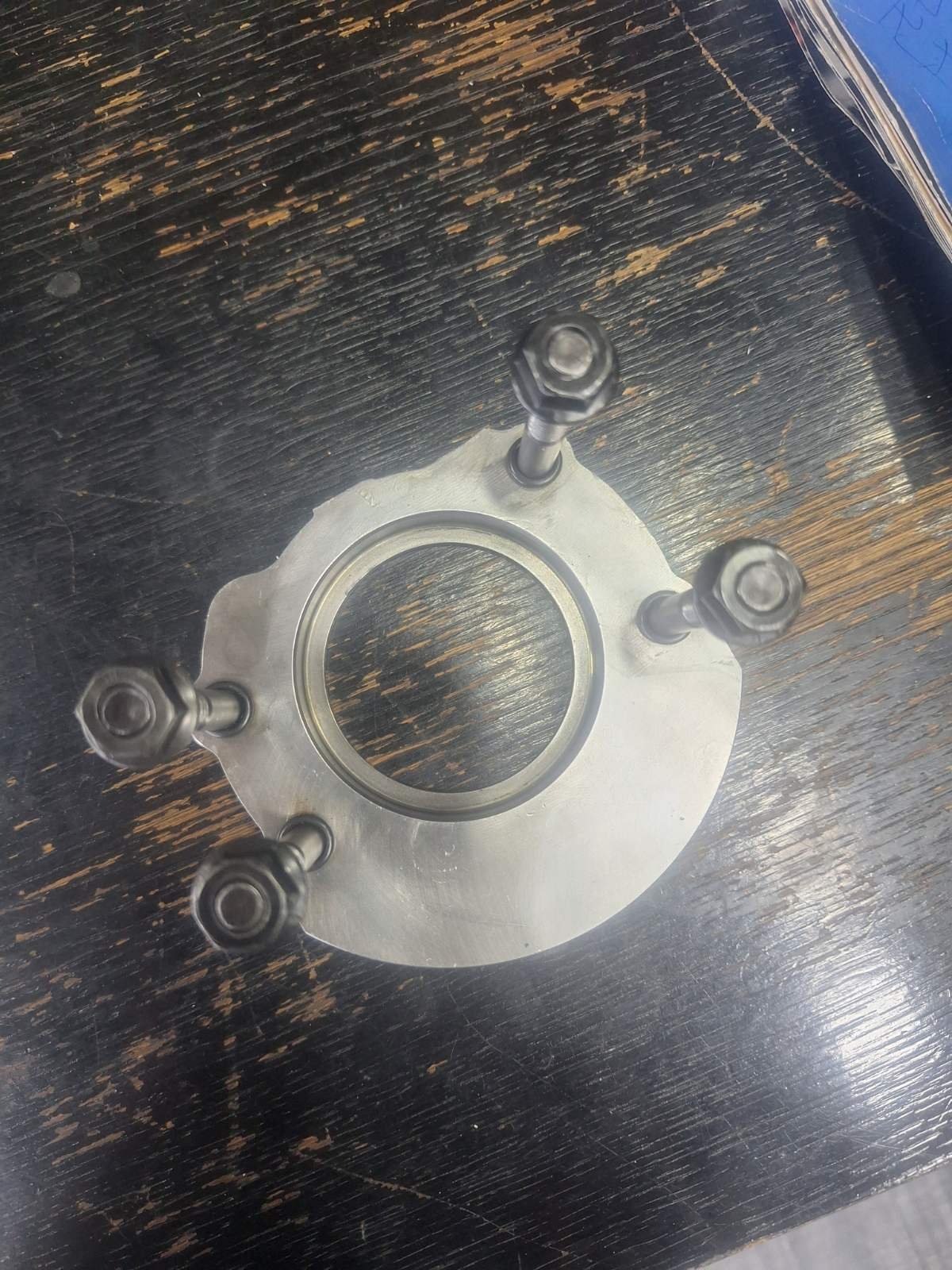

R8 coil adapter for AGN smooth valve cover finally chrome plated
bit nice that
2 hours ago, dubDEAN said:
bit nice that
Beside great look I look forward its function to, so coils do not pop out anymore, from time to time, causing missfire errors.
