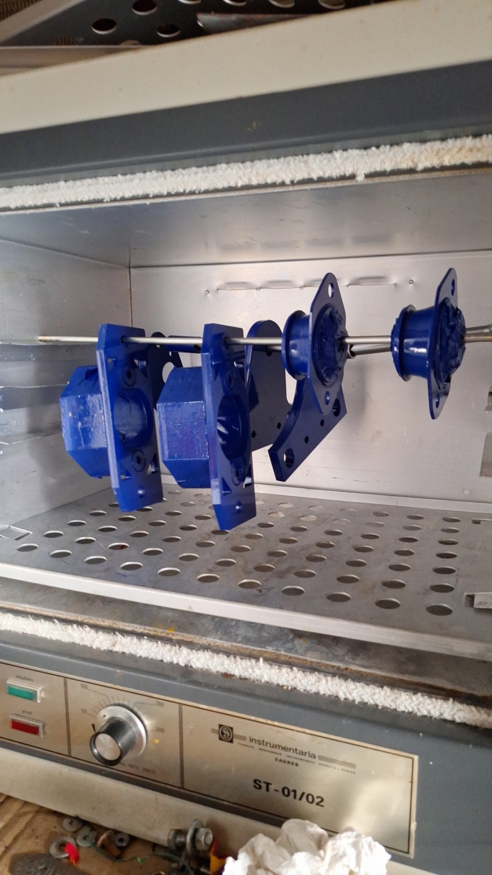

Mounts are Being painted in Blue to

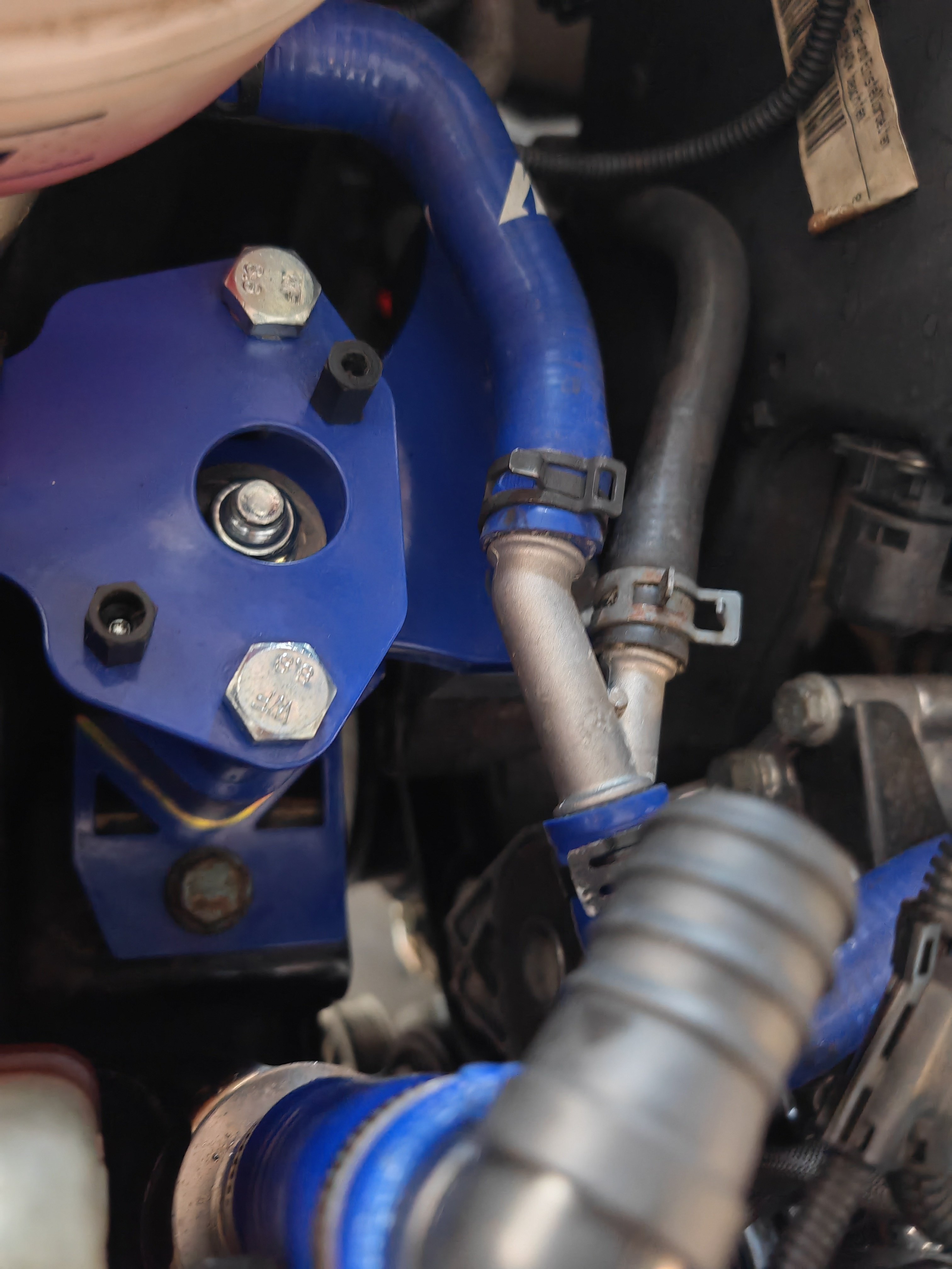

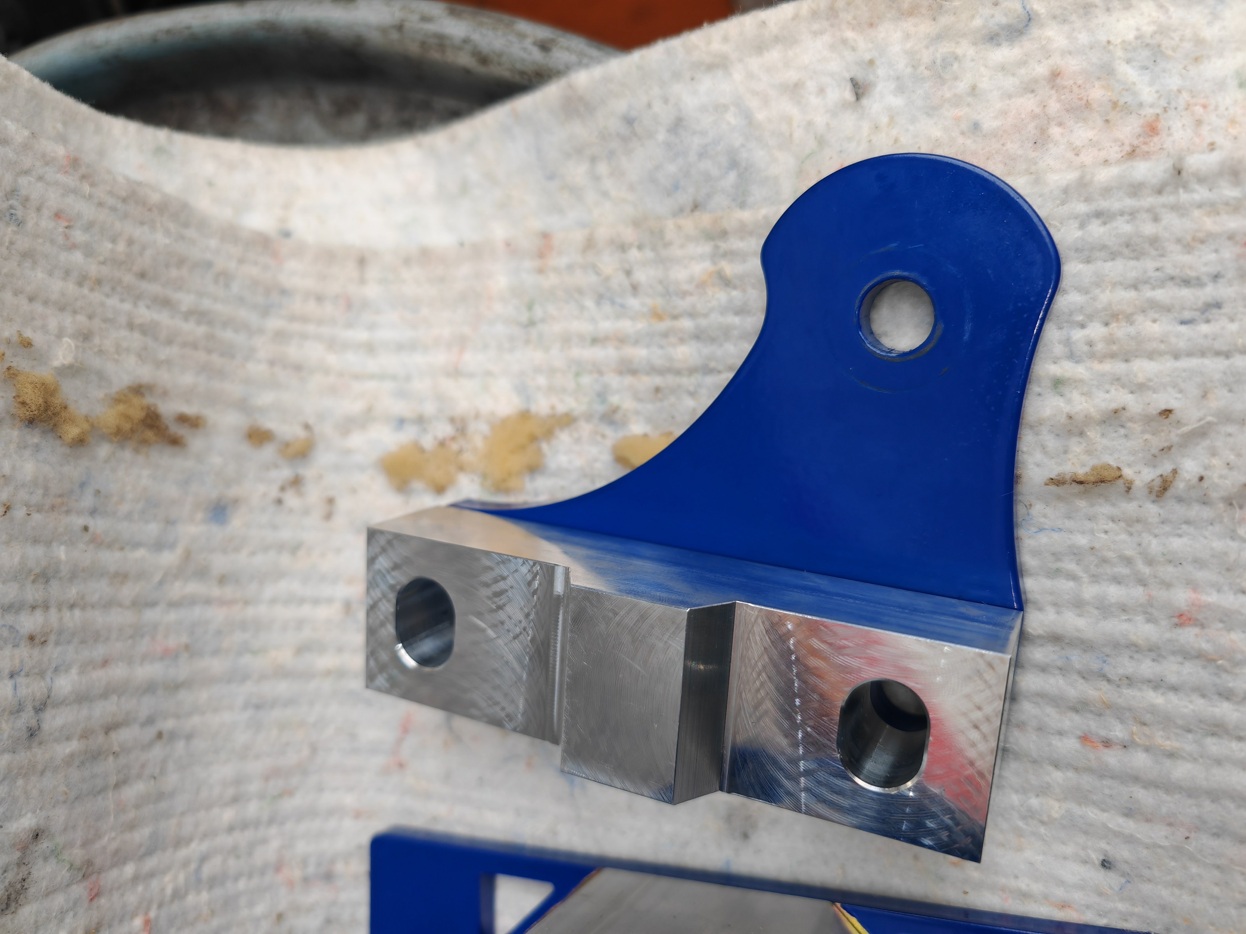

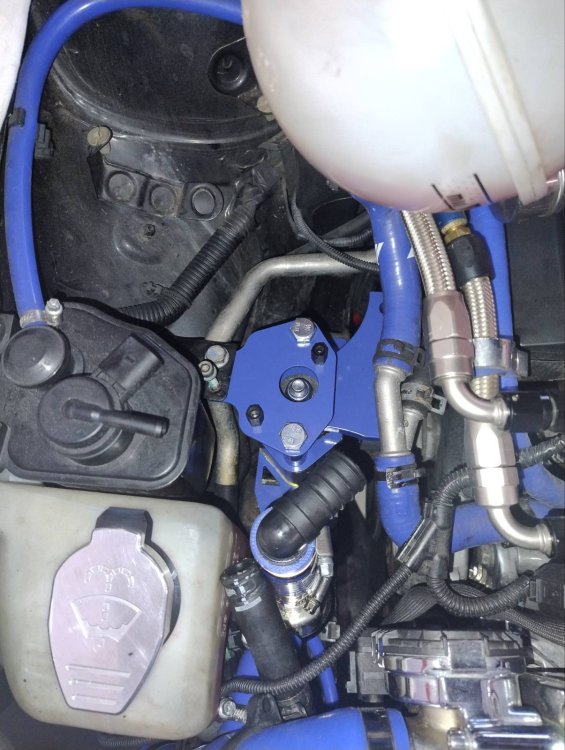

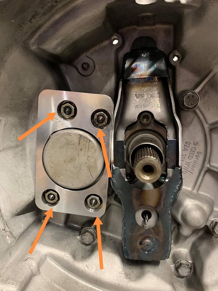

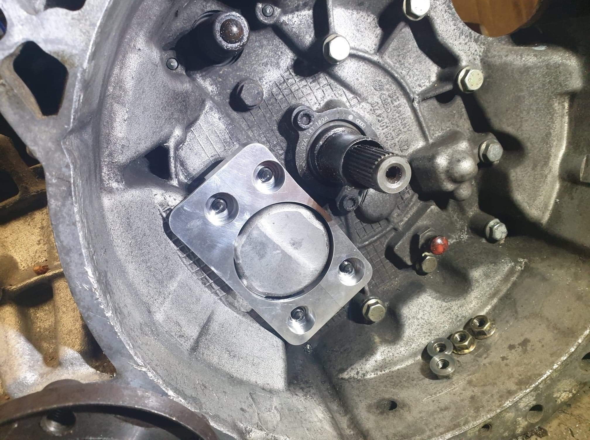

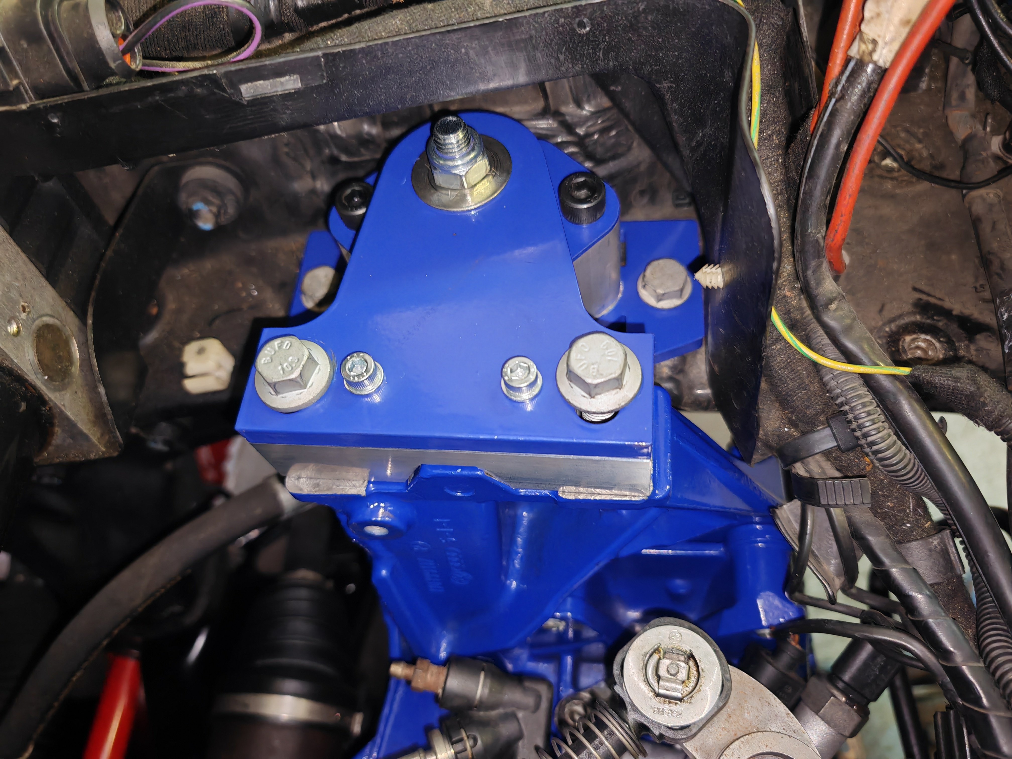

Regarding pinion shaft brace I decided not to put it on for now together with my mechanic. It could be fitted but guys it looses 3 or 4mm of Bolt thread, and holds less than half of nut threads  on, that's not the way to do stuff, maybe housing Will not break in this case but nuts will fly of that brace, do you agree?
DubDean can you provide us with your pics of brace please????
Edited by davojuri
This is bad tuning!!!
Talen from the shop website which sells them as a Holly gral. This is not proper installation because bolt thread didn't gone through the whole nut!

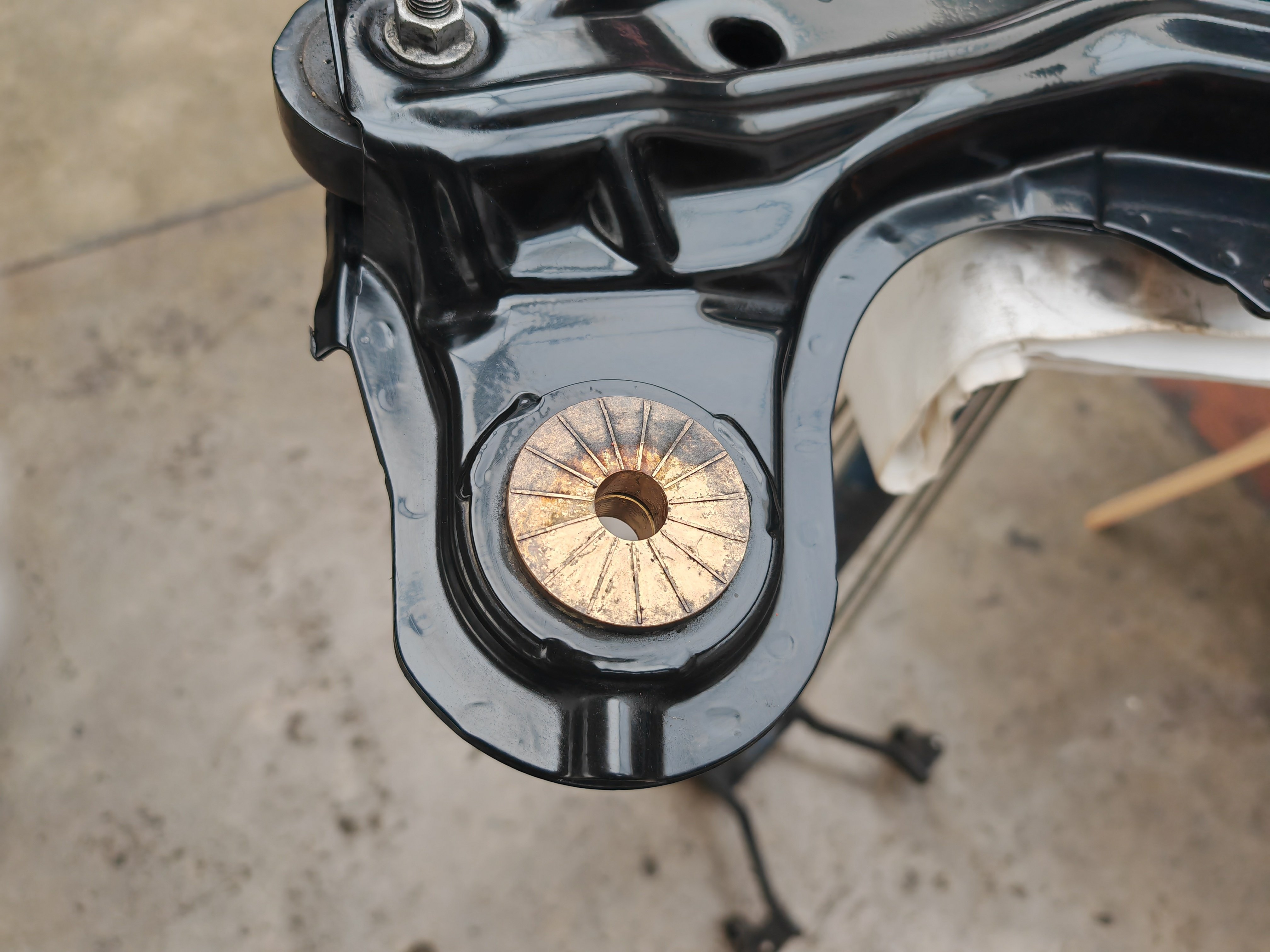

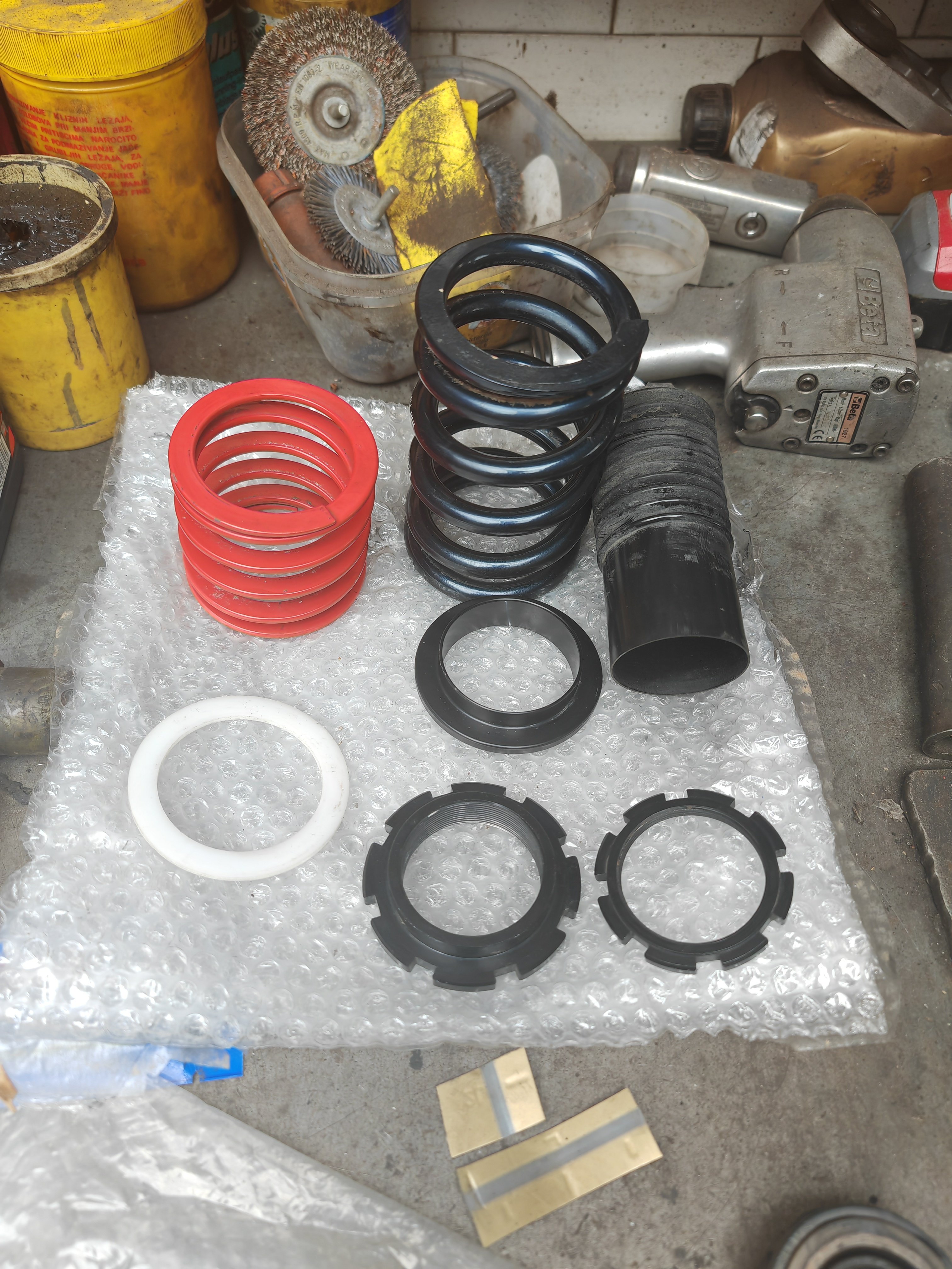

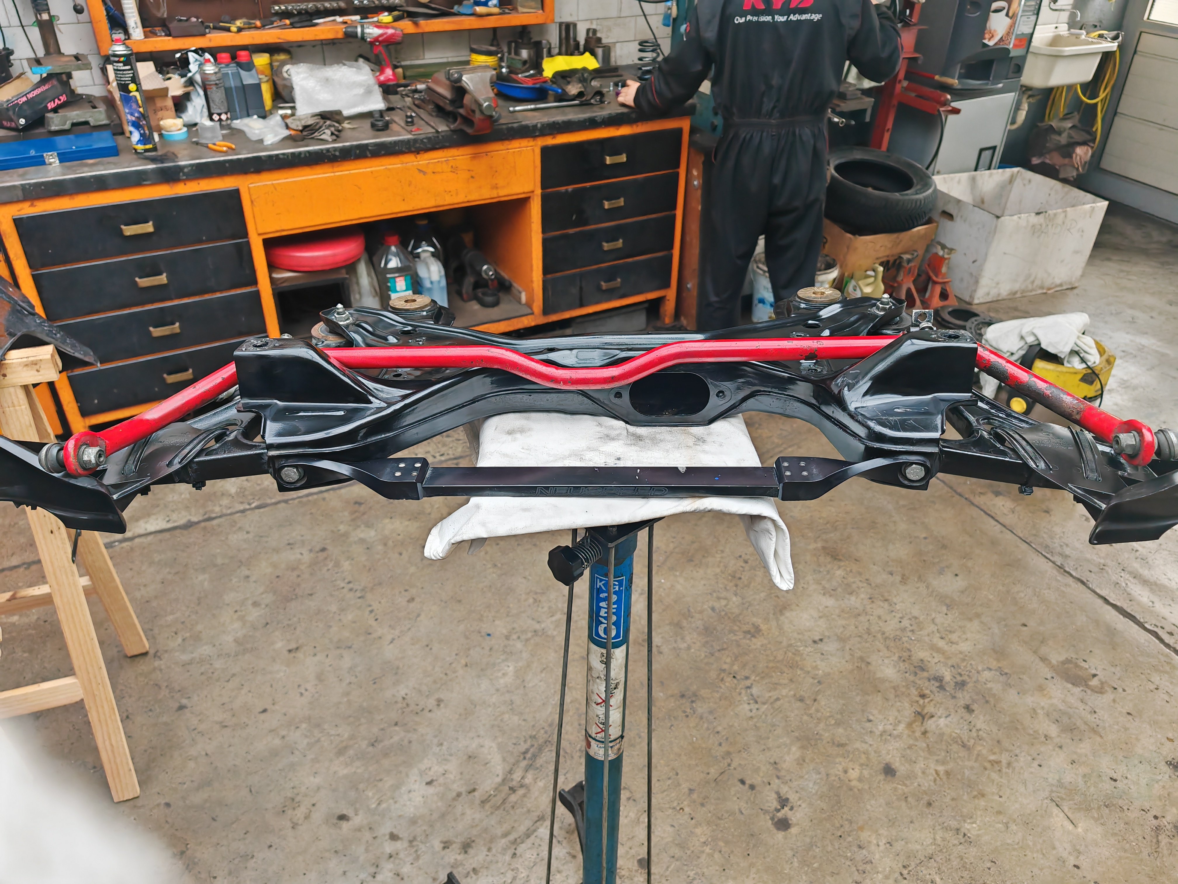

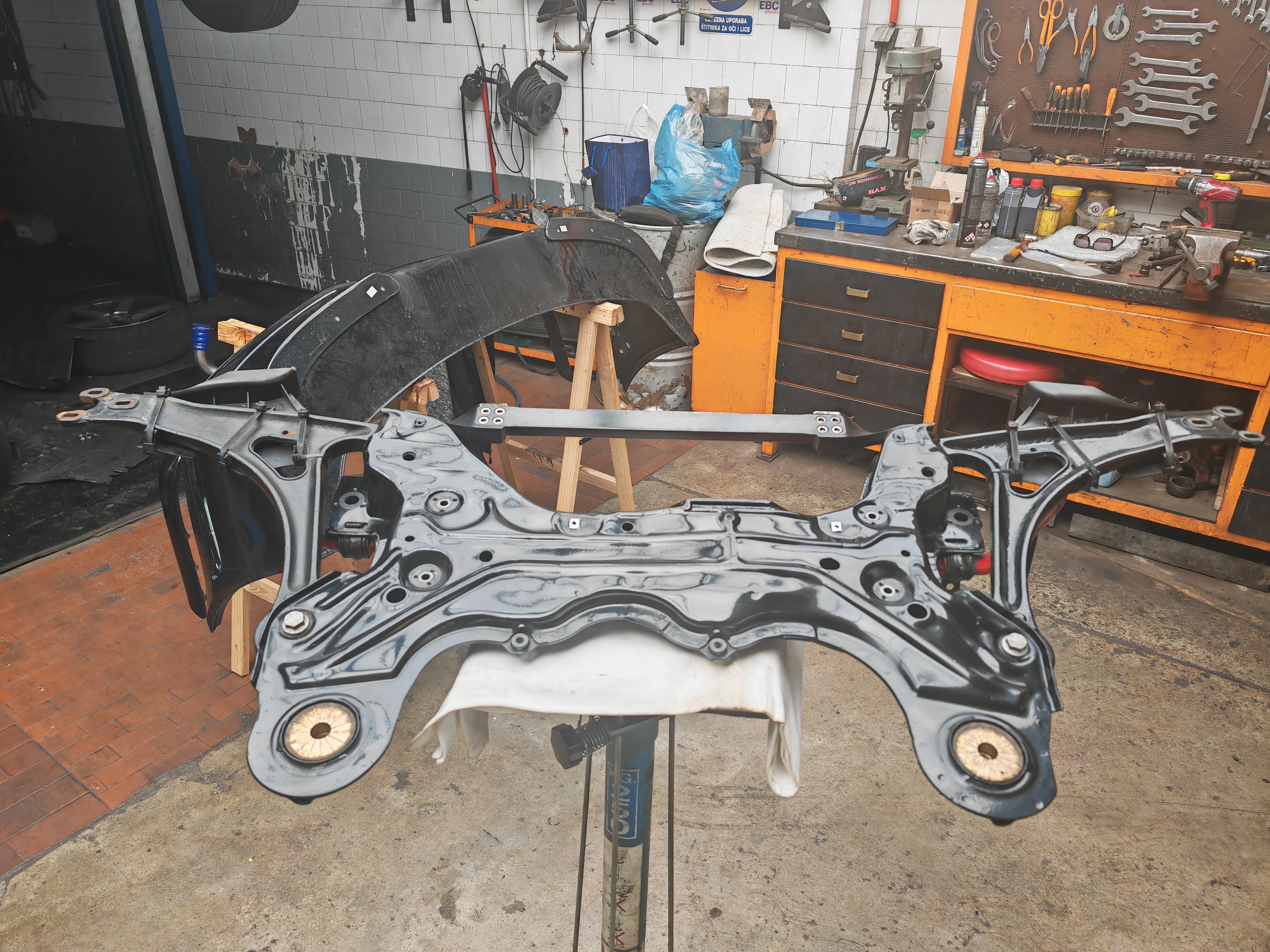

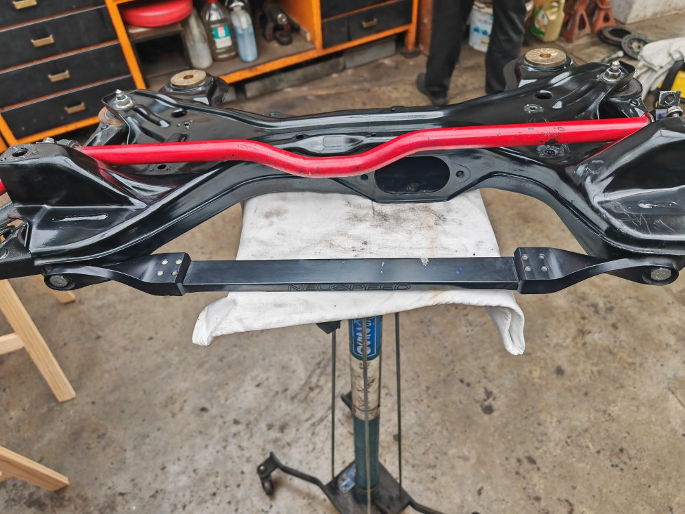

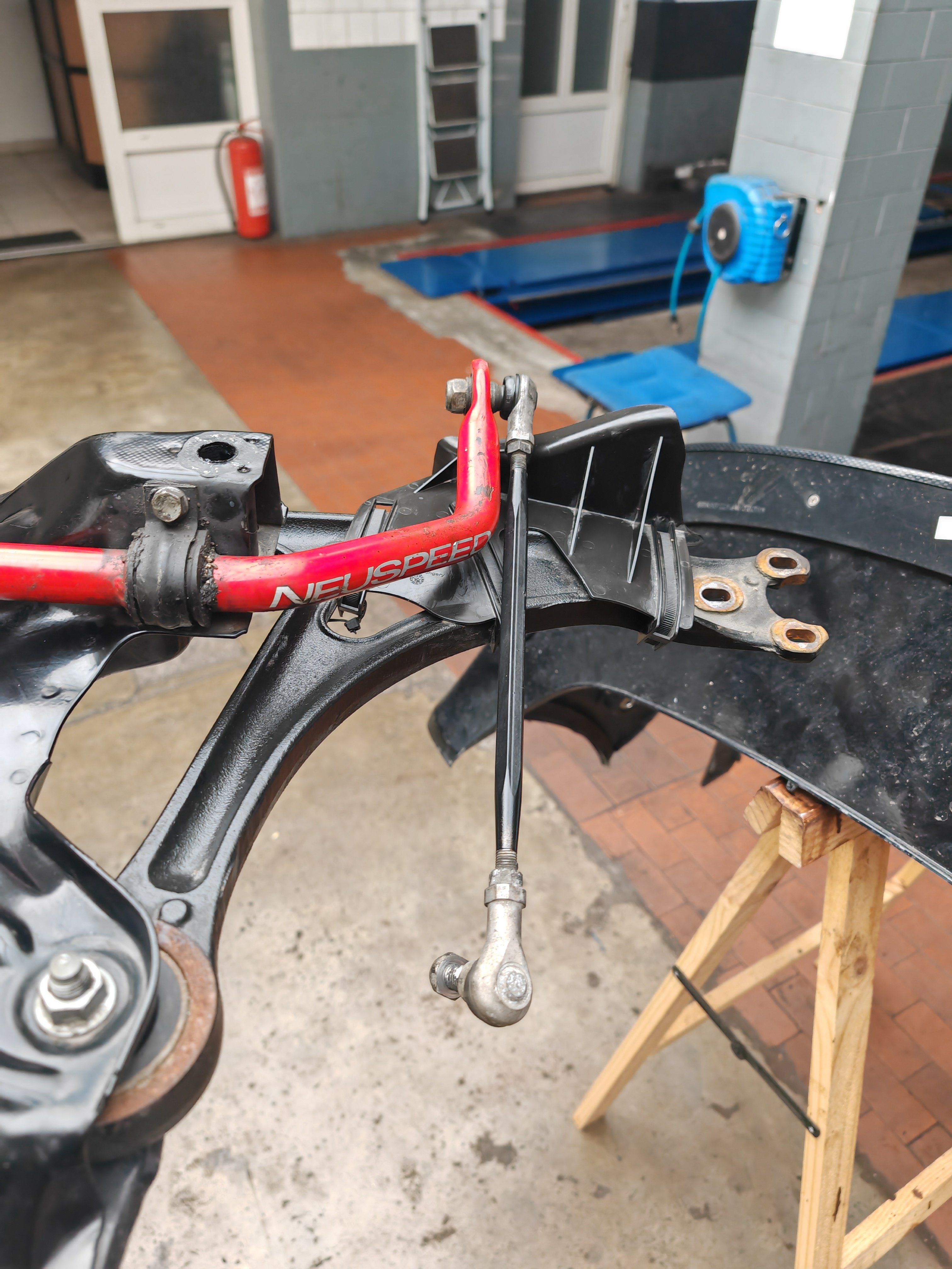

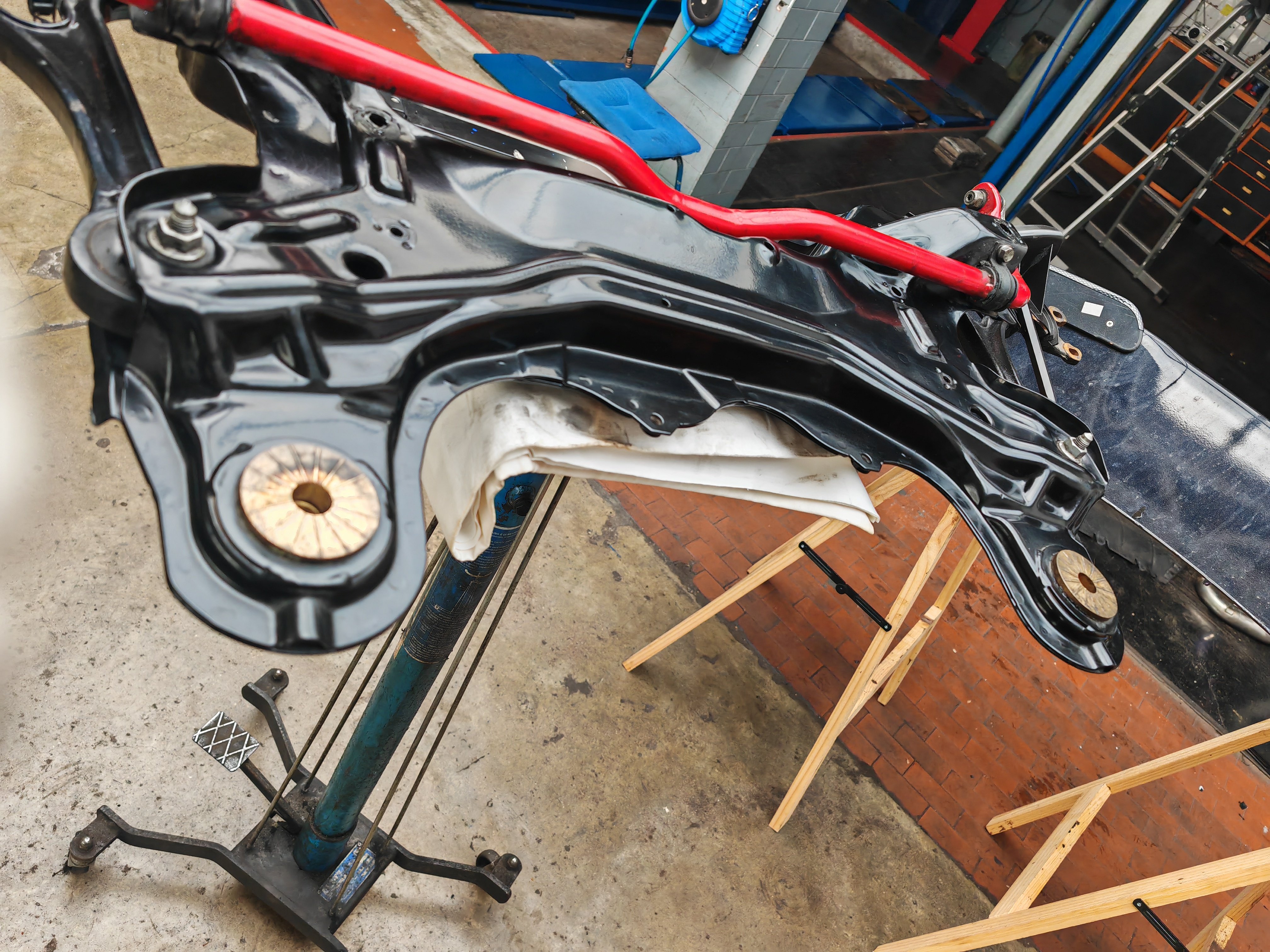

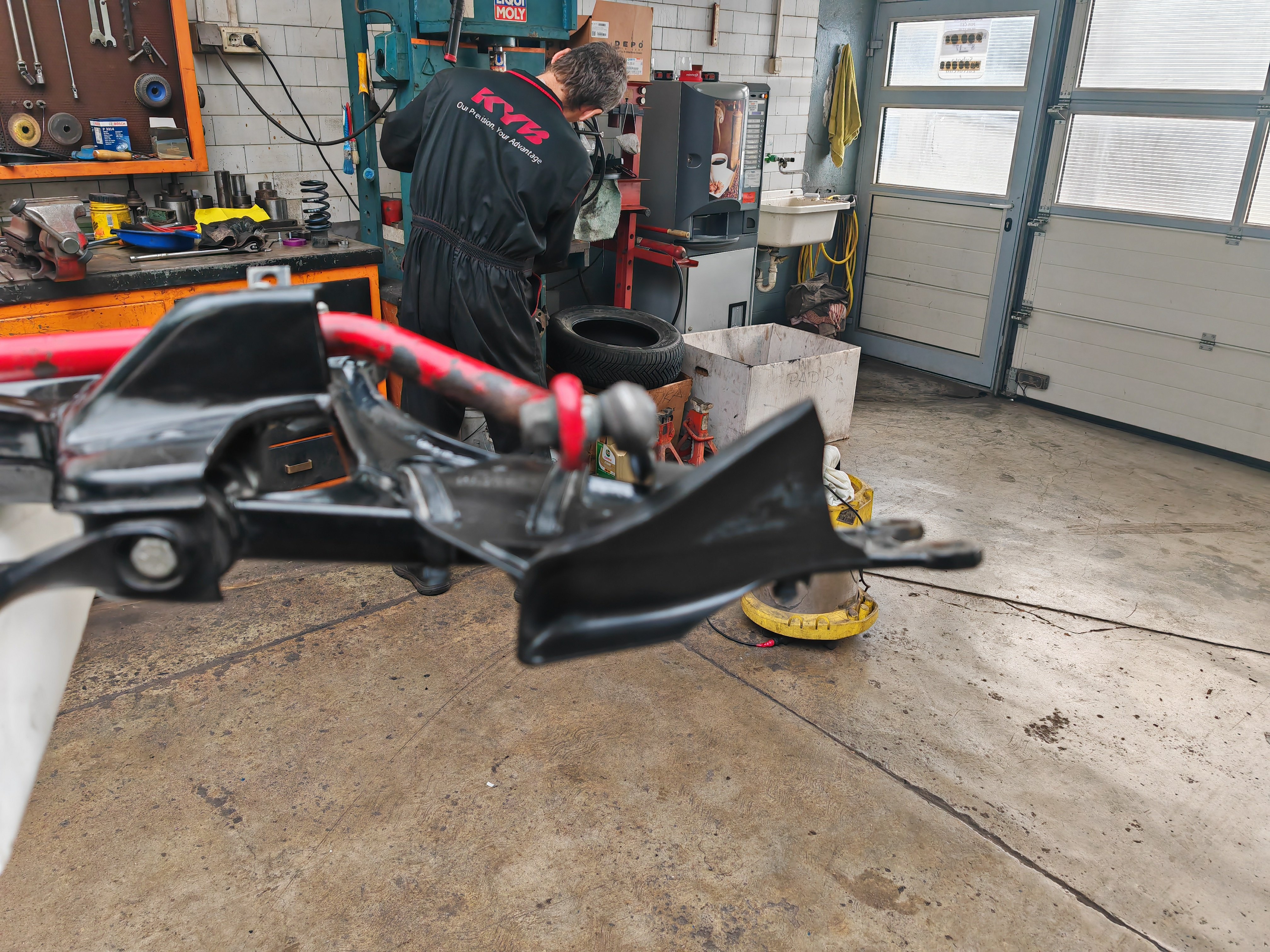

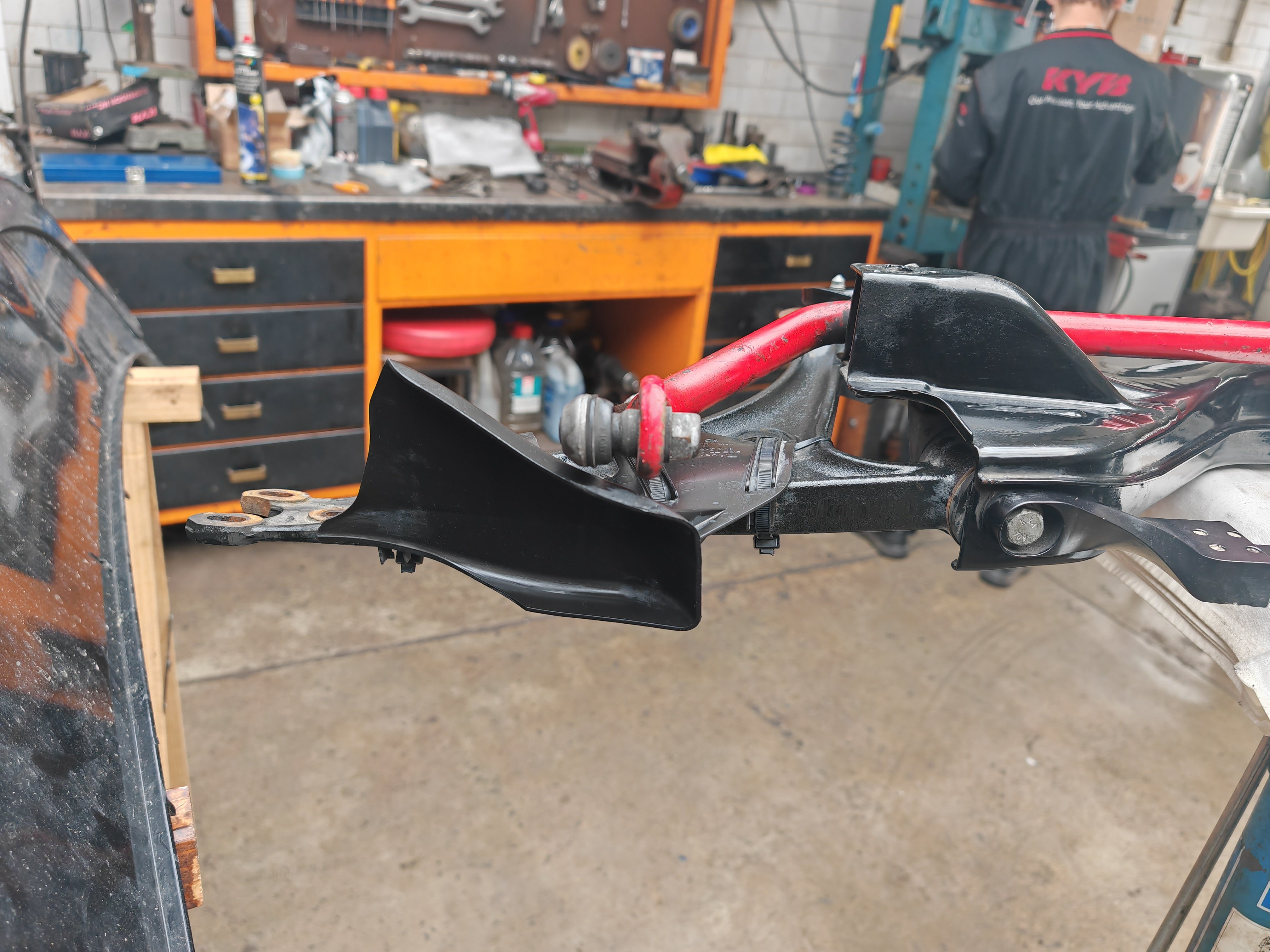

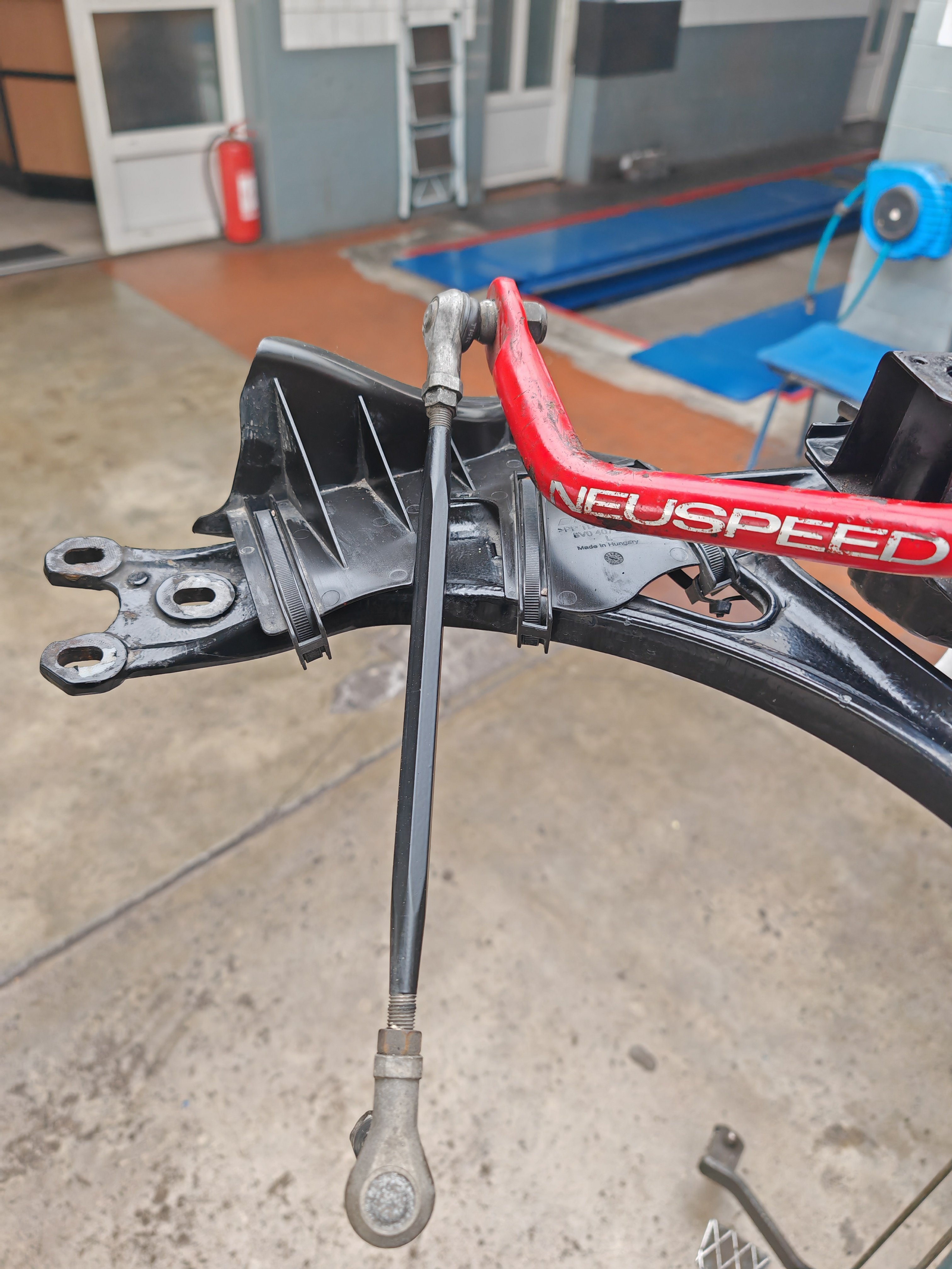

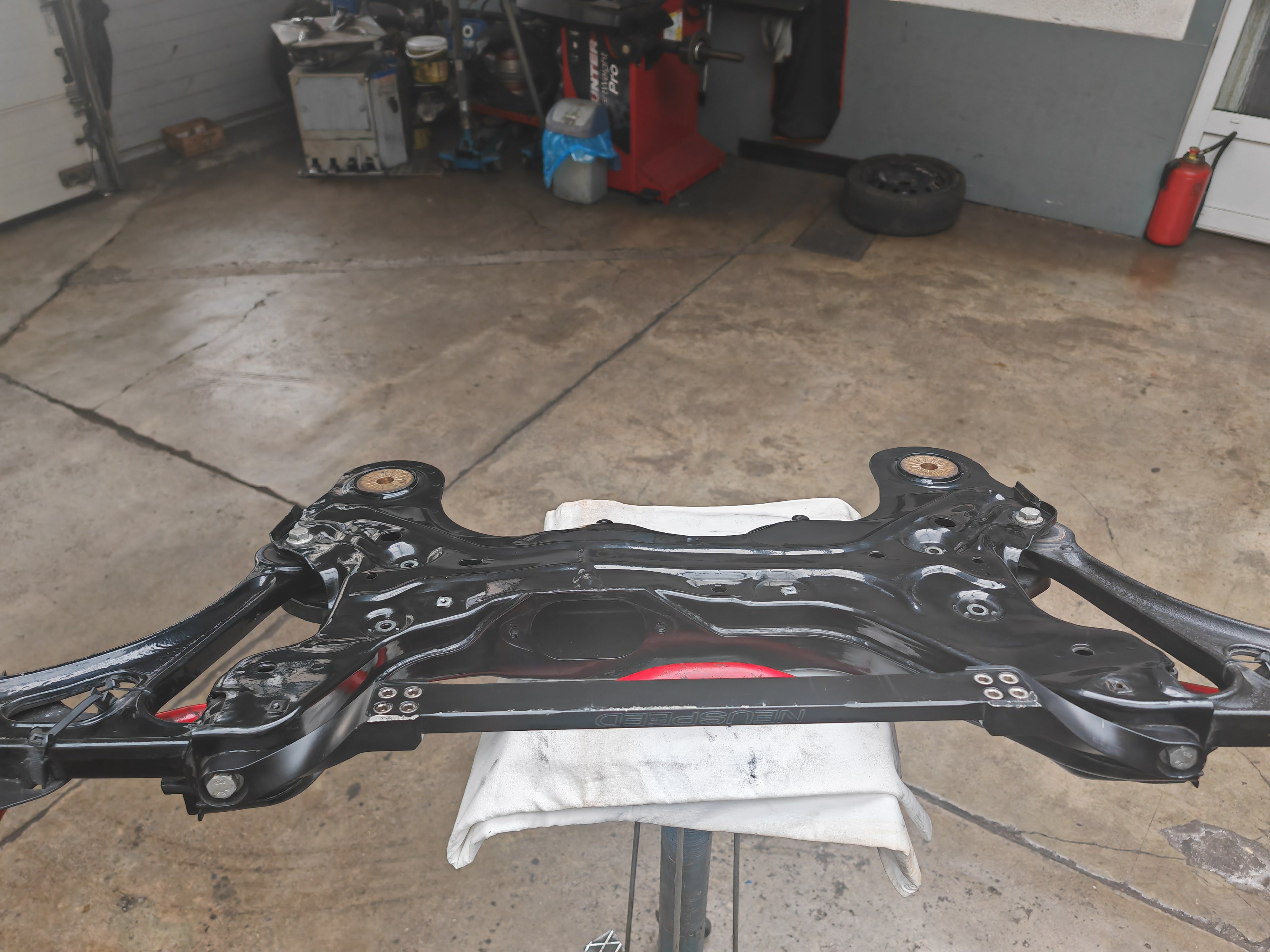

Had time to clean my powdercoated subframe with 42DD solid mounts,Neuspeed tie bar and sway bar, TT LCAs, brake ducts from TTRS, and custom made shorter tie rod from 7075 aluninium, HR RSS clubsport coils with New KW top mounts. Hope to get rod od that doing doing sound from old Ground Control while turning the wheel.

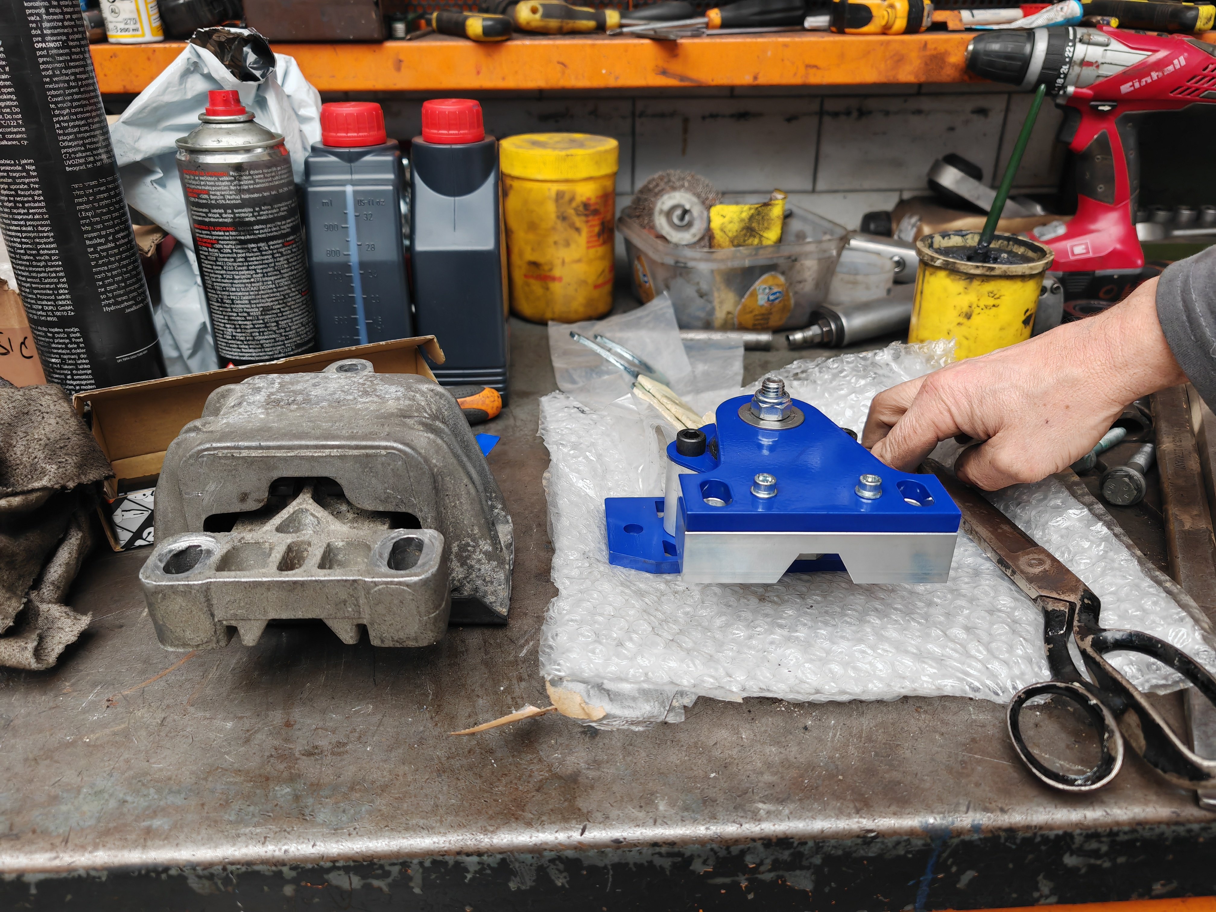

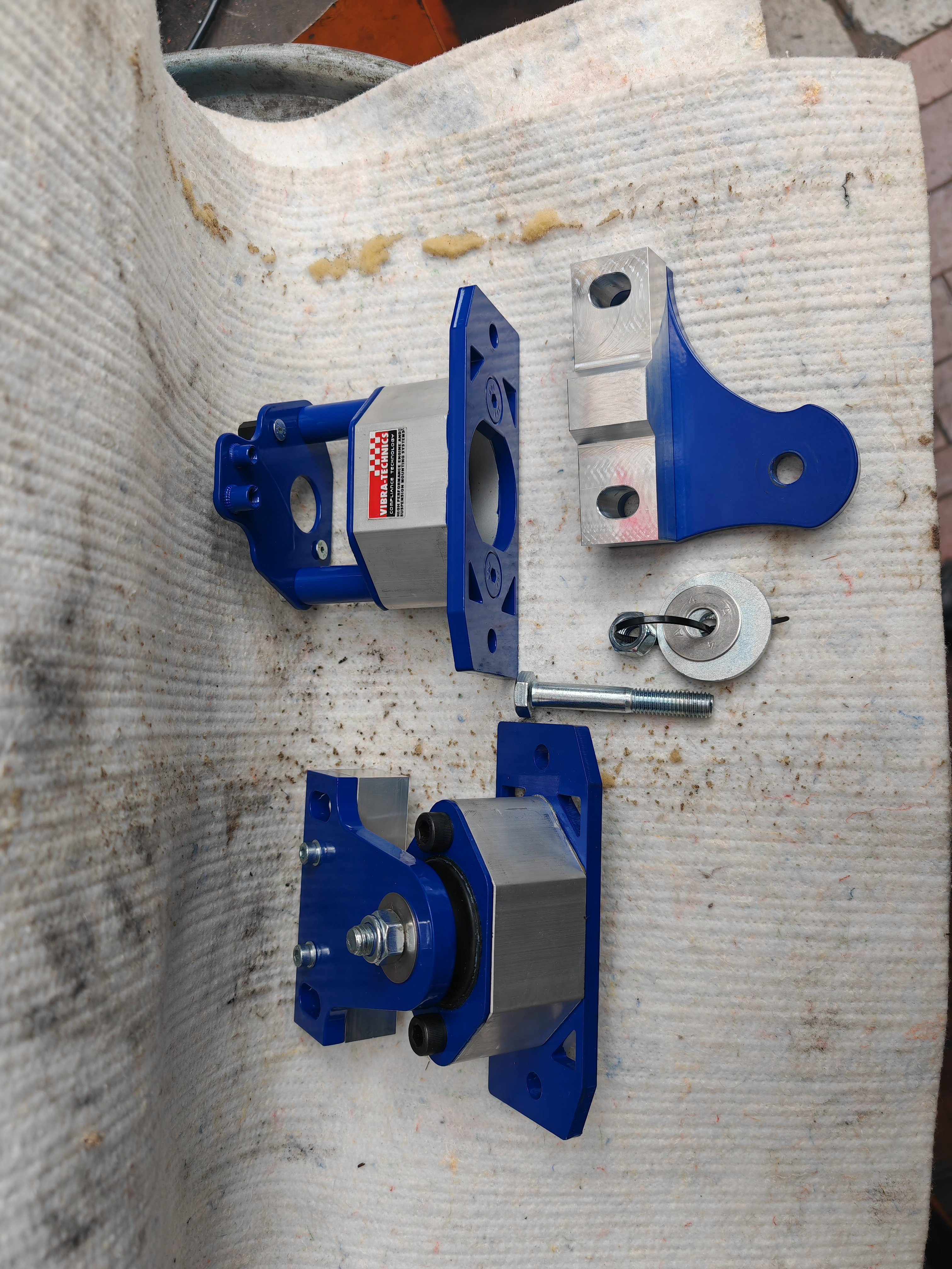

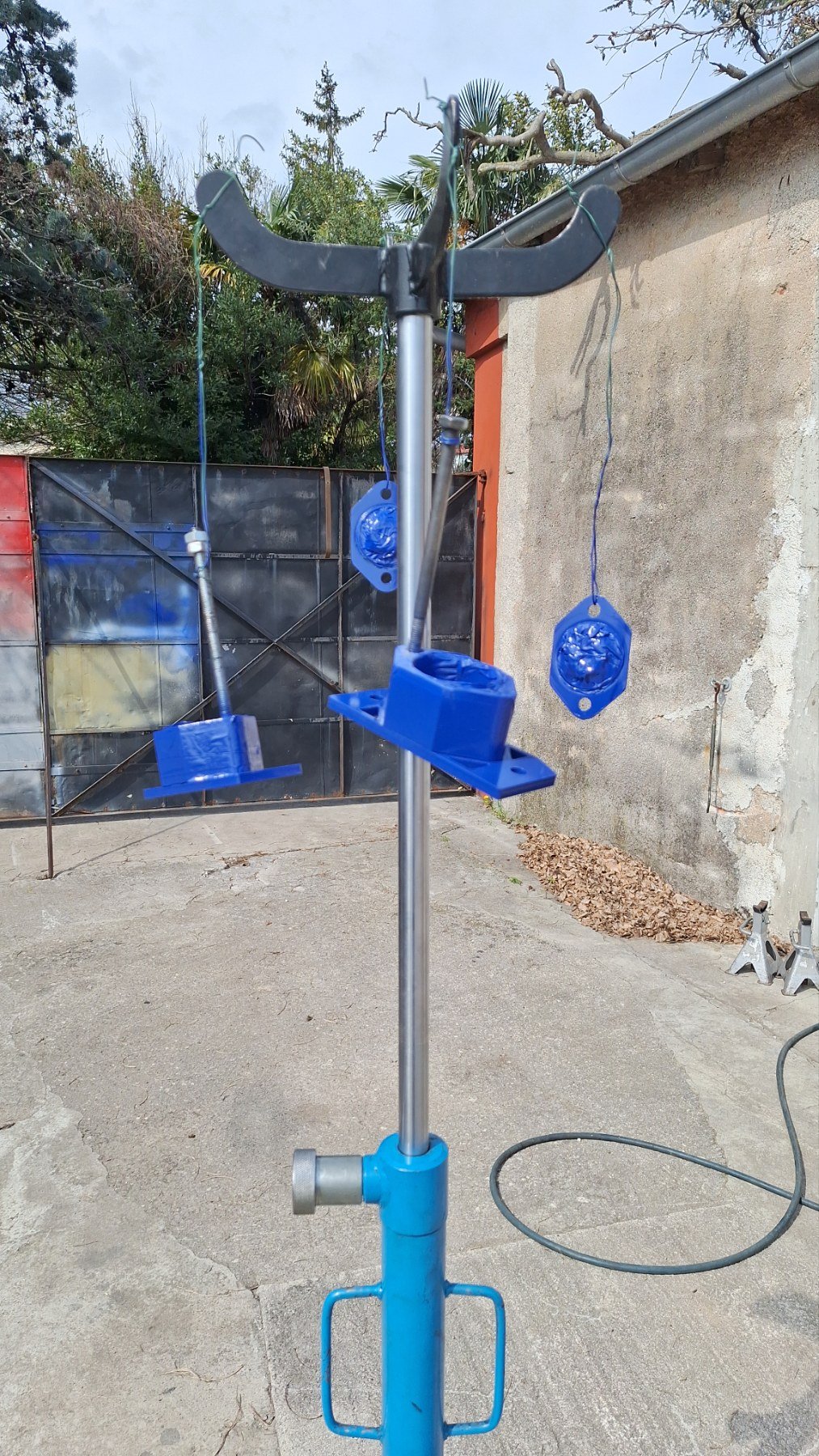

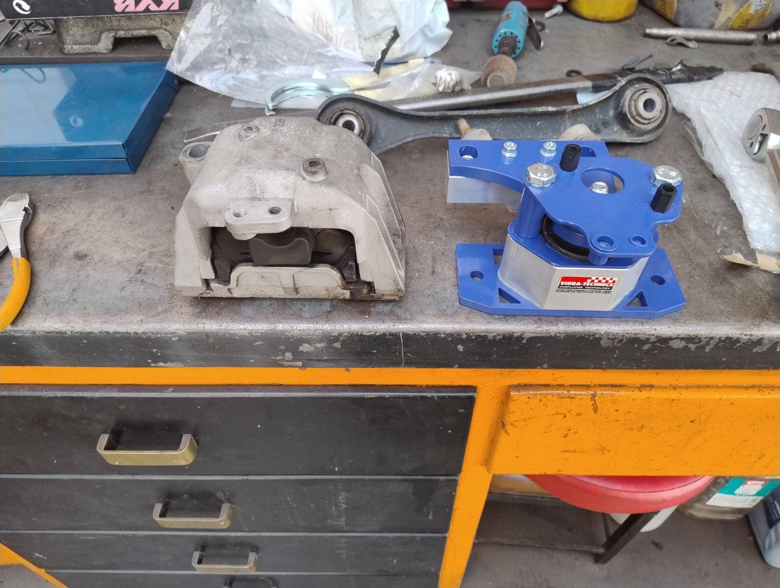

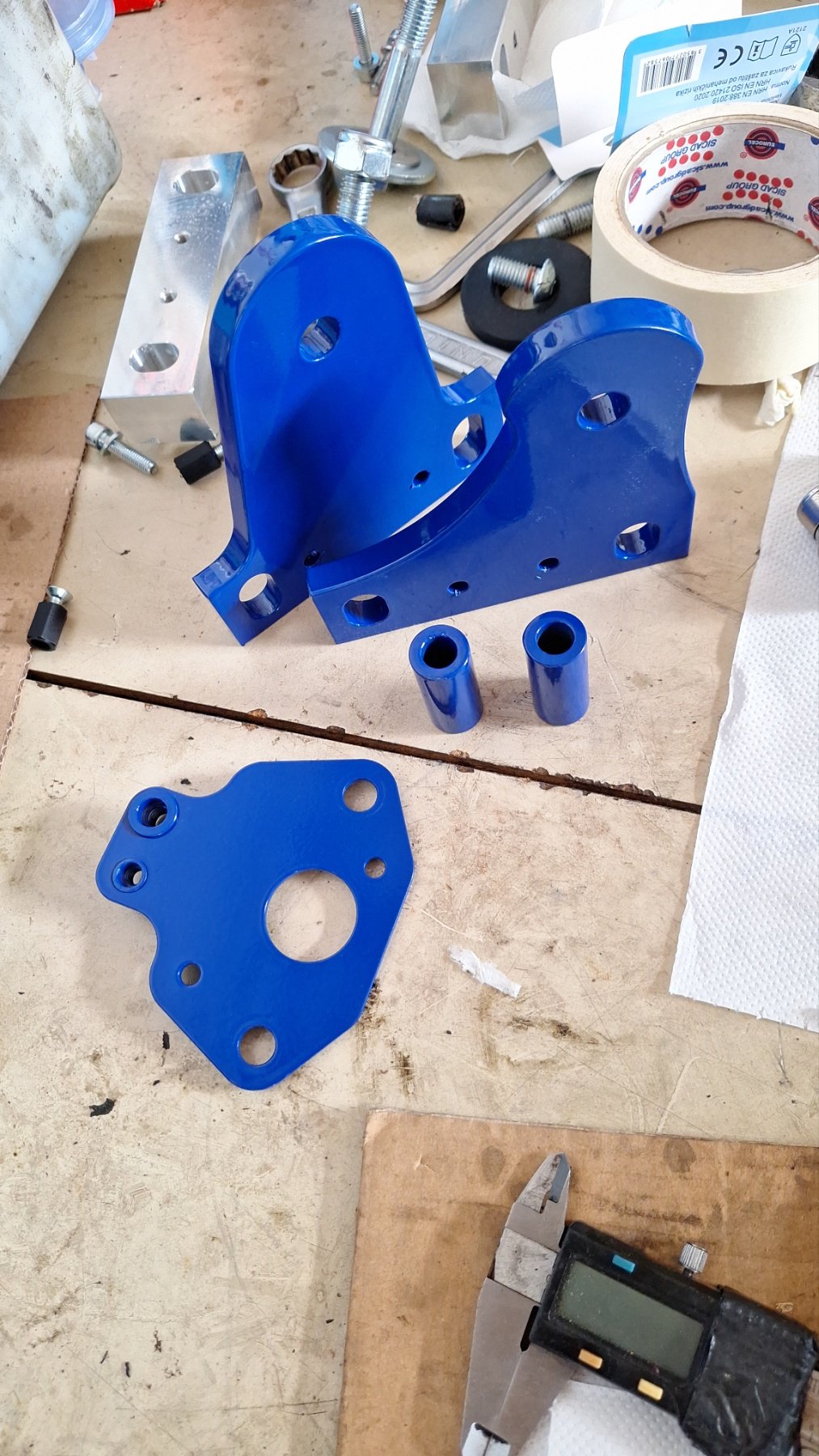

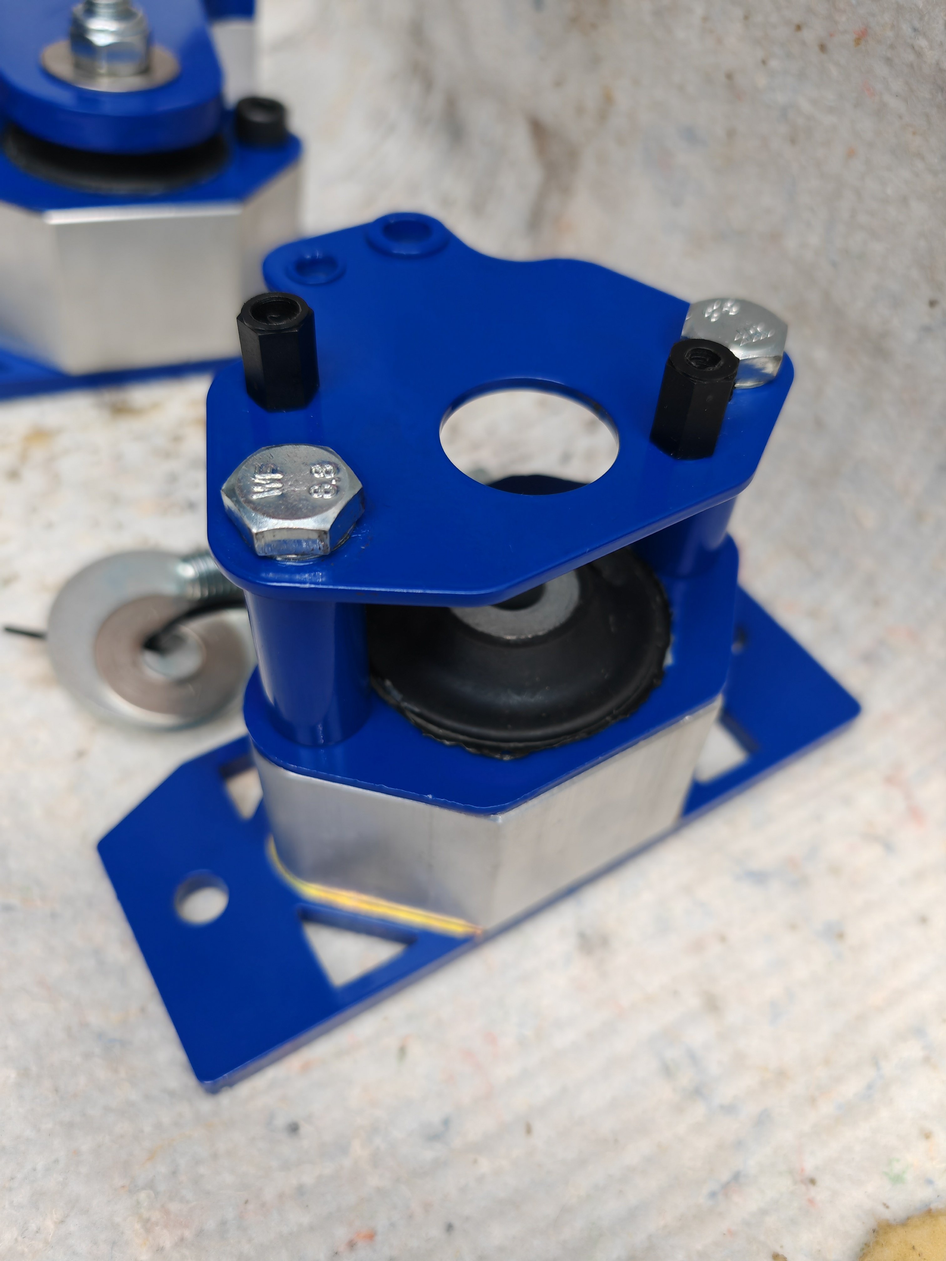

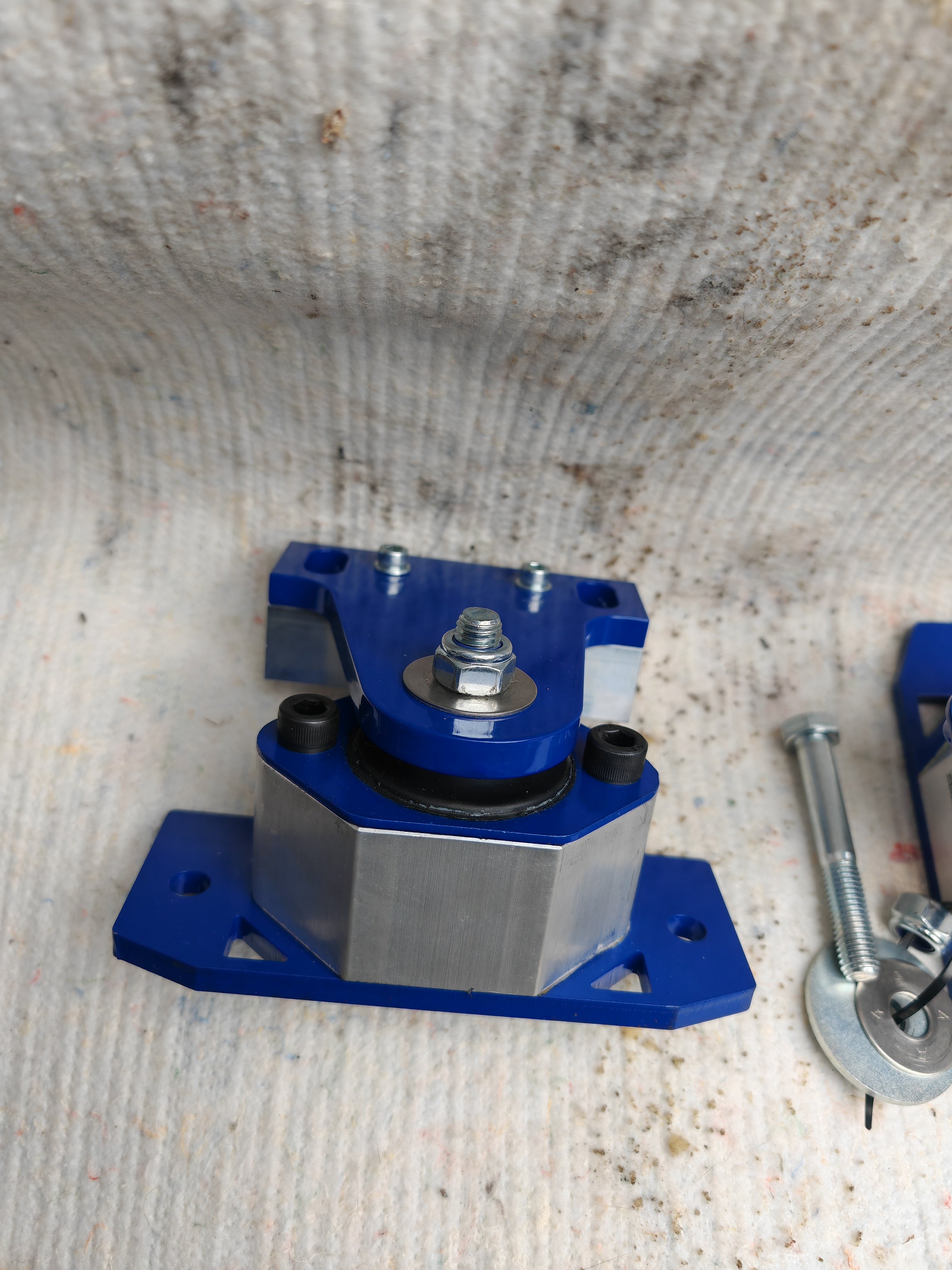

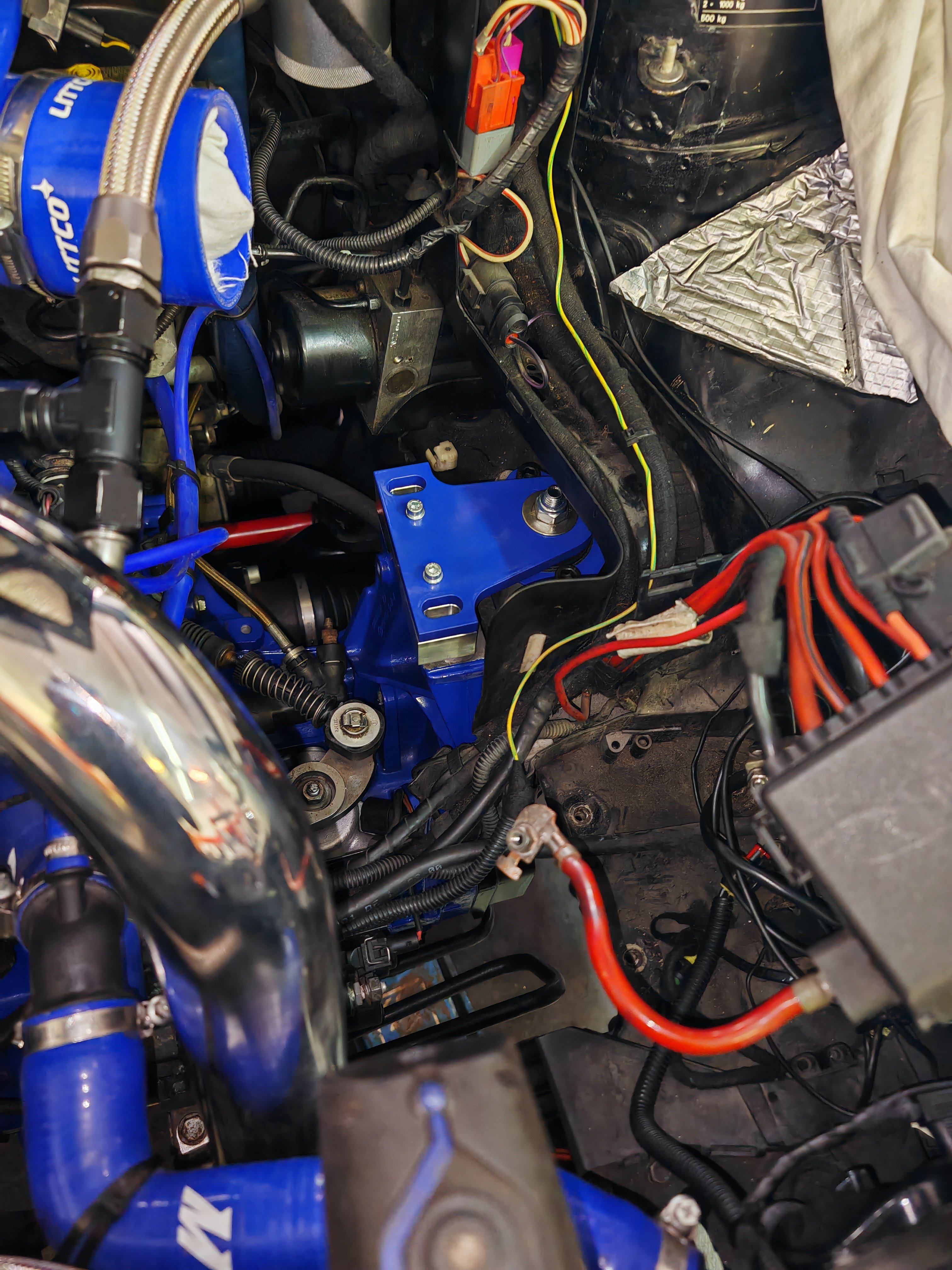

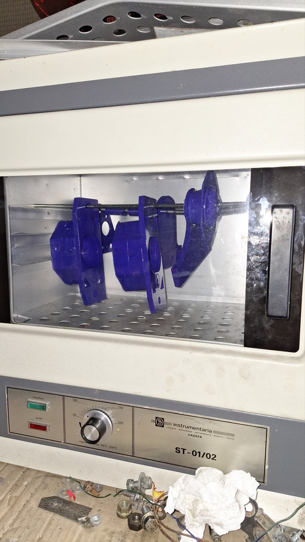

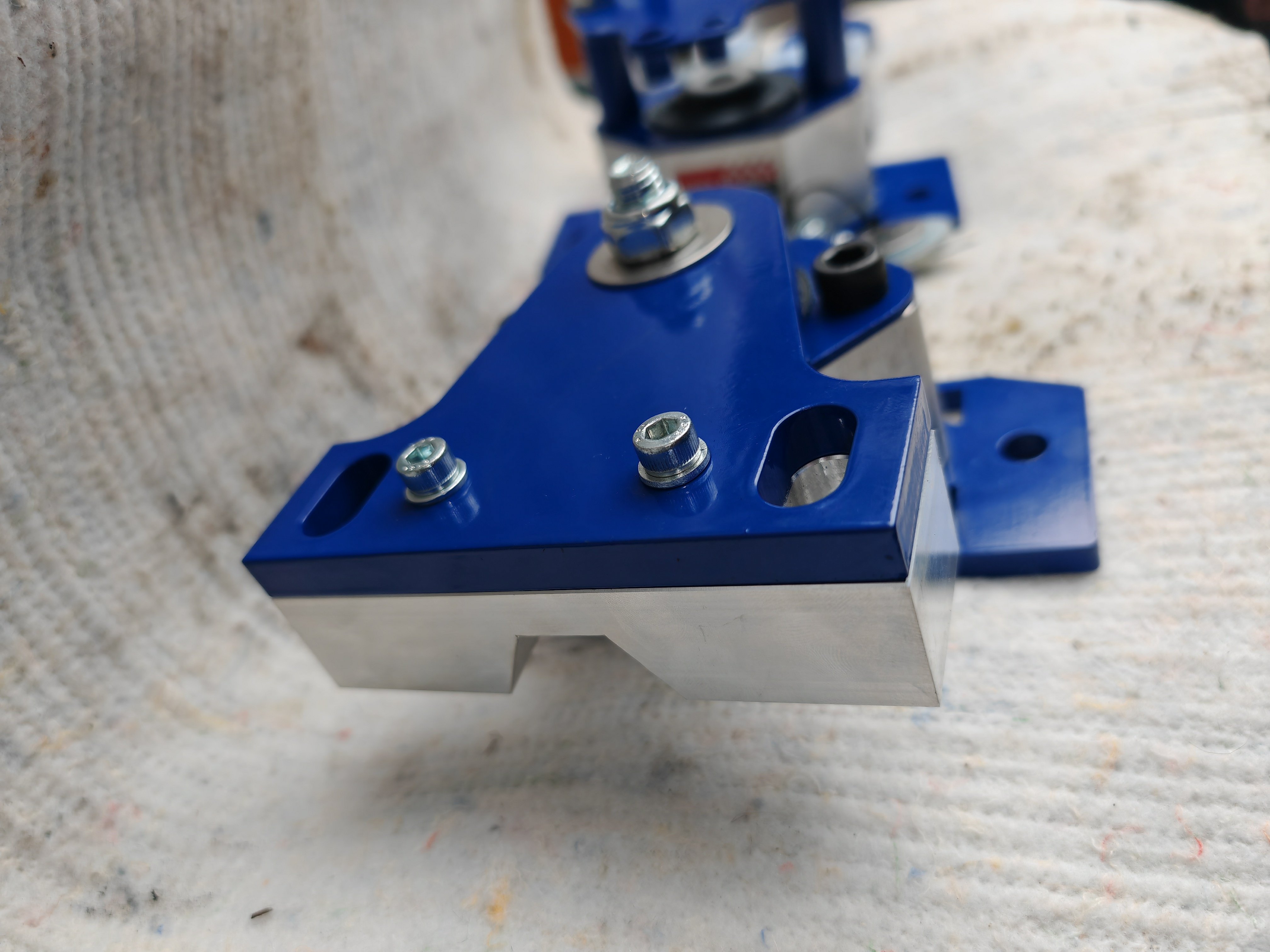

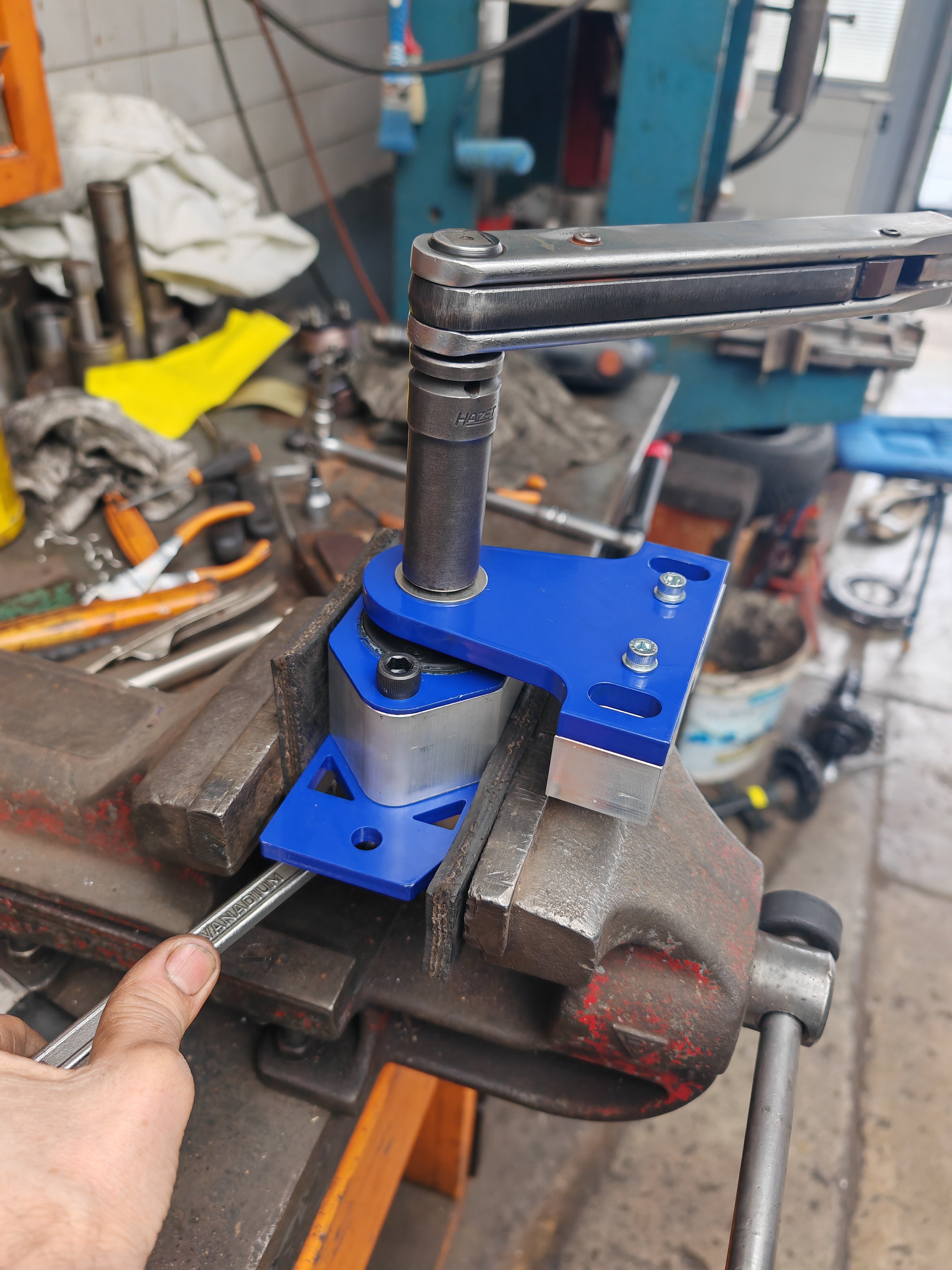

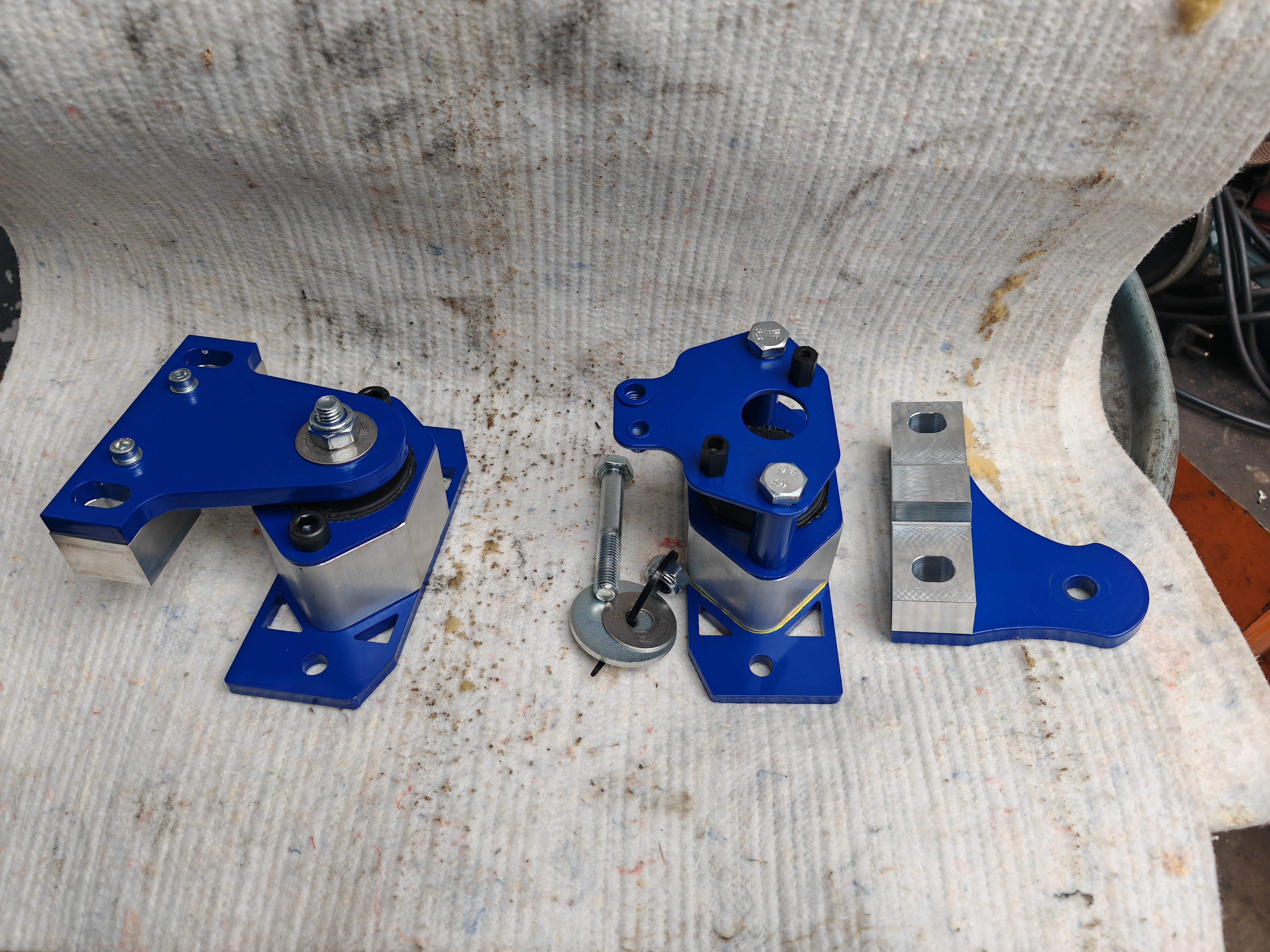

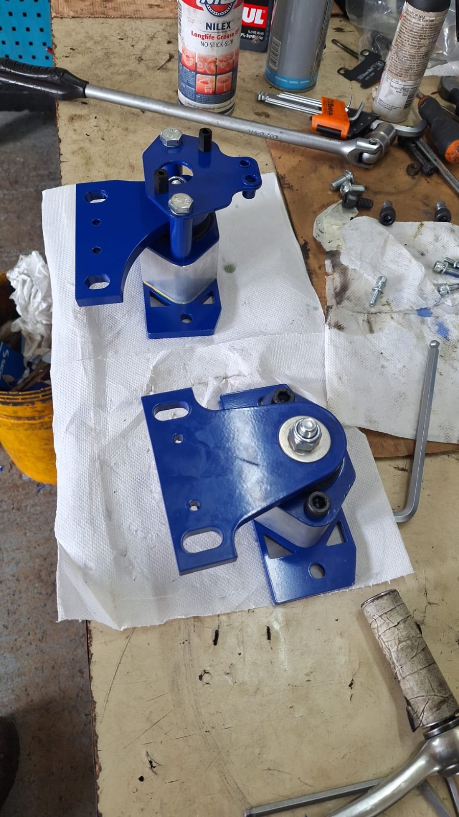

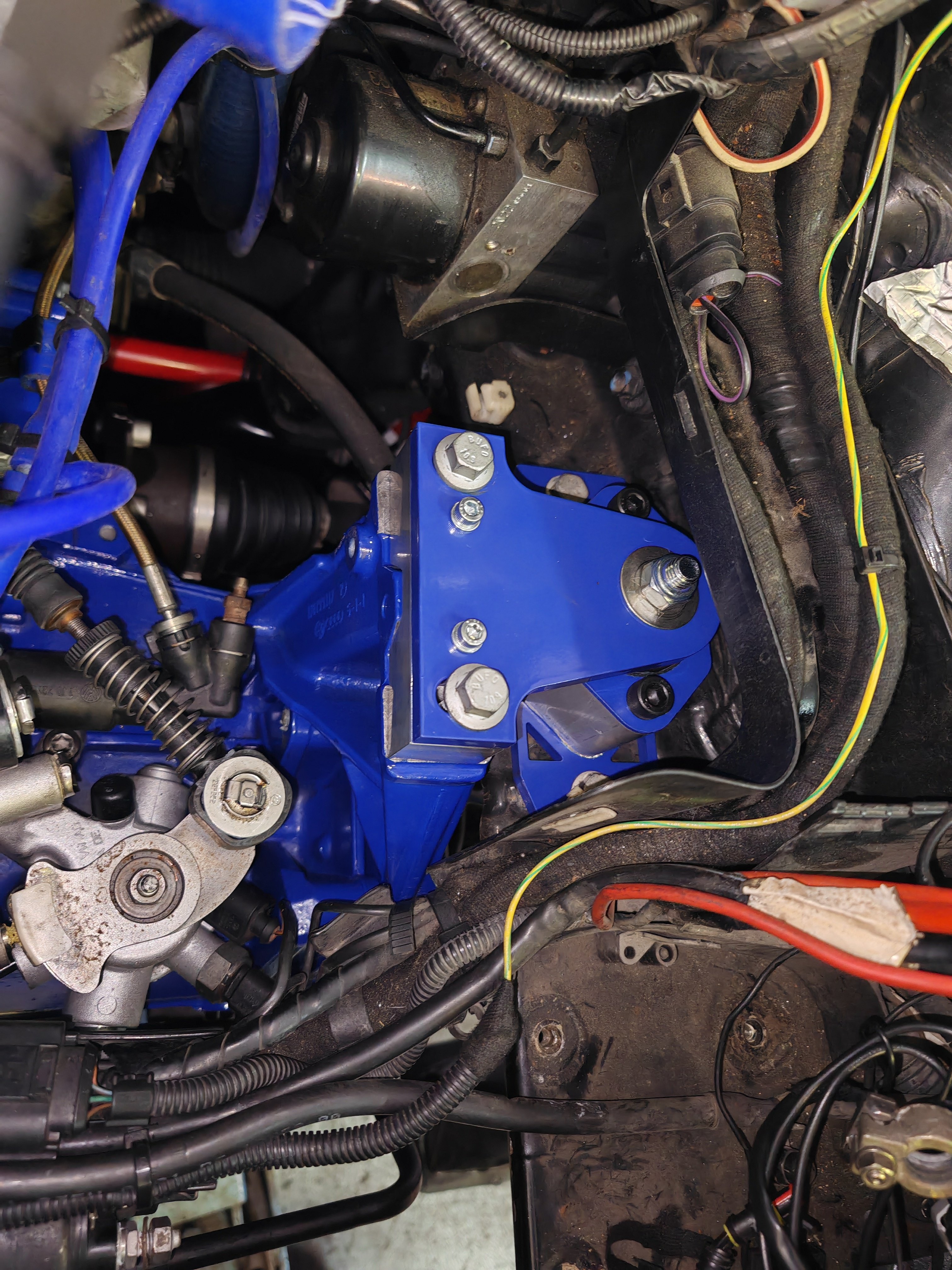

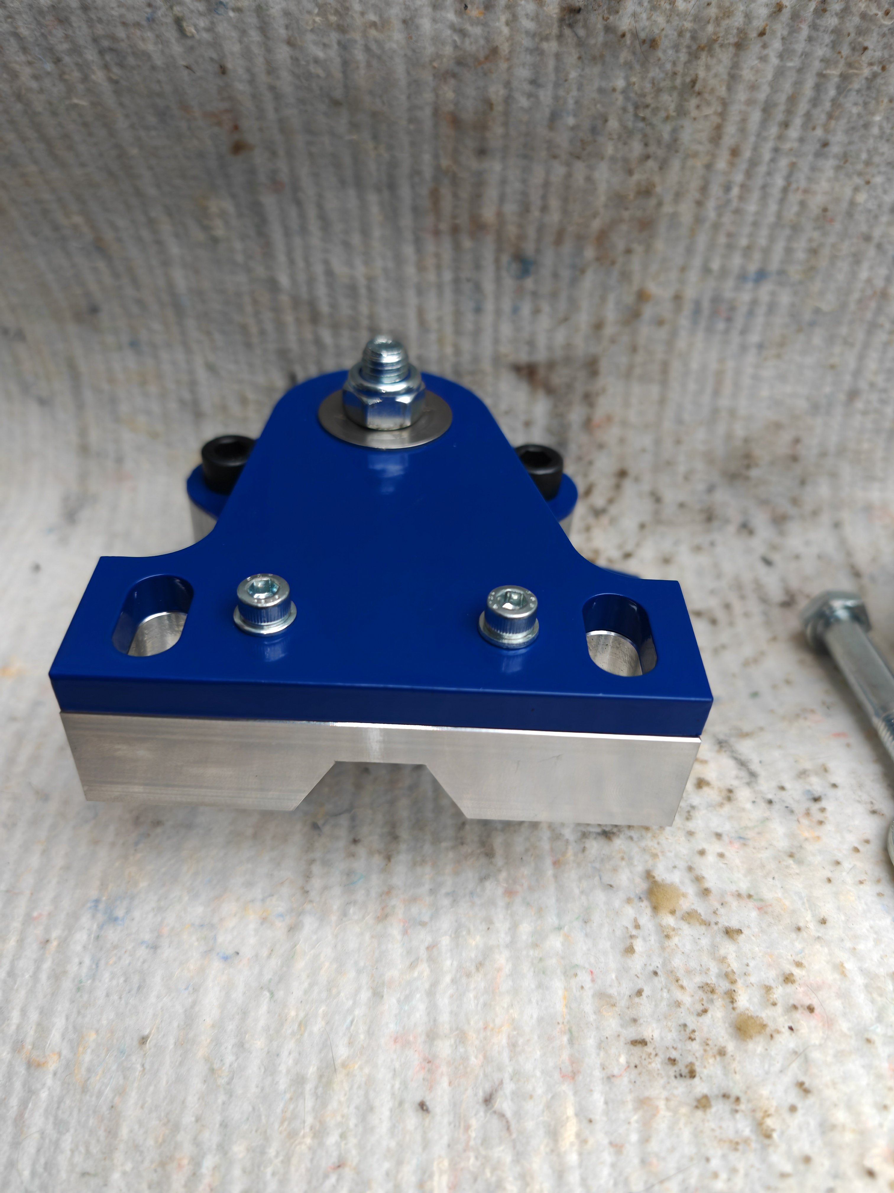

Mounts are done

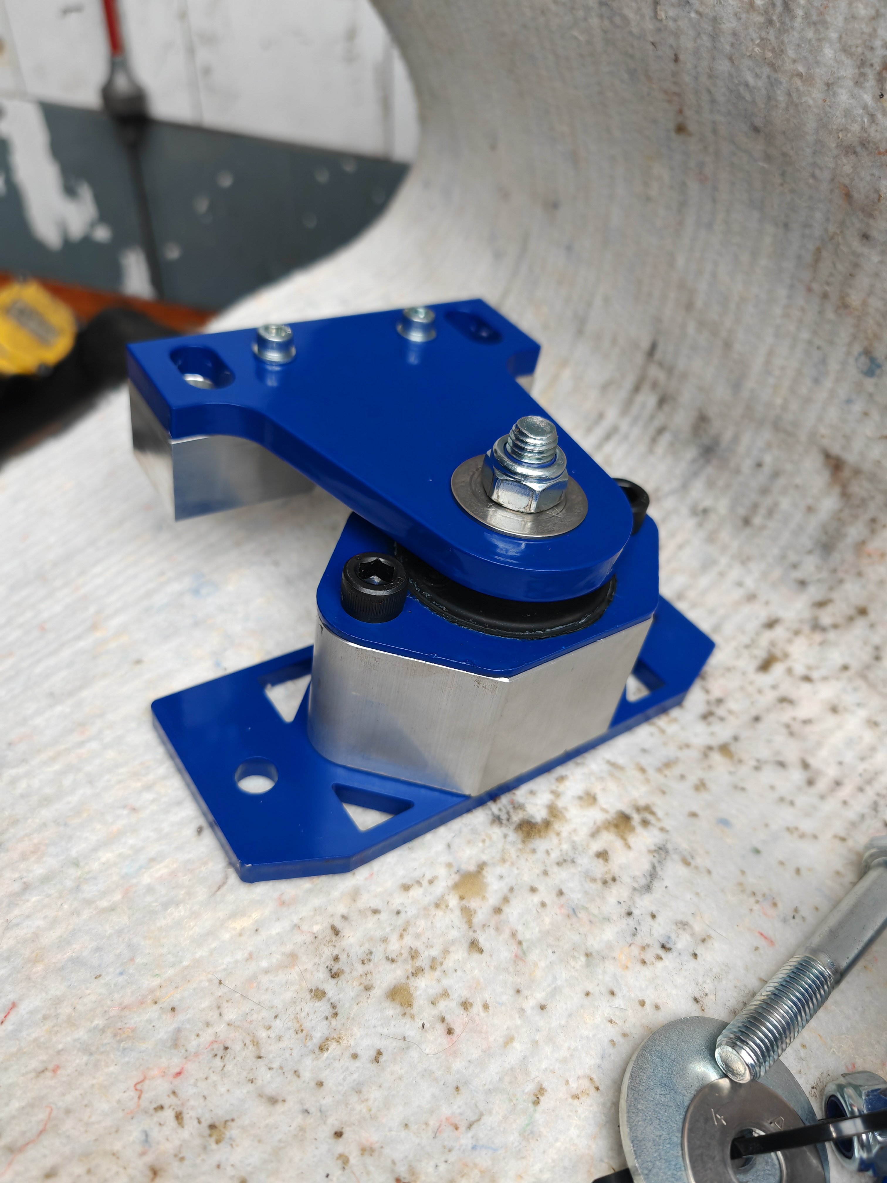

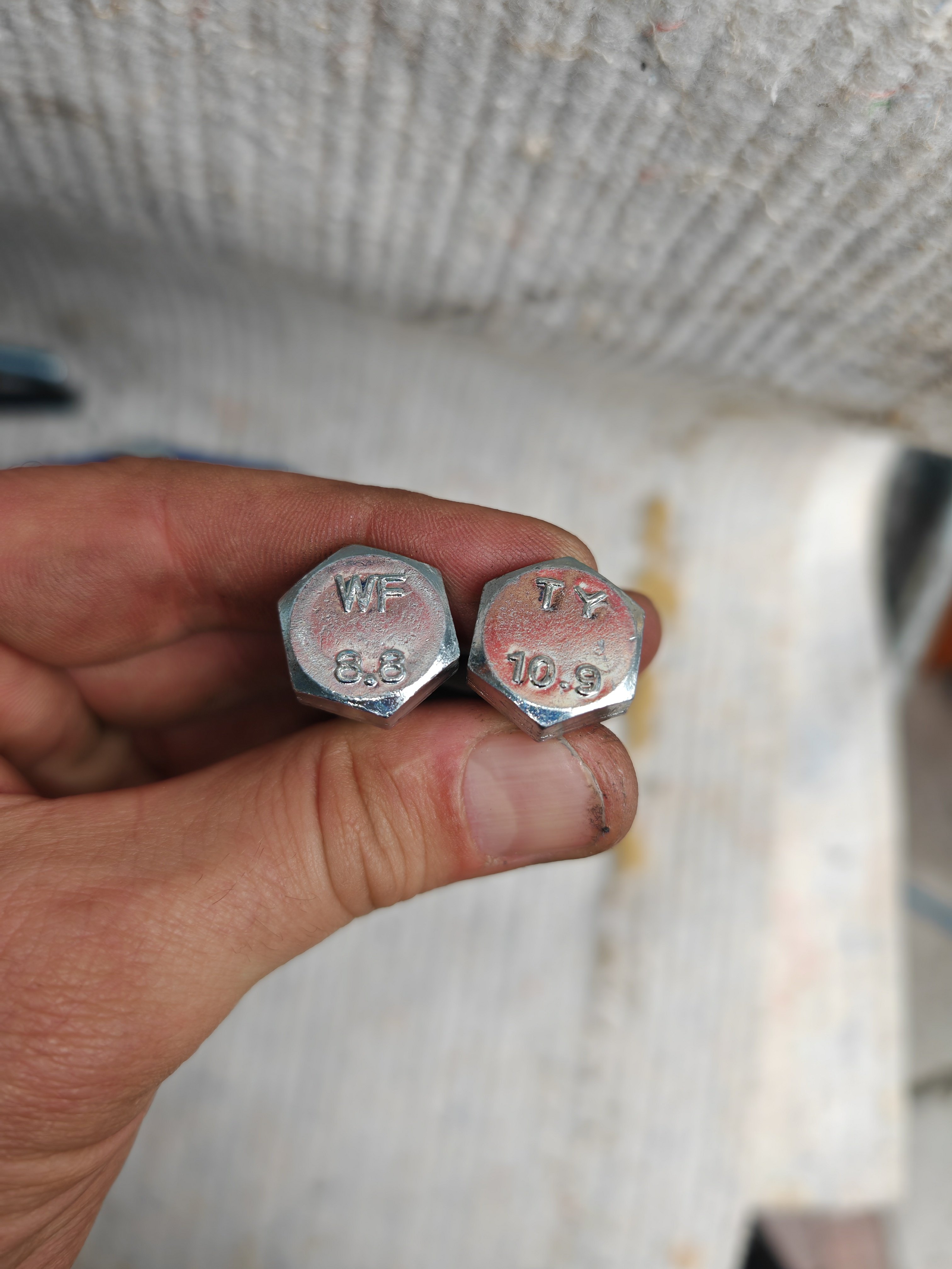

As always I must change things. Two black bolts are 12.9, because from  old ones 8.8 one broken at grad during dismantling , VibraTechnics did put all 8.8, I bought more 12.9 black ones and 10.9 with 10.9nut for center ones M12 to reinforce it a little. Want to put all 12 9 but black nitrited Bolt with Chromed nut will corode, so probably 10.9 nut and bolt 😂😂😂

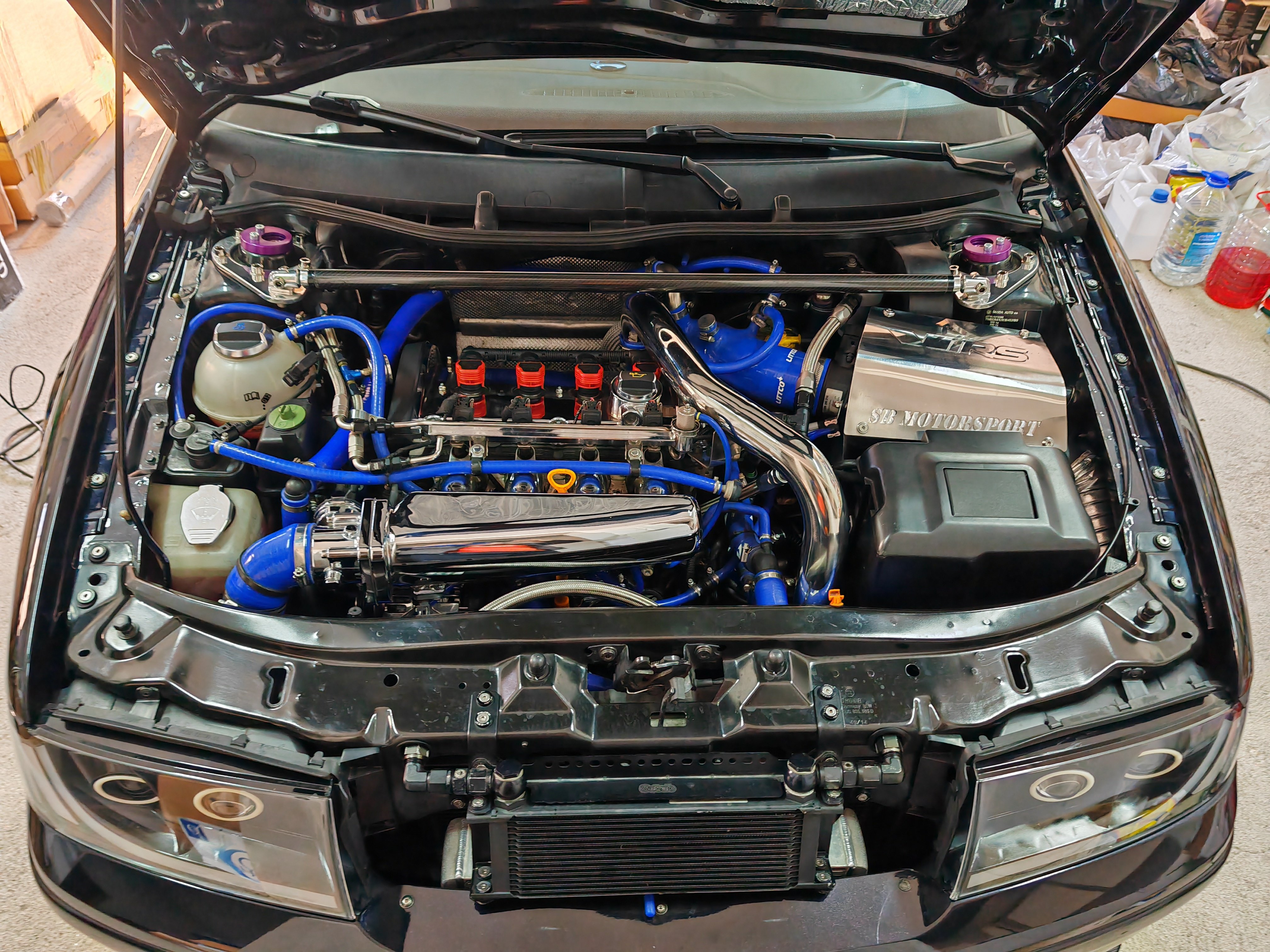

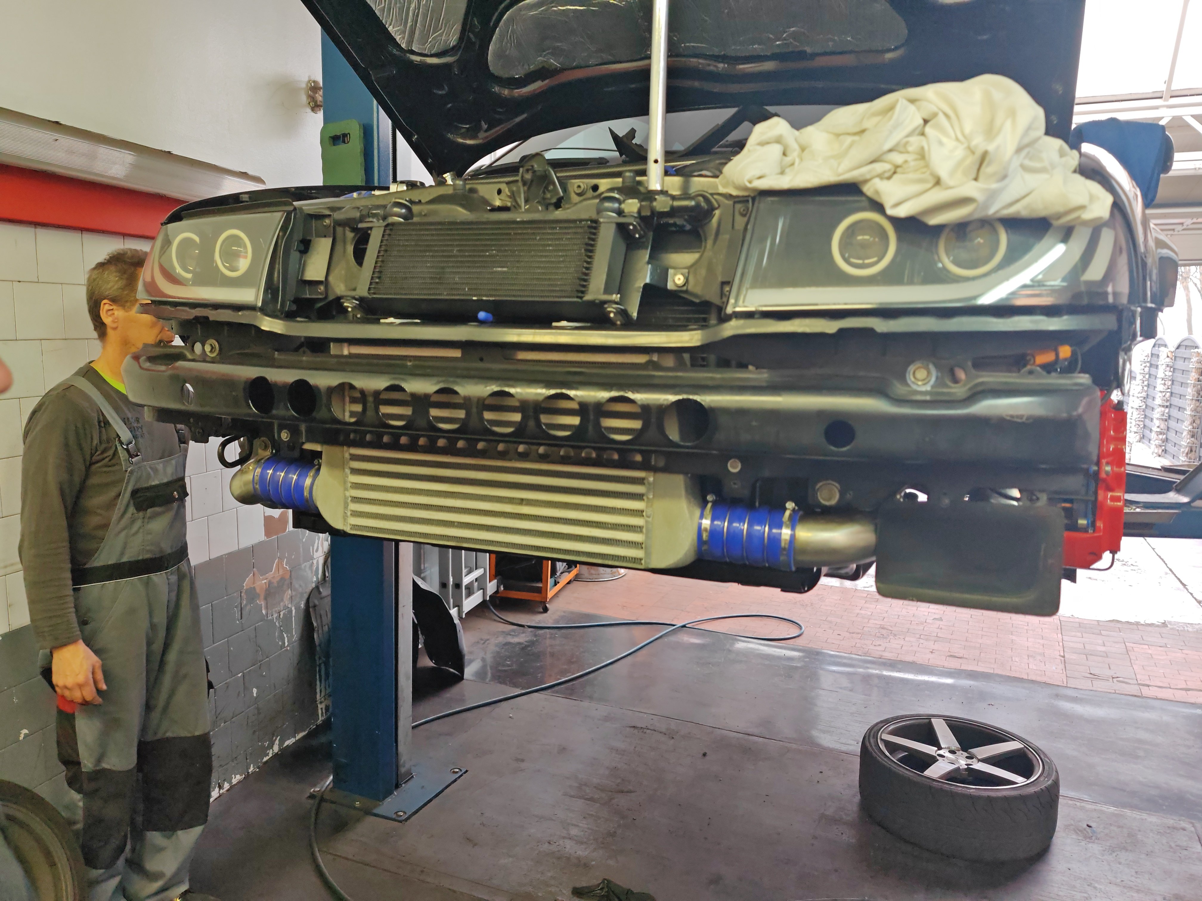

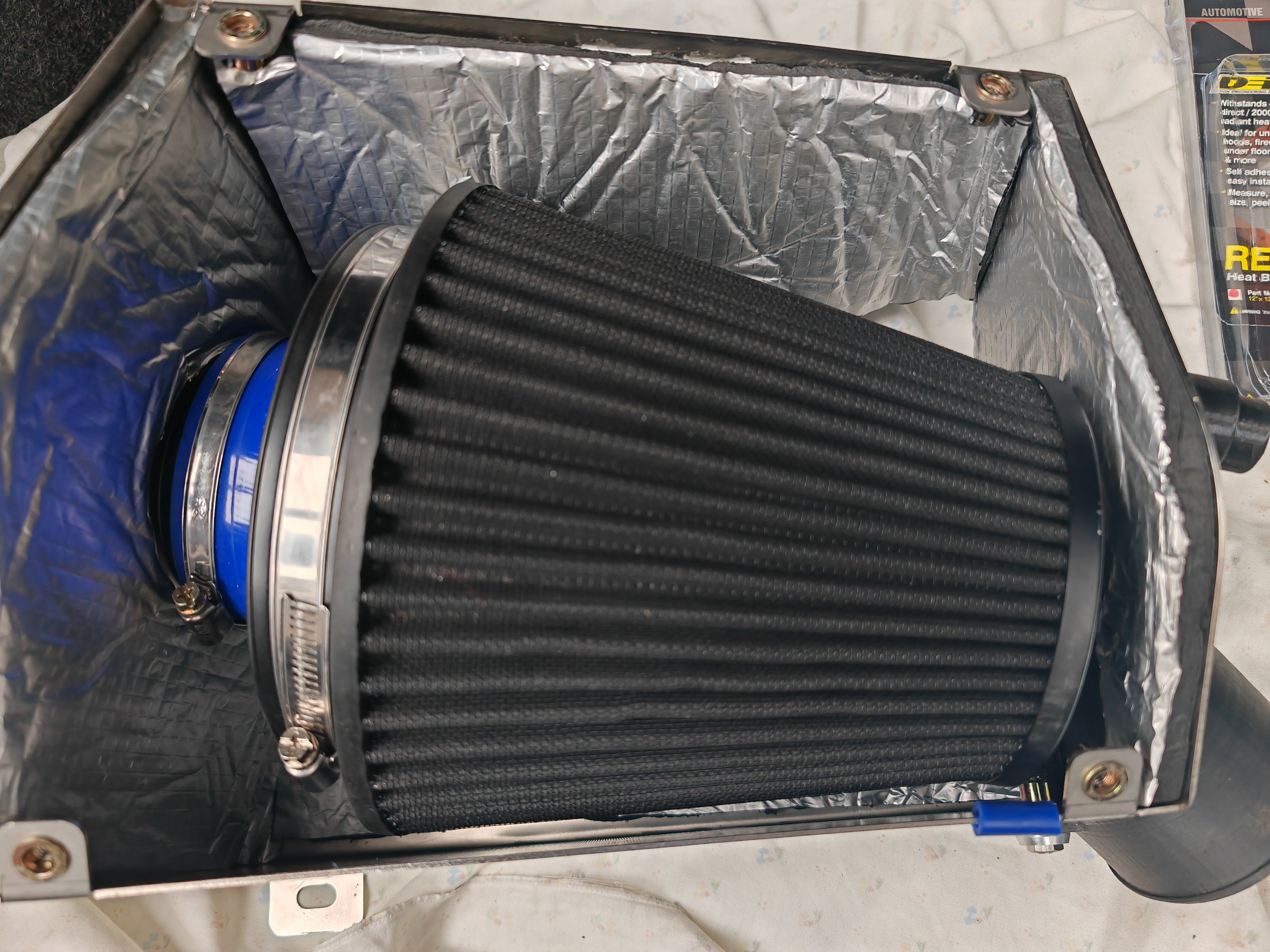

Sneak preko into my FMIC endtanks with custom diffusor - idea taken from HPerformance Germany

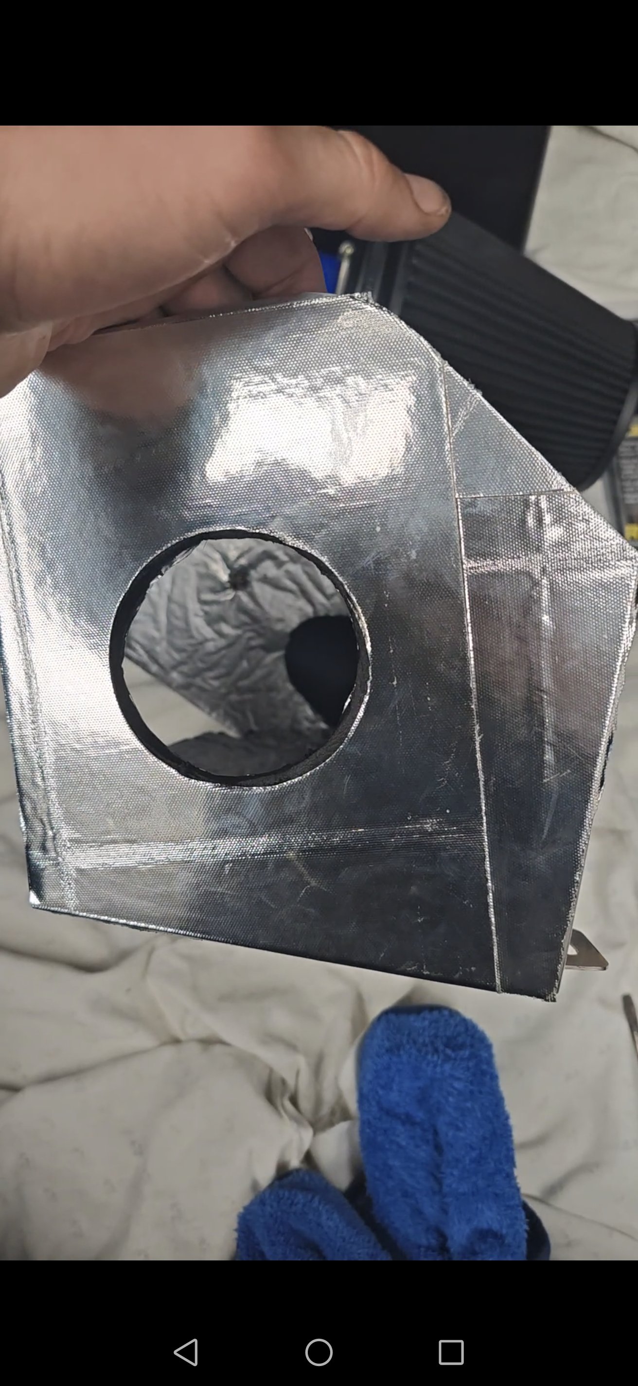

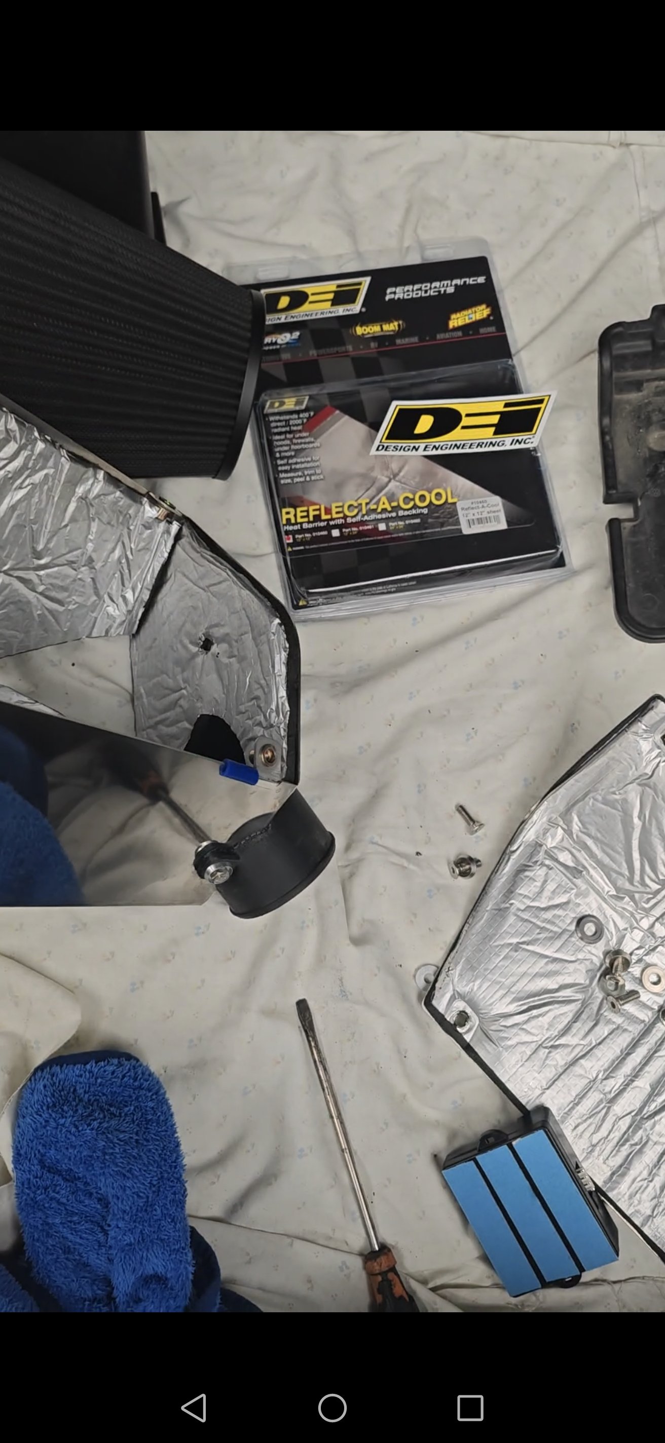

I additionally used DEI reflective foil to cover surface facing engine ,where MAF goes, and Will buy more to cover the side facing the cabin, airbduct entrsnce and the bottom one, to have insulation from inside and outside. It is so easy to aply, top quality.
Edited by davojuri

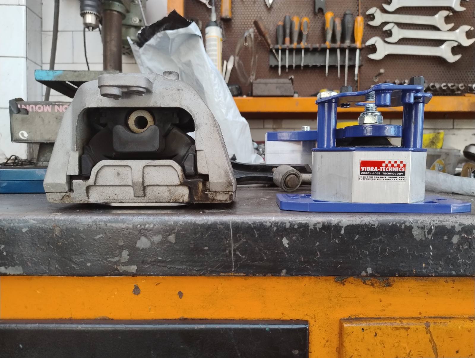

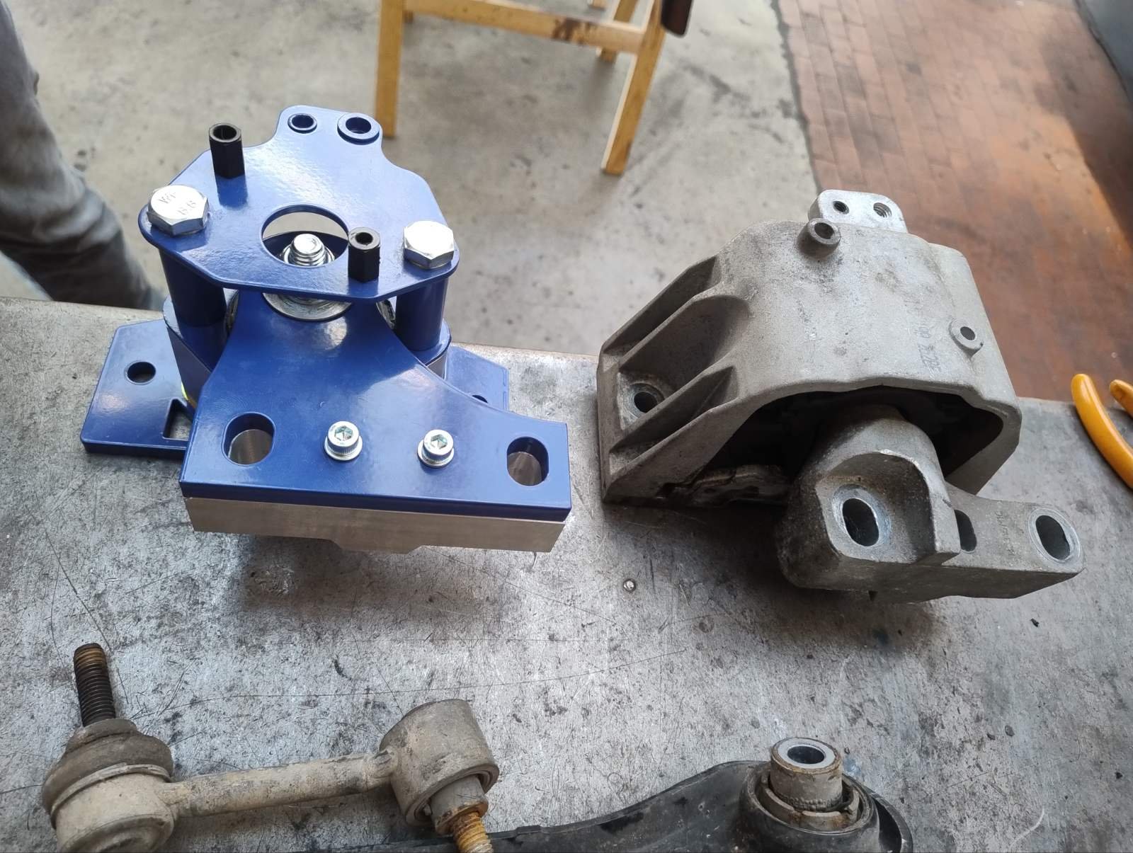

VibraTechnics assembled mounts with 8.8 grade hardware. I removed some for black allen 12.9 bolts, and central ones for M12 10.9 ones.

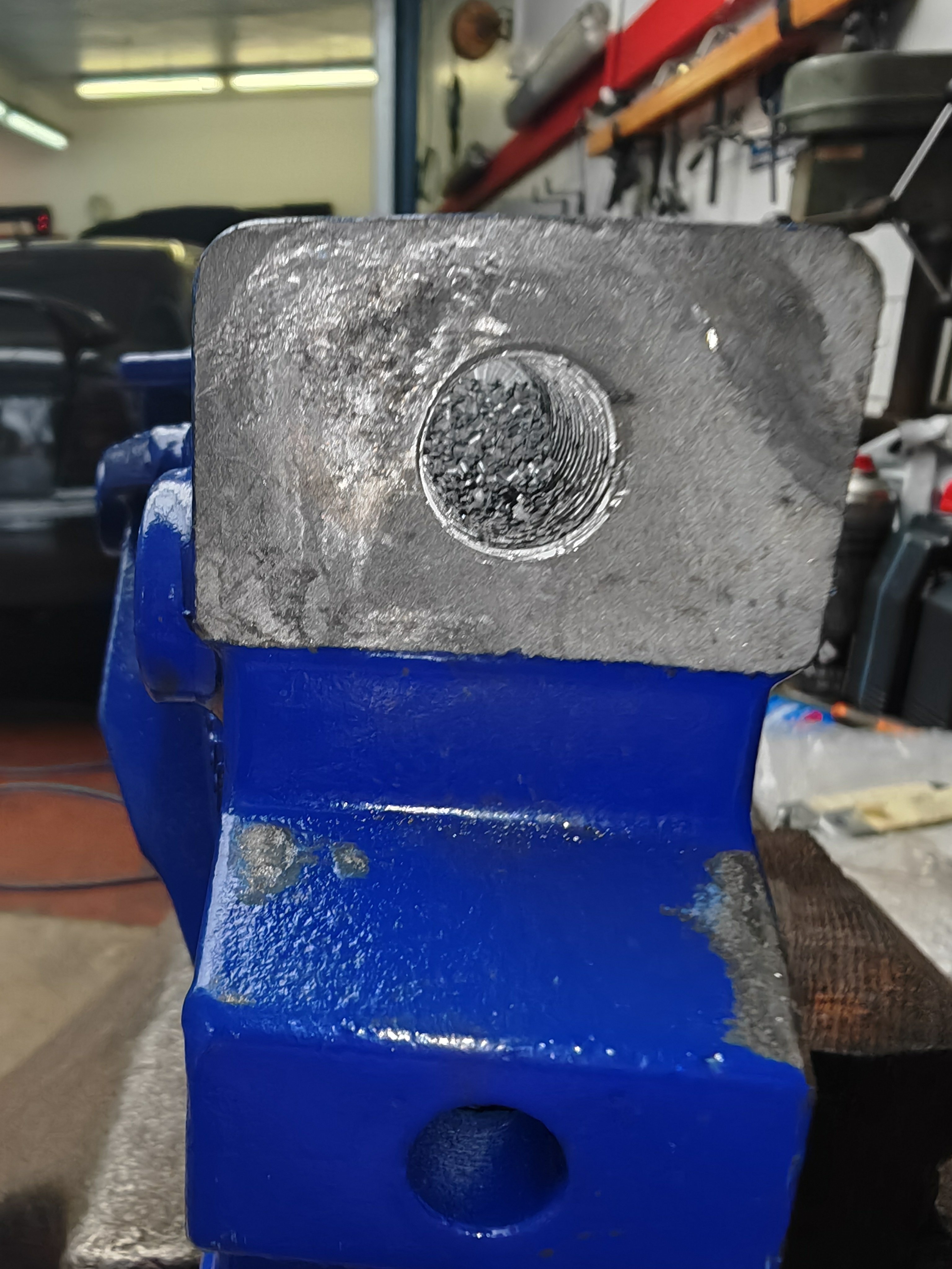

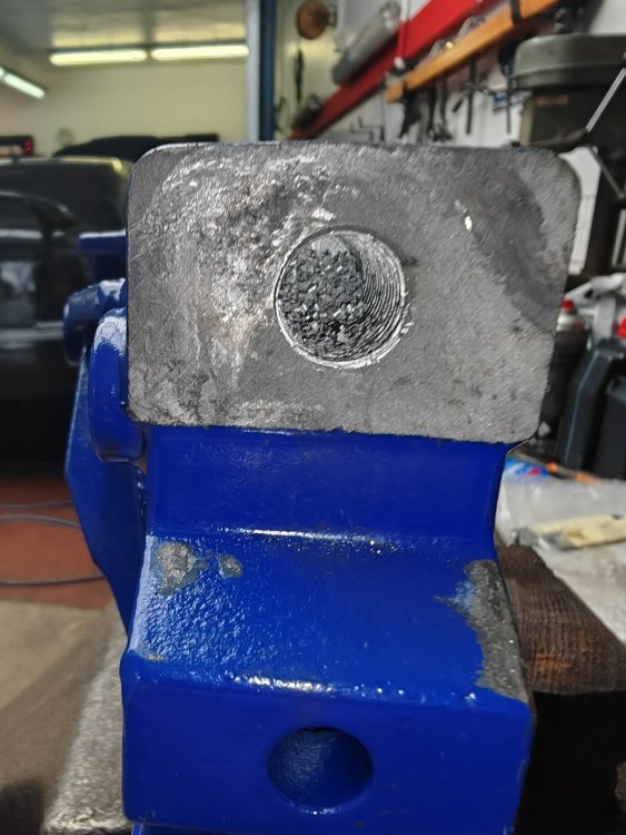

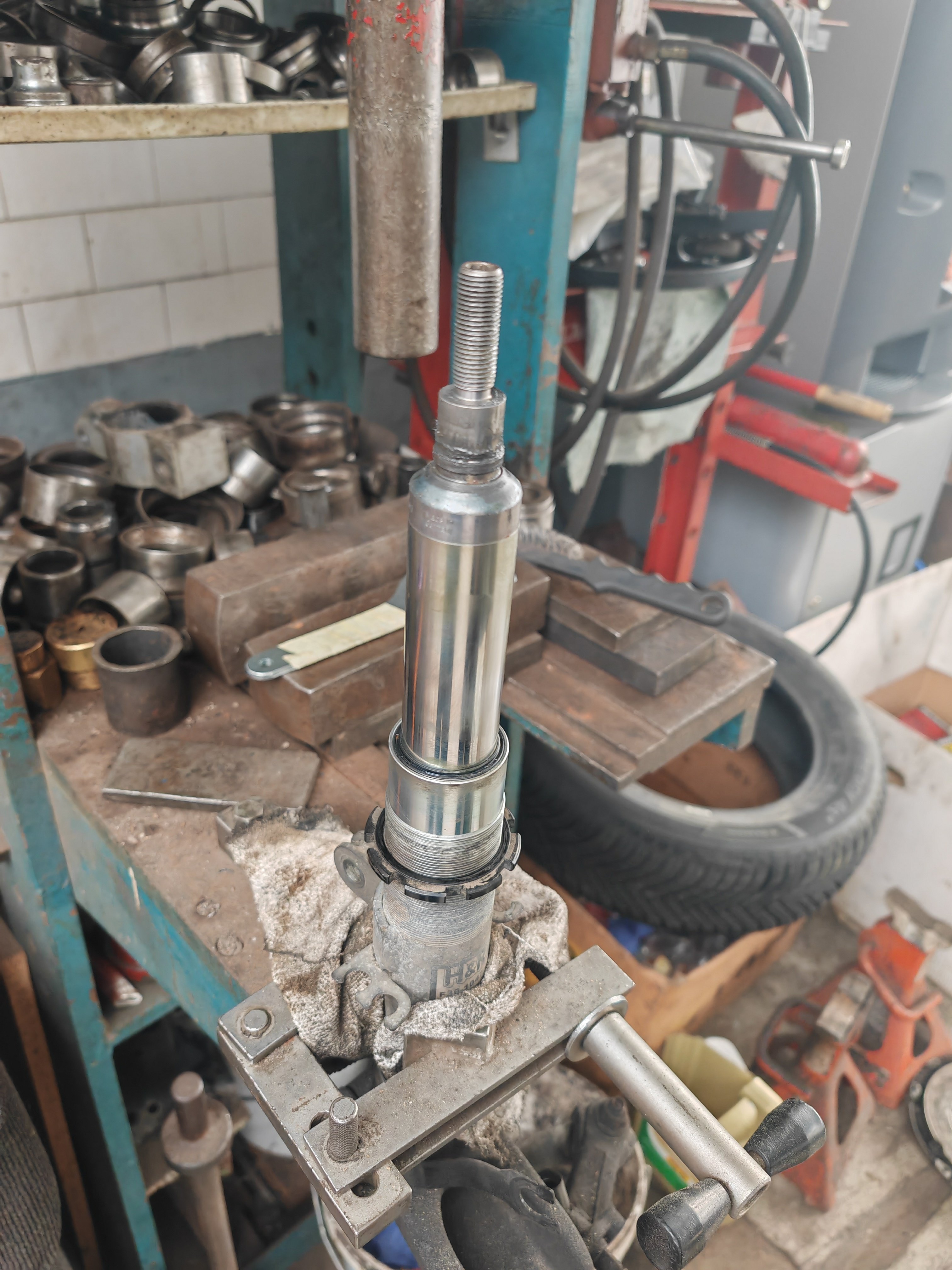

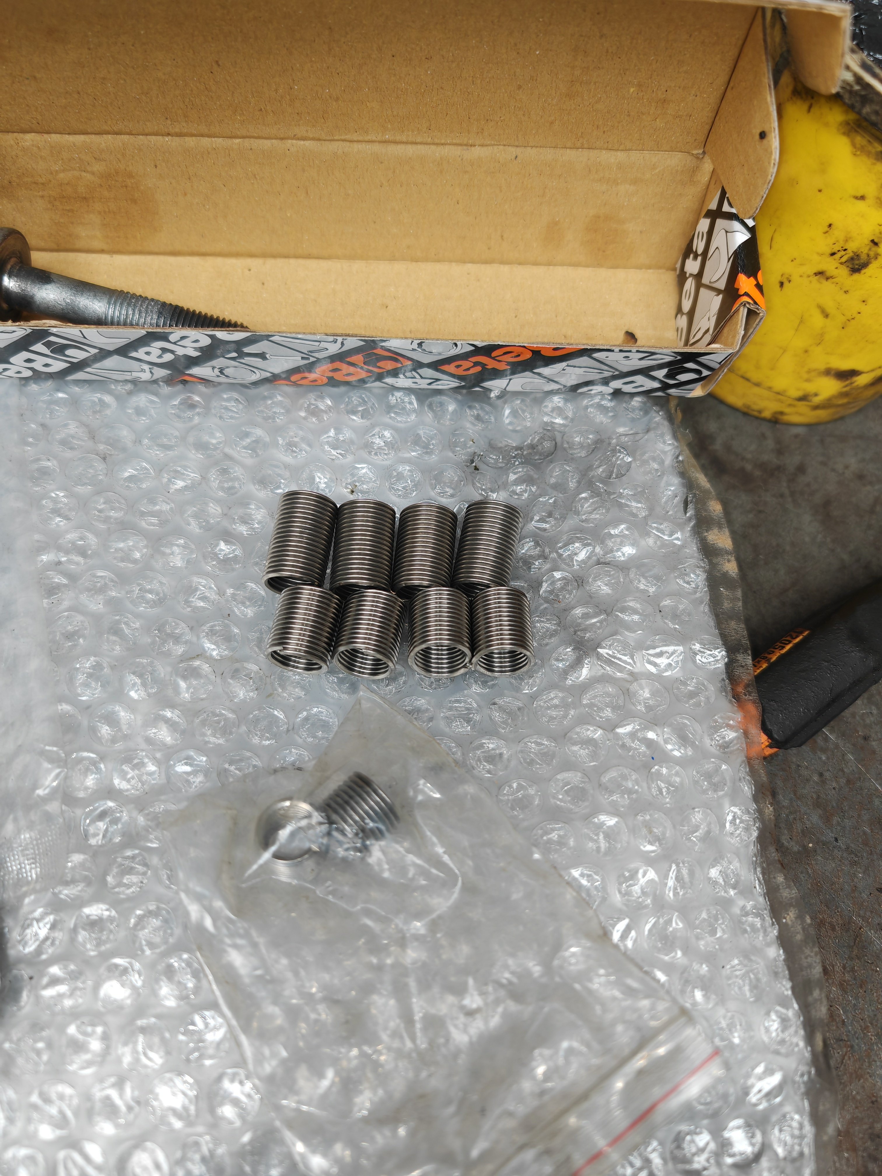

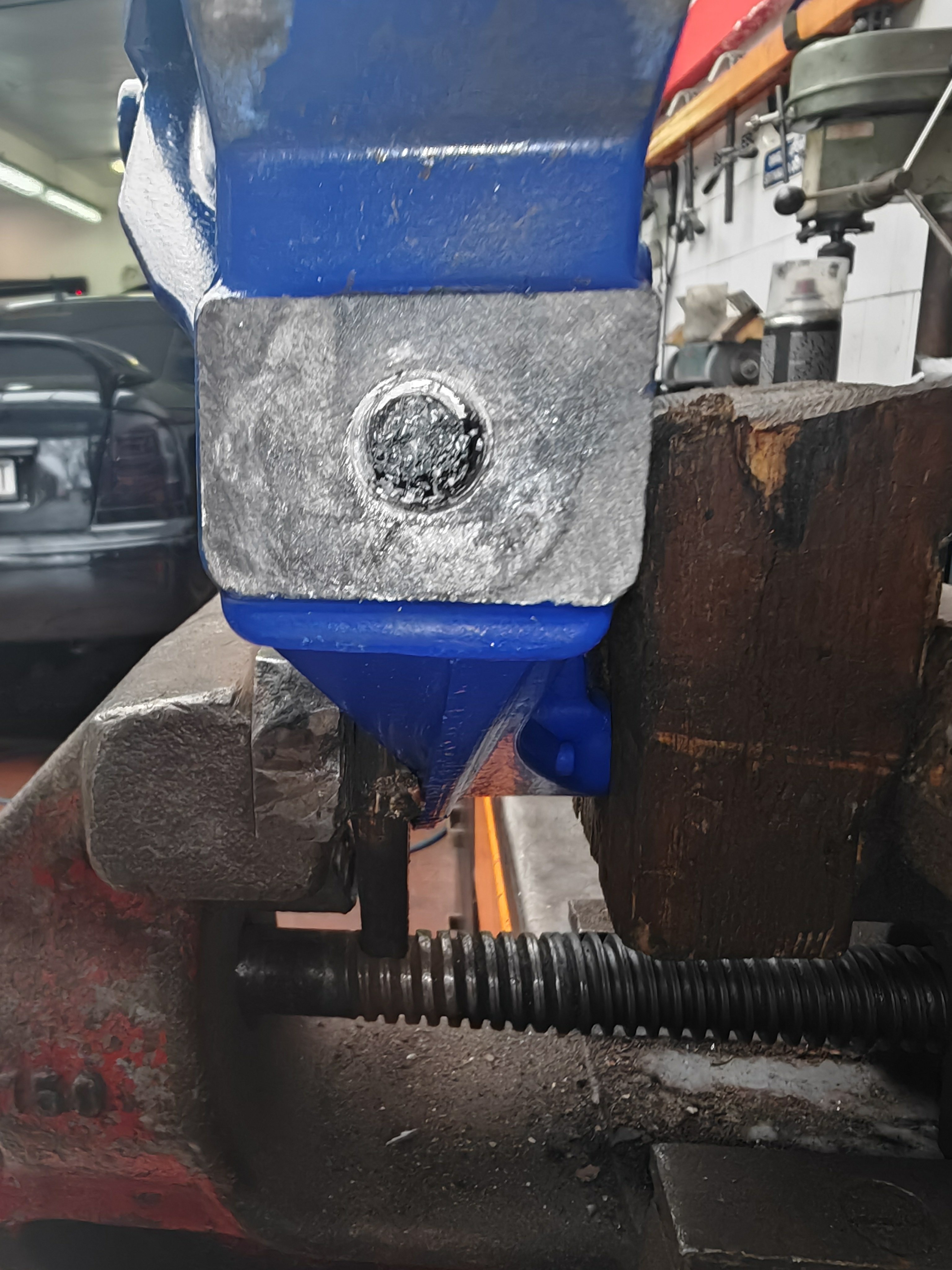

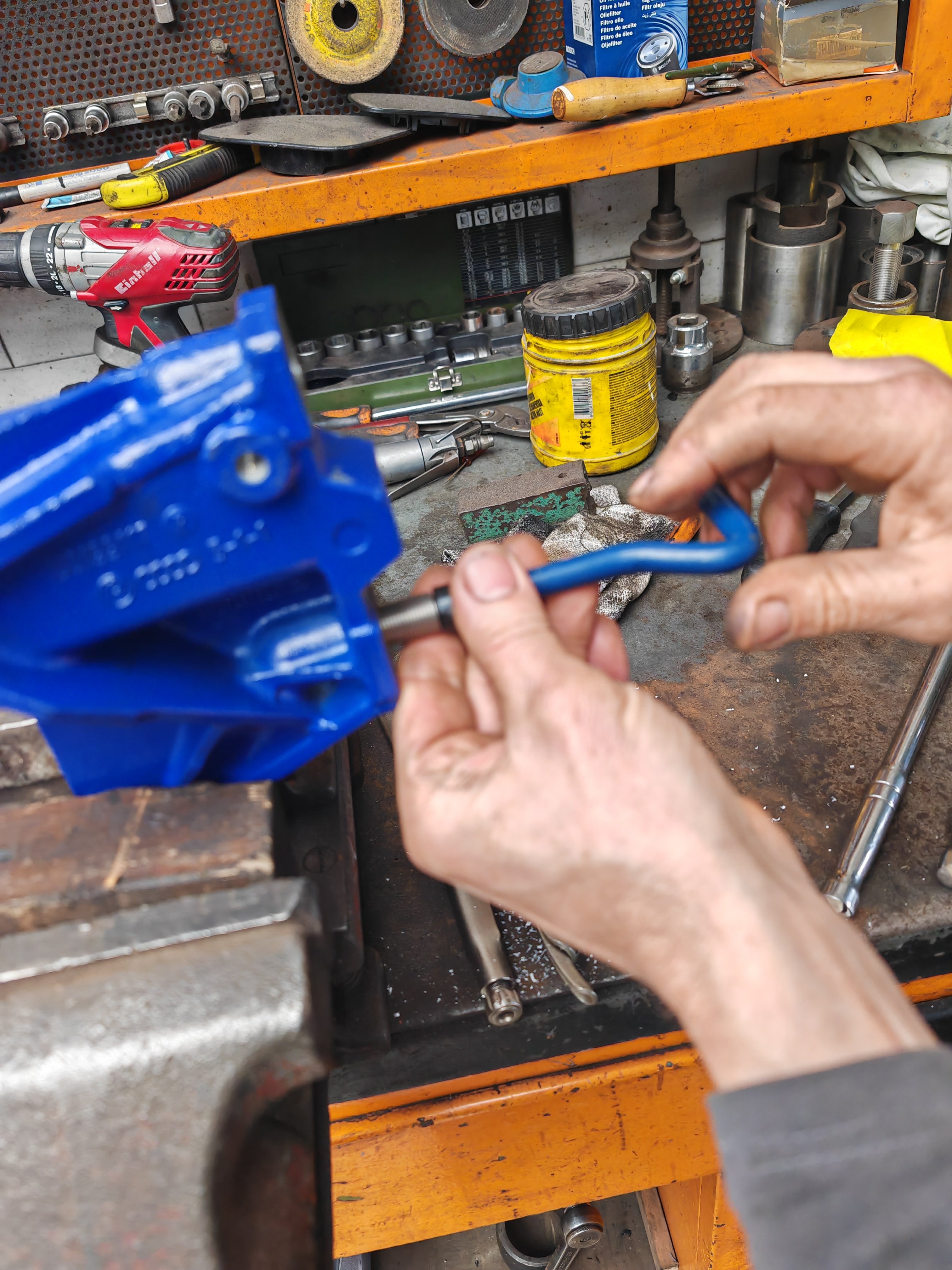

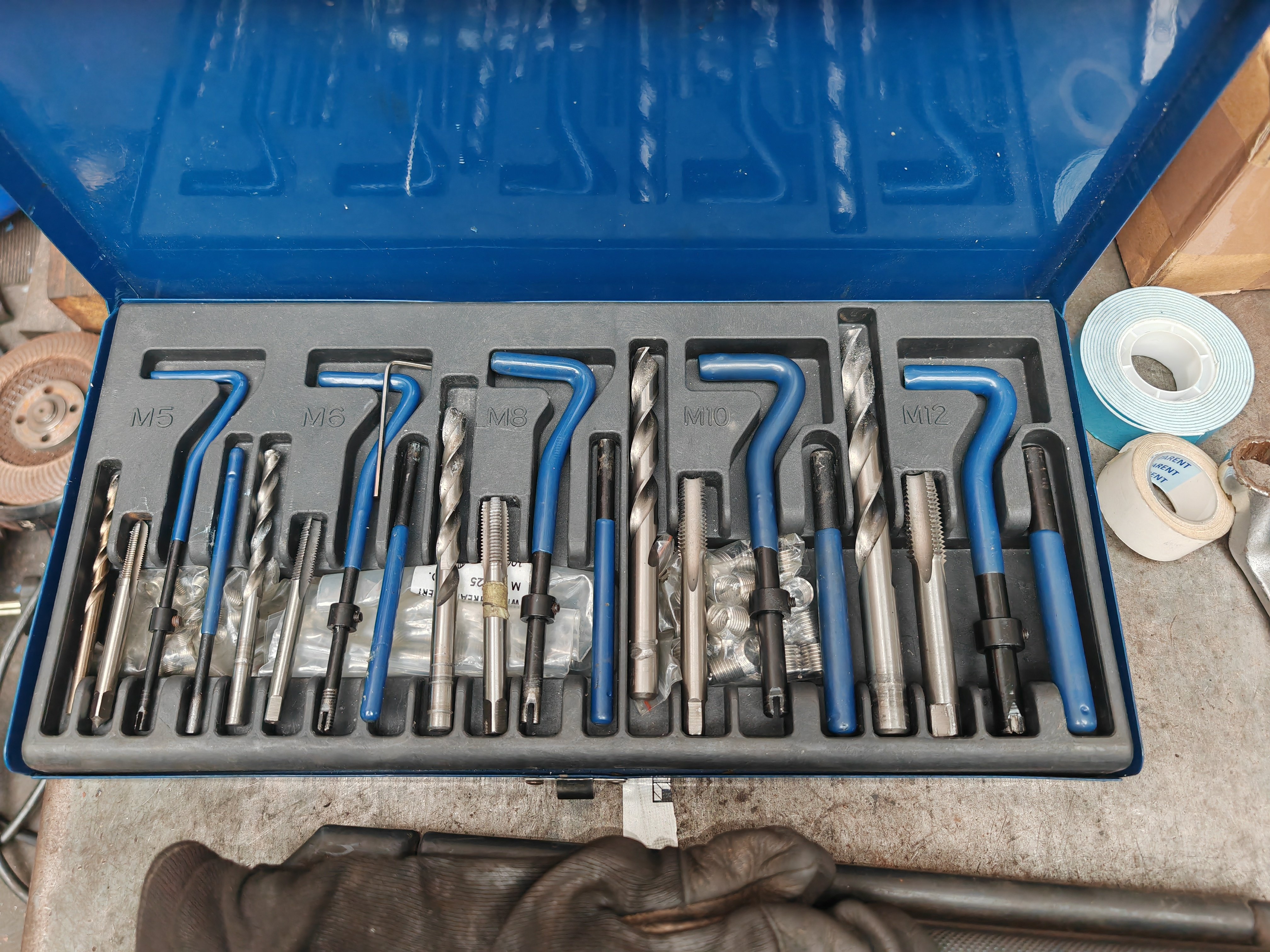

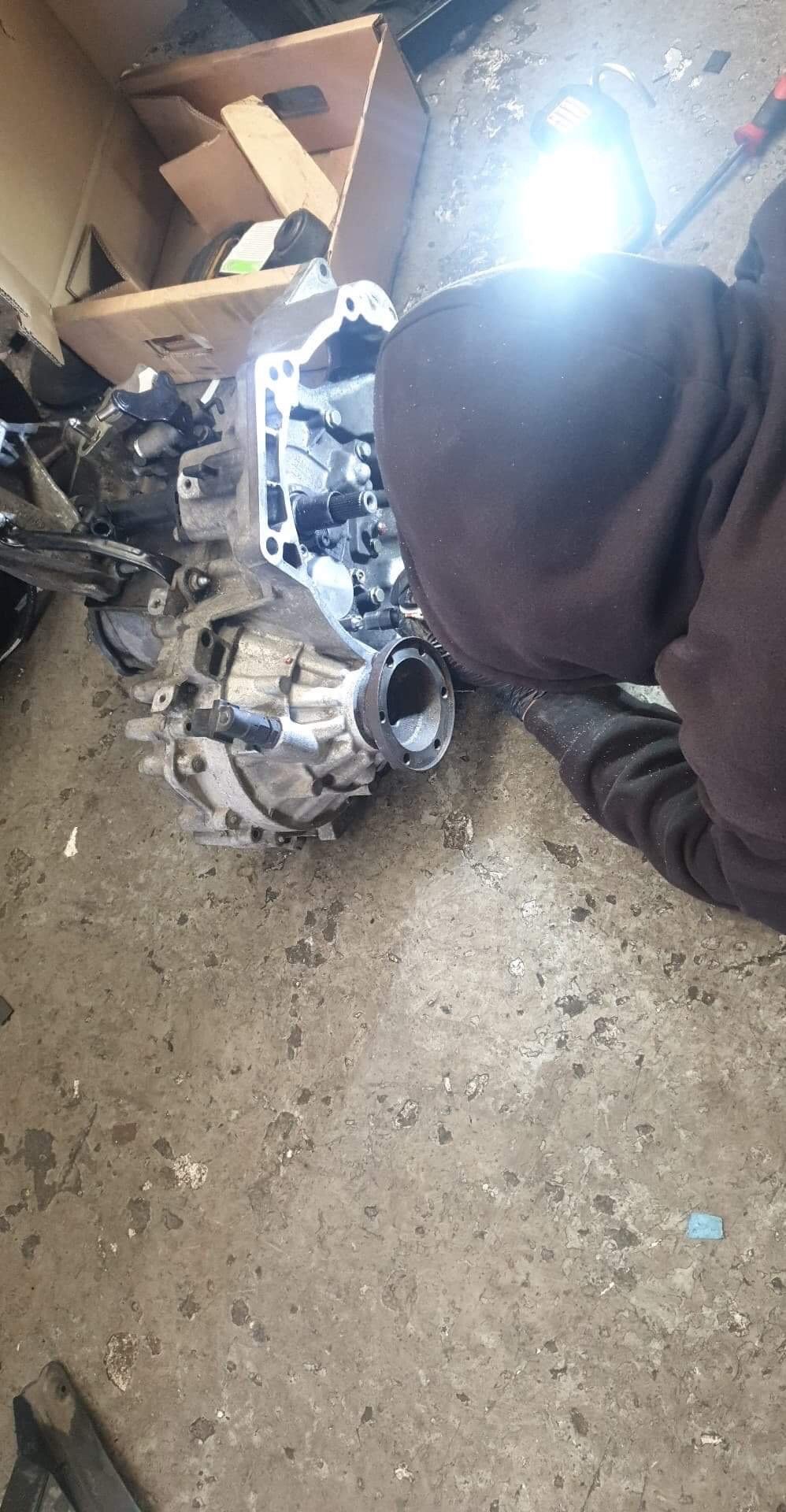

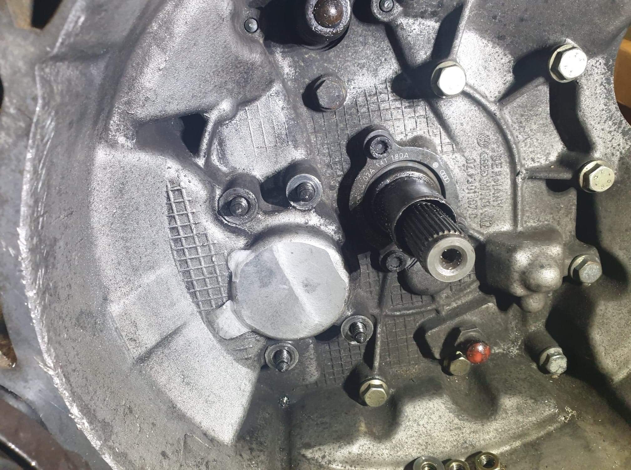

I had problems with threads on the bracket that holds transmission mount. They were worn out so I used this special tools to make new ones using spring wire-thstvway retaining the same bolt size, also with two front threads for bolts that holds dog bone to the transmission. Great help

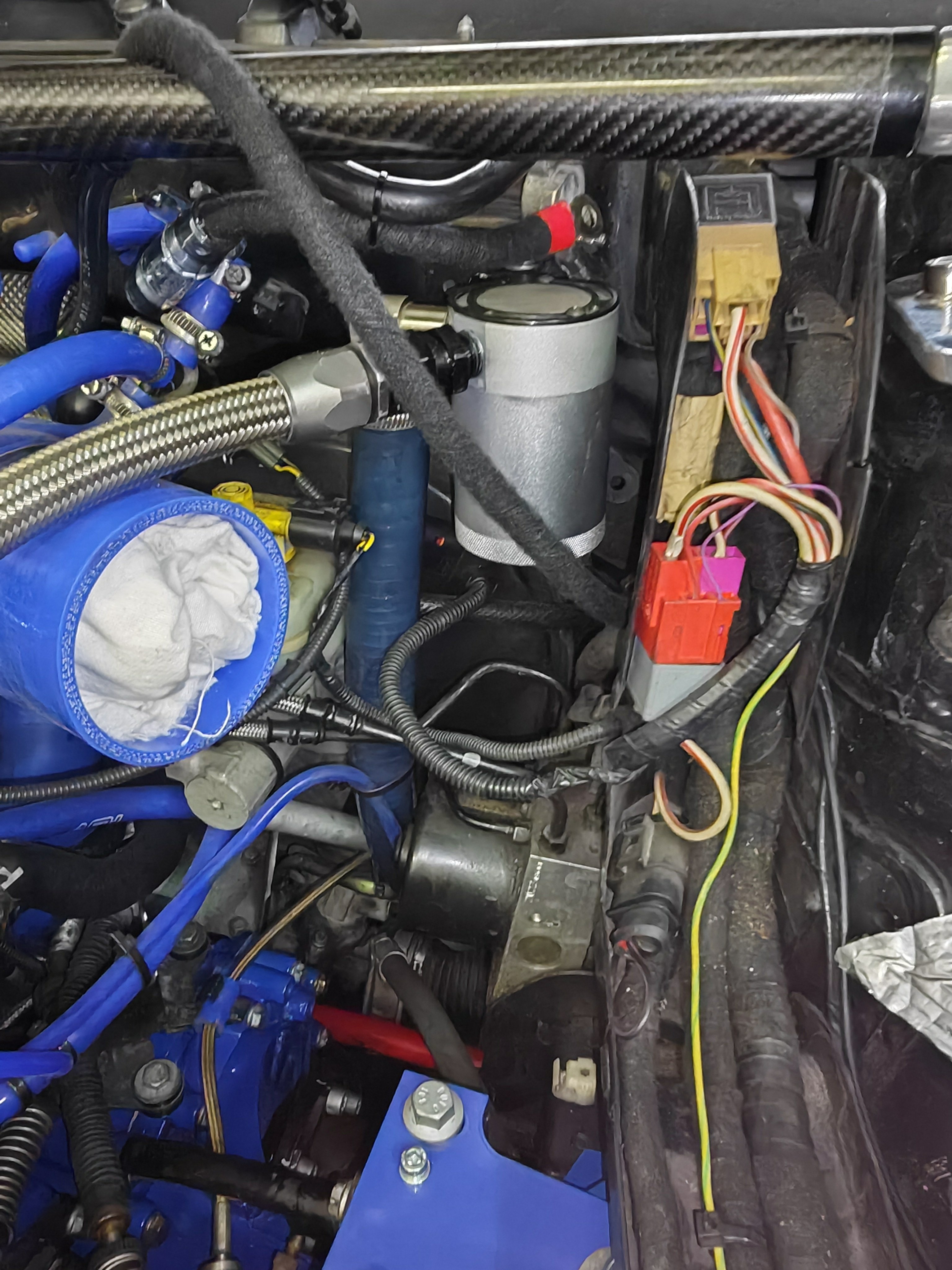

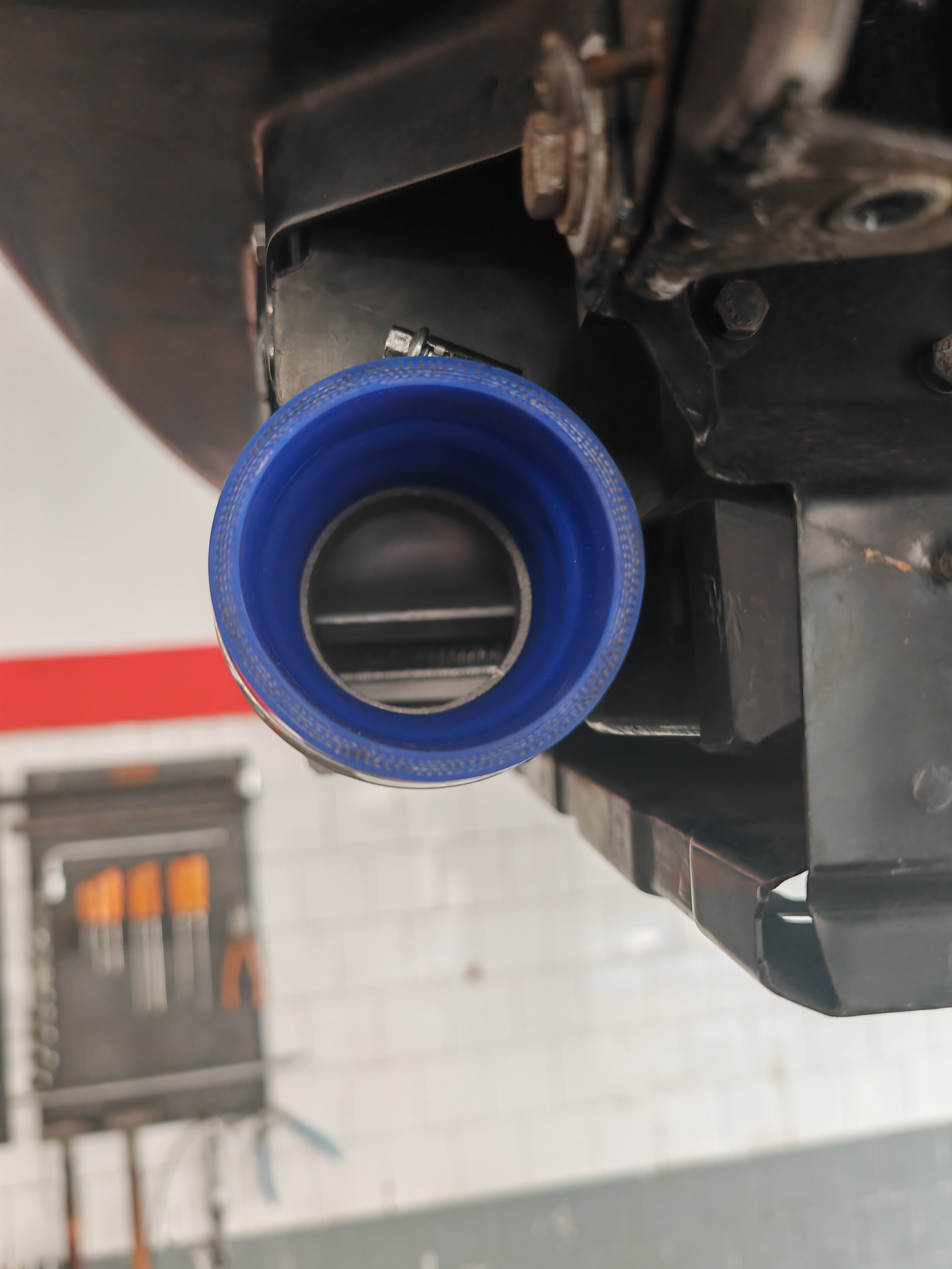

Just to show my 25mm silicone tube found under the car porngases from oil catch tank-not Eco froendly

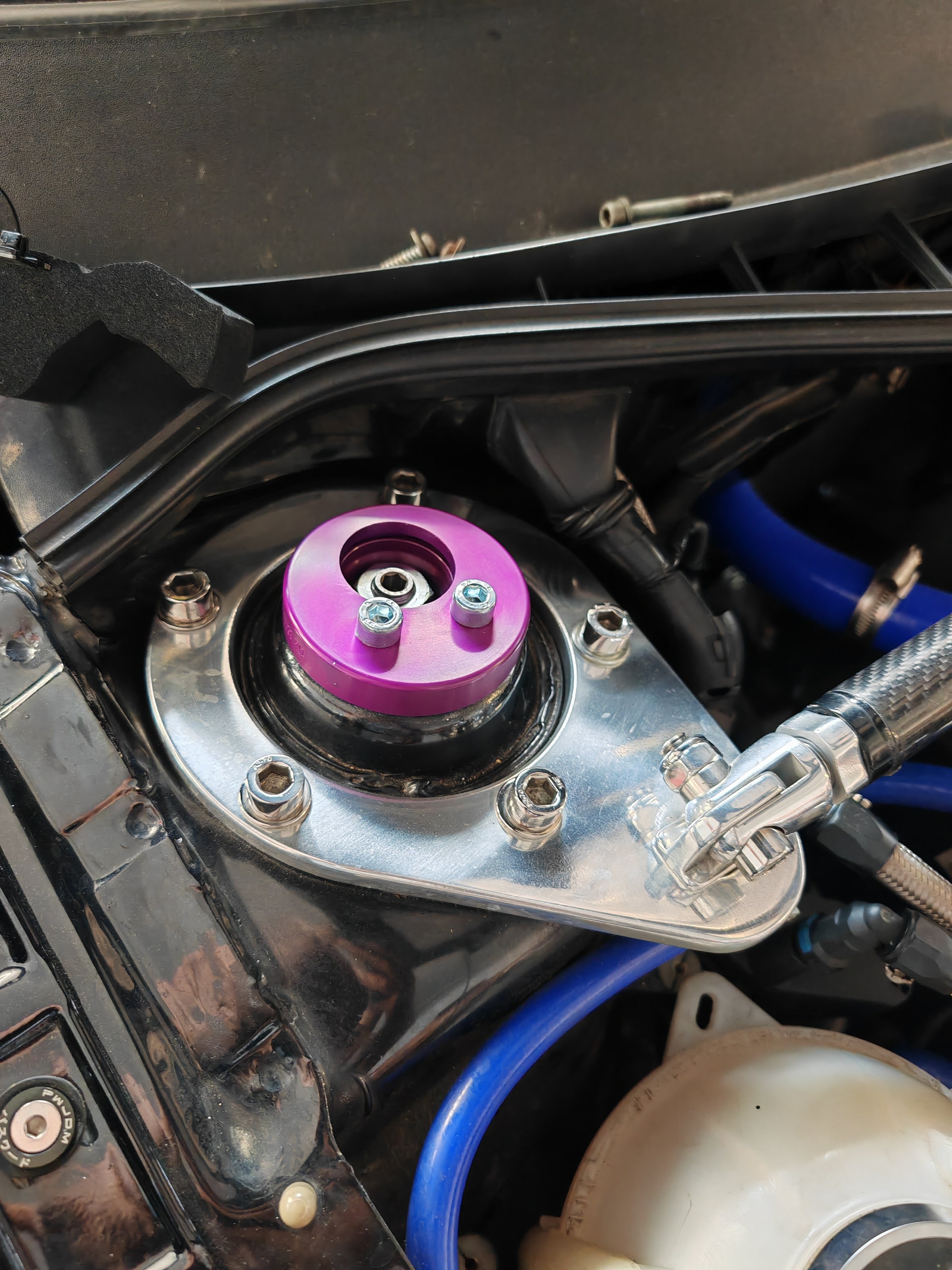

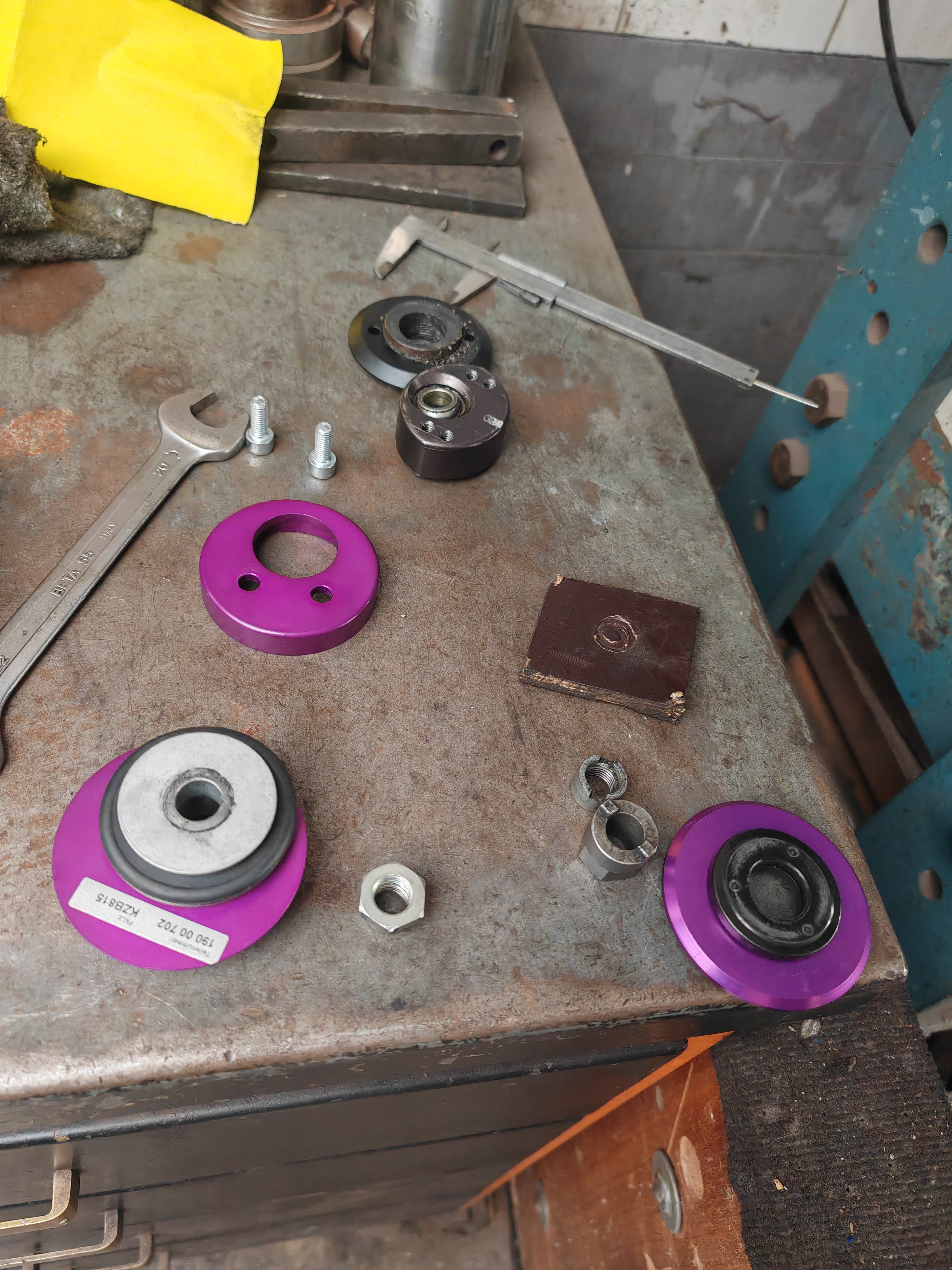

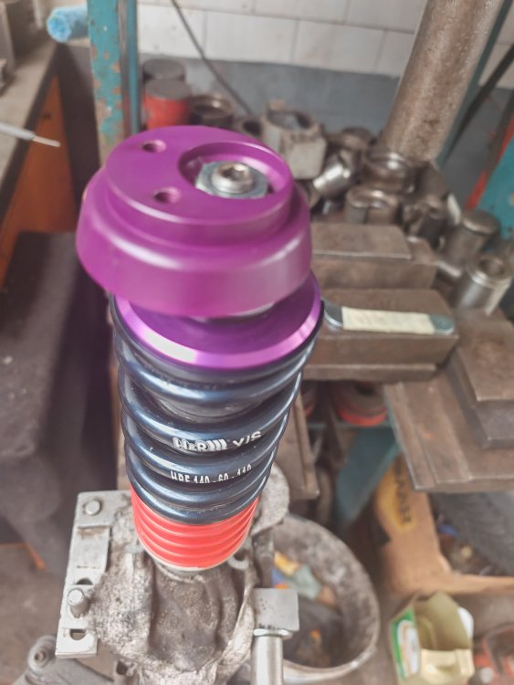

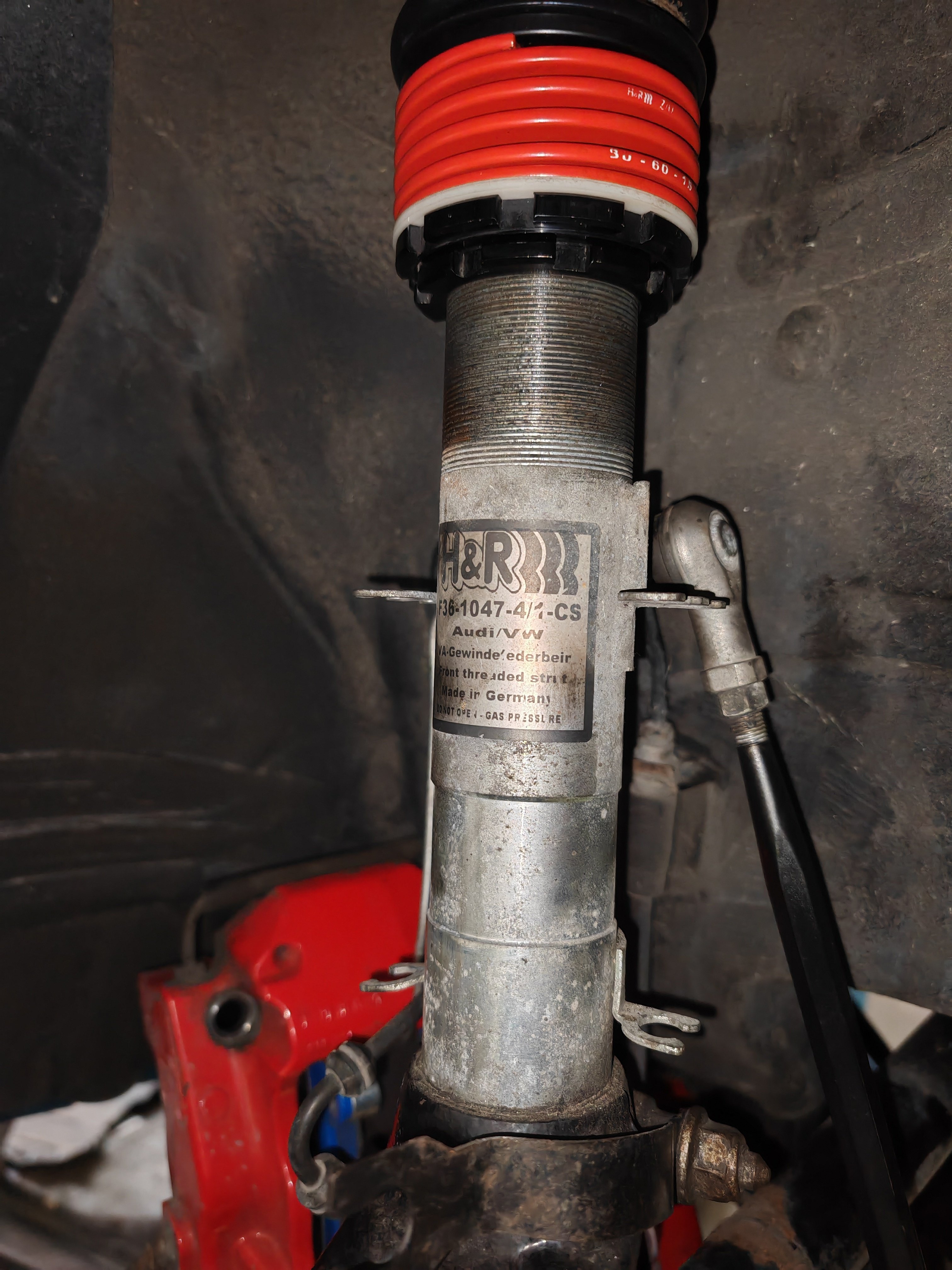

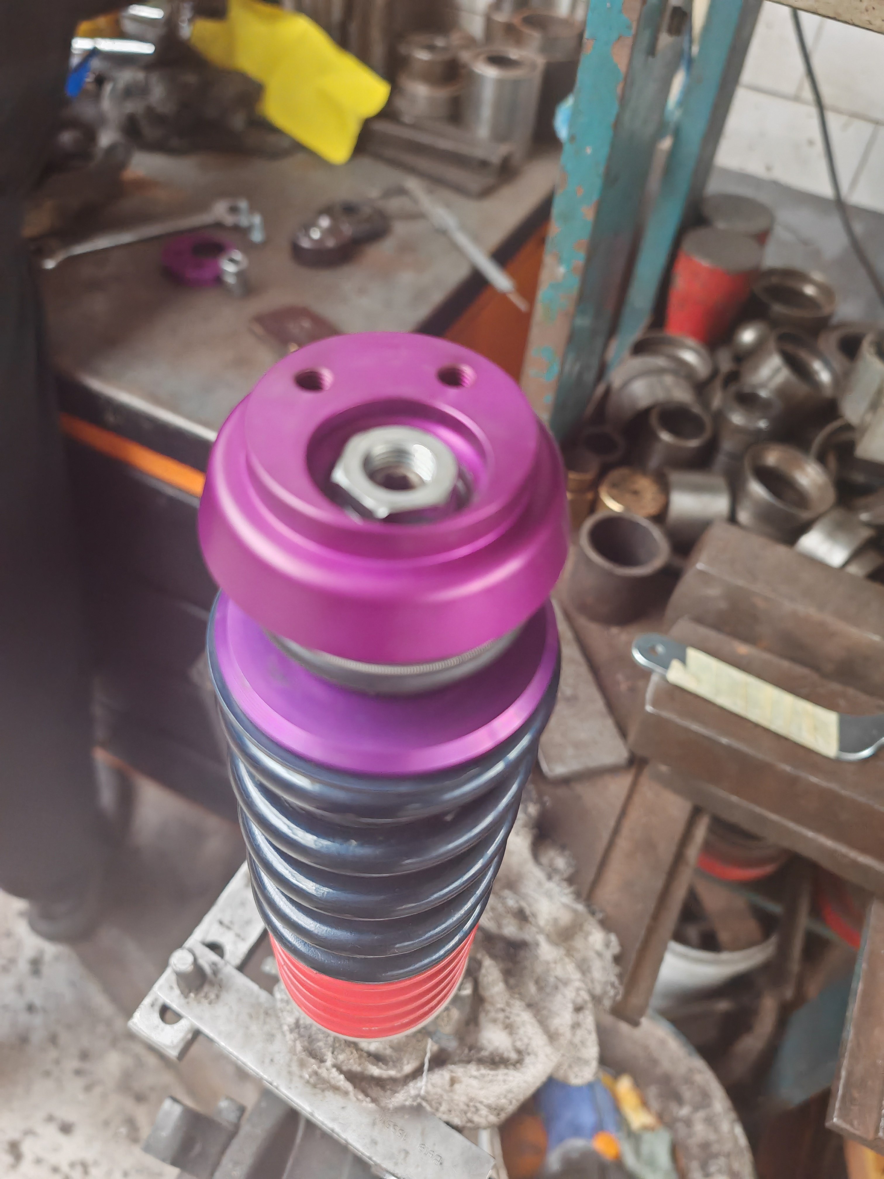

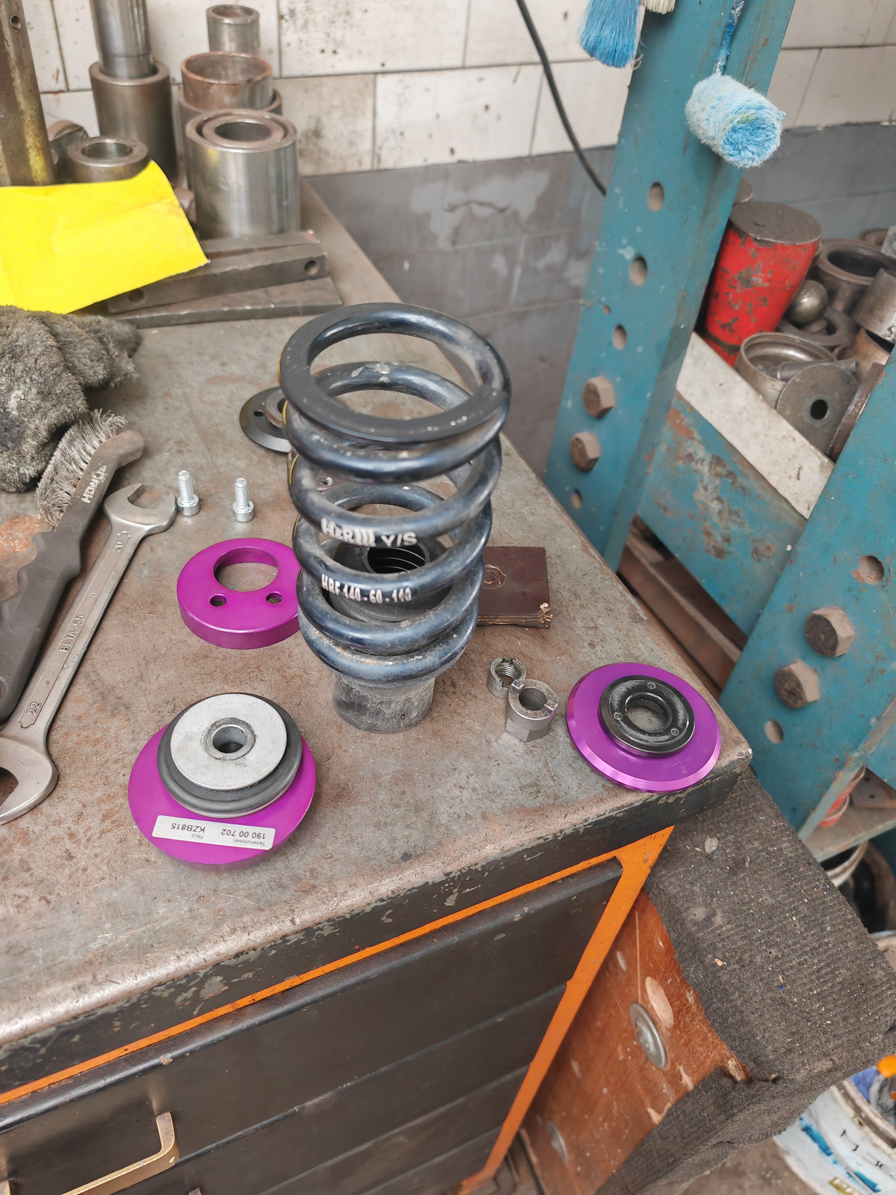

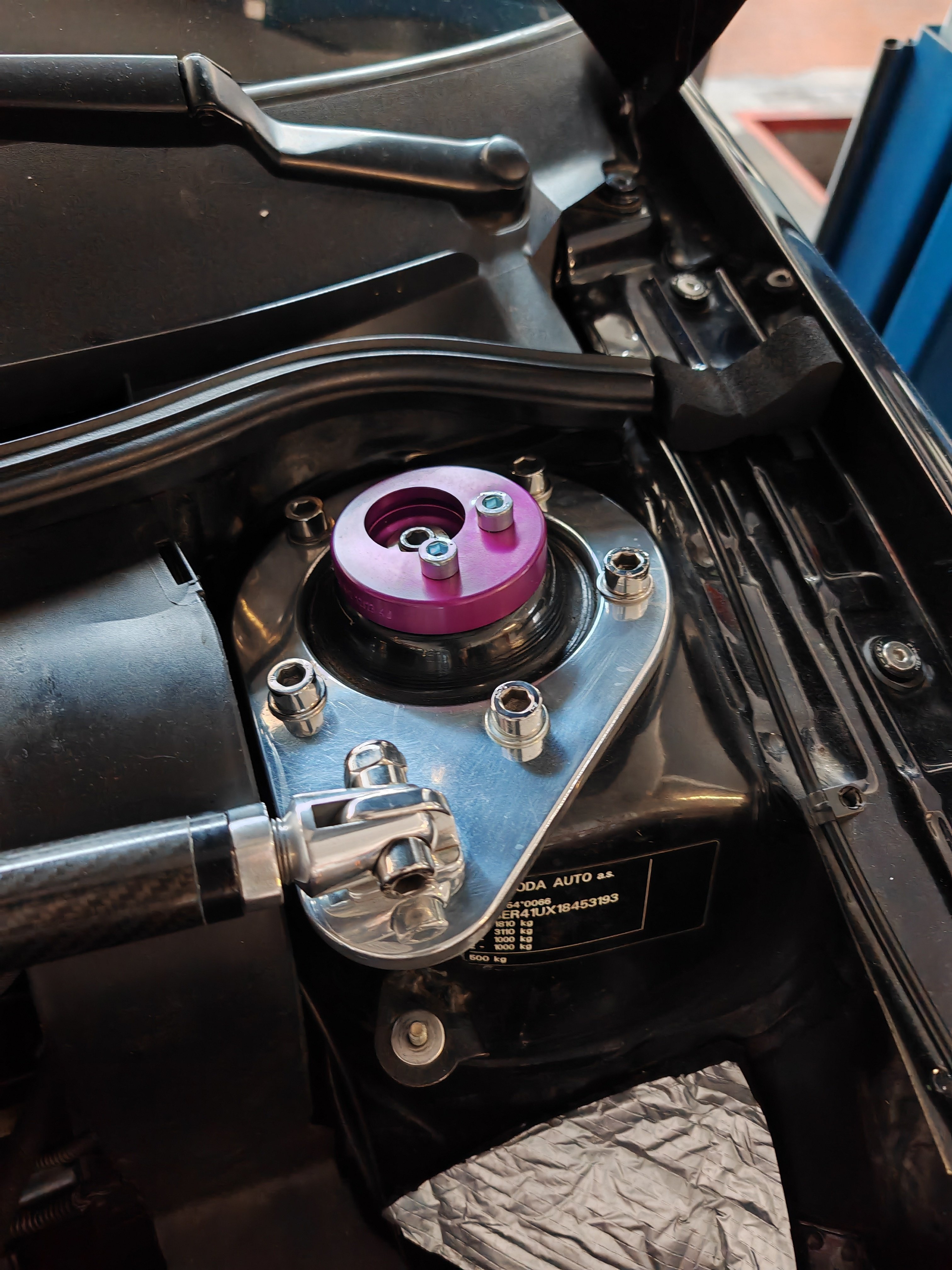

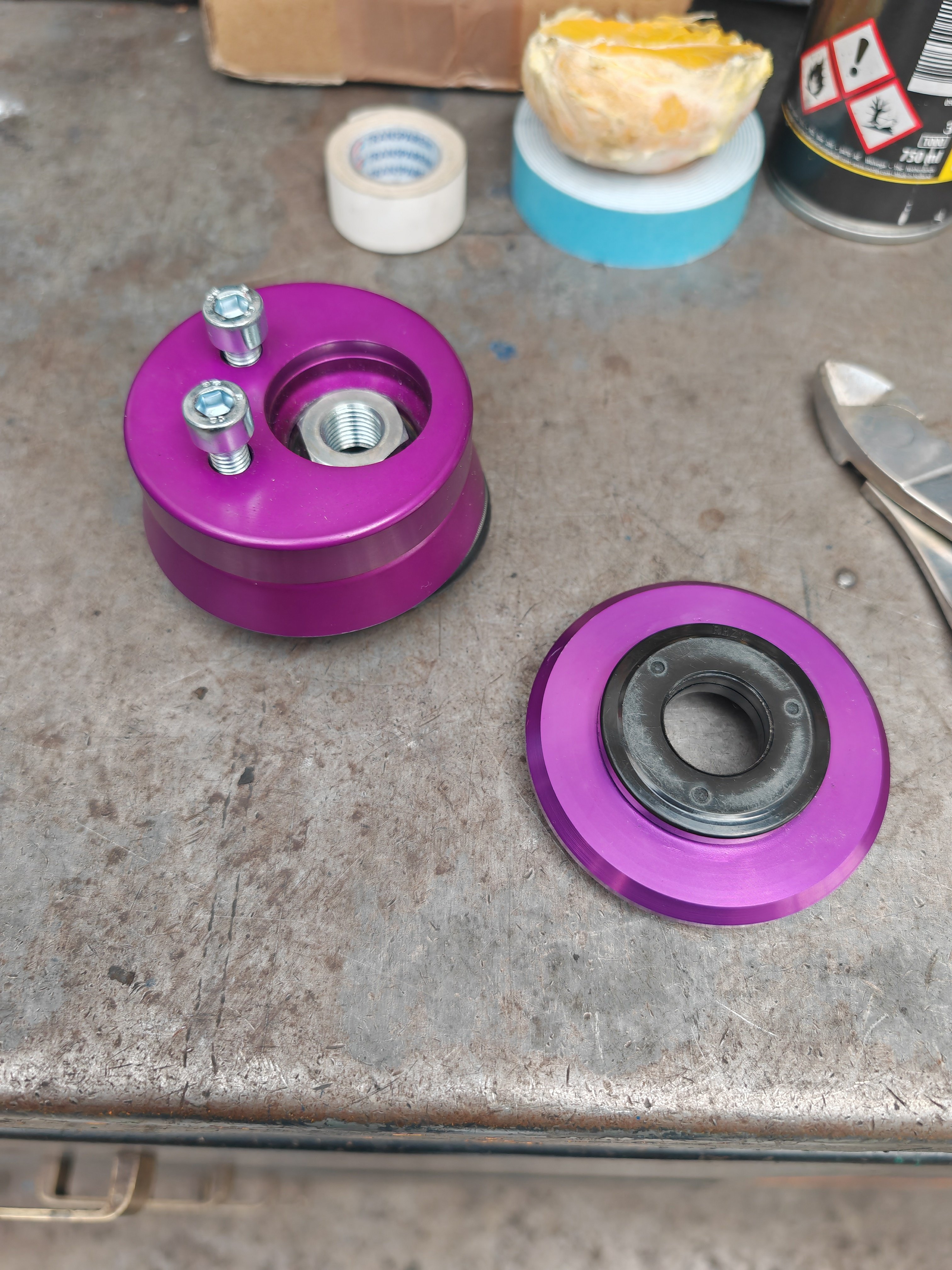

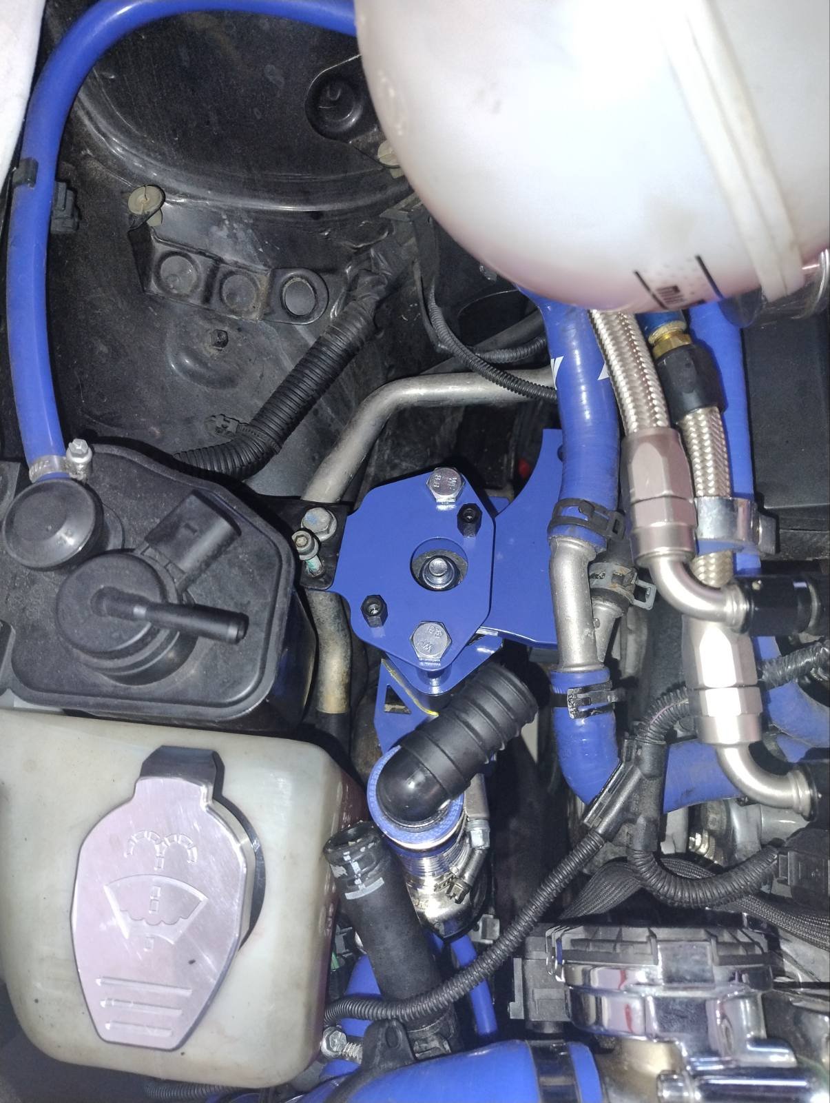

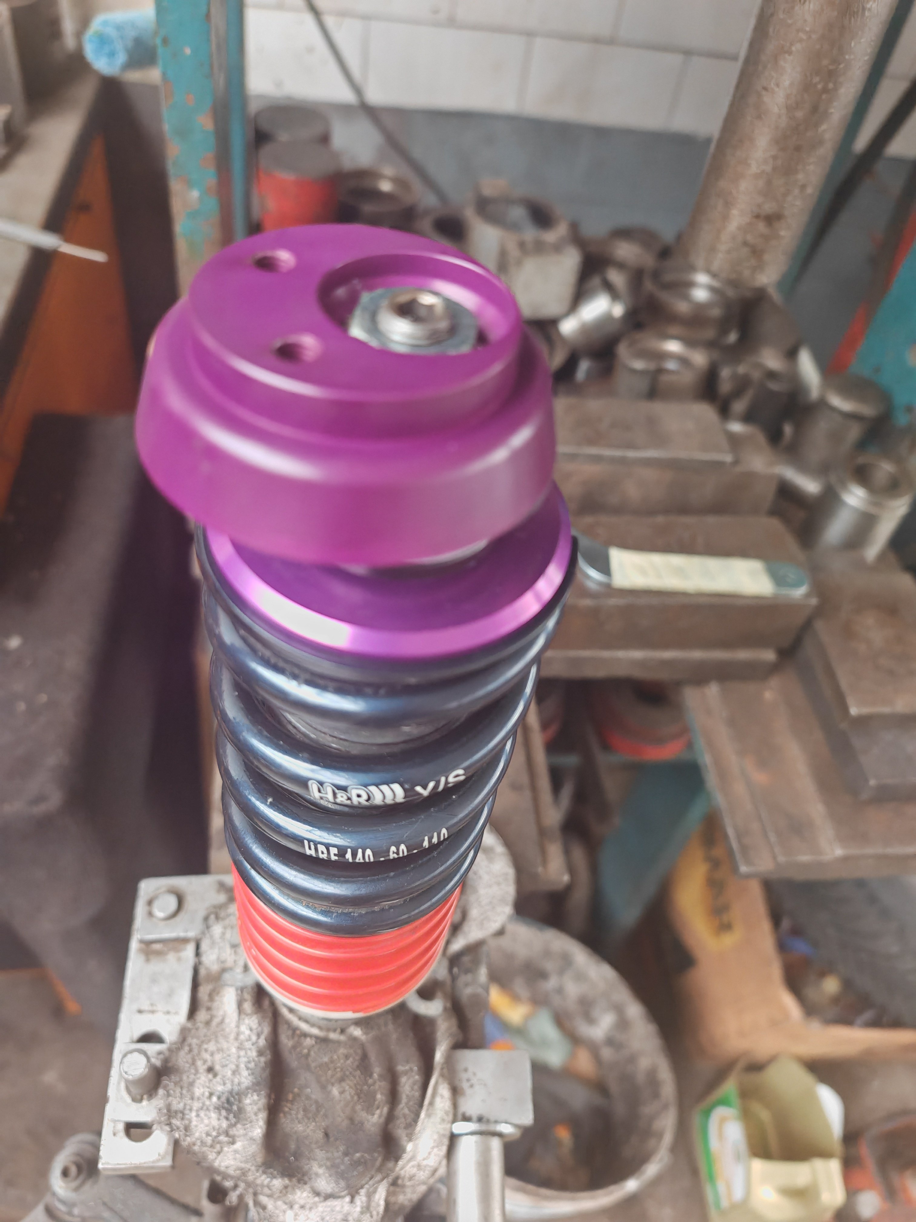

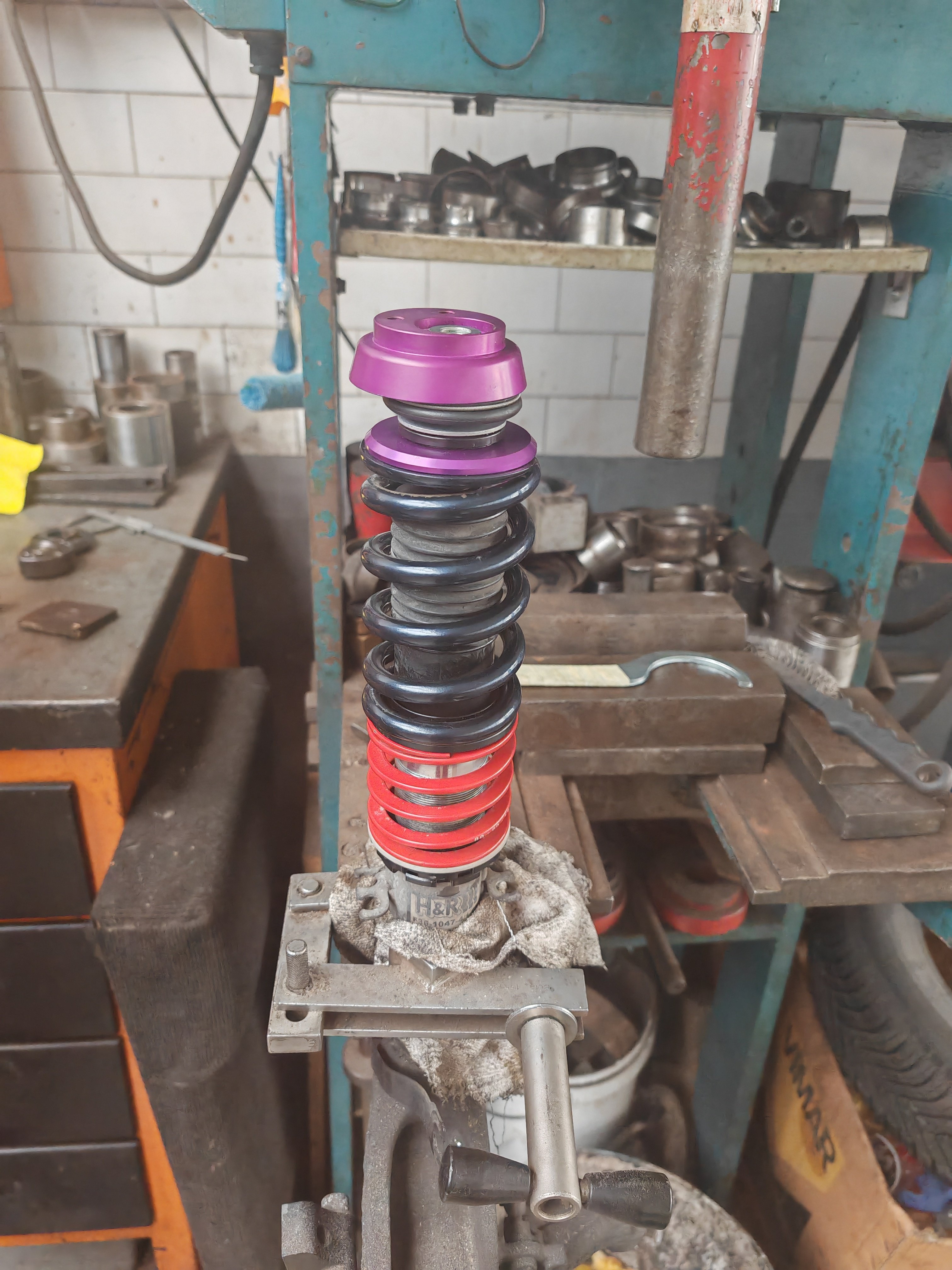

We mounted new top hats, looking great, and according to the look,and construction I expect great function to.

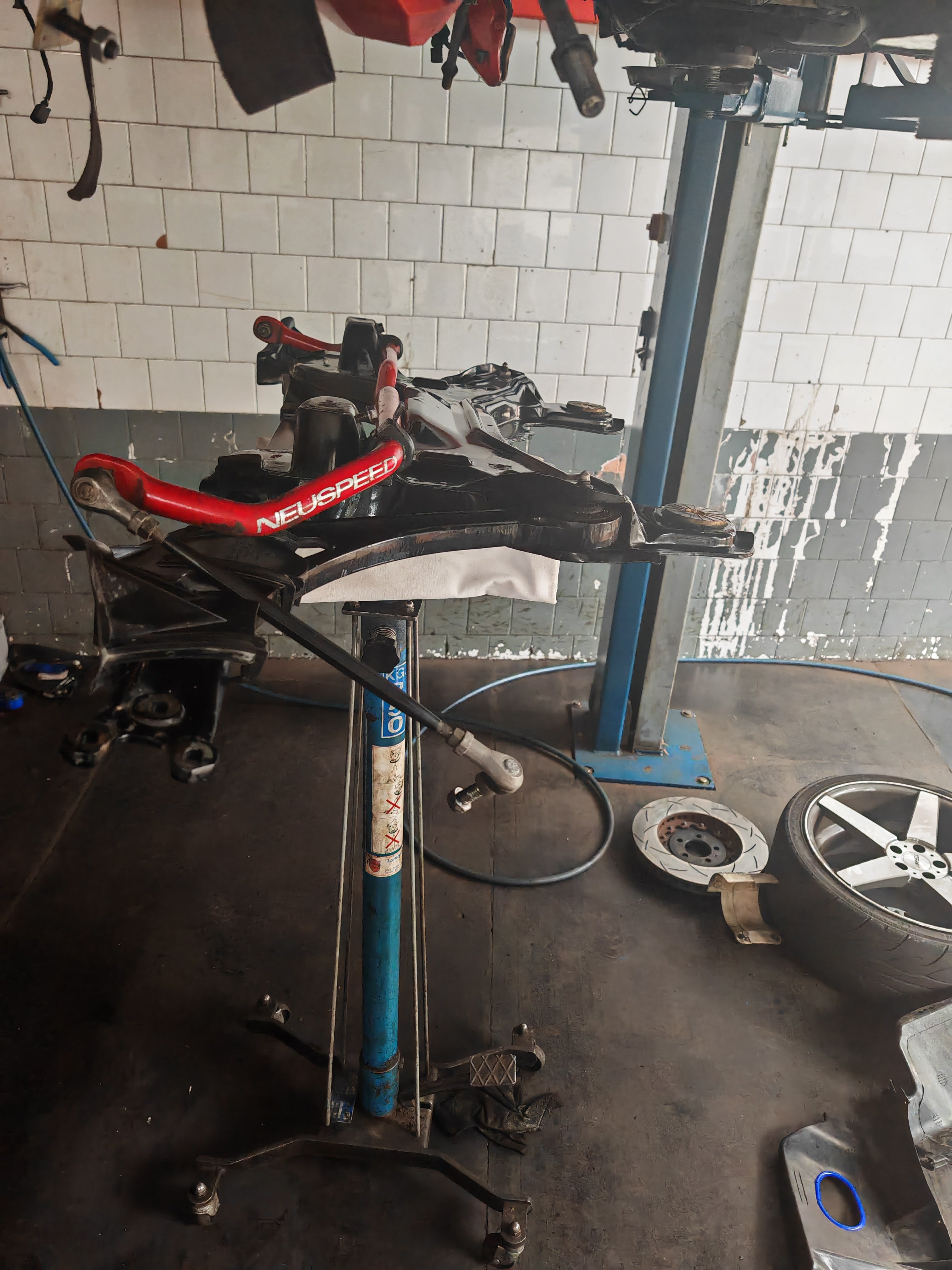

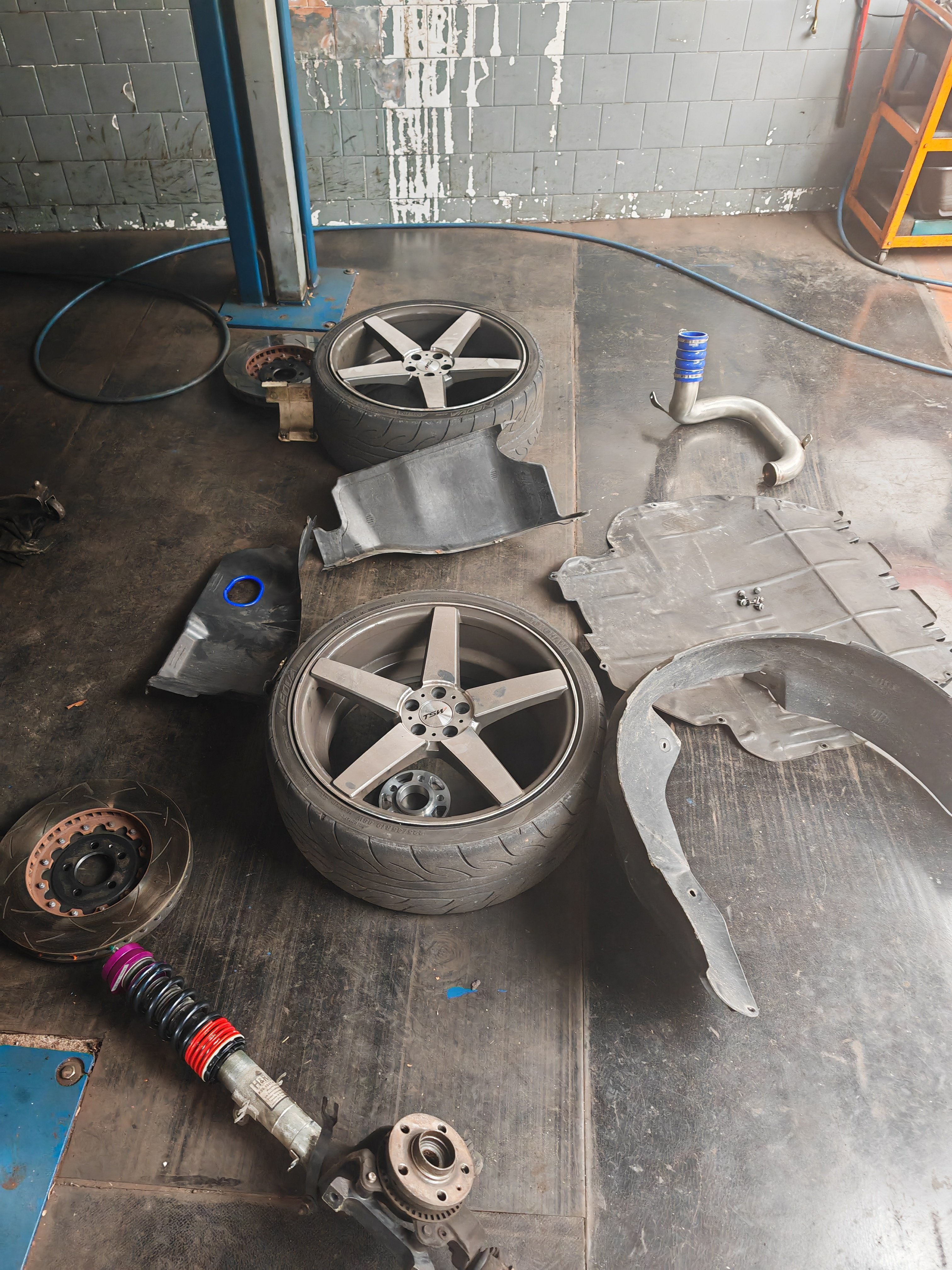

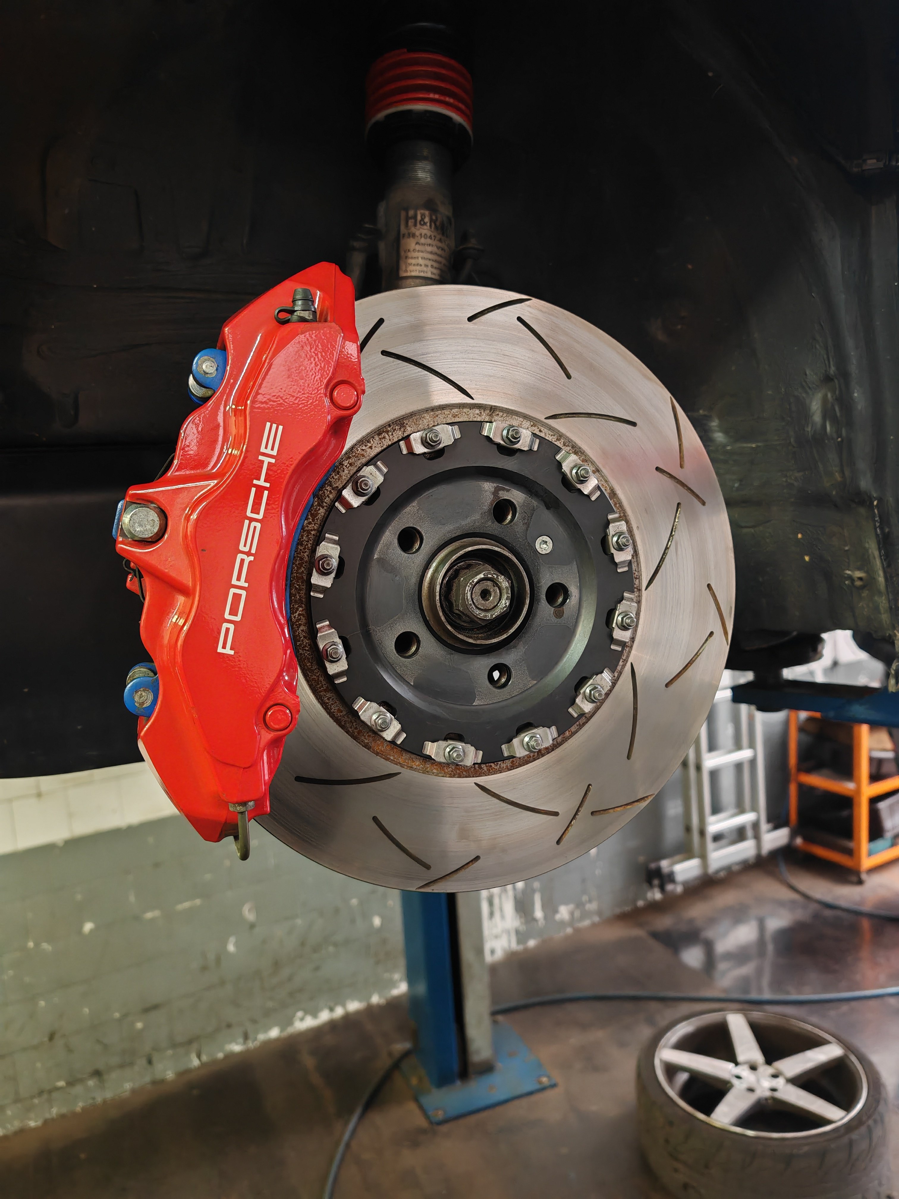

Brake discs, calipers and coils are back on again with LCAs, tie rods and sway bar links, all cleanded as I Like to have them all shining

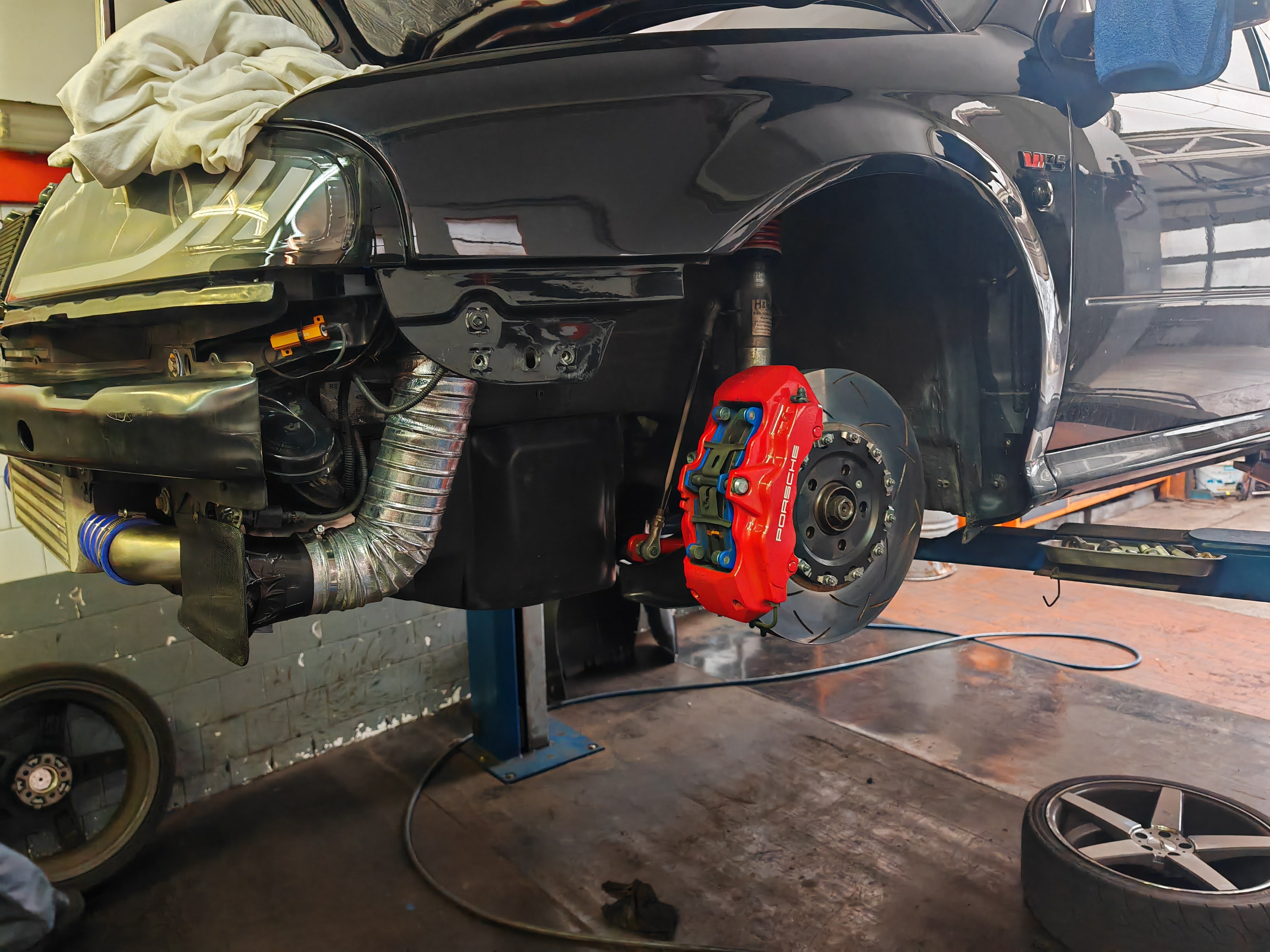

Removed old wire from Xenon balasts, water pump and water thermostat. Still need to put on engine Mount, to see why is right rear (passenger) calipers blocking that wheel from spinning naclward-onnthenroad making squezing sound, they were new Ate and painted red-hope tonsočve that, no more oil letaka whis was notnfrom the rear main Seal,or that gearbox sleve but were driven by thensir from blocknbreather adapter (Crestion motorsport one with 2 o rings) so we used OEM WV sealant to eliminate it and we did it, but I am planing to bore that adapter to a larger inner hole diameter, because it is funny small compared to AN10 adapter on it-and thus not fully functional😇😇😇

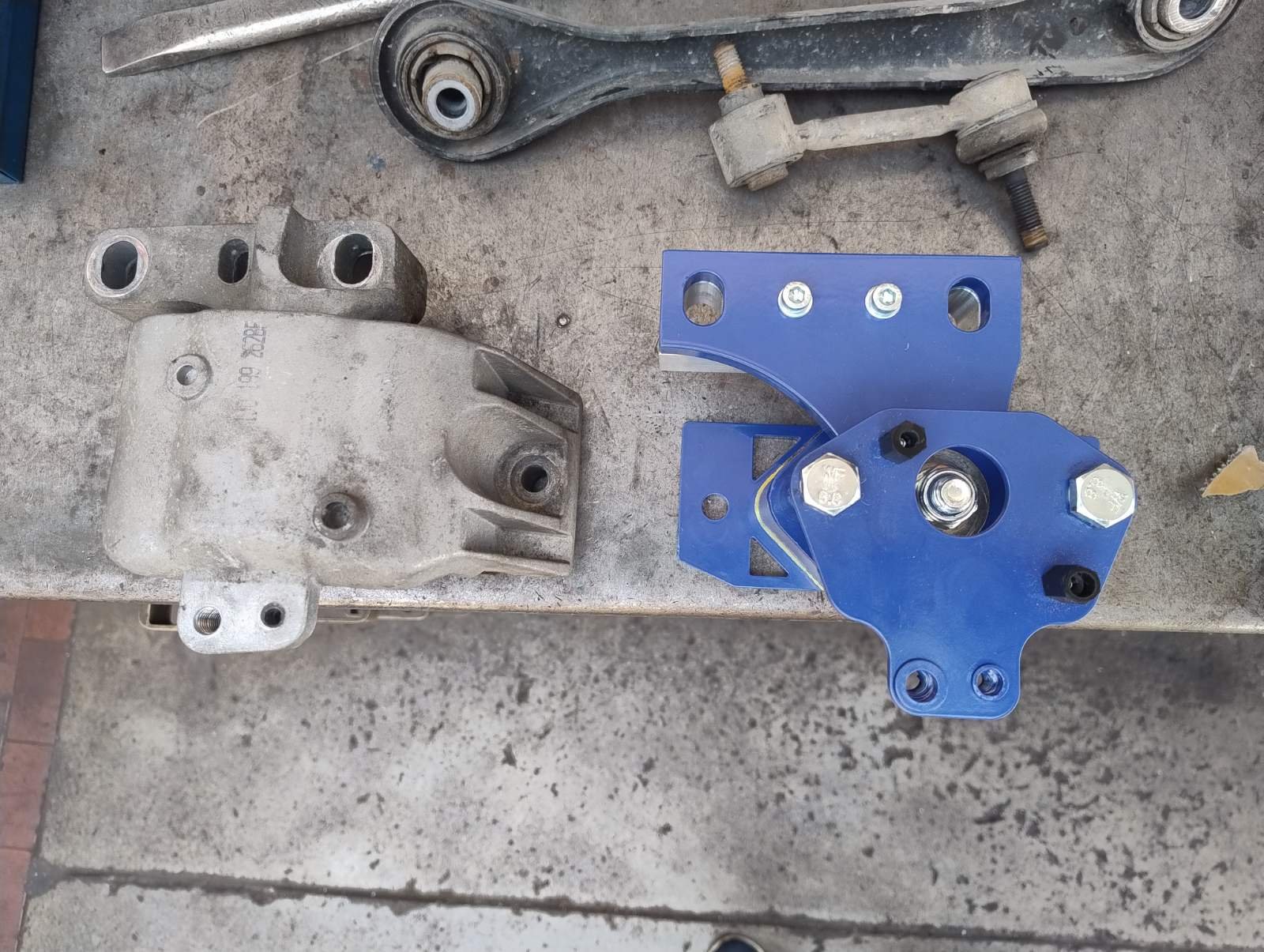

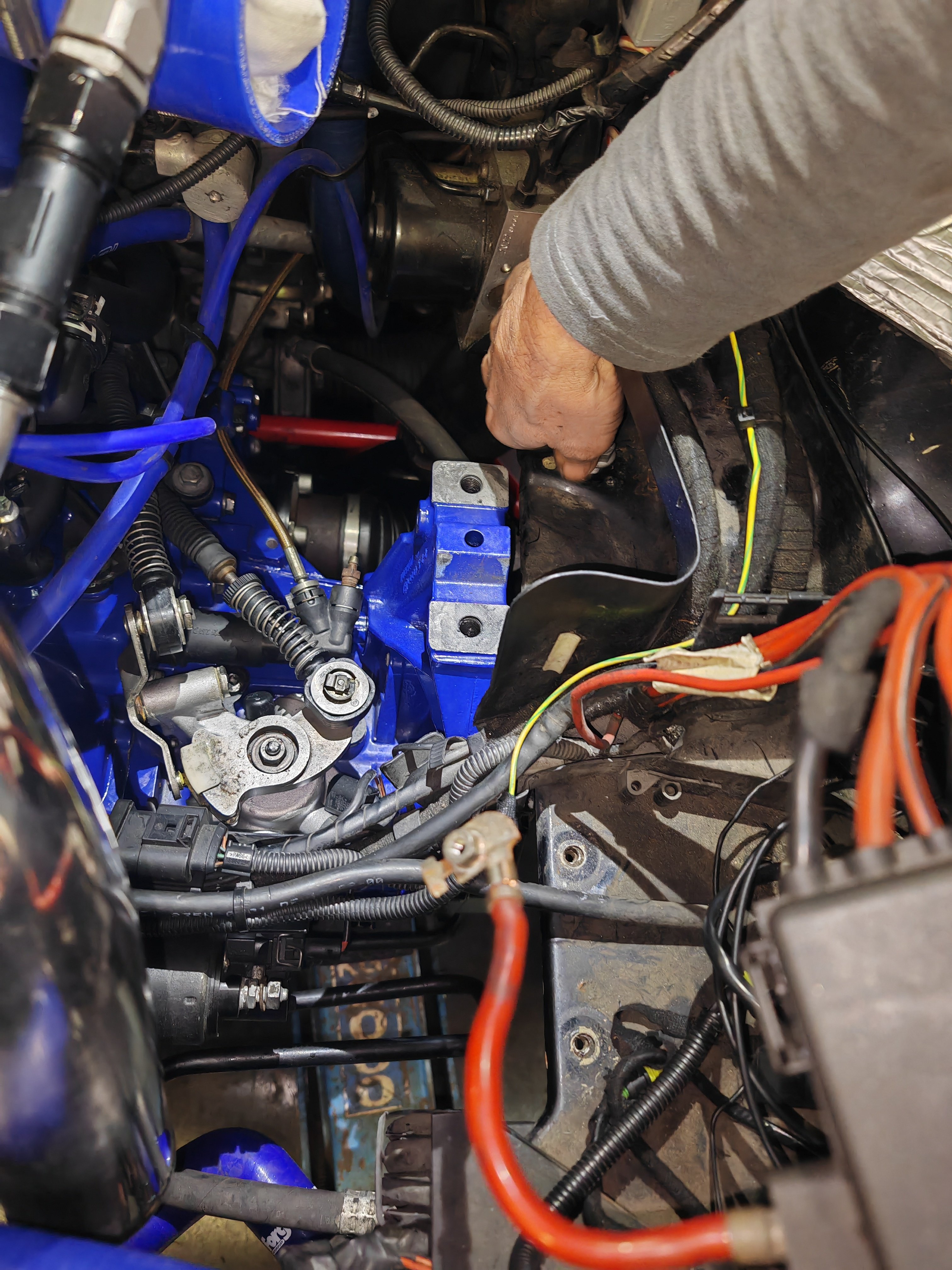

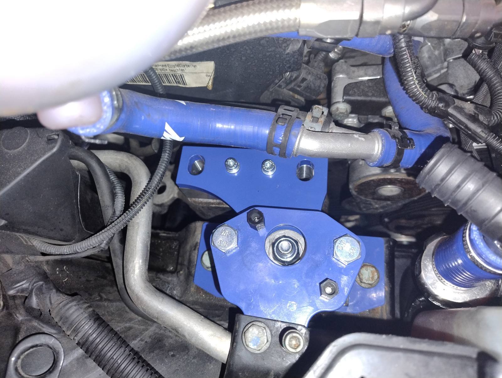

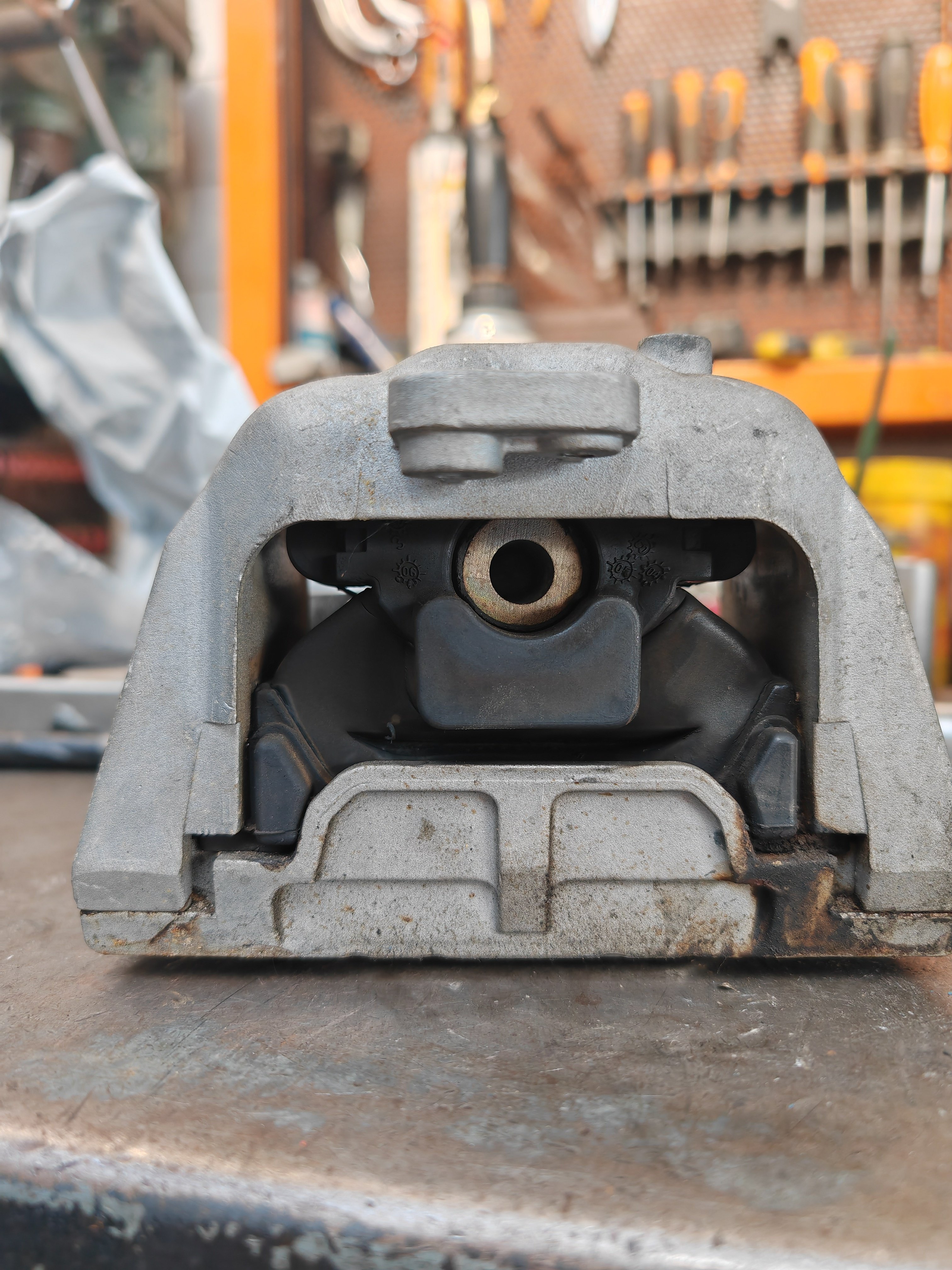

IMG_20240319_162809_1.thumb.jpg.4064b1c788182c909338cf4d82ef6c05.jpgEngine mount also installed. Old one was pretty colapsed-bolt hole through rubber should be by half covered by drame from upper side
Edited by davojuri
So first impressions are great.
1. engine and transmission mount from VibraTechnics is top, no NVH increase

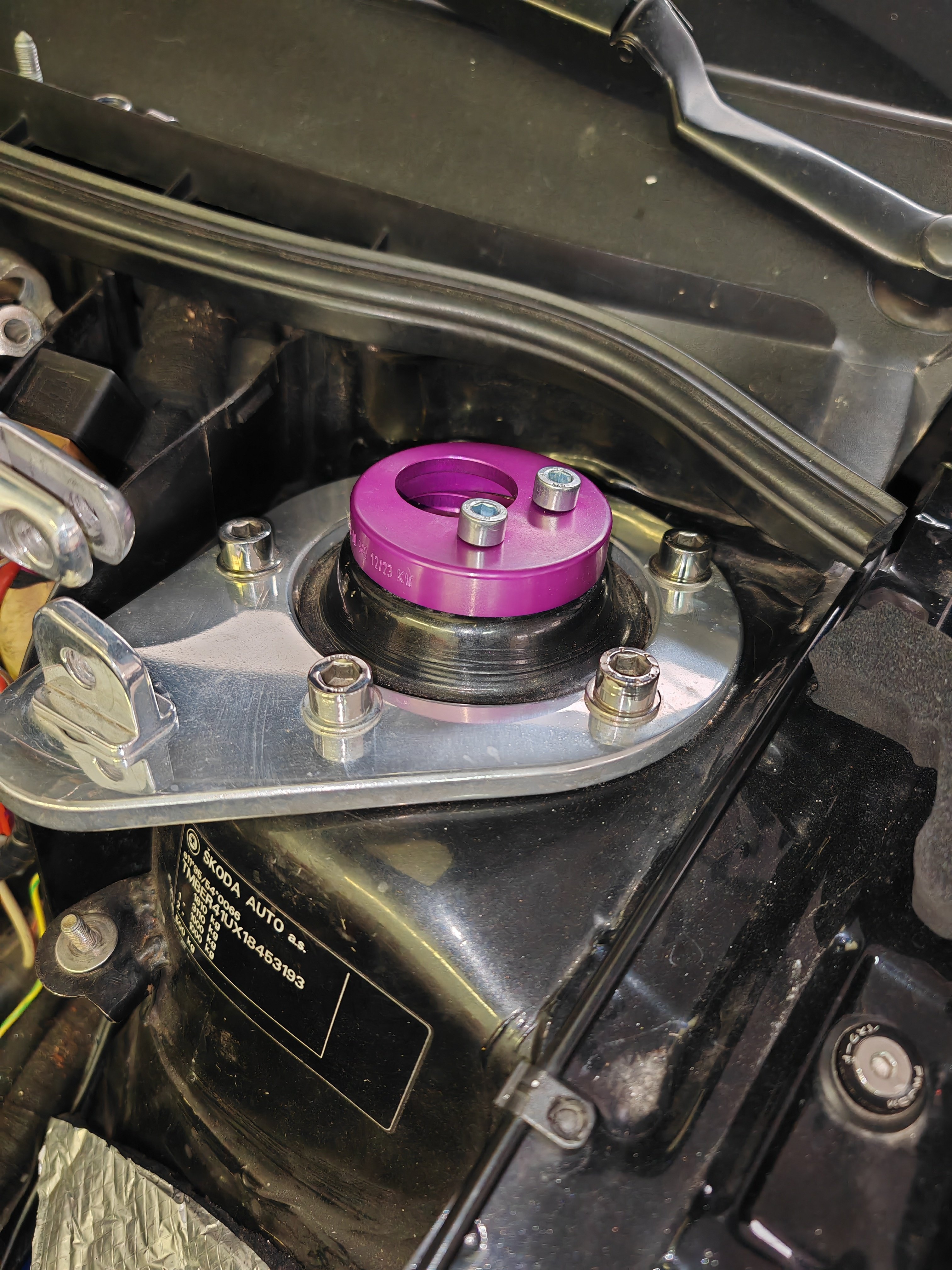

2. KV top hats are far better than old one
- no doing doing sound by wheel turning
- no noise over every bump or hole in the road-simply can't believe

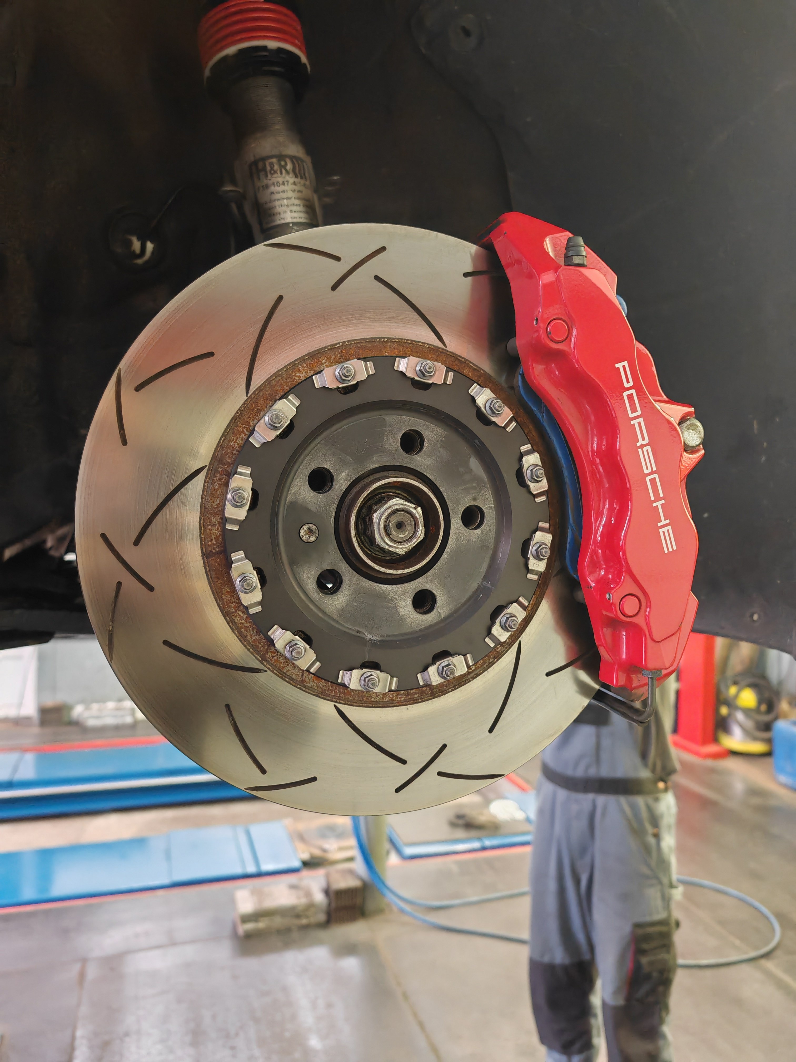

4. we worked a little on rear right brake caliper-was stopping wheel from backward rotation-squeling sound-its gone.

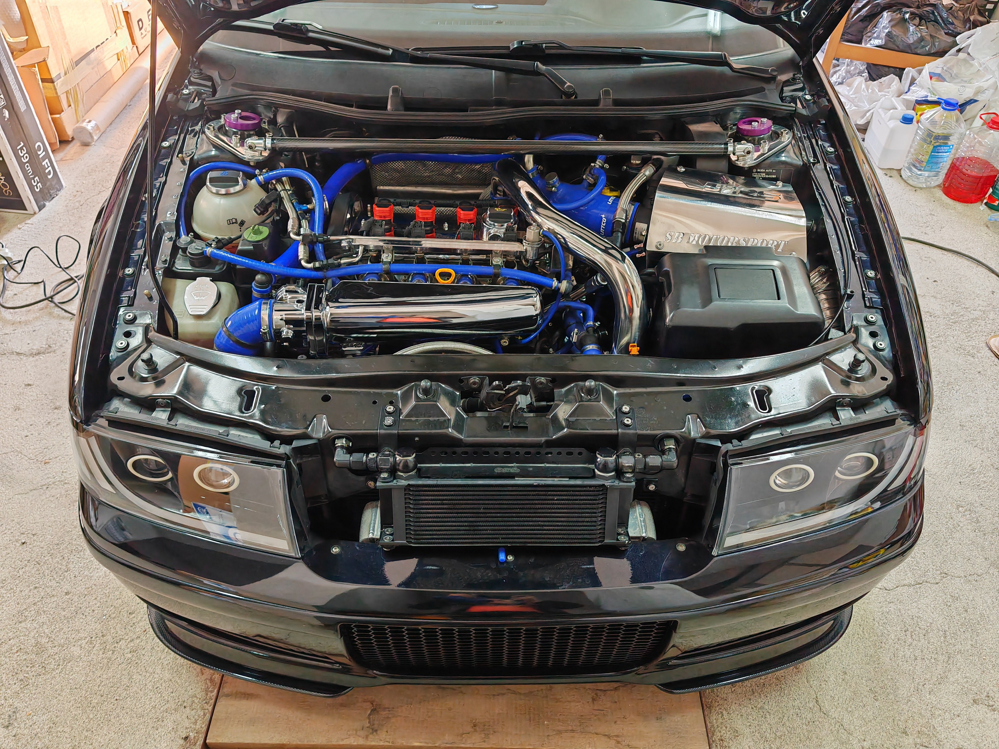

So now I can take final pics of my black mamba and advertise it for selling if there will be a good buyer. lets see.

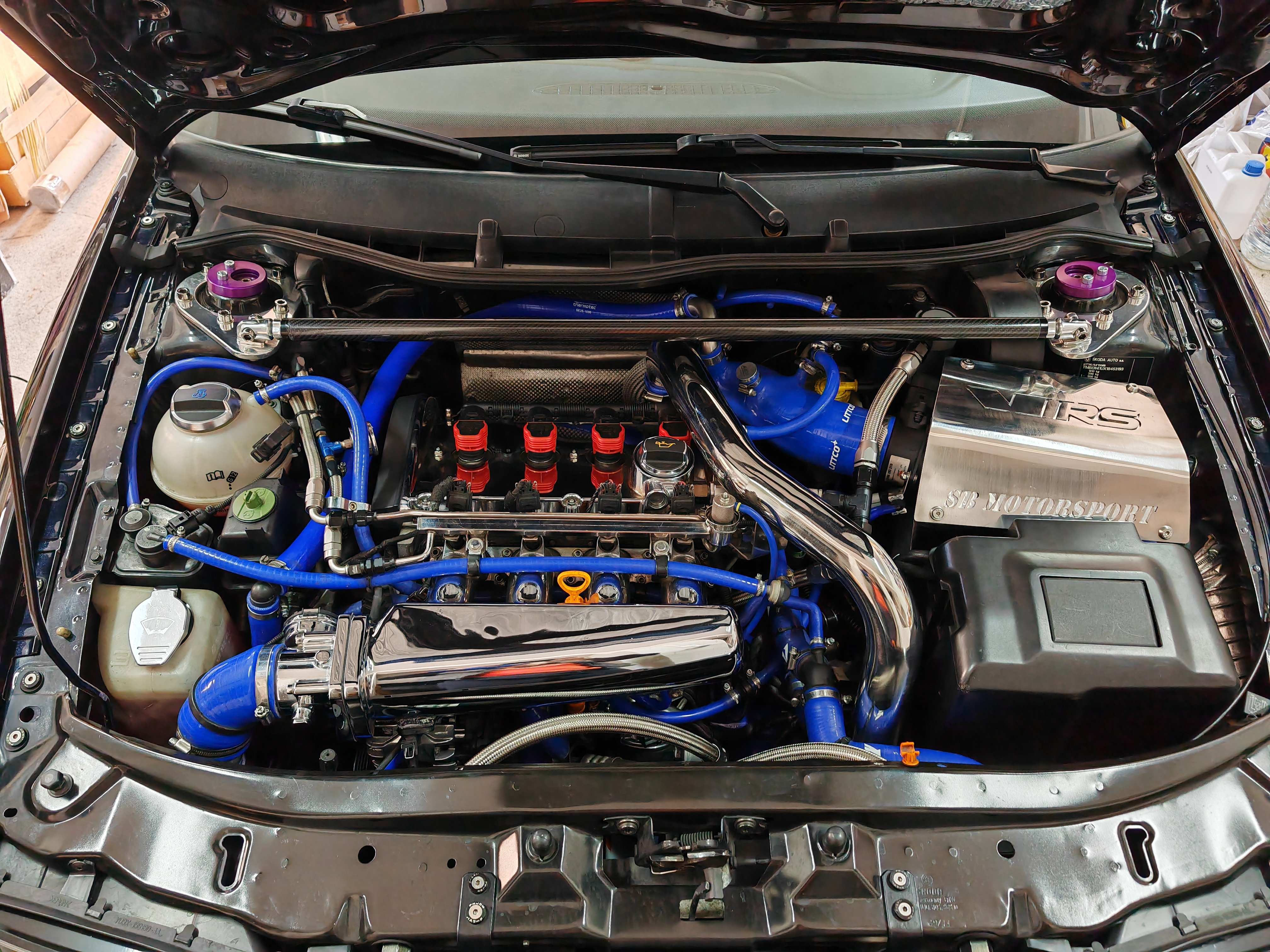

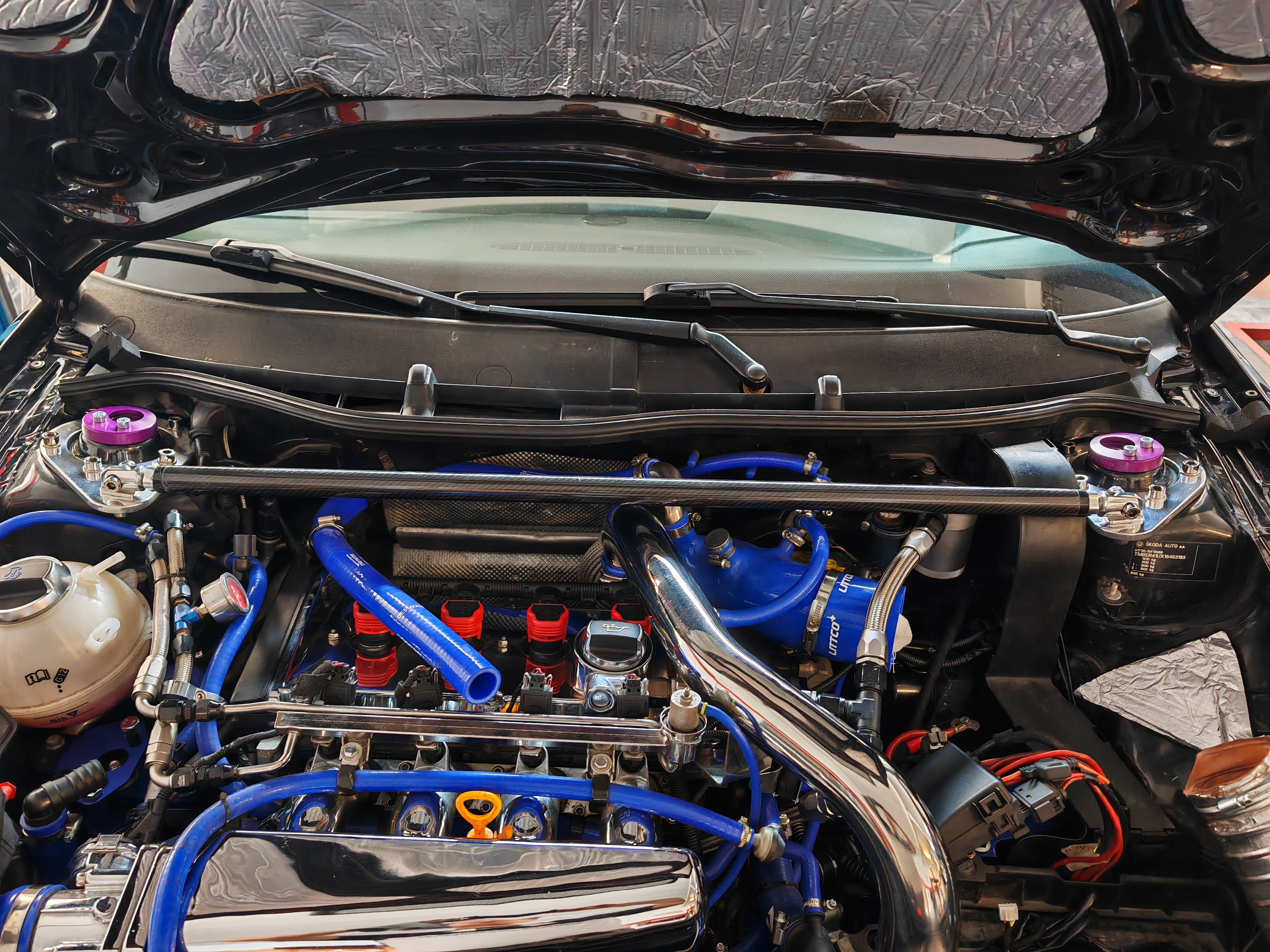

Lovely engine bay😀

had mine on 5 years now i think (thread lock is key)

My friend Loctite is for sure one option. I just found here at page 12 that I already have custom made reinforced that part so I asked my friend in Čačak, Serbia Miško Herc tuner to make new one with longer bolts, that's the proper way of instaling it in my honest opinion. Will keep you upfated
let me know what you think of them
