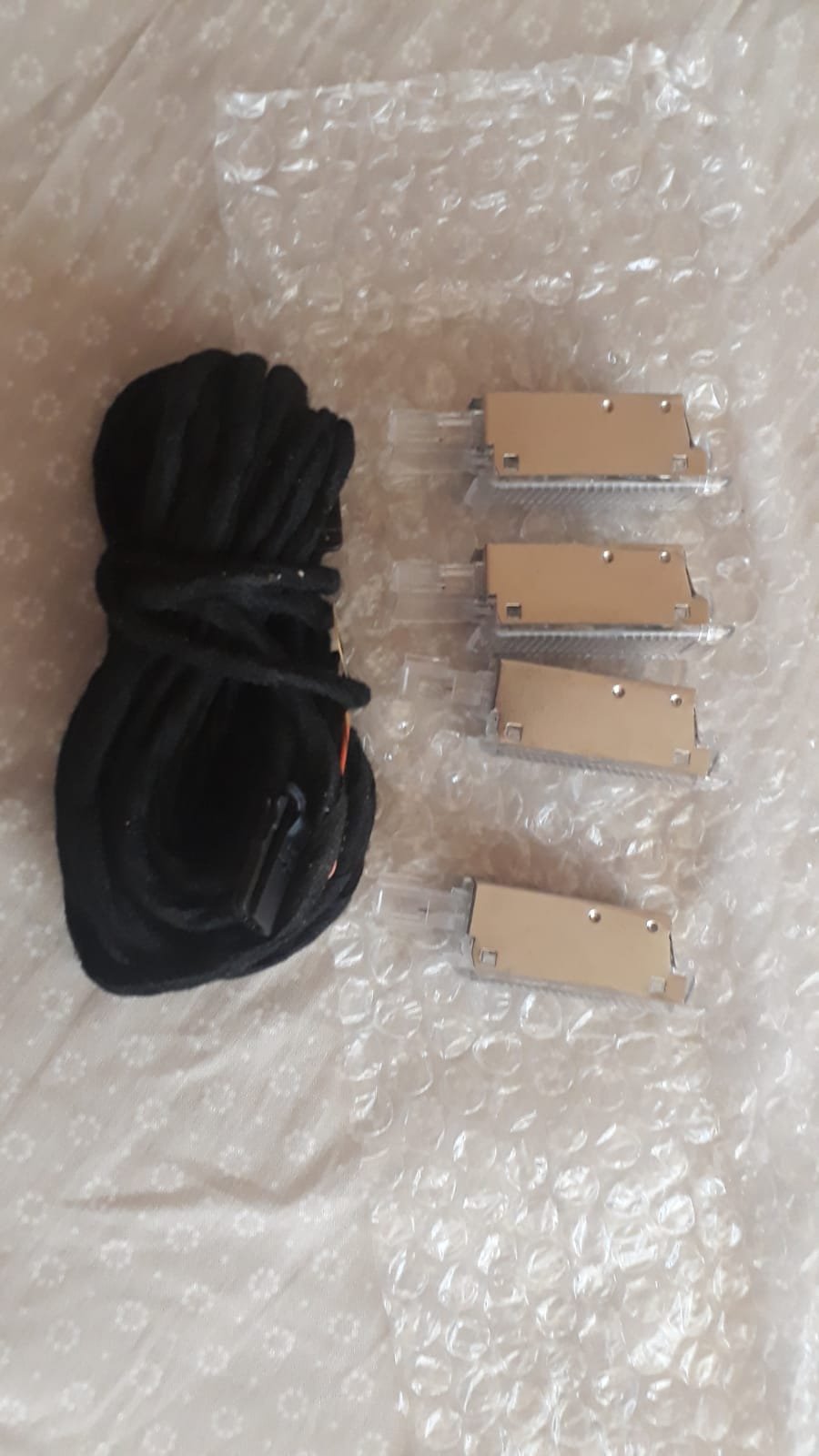

Hello guys.
Mykit came through the post but why have I got a double CECM pin and double earth connector?
Because you have a front loom and a rear loom, the kit I bought (boldsport) used a single loom for all 4 lights.
You will need to splice the two CECM looms together.

Cheers for the reply Gizmo.
Yeah just thought it would come as a single loom as you say.
Shouldn't be any problems with just soldering the two cecm pin wires together. Earth I don't think I'll need to as can just fit both connectors to the bulk screw.

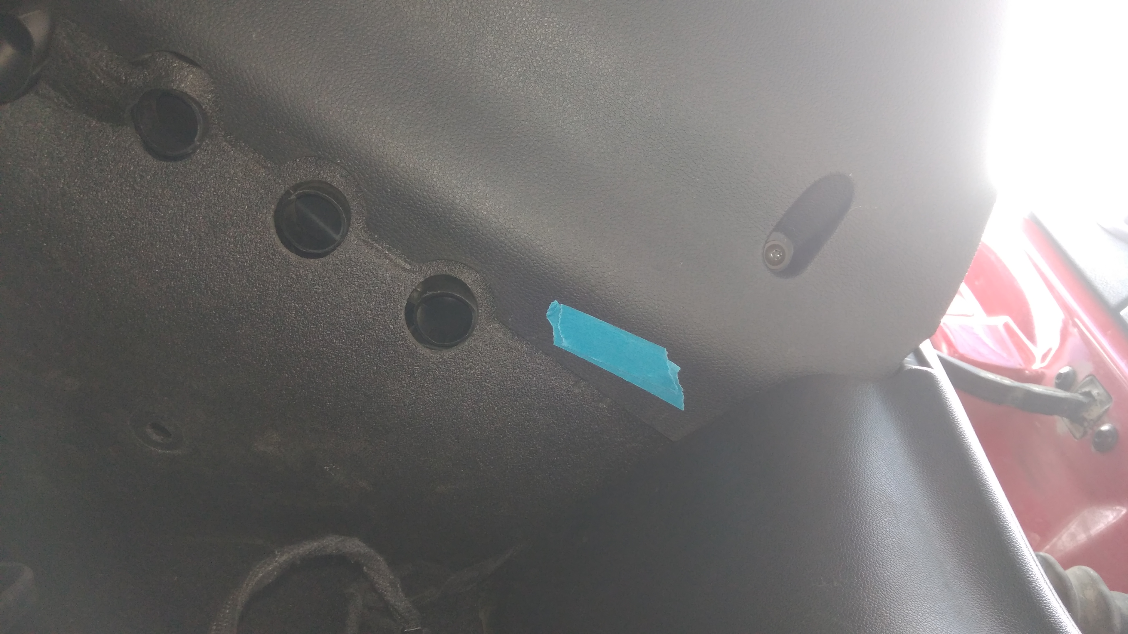

Hi everyone,
Did someone tried to put footwell lamp (on passenger side) in to the hard plastic (let's call it glove box surrounding)?
I've searched perhaps all boards about footwell lights and everybody were cutting holes in to soft panel. Is there the only way?
Edited by Marewx
20 minutes ago, Marewx said:
Hi everyone,
Marked posible spot with masking tape. There's free space behind it. What do you think?
P.s. it's RHD.
Edited by Marewx
Think I tried this by moving around before cutting but the light didn't look very uniform. Obviously, mine would have been the opposite side as your car is a Euro model, and I tried it on the centre console side, not the door side. Depends what you're after.

On 21/05/2018 at 14:32, Marewx said:
Hi everyone,
Not in the hard plastic because it wouldn't be in the right place.  I've fitted mine in the foam, and in a similar location in the hard plastic on the driver's side.

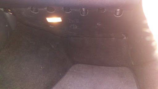

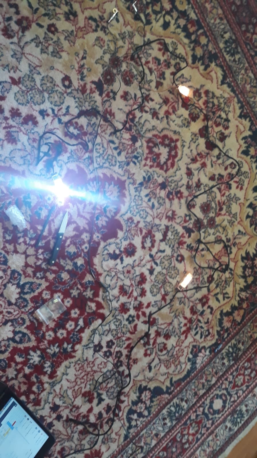

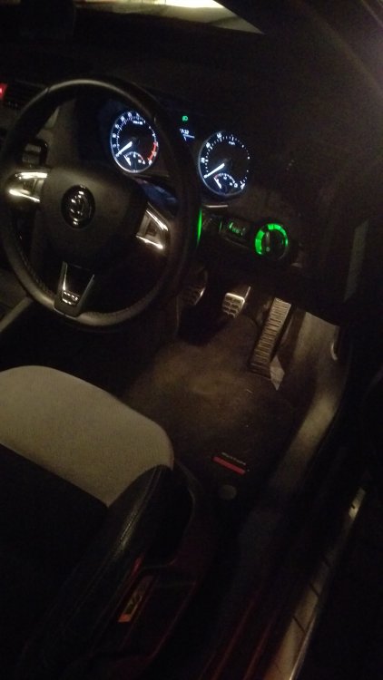

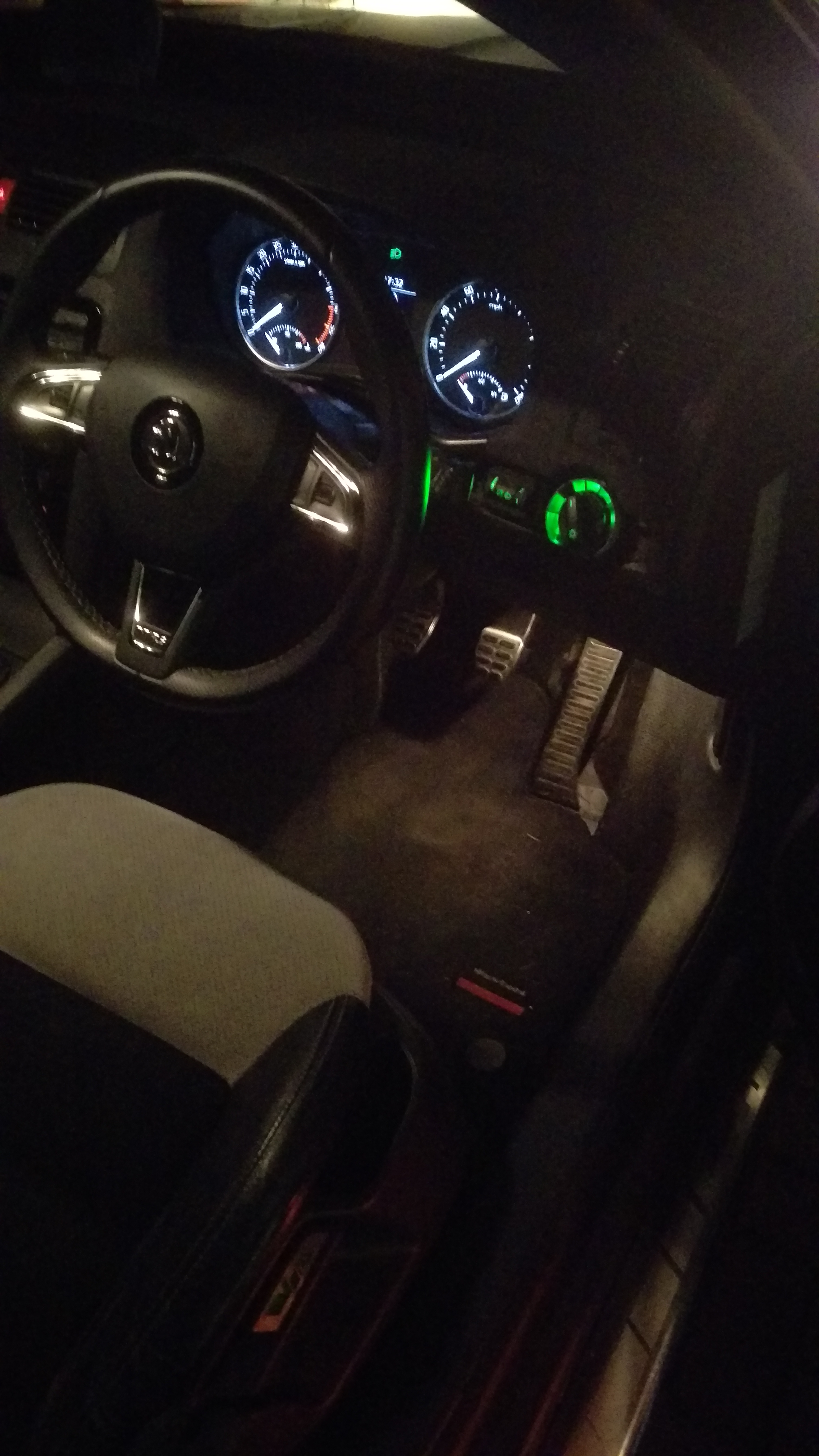

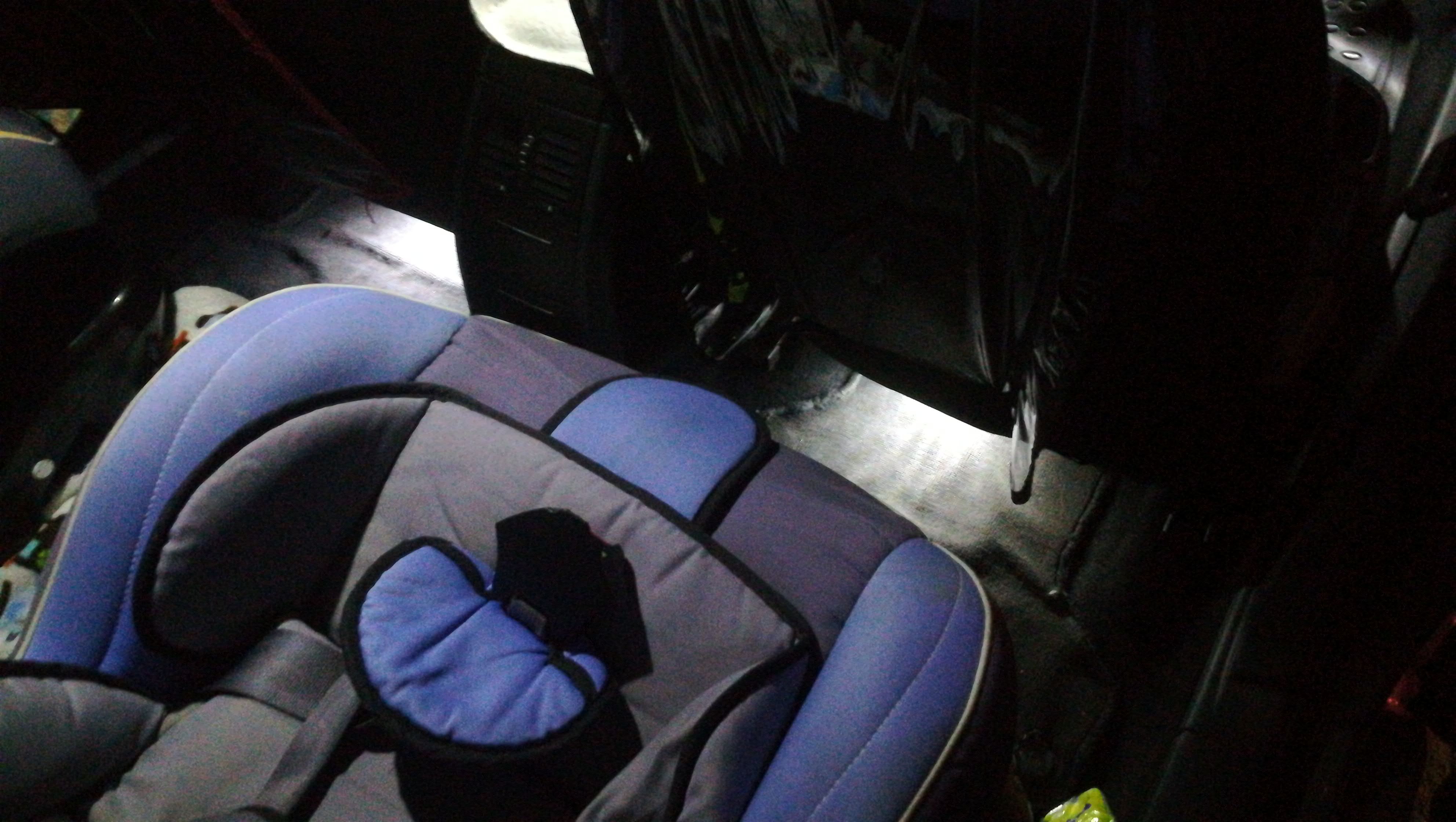

Hi there, today I mounted myself the footwell lights on my Octavia 2, MY2008, non-FL, total cost 18$ and 194 minutes of labor. Thanks all for the tips,  I am pleased with my purchase and LED lighting (lamps came with normal bulbs) . Pictures attached.

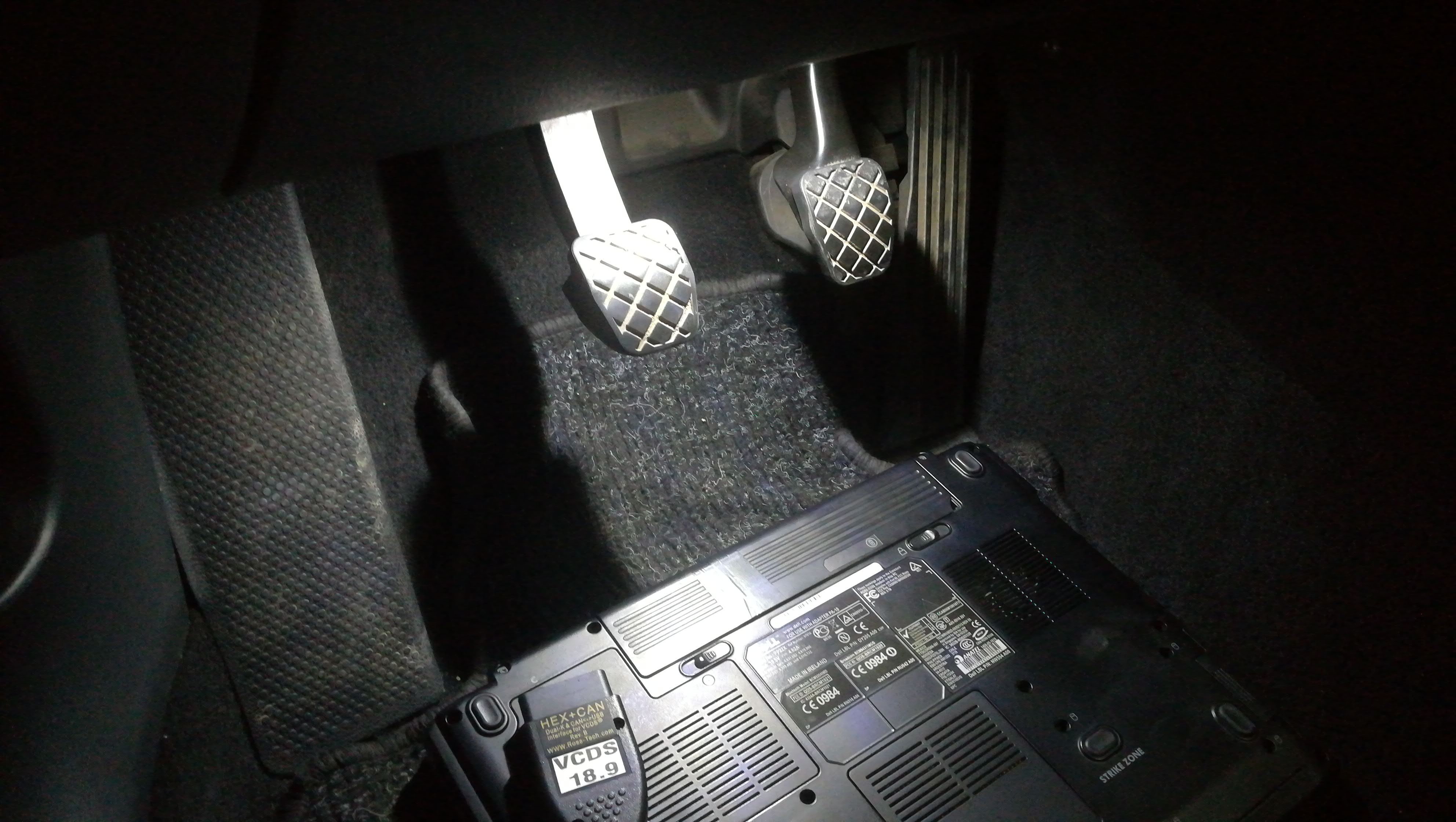

All fitted and working 😁👍
