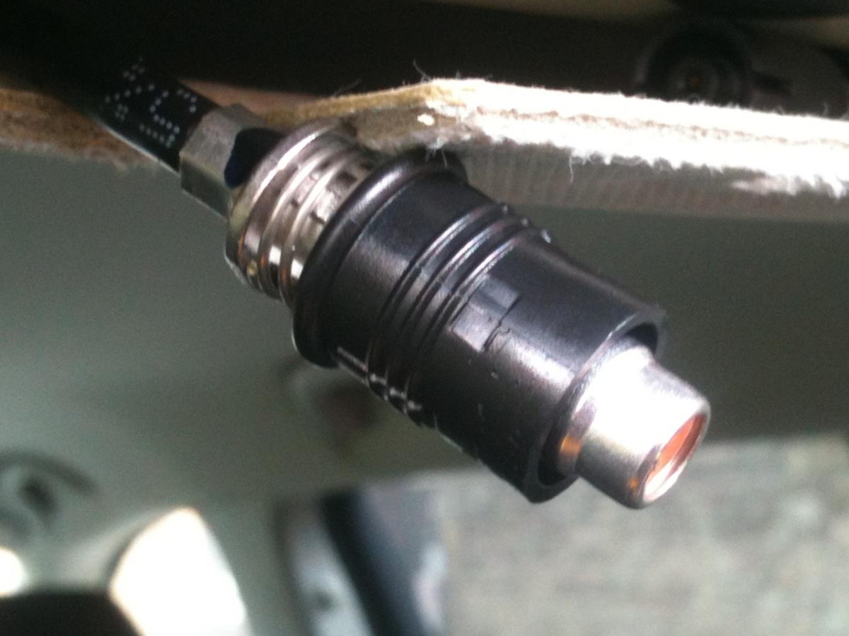

This is the standard connector on the Octavia 'whip' aerial base, but can anyone confirm for me that it is called a 'DIN' connector?
Or is it called something else?
I'm planning to extend the existing aerial cable to the NS rear side window (boot) glass and create a new window aerial there. So I need to know what connectors to get (the amp has a FAKRA connector - white colour - for FM aerial with Phantom Power).
Most likely this connector is called "RAKU II" and the corresponding female connector is called "RAST II". In FL Octavias they are replaced with FAKRA connectors.

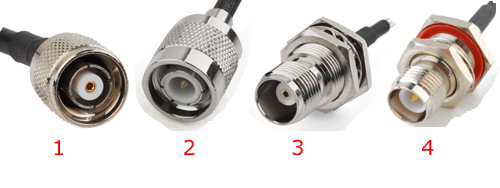

Is the RAST II one of these?
They refer to is as the 'TNC' range of connectors.
No, none of these are the connectors you're looking for - my guess is that you're end up having to purchase two cables and splice them together so you end up of the correct combination of connectors.
